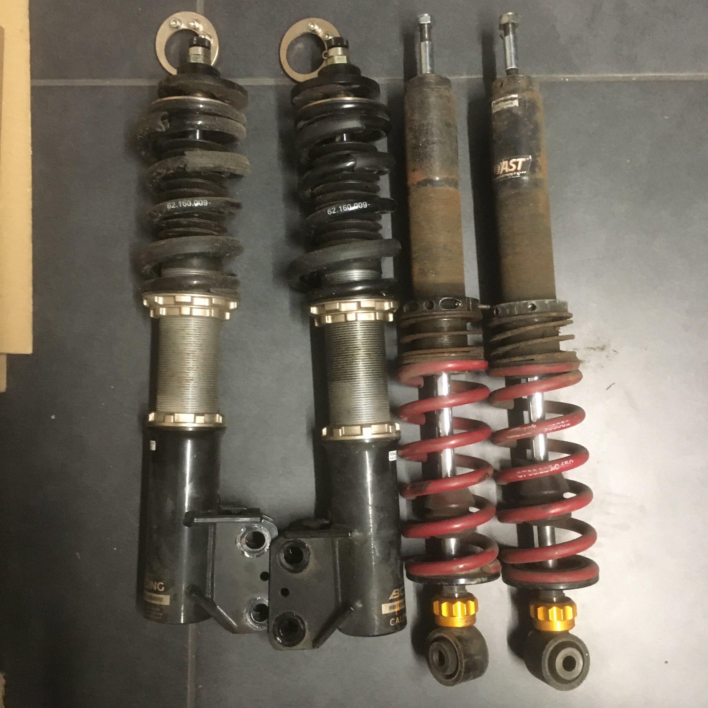

I recently picked up a 182 which came fully fettled for the track. I actually took delivery of the car at a garage where it had just been serviced with brand-new brake discs, hoses, pads and fluid fitted, set up and corner-weighted ready for a trip to the Nurburgring.
However the owner's plans changed and I became the new custodian of the little Liquid Yellow buzz box.
I am not a track driver but I do like to make progress on the road. It quickly became apparent that the setup on this car was too hard for road driving. It was fitted with brand-new BC DS coilovers on the front with 9kg/mm springs, and AST 4100 units on the rear, plus a new Whiteline rear arb.

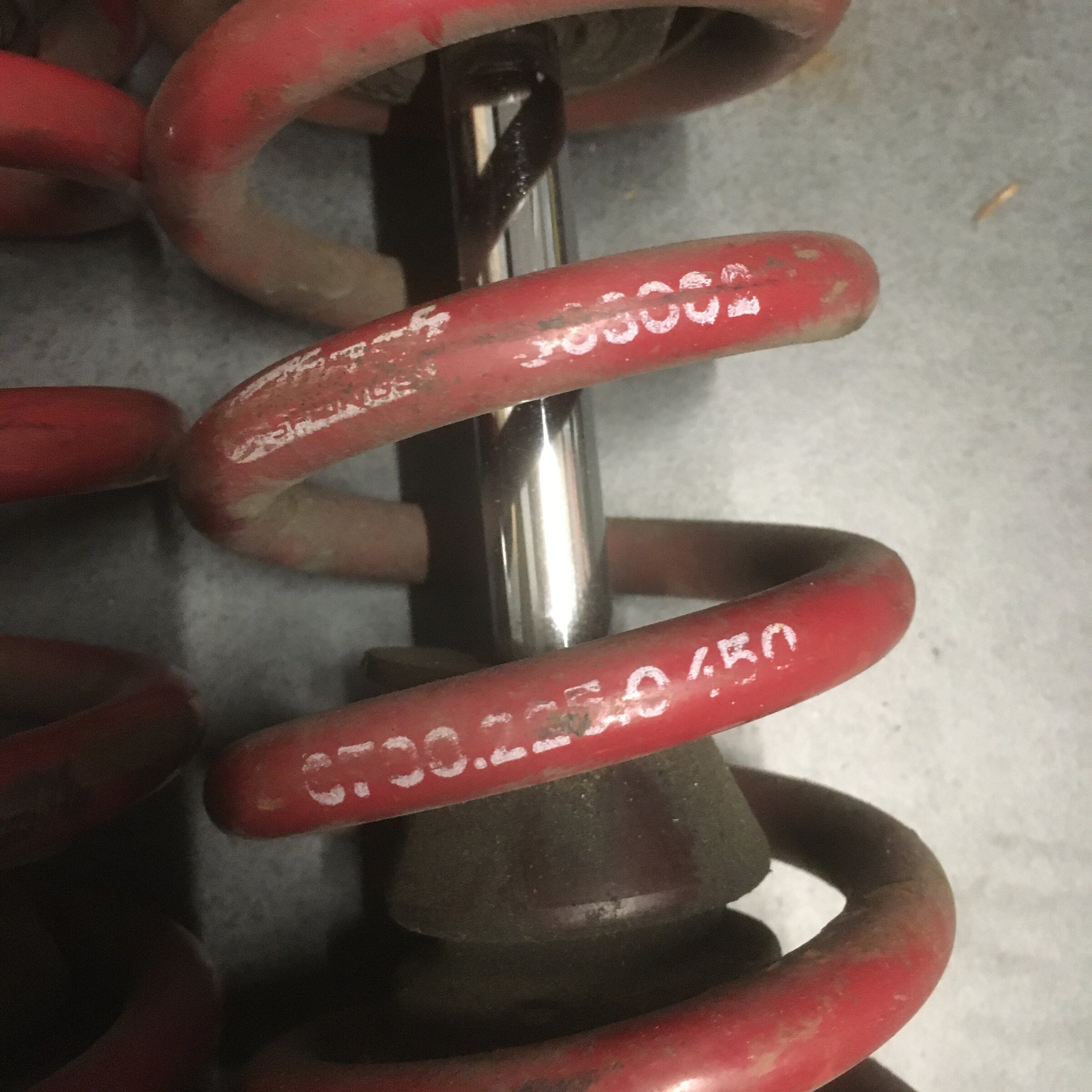

Pending confirmation from AST I suspect the "450" lettering on the Eibach-made springs denotes poundage, 450 lbs/in corresponding to 9 kg/mm.
The setup while no doubt superb on track discourages spirited driving on the road. With only 950 kgs of car to deal with every undulation makes its presence felt, and the thin plastic seat base of the Corbeau Clubsport buckets is felt constantly flexing through the derriere.
So the quest is on to find a new setup. The first and foremost criterion is enough compliance to deliver a good primary ride - essential in my opinion for a road car. I appreciate many others have been down this path before, but having devoured all available information on Cliosport.net and indeed the internet, I am still left with questions hence this thread which hopefully may be of use to others.

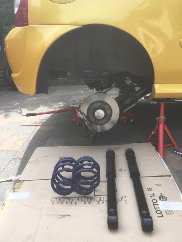

New struts are cheap but I happened to find a used set locally with H+R springs, which at least visually were in good condition so I figured no harm to give them a try. At least would give me some practice fitting the parts.
It couldn't have been easier to take the rears off and put on new (used) parts. Except that I didn't have the correct rear top mounts so there was a wait while I sourced those. Was amazed to discover you can actually change the suspension without even taking the wheels off.

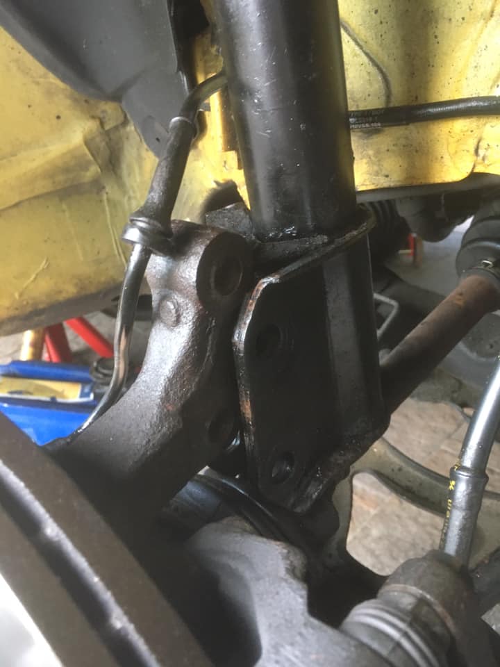

The fronts were a little more tricky due to the upward pressure exerted on the hub by the anti-roll bar, but once you've got one side on, the other is cake.
Here's the kit that came off. Top branded gear for sure. I'll keep hold of it for now just in case I ever decide to do a trackday, or in case I try the 7 kg/mm BC spring option.

Things may have changed over the last few years though as AST pricing has increased maybe its to compensate for more custom work.
I would assume these were an older pair as I got them used a while ago, they came with the spacers on the rear to make up for the short spring length. Since got the right lengths and the rears were fully serviced for the new springs. Fronts kinda need a service but nothing adverse is happening to the handling in that area so will send them off in a bit.
Kev@KAM
ClioSport Trader
  Badass Toyota
Well I guess thats why the older ones were sold for £1400 vs £2k today. Custom costs extra time and therefore money
