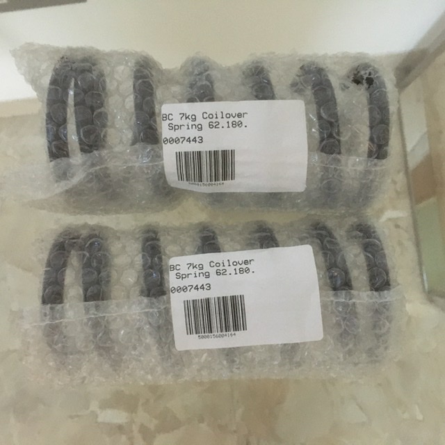

Thanks chaps. If I still don't get along with the softened BCs, my next port of call will be solid top mounts and camber bolts with OEM struts. I'm convinced I need camber to get the turn-in response I'm looking for.

Ordered these just yesterday - great service from BC/Apex.

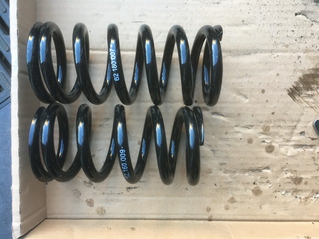

AST confirmed that my 4100 rear spring rate is 450 lbs/in. Which means they are almost four times as stiff as OEM, or Bilstein B14.
Are you going to get softer springs for the asts? They look a bit tired too, a service and lower spring rate I think would be better than oem shocks although its cost, Im not sure how much ast springs are now days. Mine were 50 quid without vat
Any idea how much to re-valve the ASTs? Would have to do this this to be able to use springs soft enough for my needs.
100 per unit not inc vat for service, just a valve is a bit cheaper but I would get them serviced. What it was for me when I had them sent off. Could be at least 380 judging on those prices (with new springs) and thats not including if anything else is needed for the service. It depends if you want the perfect fast road setup then youl 100% want coilovers but for the price of just the rears you could get f+r cup dampers and springs..

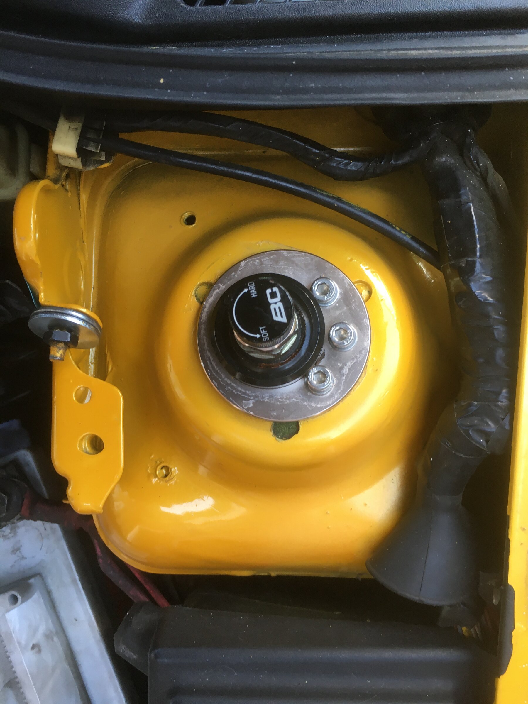

Almost too hot outside in the sunshine to work on cars, but managed to get the front struts off and the BCs back on now with 7 kg/mm springs.

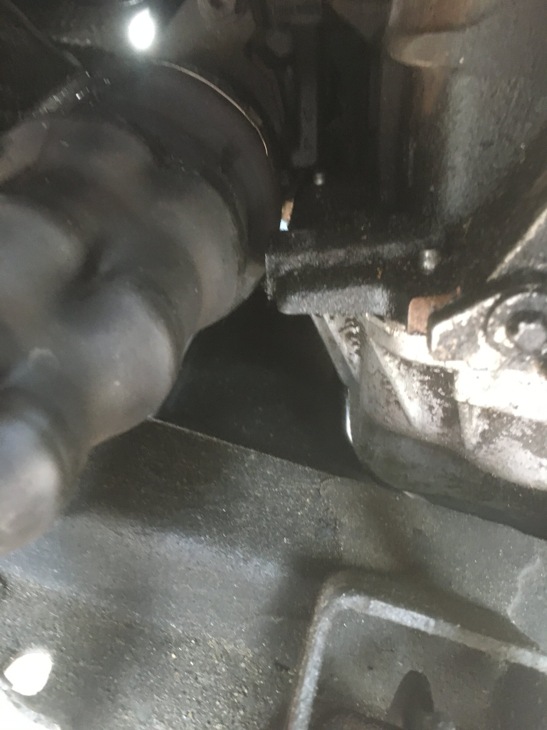

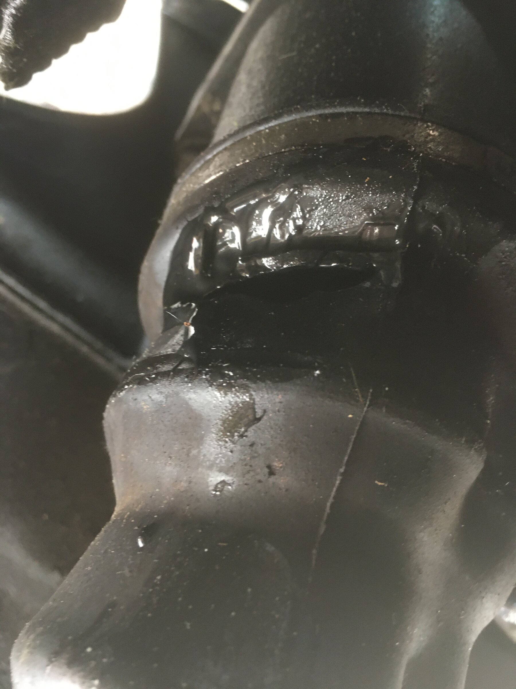

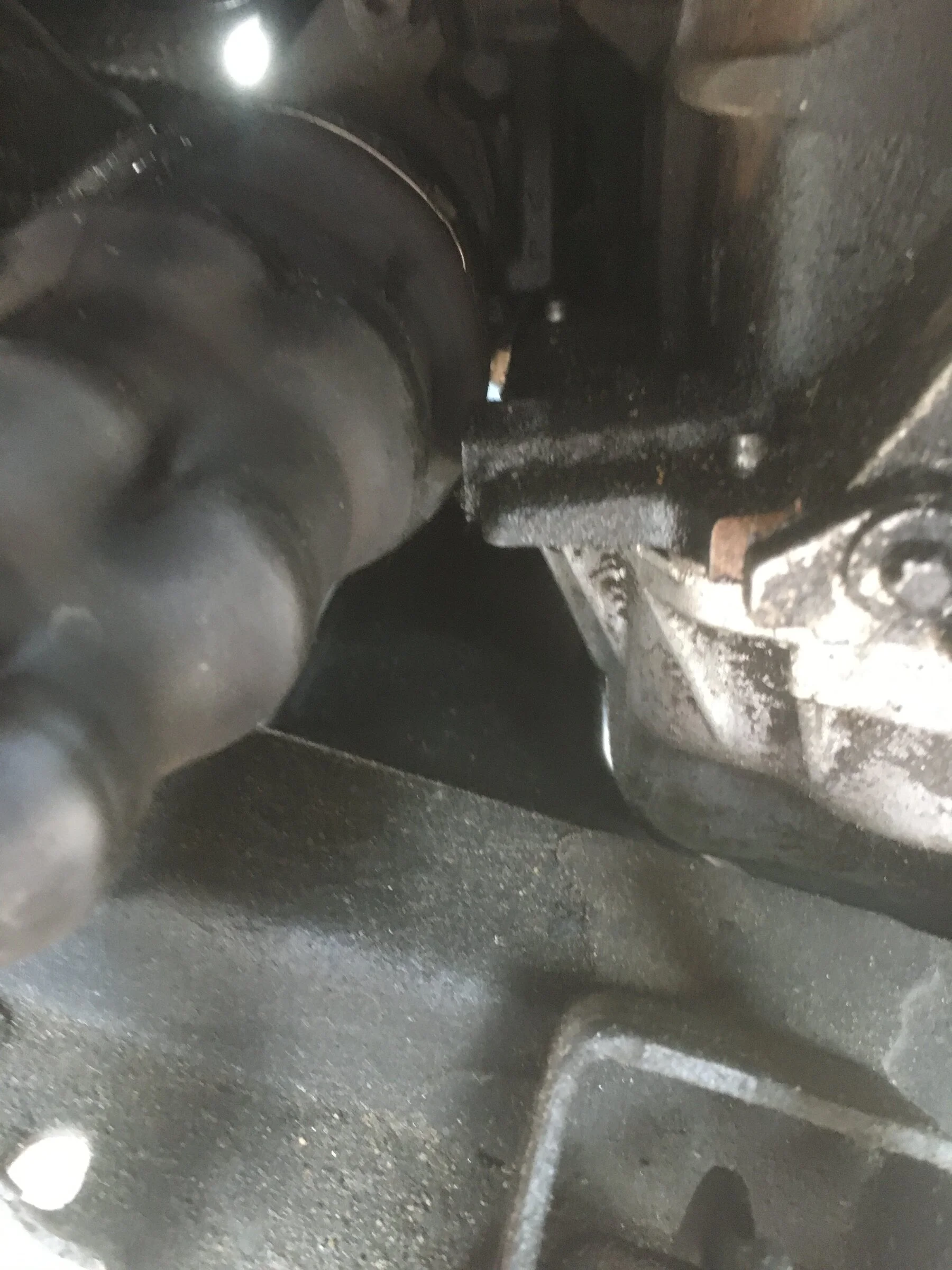

Along the way I discovered a nice tear in the driver's side driveshaft. A bit of reading up on Cliosport.net reveals that this is a common problem and a pretty shocking bit of design from Renault. The tear is on the inner not the outer fold of the bellows, and I suspect what has happened is that the CV boot expands at speed due to the air trapped inside, which then catches the rear of the block.
Replacement driveshaft incoming. Going to try a trick a friend recommended of inserting a red WD40 straw into the CV boot as a breather to stop the ballooning. However I was eager to get the car back together for a test drive, so put a bit of superglue on the tear as an interim measure.
This photo shows how close the OS shaft is to the block.

Rather gratifyingly the ride quality although not quite as compliant as on the OEM front struts and rubber top mounts is far better than when using the 450lbs AST coilover rears. So it appears Bilstein's approach of using a harder front and softer rear is just the ticket for the road.

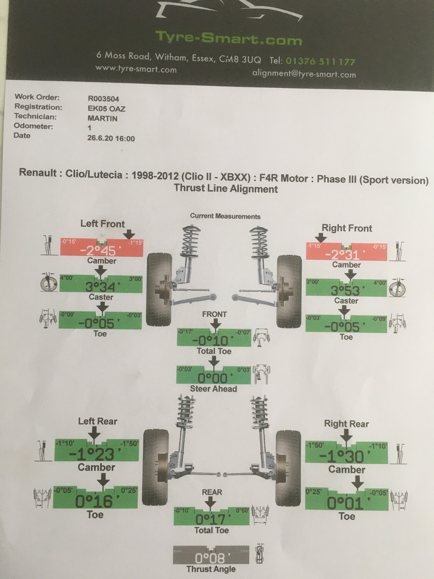

Following Alex's recommendation I drove straight from his workshop to Tyre Smart in Witham for an alignment. With the BC top mounts rotated to maximum caster these are my settings:
The drive home felt very good but in Friday-afternoon traffic and with parts in the boot I wasn't inclined to push.

100 miles across Herts and Essex on my new suspension and I am happy to declare job done.
I can honestly say now this is one of the best-handling cars I've driven, and I've been driving for 31 years. In fact I think I prefer it to my R26.R which can get a bit twitchy at the rear when entering corners on a trailing throttle. Some people like a mobile rear end - I don't, not on the road at least.
The poise is resolutely neutral - the front refuses to let go and yet the rear with relatively soft springs and the Whiteline ARB on soft is also absolutely planted and poor road surfaces are dismissed with ease. With 7 kg/mm front springs and adjusters set to the middle, body roll is well contained. For my tastes the firmer front/softer rear combo is 100% bang on.
It is such a confidence-inspiring car. Through all stages of the corner the car is with you - it never threatens to bite or do anything unexpected, but it eggs you on and invites you to push harder. Coming from much faster cars the Clio is making me a better driver as I learn to carry much more speed and conserve momentum rather than relying on grunt to make progress.
The new suspension isn't a night and day difference, suggesting that my old parts weren't completely shagged. The most noticeable benefit was the squirm under braking has disappeared, making corner entry a much more composed experience. In fact the chassis could easily handle more power. Must resist turbo conversion!
The steering is still too low-geared and a little too vague around the straight-ahead for my liking. And an LSD would be nice. But that's about it for drawbacks. What a car.
