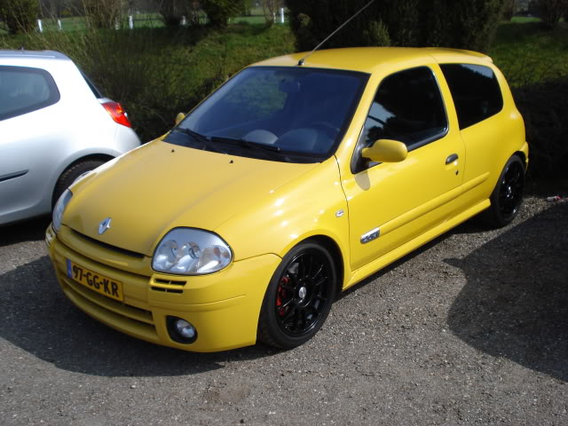

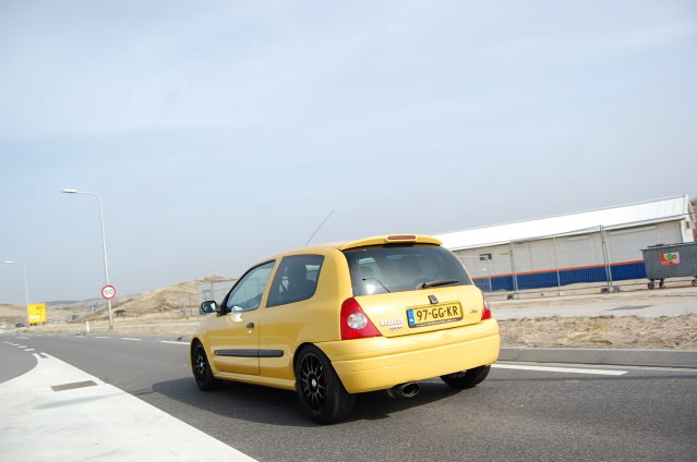

My rs project from the start...

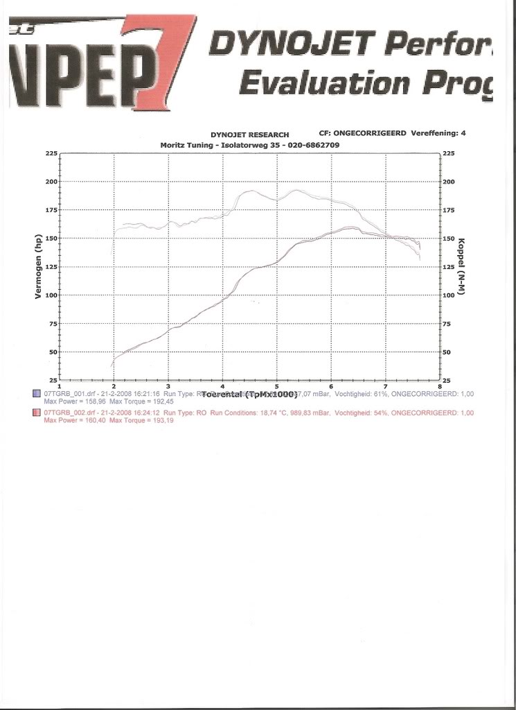

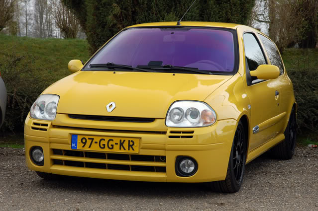

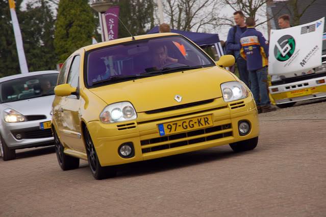

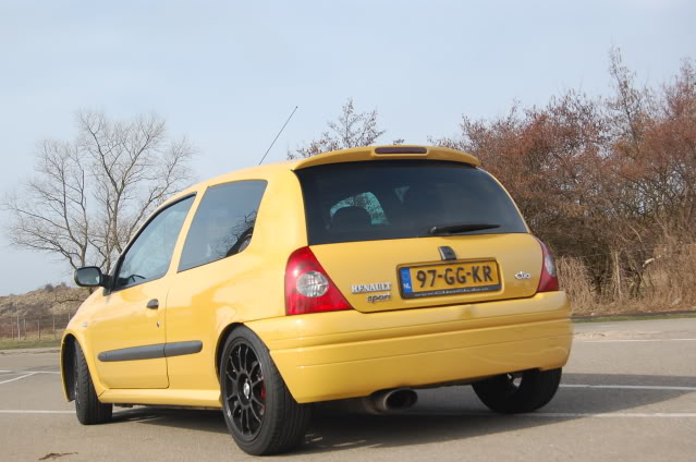

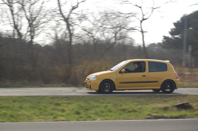

Excellent car. Henk did a fantastic job I think.
But 163 ATW is a little optimistic w/o cams.
  f**ked ph1 172
he's brought the transmission losses right up by letting the engine run down with the wheels rather than letting it coast.
  RSTUNER'ED-C&B'ED RS-1
163 HP ATW is almost 190 at the fly, w/o cams it seems a little high to me. I think your engine is very healthy.

Good job getting the remap to suit the filter !! Would never had thought it would make that much

Maby i have cams and other things in the engine. When i bought it it had the 182 header so, maby there is more work in the engine.

btw mine had 160,4 atw on the rollers in Amsterdam and i was thinking this was exaturated a bit too. (with Exhaust and Group N map)

Stunning.... Coming along really well..... Chasing down Middo for the Nicest Sunflower on CS

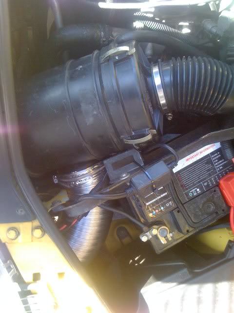

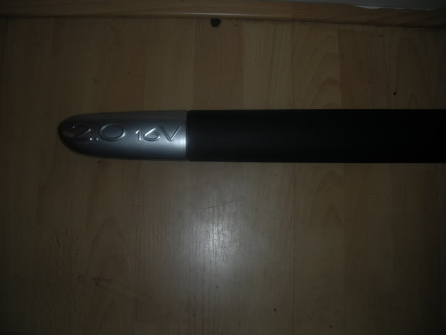

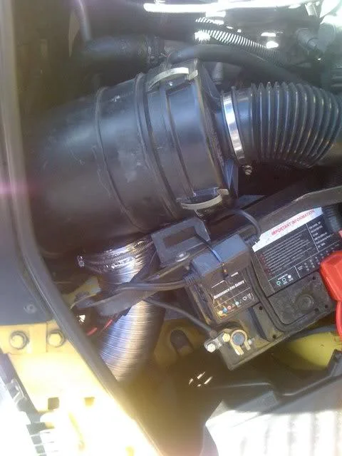

Got my Espace v6 airbox fitted and i can say it realy feels beter than the old 172 airbox. With a hose down the front bumper.
