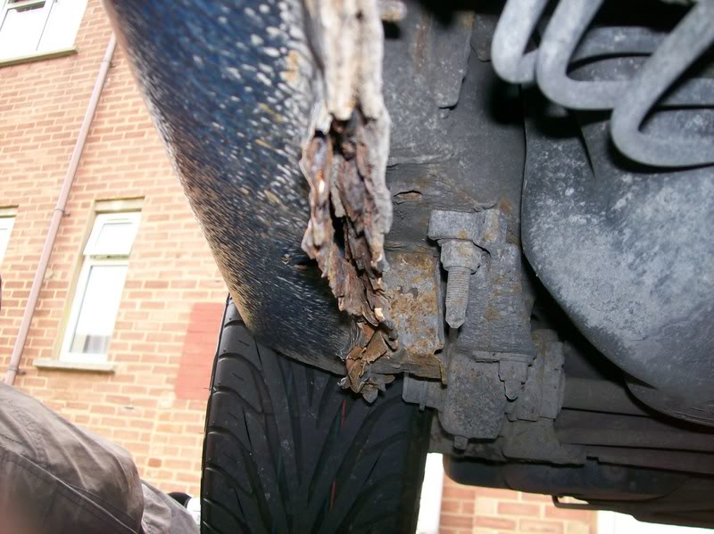

ok i've now got a williams 2, owned it for a week and am now sorting the little nigles that it keeps throwing at me.
this being the main one!!!!
not sure how bad this is? and how easy to fix?
passenger side is fine not a mark on it.

new sil section, bit of welding. not a big job really.
i dont think the sils are that expensive from renault, but if they are, just get universal ones from any automotive parts place, the sills you get you just cut down to whatever size you need.
depends where you go.
normal backstreet garage would charge maybe £100-£150
renault would be closer to £500

from what i can see, a previous owner has jacked it up just passed the jacking point - denting the sill and lifting the paint - thus causing a pocket for water and general crap!:mad:
so hopefully, garage to weld in new bit - bit of filler then some thick hamourite over the lot and some waxoil or the likes where ever i can spray the stuff!!!!!!
ya its bad jacking that causes this crushing up the sill lip just enough for salt water from roads to cause damage, over 12-13 years of salted roads wouldent help, i find after a small weld job on a car with rust compleatly gone , a good high build 2 pack primer works wonders to prevent future rust..
