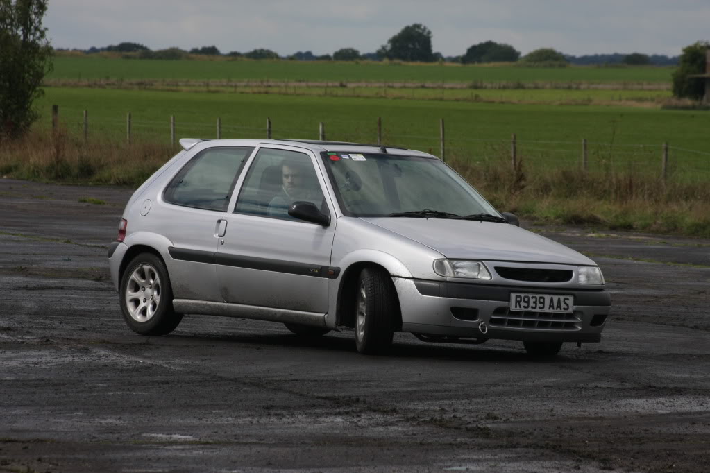

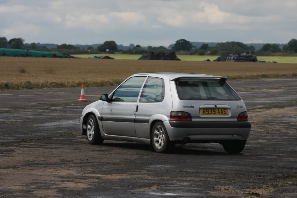

This meant the car was ready for the airfield day, which was great fun:
Click this bar to view the full image.
