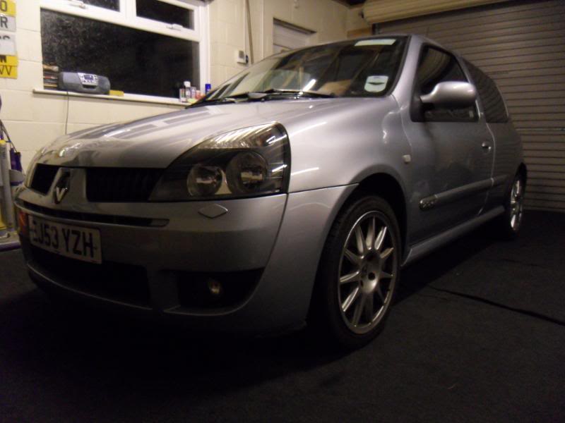

My Silver 172 Cup
Chris205
  Many Things

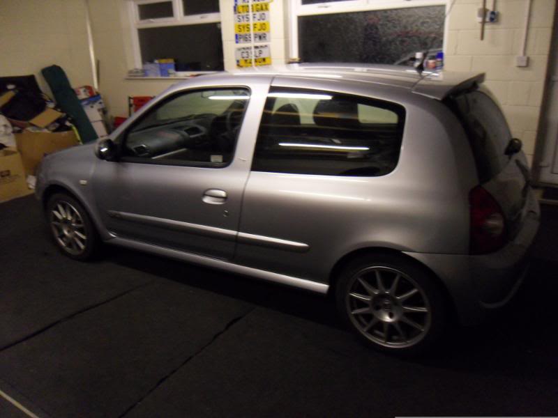

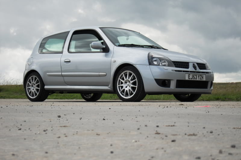

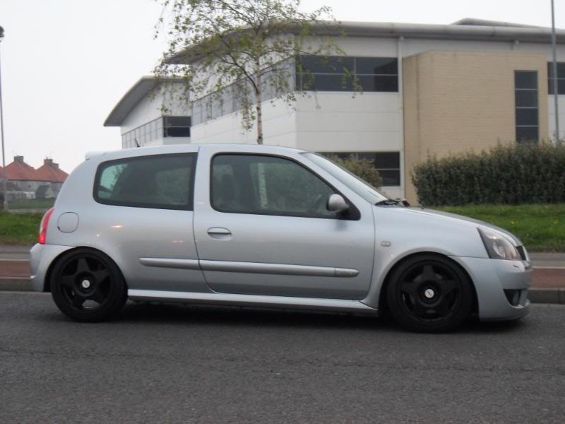

Purchased 2 weeks ago after the demise of the trophy (mwahahaha) Completely standard :cool:
Wasn't looking for another clio but saw this on ebay and thought I would put in a bid for it, 74k miles, belts just done, new discs and pads and 12 months MOT on it. That was all I knew and I set off to derby on a mission. After arriving I found out the lady who owned it has had it since it was 2 years old, so just over 5 years. I also was suprised by it having climate control, I do quite like it although I am thinking of making it a propper cup and removing it.
My girlfriend has just bought a 172 which means I can go daft with this one and make it as un-user friendly as I like.
So here are the pics after purchase, I've done bits and bobs so far but waiting for some parts to come back off the trophy.
*Check out the diamond style washer blanks* ..... I will be removing the bumper to rectify them shortly though, probably when I pick up some xenons

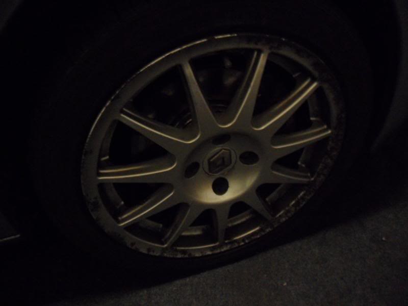

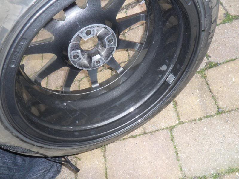

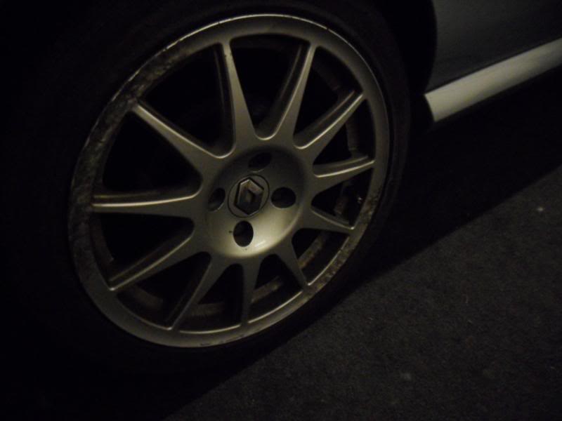

Scabby wheels :dead:
Split thumb grip

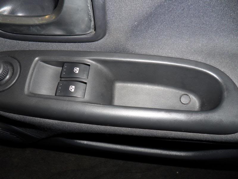

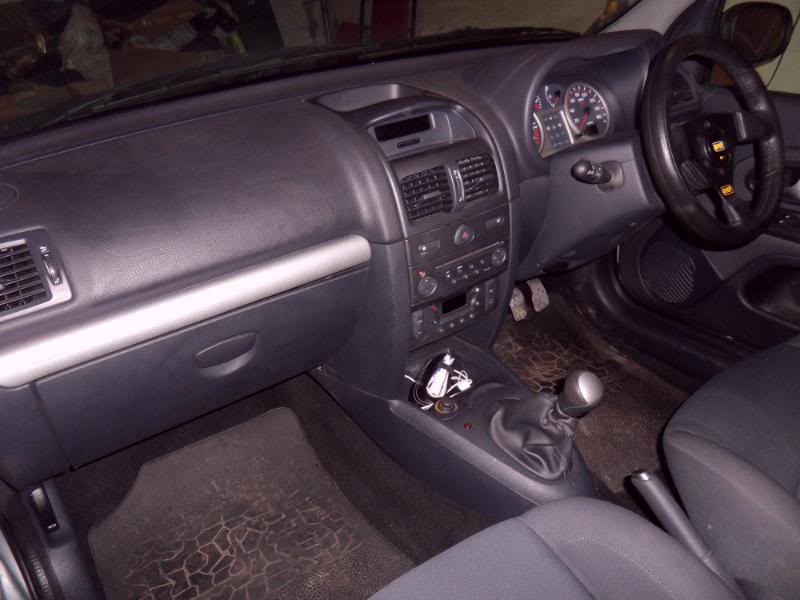

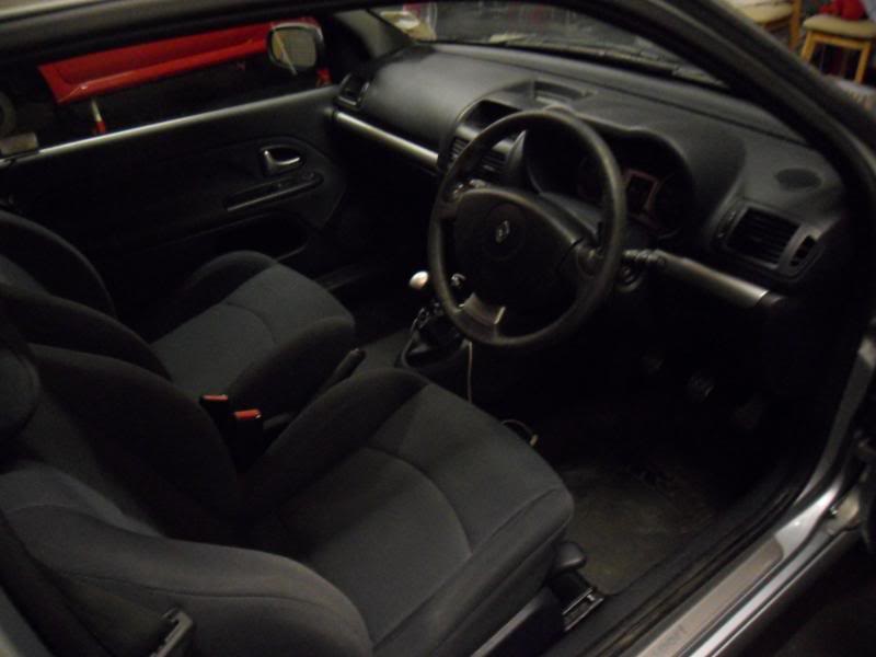

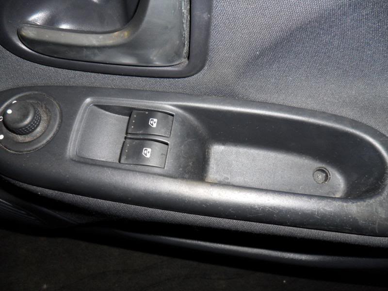

First job was to sort out the grab handles, they were looking a big grubby so I took the ones out of the trophy and put them in the cup

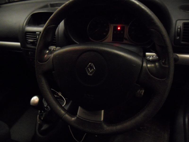

Steering wheel swapped over

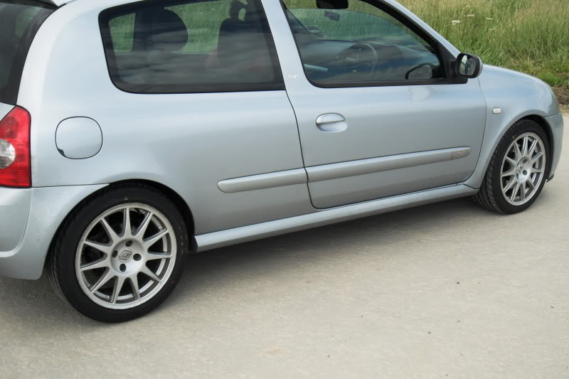

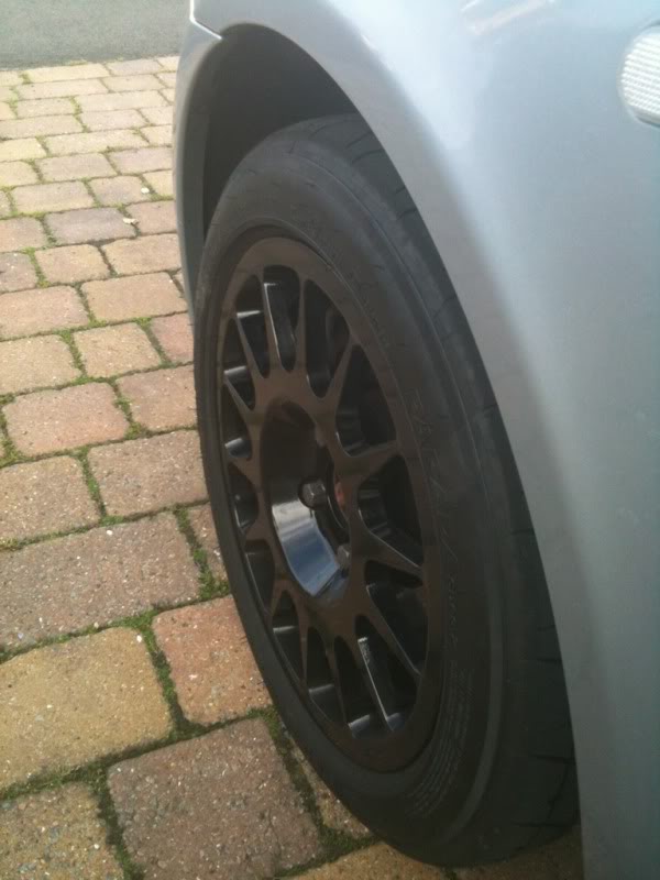

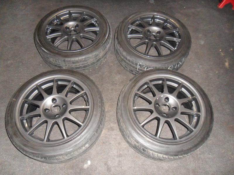

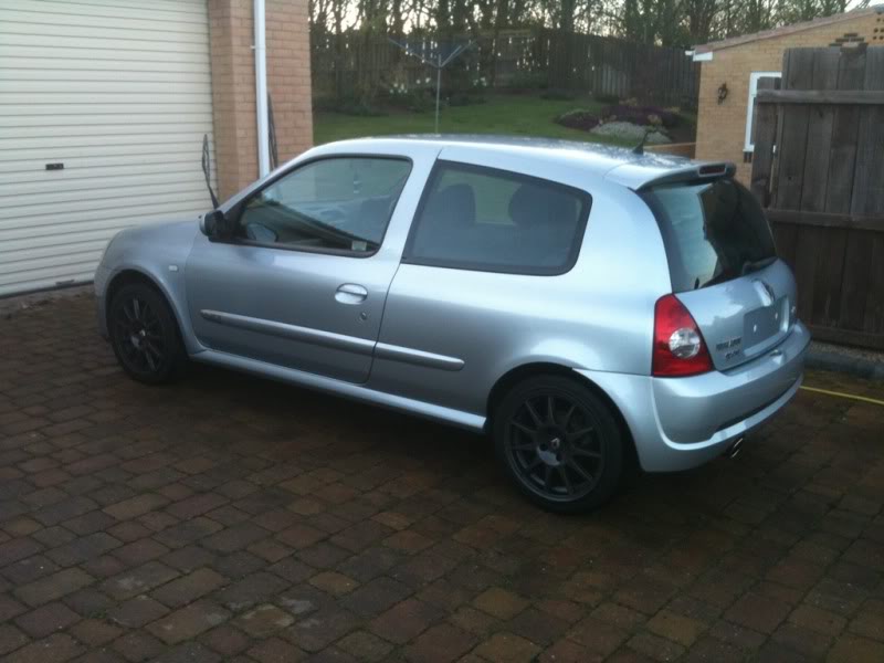

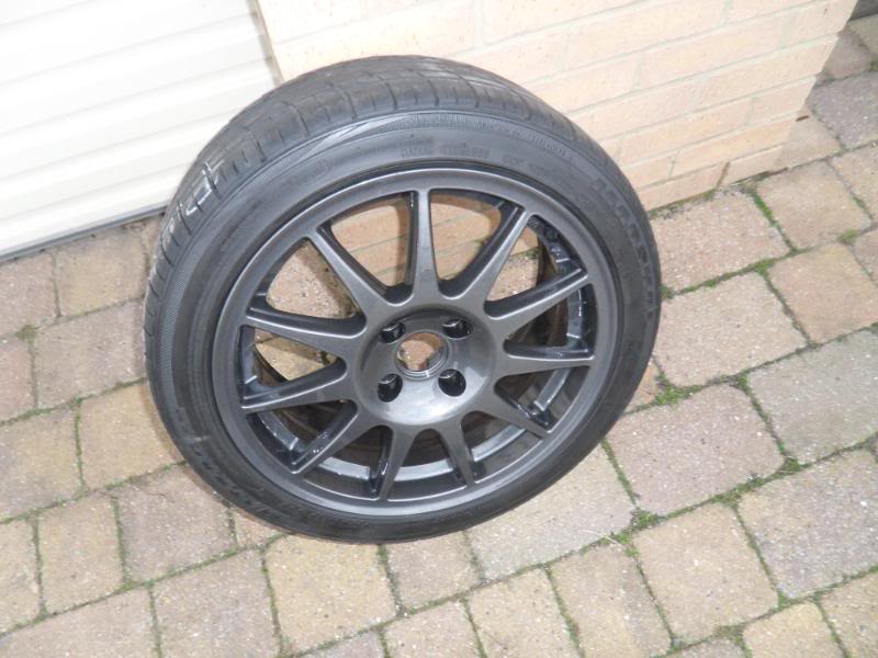

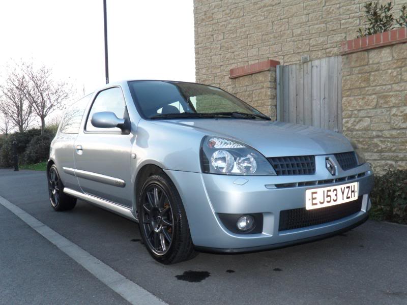

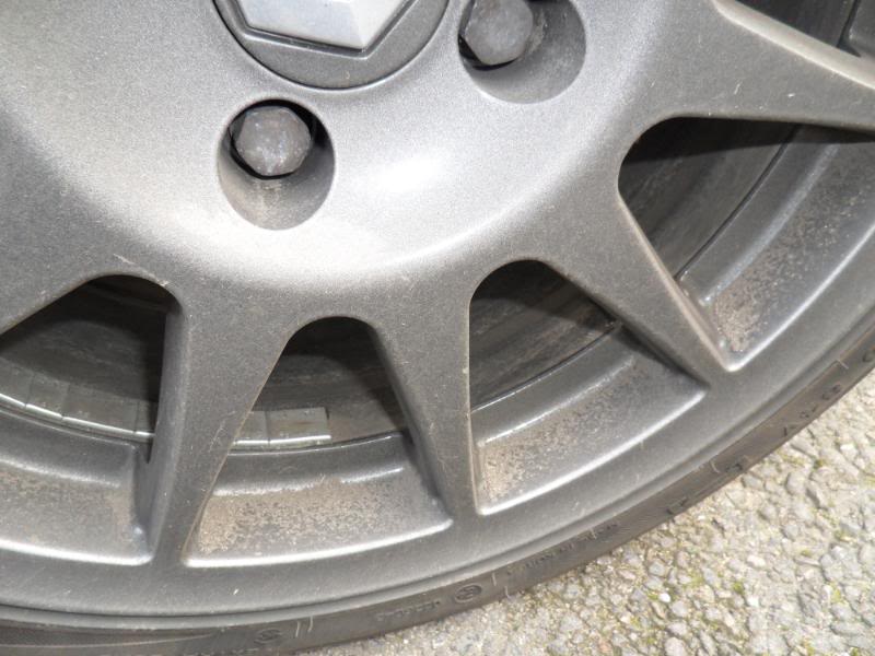

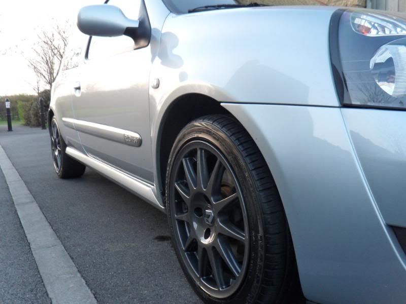

I sent the wheels away to a local refurbers, they've been powdercoated anthracite to the tune of £240 , I was considering going silver but I'm going to get myself another set of wheels to fit some hankook rs2's to so they can go silver instead.

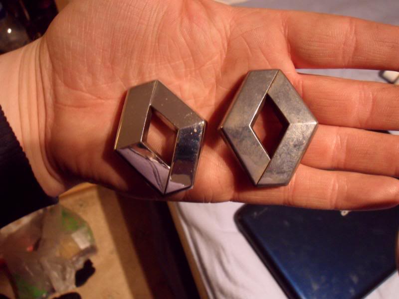

I had the centre caps painted aswell and while they were away I popped out the diamonds and gave them a clean

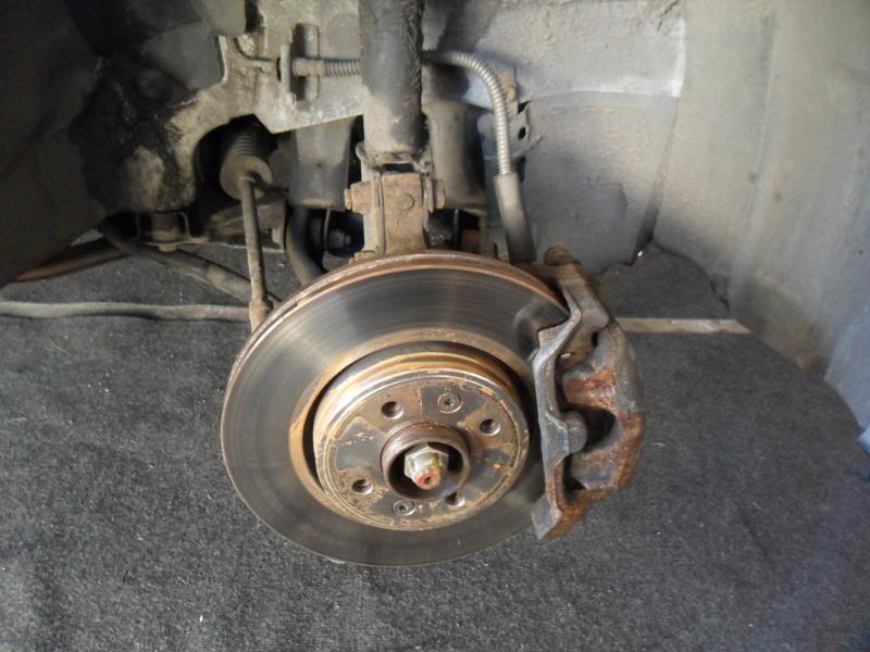

Sort out these calipers and paint the hub part of the disc

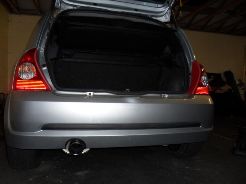

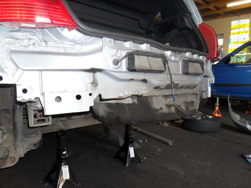

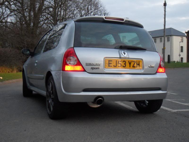

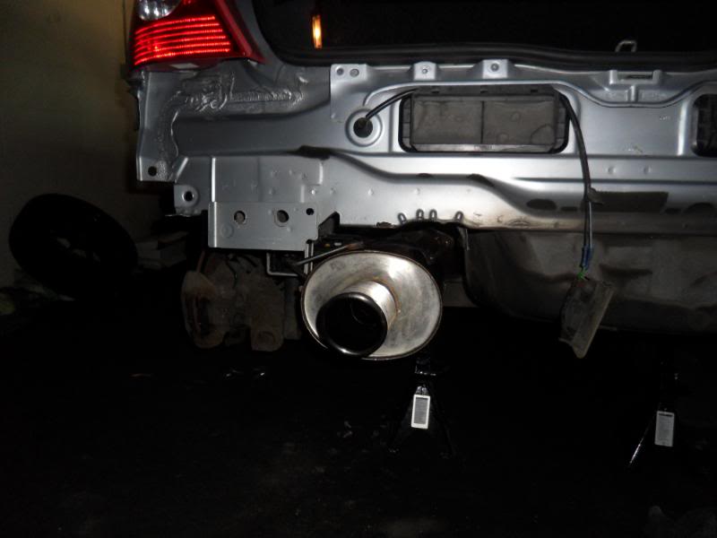

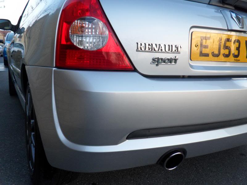

As I mentioned the girlfriend bought a 172 and it had a full AAS cat back exhaust on it :) needless to say I bargain'd that one off her, so I set about removing the old bumper and replacing a few things on the way.

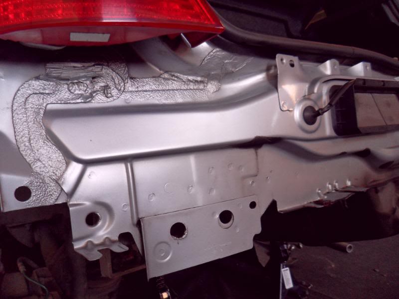

Gave the back panel a clean while the bumper was off

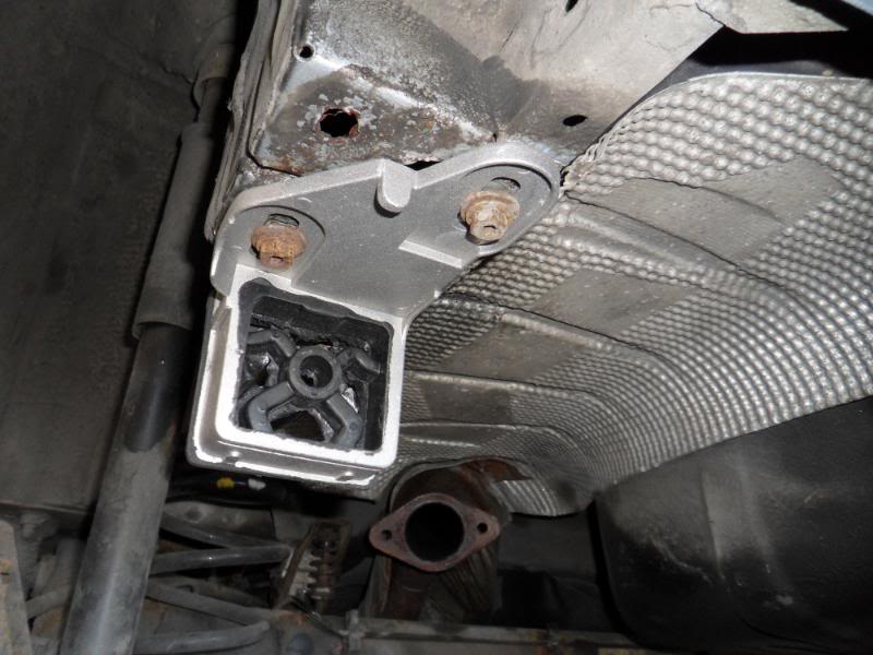

New exhaust mount, will be replacing the bolts and giving it a full re-paint/underseal at some stage anyway
Exhaust mounted up, gave it a polish before it went on, need to get some wire wool and spend a few hours with the autosol to get it up to standards

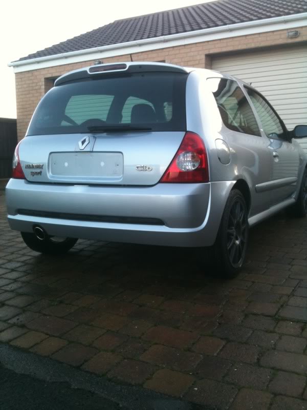

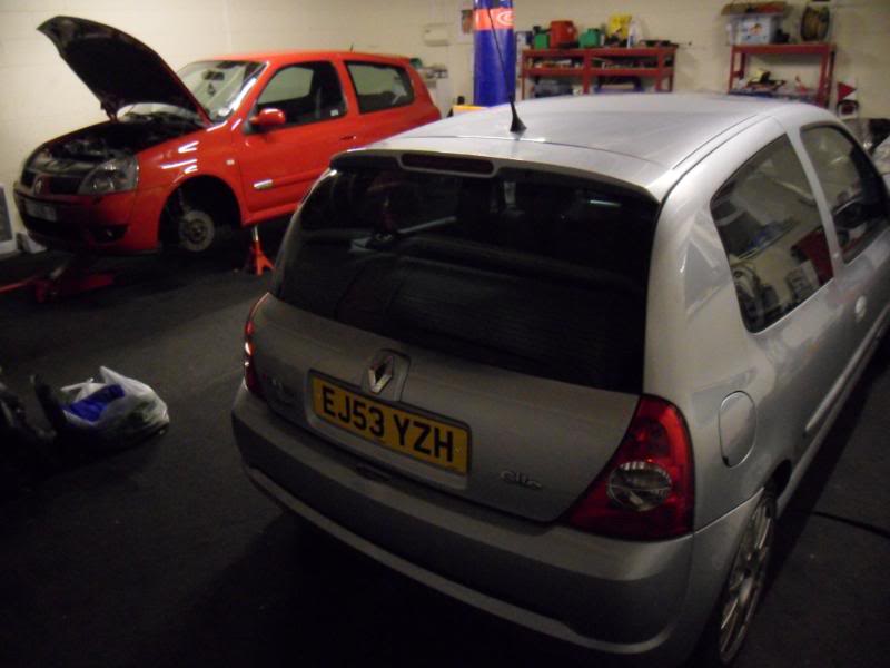

Small aerial and my mats fitted

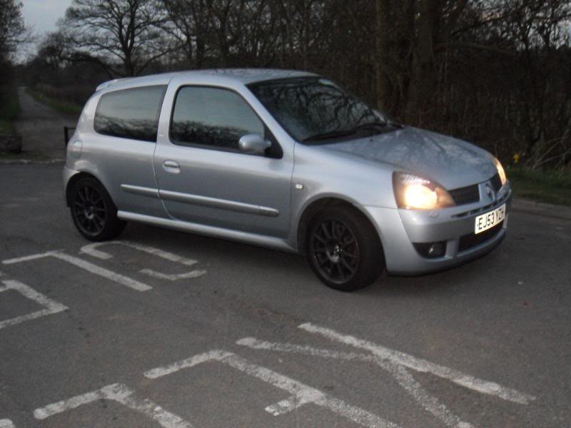

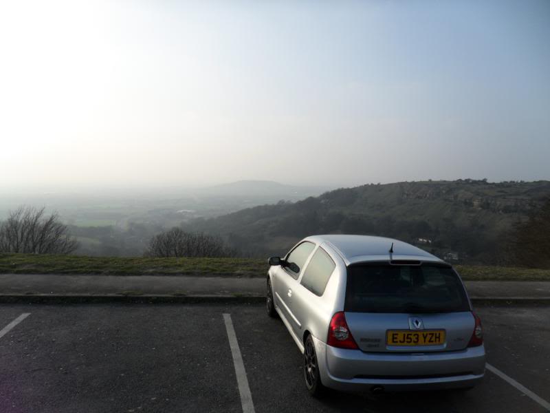

Took it out for a quick drive
Crap pics tbh but I will be getting some better ones when the suspension has been set up etc.

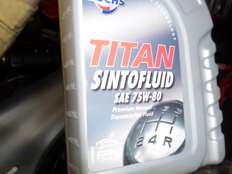

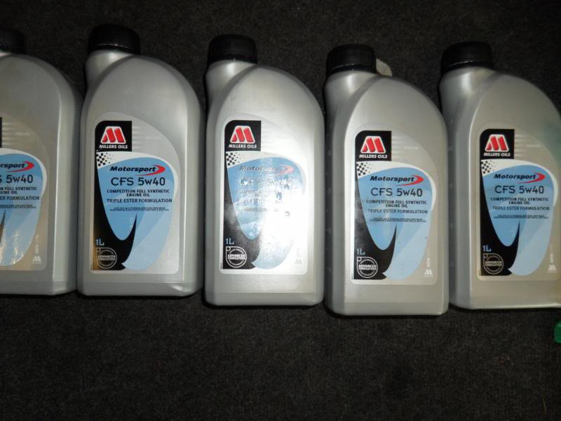

and a new oil filter which I'd already fitted before busting out the camera

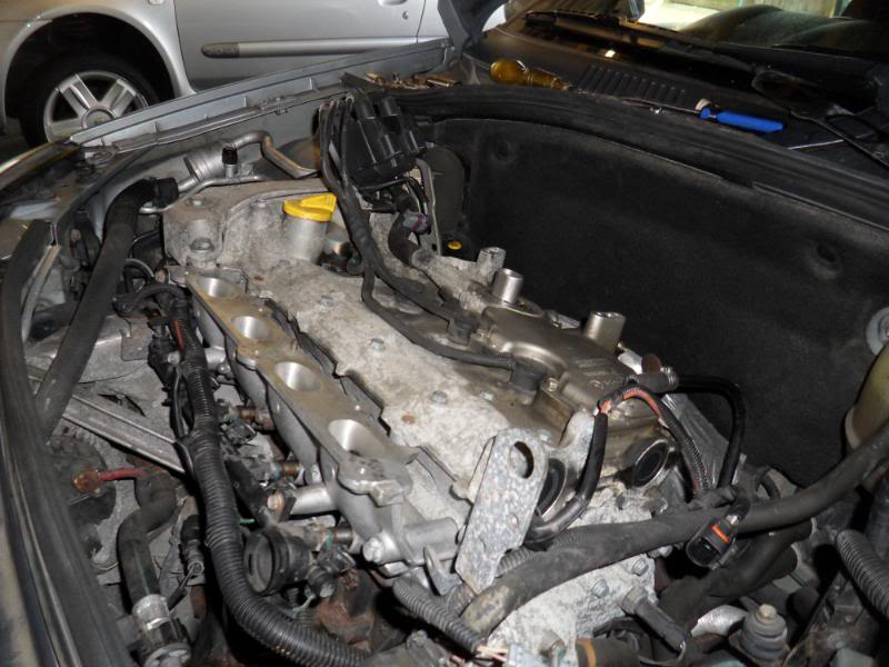

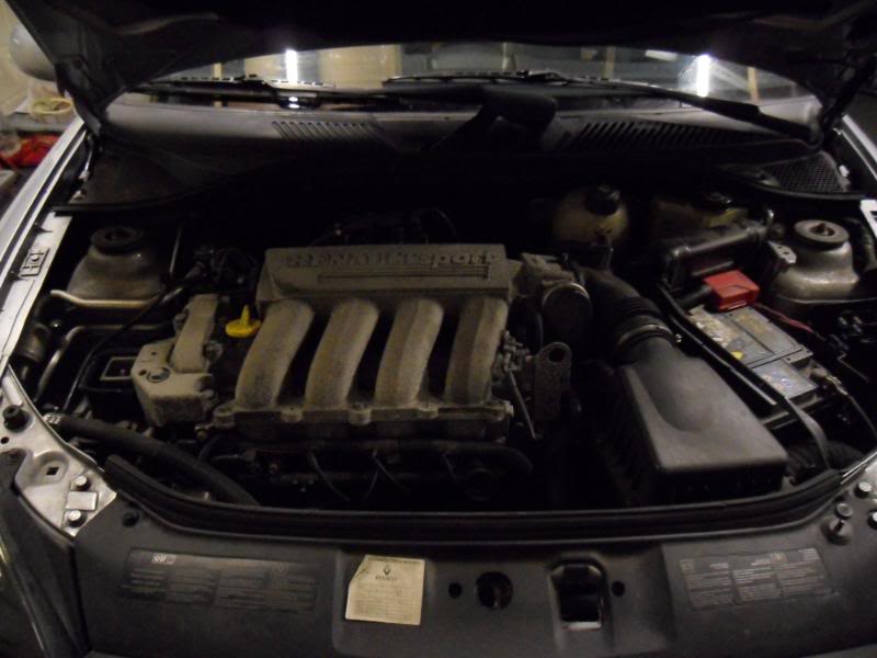

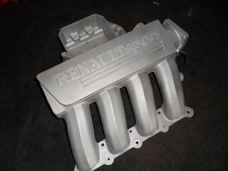

Matched inlets courtesy of JMS

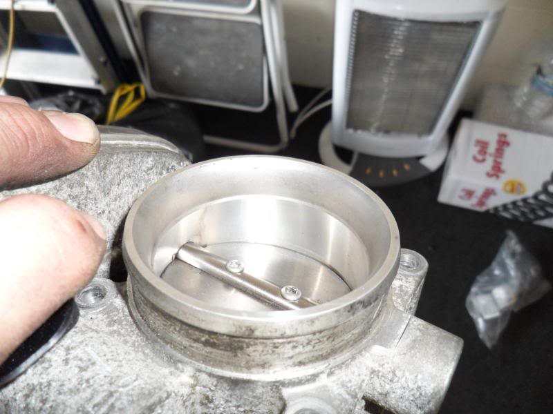

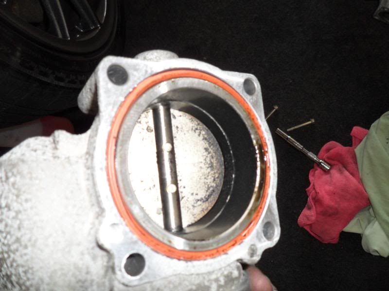

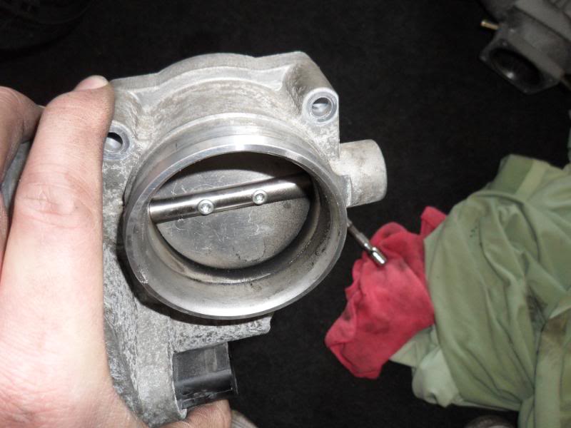

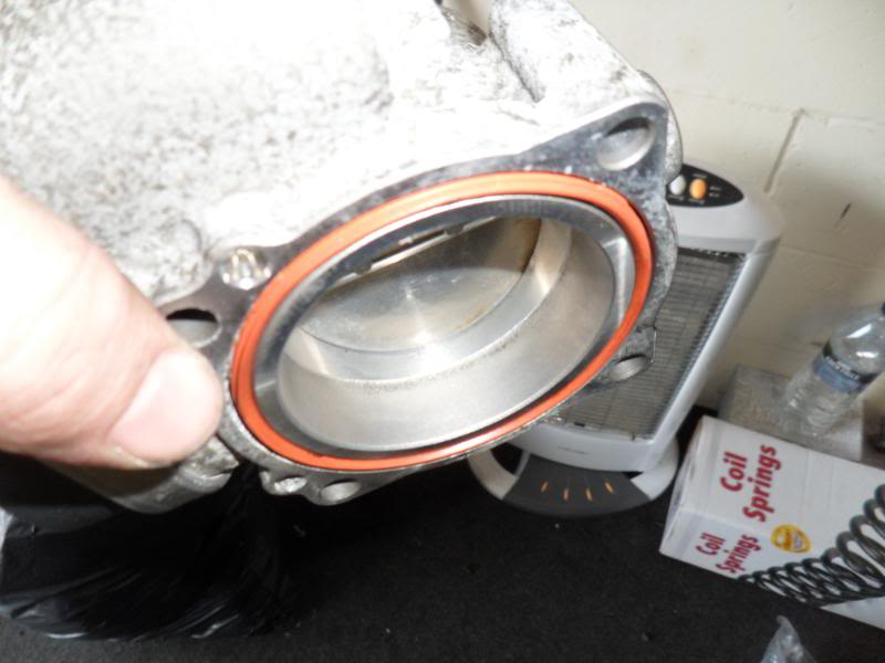

While these were off I took the opportunity to clean out the throttle body,
Before:
After:

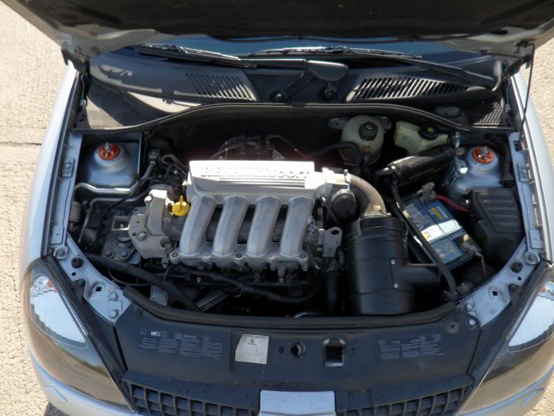

I've also re-homed my ph1 airbox and hillpower bend in the Cup engine bay, the housing had some damage so I got a new airbox itself
Also got some uprated mounts fitted courtesy of k-tec, top engine, top gearbox and powerflexed dogbone mount.

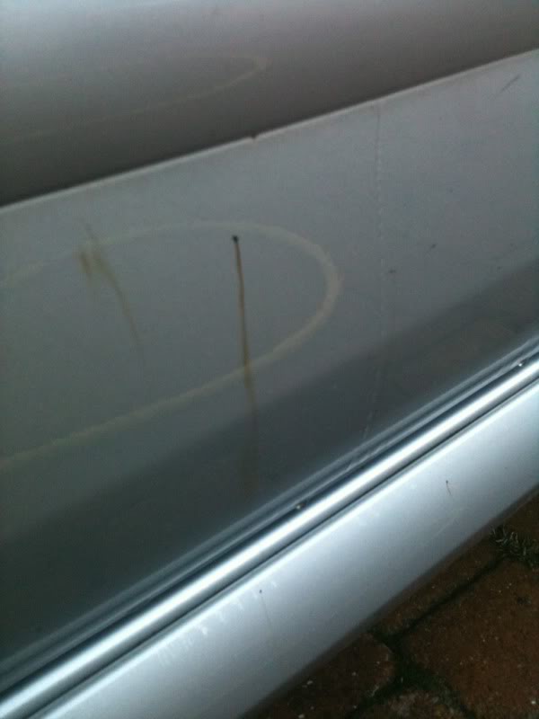

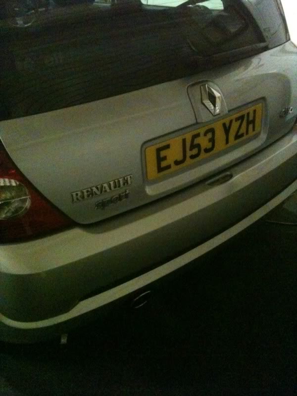

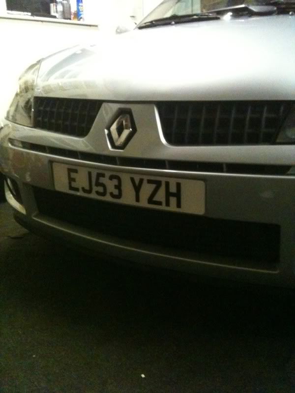

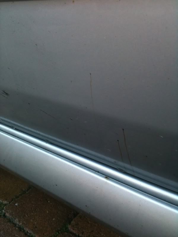

After last weeks clean I noticed an extreme ammount of tar build up on the lower sections of the cup, at the time I wasnt anywhere near home so as soon as I got back I sorted it out
Tardis doing its thing
Front plate removed
And the rear
New 3/4 plate added
New rear plate, slightly smaller than a standard size but only by 10mm wide and 10mm long

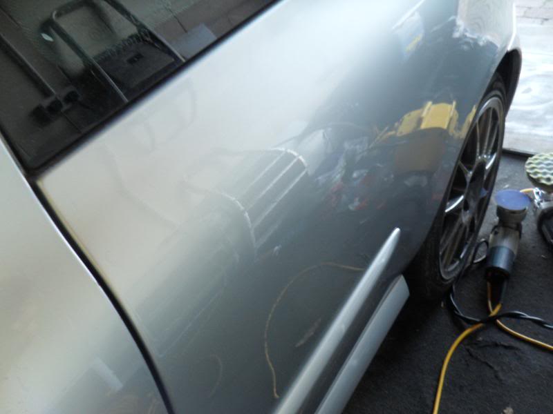

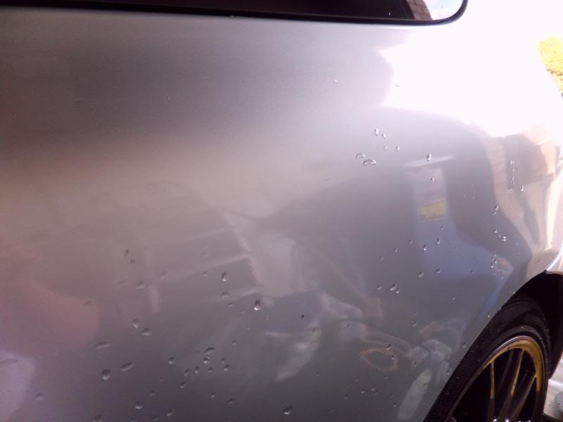

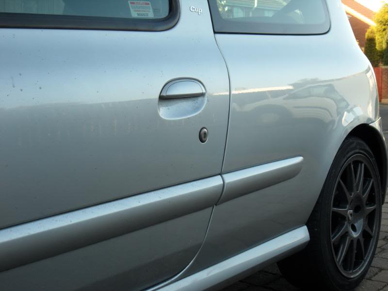

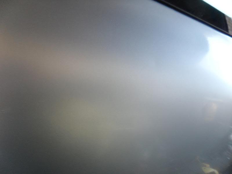

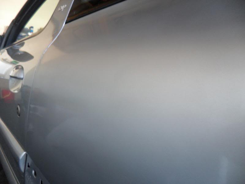

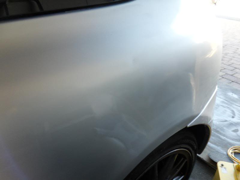

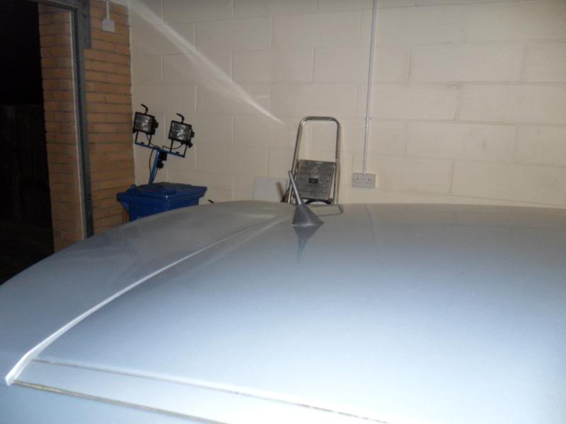

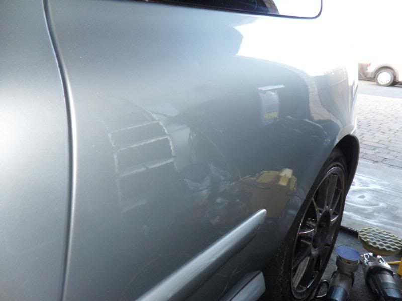

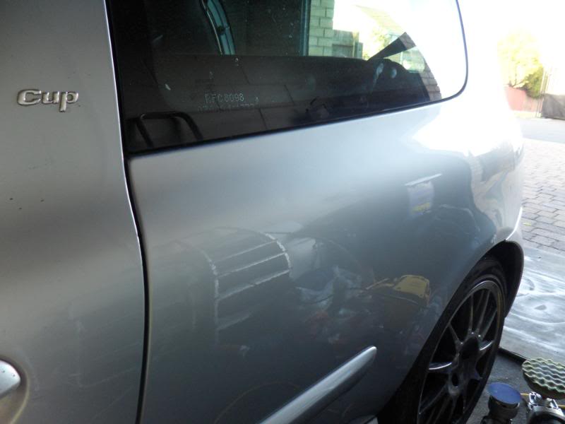

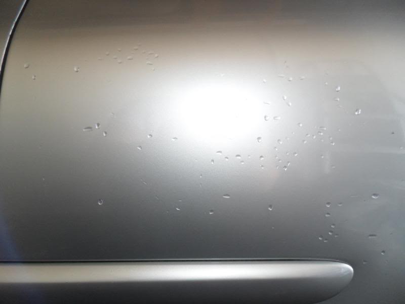

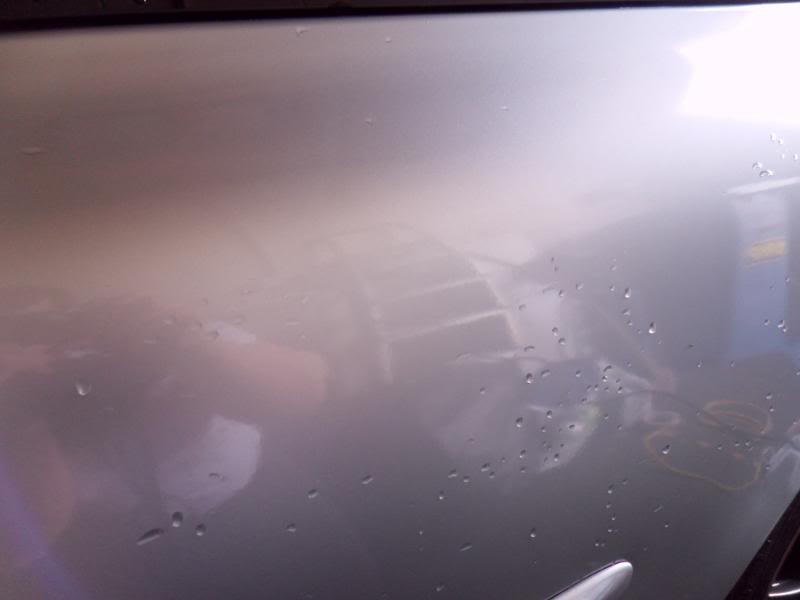

After noticing a smart repair on the clio on the rear quarter and the paint looking rather flat I decided to take a look at it in the view of wet sanding it back and polishing it back then paint correcting it.
Here are the pics, not fabulous as silver is a pain in the arse to try and catch anything from
Before
During
After
I used 2000 and 4000 grade wet and dry pads, first via da then by hand.
I would like somemore time but only had the two hours to do the above in, I'm happy so far but maybe at a later date I will do it again to see if I can improve on the current outcome.

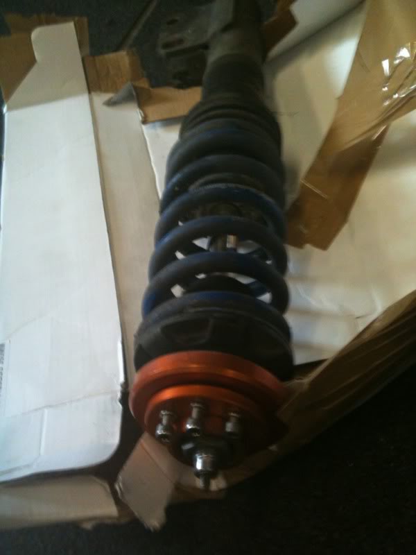

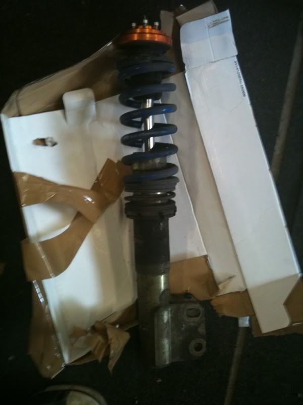

Few parts starting to stock up and take residence in the garage awaiting fitting, this includes:
Fk Konigsport Coilovers

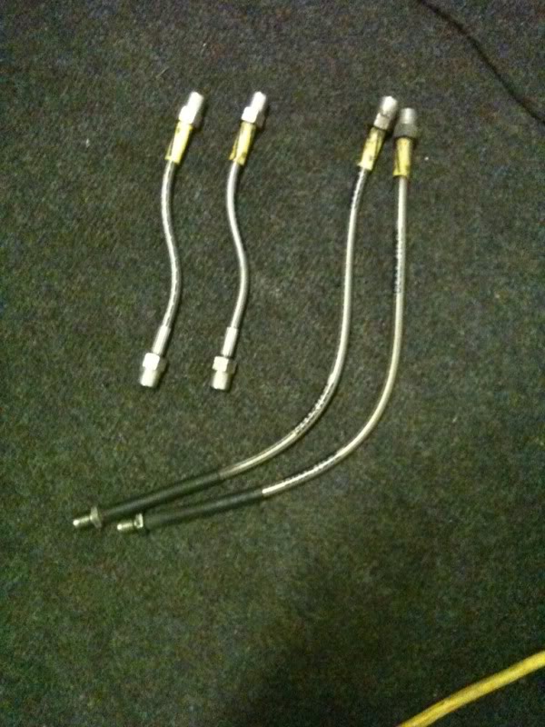

Goodridge Braided hoses front and rear
Brakes need to be blead.

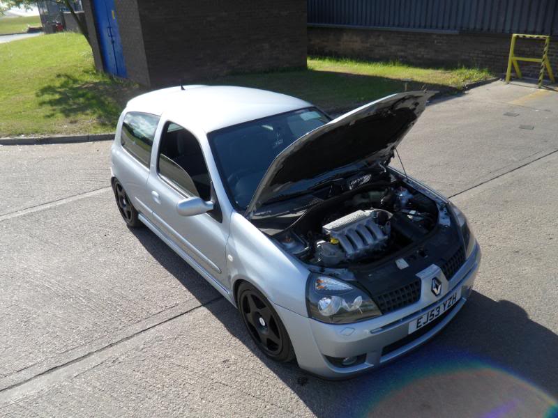

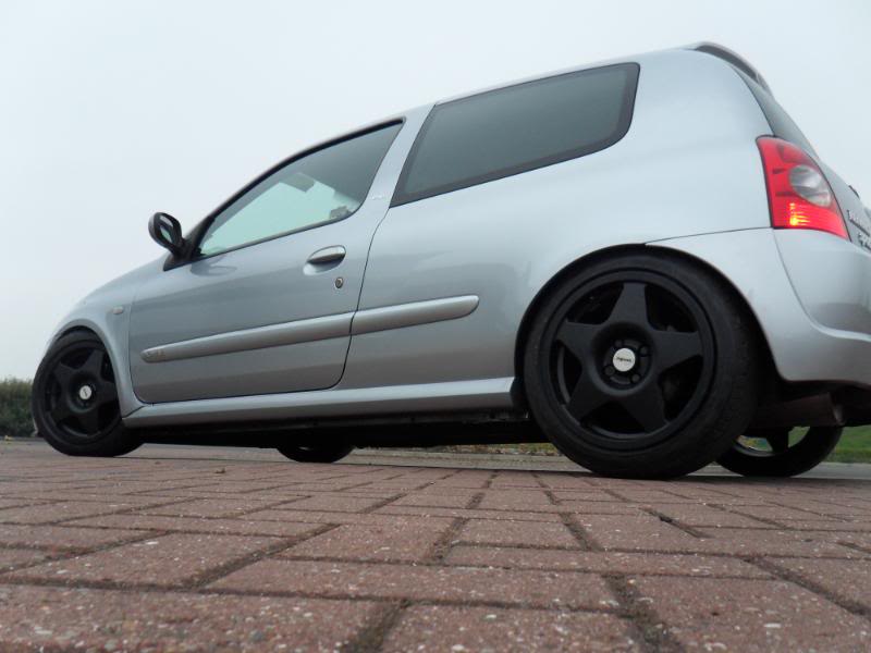

Time for an update:

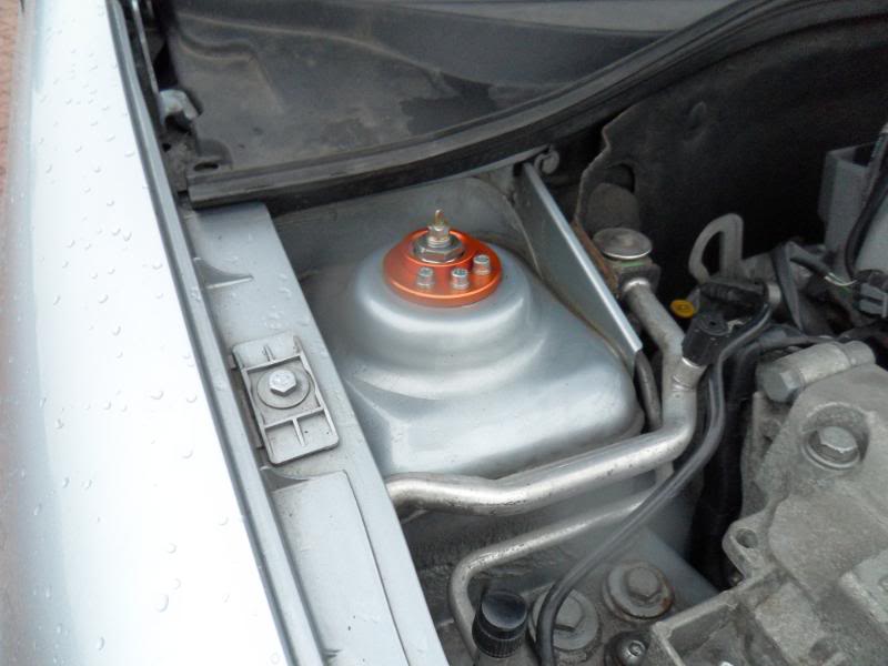

AST top mounts fitted
Fk konigsport coilovers fitted, speedline 2110's painted satin black with white centre caps
Engine bay shot of new inlets, ph1 airbox, k-tec engine/gearbox mount and AST top mounts

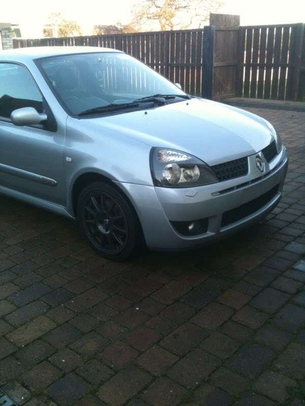

As some will have seen I've been putting my car back to standard'ish.
After selling a lot of the important bits, I went out for one of 'those' drives and realised that the car is awesome and I really love it, I'd sort of convinced myself that a fabia vrs would be better but I think I was delusioned.
Here's a few pics that never made it in the project thread, as I think it's important of logging all work etc done to the car.
Pics of the fk konigsports and top mounts I never posted before

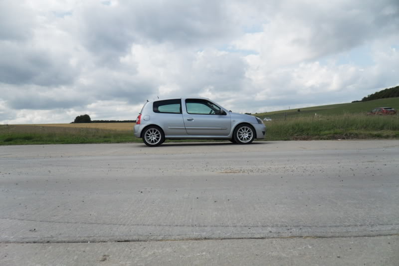

Now running standard exhaust, standard filter and standard suspension.

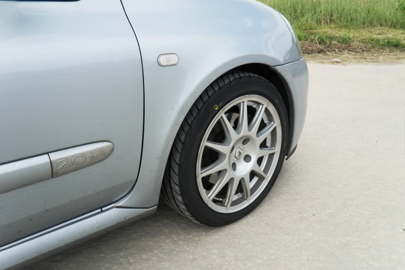

As I couldn't find any silver turini's local I bought these from AndyRg off the boost wagon

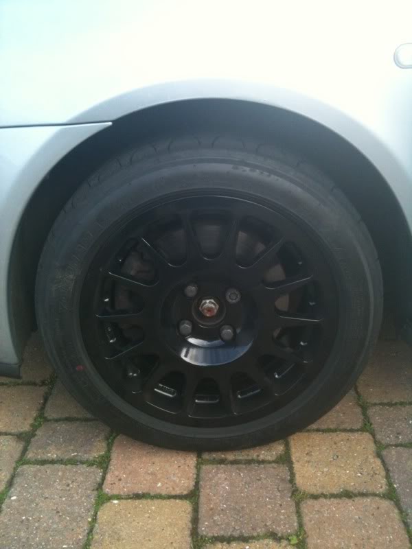

Speedline 2118's powder coated black
Got a few plans here and there, exhaust, 182 mani and maybe somemore coilovers but just for looks so not going to spend a fortune

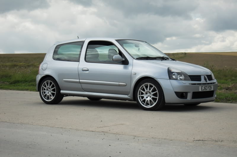

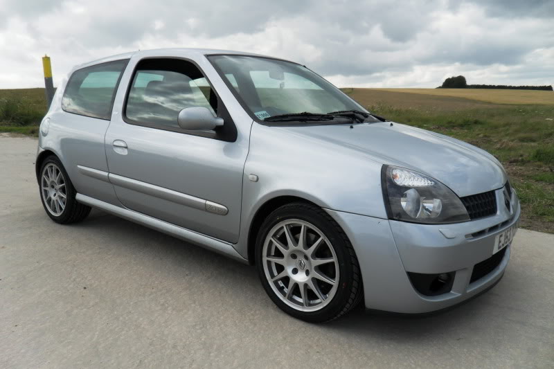

So since I bought the clio 4 months ago I've been chopping and changing the set up like nobodys business. I haven't been able to find a happy medium until now
I've finally got some original cup turini's for it, so I've put some yoko s-drives on them to try them out. At the same time the absence of coilovers has left me fighting off illegal immigrants from my arches each morning before work.
Something needed to be done, so a set of eibach sportlines were introduced. These went on, but the rear was still quite soft, so in came the trophy rear dampers. All that was left now was to cure some of the understeer and sharpen up the car. Que the Whiteline ARB. All sorted now and it handles awesome as expected, only improvement yet to come will be a 182 trophy front set-up i.e sachs dampers.

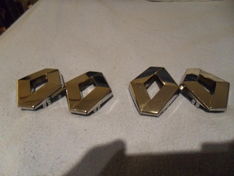

I did a front end tidy up the other week but I've decided to source another chrome front badge and refit the fogs. Megane ph2 splitter has been put on but needs a little trimming on the corners until I'm happy with it.
I'm quite happy with the car at the moment, there is a distinct lack of power since the yozzasport has been taken off, so a btb or yozza will be next on the list. Once I've fitted my recaro's that is.
