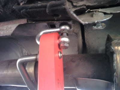

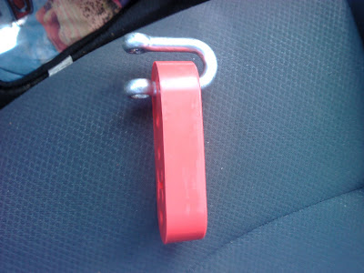

first up was a D shackle from b&q for £3 or £4
then a powerflex universal mount from ebay for £6
resize_image.php
then rammed together like so
a picture is worth a thousand gummy bears
i bought the rather large powerflex hanger as i wasn't sure where it would sit, but then realised the k-tec exhaust has an adjustable bracket. i'm probably going to replace the big red hanger with something like this
resize_image.php
should last alot longer than the standard replacement (which got launched at 7 months). the holes on the hanger give a pleasantly tight fit.

difficult to say tbh- the bracket on my exhaust is adjustable. maybe you'll be better trying to get an adjustable exhaust bracket?
