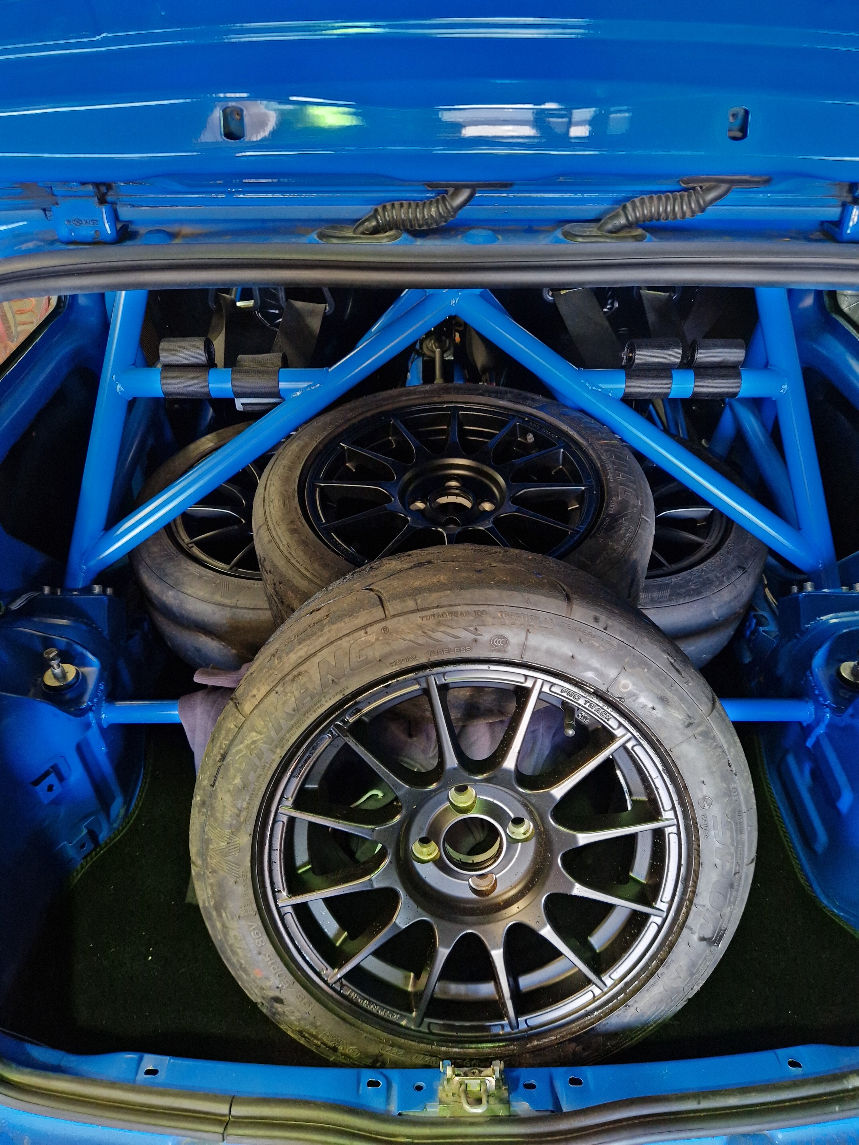

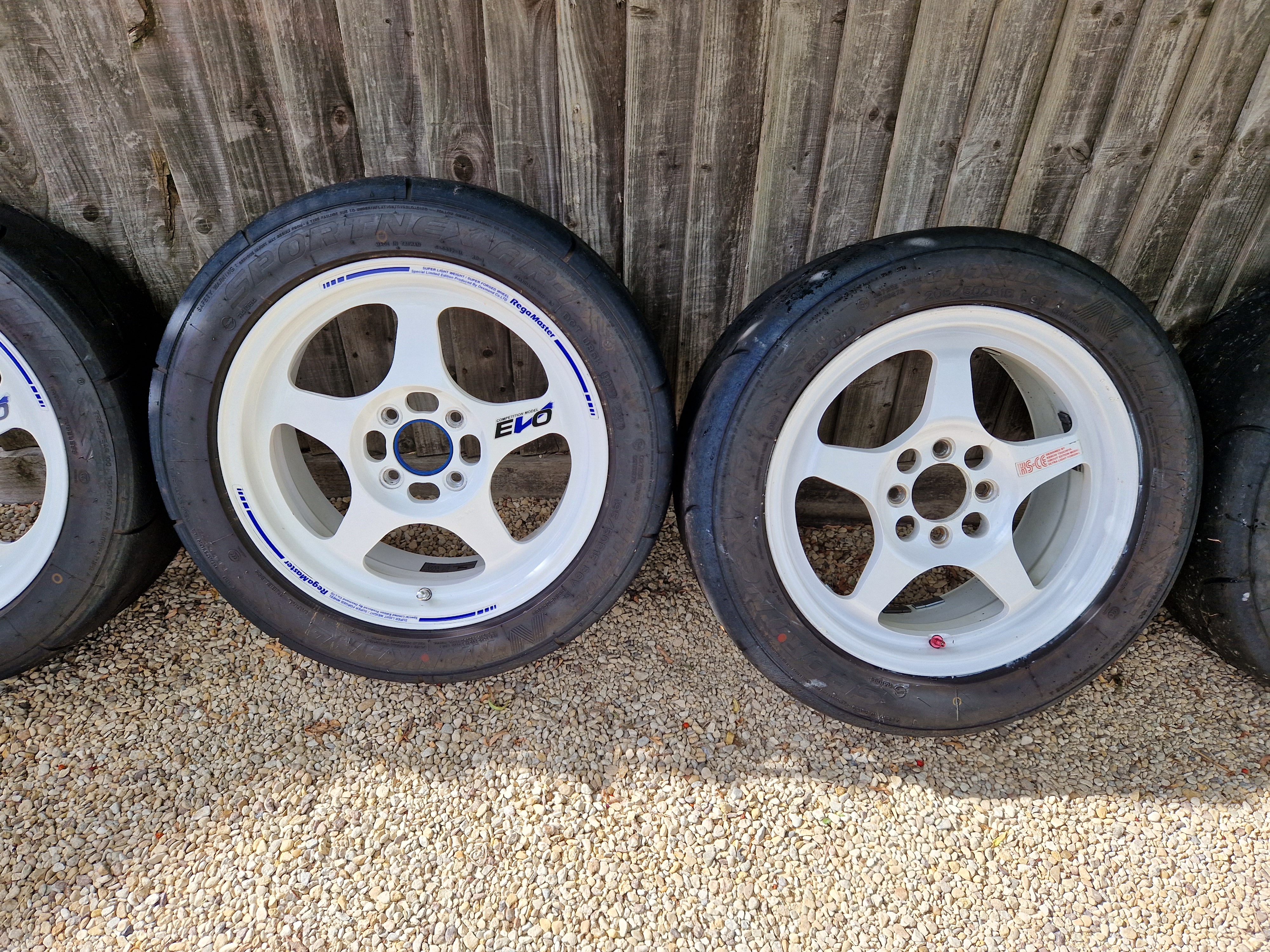

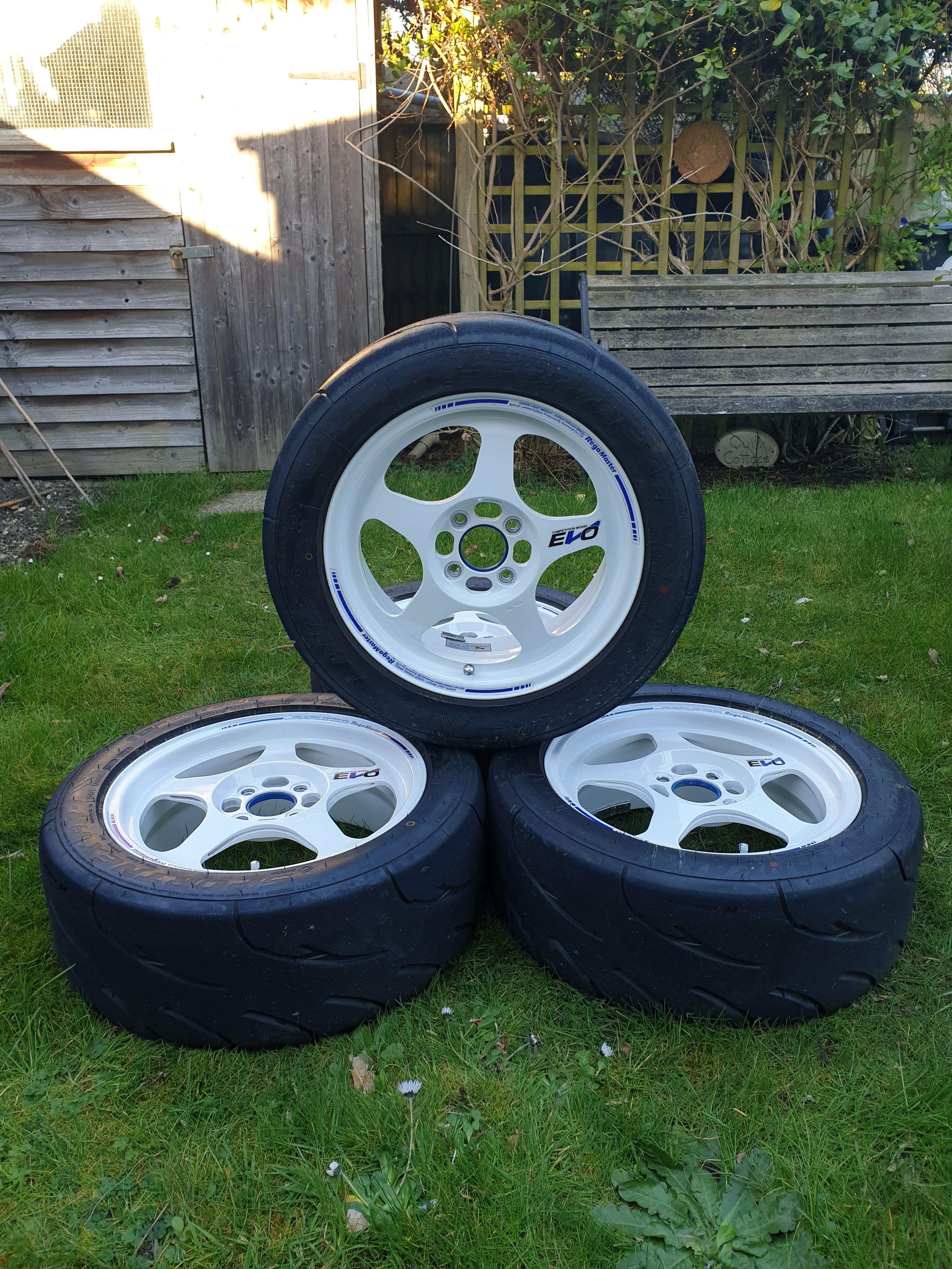

When the Regas were getting a refurb I ordered a set of 195/50r15 Michelin PS3s to replace the frankly garbage (for track) AD08RSs on my 2118s to use as 'everyday' and wet track tyres.
Got a bit of a bargain on eBay and spent £135 on a set all with 7+mm tread and got my mate to fit these too.

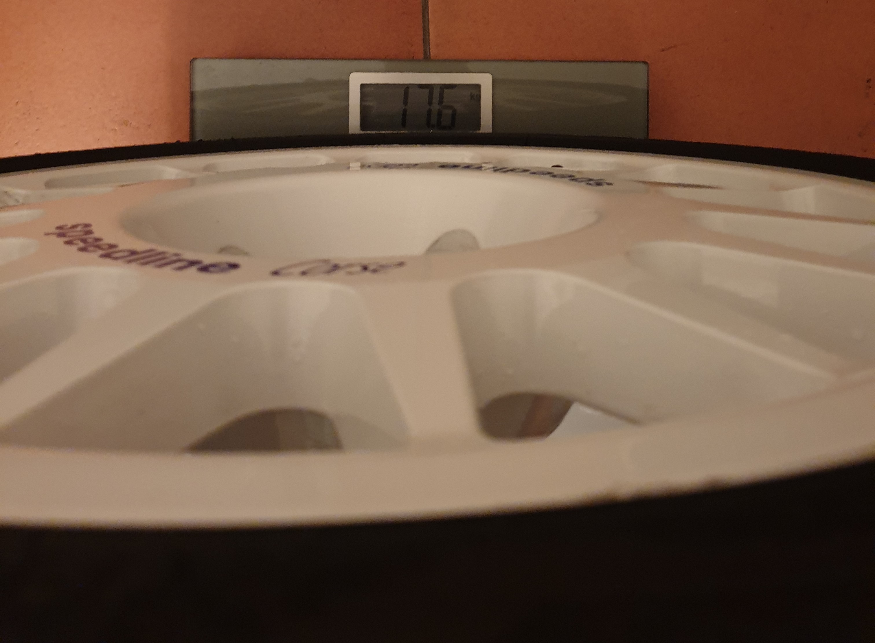

Weighed the AD08s on the 2118s:
And then with the PS3s:
Not really much difference between the two sets, but both packages are still about 4.5kg heavier a corner than the Regas.

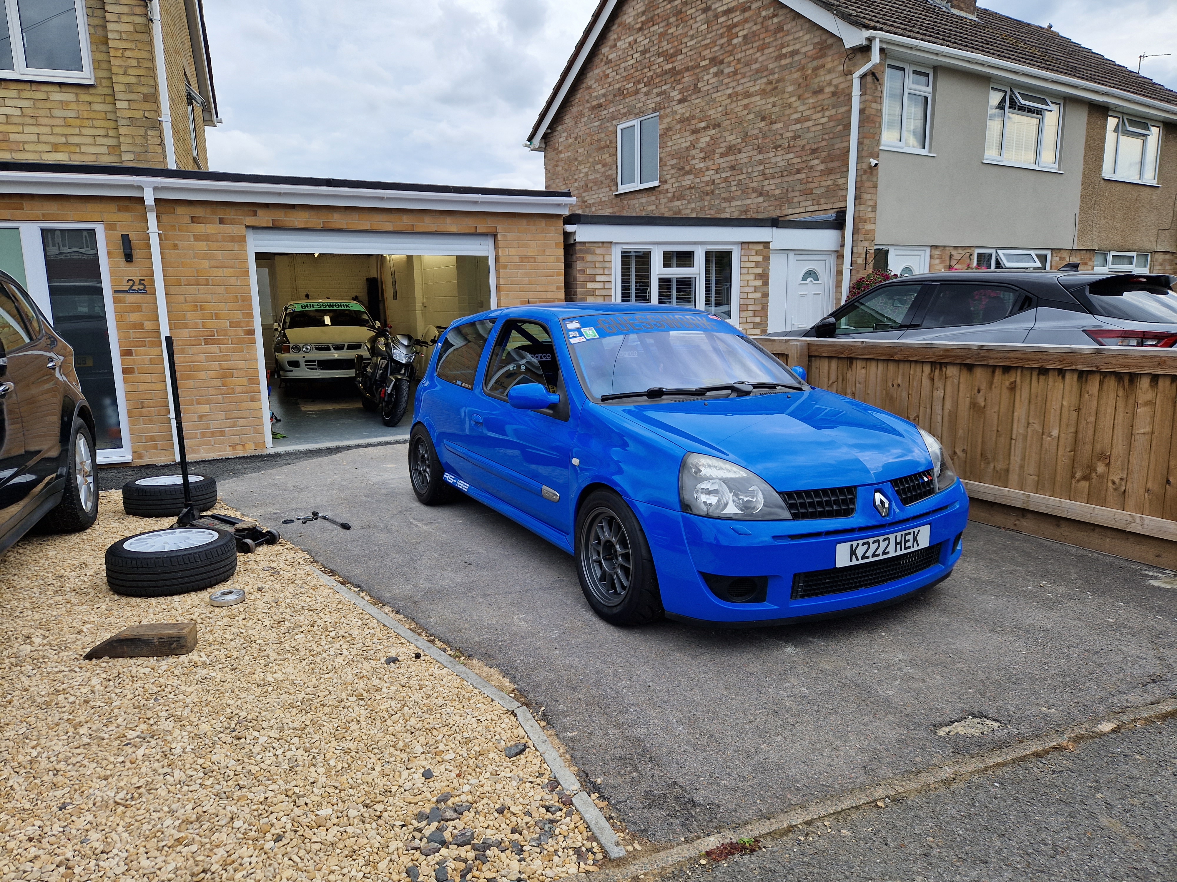

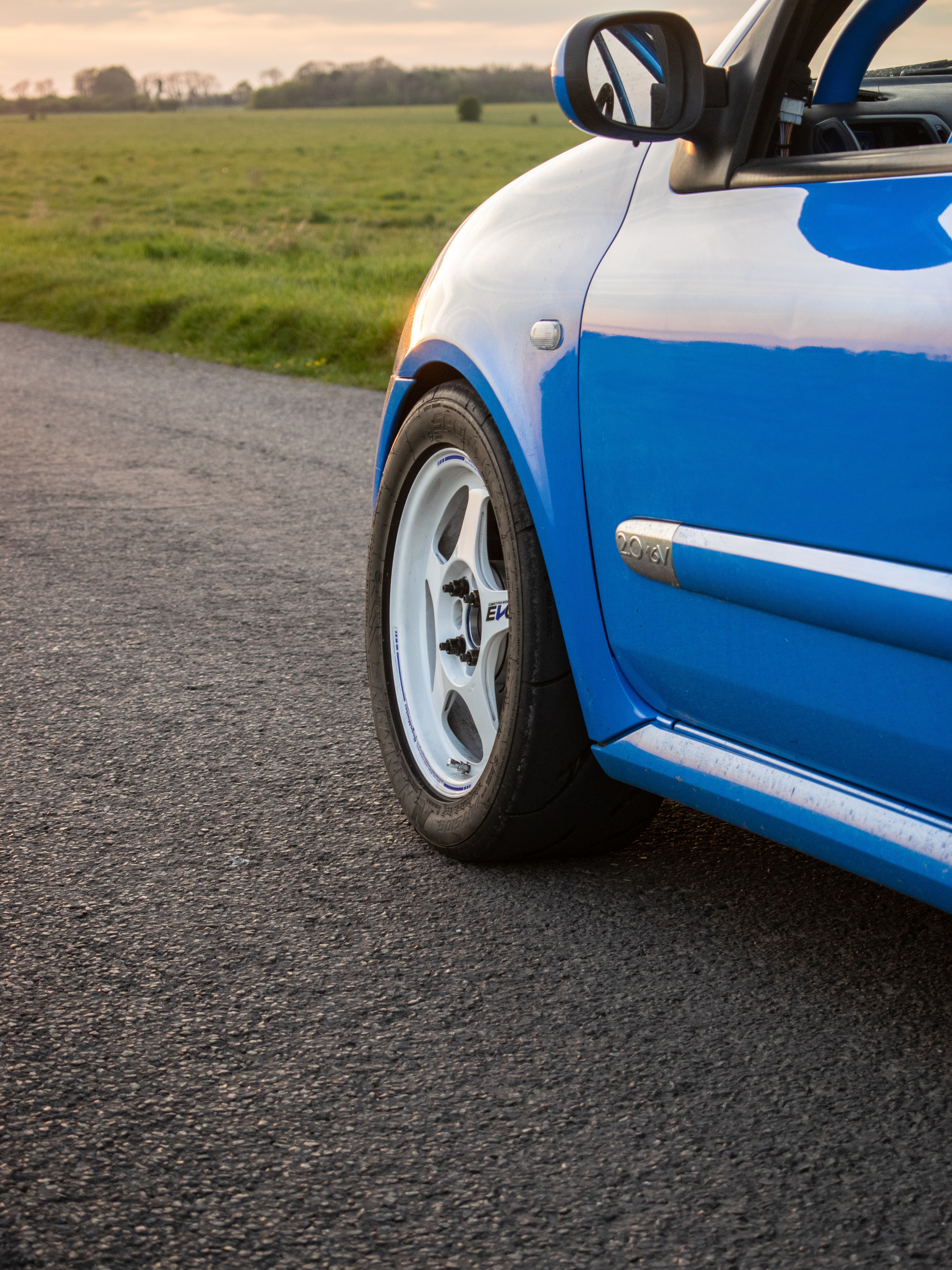

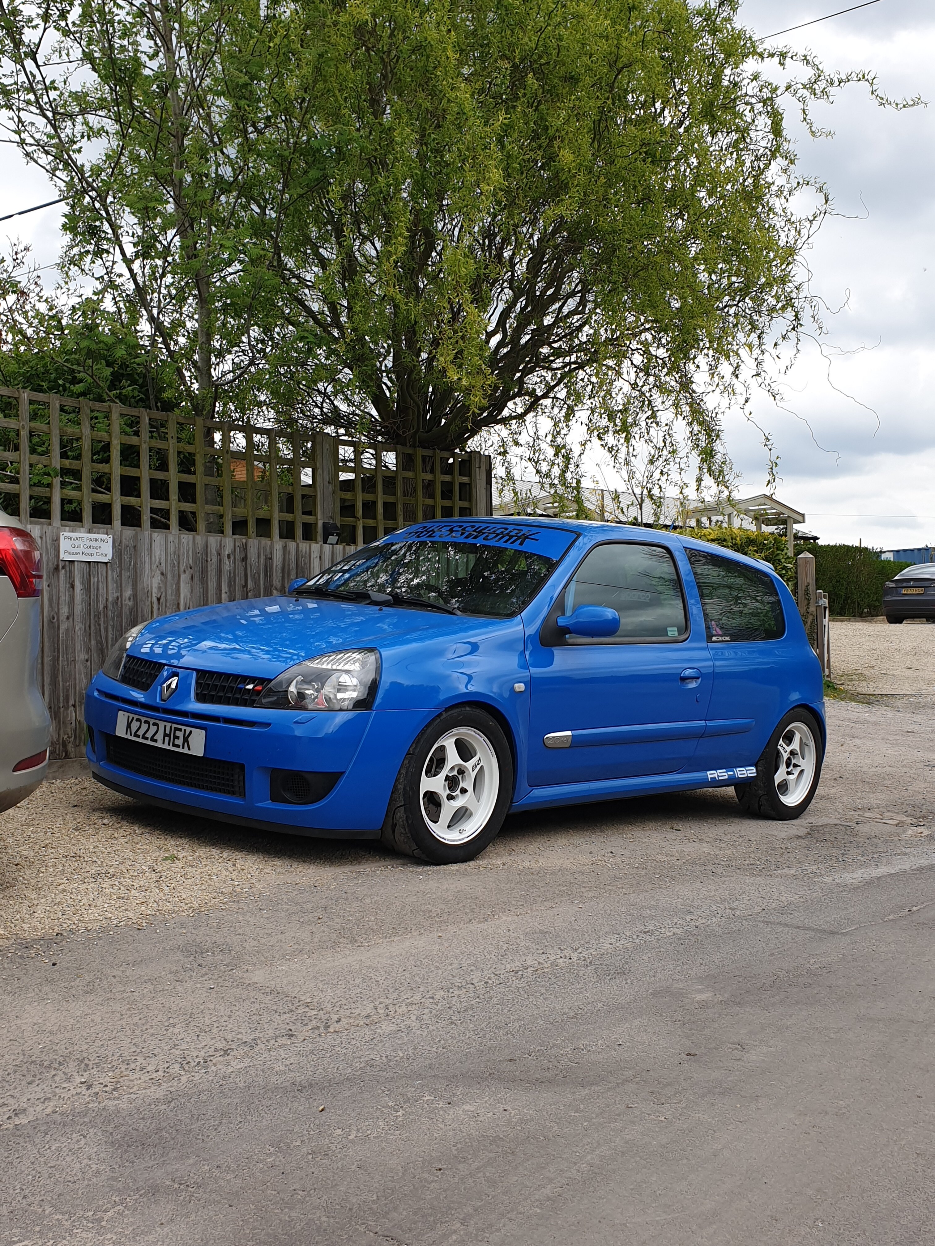

Then put the 2118s and PS3s on and left the 25mm front and 15mm rear spacers on. Looks much better than the previous spacer setup.
There's definitely going to be some rubbing on the rear so may need to roll the arch lips or grind them back, but for the meantime it looks better and I'll put up with the rubbing.

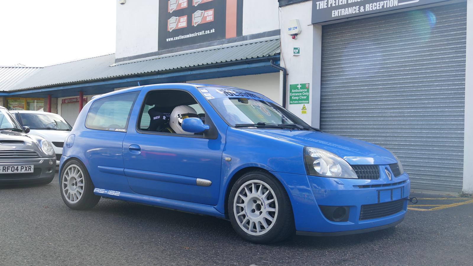

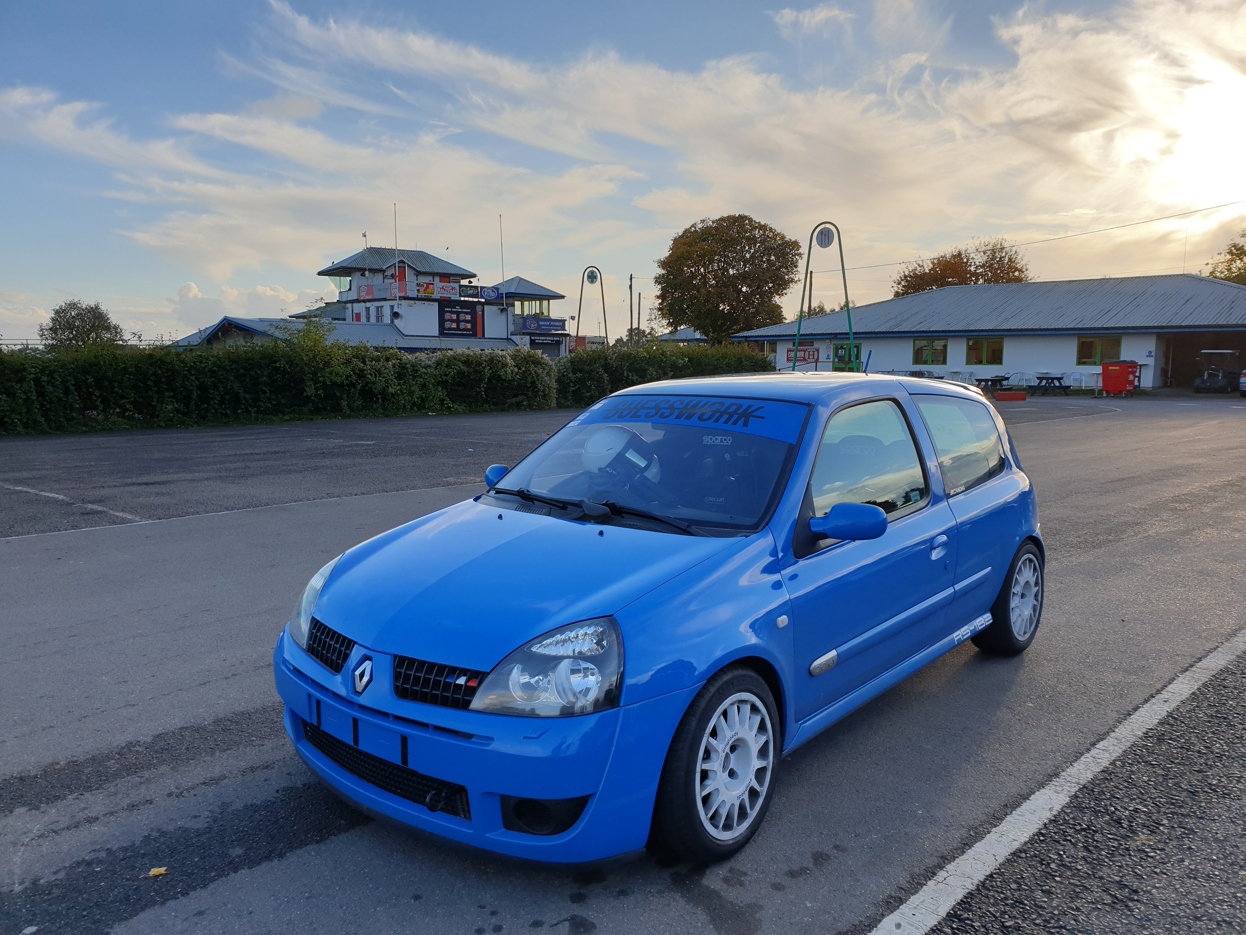

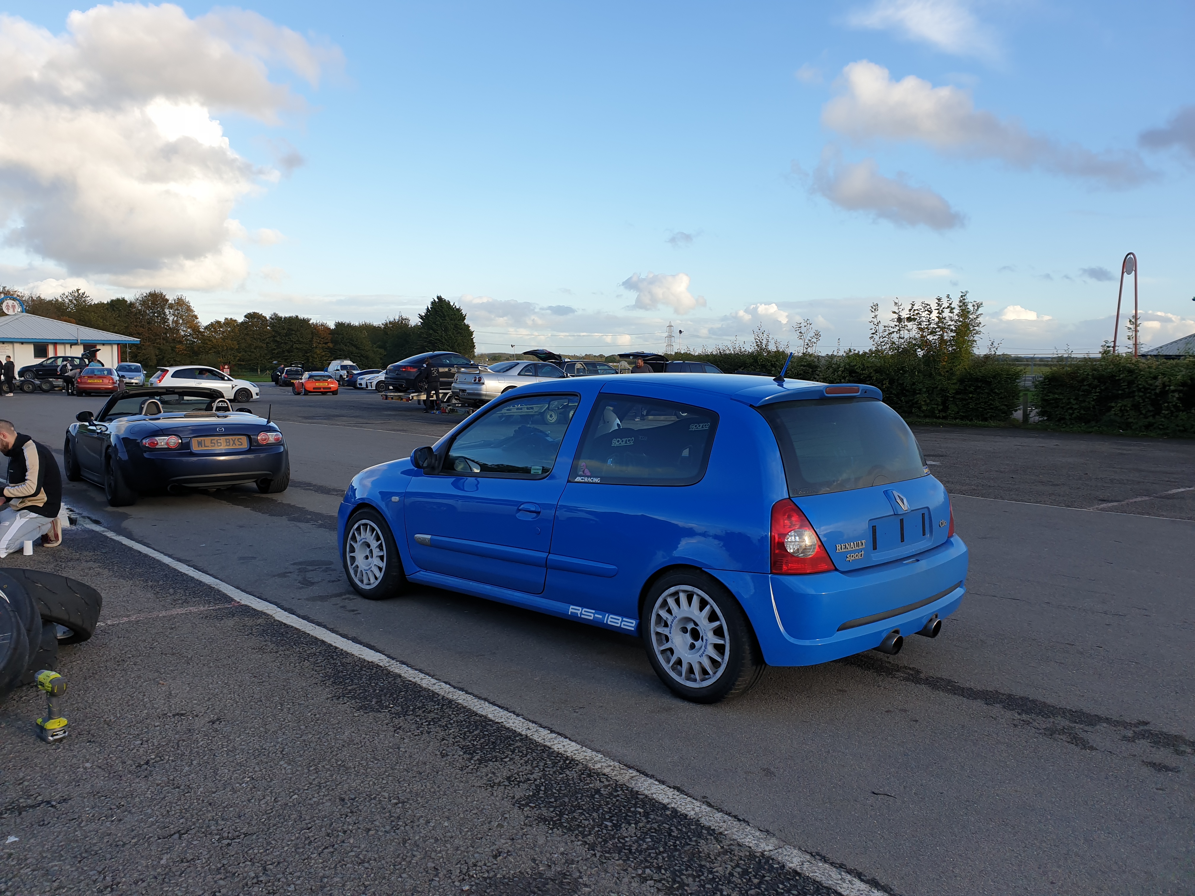

Combe on 25th October (not the 28th as previously said) was pure class with the GUESSWORK squad. Skies started off clear but the track was wet from the previous night's rain.
The day before I also removed the shopping list on the back window. I think it's for the better.
First thing I noticed was that the Circuit seat was an enormous improvement over the grid and I felt much more comfortable driving the car harder whilst not being chucked around so much.
Also, the pilot sports were class and combined with the Quaife diff, the car felt amazing in the wet! Managed to have a couple of moments that I managed to save which I was pleased about. Nothing Camber and Combustion level but I didn't crash it so that's a win at least.

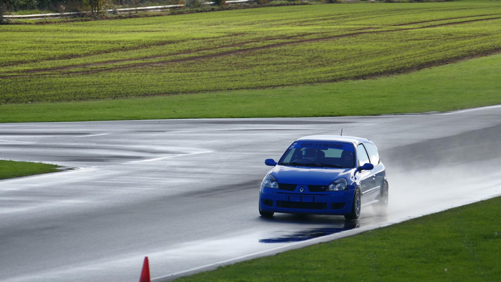

I was initially disappointed and a little nervous about doing a wet trackday but I enjoyed the wet sessions immensely and didn't get overtaken once throughout the entire day - something I'm quite proud of but more likely down to the faster cars staying in the pits rather than my own skill. This M3 which did get the chop though.
Once the track dried after lunch I did a session on the PS3s to see what they were like compared to the AD08RS's I had previously run and the PS3s felt much better. I wouldn't recommend the RS's really to anyone.

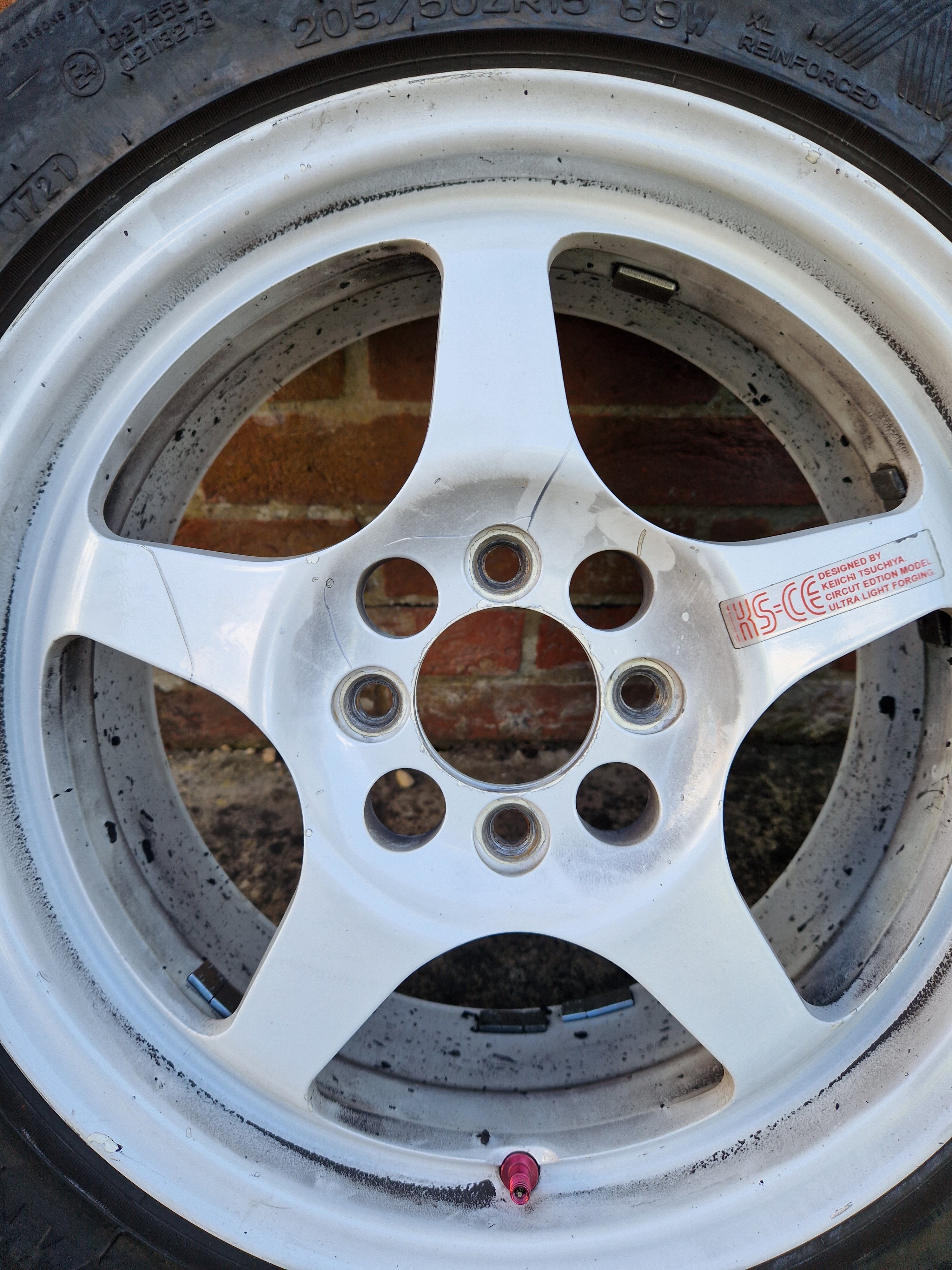

However problems started occurring then - I guess 3 trackdays without issue had caught up to me clearly!
As I pulled into the pitlane after the first session with the AR1's on there was a horrendous wobble through the steering wheel. I stopped under the Avon bridge and my mate who I took out as a passenger got out to check if there were any issues. To which there was a pretty much instant "STOP!" shouted as I continued to drive slowly back to the pits.

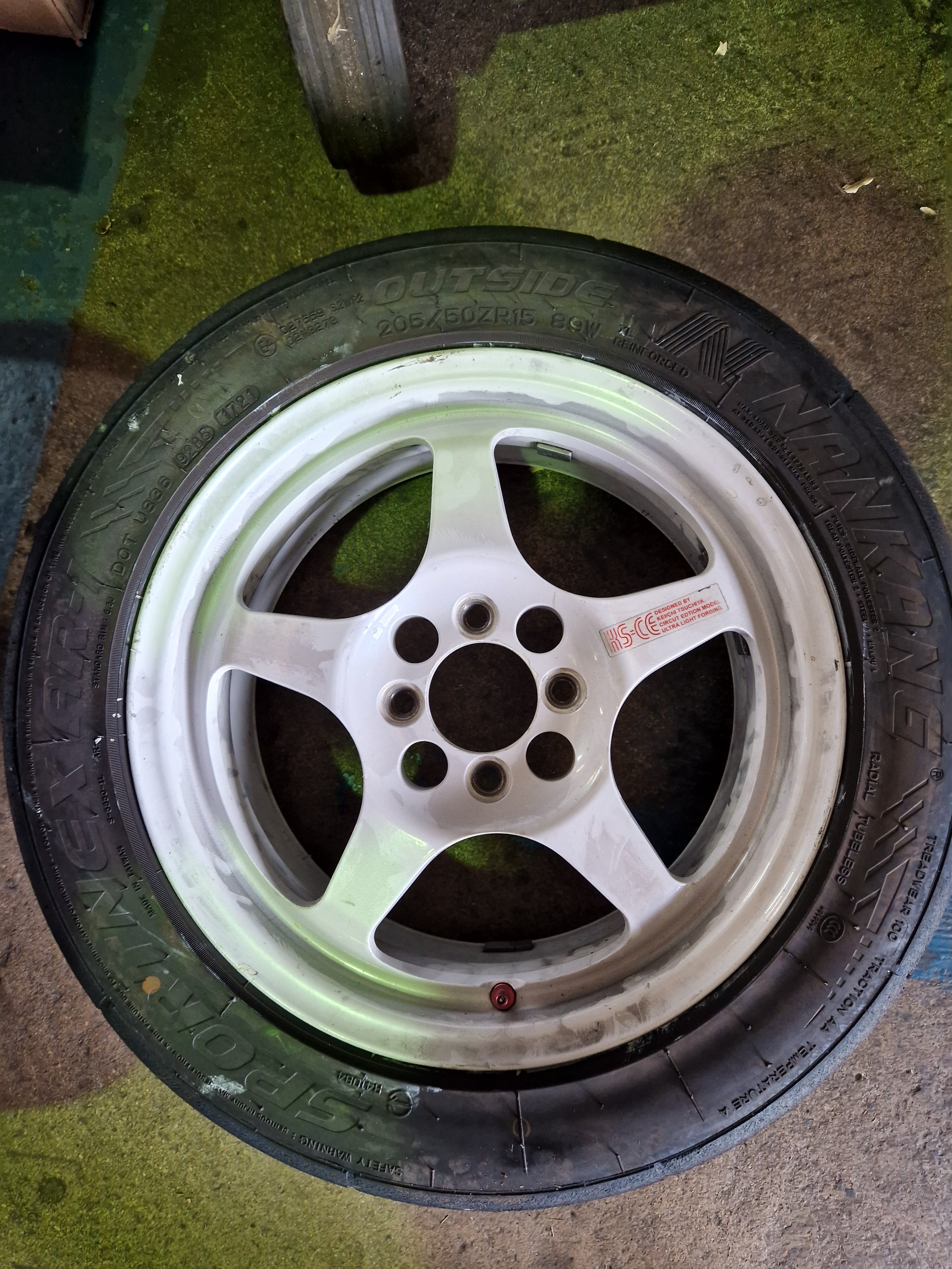

The NSF wheel was about 5mm off of the face of the spacer! Damn lucky it didn't happen whilst I was out on track though or even worse fall off.
Turns out I probably should've sanded back the fresh paint from the refurb on the mounting face and where the bolt tapers tighten. The paint had melted and the bolts came loose from the gap that had then appeared. You learn something new everyday I guess.

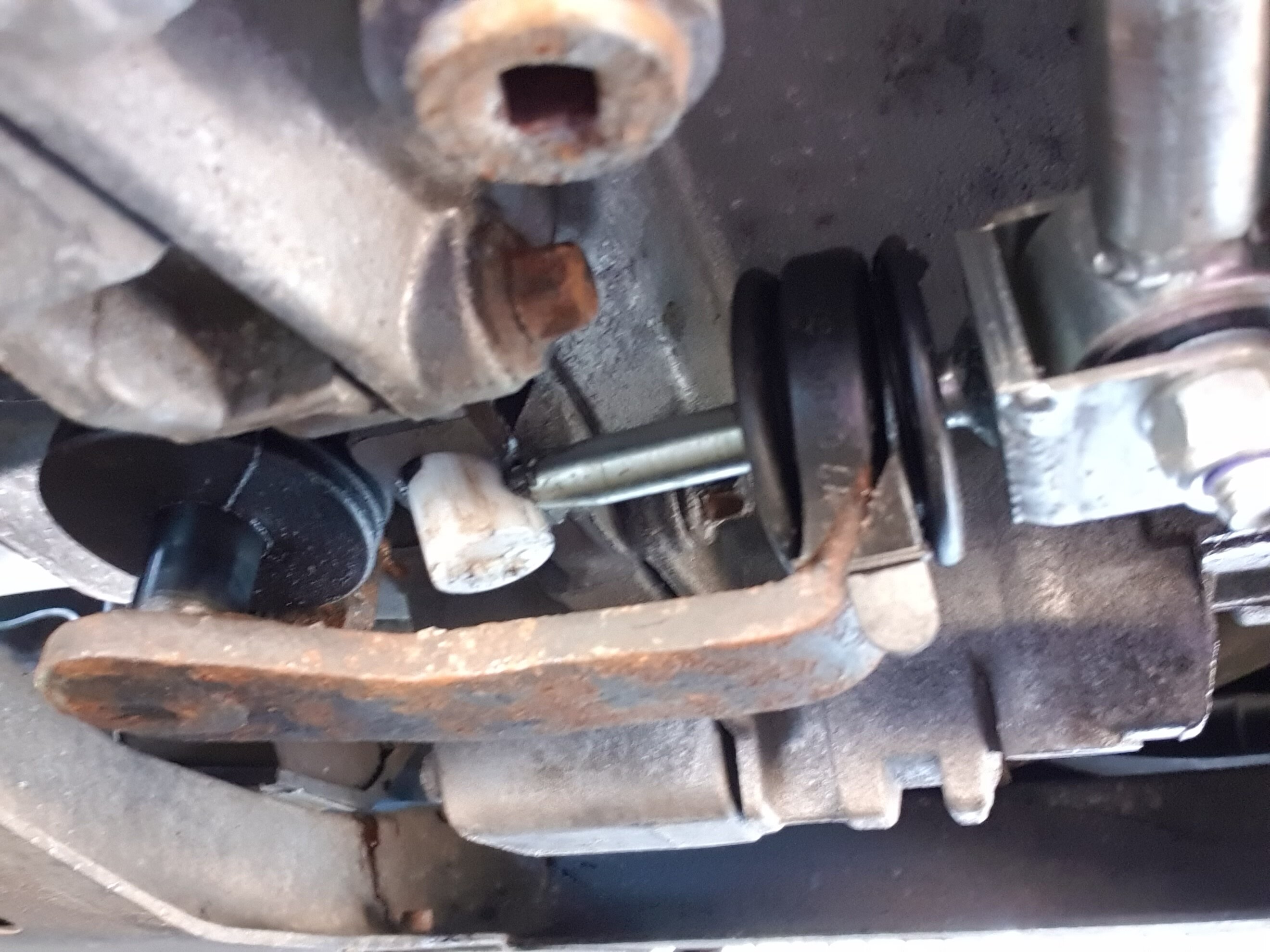

And then, its that time again...... Yep another brake related issue. Only went and snapped the OS handbrake cable parking it up. Again, something to sort another day though I thought at the time.

I bought a spare set of handbrake cables from BTT ages ago so the drivers side handbrake cable was a pretty simple change once the car was up on a lift - very happy to have a mate with one.

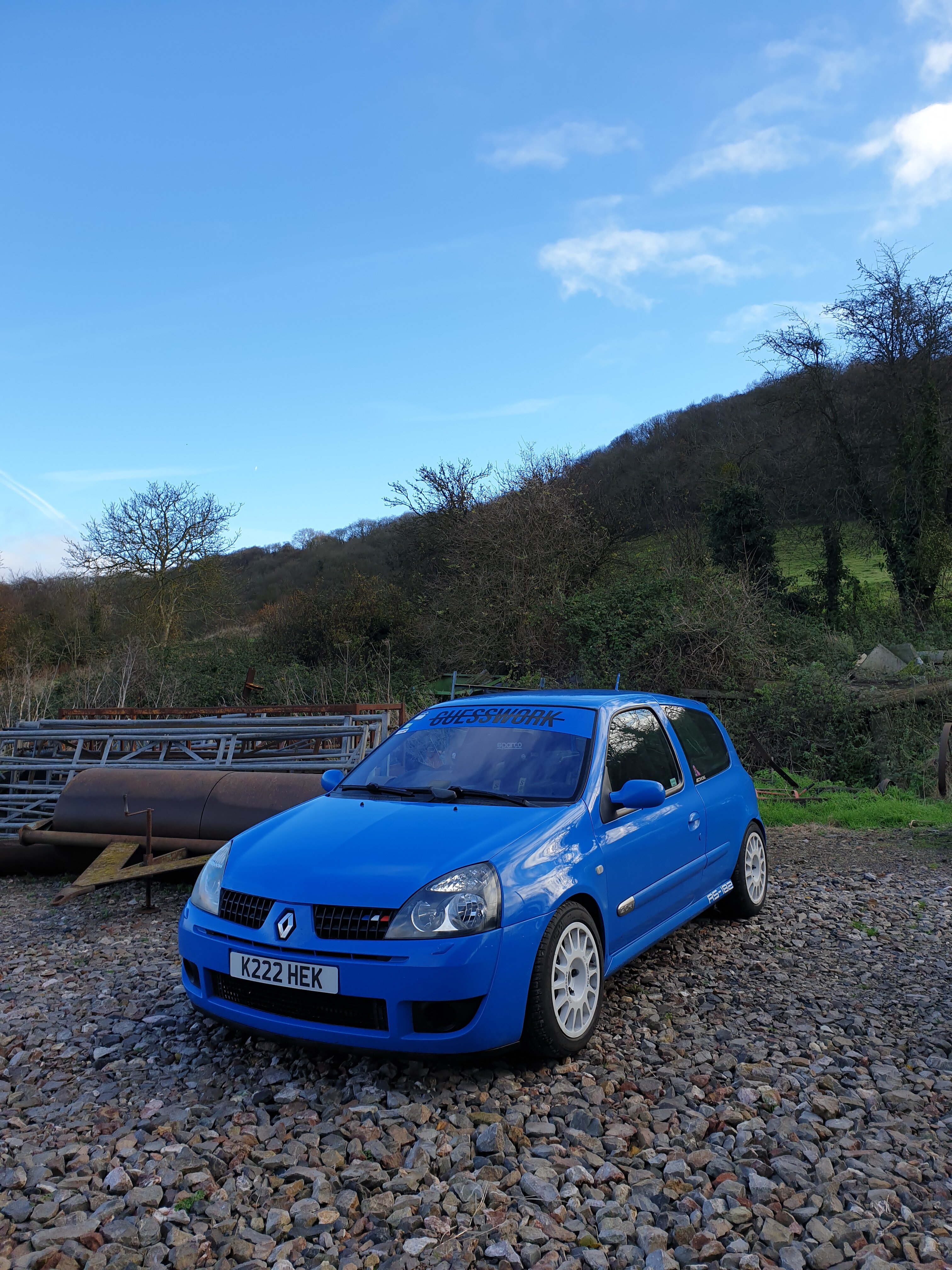

Parked up for a couple of weeks and then made the trip to Somerset to the Late Brake Show Christmas Event. Hosted by Jonny Smith and Jason Plato (who joined for the quiz), it was a great day out and there were some proper machines on display as well.
The little Clio got tucked away up the top next to an old roller (which I had to be careful not to smash the door on), but still managed to make an appearance on Jonny's YT Channel!

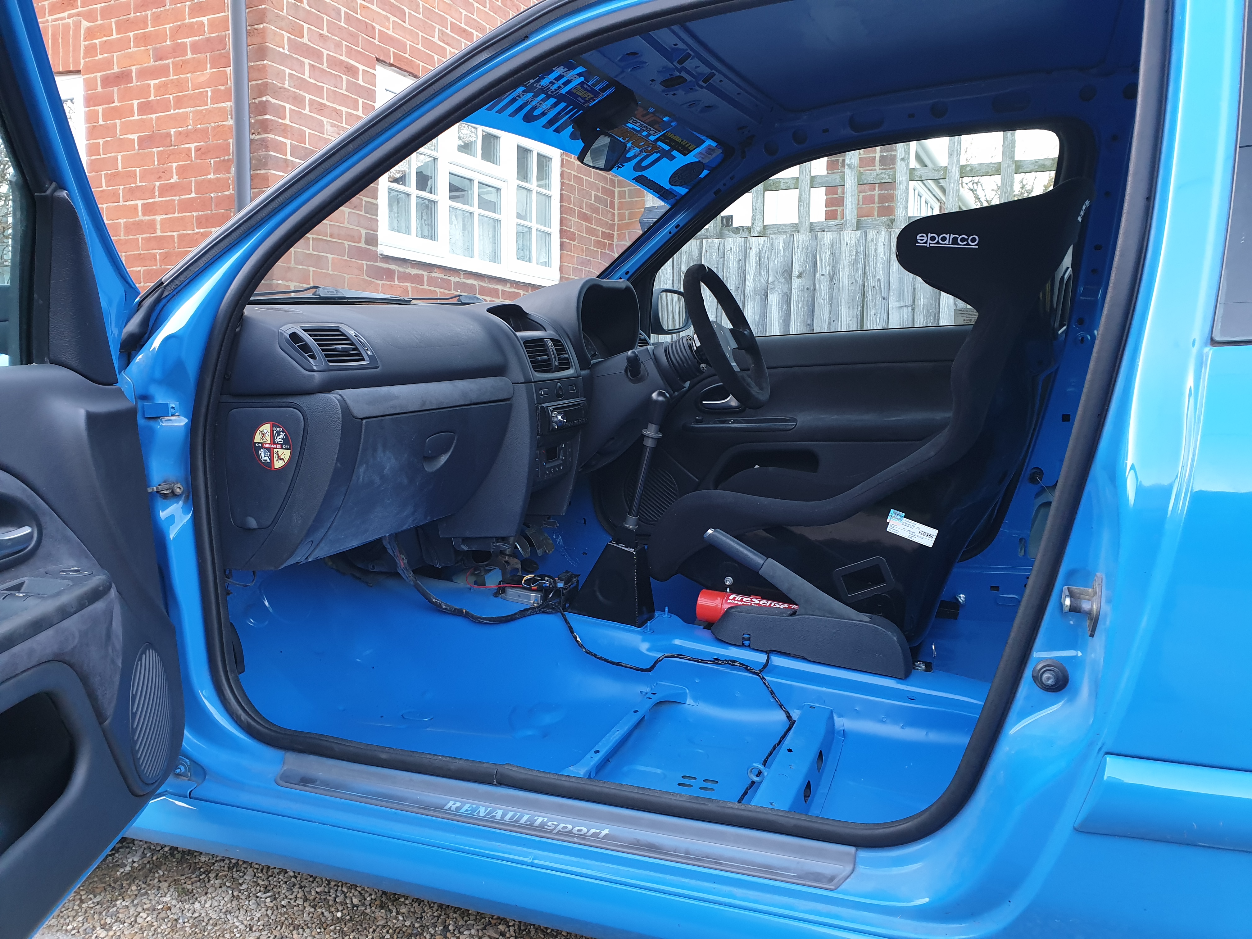

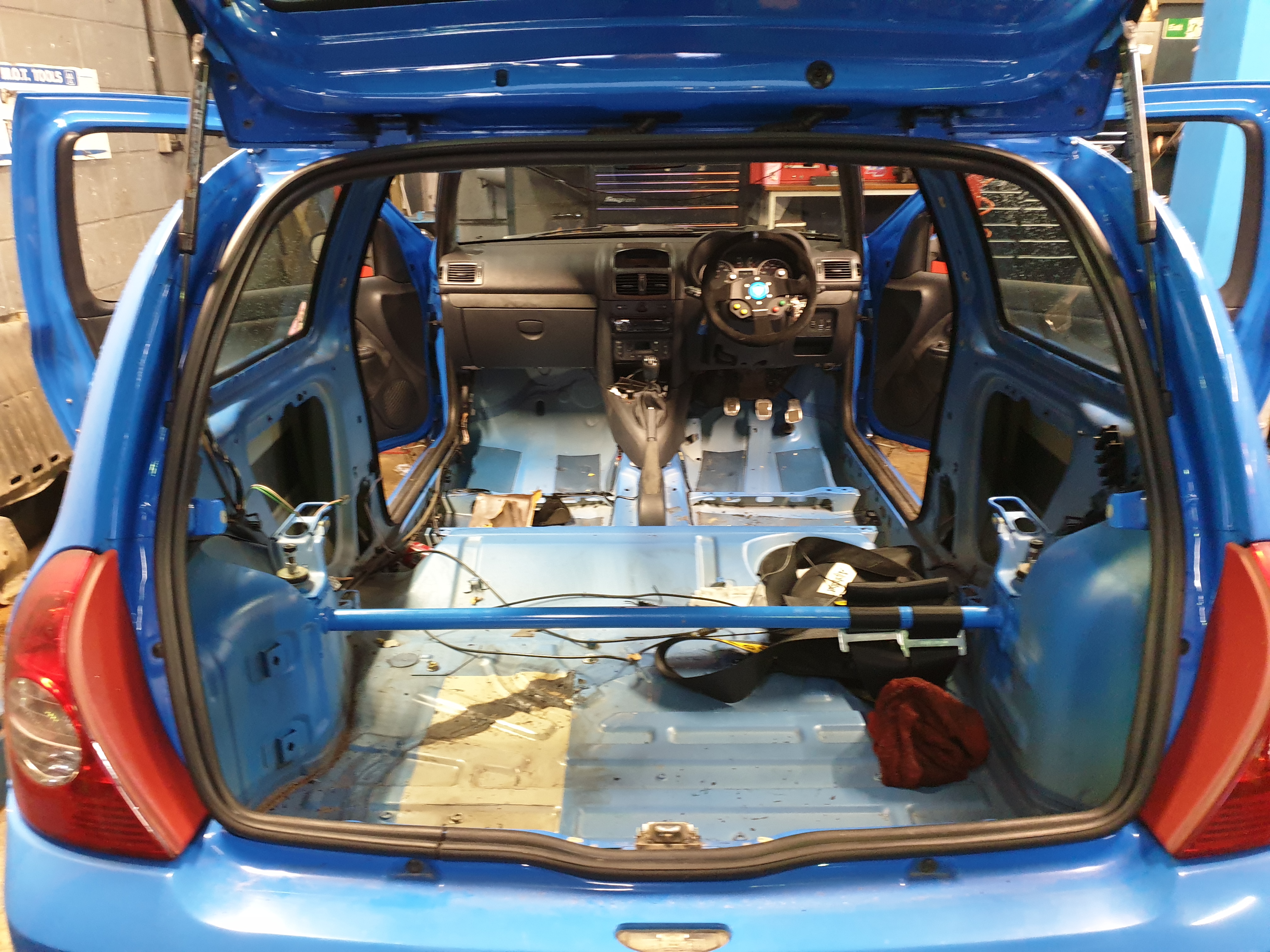

All the other Guesswork lads were doing stuff to their cars and, not wanting to be left behind, began to think about what I could do too. Looked at a few things that were left on the list and a cage seemed to be the next logical step for the "build".
"Clubsport" spec no more as the teardown began.....

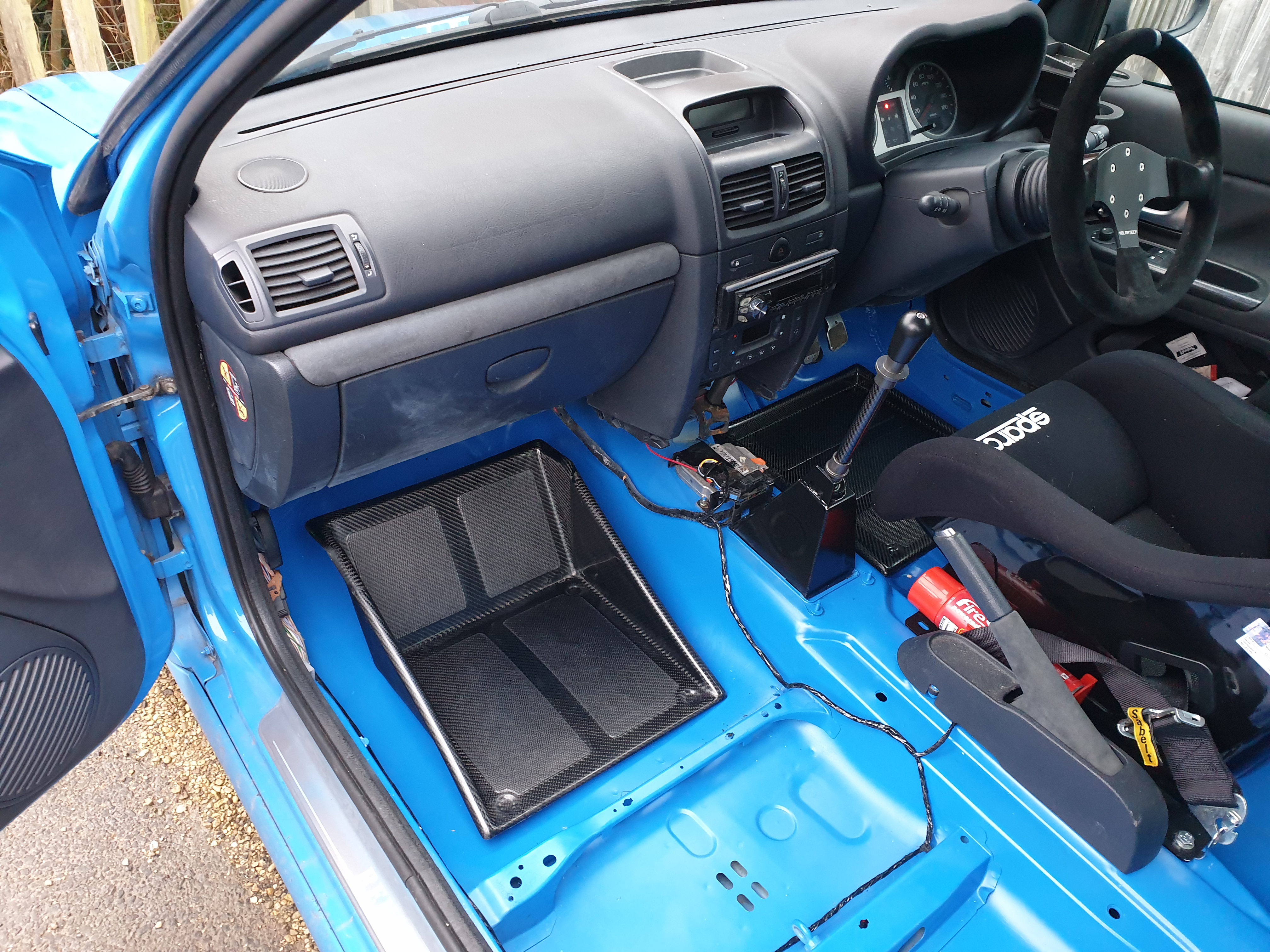

Removing the sound deadening is actually pretty easy. I just used a heat gun, paint scraper and a wire wheel on a drill to clean up all the residue afterwards. I was surprised at how much it weighs really - I've got the goal of 1000kg with a cage but I guess we'll just have to see if that can be done or not!
I'm going to paint the inside of the car Racing Blue and the cage will be powder coated in a similar blue to match. I'm very excited to see it all done.
I just have to remove the sound deadening under the drivers seat, degrease the inside and then mask everything before I can get on and spray it. Hopefully I'll get some time to do it soon.
A decat was fitted at some point last month too and I've also ordered a PMS Shifter - something which I have wanted for a long time.
I'll have to stop spending money for a while now...

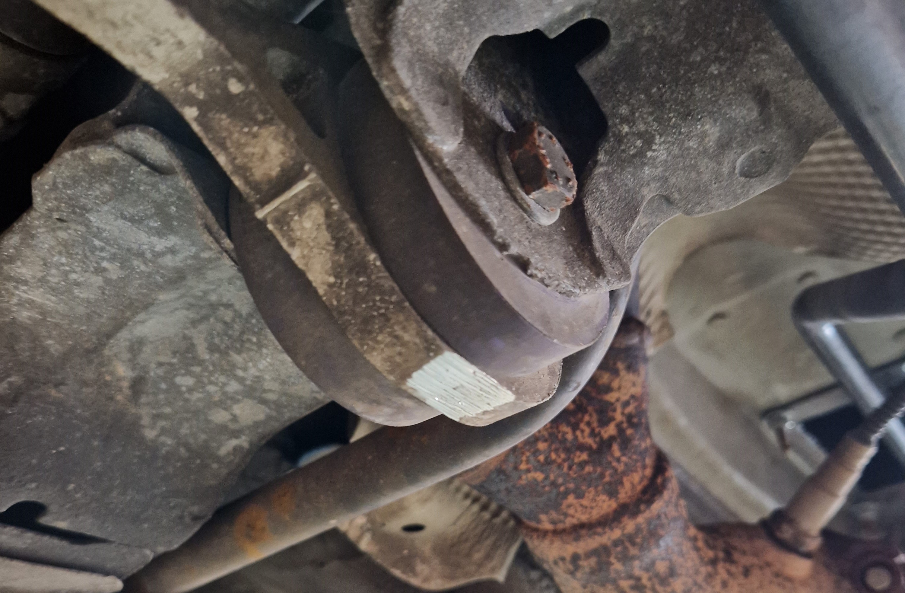

When fitting the Decat we noticed that the centre exhaust mount had perished. So a quick trip to eBay and a BTT poly mount was ordered ready to fit the next time the car was up on the ramp. The passenger handbrake cable had also broken since the last update but I had already got a spare one ready. Something to fix alongside the exhaust mount.

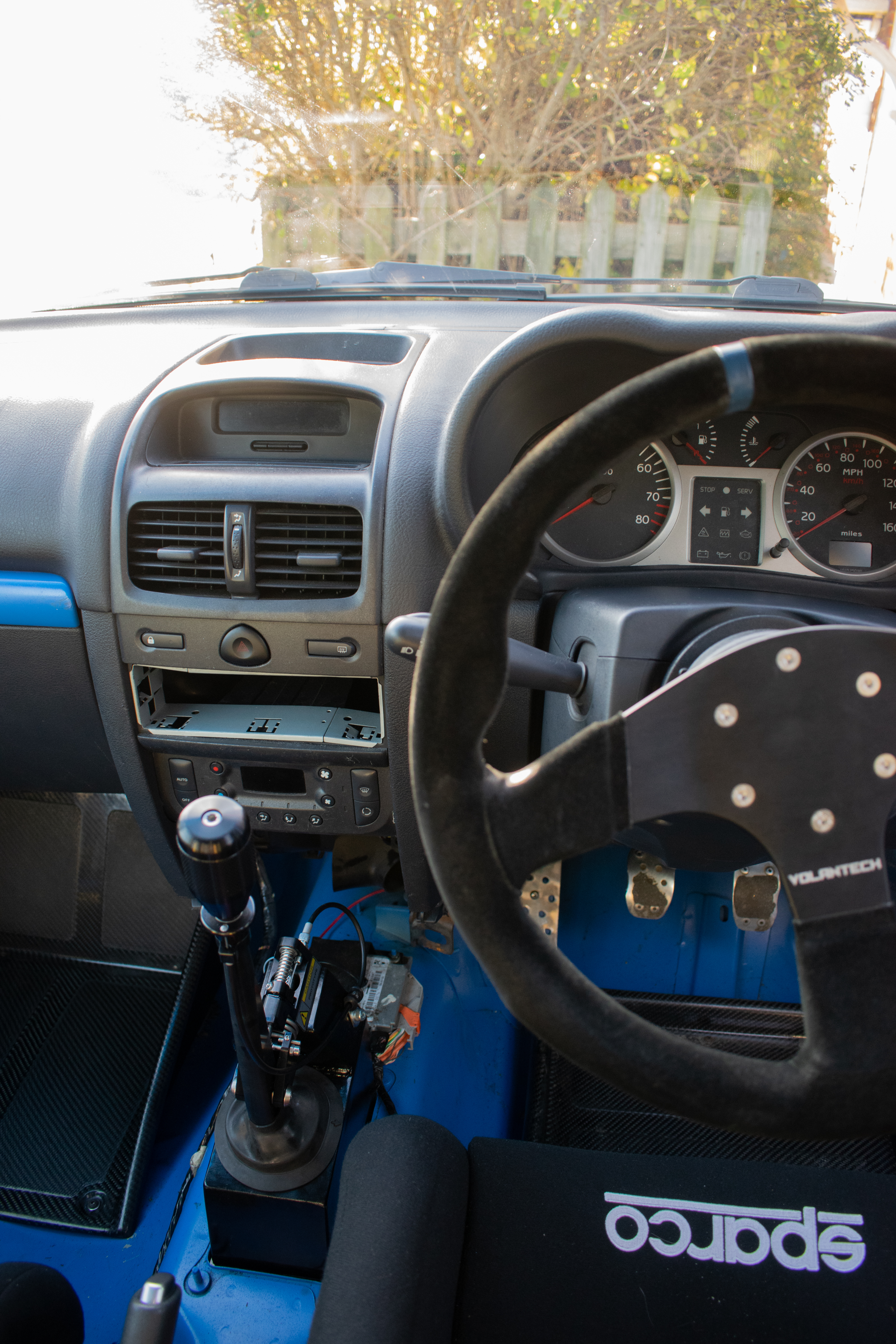

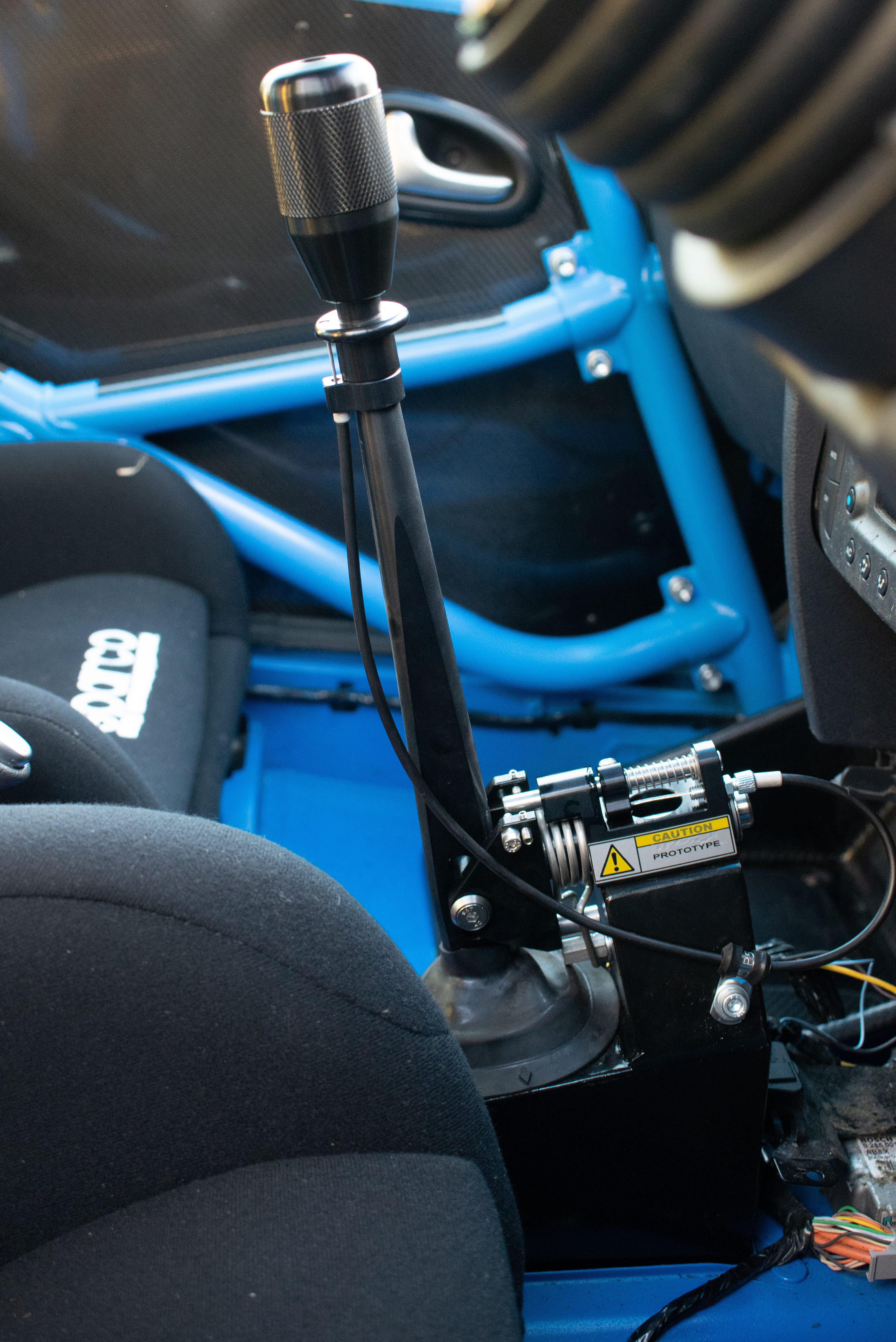

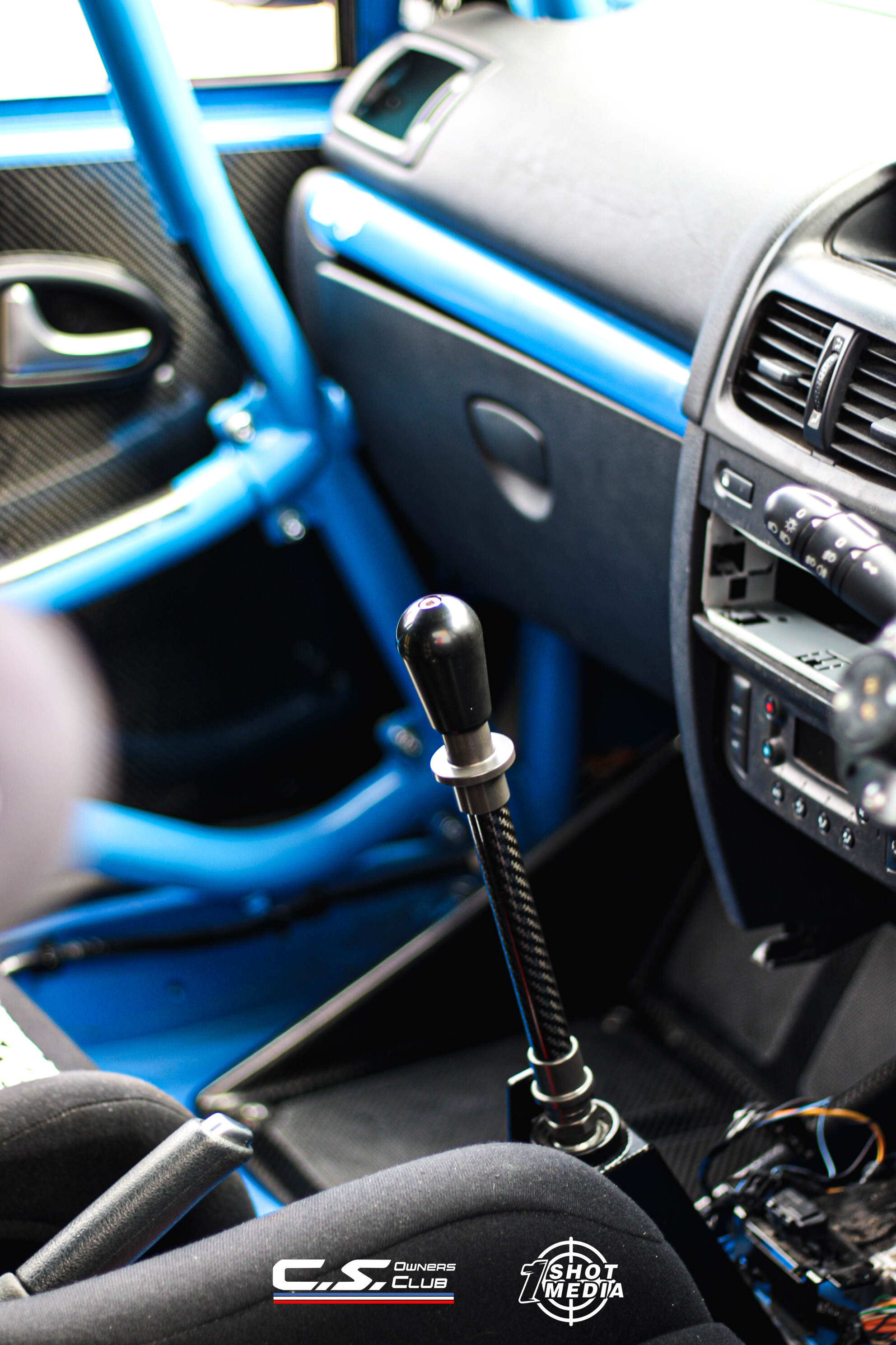

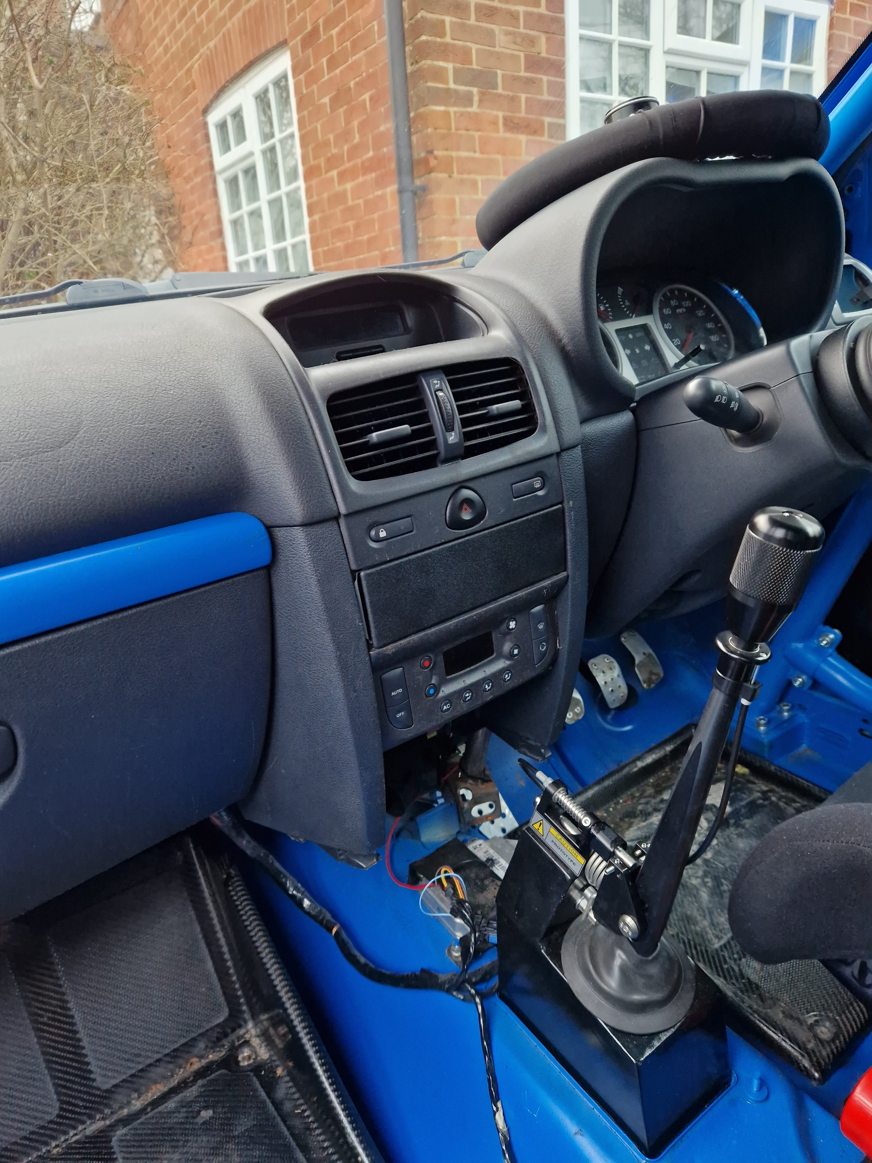

Once the PMS shifter turned up it was off to the garage to sort and fit everything. I never really bought into the whole "The PMS shifter is one of the best things you can do to one of these cars" idea but, it turns out that its pretty accurate. The fact that it is much closer to the wheel makes the most difference I think. Plus it looks better than the standard setup.
Quick release wheel boss was next to install. A few mates run these Driftworks bosses and so I decided to go for one. Pretty good value and there is no play in the fixing. I ran a 40mm Spacer anyway and this boss is only a little larger so its still in a comfortable position. I will have to lower the column at some point though.

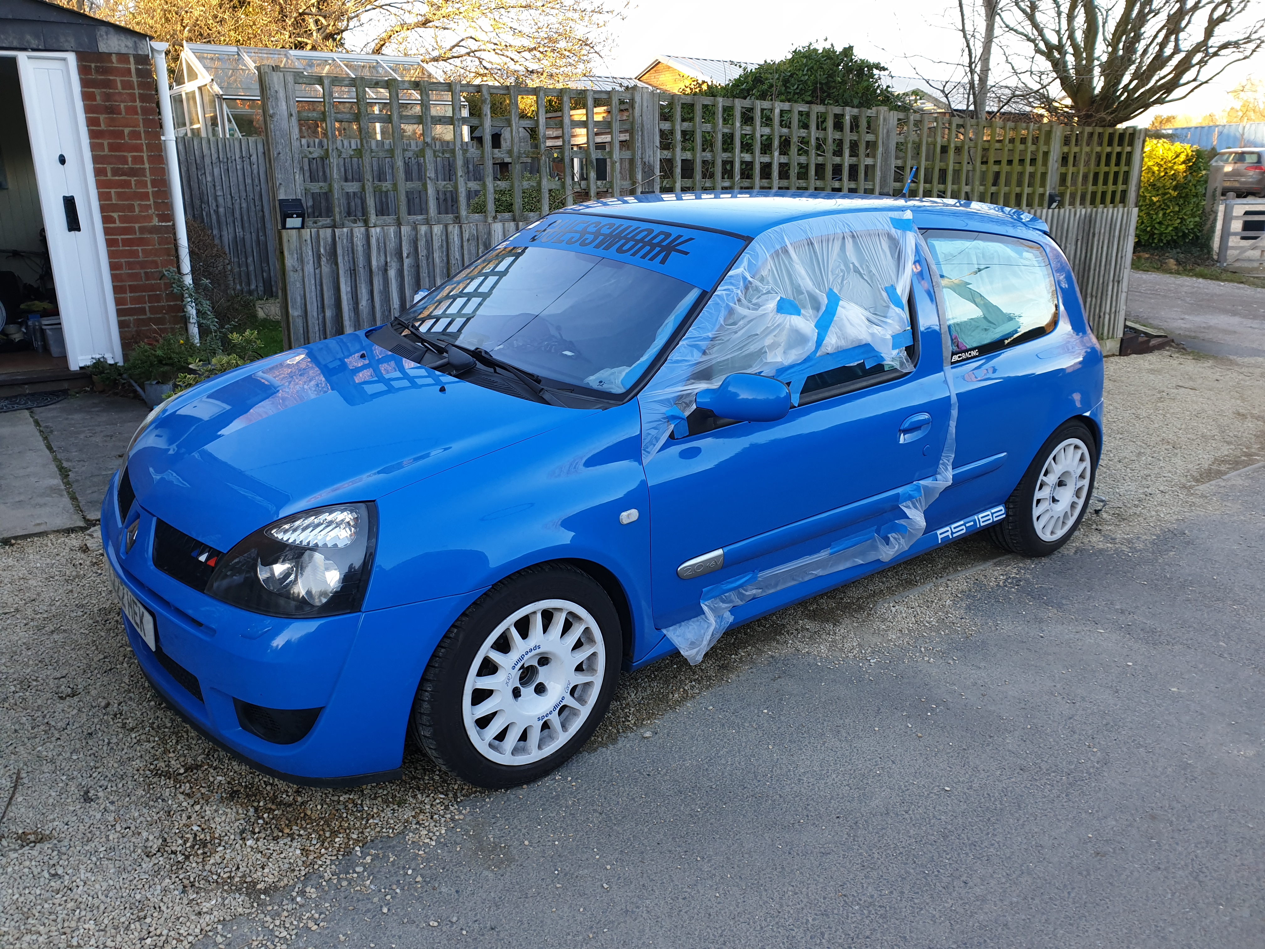

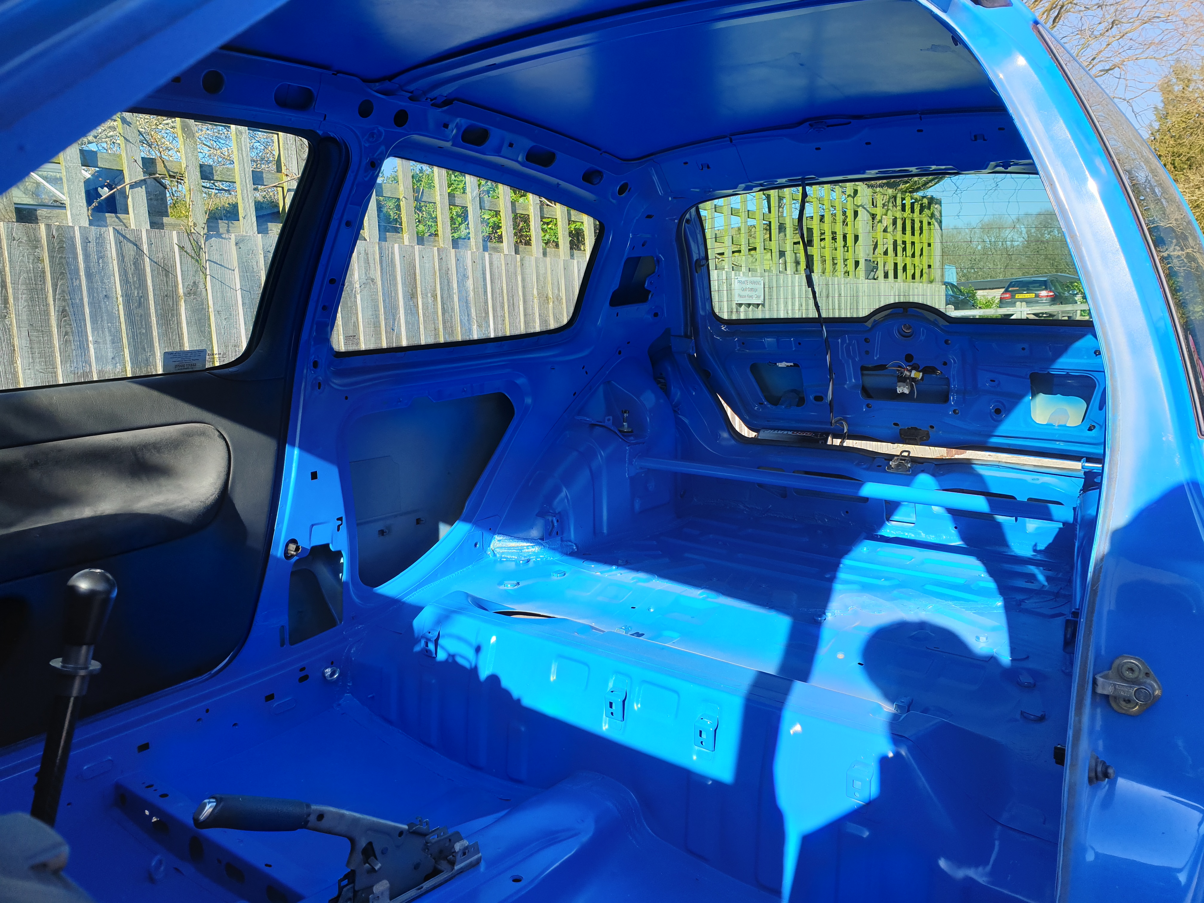

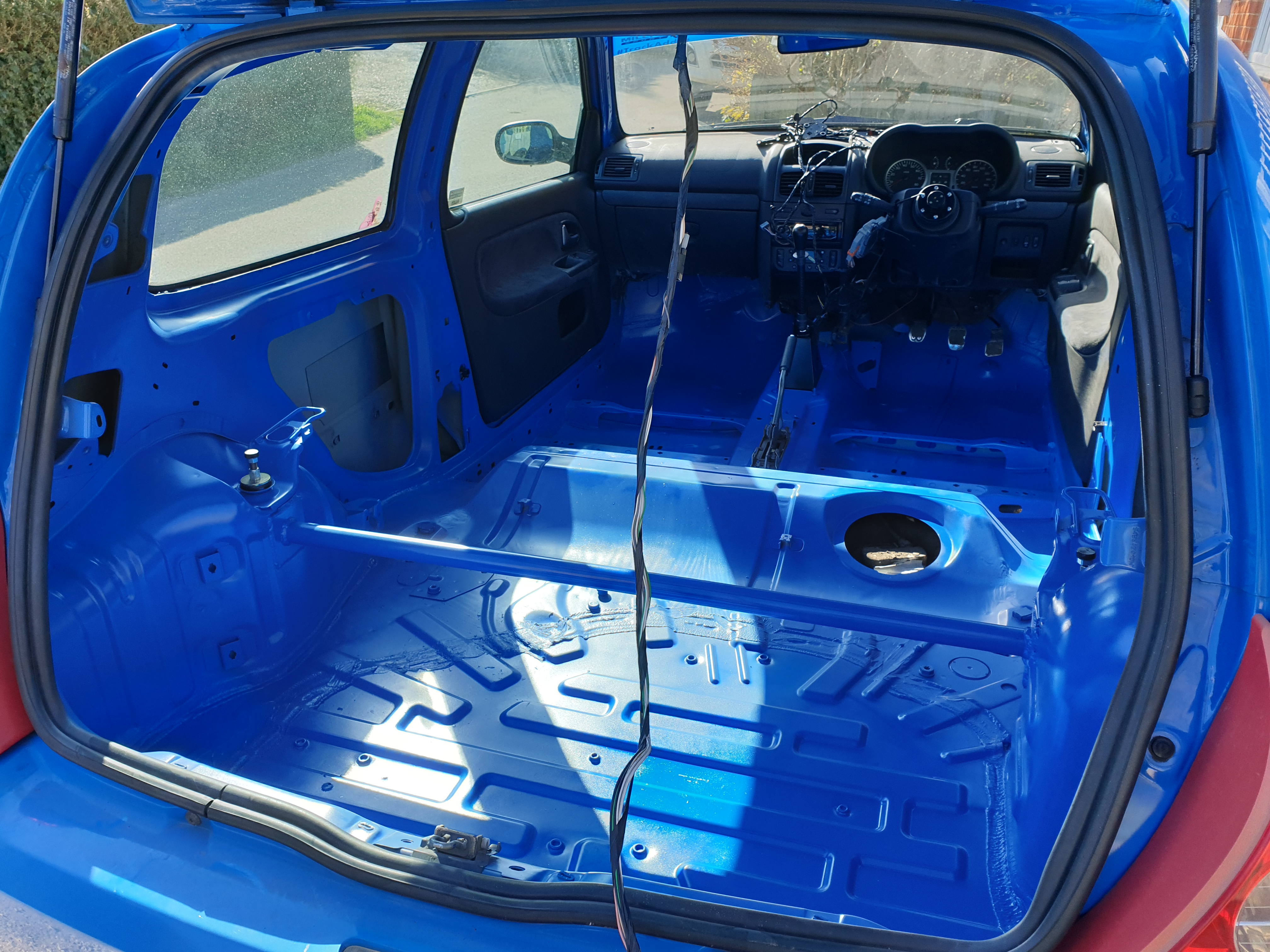

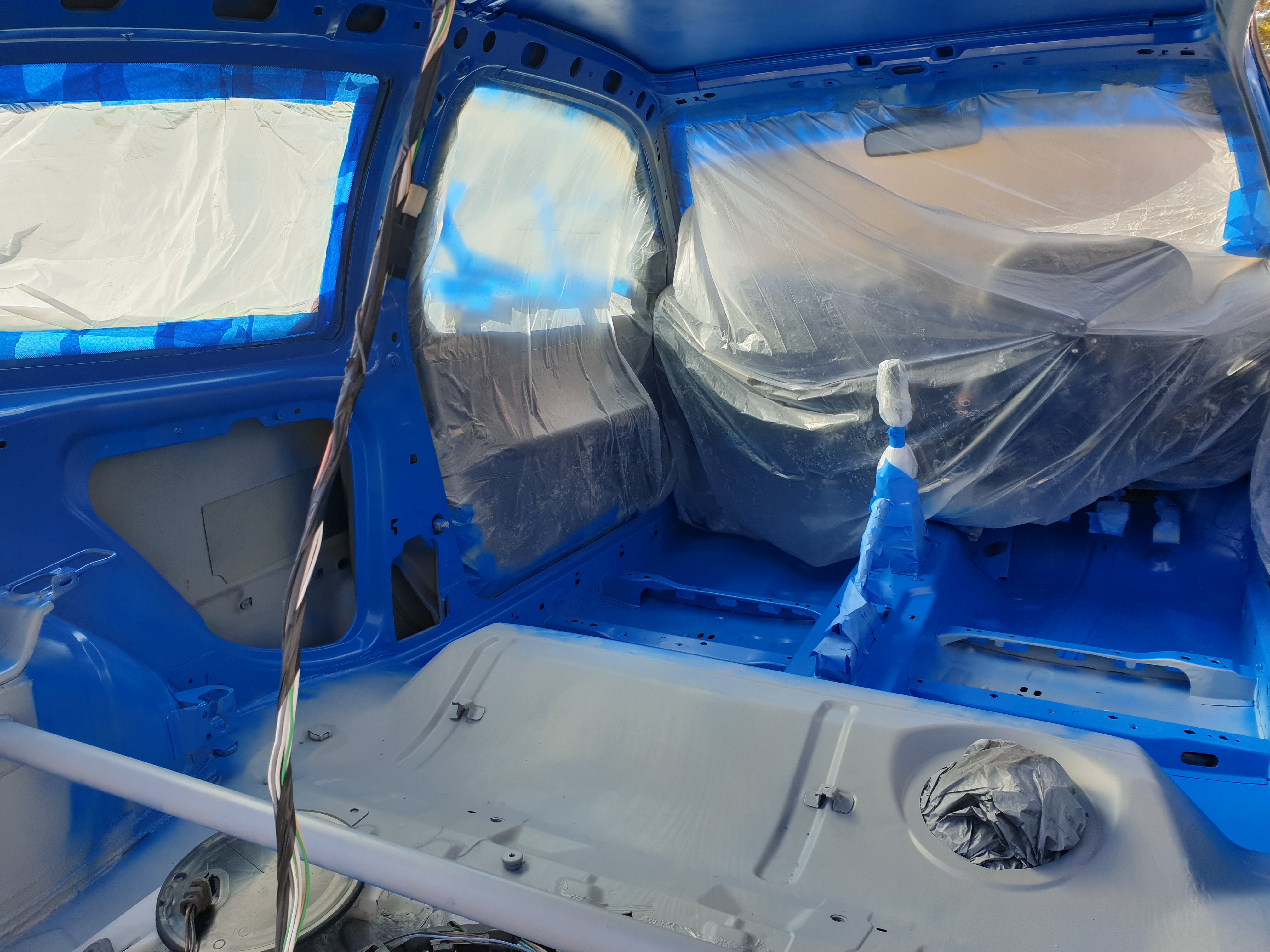

So, I thought I would use the isolation time wisely and get the car painted. I'd already decided that it would be a driveway rattle can job and had placed an order for primer, J45 RB and lacquer through Rapid pints at the beginning of the year.
Cracked on with removing the last of sound deadening on Tuesday, began to degrease on Wednesday, finished degreasing and scotched everything up on Thursday, masked Friday lunchtime and primed in the Eve.
First coat of paint went down Saturday morning and then a second coat went on in the afternoon.
Managed to get 2 coats of lacquer down on Sunday morning.
Then I tore the masking off and plugged everything back in late in the afternoon. One of my mates popped over to help put the seat back in too.
I'm very pleased with how it came out. It's not concours, but for an impromptu driveway jobby in February I think it's respectable.

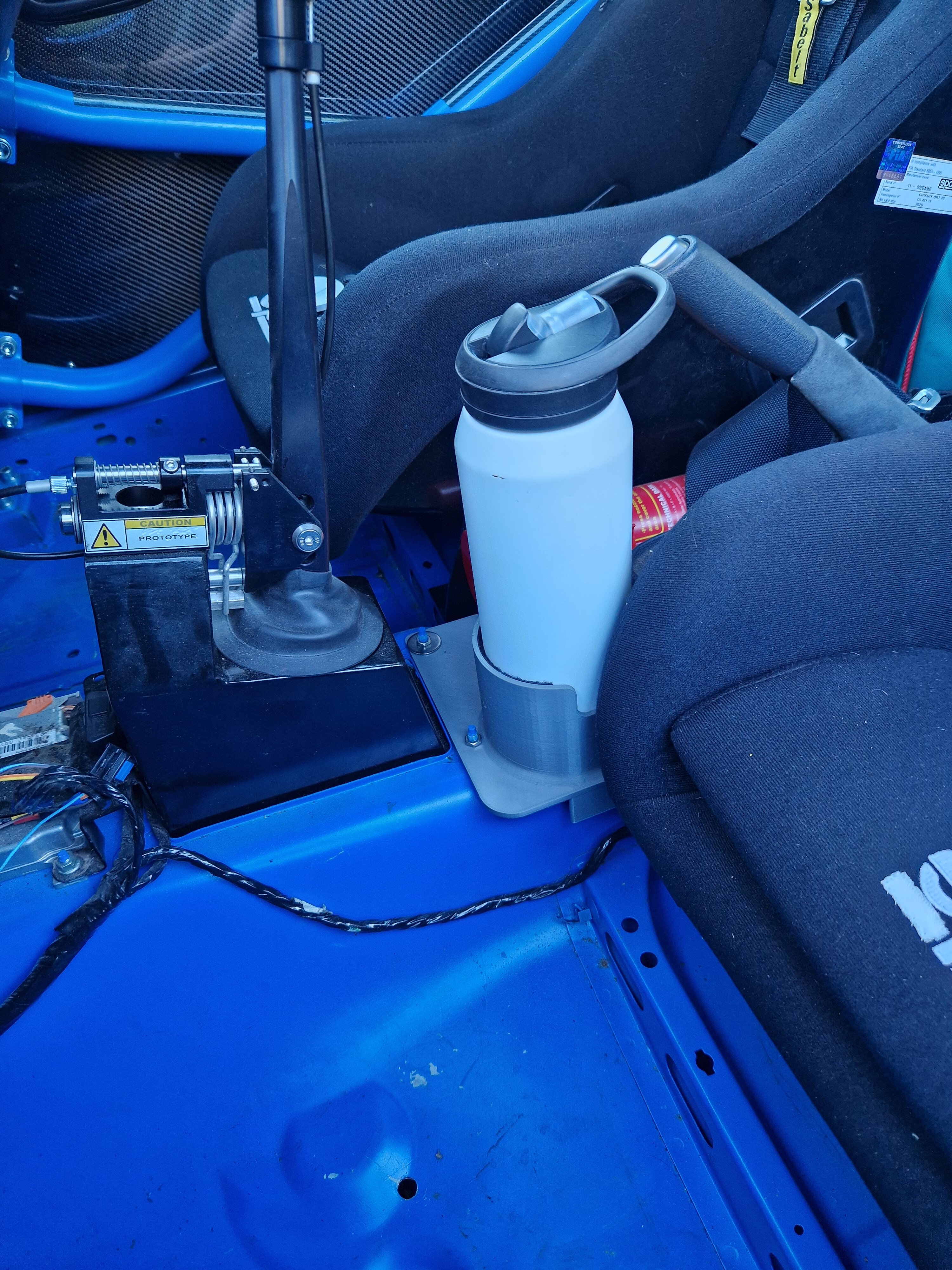

No centre console (and flat doorcards soon) means that there is nowhere for a water bottle to be kept for longer journeys, so I was pleased to see this handy air vent cupholder advertised on the Mk2 Clio FB page.
Really neat solution. I just hope it will still fit with the cage! More parts turning up soon.....

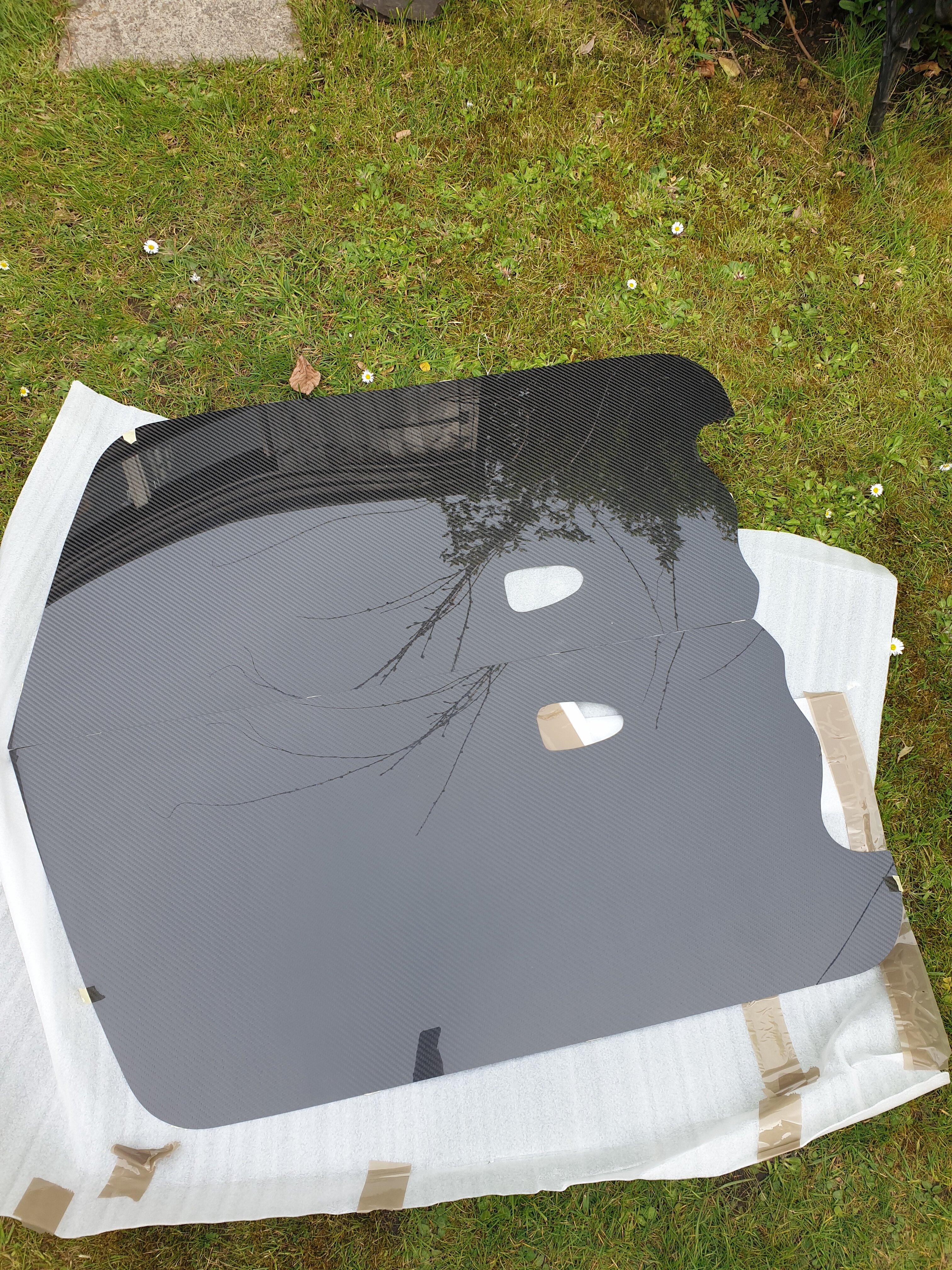

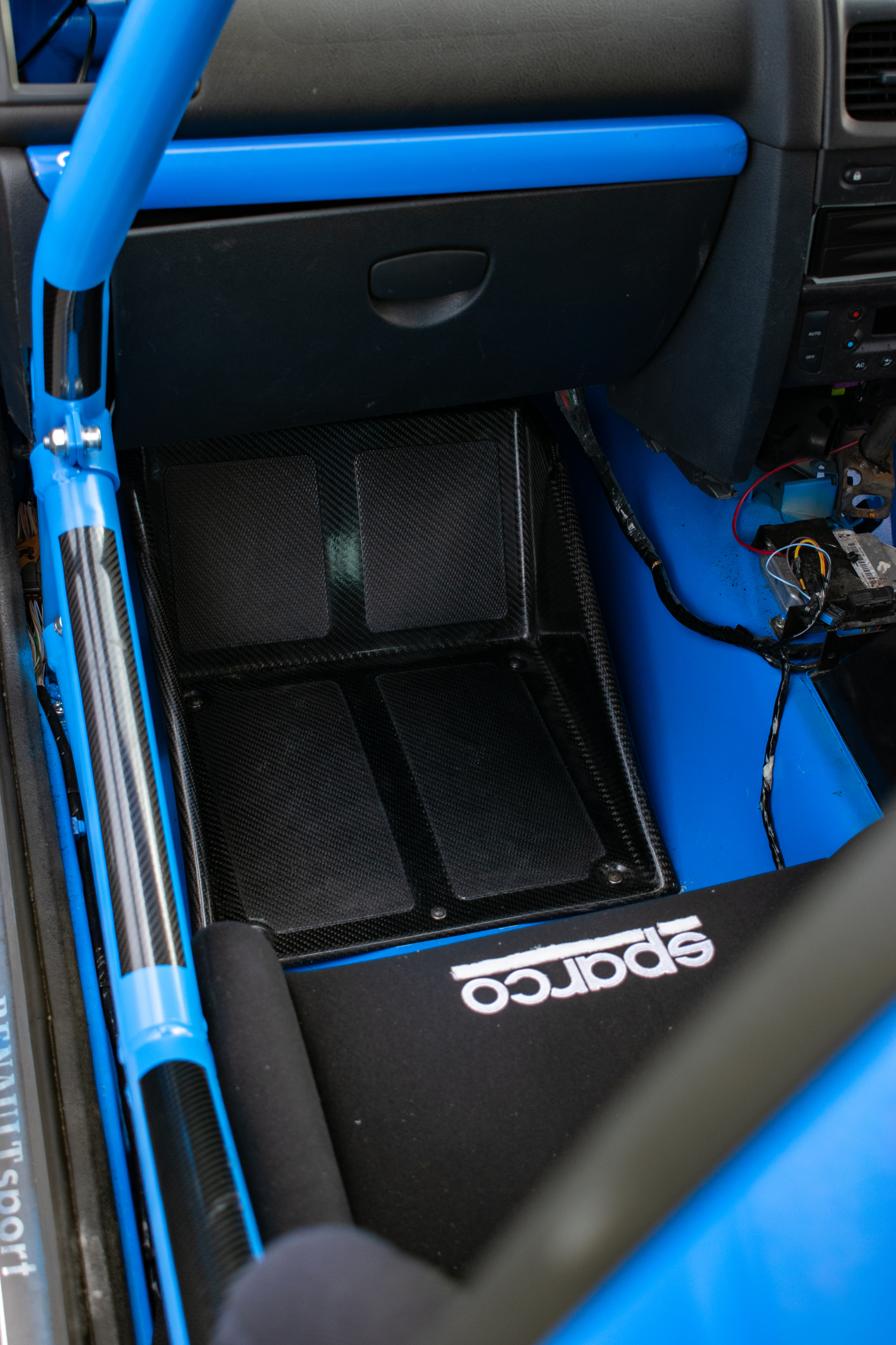

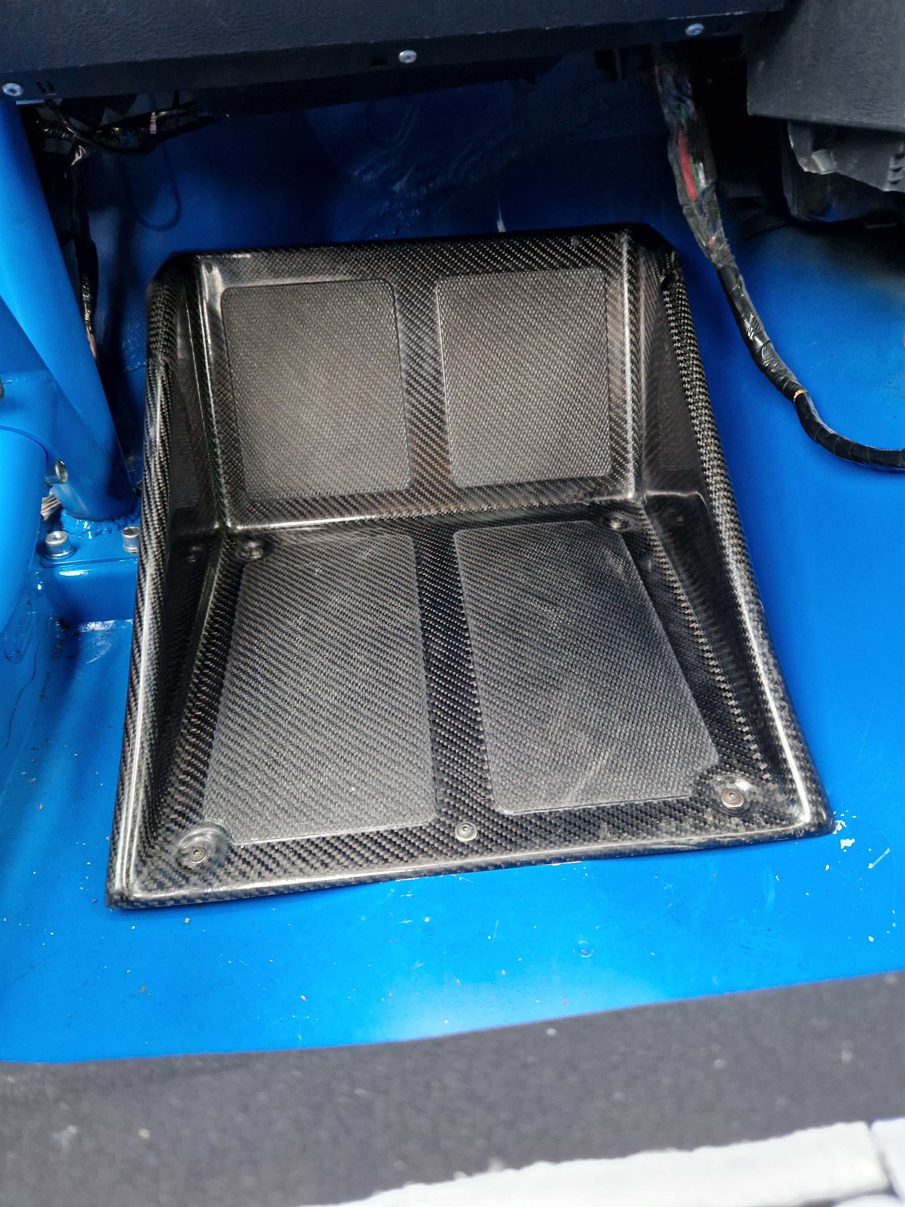

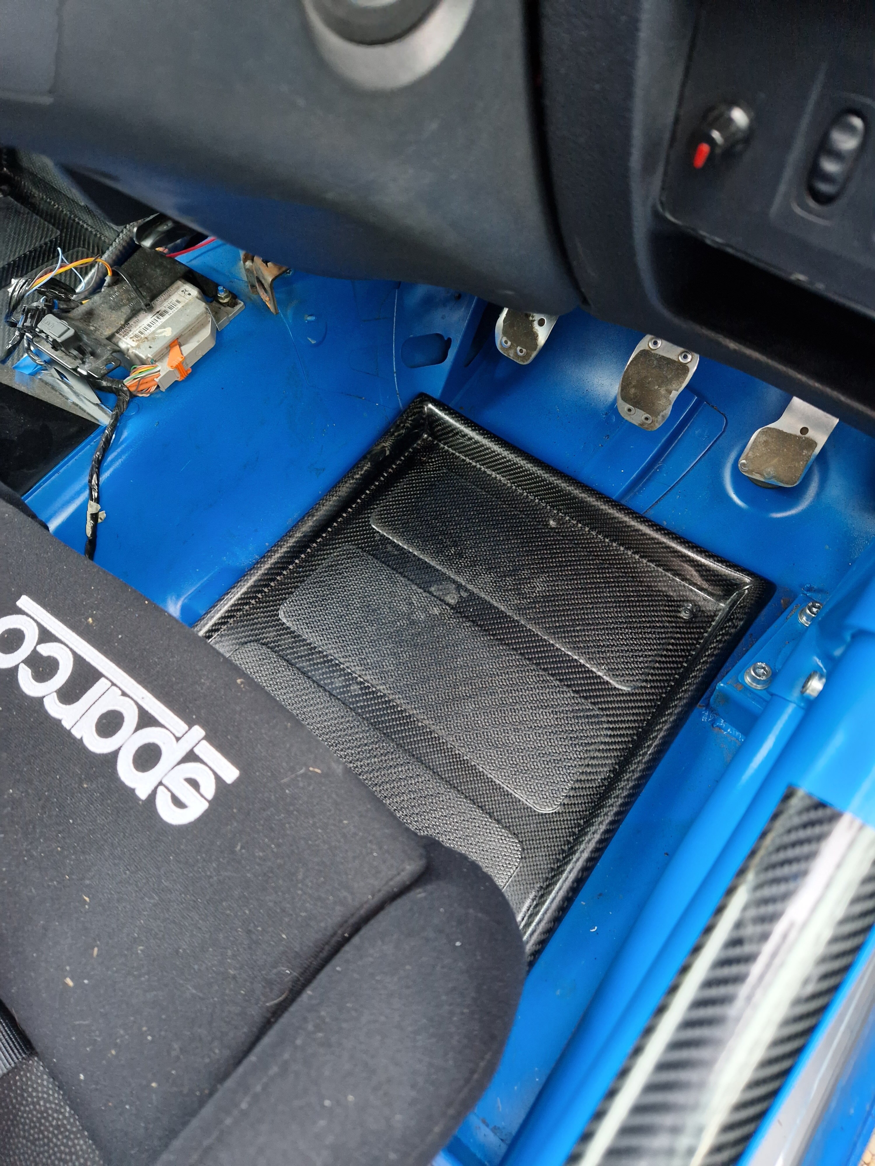

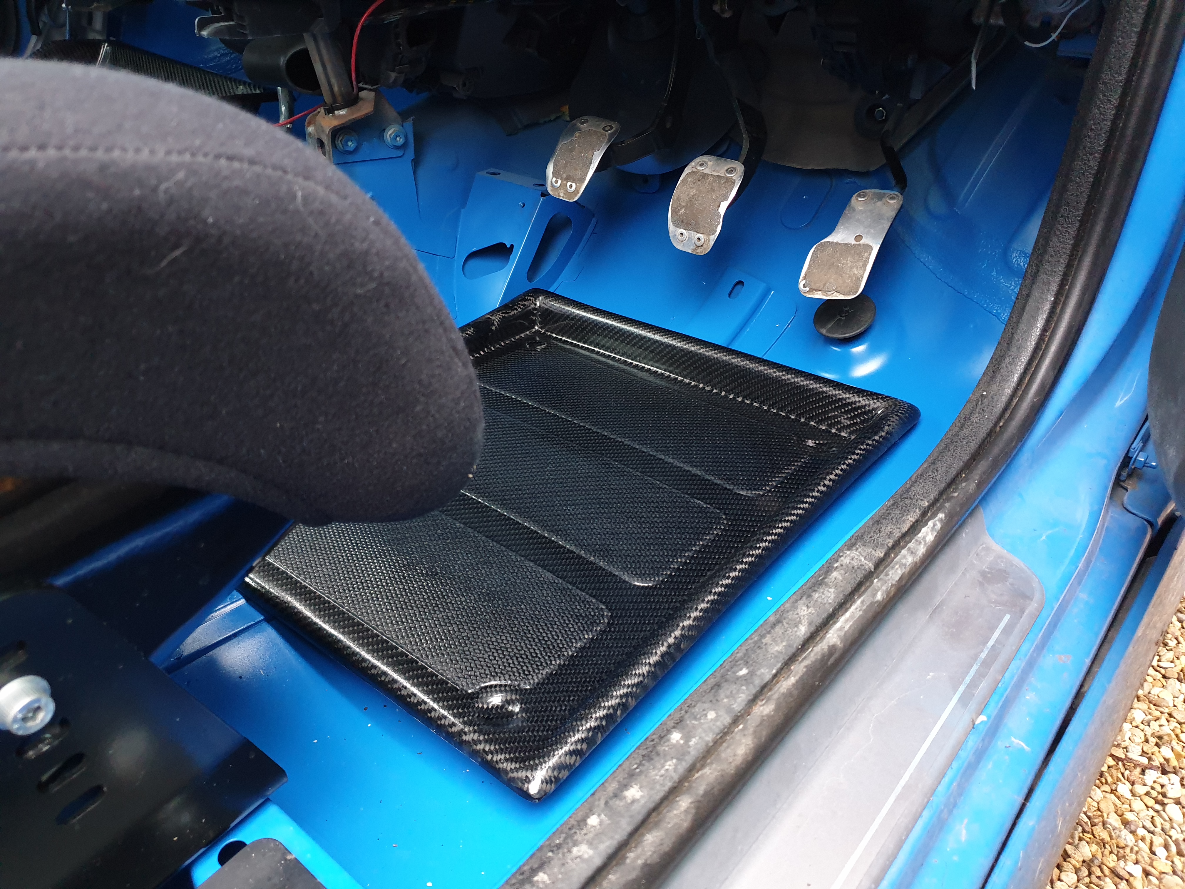

TRS Carbon foot trays for both driver and passenger first up.
Then I quickly realised that non carbon doorcards might look a bit strange next to the foot trays so a set of Carbon-Tec front and rear doorcards were ordered.
All seem to be nice pieces of kit.
To go with the doorcards; there are a couple of blue door pulls (just cheap ones off ebay), a Renault Master Window switch so that I can keep the mirrors and electric window functions and some nice neat black fixings to attach them to the doors.
Foot trays and doorcards are waiting to go on still though... Any suggestions on how to fix the foot trays in place are welcome!

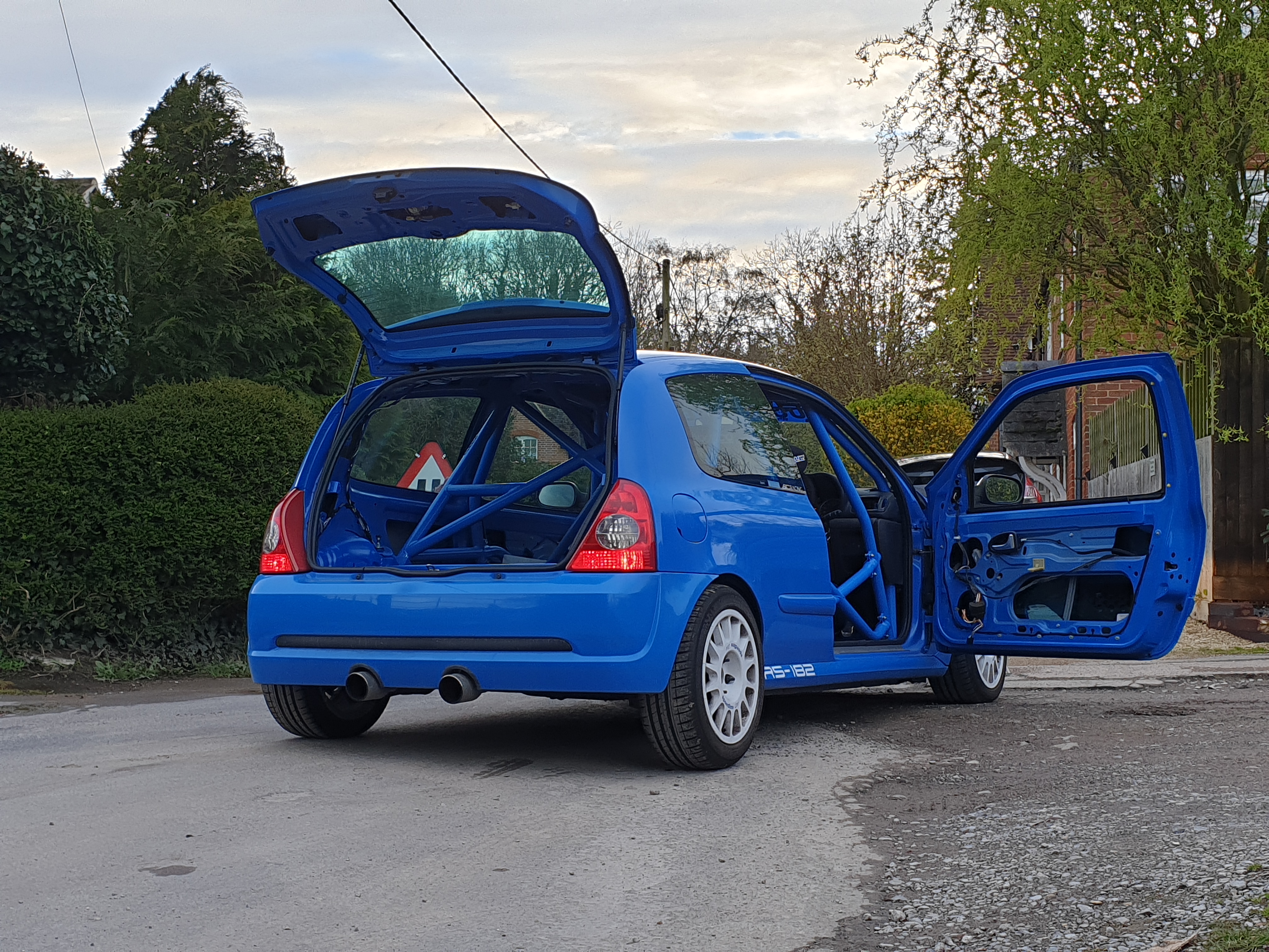

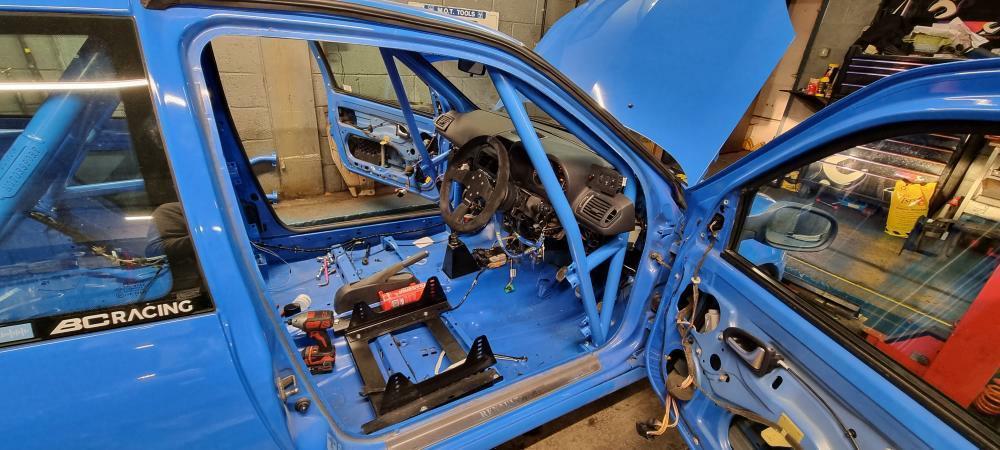

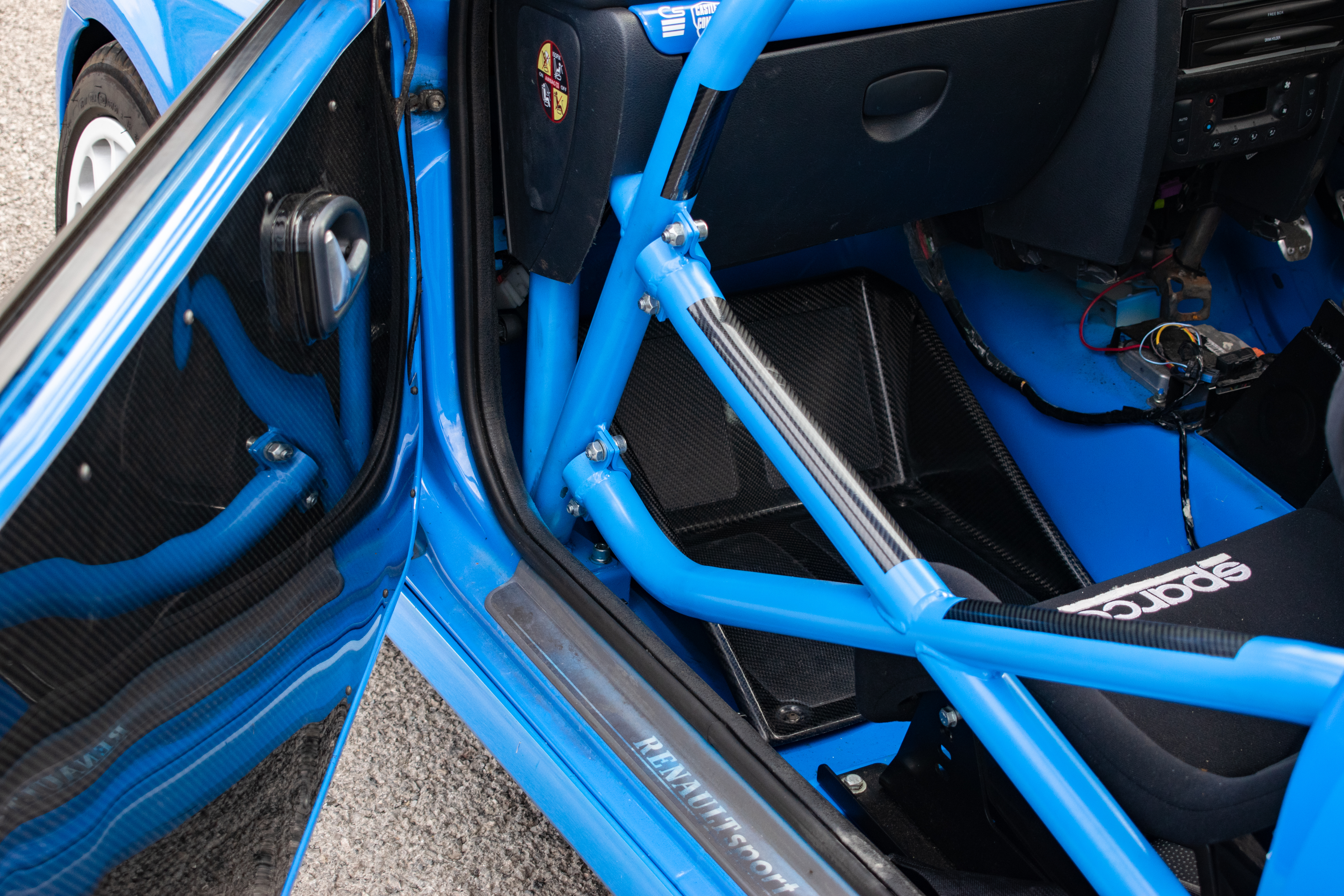

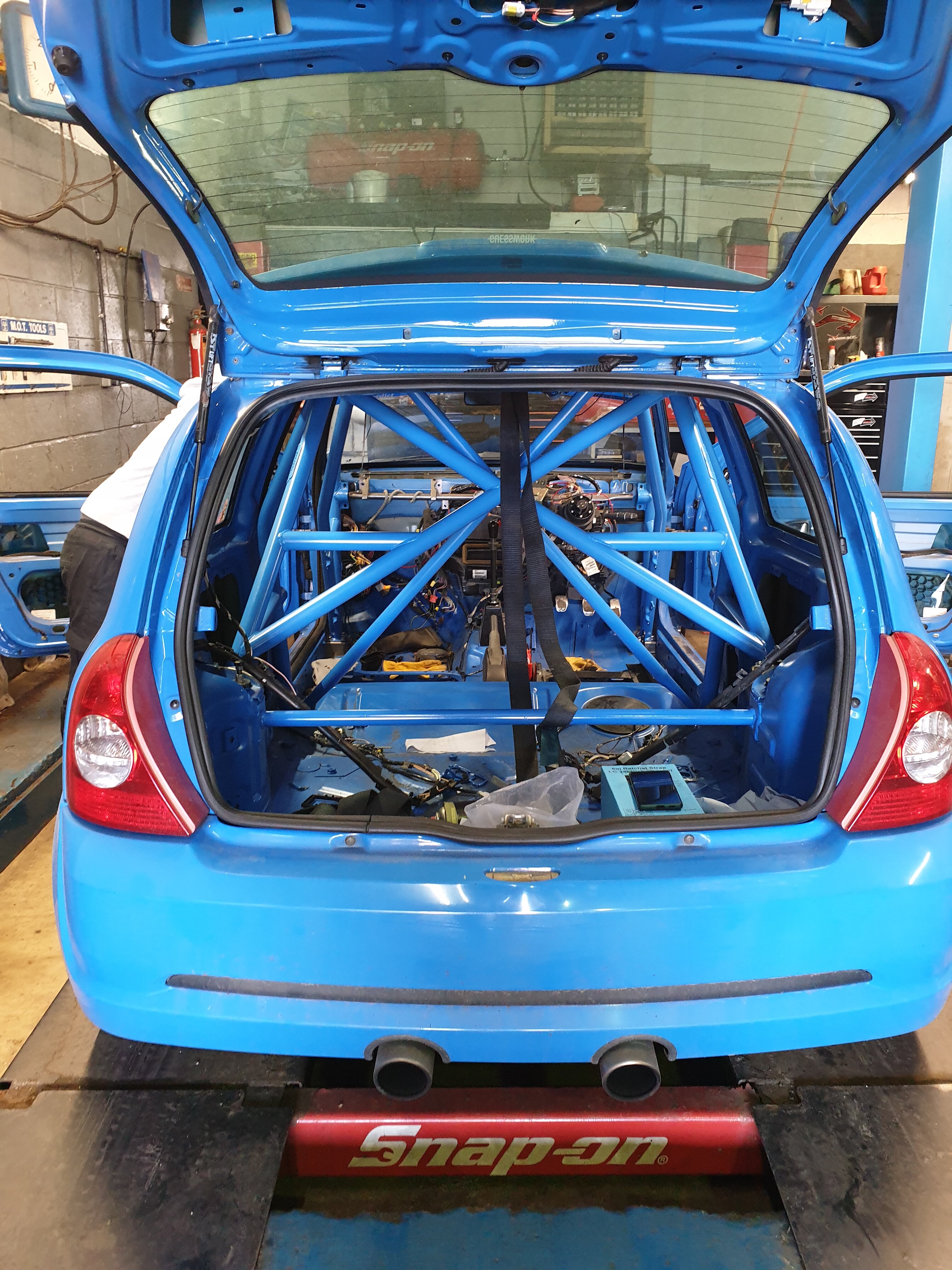

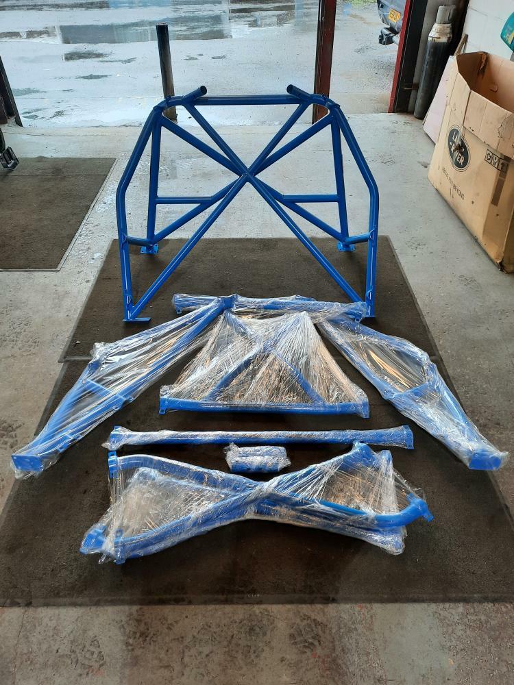

Had a nice message from Tom at Fulcrum Motorsport just before my cage was shipped. Went all out with spec - Rear X, Centre X, Roof X, X doorbars, and A pillar supports.
But there's always something you bring you down! Next issue was that the circlip had popped out of the selector bush of the gearbox so I couldn't select gears properly. Oh well, new one ordered and fitted but did have to file the bush down to get it sat within the groove properly however.
Then cheered myself up by cleaning the Regas. They were still dirty from the trackday in October but the coating on them made it easy to get the dirt off!

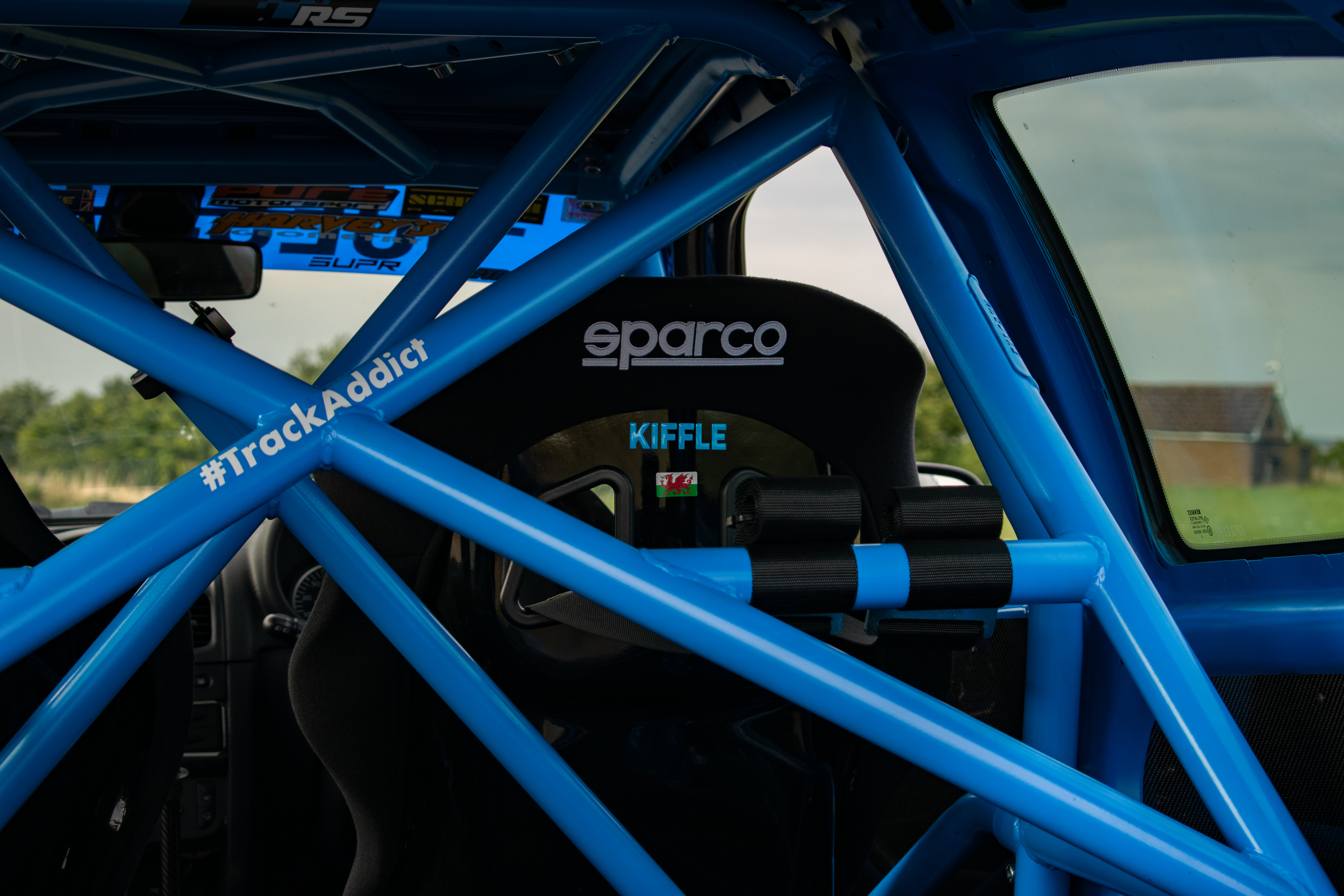

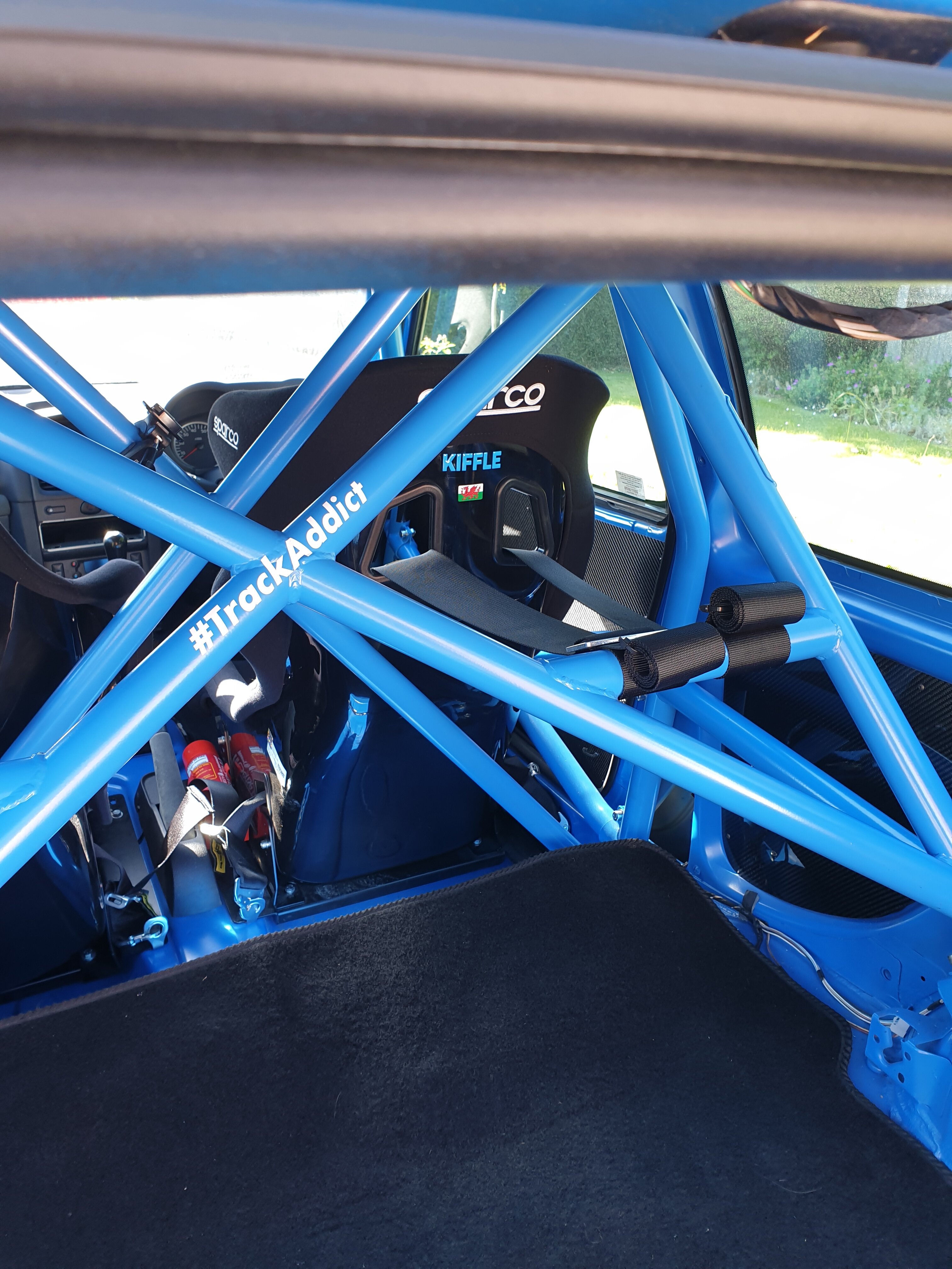

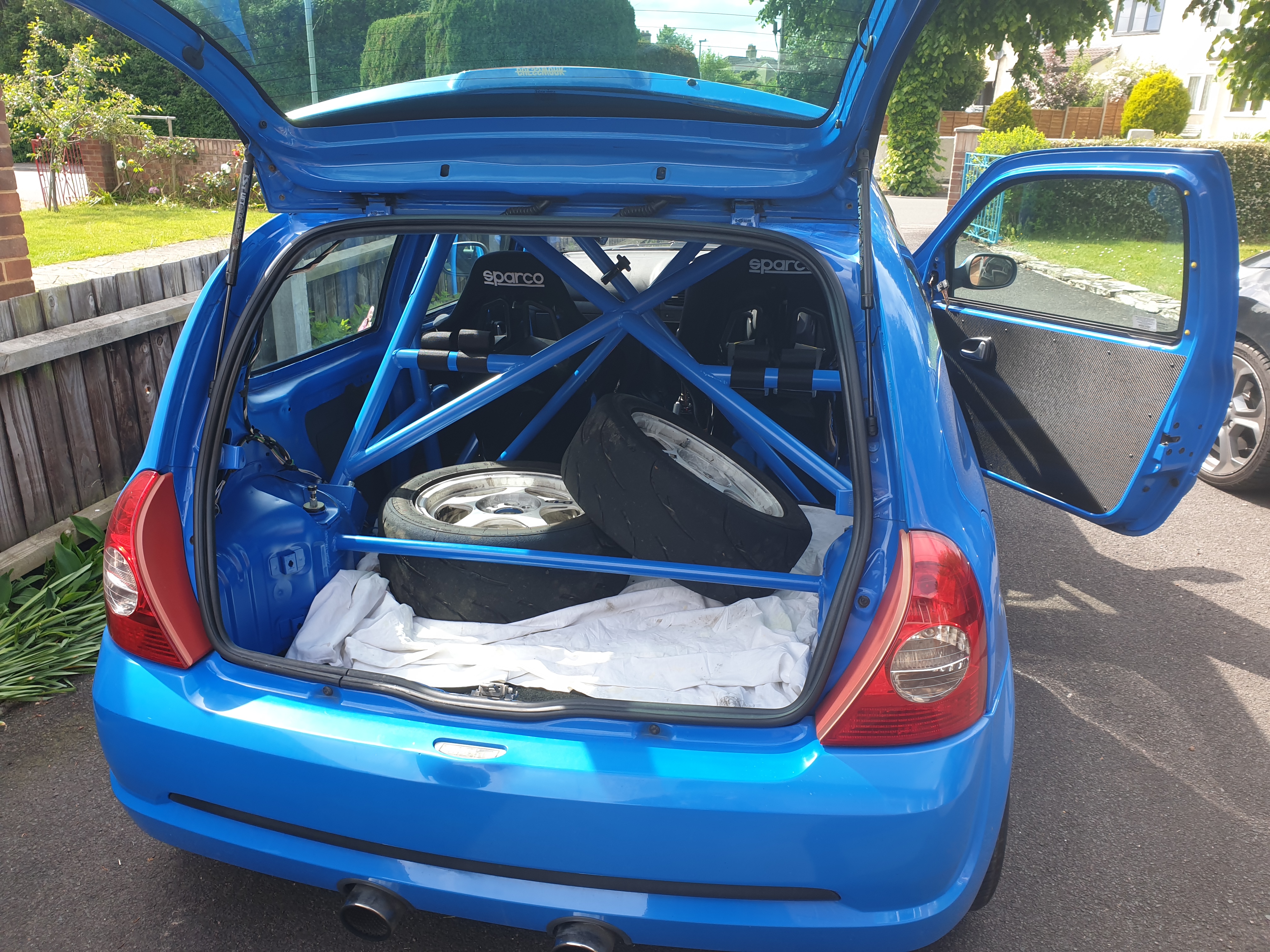

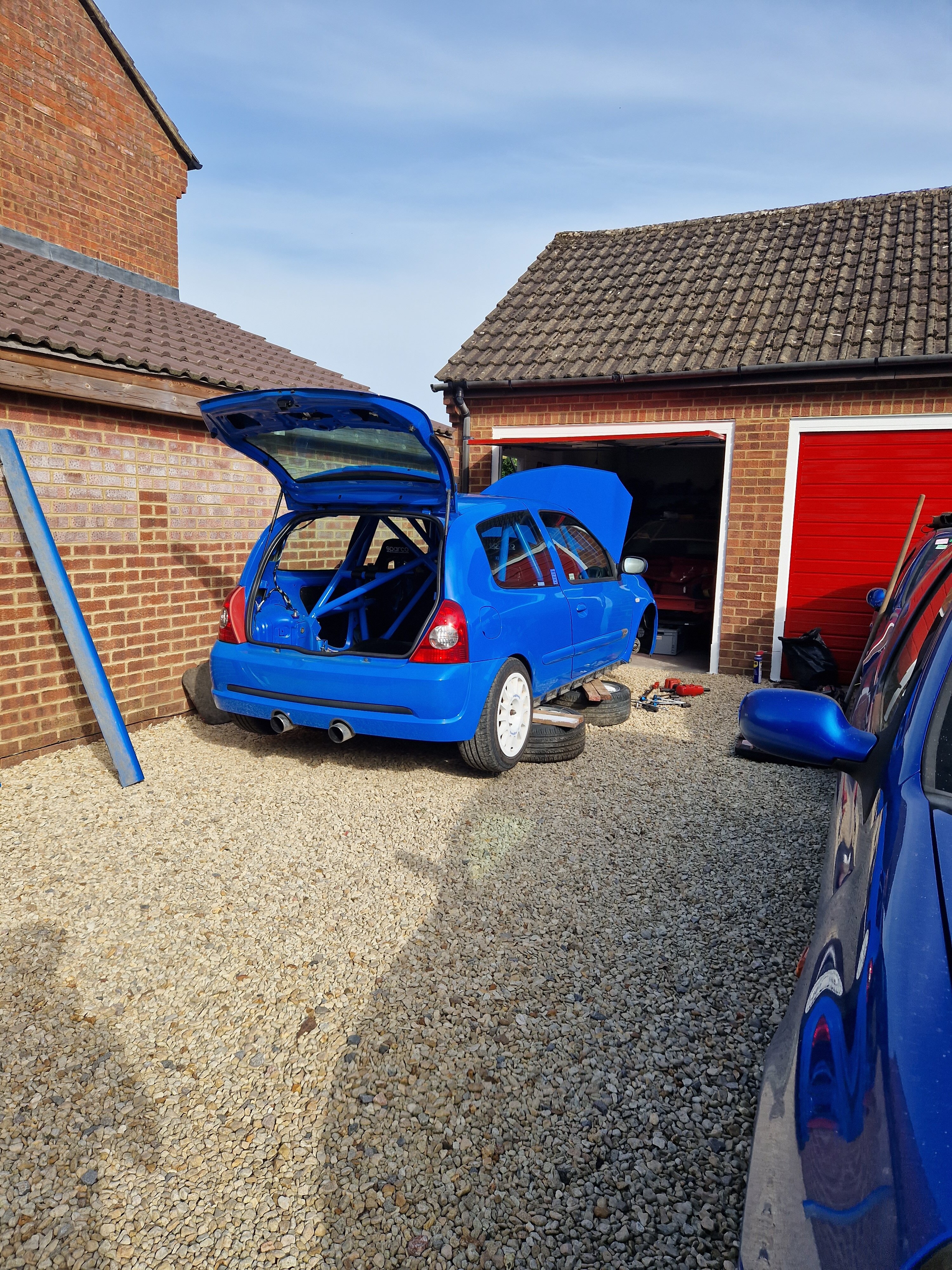

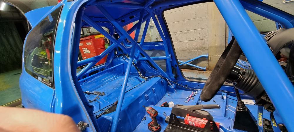

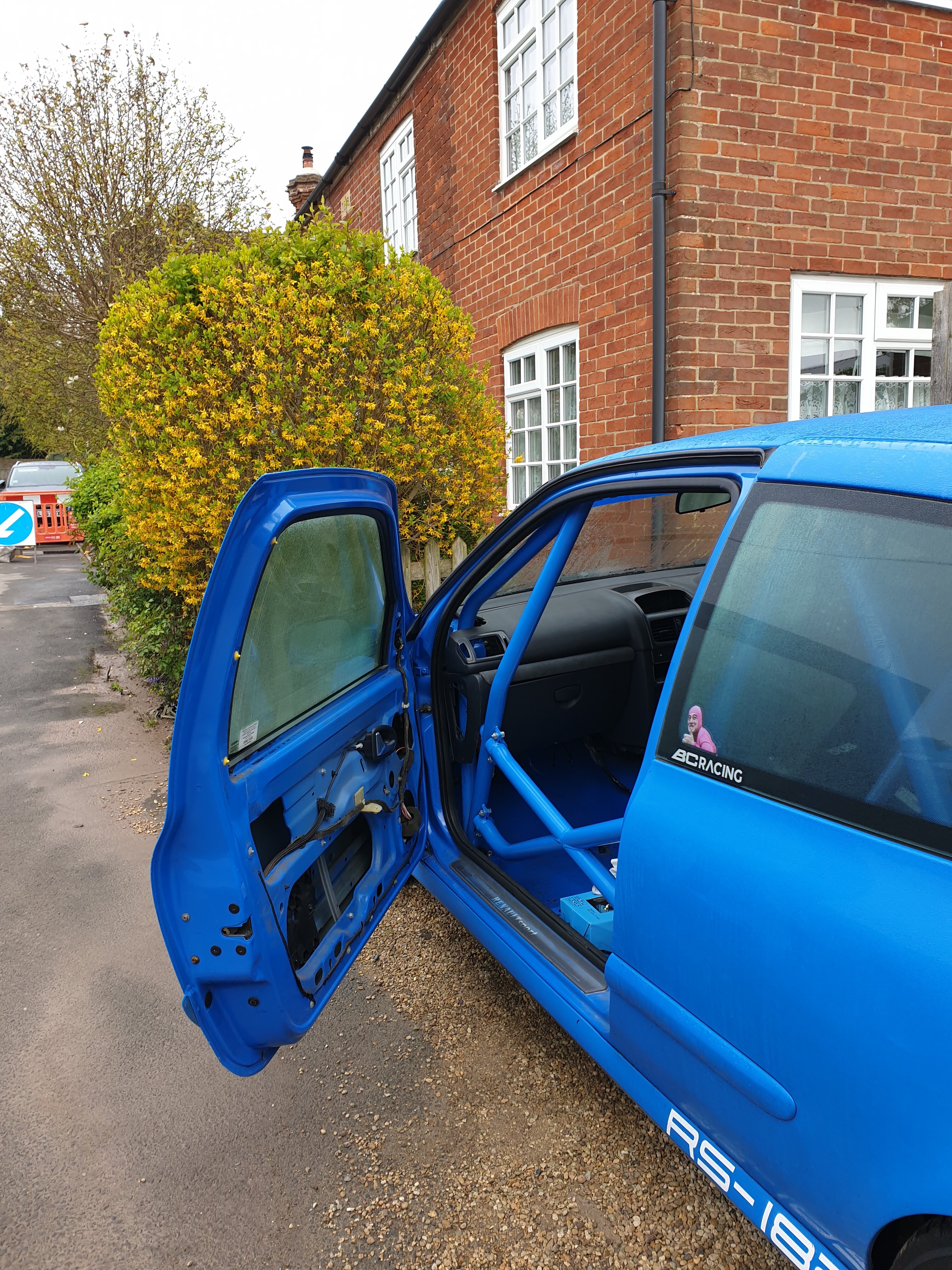

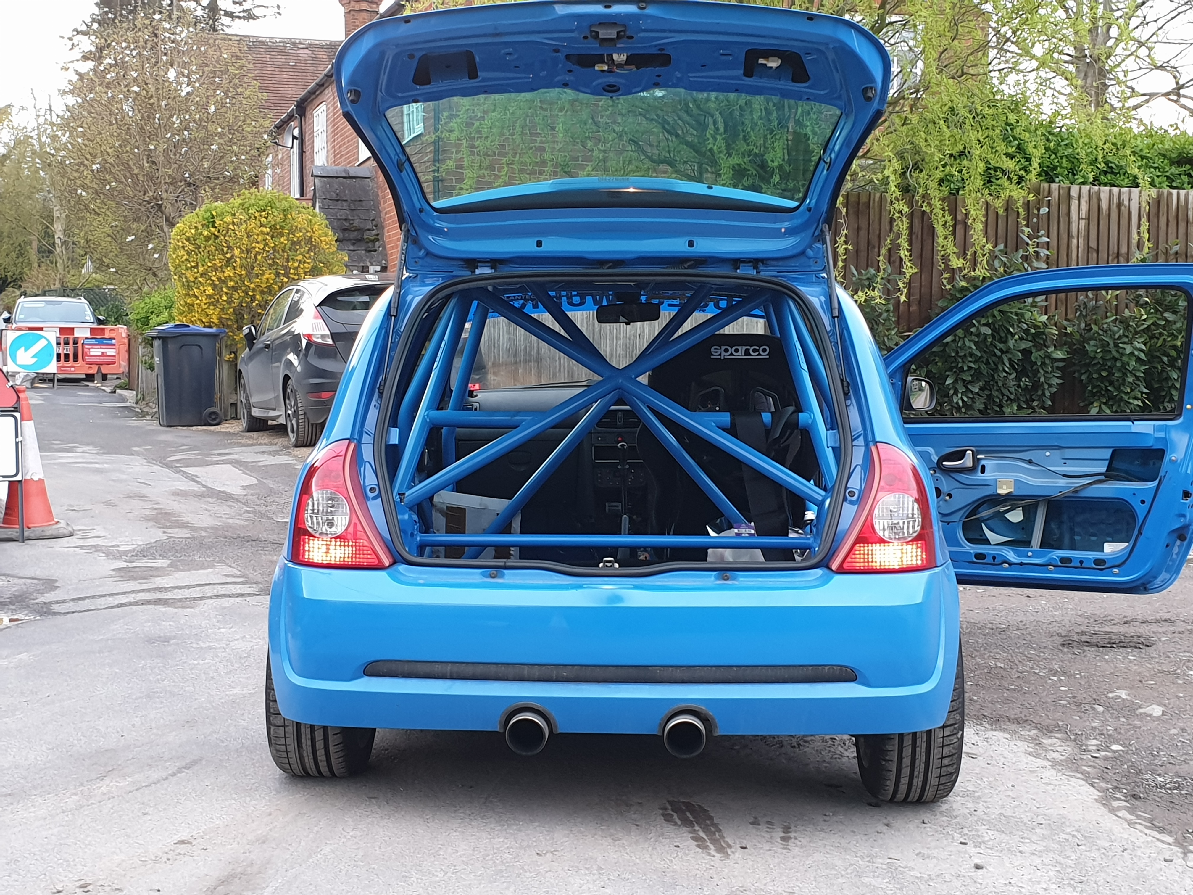

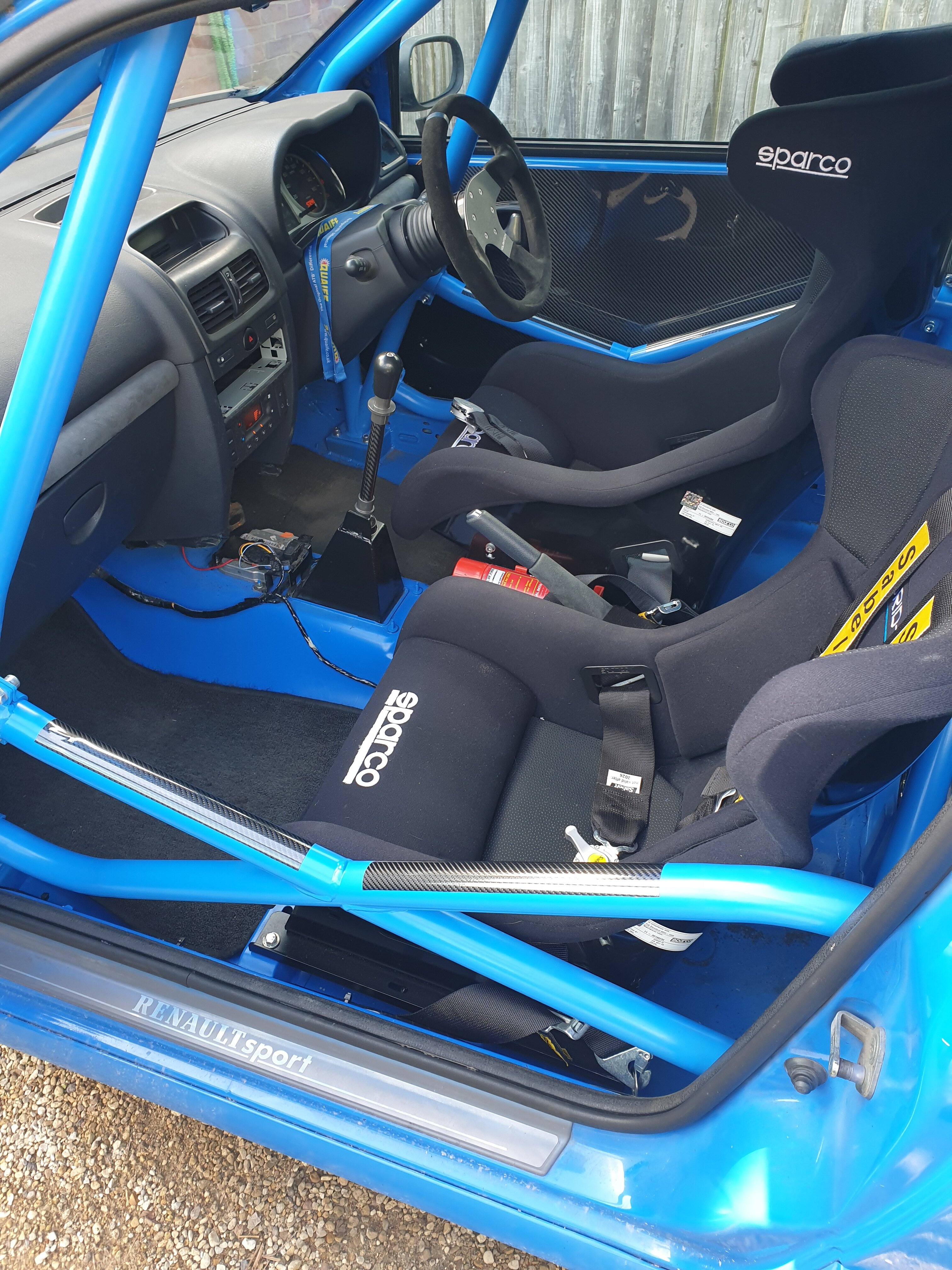

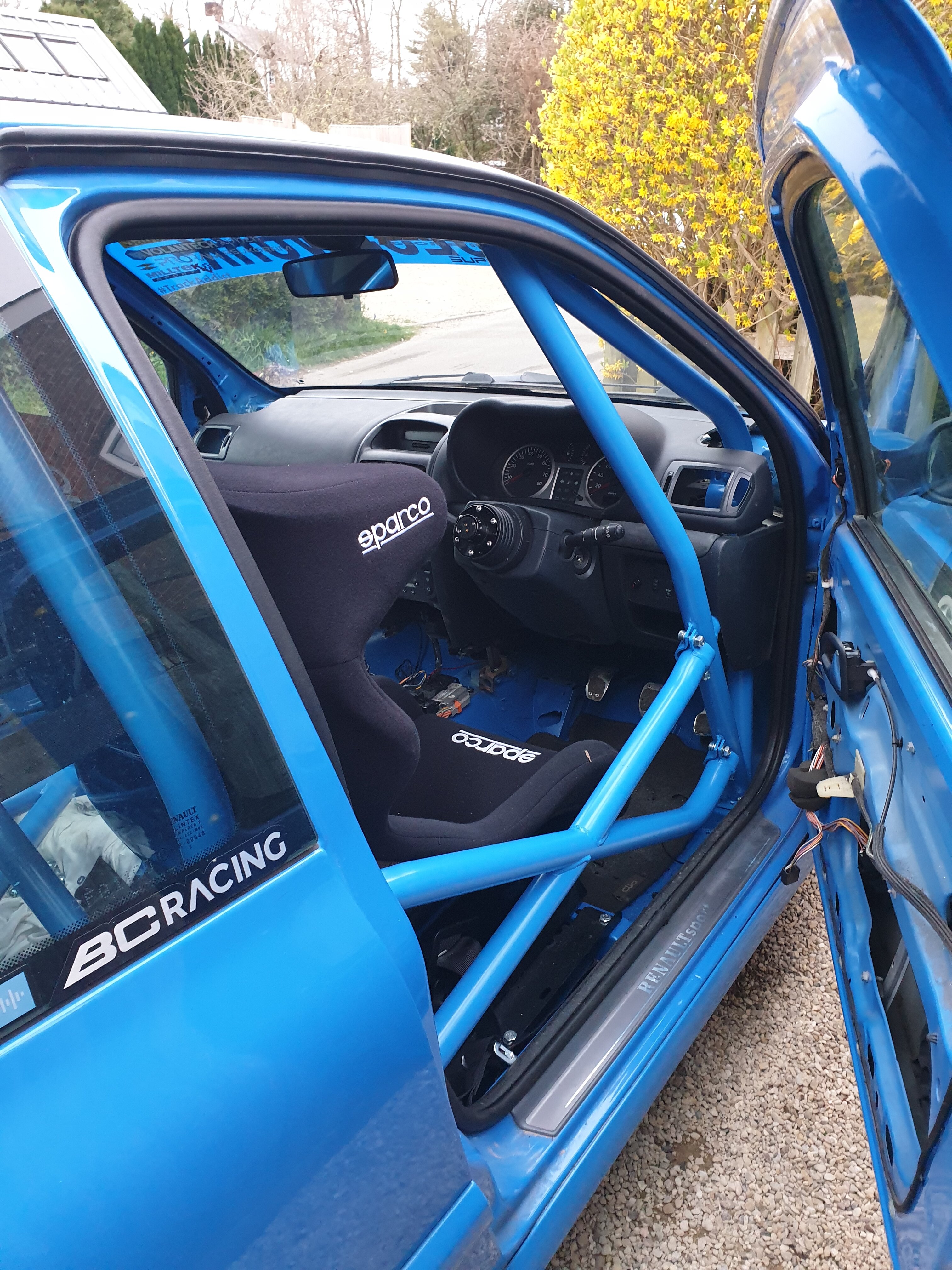

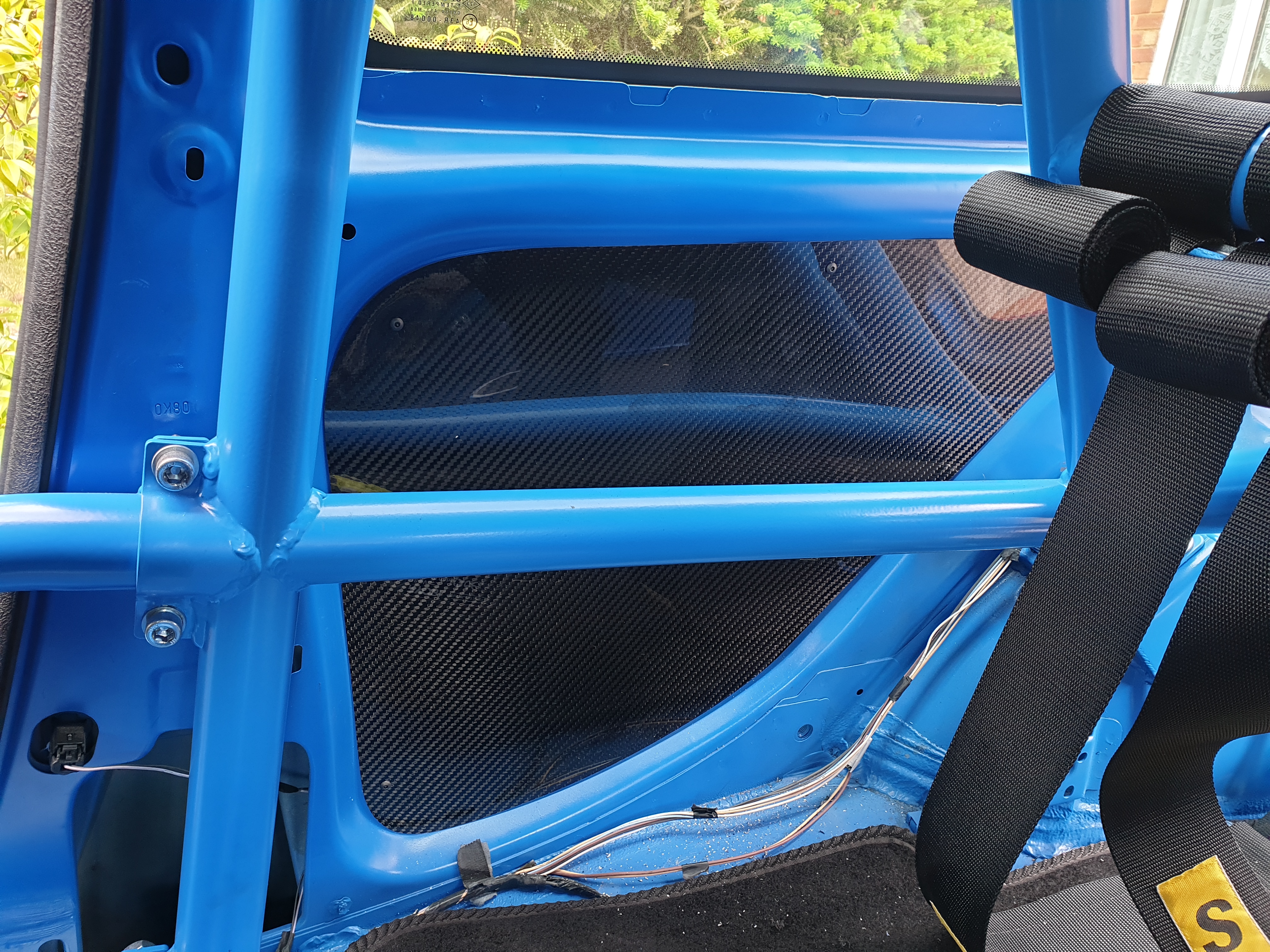

Now onto the cage.
I didn't actually take a lot of photos of the fitting process, but it was a very long day and much more of a faff than I (perhaps naively) thought it would be!
Ratchet straps came in very handy to pull everything into place!
Colour is a pretty good match. Sky Blue RAL5015 was the closest to RB and I'm pleased I chose to go blue. I think it looks really good, especially now the inside is painted.

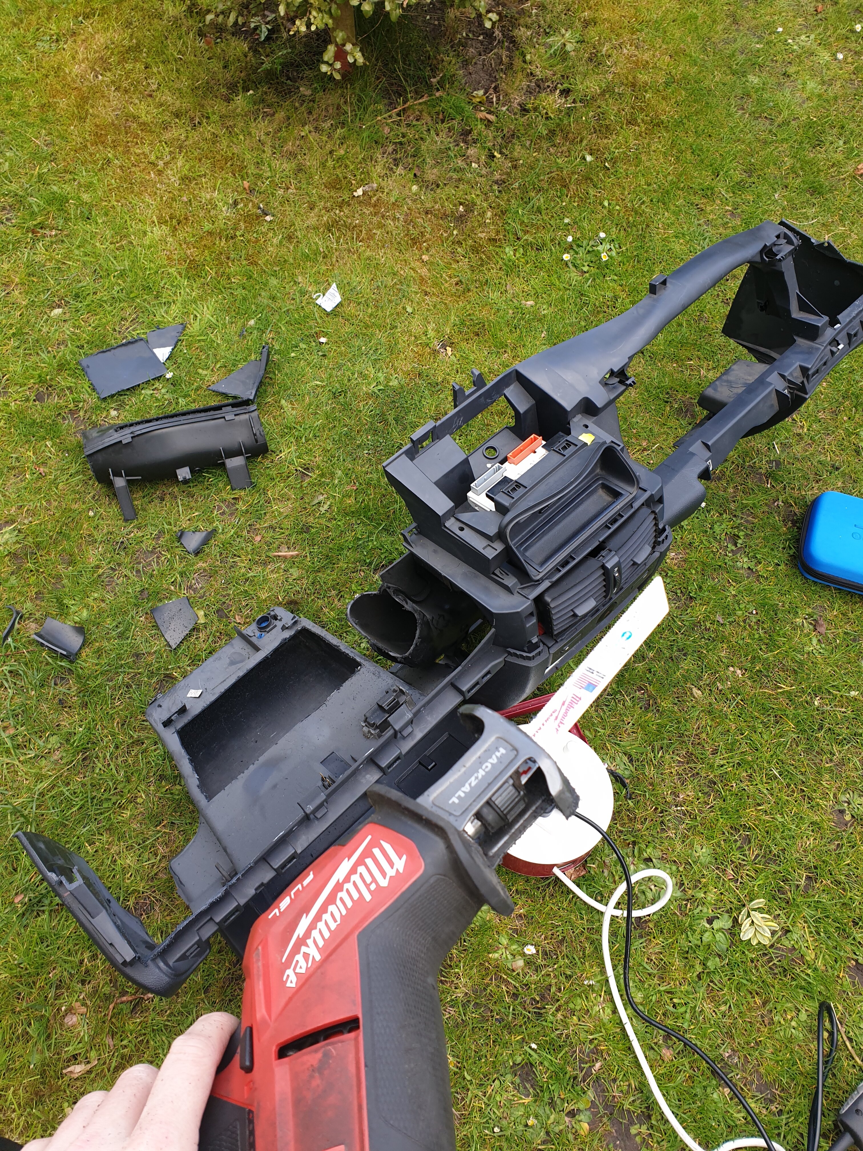

The lower dash then got some weight saving treatment! Think this is my new favourite tool too!

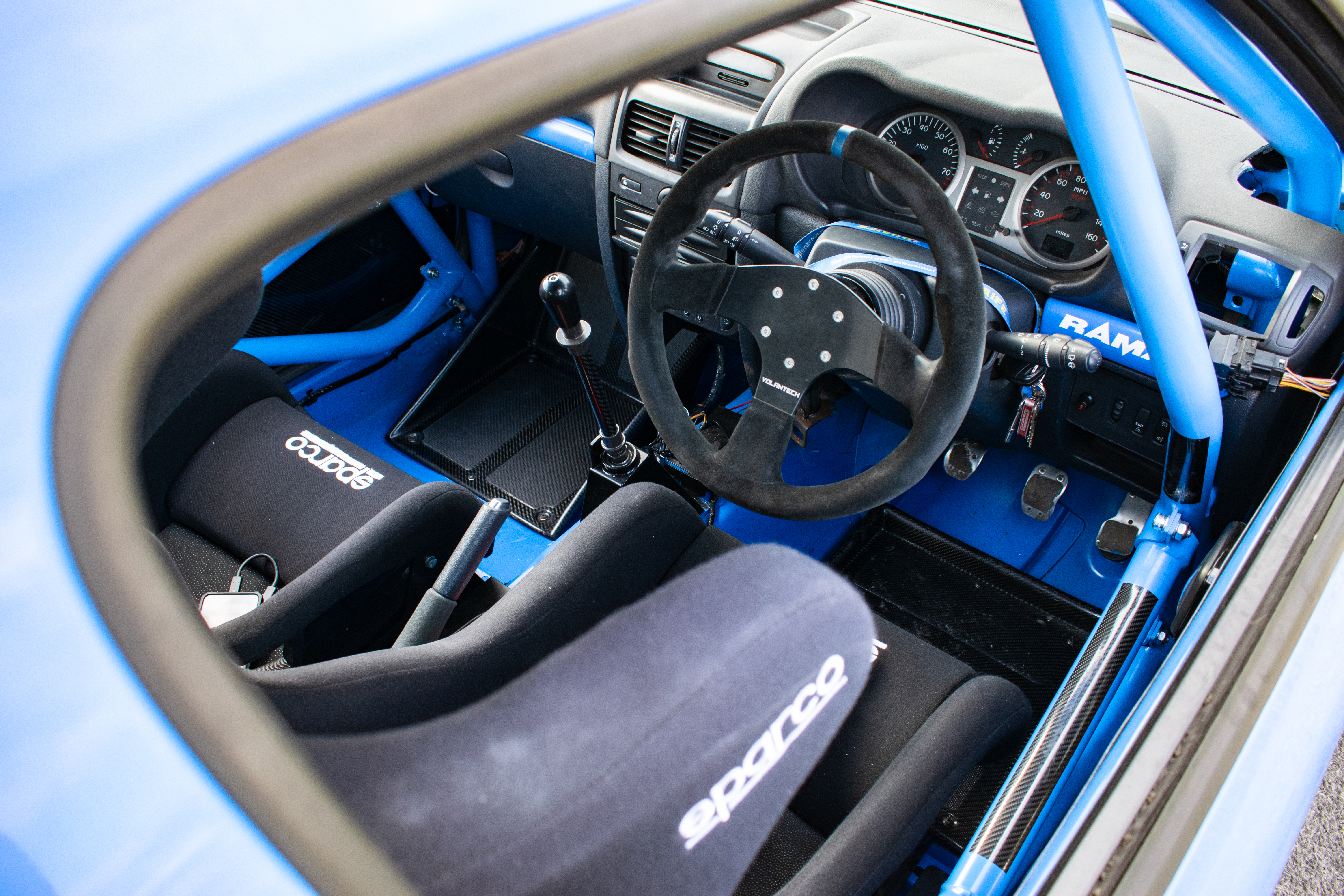

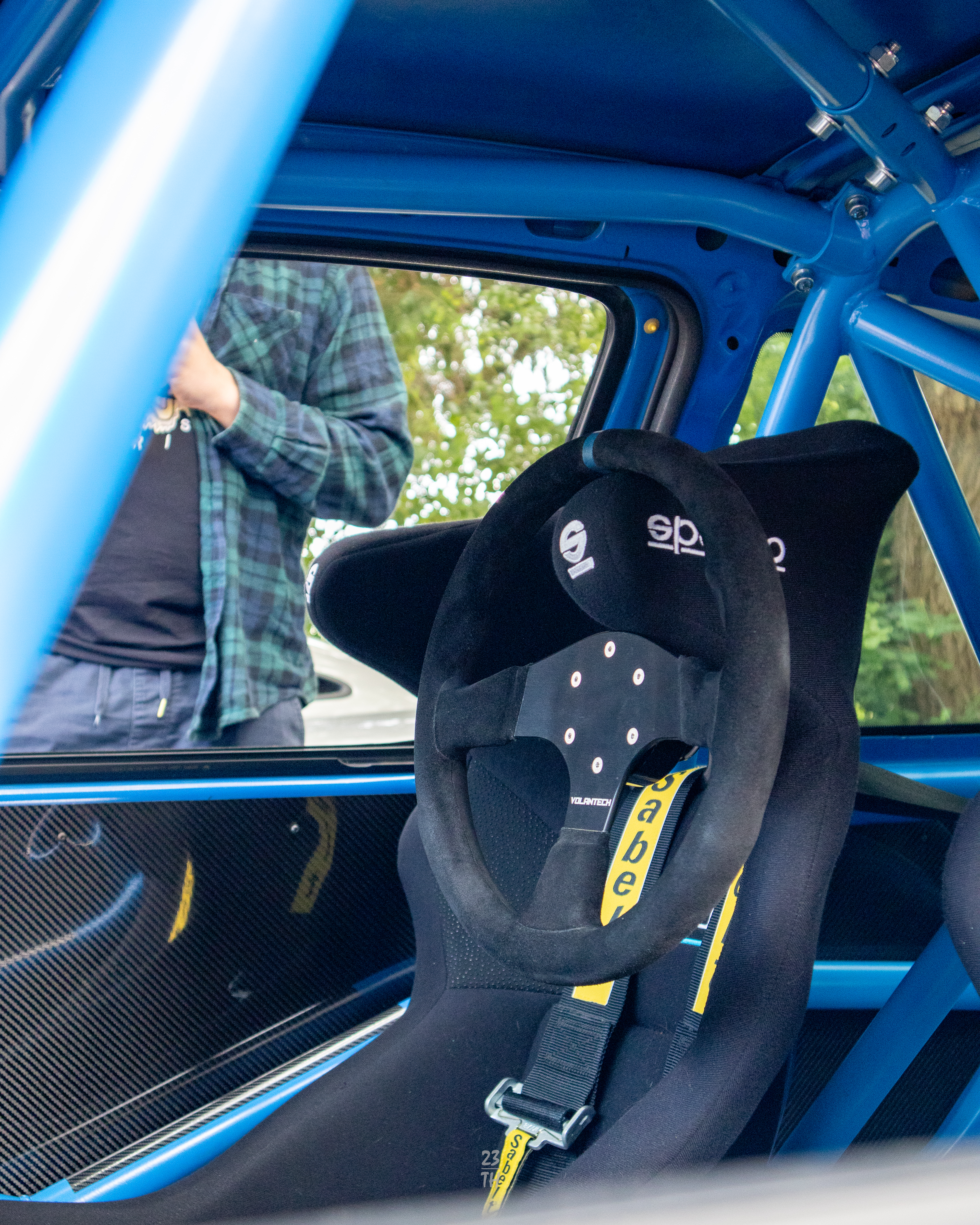

Absolutely buzzing to get it the cage in and the dash fitted and take it for a drive. it probably sounds strange but it feels incredible to be driving caged car on the road and even more so due to the fact it's my own!
I was initially concerned that I wouldn't be able to get in and out particularly easily because I have my seat so far forward and there's a cage bar that comes down in front of the dash. But, even though it took some getting used to, there is enough room. Good job too as I didn't really want to change seats again.
The wiring behind the dash needs some tidying, but everything is in and I'm very happy. Tom also provided a dash bar for the cage too, but I'm not super fussed about fitting that at the moment. Maybe down the line though.

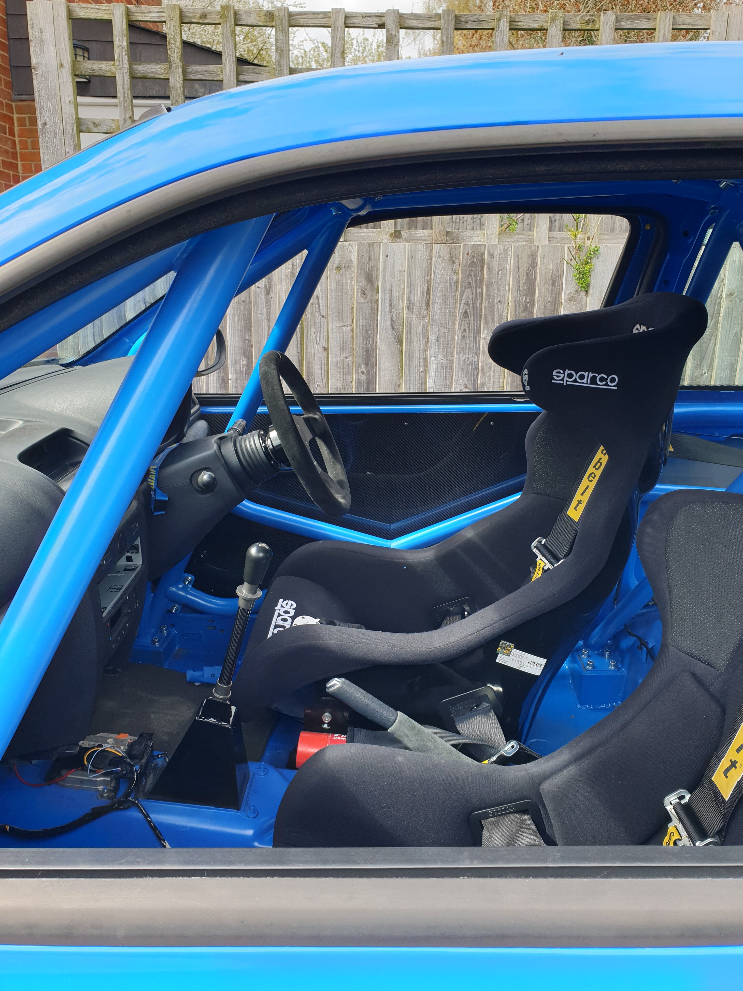

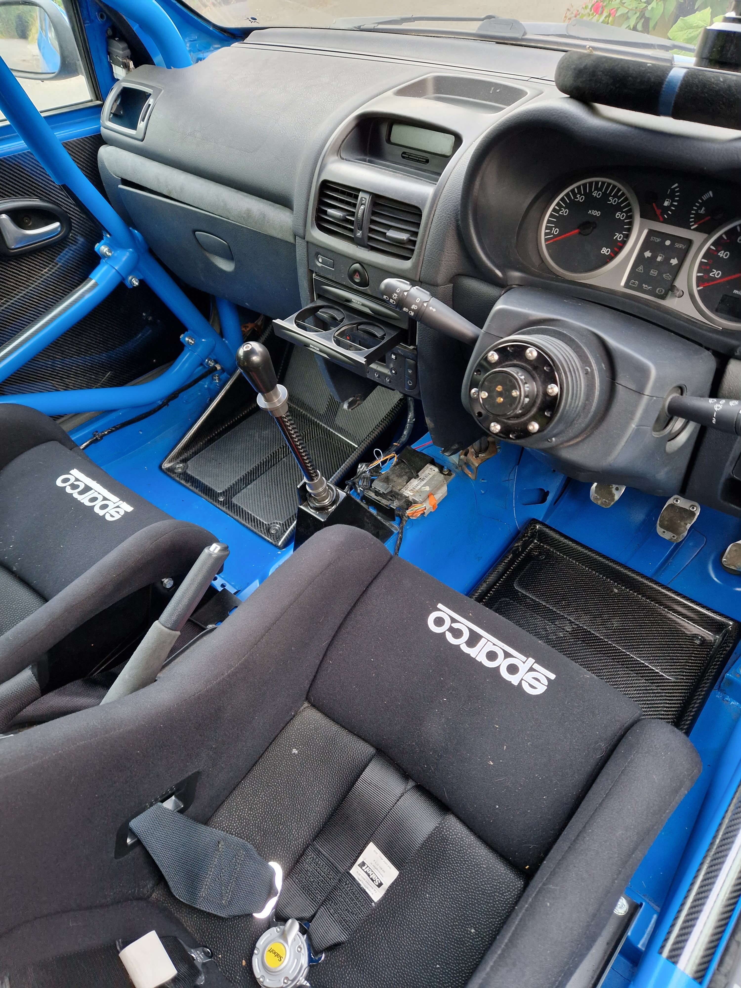

Passenger seat to go back in, along with doorcards and foot trays and then the inside will be complete!

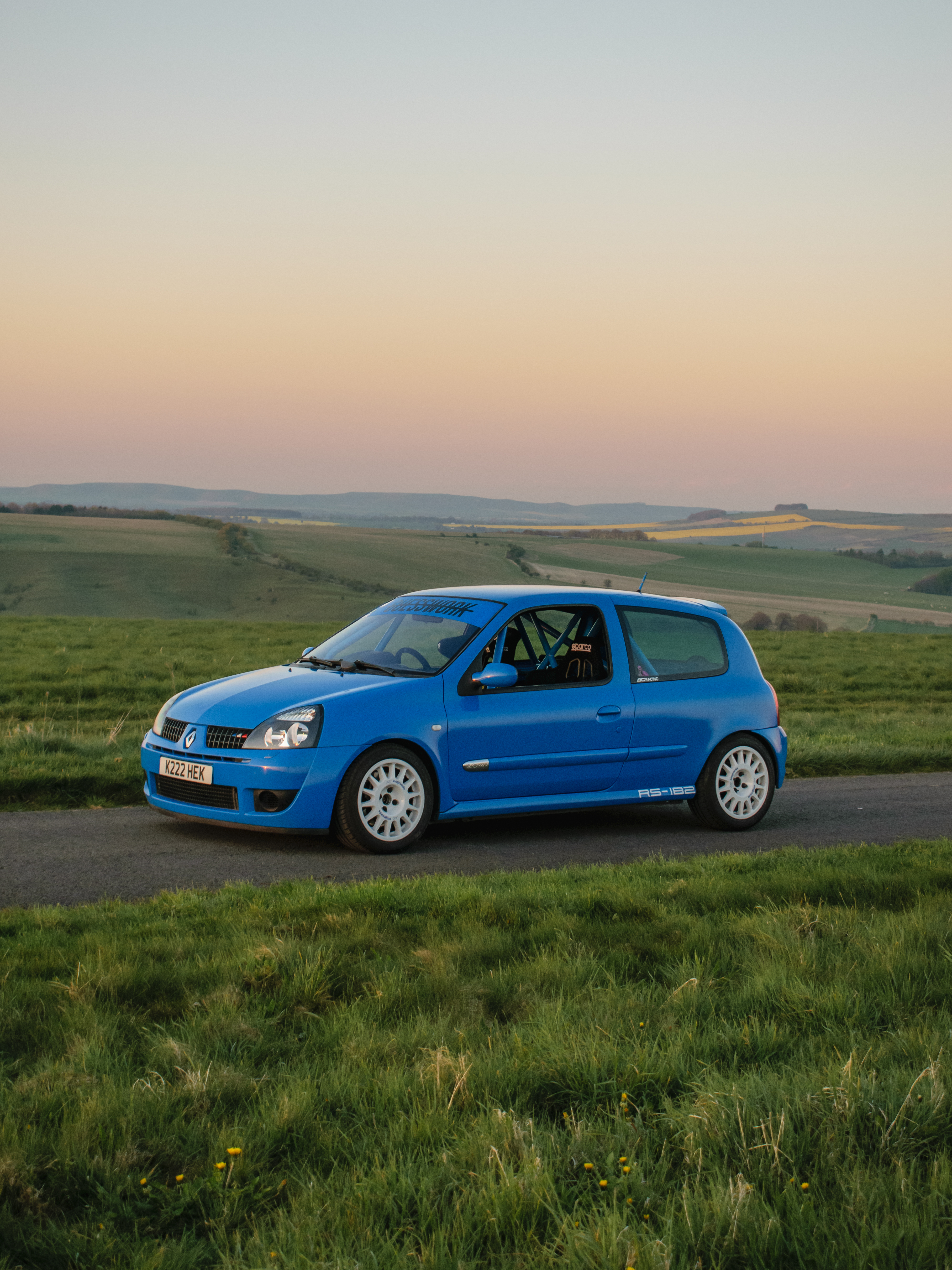

And... I managed to get to work and back successfully in it. Perfect Daily!

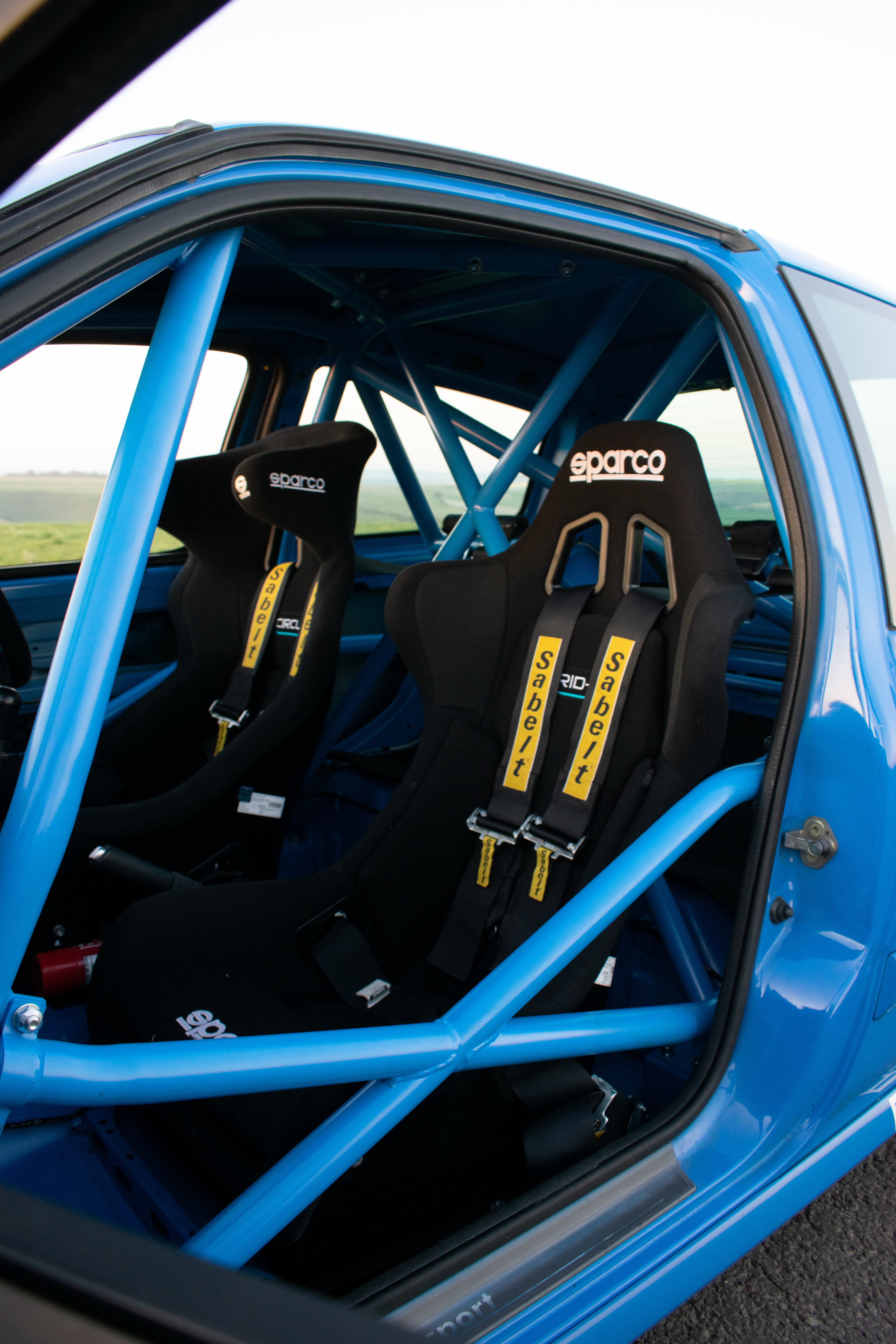

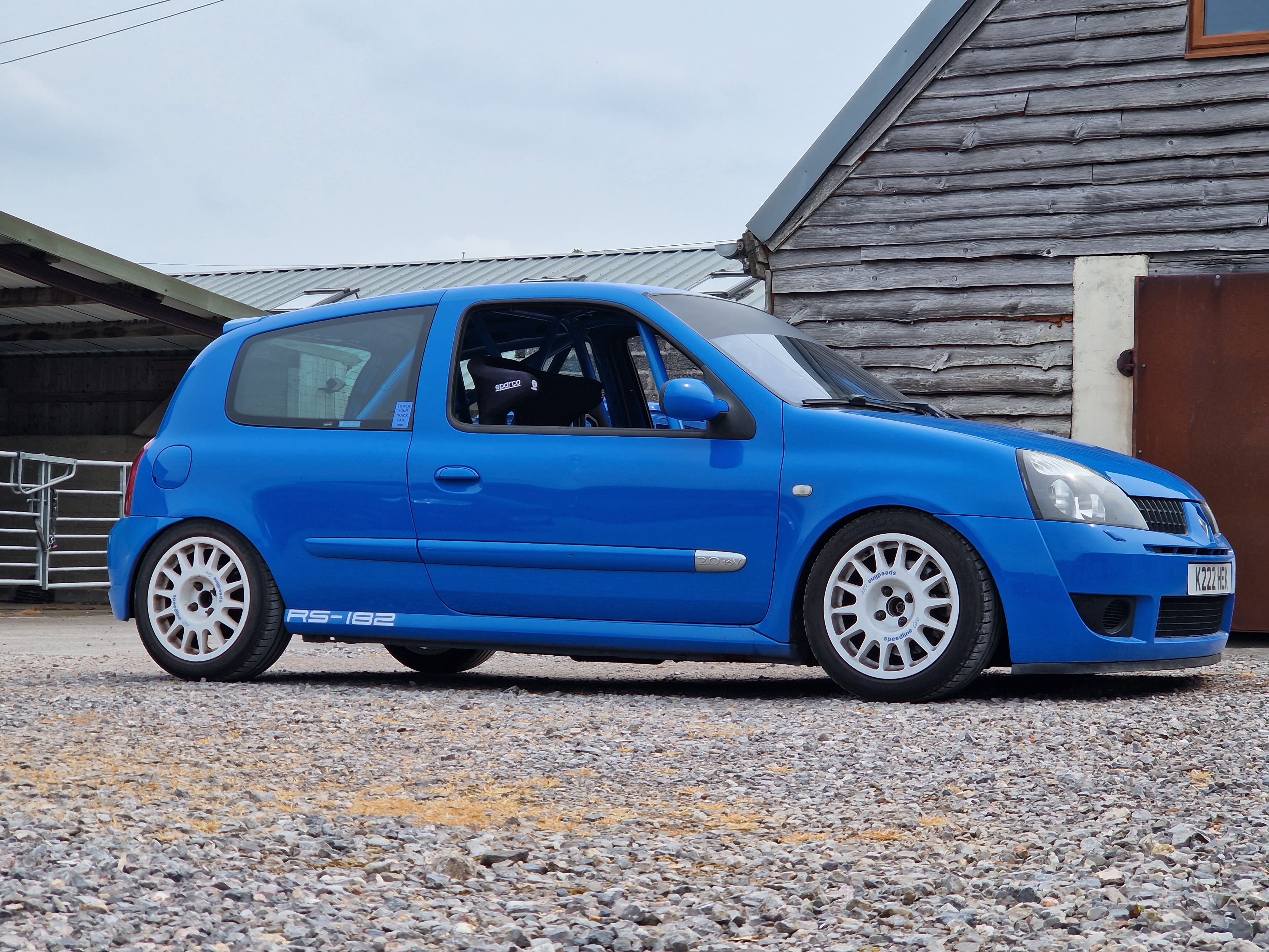

Put the passenger seat back in yesterday then got the camera out in the evening...

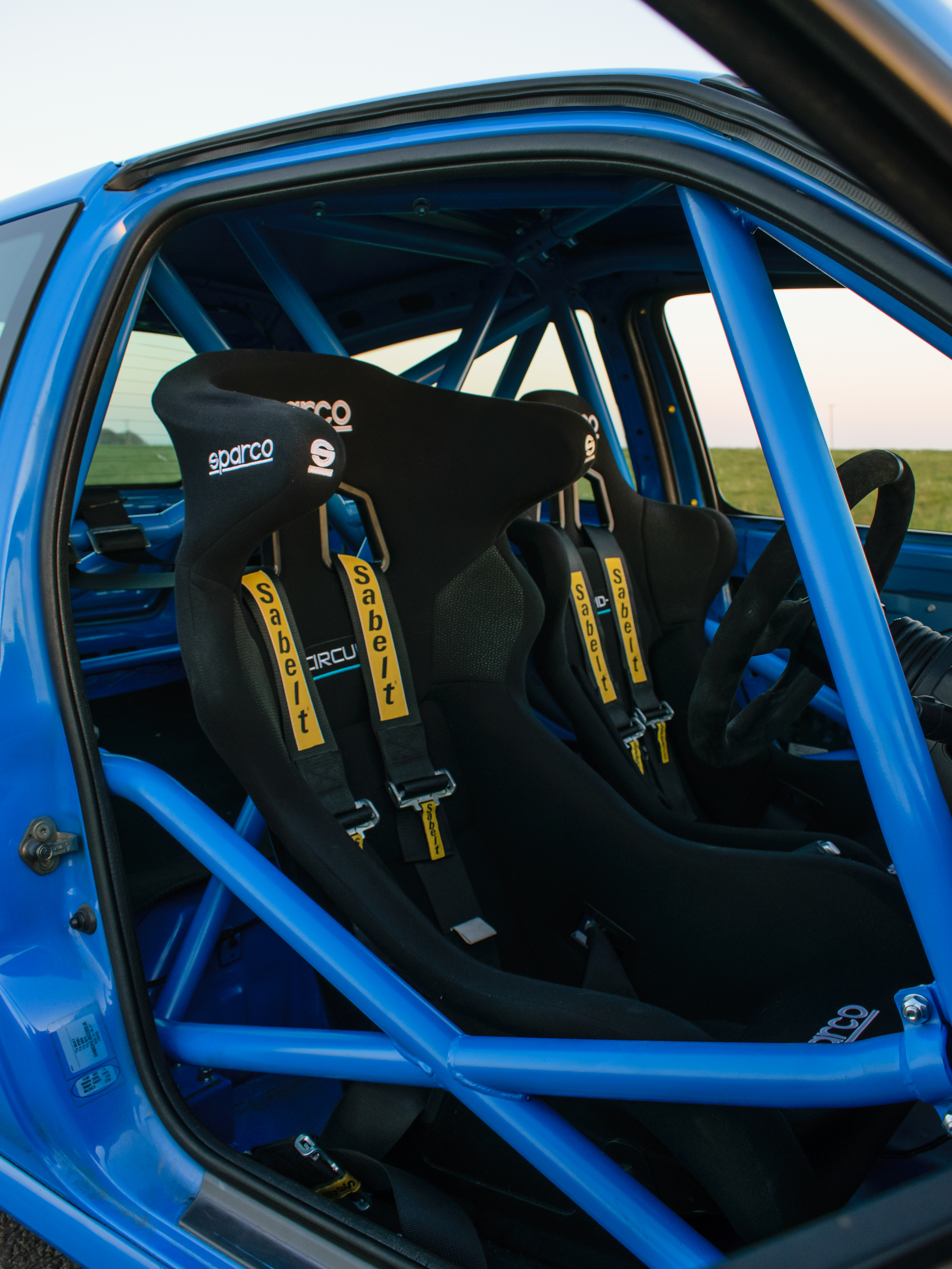

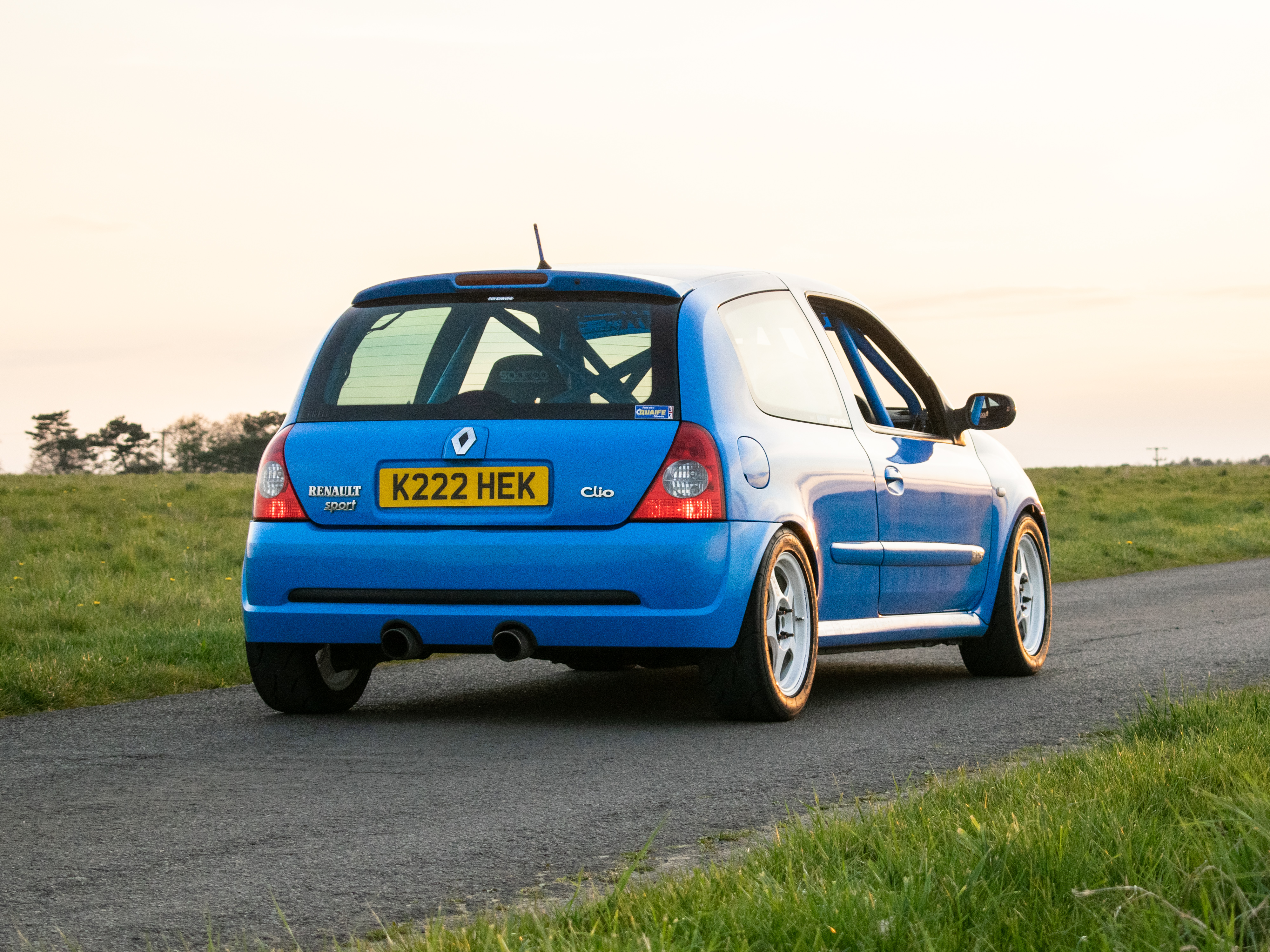

I cannot stress how happy I am with the car now. My friends have put a lot of hours in recently to help me get it to this stage and I'm very grateful.
Very close to being complete I think...
Simple things like wrapping the harnesses up make such a difference.
The above might be my favourite angle.
I would love to say that I meant to get the sparco logo in the rear view mirror here, but it was really only a happy accident! Also do I now get scene points for putting the steering wheel on the dash? Basically a show car rather than a track car.
Much more professional looking and complete with the passenger seat and harness fitted back in.
You also might be able to tell that I like RB just a little bit!

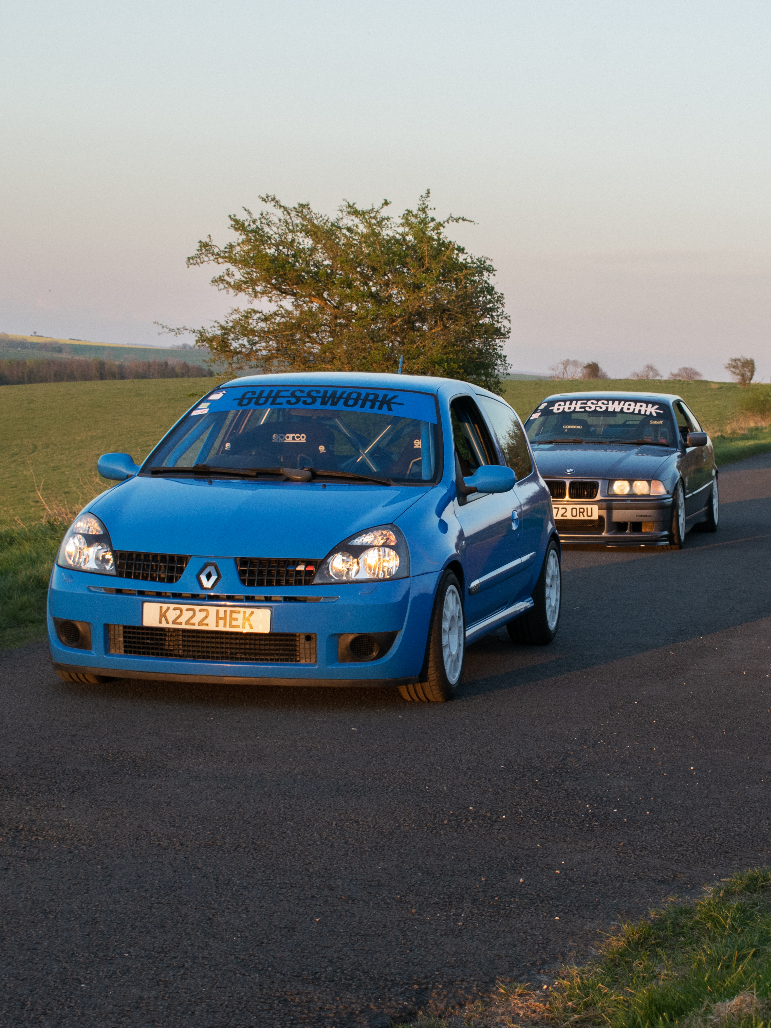

Sunny bank holiday weekends mean some drive outs!

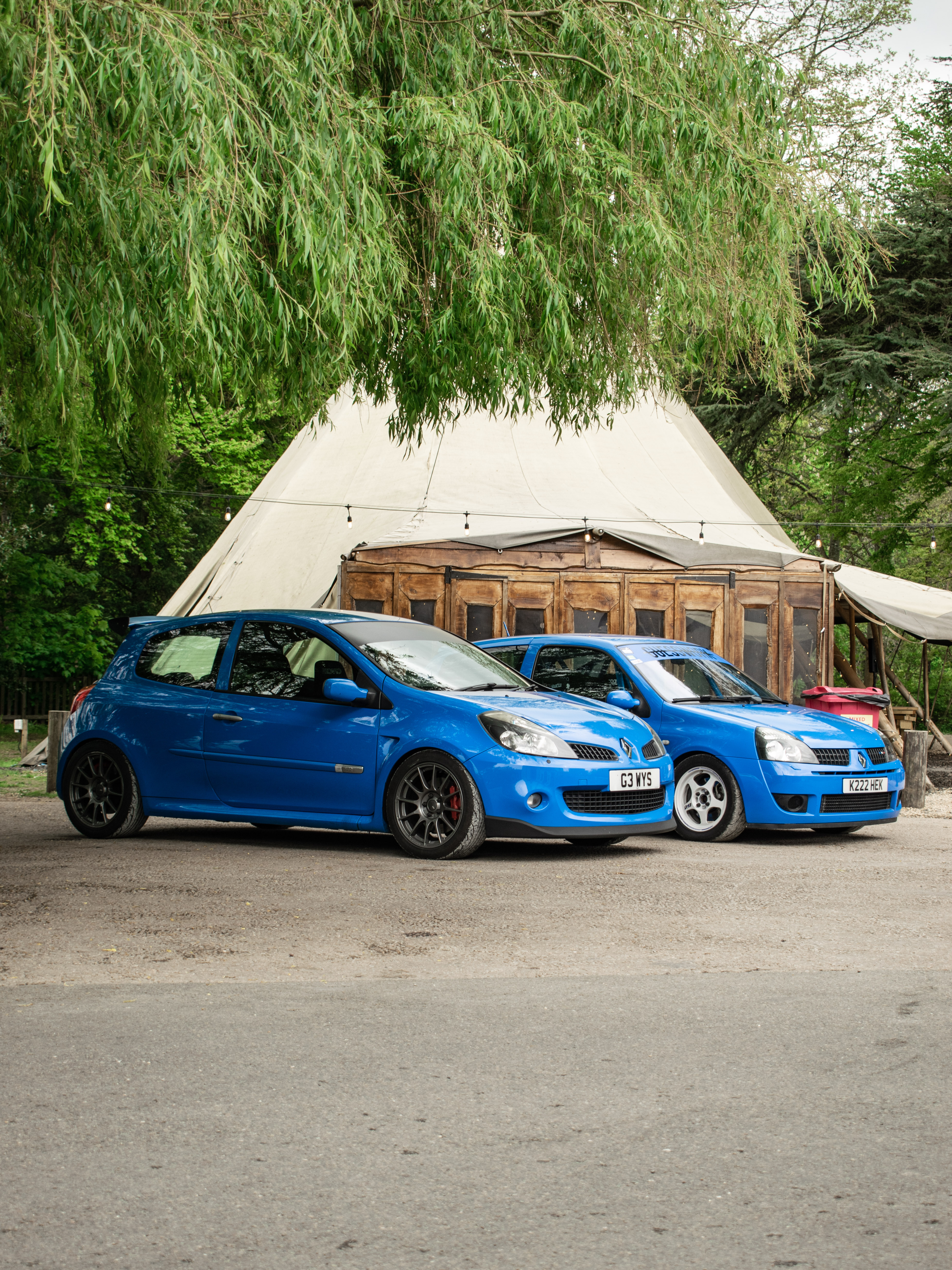

When I took the photos of the cage, my mate with his E36 came along too so got a couple quick pics of ours together.
Golden hour doing bits in making these 2 sheds look half decent.
Then someone in the Guesswork chat suggested going to Podium Place in Newbury. I'd heard of it, but not really looked into it before. I expected a "Caffeine and Machine" sort of vibe but it was really just a small dealership with like 20 odd spaces - but we seemed to be the only ones there! An F430 scud did turn up which was pretty impressive though!
The squad looking fresh! 197 and S2000 are new additions to the group and I'm very much looking forward to seeing how mine compares to the MK3. Should be able to get some decent laps in together this year and it wont matter if we end up rubbing bumpers!
Really good to go for a drive and make the most of the weather. Definitely going to be making the most of the sunshine before it hides away again.

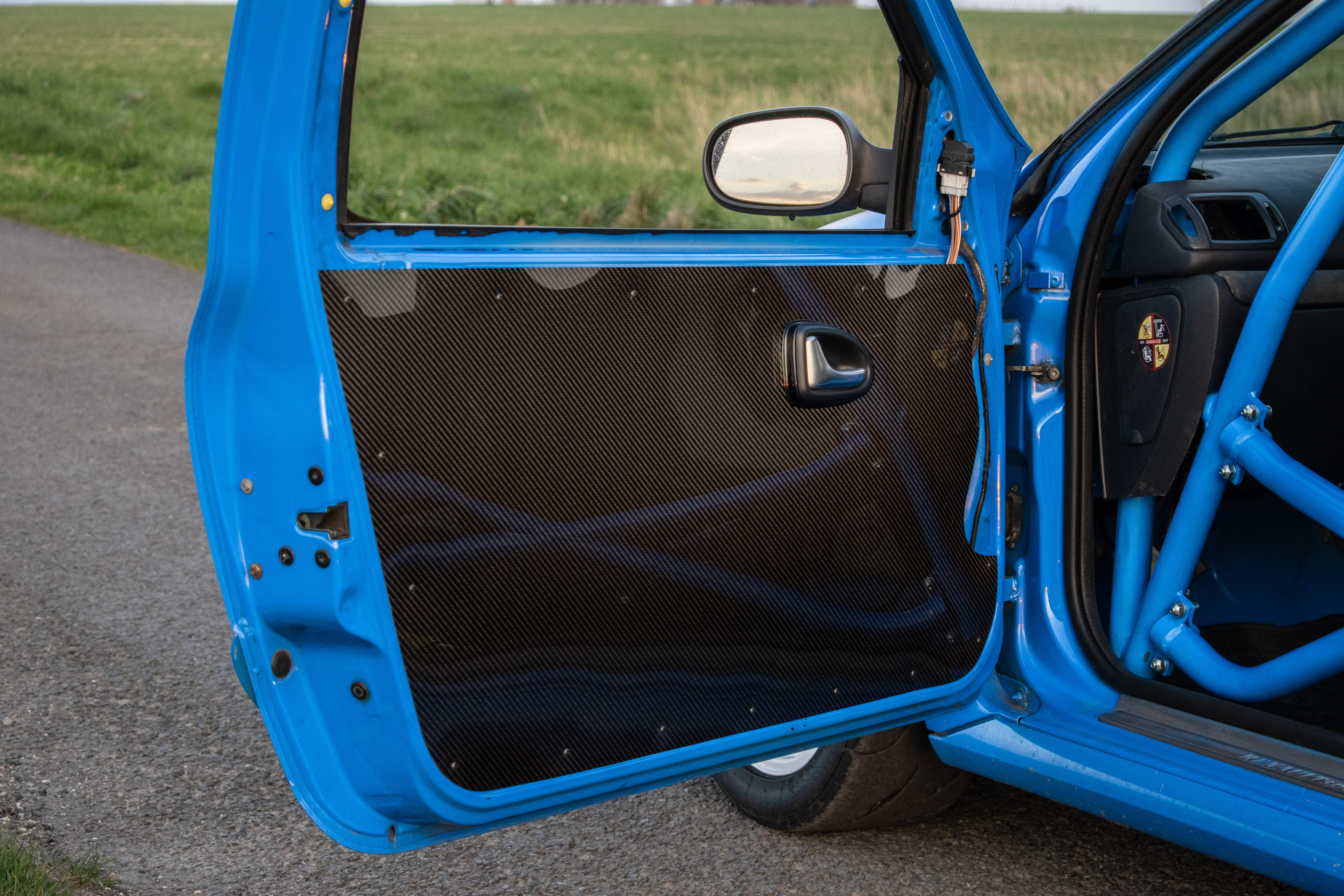

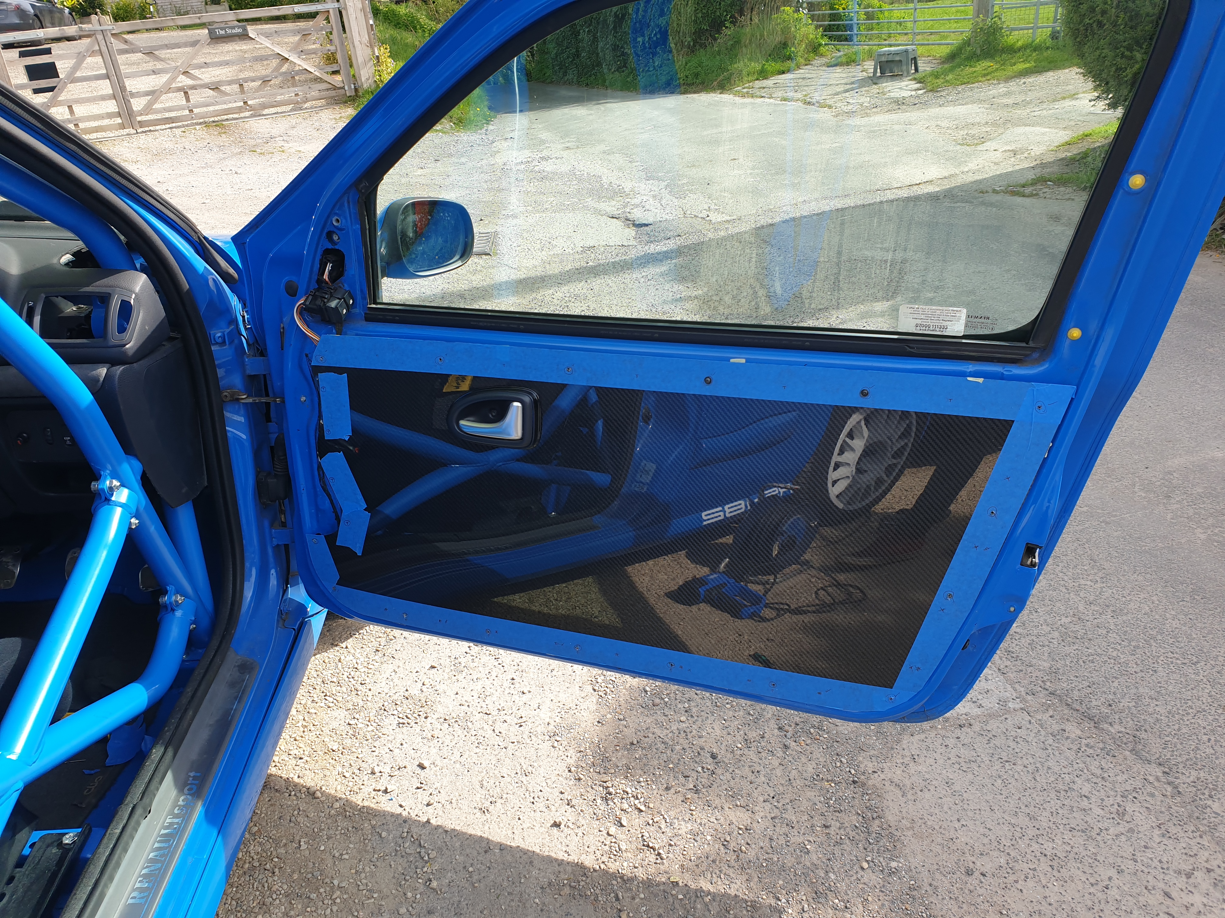

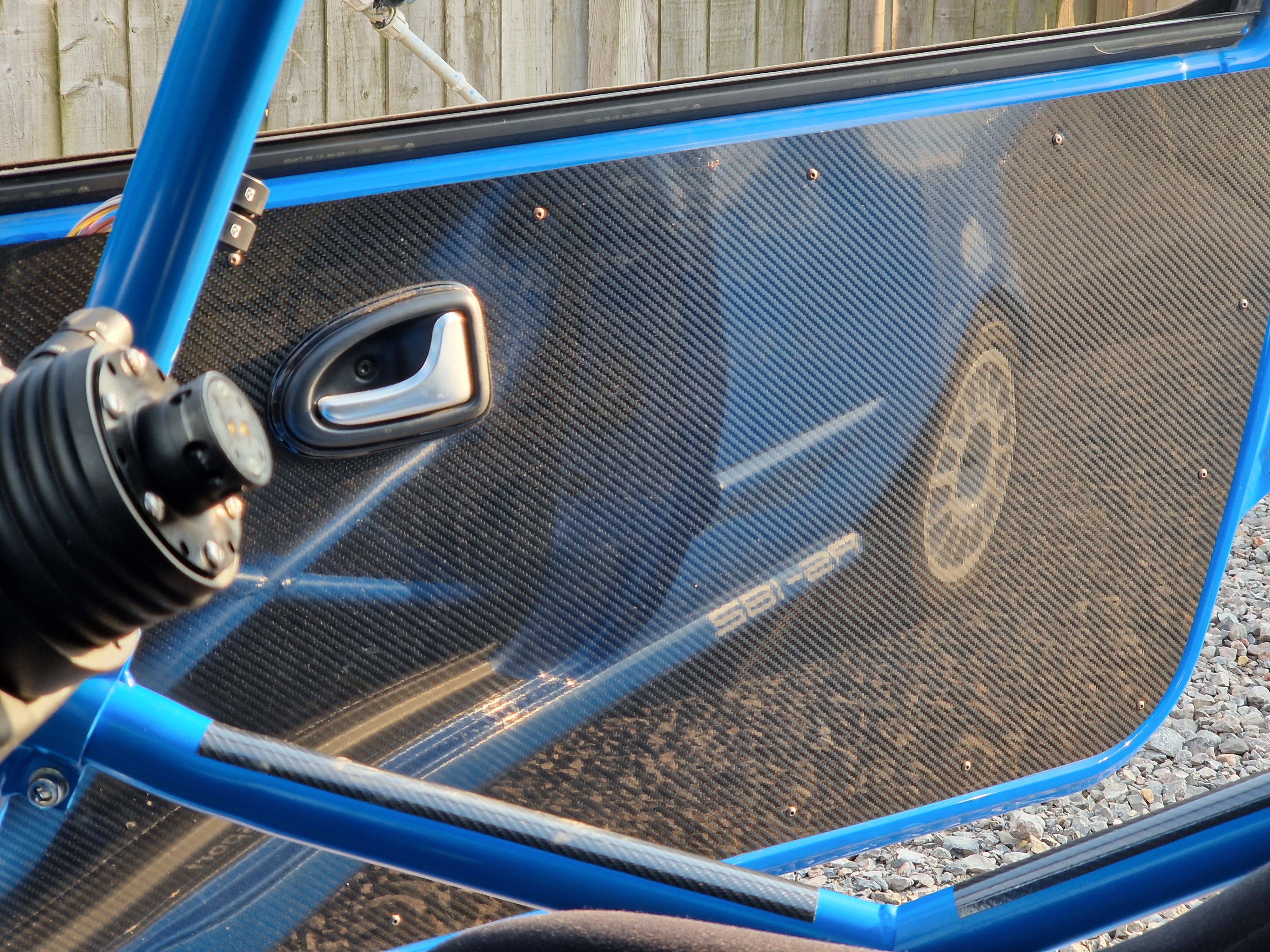

Doorcards were first on the agenda for Sunday.
Taped and marked the holes up on the panels, then stuck them to the doors and drilled through.
I'd bought black M4 hex head bolts and plastic rivets to fit them to the doors.

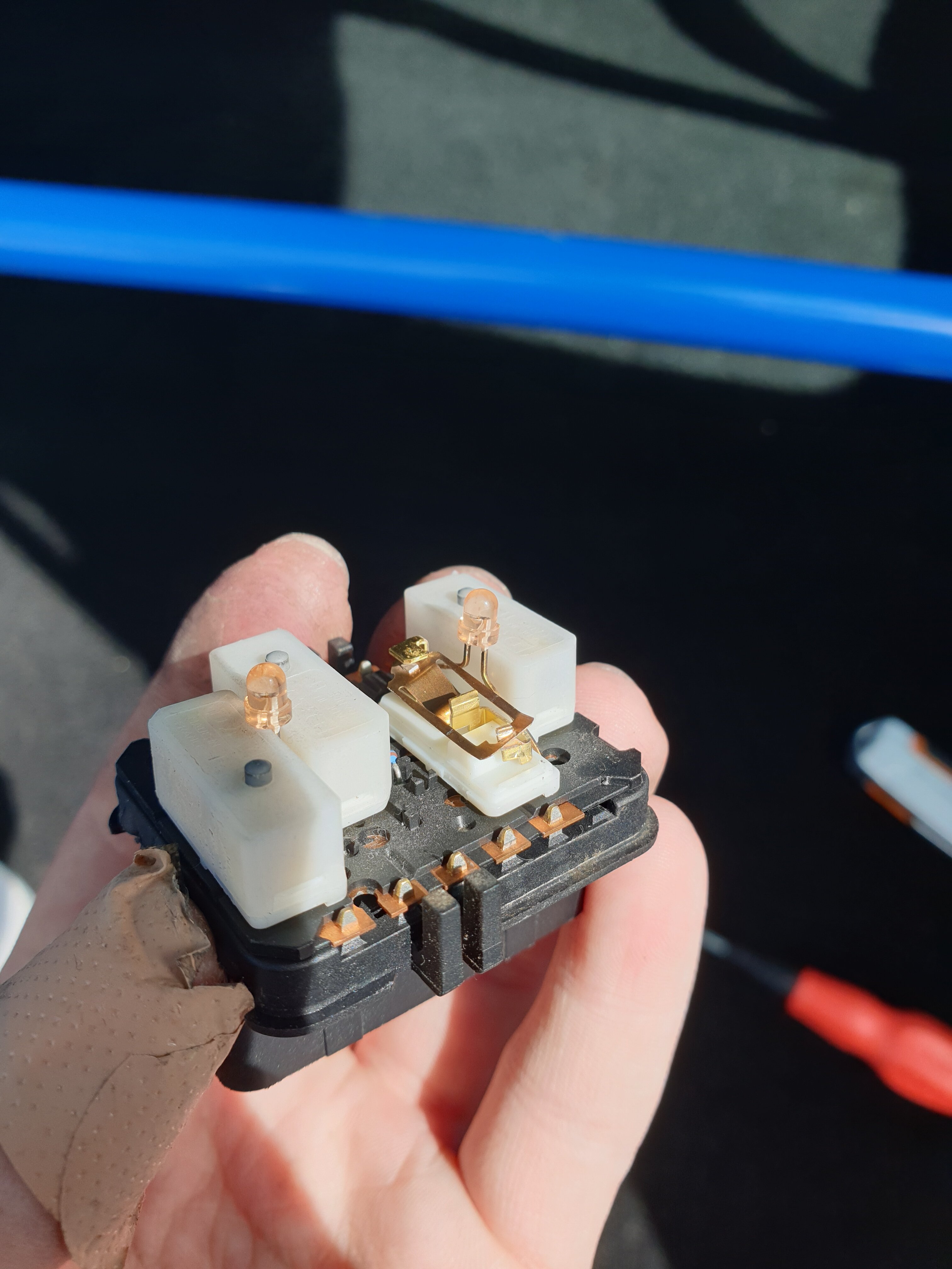

Unfortunately though, I screwed up and slammed the drivers window switch in the doorsill fitting the doorcard and broke it. The passenger window was down at the time and wouldn't go back up. New switch ordered...
Really pleased with the look of the doorcards. I haven't cut into them for the doorpulls yet and will do this soon, as well as tidying up how the window switches are mounted.
Weave of the PMS shifter and doorcards are a pretty good match!

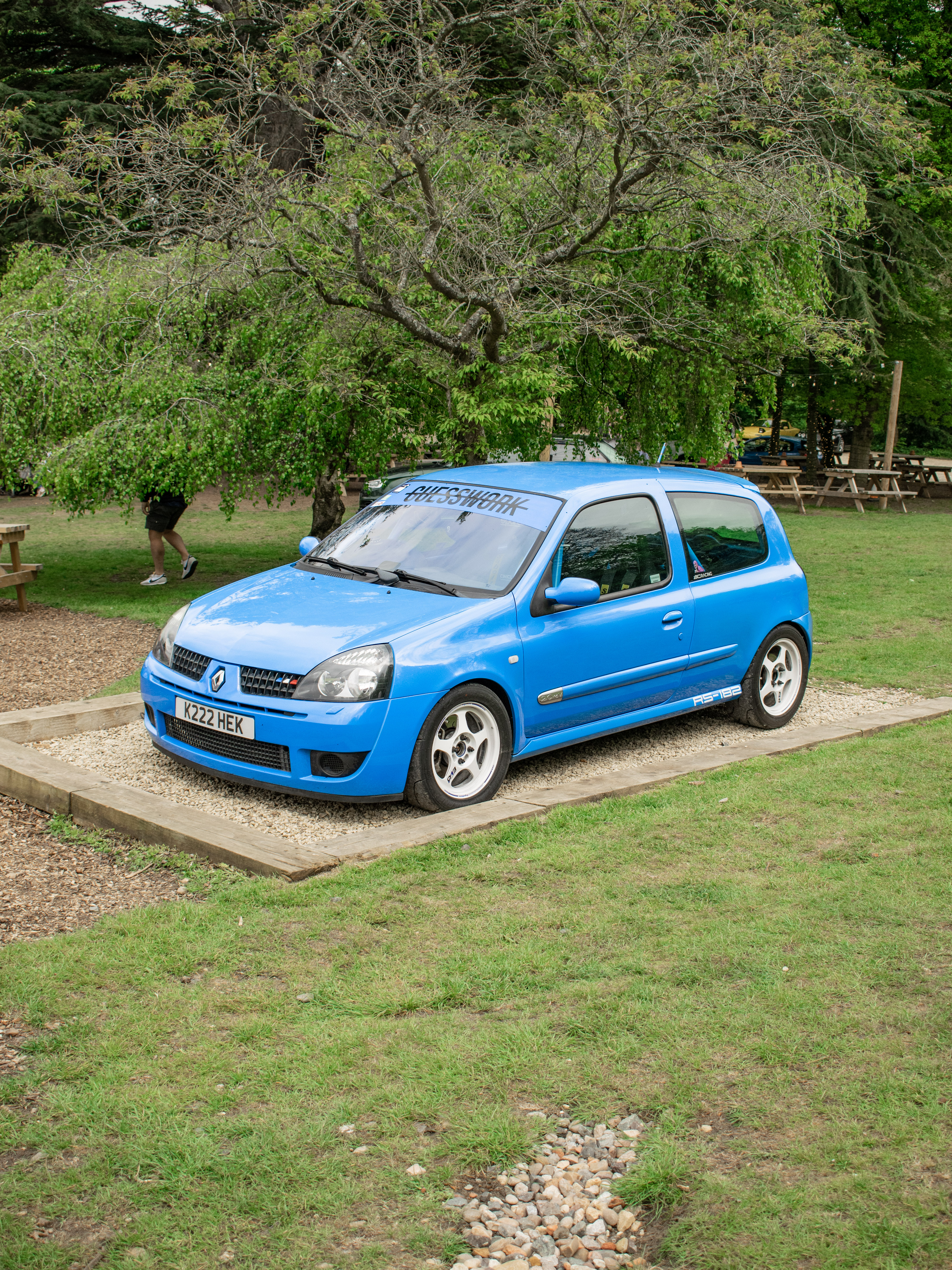

Then, to cheer myself up after breaking the window switch I took a trip to Caffeine and Machine. Seems to get quite a lot of attention now that it's got the cage inside!
I only took the above image but @24sevenphotpgraphy took some luckily!
Bumped into some fellow RS owners as well and had a quick photo. Shame it was at the back though. I just like to think it would be reverse quali order ;)

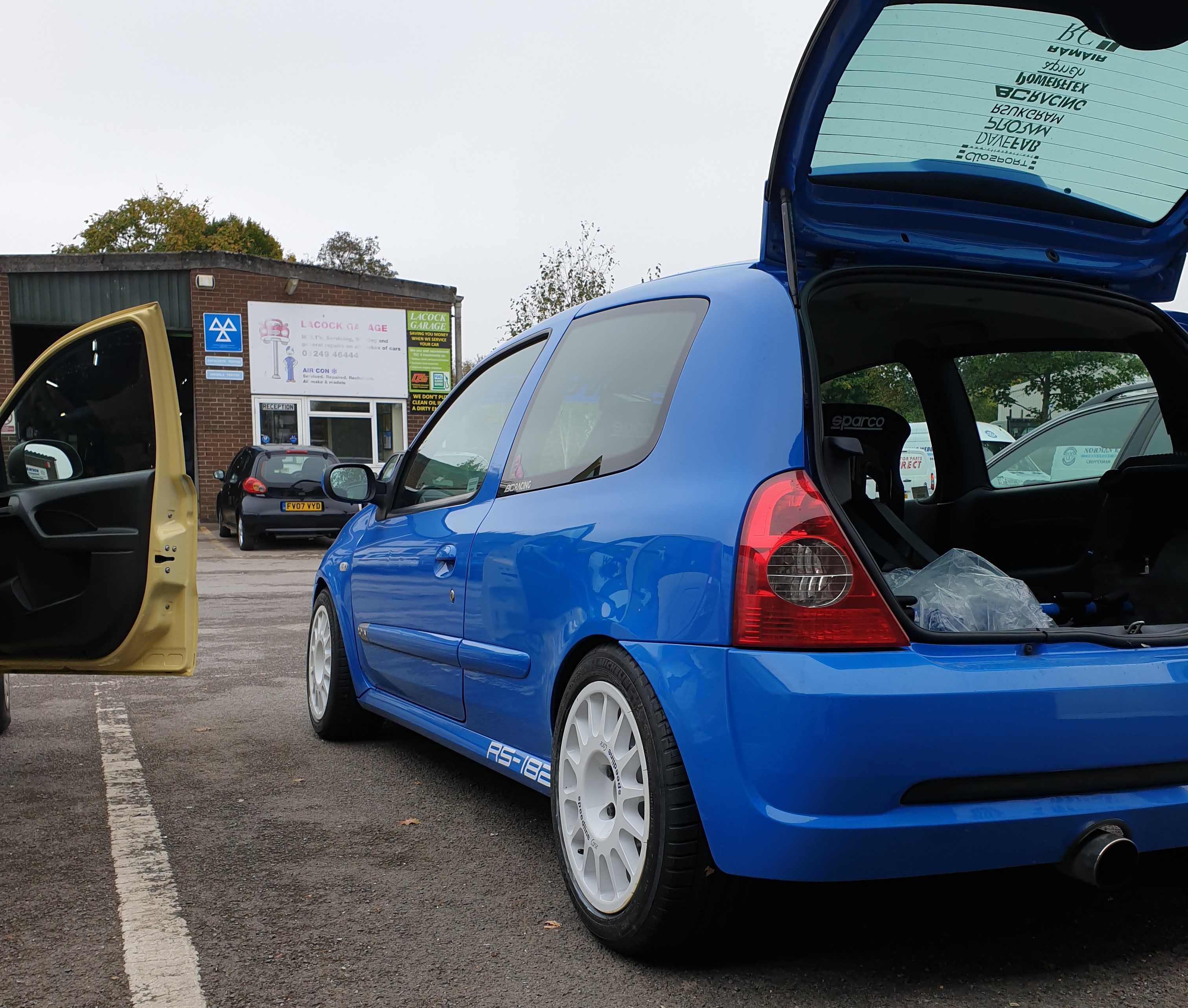

Next up was trying to fix the window switch. The Renault master assembly that I had bought to fit to the doorcards had a switch that looked identical so I tried that on the door connector but still didn't work unfortunately. Then took a short trip to Chippenham to grab a 197 window switch that one of my friends had. I thought I had seen 197 switches used on the track car doorcards before, but I tried this one and it still didn't work. Another mate's garage is only round the corner so I popped round there where it turned out that the fuse had blown for the passenger side window so we replaced that, and then bridged the broken 182 switch with a screwdriver to get the window up.

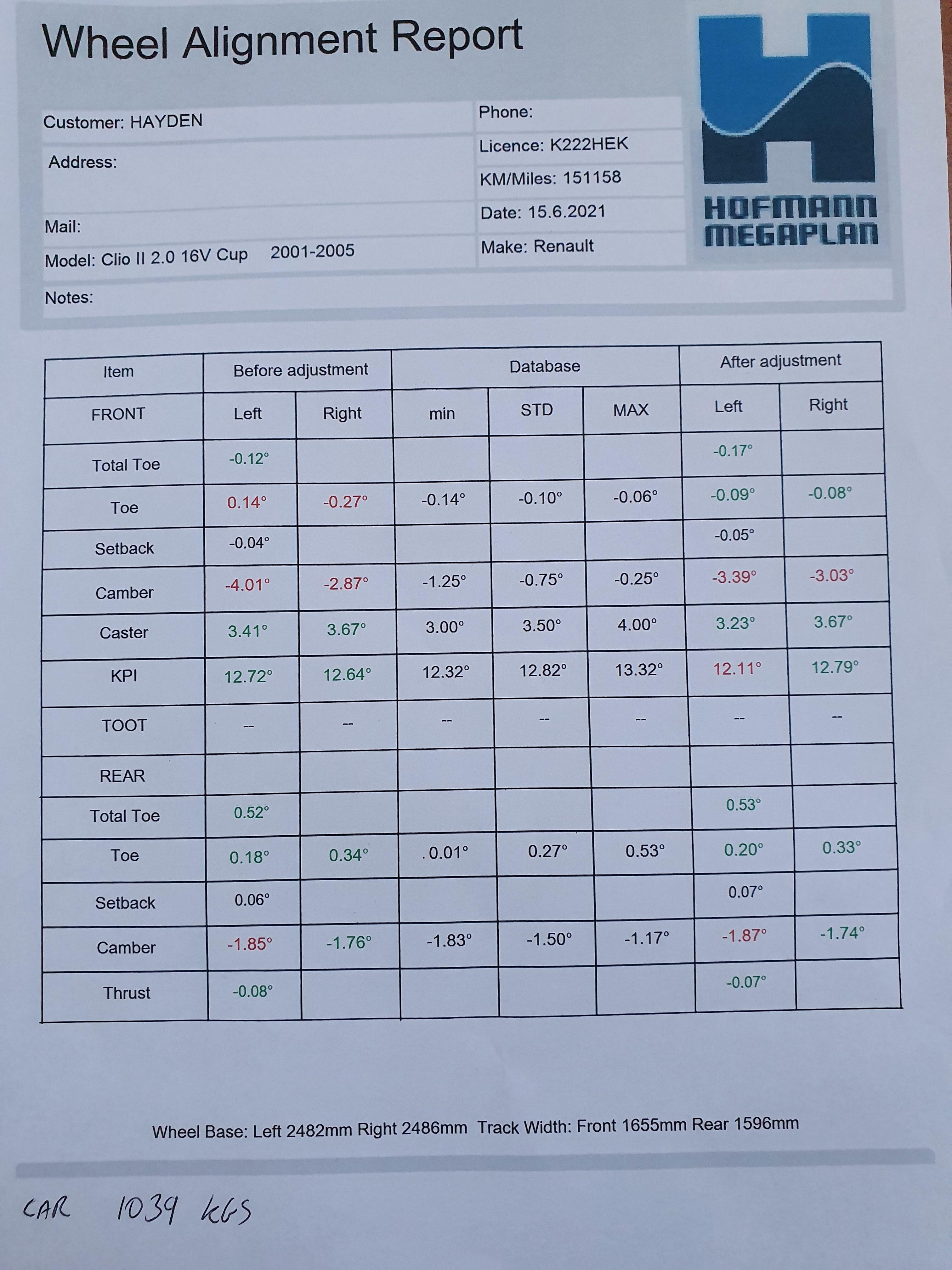

I then messaged Josh at Harvey's Auto-Tech in Westbury (who did my alignment and weighed the car last June) to see if he could weigh the car now it has the cage fitted. He said to bring it over later that day so that was handy! Below is the image of the alignment and weight last summer.

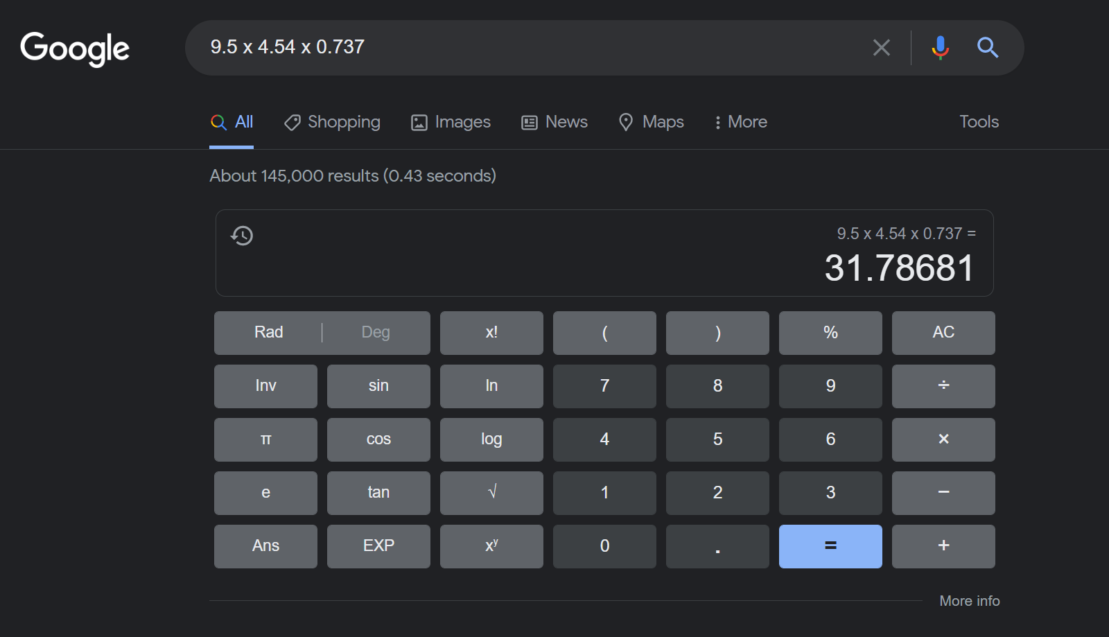

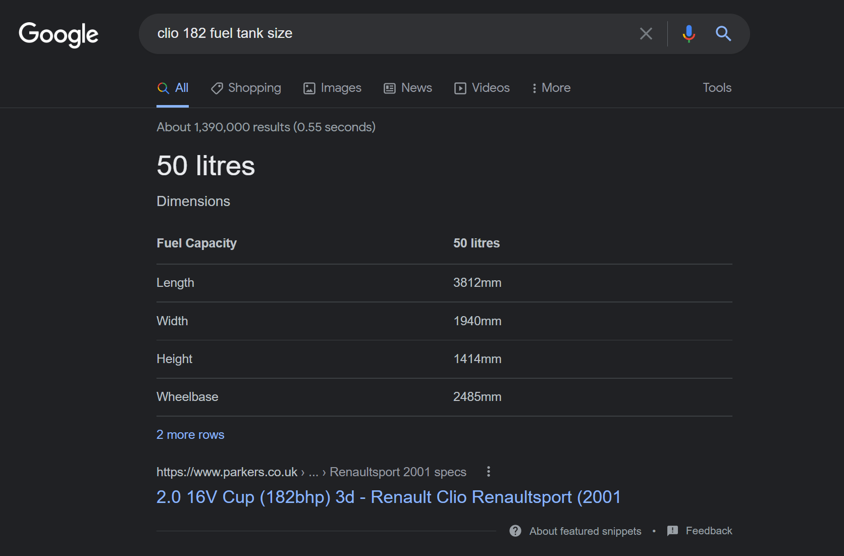

Tbh I didn't think 1039kg was bad and from memory, this was with 1/3 or a 1/4 of a tank of fuel so more like 1030kg dry. A decent saving over standard! The spec at the time compared to a standard car was no AC, EPAS rather than HPAS, 1 fibreglass bucket seat and steel mounts, 1 steel bucket seat and steel mounts, no seatbelts, harness bar, and rear bench removed. The car was also sat on the BC's and 2118s with AD08RS tyres. All the interior trim was still in at this point.
Things have changed a bit since last June. Main differences are that both seats are now fibreglass (all mounts are still steel though), the sound deadening has been removed, all the carpet and trims have been removed bar the dash (which has been significantly cut to fit round the cage), no speakers or radio, decat, the cage obviously and I put it on the regas to instantly get a saving.
I had initially hoped for 1000kg with a cage and no fuel, but it's about the heaviest spec cage you could get so I thought this would be unrealistic. I then settled for a goal of 1050kg with no fuel.
Well, what a pleasant surprise this was! I had filled up with fuel in the morning and according to the trip computer, had used 1.5 gallons for the 52 miles I'd driven since filling it up.
Therefore, 1039kg with the above fuel amount works out at just over 1007kg dry. Very pleased with this as according to Tom at Fulcrum Motorsport, he reckons the cage is between 60 and 70kg. Also, I'm very happy with the 50% cross weight considering the car hasn't been corner weighted.
Forgot how good it looks on the regas too! Haven't run them since the trackday last October but will start to now the weather is getting better I think, just got to be careful to not smash any potholes!

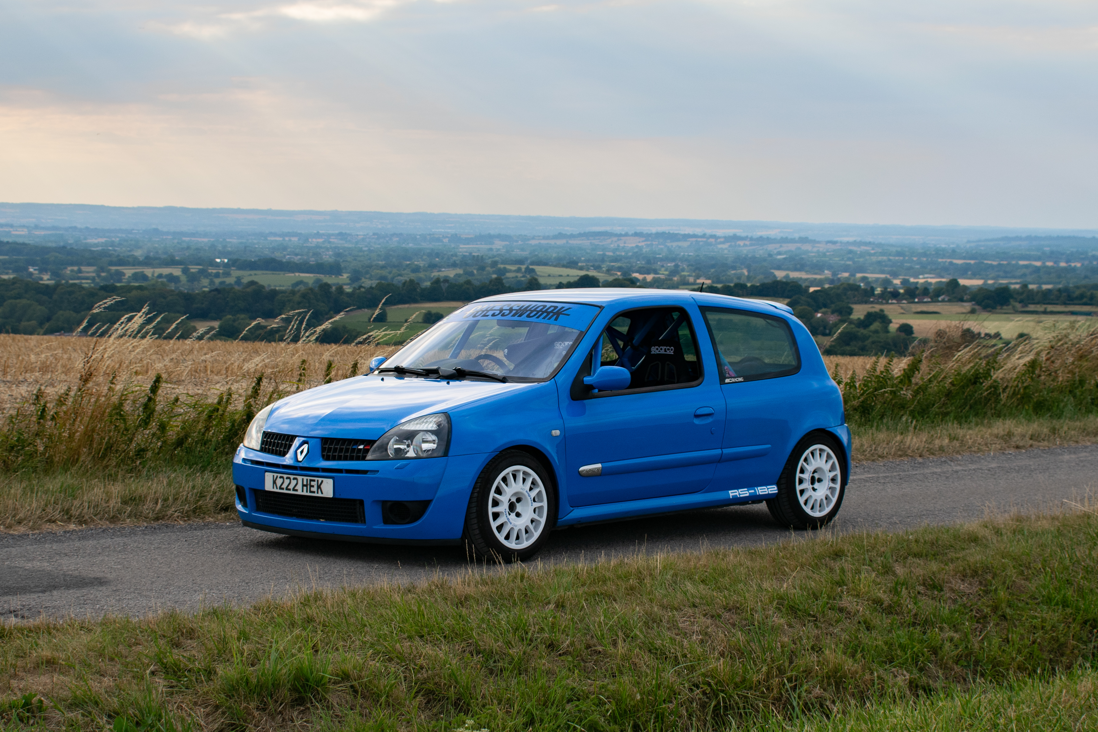

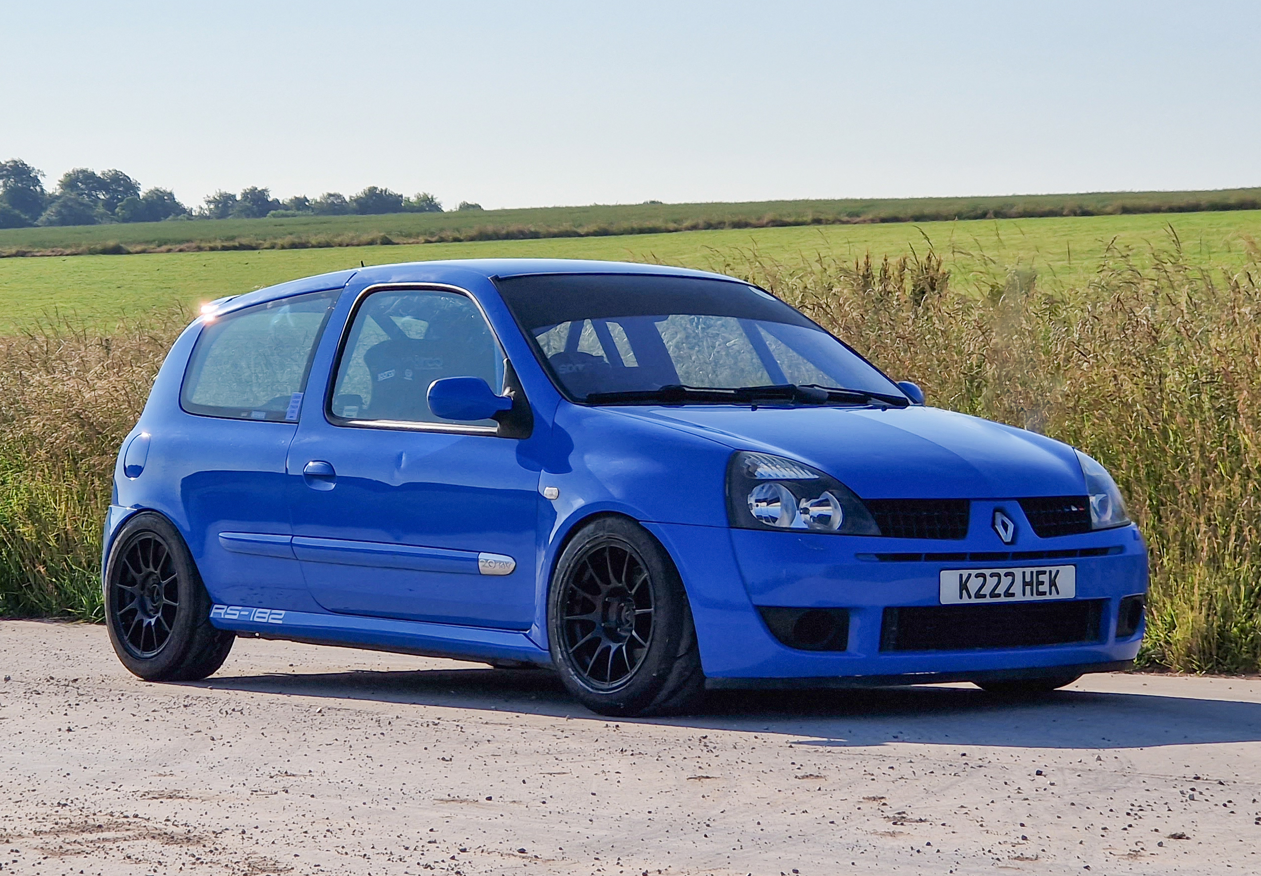

Seeing as I hadn't run the Regas since October I thought I better get some updated photos of them on the car.
I didn't have much time however so just stayed close to home for some snaps. Next time I run them I'll add an extra 5mm shim to the rear to just help fill the arch a bit better.

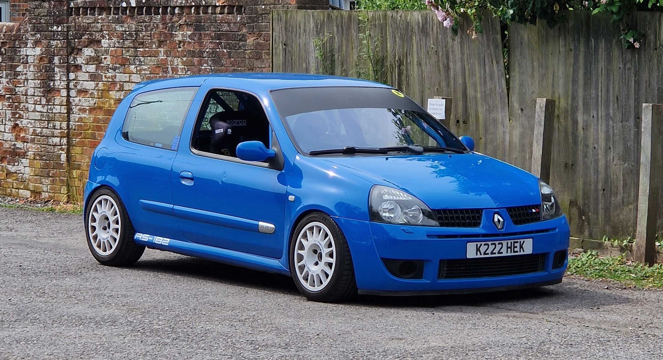

I'm so happy with the car now. Just a bit of tidying here and there and then its just onto maintenance to keep it going strong.

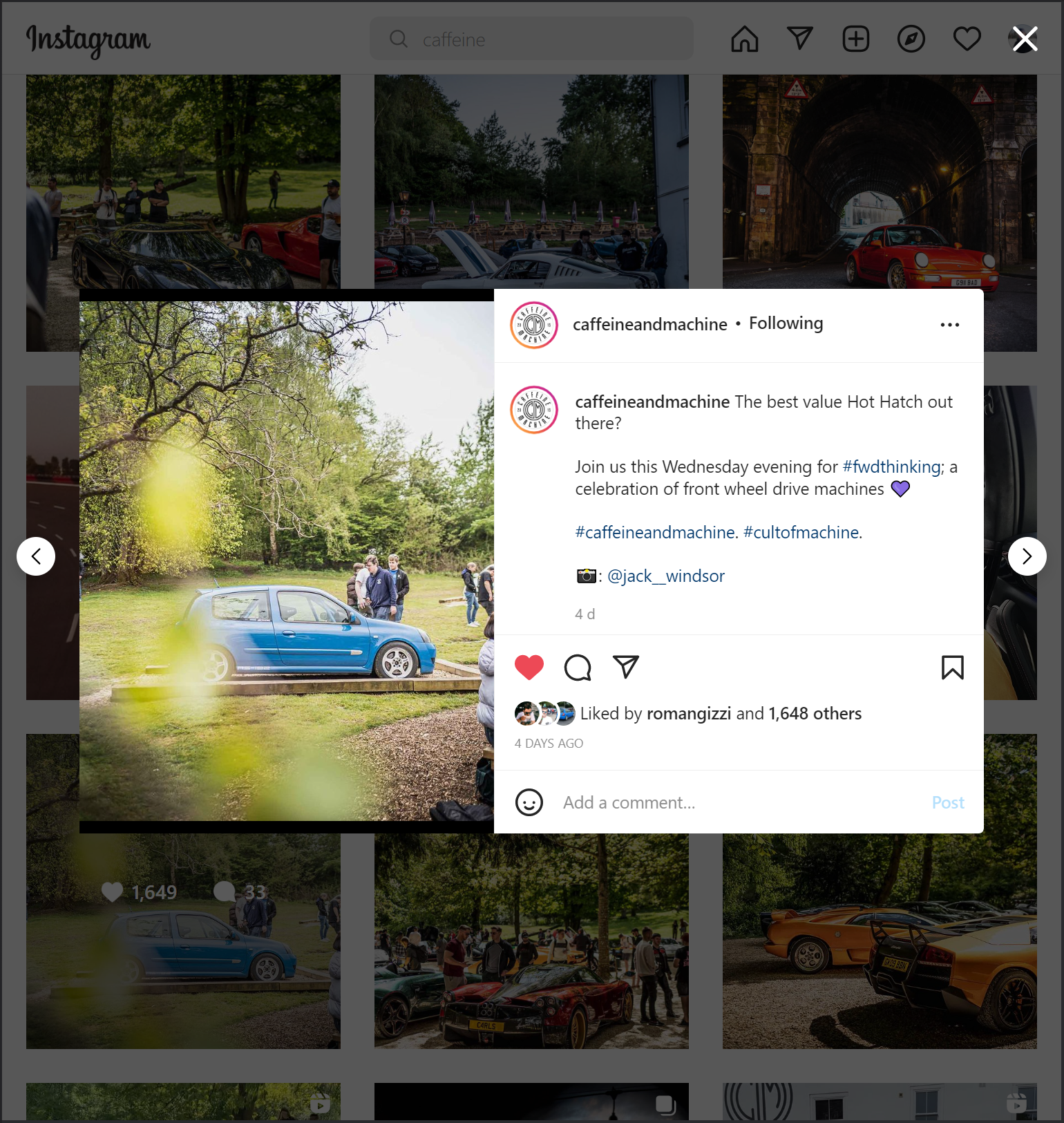

Got bored on the May bank holiday Monday so went back to Caffeine and Machine, this time accompanied by my mate and his 197. They even let me park on an empty plinth up on the side - one of the few spots here it hasn't been!
Even got it's own feature on the C&M IG. You love to see it!
I certainly think so in answer to their question! Not that mine has been particularly good value for money though, but nevertheless its famous now (or so I like to think).

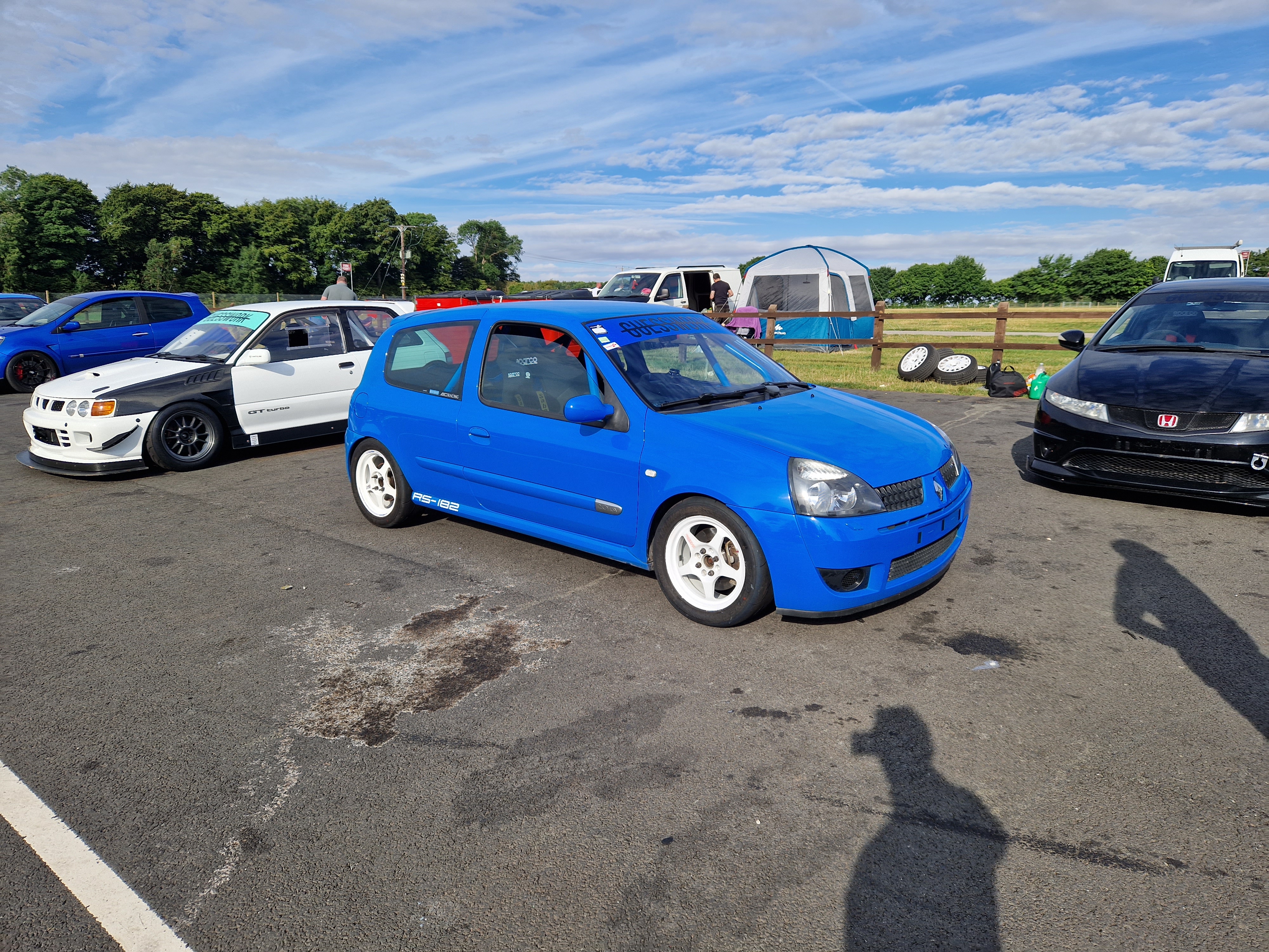

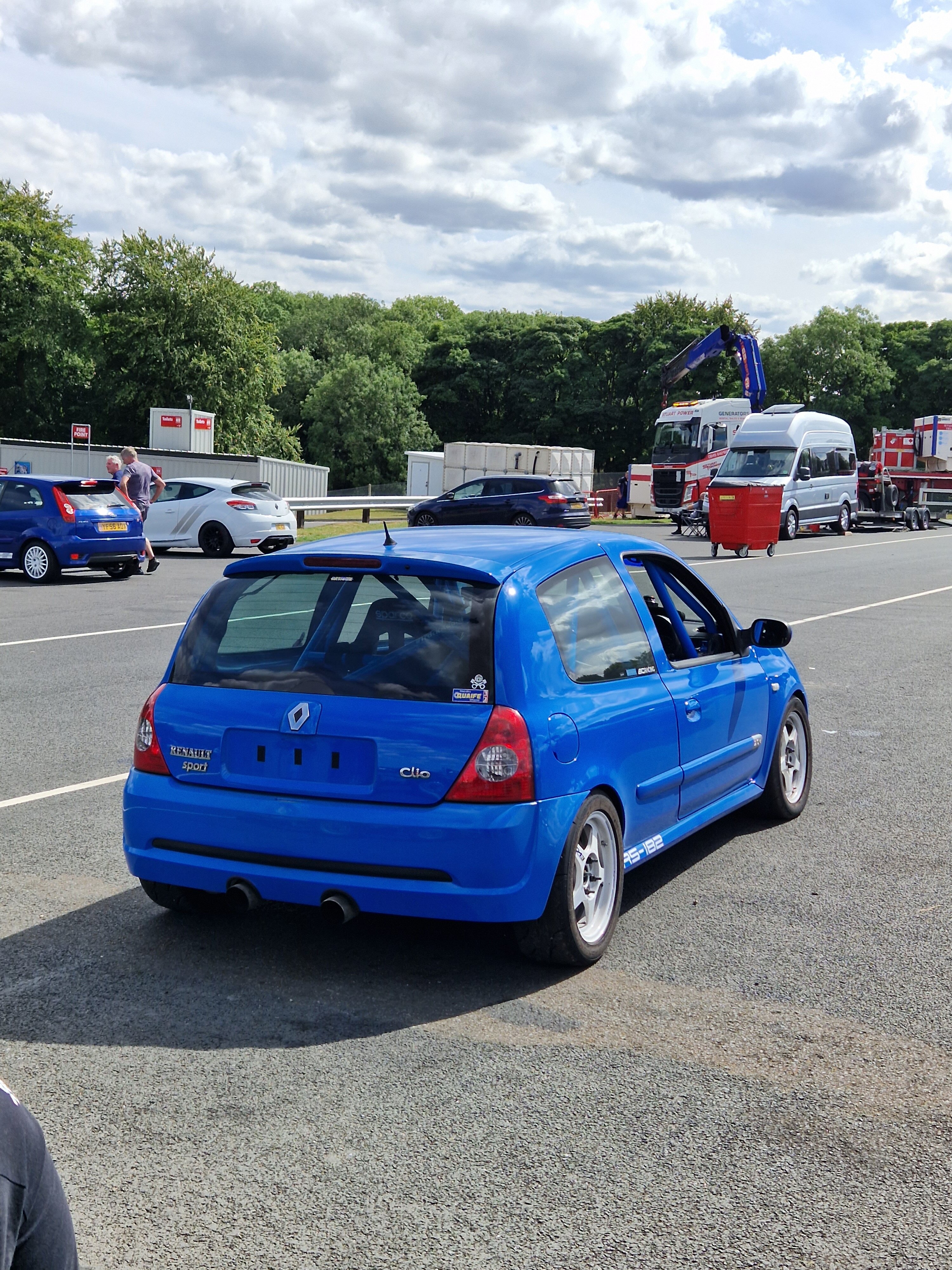

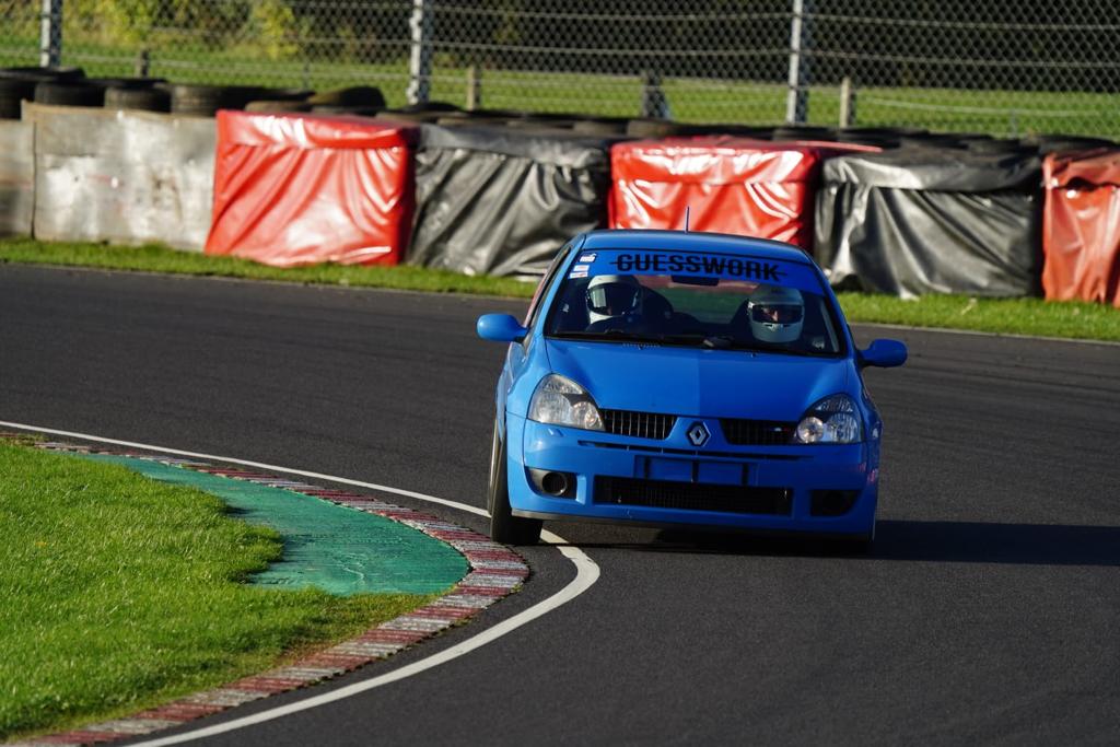

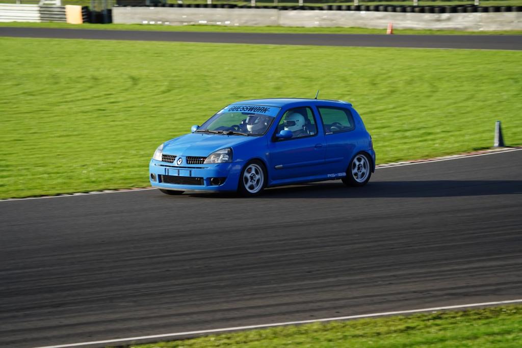

Trackday time once again with the GUESSWORK boys.

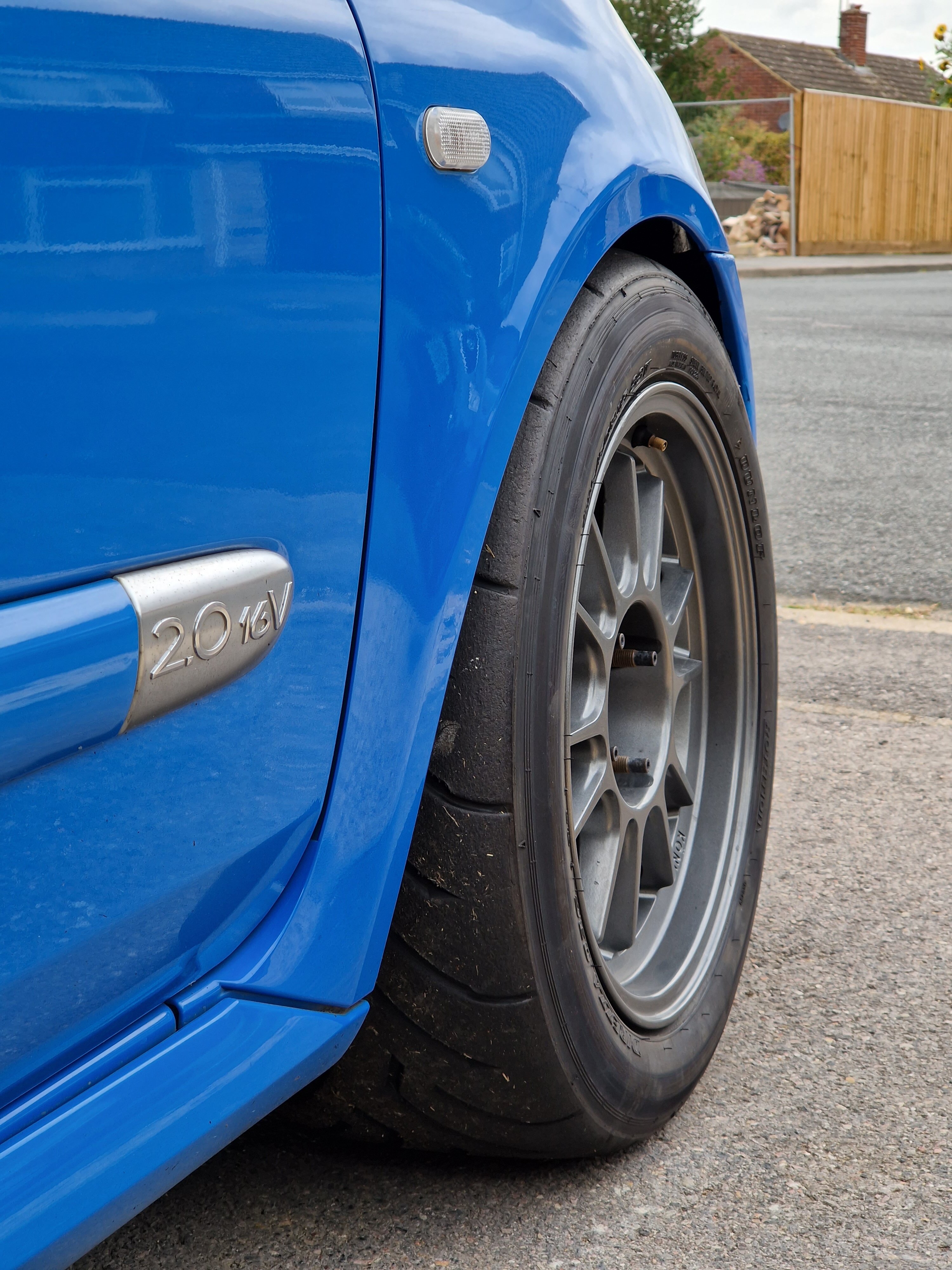

Turn in on the AR-1s was so much better than the garbage AD08RS's that I was running last year!

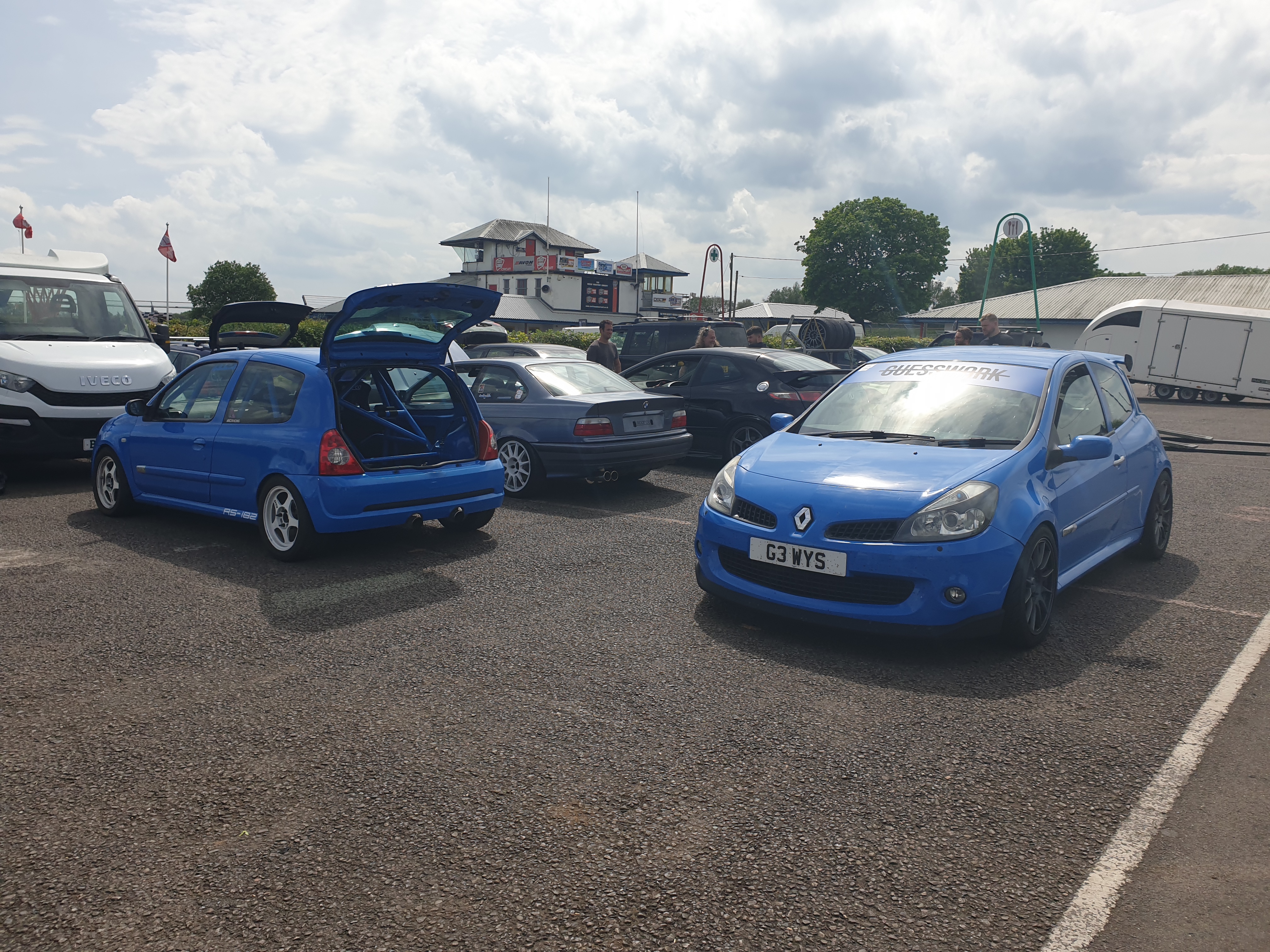

Squad goals. We had my 182 and mates 197, FN2 Type R, E36 325i and S2000. All lapping within similar times to each other throughout the day.
Wish it looked this low all the time!

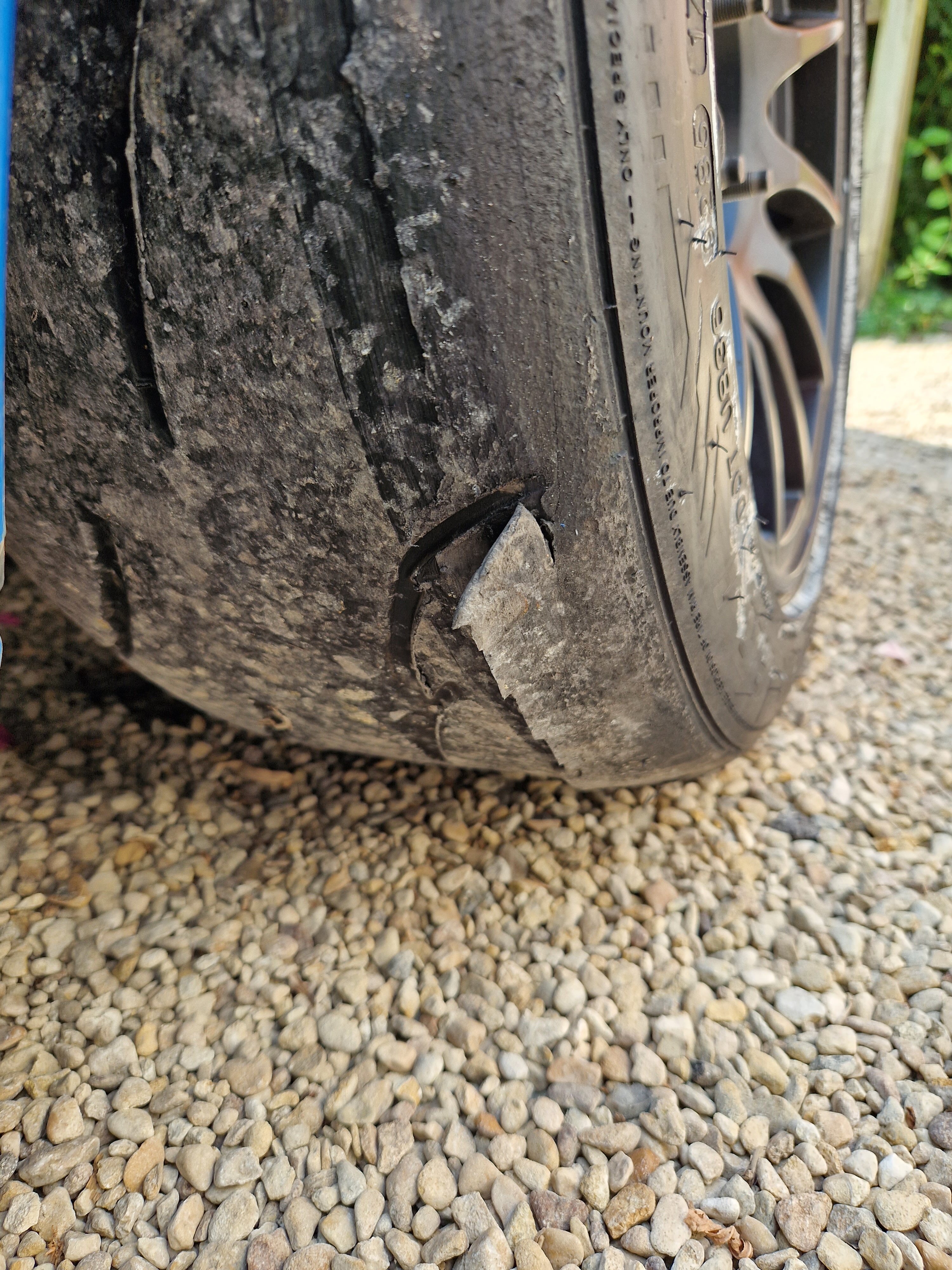

I was carrying extra corner speed over the previous trackdays and so the brakes were starting to fade after 5/6 laps. Rears are standard and fronts are just DS2500 pads so I think an upgrade is needed. I was very impressed with the PBS setup in the 197 so maybe a set of brembos calipers are needed so I can copy the setup.

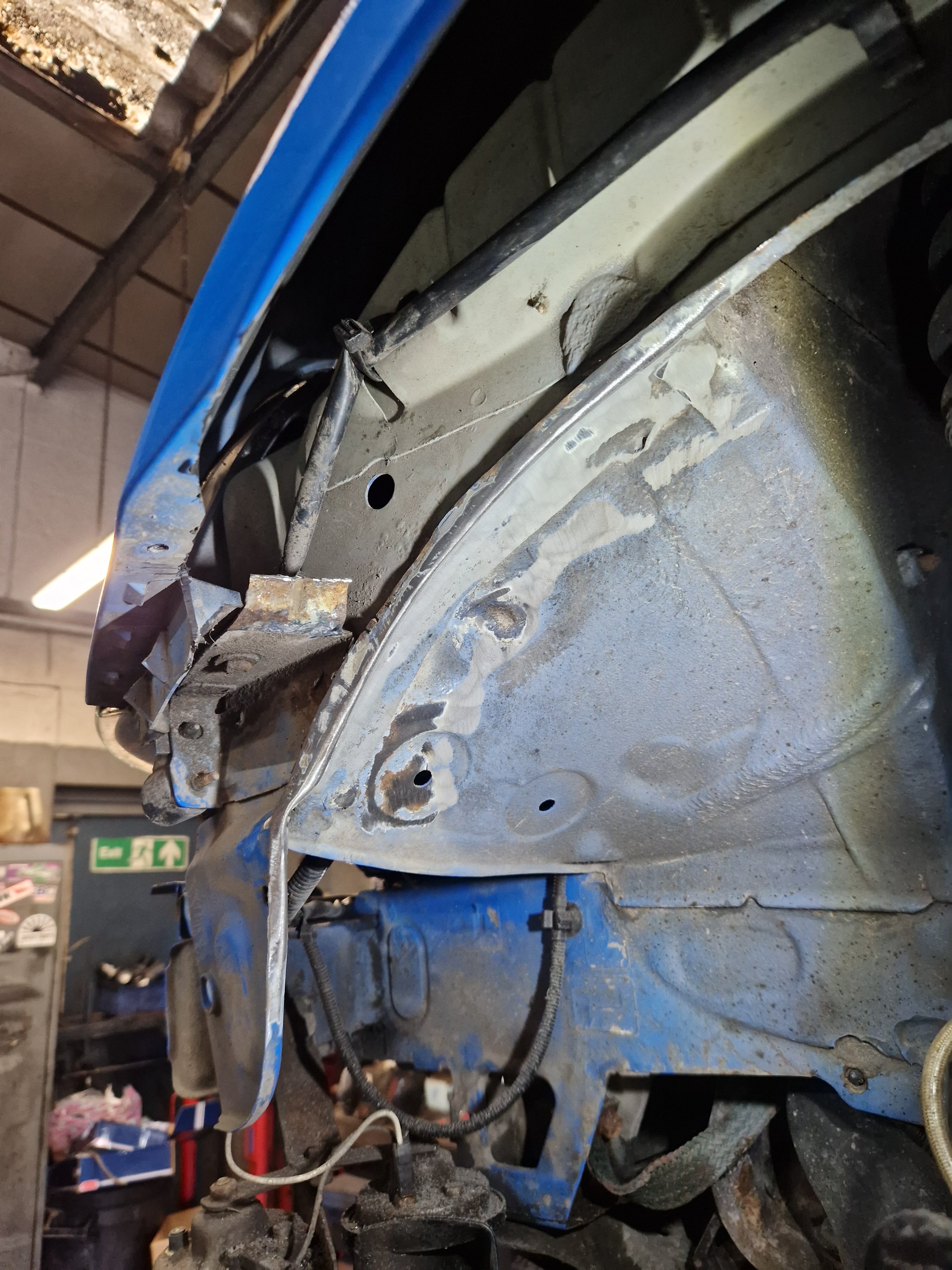

Upon further inspecting though, the inside of the arch has been pulled sort of square by the spreader plates from the harness bar inside. I had heard that some "percussive persuasion" may be needed but with that bar across the arches it isn't happening and so the harness bar will be cut out, and the air hammer will be unboxed for some action when the time comes to fit the coilovers....
The BC parts arrived this week and I have drawn a top mount up that I am currently waiting for a friend to machine. Then hopefully we should be able to get it all fitted!

Some spare time this weekend meant that I finally got round to fitting the rear Carbon-Tec doorcards that had been sat in the shed for 3 months.
Definitely the most difficult 4 holes to drill as some idiot didn't fit them before the cage was installed. They're in nevertheless and I'm really pleased with how they look.
Much nicer than having the ugly metal behind that didn't get painted when I sprayed the car back in Feb. Very pleased with the interior now and just need to fit the pulls to the front doors to complete it.

Made myself have a bit of a clear-out of all the interior parts that I wouldn't be using anymore. I thought about selling it but couldn't be bothered to list it all for sale or be at the mercy of when other people could collect, so I packed up the daily and took it all to James at JMRS. He's a good mate and I'm sure I'll need his expertise and a part soon enough so was happy to drop it all off to him.
Headliners are not the easiest things to transport however!

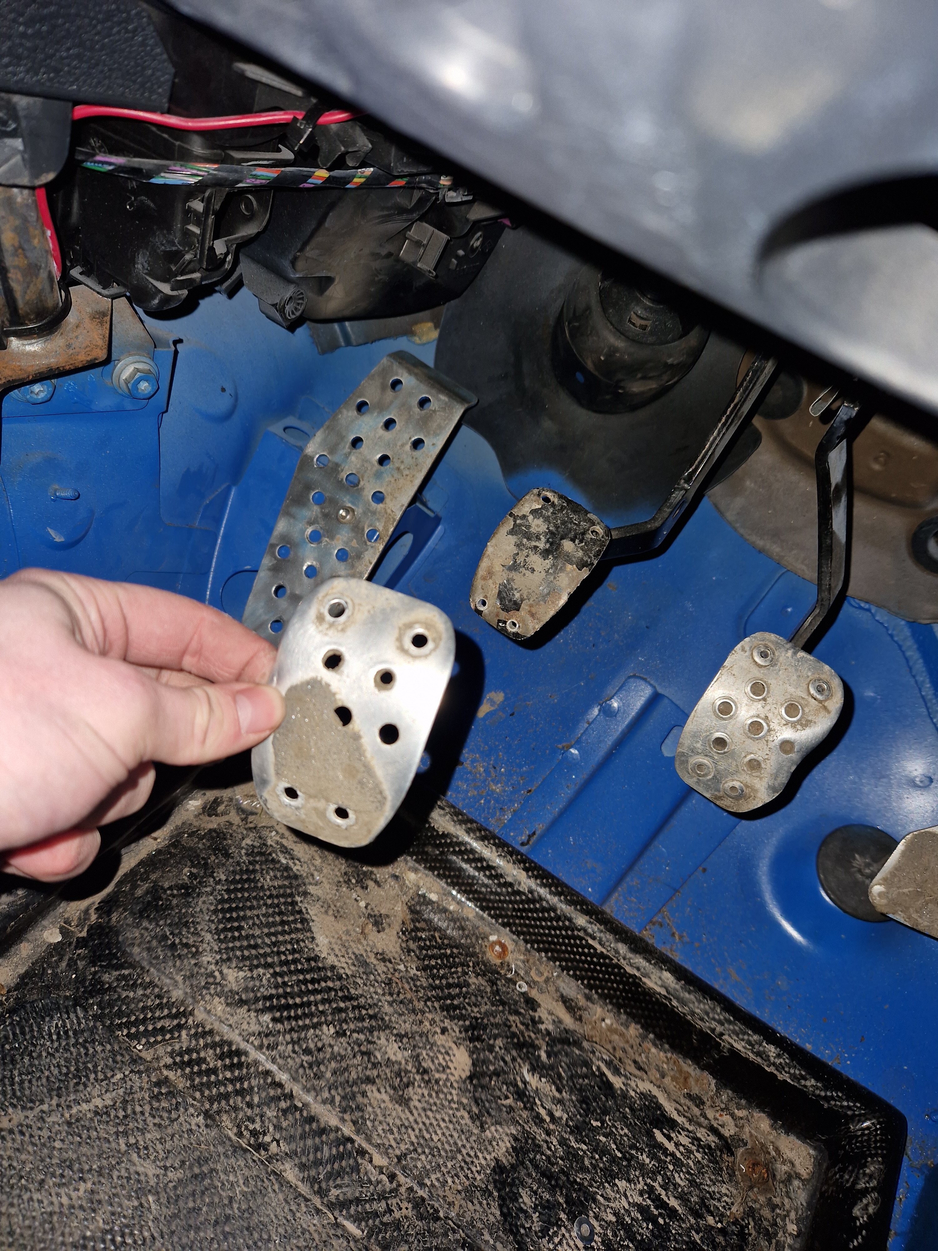

After all the junk was cleared I finally decided to get the footplates fitted. They had been sitting in the shed since February and so it was about time they made their way into the car.
Driver's side was first up...
Then the Passenger side...

Then I went to check the car over for Cadwell and had a nasty shock :(

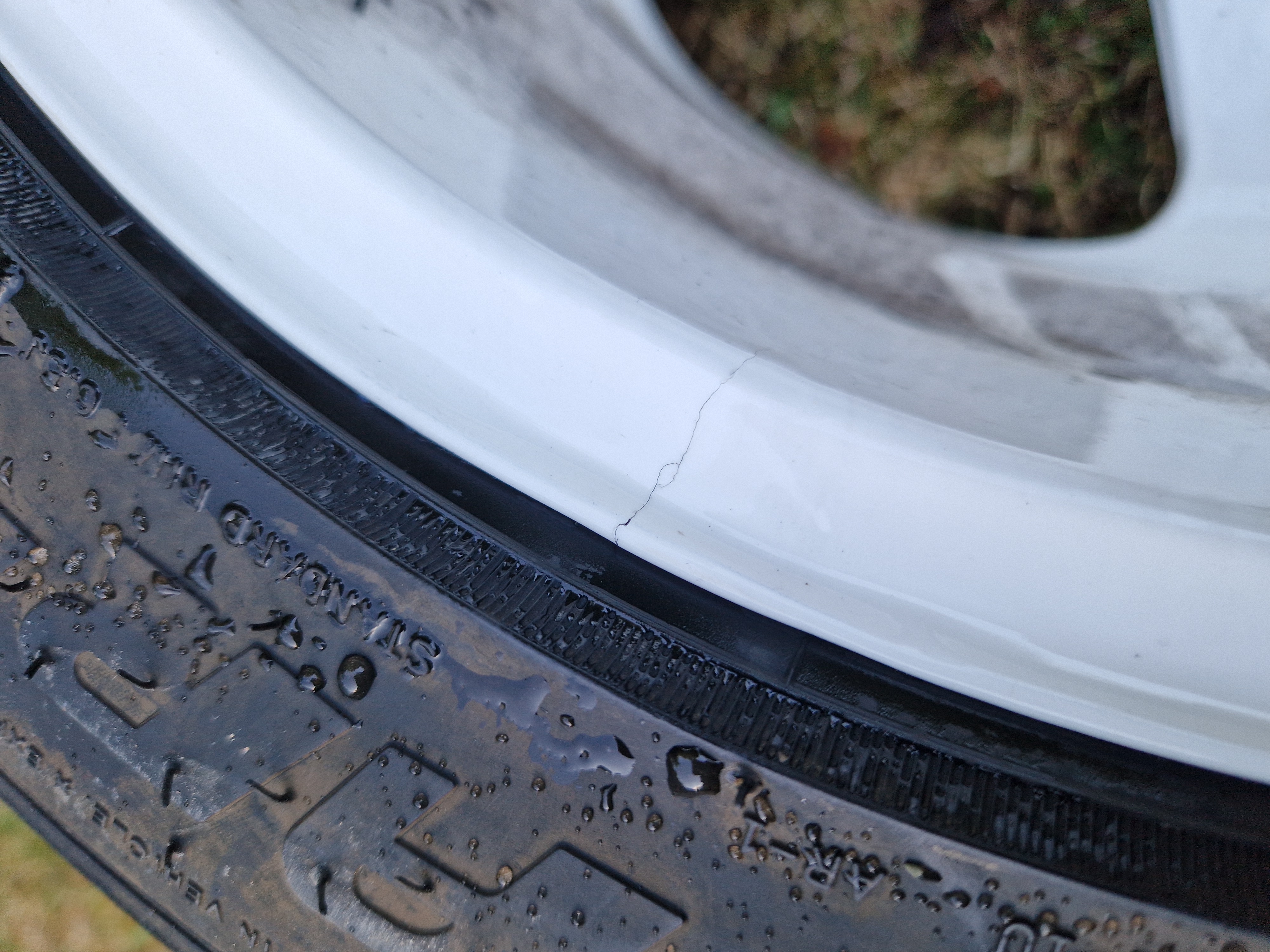

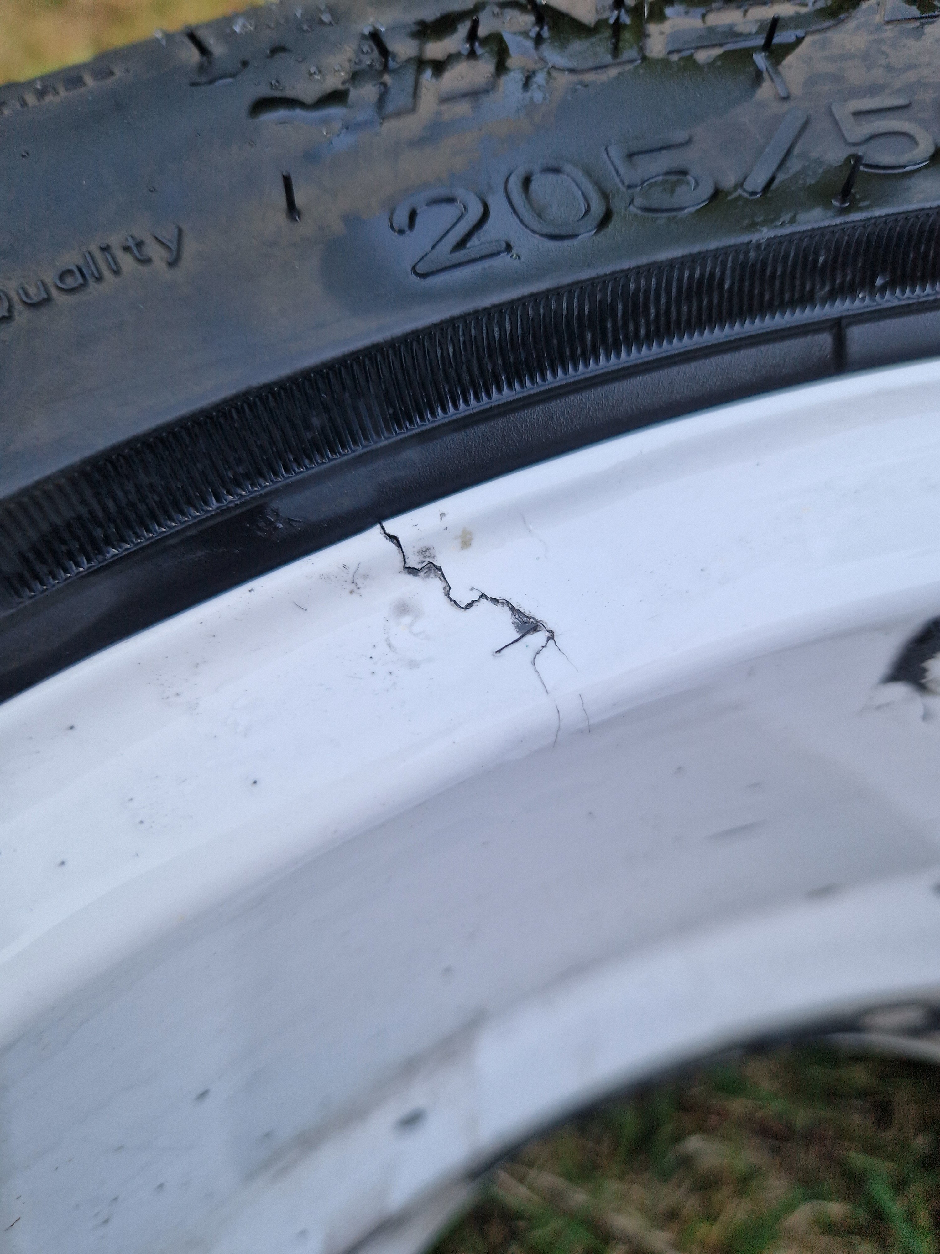

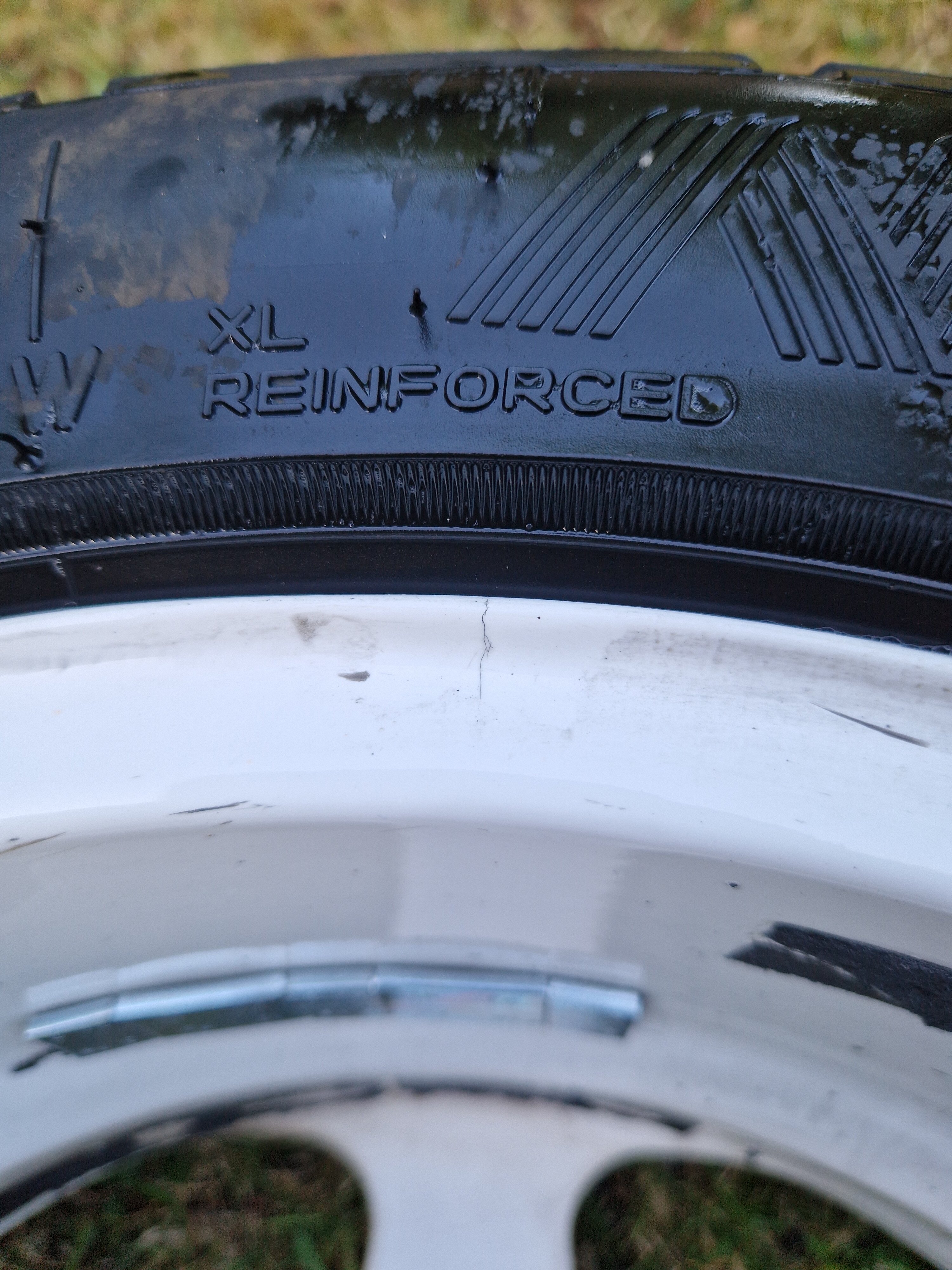

I hadn't properly cleaned the Regas since January (I think) and had only washed them on the car. That time they were fine but I had done a trackday at Combe and driven to Caffeine and Machine on them in the meantime.

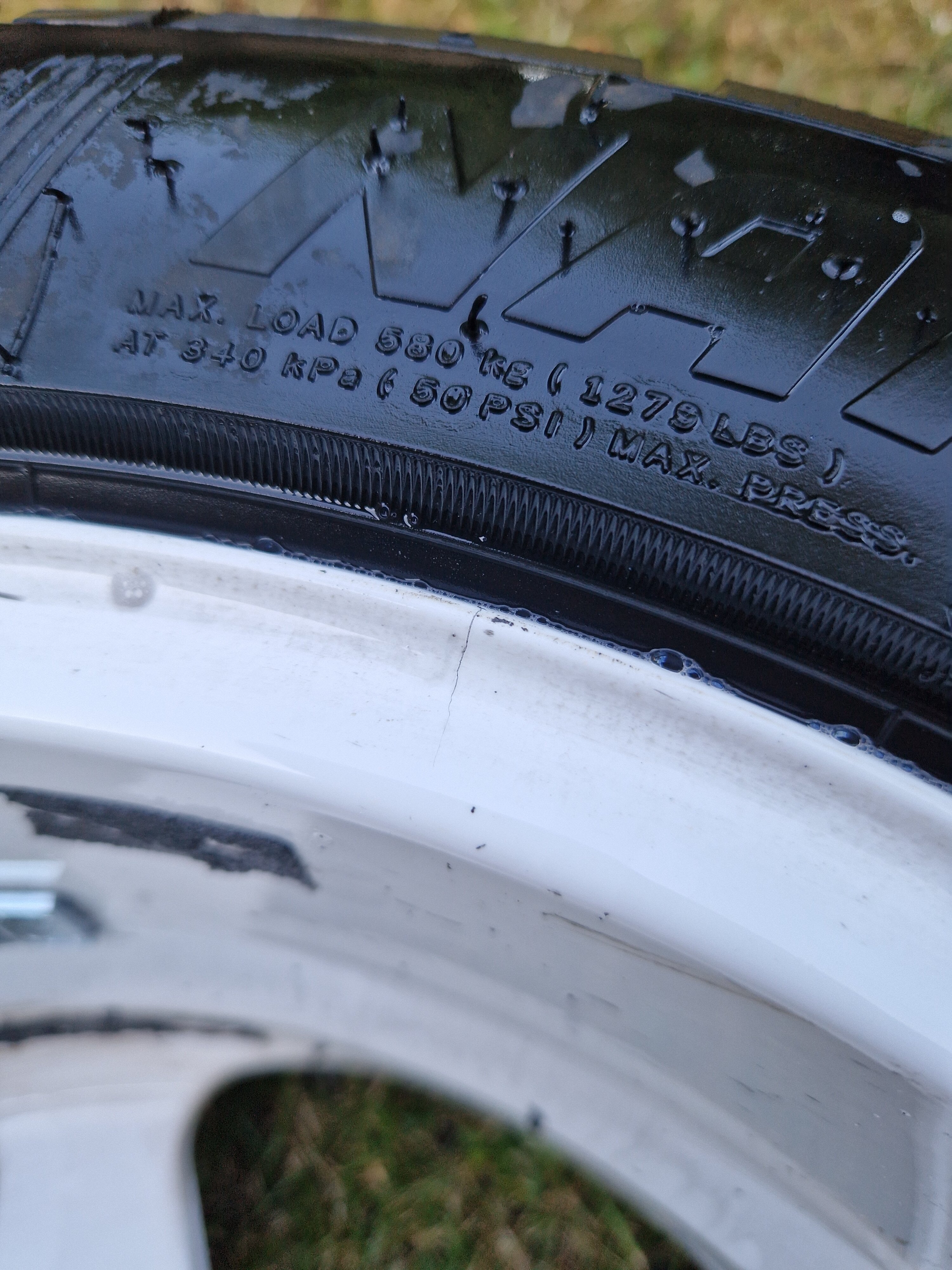

Anyway, when I was cleaning them I noticed some cracks in one wheel. Now, I had been told and read enough about them to know that they were weak but 3 were fine, yet one had 4 (pretty sizeable) cracks on the inside lip - I was absolutely gutted. Especially as this was the Monday eve before I was supposed to drive to Cadwell on Wednesday.
Big sad indeed for about half an hour whilst I worried how I was going to run AR-1s on the trackday. Well one of my car mates came in clutch and lent me a couple of his Jap wheels in the same spec. A genuine pair of KC-SE wheels (15x6.5 ET+45 - exactly the same as the Regas) developed by Keiichi Tsuchiya.

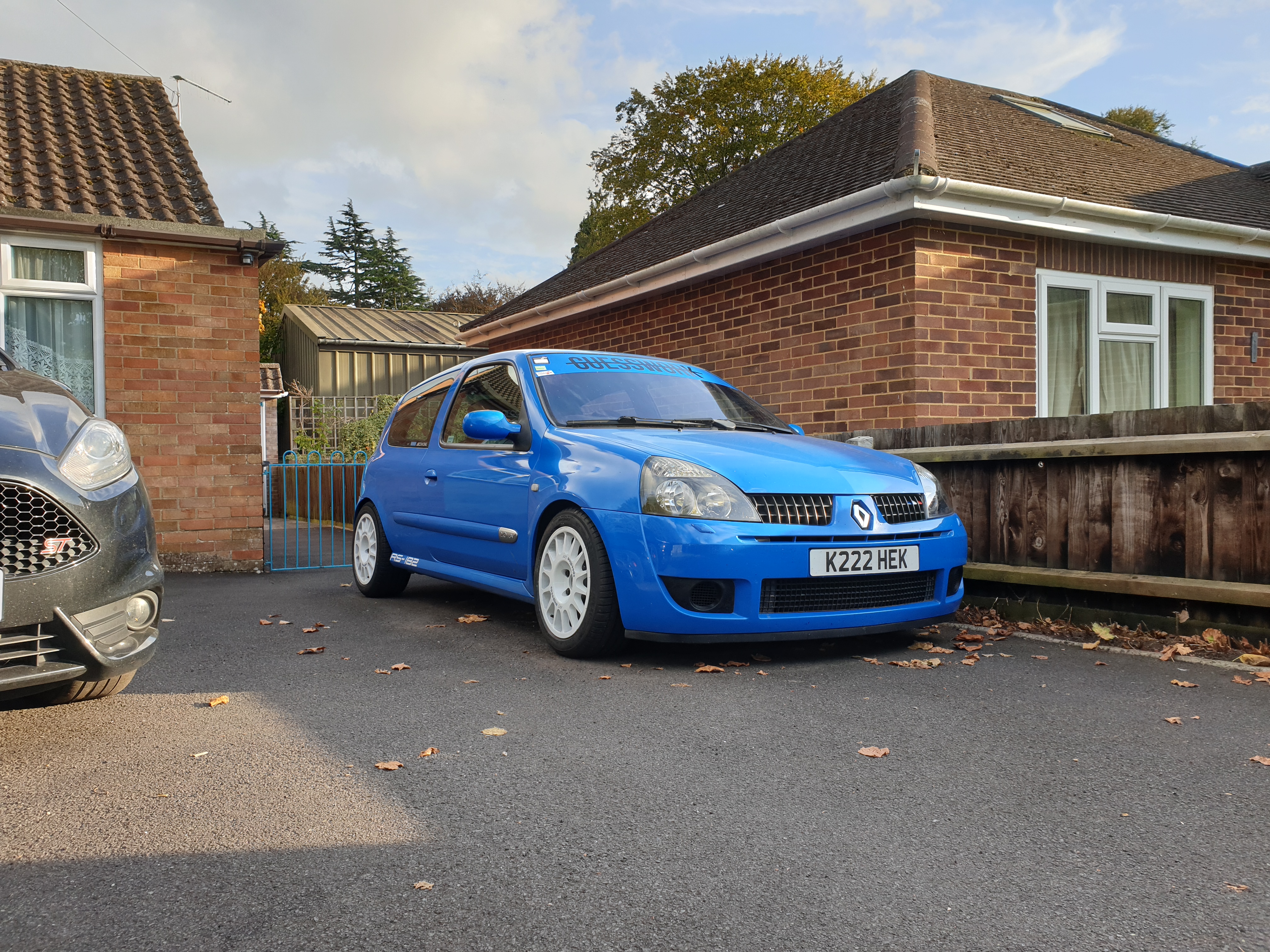

Jap wheels are cool...
Tbf at a glance you wouldn't even know that I would be running two different pairs of wheels.

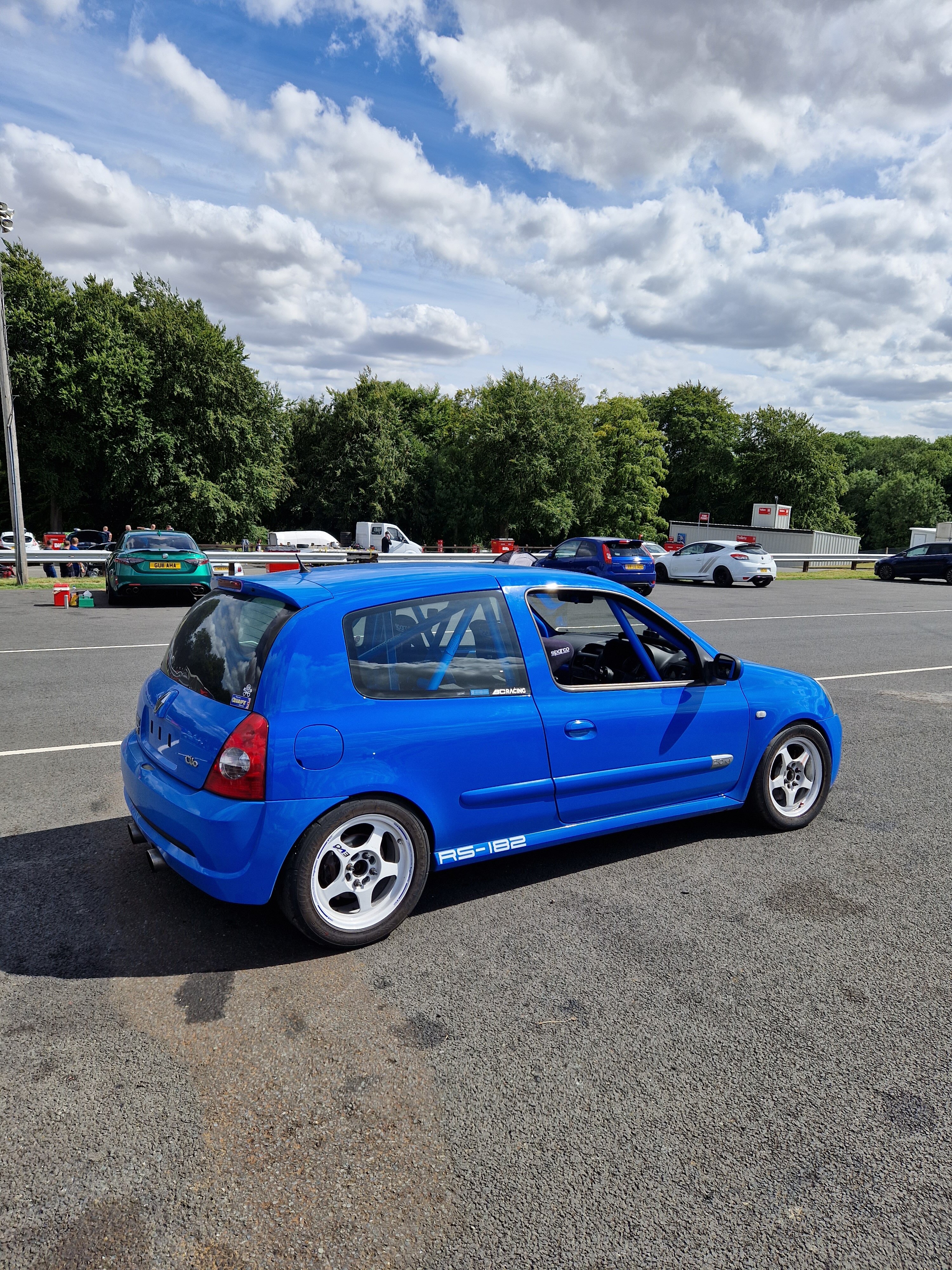

Cadwell round up time. 4th August with Javelin and the GUESSWORK lads.
Firstly, I hate driving at a constant 70 unless I have my earbuds in. The PMS rattle is awful and ruins an otherwise pretty nice cruise.
Secondly, I think the car looked pretty spot on even with its mismatched wheels.

The lacquer has appeared to crack on the KS-CEs which I can only put down to the heat cycles and the fact that the paint is original.

Clios and Coffee at Hendy Performance last year was a good event and so I thought I would attend again as it's only about an hour away from me. Also on the same morning was a Wilton Wake Up in Salisbury so detoured there along the way.
Had a nice, albeit slow, convoy down with the G/W 197.
Always some nice machinery here on display but only stayed for a few mins before heading down to Eastleigh.
Callum had arranged for a photographer to be there and was pretty happy with the results. Good job because I took 0 of my own car 🙃.

Over the last few weeks I have been in the process of selling the Regas so have been thinking of what to go for as track wheels next. I'd like to move to bigger tyre and since taking a dremel and grinder to the front arches, I had thought that a 225 or maybe even a 245 tyre would fit. So on the way home from Combe I stopped to try a Konig Hypergram off my friends K-Swap Starlet.
15x8.5 ET20 with a 215/50R15 Direzza (which I think actually measures at 234 treadwidth) and no spacer fitted fine up front. Clearance in the arch and around the shock was fine and there is probably room for a 245 AR-1 to run something road legal.
Also tried the rears which are 15x7.5 ET35 and were fitted with a 205/50R15 Direzza. Without spacers the spokes hit the rear calipers and so I put the 15mm ones on that I run on the rear with the 2118s but the tyre poked a little so wouldn't have worked. A 5 or 10mm would probably be ideal on them.
So, I just need to decide on what wheels I want now. I want something that not everyone has but also something that isn't going to crack again 😭. A lot of Googling to be done to work out what I think I will be happy with.

I've really enjoyed putting miles on this car this year but there was one upgrade that had been fitted which I kind of wish never had been...
...the PMS Shifter.
Now, it's a nice bit of kit and it's better having the gear knob up closer to the wheel (+ it looks quite cool) but my god does it rattle. I was getting so fed up with it that I was almost at the point of not wanting to drive the car. Having to use earphones as earplugs or rest your hand on the lever really wasn't great and on track at high rpms it was pretty horrendous. 3000rpm seemed to be where the rattle started though and with the Megane 5th, that's 60mph.
I then remembered that I had seen on Instagram that @FrogJam Motorsport had fitted a Pro Coolerworx to their race ca which sparked my interest. I sent them a message asking if they would make something similar for me that would fit a standard tunnel (theirs is modified and mounted from the cabin rather than underneath). Fair play to them they said they would help out so they told me what bits to buy and so I got the bits ordered and sent the required parts off to Freddie.
Less than a week later I received the tower and had everything I needed to try it out. I'd been very impressed with the work done on the FrogJam car so had complete confidence that it would work in mine. Took it to the Guesswork garage to fit and setup the Saturday after...
Now I thought the PMS looked "race car" but think this is even better! The prototype stickers were taken from a project at work which I think adds a nice touch.
Not quite as simple to setup as the PMS down to the fact you need to adjust the spring centre and the lock limits for 1st/2nd, 5th and reverse but still only took about 30 mins. Guess that's the luxury of having access to a ramp though.
More importantly though the shift is way better due to the strong self centering spring and the lock limits. There is also absolutely no rattle throughout the whole rev range and we also moved the gears closer to the driver (if that makes sense) which is also an improvement I feel. The above photo is where the shifter is held in neutral by the spring neutral so 1st and 2nd are more where 3rd and 4th were with the original Renault shifter.
Shift feels great and is honestly such a fantastic addition to the car. it is so direct whilst being really smooth and no rattle means that it's just a nicer place to sit now.
Over the 3 weekends that the shifter has been fitted I have done just about 500 miles with no issues at all. Seriously one of the best mods on the car.
Further updates coming soon when some more shiny bits arrive.

I sold the Regas to the UK distributor of the new Regamaster/Spoon SW388 wheels to be used as demo pieces in their office. Rather nice I thought but then of course meant I was looking for a 2nd set of wheels again. After trying the wide Konigs on in September I knew that I could get a decent sized wheel and tyre on. I would like to move to a wider tyre once I've used up my 205 AR1 this year.
I wasn't very adventurous and so bought a set of Protrack ones. 15x8 ET20 for the front and 15x7 ET35 for the rear in black. They fit well on the back with a 15mm spacer, but the fronts still need about 10-15mm but it needs lowering badly. I only fitted the wheels briefly as it was super wet out and didn't want to aquaplane all the way home or into a hedge somewhere on the way. There is still room on the front though and I feel silly for not buying a 15x9.

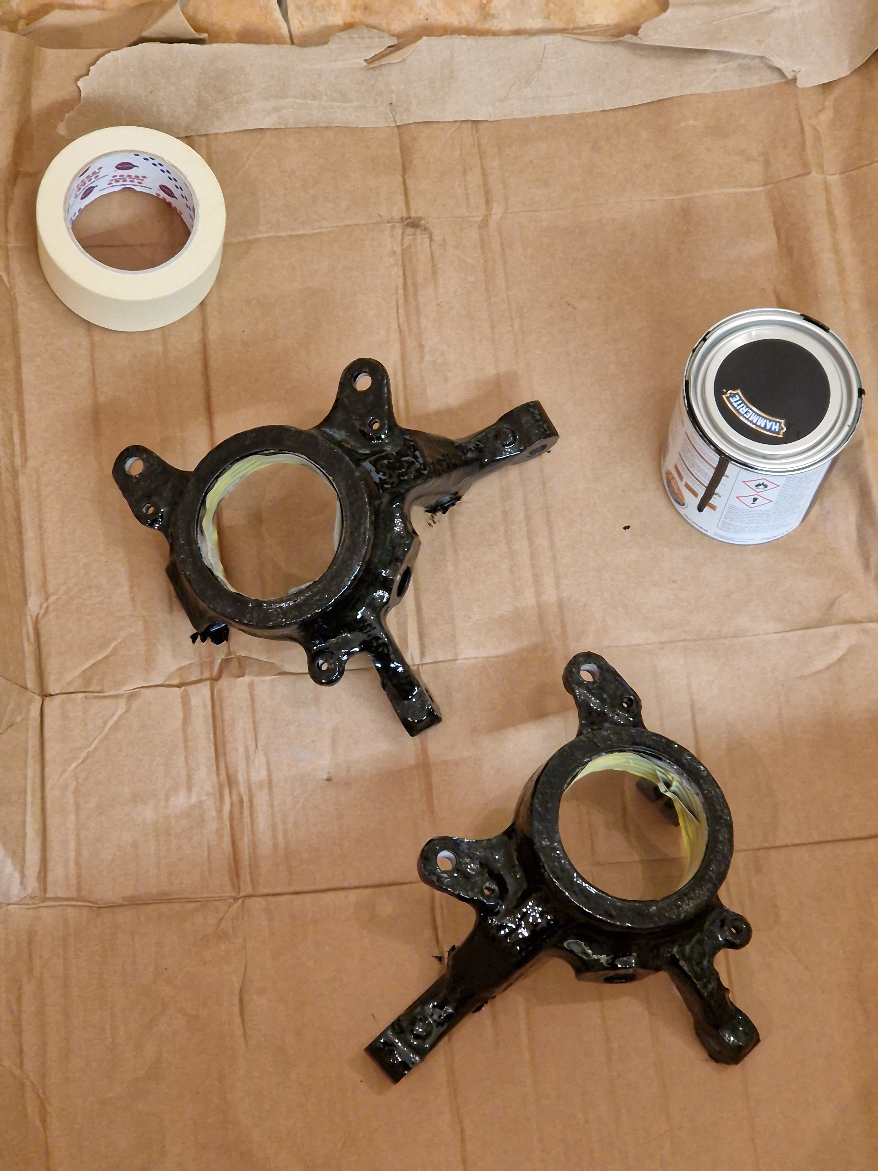

I try not to believe a lot of what is said on FB and the forum on opinions on parts when I haven't tried them or been in a car with them fitted but I had not seen a bad review (on the performance at least) of a Roll centre kit. I looked at buying the PMS kit initially but that was quickly ended when I saw that I need Laguna hubs which are NLA. Then it was onto the Pro-Am kit which was also short-lived because there are reports that they break and I do not want that happening. Apparently the design has changed but the reputation is a little tainted for me. Therefore I was left with the NorthLoopCup/Bridgecraft Motorsport kit, only problem with this was the fact that I needed hubs to send off for machining. Quick call to James at JMRS who let me have a pair of hubs to send off on the basis that when mine were removed I gave them to him on an exchange basis afterwards.
Blasted them at work and quickly slapped some hamerite over them before sending them off to Allan at Bridgecraft. Didn't have to be perfect though but it'll add a little protection. Hubs are still away with Allan at the moment but new track rods, wheel bearings and ABS sensors have turned up ready for when they are returned. Exciting stuff!

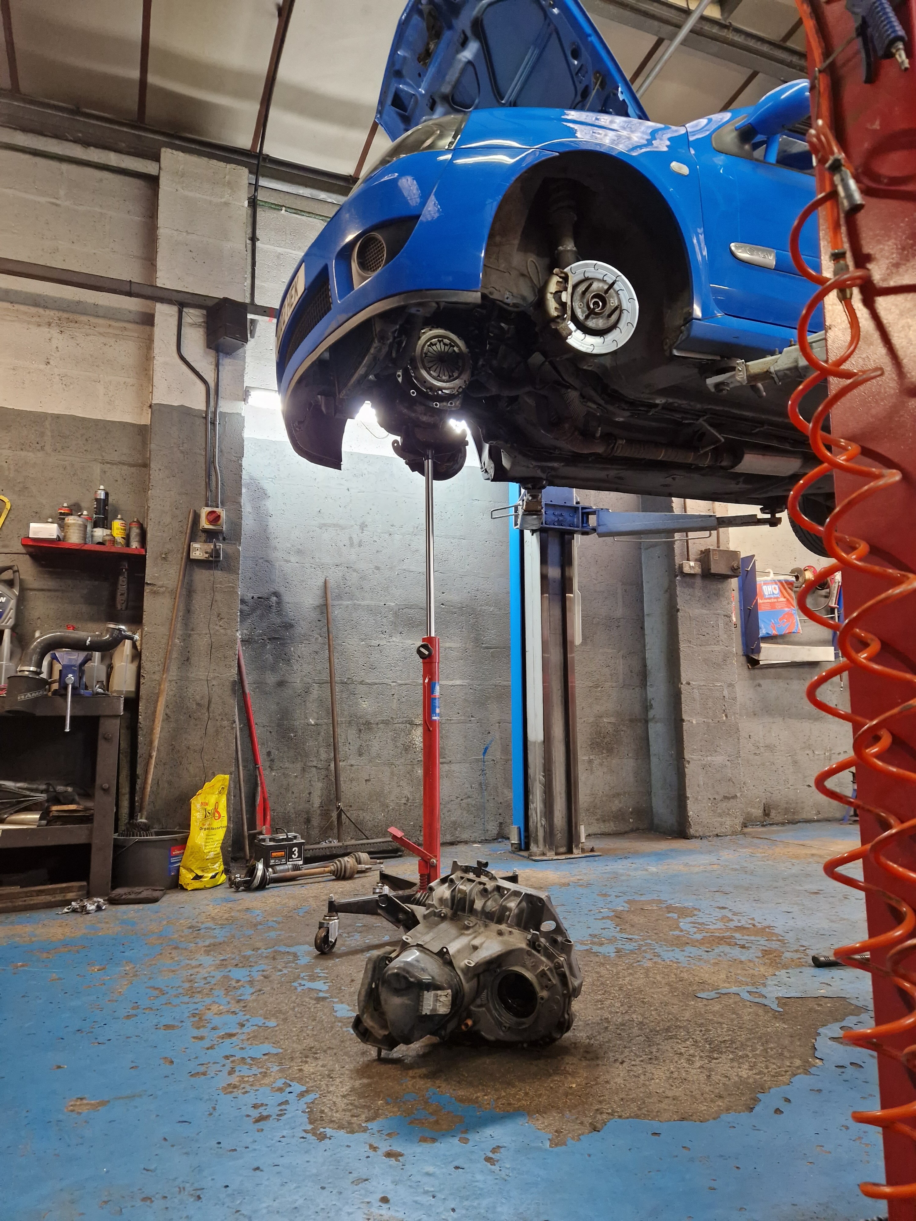

Trip to the Guesswork garage was arranged and so on Friday lunch we dropped the box out the car and took it down the road to be rebuilt and have the original 5th put back in and then I went and grabbed it back yesterday morning. It was 26 hours between driving in the garage and then driving out again. Also took the chance to fit some Powerflex bushes to the front wishbones whilst the subframe was out. Not too shabby and also no crunch... Yay!

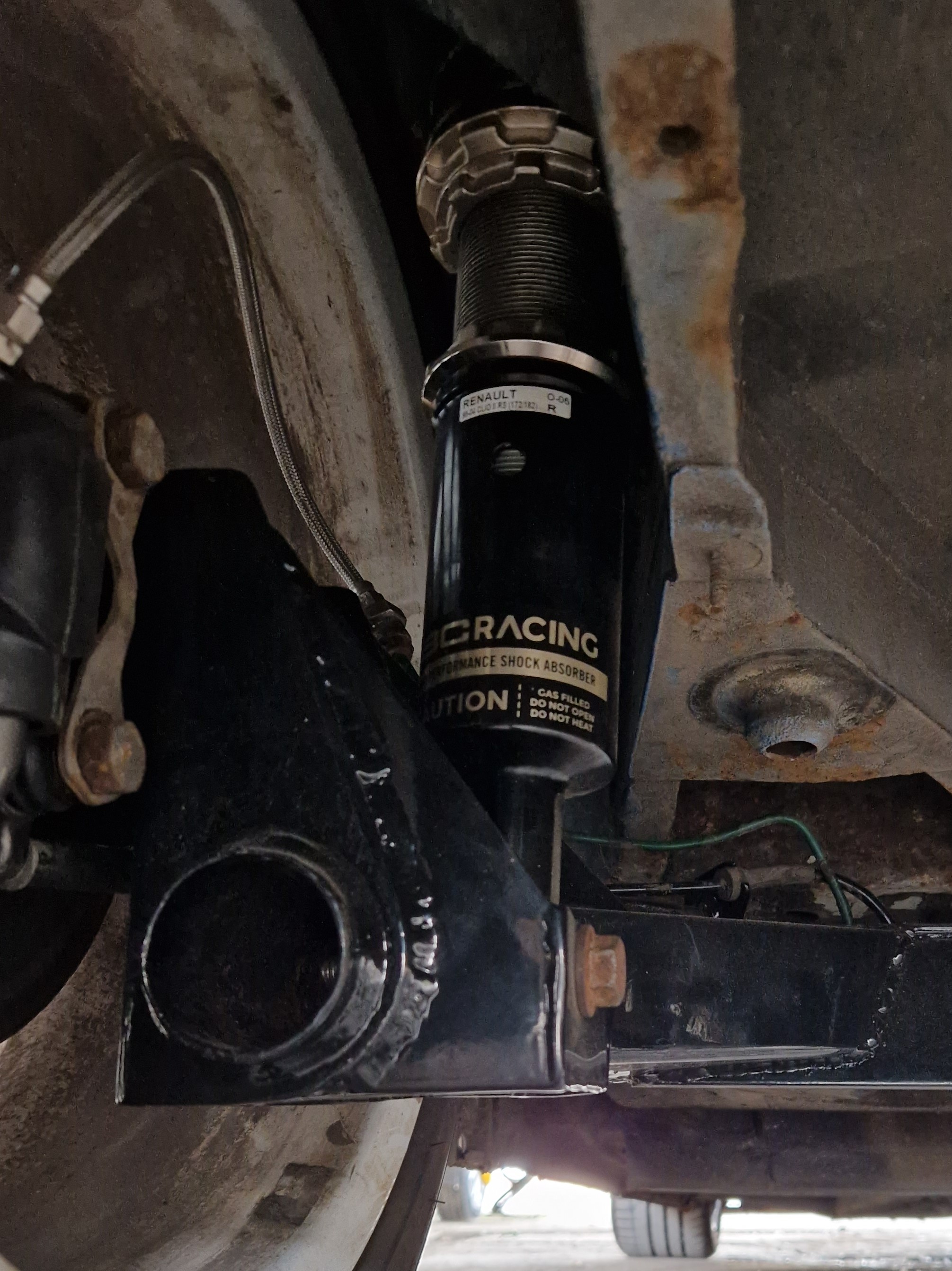

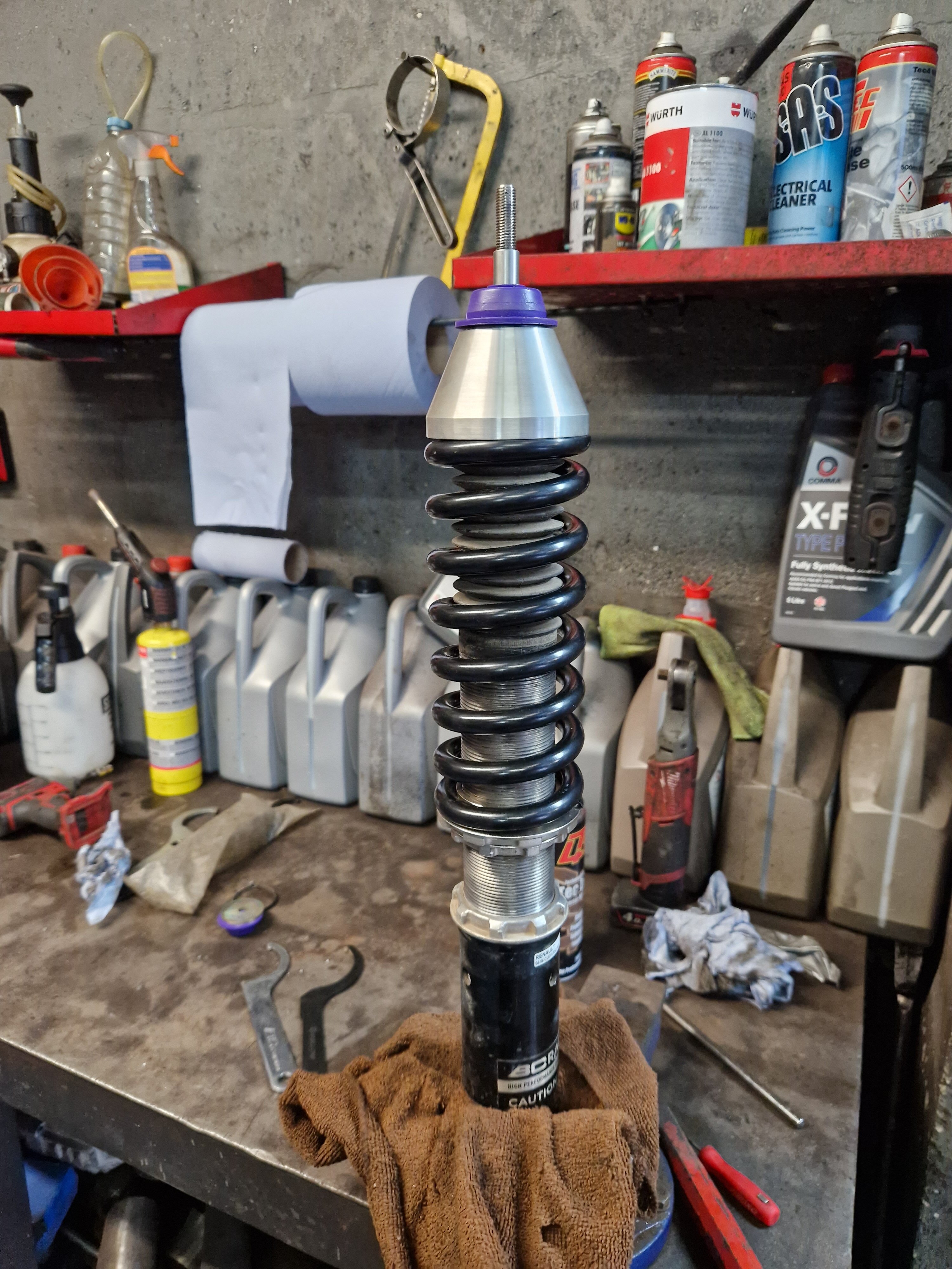

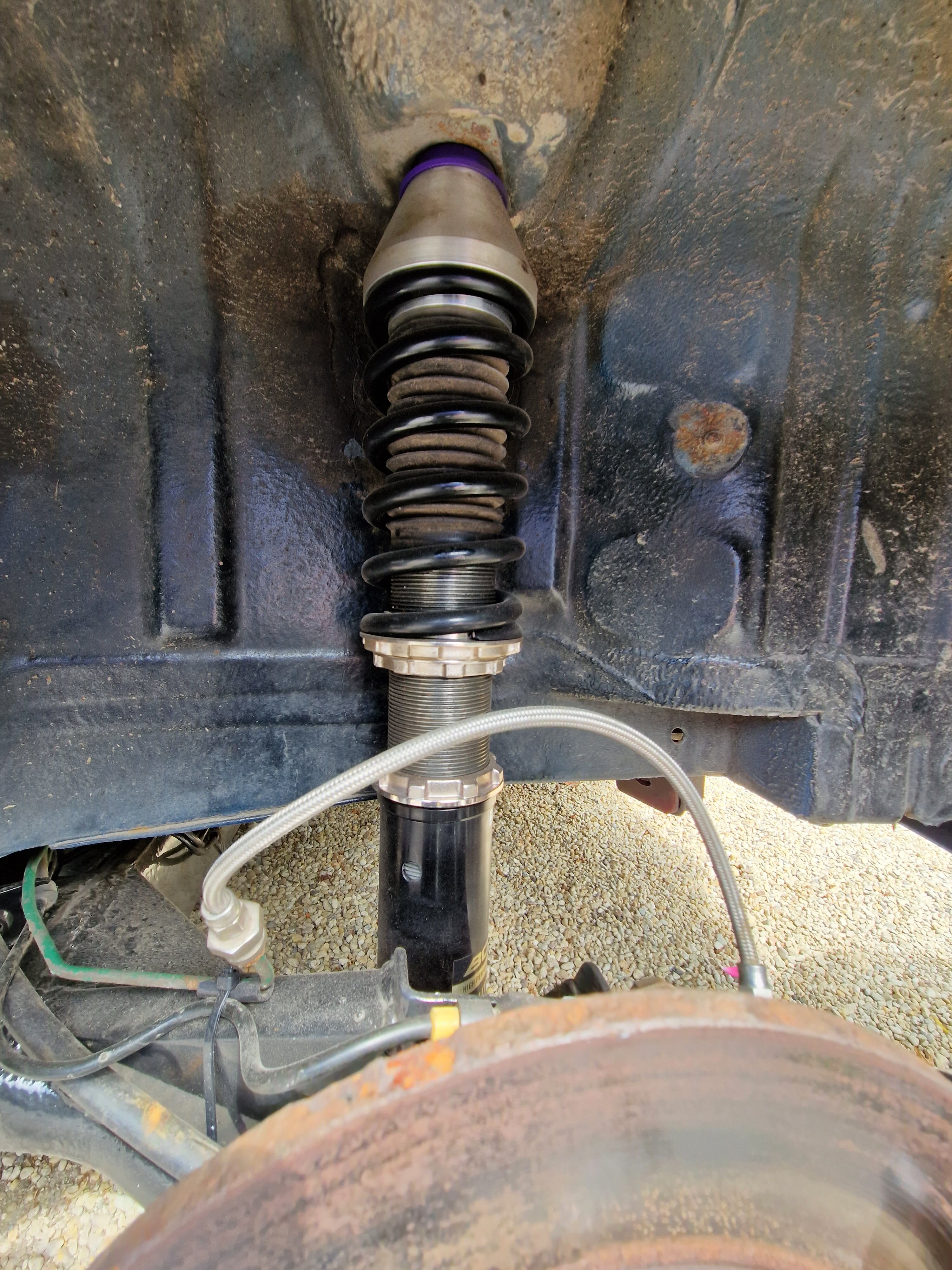

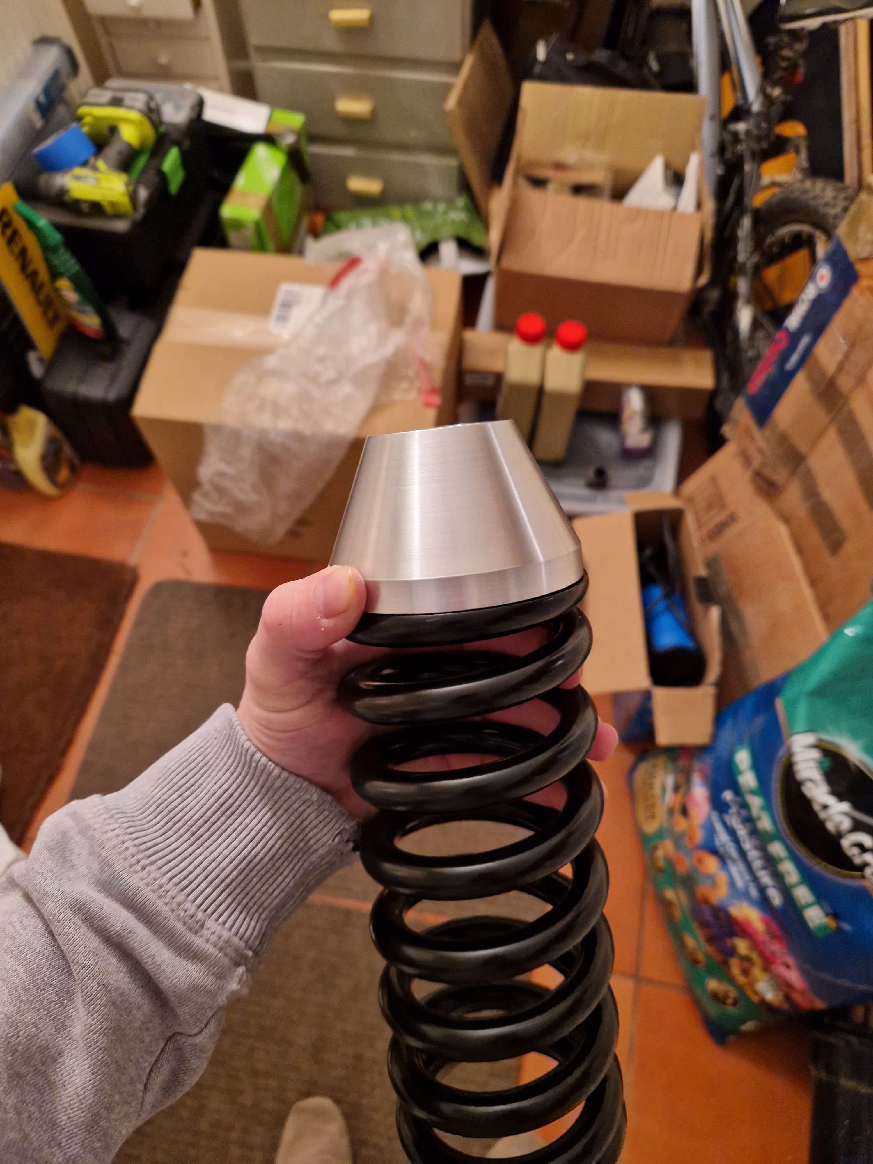

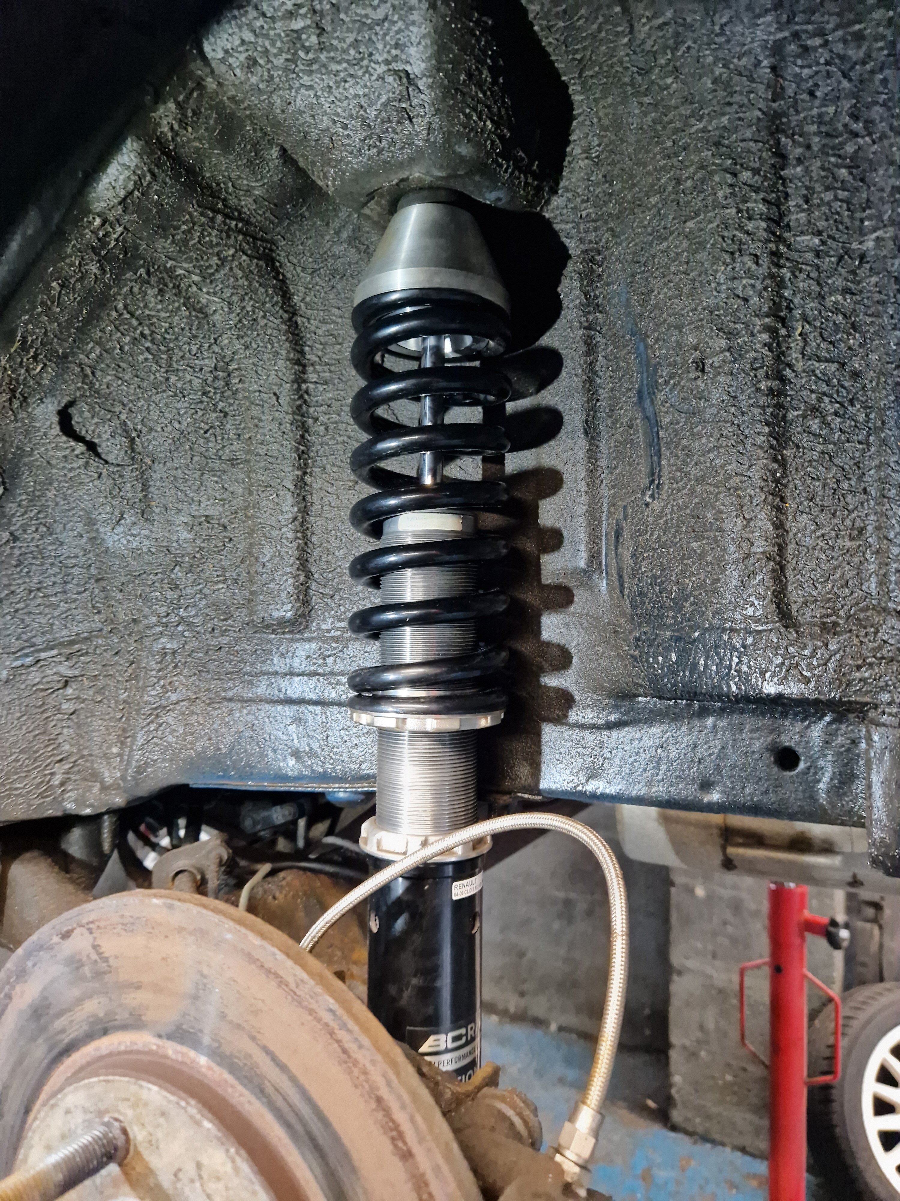

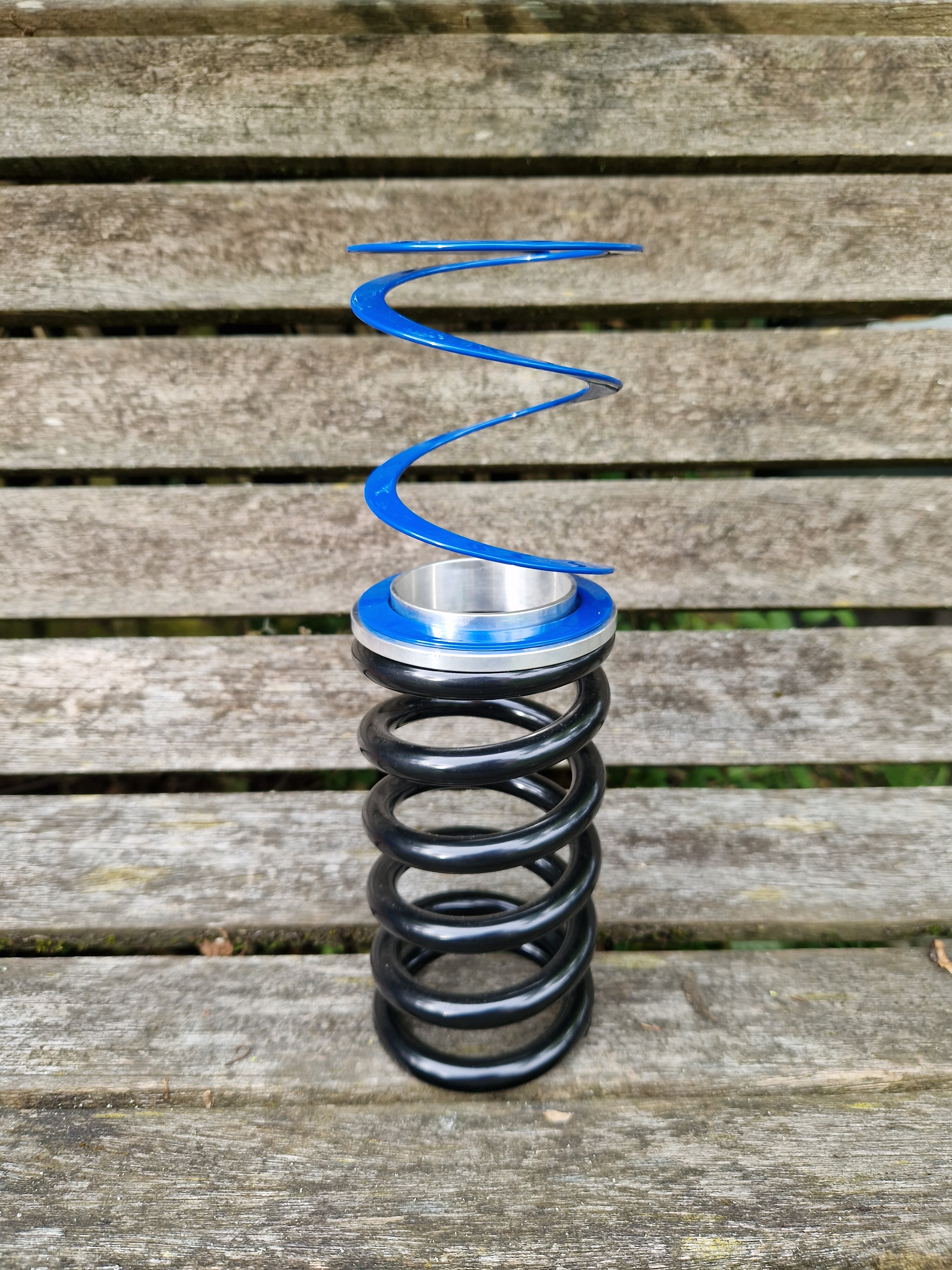

So a day after the previous post I managed to get the spring perches for the rear dampers from the machine shop.
Test fitted them with the Faulkner springs as soon as I got home.
Once I knew they sat right in the springs it was time to go to the garage and test fit on the car...
As stated in a previous post, the springs are very close to the body and touch where the harness bar plates have been welded in. A bit of beating with a hammer got most of the clearance sorted but the bar does still need to come out. However, it fits really well and looks proper smart.
But, there's always something to sort out. I bought the Powerflex top mount bushes for the rear dampers but the metal sleeve does not fit over the rod on the BCs. I thought this would be the case but just wanted to be sure as the new bushes are made for standard dampers. These, as well as the spring perches needed going to the machine shop again for a couple of adjustments. The top hole needed boring out and so did the Powerflex sleeve.
Last problem during test fitting were the bottom locking collars on all the dampers. They are all seized to the silver damper units which was pretty annoying. We were not about to start heating them or smashing them up and as I know you can get all the spares from BC I decided I would order 4x new lockrings and cut the original ones off.
Cleaned all the units up in the meantime and have invested in some ACF-50 ready for when they are off next.
The spring perches and bush sleeves have been machined out and the new lockrings have turned up so I should have all that I need to fit these to the car now.

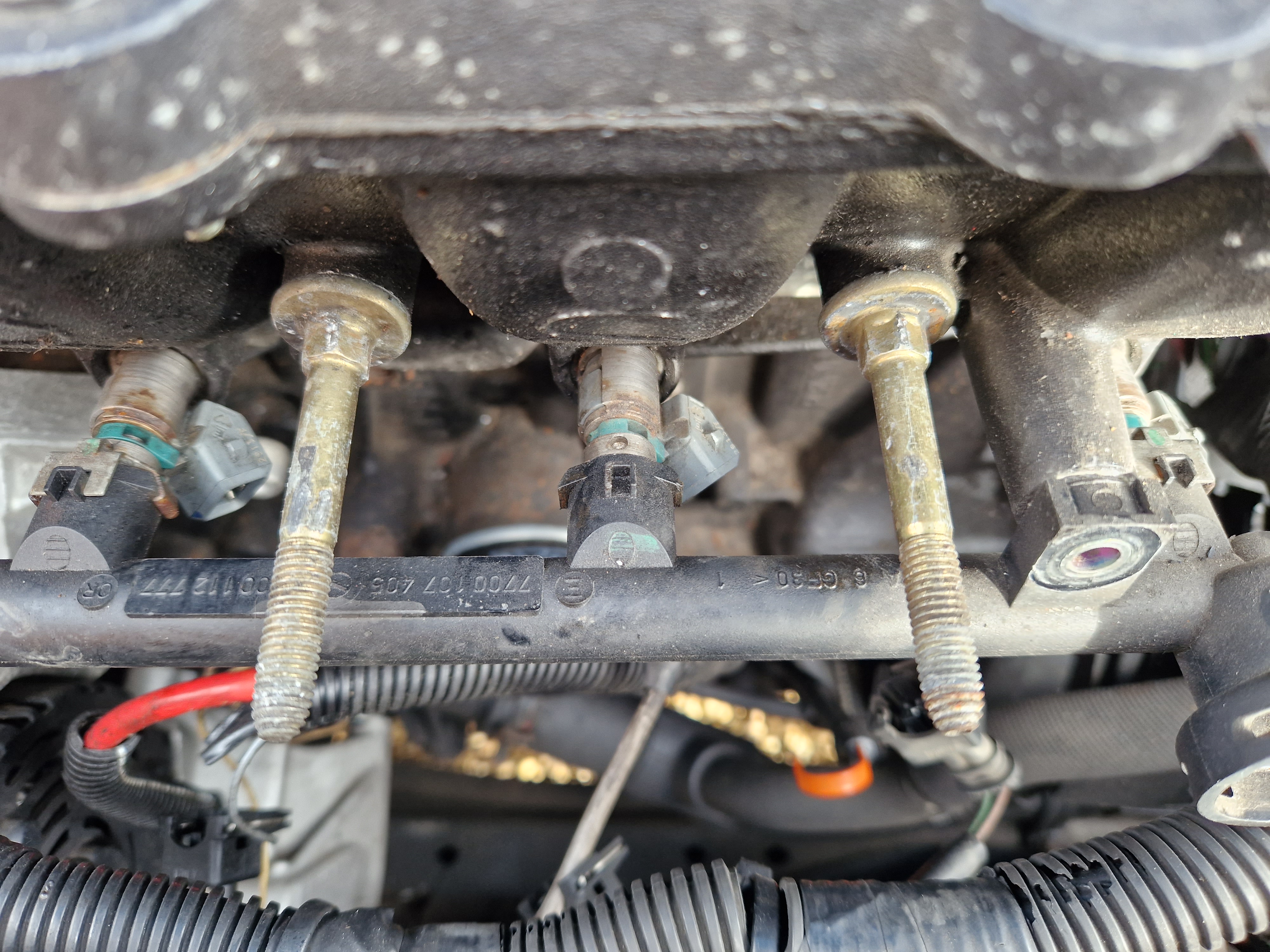

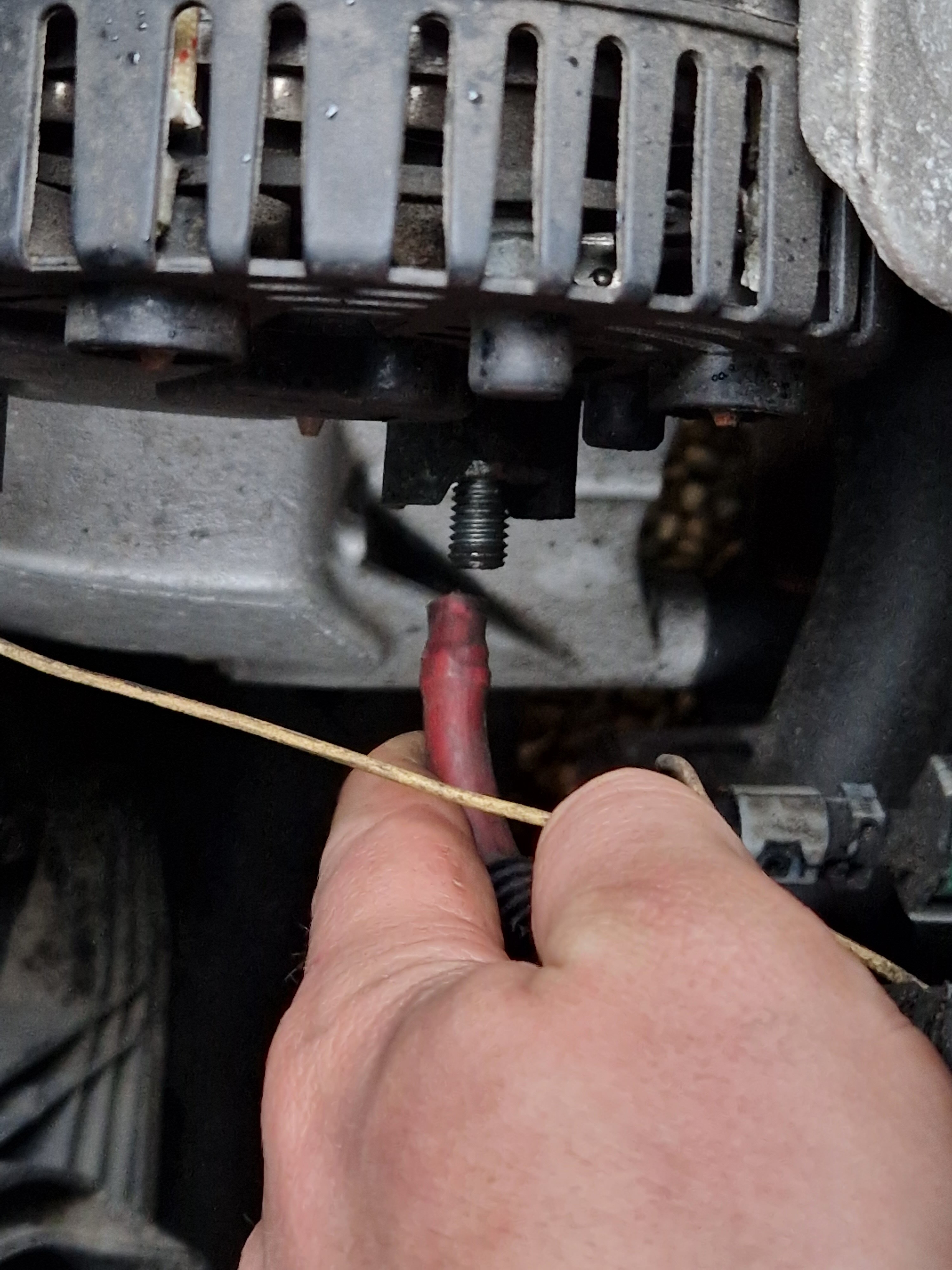

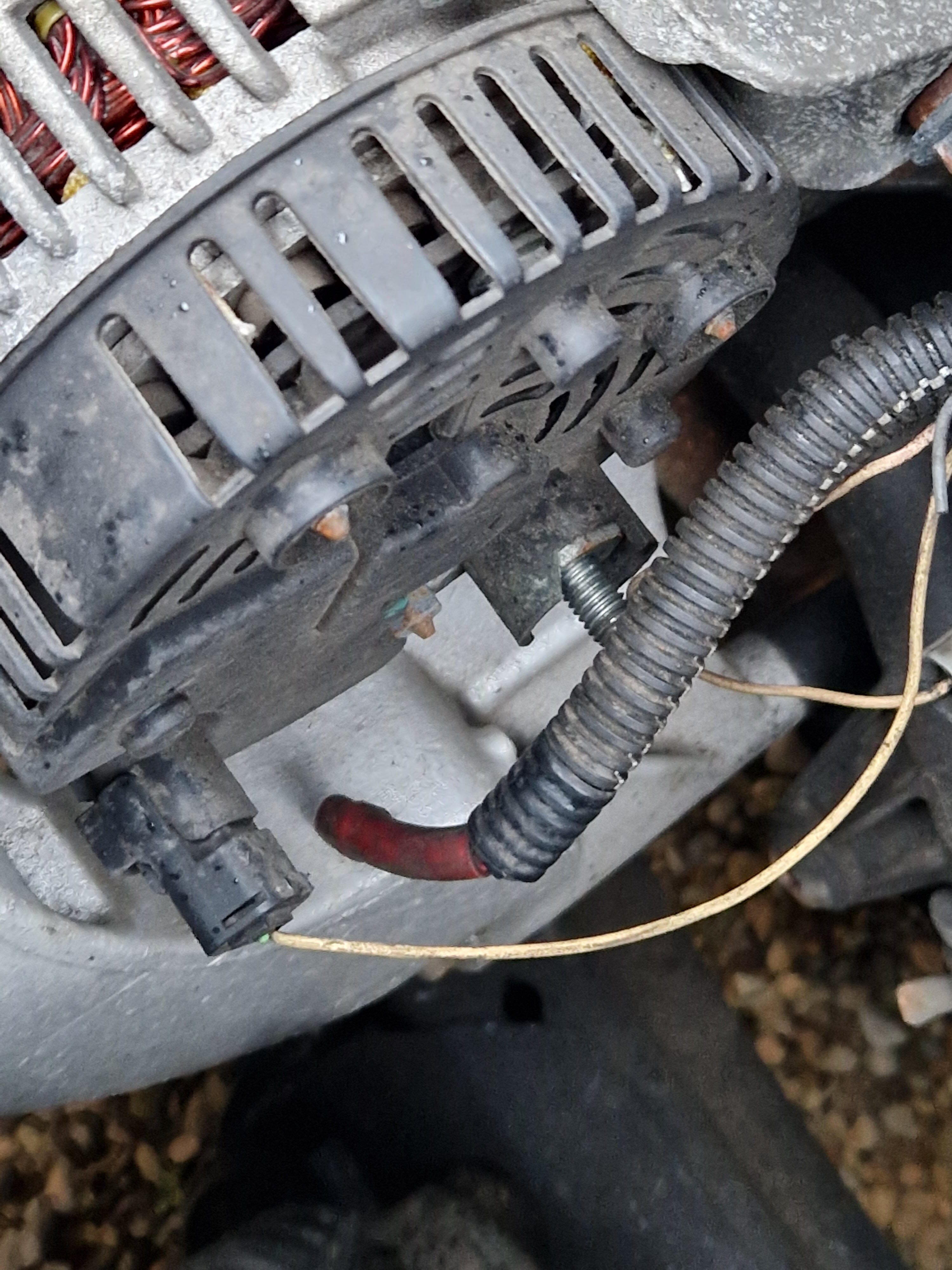

Now, remember I said it misfired on the way to the garage... Well on the way home this time it got real bad. Battery and stop light came on along with the misfire, plus the ABS and TCS light came on too. Not. Good.
I pulled over on the way home and gave it a minute to just think what to do and it really struggled to start again, sounding like a dead battery. I limped it home and then had a friend pickup a new battery and bring it over. It started the car easier, but the stop and battery light were still on and the damn misfire was too.
Then a bit more digging found this...

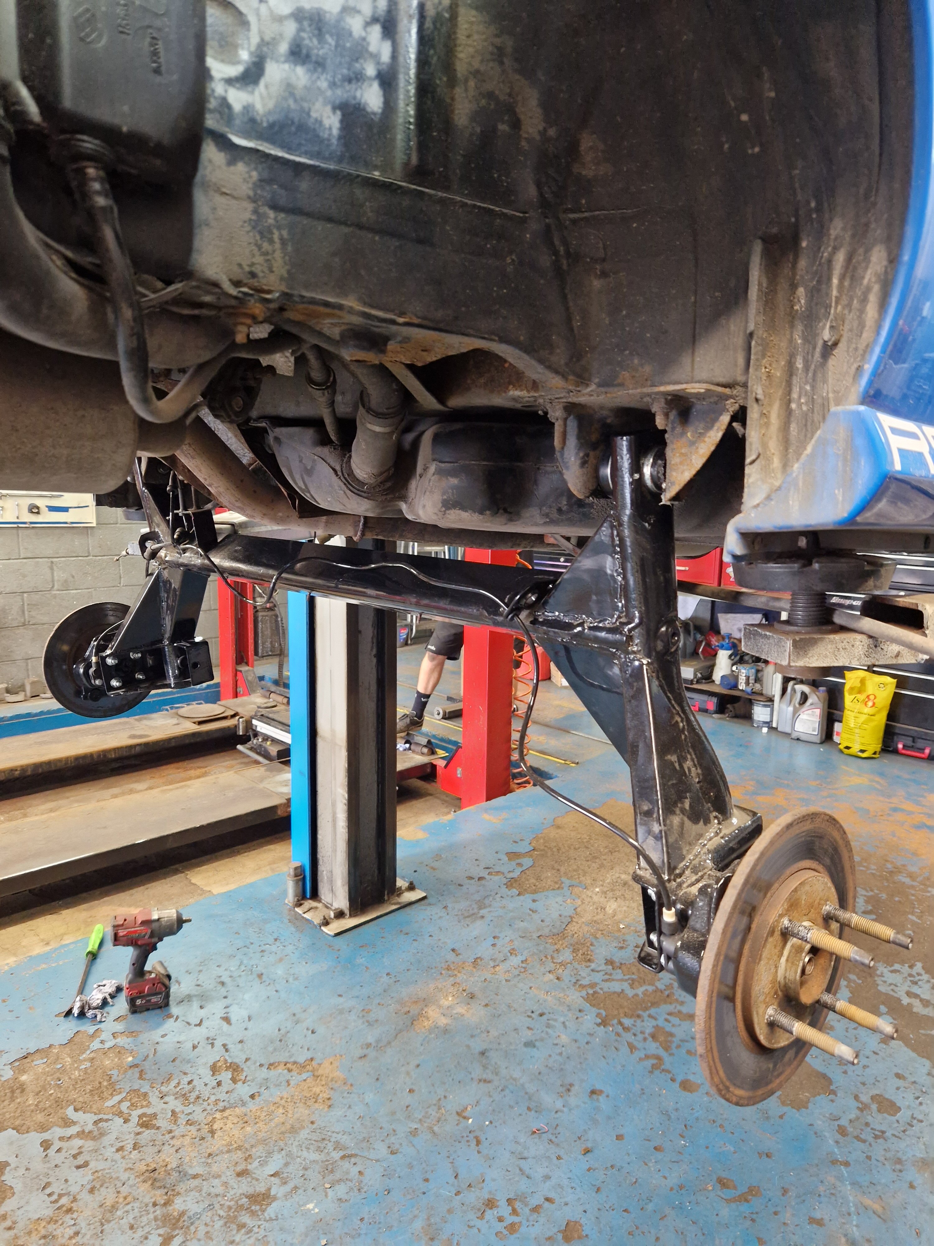

The crimp for the cable off of the side of the alternator has sheared so the battery wasn't getting charged. A new one needed then... Always something isn't there!

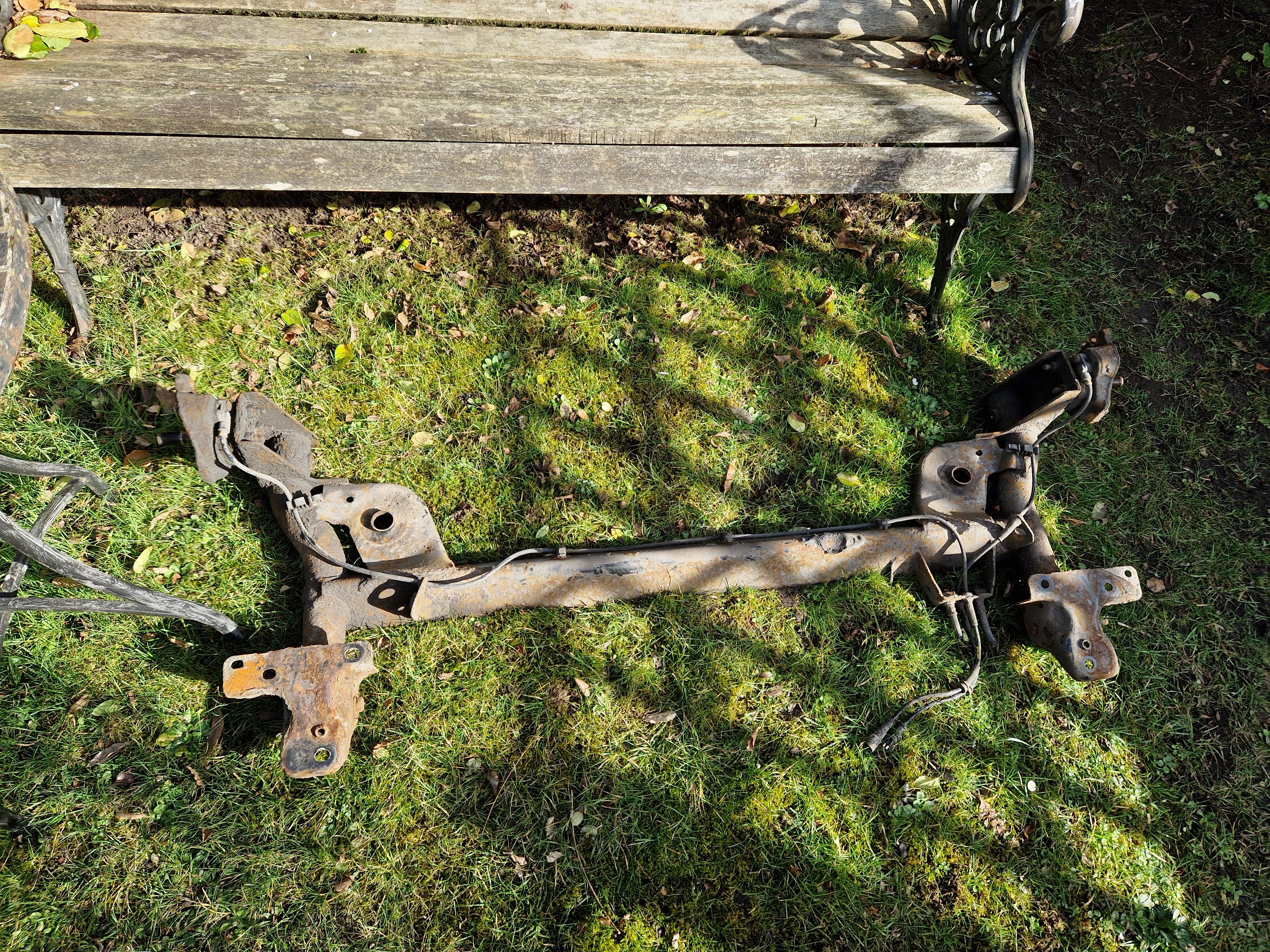

I needed to pop over to James at JMRS anyway as he's just down the road to get a beam. Like the hubs for my roll kit, he'd agreed to let me have it to build up with a PMS strengthening kit and new bushes in return for my standard one when it got swapped. When I got there I mentioned the crimp and James then grabbed a crimp and his hydraulic crimping tool and said I could take them too to get the cable sorted. He is a top bloke!
Beam is a little crusty and the bushes need replacing, but I have Whiteline ones to go in and will clean it up before fitting it down the line.
After dumping the beam in the garden I recrimped the cable on the alternator and it didn't solve the misfire, but the stop light and battery light went off so small steps towards solving the issue.

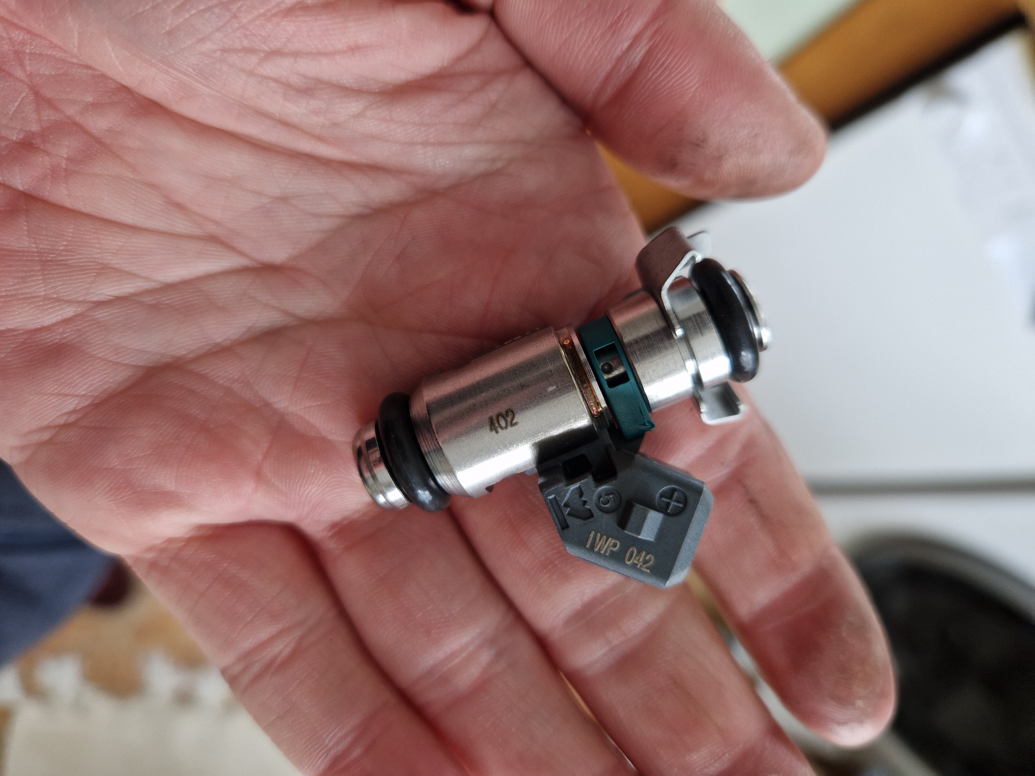

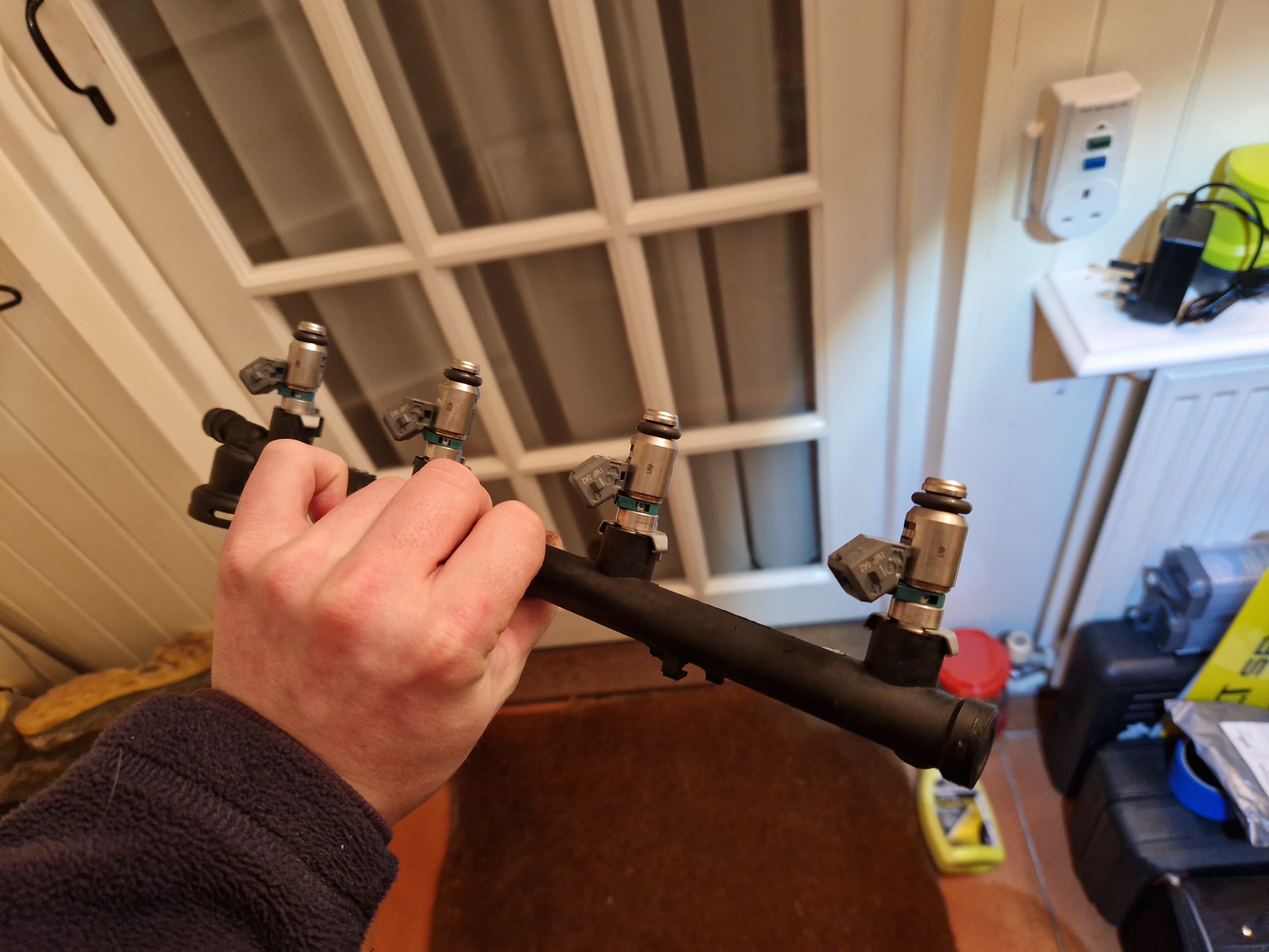

When the engine was changed at the end of 2020, the leads and plugs were new and the coil pack was taken off of my old engine which was known to be good (albeit at the time). The injectors were the only thing that was an unknown. I changed the coil pack first and tried it with the yellow leads which made no difference. Then I went back to the Renault leads that were on my old engine and tried those with both coil packs which also made no difference.
I then took the plugs out to see if any had fuel on to narrow down if it was a spark issue or fuel issue (I should've done this at the start but oh well). All of the plugs were dry so next up was injectors. It was dark and cold by this point so I turned the car on and removed the plug to each injector one by one, assuming that when I unplugged the dodgy one, it'd run the same. Sure enough the car ran the same depending on whether injector 2 was plugged in or not.
Now I remembered on FB that people had bought injectors on Amazon that seemed to be genuine and performed well. I ordered one at 10pm and it was delivered at 10am the next morning so it was super easy.
It arrived in Magneti Marelli packaging and looked good (even though I'm sure that a non genuine one would probably look good too).
Also noticed that when I was checking the injectors number 2 had no clip on it. Replacing it was super easy and afterwards the car ran much better. I was very relieved to get it sorted.
Due to the fact the other 3 injectors were still unknown I ordered 3 more and changed them the next day so at least they are all fresh, and I have 3 spare working ones now. The other 3 injectors were also bought on Amazon, came in the same packaging and were all of the same quality.

After the faffery with the injectors and the fact I was still waiting for the Roll Kit to come back, it was time to crack on with the rear beam.
When reading the instructions for the PMS strengthening kit i realised that the box you add around the lower shock bolt is really designed to be done with a shock in place so that you can make sure its done correctly. I wasn't really in a position to take a shock out of the car and leave it on stands (where the car is kept I am not able to work on it), so I just measured the spacing and got a little spacer made up. Borrowed a shock bolt from James at JMRS and then got onto welding the beam up.
Didn't take many pictures as the welding isn't pretty, but I had a go at it (with some supervision) and it was my first time welding. Got well acquainted with a flappy disc too but it won't be seen and its all stuck so not too bothered by the how it looks. The beam, along with the mounts and the stub axles are away for blasting and powdercoating at the moment. Hopefully should have them back at the end of April.

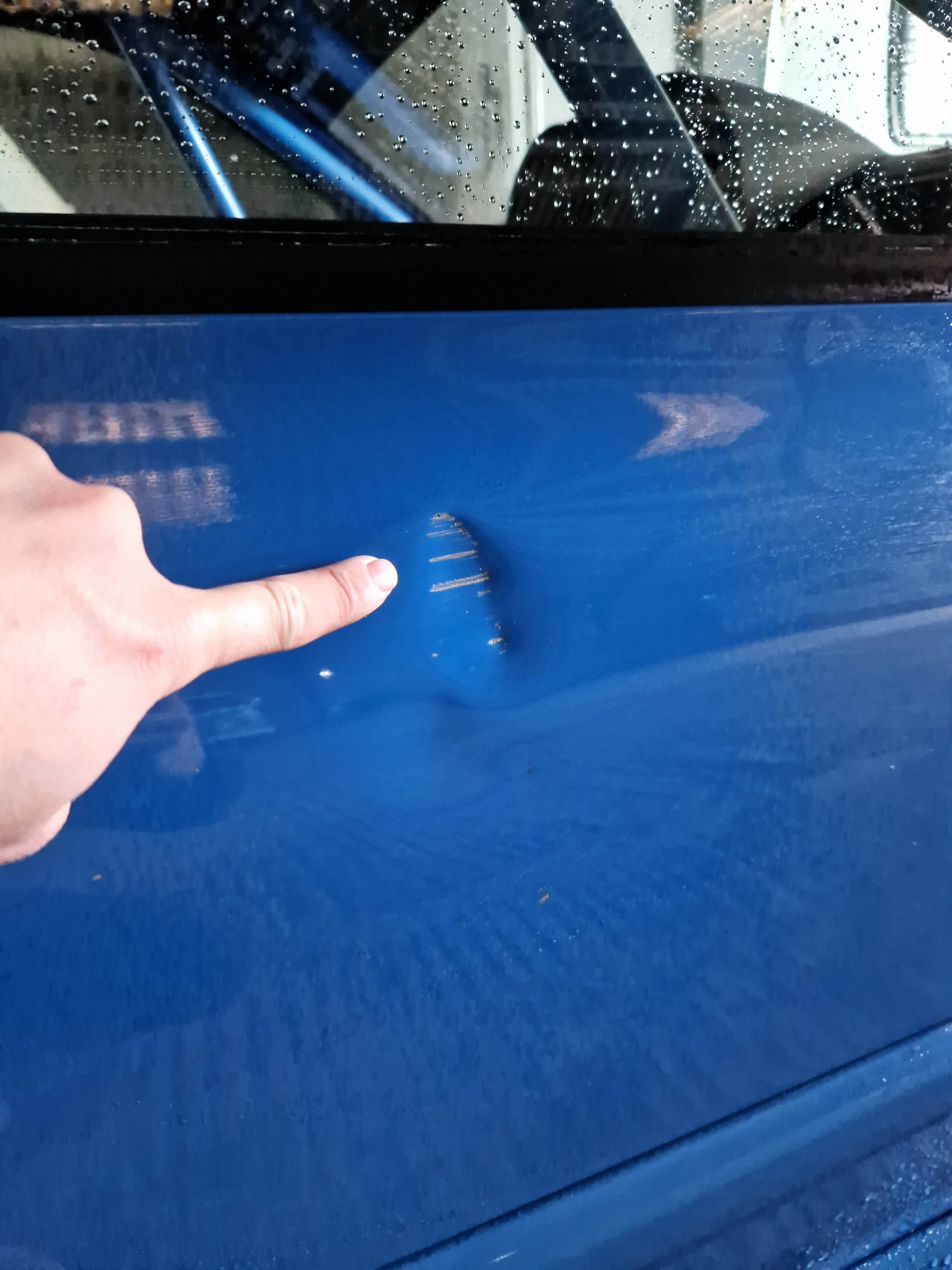

Skipping ahead a couple of weeks now and stupidly, when I went to get the car on Good Friday I didn't check that the car was in neutral for some reason and when it cranked it lurched forward. Worst part was the drivers door was open and it hit the post next to the car.
I didn't notice at the time but when I got home and was giving it a wipe over I saw it and thought "that wasn't there last time I drove it" - not my finest moment and was really gutted. More on this later on...

The only issue was that the ABS sensors I had been sent were incorrect. Not the end of the world and the ABS light was on anyway so it didn't make any difference driving it home.
BC lockrings were cut off and the damper units were all cleaned up and made pretty again. I really should have been better at taking them off and cleaning them as they have done a fair few miles now and most at the same height. As previously mentioned in the thread I have been getting bullied by my mates for having poor fitment and monster truck ride height, so when they were back on the car we began to lower it. Each front was lowered 20mm.

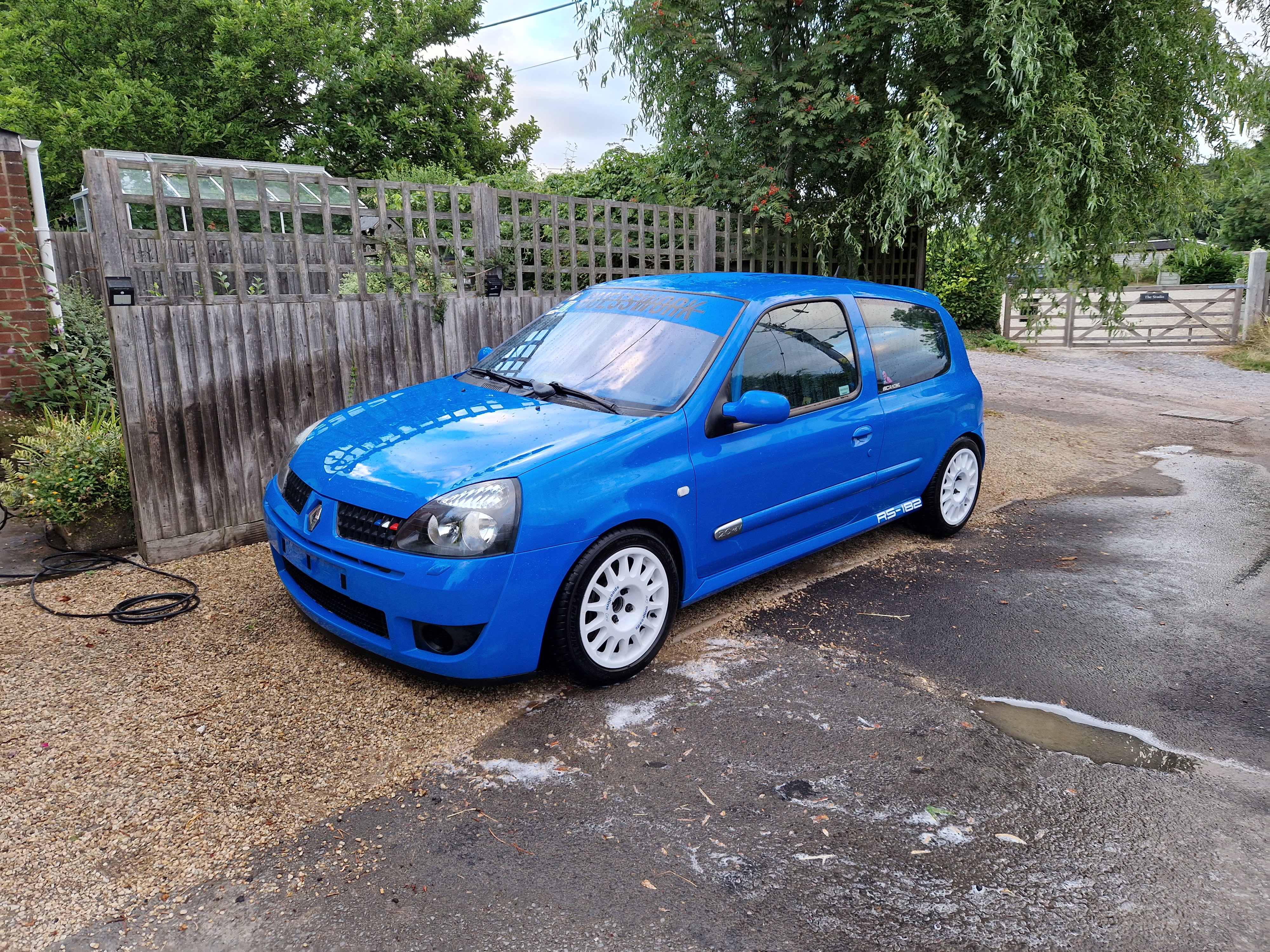

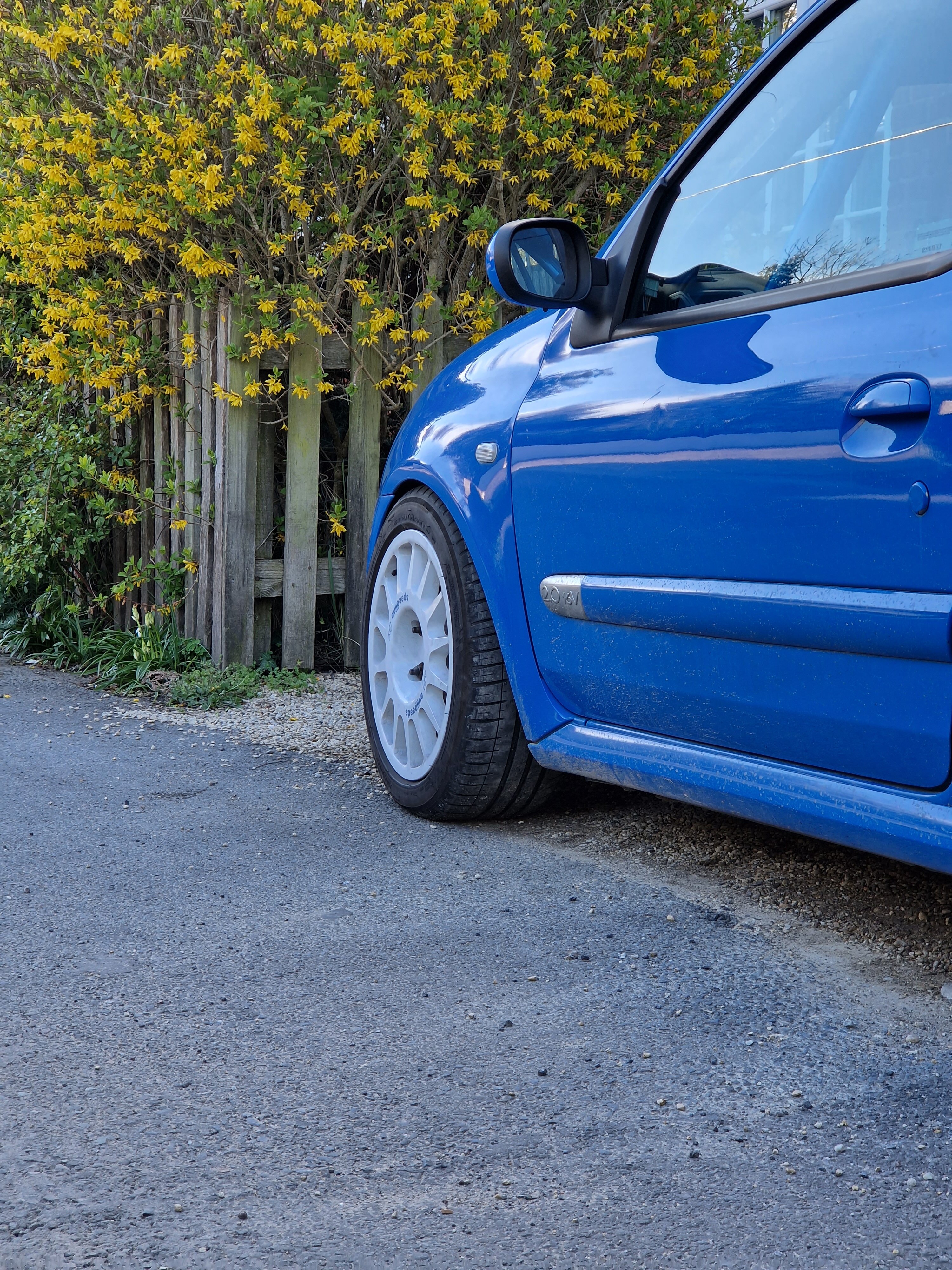

I then drove it home, cleaned all of the arches out and fitted the 30mm spacers to the front.
It wasn't difficult to line the wheel up with the arch with the standard alignment settings, but with ~3° camber it tucks the top of the wheel in quite a lot. The car doesn't need to be driven now until it goes for aligning but need to wait until the beam is back for that. Hopefully there will be a chance to get it weighed at the same time again to see what it's like on the fat 2118s.
So the beam is next up but the paint and the dent on the door needs fixing also. As gutting as it was at the time, it may actually be a blessing in disguise (that's what I'm trying to tell myself anyway 😭). There is a little patch of rust on each rear arch and so rather than keep ignoring that and getting some mobile repair to come and sort the door, I have decided that it should be done properly and will get the rust sorted at the same time. I will take the skirts off as well and see what they are like so if there is any rust there then it can all hopefully be hit in one. I don't expect the work will be cheap, but it needs doing and will only get worse. I don't need it to be mint and the car never will be as it's used hard but that's no excuse to not maintain it and keep it looking presentable.
Motivation rapidly declined for the car since receiving quotes for the work that needed doing. I started to add up whether it was going to be worth but I began to feel that I could not justify it. Thoughts of breaking it began to manifest in my mind... So it was parked up and ignored at the beginning of May.

Think the front might be nearing the limit of how low it can be!

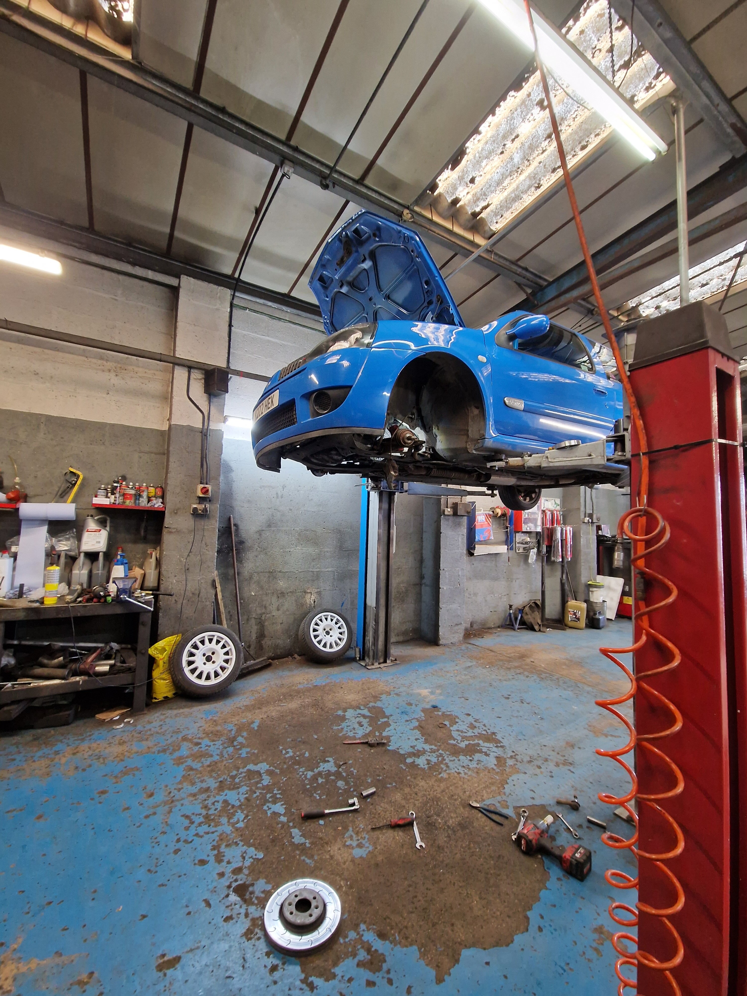

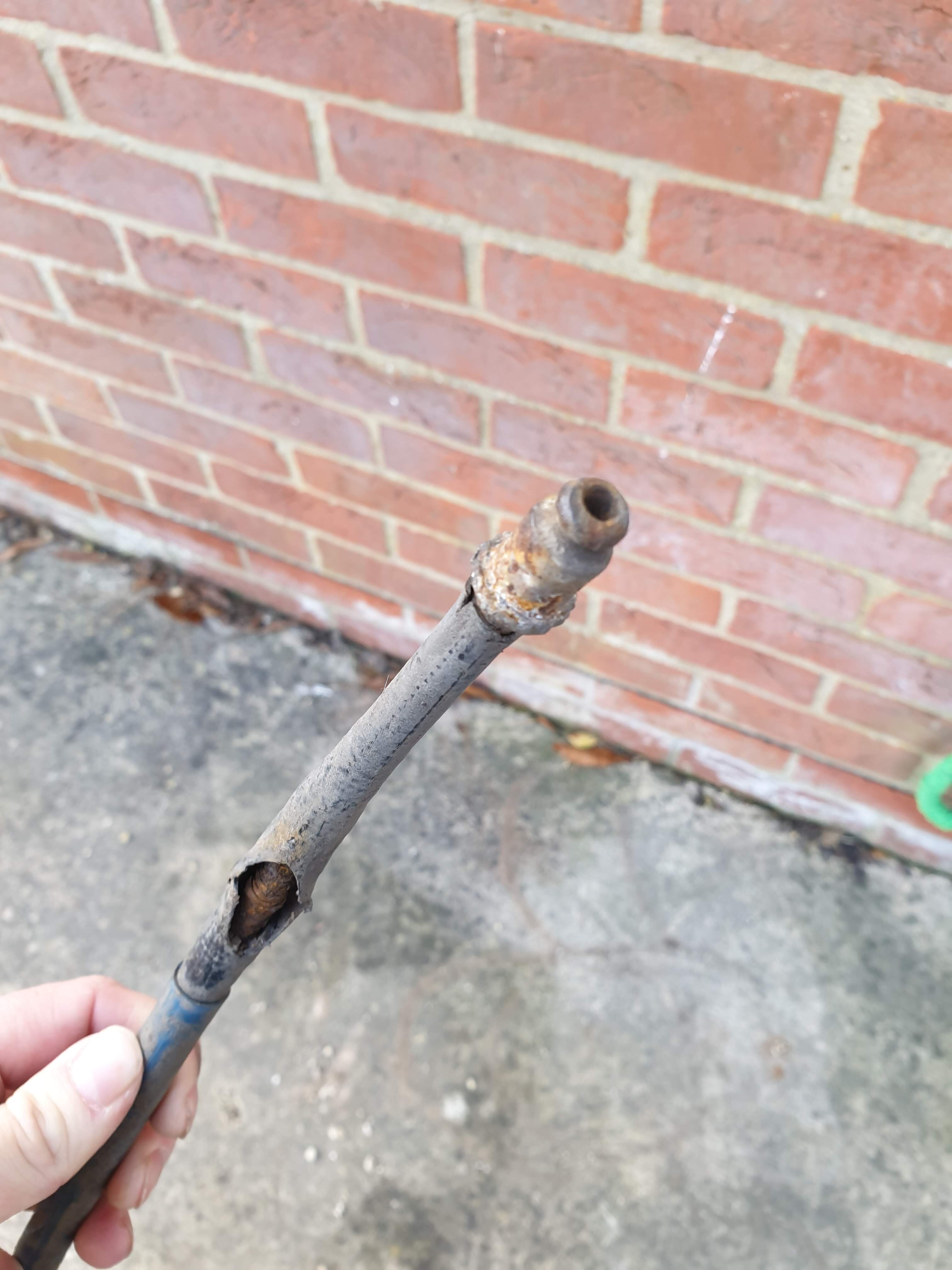

First up was removing the old beam from the car. Rubber flexi brake lines were cut and clamped and I had seen a post on Instagram about cutting the bolt on the fuel tank side slightly, so that you can slide the bolt out through the bush and drop the beam without taking the chassis mounts out. Bit of jiggling but the beam was dropped out relatively quickly. The Whiteline bushes were pressed in no problem on the vice and the mating surfaces and threads on the stub assemblies were cleaned up on the wire wheel.
Between the initial trial fit to see if the coil setup would work, we had a second go and found that the bottom coil mount on the BC (the black part that the damper unit threads into) was seized on the OSR. We also found that the Faulkner springs I had got were too long and stiff. I called BC to order 2 new bottom mounts and exchanged the 8 inch, 550lb springs (that I had bought way back in May 2022 and pictured above) for some 450lb, 6 inch springs and also a pair of helper springs and spacers (pictured below).
We tried to build the coils up but unfortunately realised that the inner extrusion on the spring divider and the top mount was thicker than that of the compressed helper spring. Kind of annoying but we soldiered on and knew that it would work without the helpers for the moment. Another trip to the machine shop needed!
BC mounts were cut and the damper unit was wound down inside the fresh mounts. Stub assemblies were bolted to the beam with fresh fixings from PMS and the disc spacers, discs and new calipers were also added.
KTEC lines fitted and rear pads fitted which just left the bleed left to do after fitting the coil units. Car was then put on the ground to check the height but the first try was still too high. Took the coils off again and then found out that the dampers were pretty much at the bottom of the mount so we wound them all the way down and fitted back to the rear end.

So this is going to be a bit of a strange update to the thread...
As the last post stated, I had a trackday booked with the GUESSWORK guys at the end of August which I (and the other lads) had been trying hard to get the car ready for with all the fancy and shiny new bits. Left on the list were brakes and an alignment...

Before it could be aligned we needed to work out the fitment on the Protracks as I'd owned them for 6 months at this point and not actually run them on the car. The test drive was not successful and whilst turning round one of the arch brackets caught the tyre on full lock and put a nasty cut into it. So it was off to my good friends garage to sort this out!
We beat the bracket back and then put some underseal spray stuff over the bare metal. At the same time we fitted fresh MS Custom Engineering calipers, some Brembo High carbon grooved disks and PBS ProRace front pads to the car.
I then booked the alignment for the week before I was due to go on holiday up until the track day.
Anyway, the weather was great and so I used the car for a couple of days before going on holiday. I even 3D printed a water bottle holder to solve the cup holder issue! Howeve, whilst using the car and ripping it about it went into limp mode a couple of times which was worrying and I knew that time was running out to get it sorted for the Oulton. I sort of ignored it and it did go away but had thoughts of what it could be began to start playing on my mind...
It came back from alignment but I wasn't particularly happy. The settings weren't as I had asked (but I was in a rush when I picked the car up and misread the readout) but I didn't have time to try and get it back to the garage to be sorted before I went away - which would have left me at a detriment before Oulton. This was disappointing.
I decided to change the wheels back to the 2118s ready for the drive up and when I took the car back to the storage unit it went straight into limp mode again. I've got AA cover and so I got them to come to my house and scan the car and it seemed to be a ground issue, so I fitted another strap from the engine to the battery which seemed to fix the issue on start-up, but as soon as I drove it, limp mode was back.
Time had basically run out at this point to sort stuff and I decided to cancel my spot at Oulton. This was gutting as a huge amount of work from friends (and money from me!) had recently gone into the car attempting to get it there.

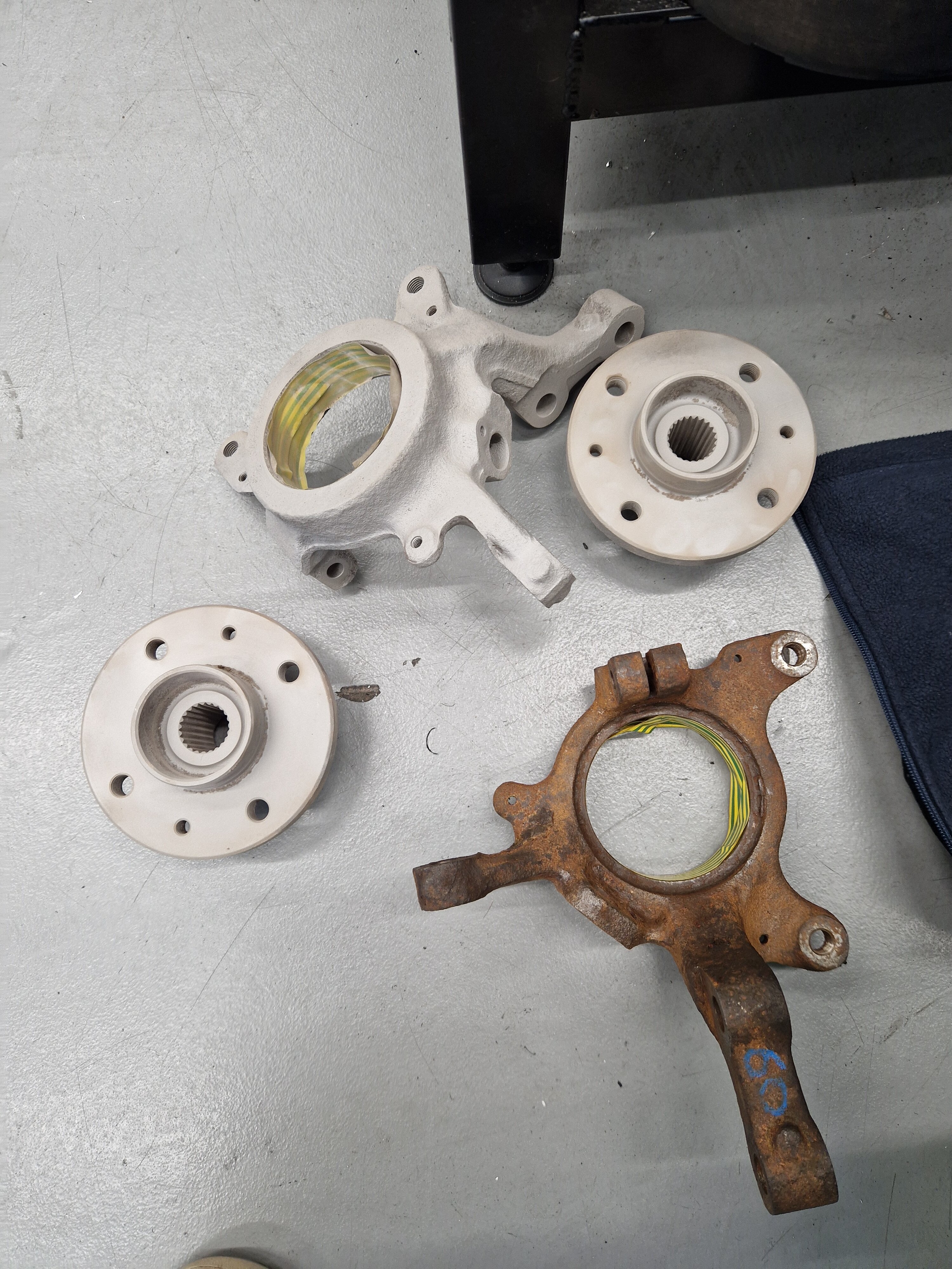

My original thoughts were that the shell would be scrapped which although sad, would be pleasing in a certain way as I had taken the car from standard and now it would end with me also. However, James mentioned that he could make use of it and so I thought that if the shell would be able to bring him anywhere near as much joy as it had brought me over the time I had owned it, then why should I stop it from "living on".
Now even though a lot of parts had been fitted in the few weeks prior (most below 200miles use), and that the car may have only needed "a few quid more" to sort, I couldn't continue to gamble with it. I also do actually want to own a few other cars whilst I still have the chance and all the cash tied up in the car basically was confining me to a 20 year old French Hatchback. My daily is a Fiesta ST180 and it reminds me a lot of the Clio when I first bought it and that gives me the "quick" FWD hatch fix. The mileage I had done in the Clio basically matched what I had done in the ST the weekend that we broke it and so there was a pleasing feeling that the "baton was being handed over".
Even though the breaking decision came around relatively quickly, thoughts of the car going had been around for a while. The fact that I wouldn't be able to drive it again took a while to sink in as driving the car was an environment that I felt so comfortable in. Owning the car allowed me to meet so many people (some of whom I'm now proud to know and call my friends) and I have so many memories (most good but some bad) attached to it, but these friendships don't end with the car and I will still have all the memories of course!
I bought the car on the 24/02/2019 and the mileage was ~120,800. The final journey (under my ownership and as the car that I built), was the 08/09/2023 and the mileage was 161,243. It was a damn good car and I am proud to have owned it. This blog, along with the Instagram account @kiffle_ is also a good place that I can look back on the progress of the car. Maybe it will be updated with another car one day and a new thread started somewhere else on the web!
