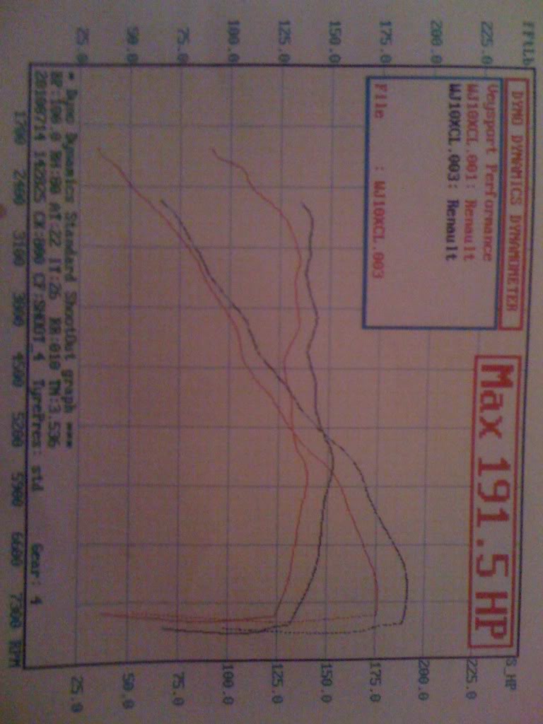

So today I wen to K-Tec for their "Clio 3 RS Tage 1 Tuning Package" (A panel filter and custom re-map).
I was primarily getting it done to see how the car was running. It turns out it wasn't running that great at all! It made 175bhp before the filter and re-map, after it was up to a much healthier 191.5bhp. To say I'm pleased with the result is an understatement.
Dyno printout below (Sorry about the pic, I just took it on my phone)
Is the car run in yet? 175 - 191 bhp from a panel filter and map?
What do the 200's make on rollers 'normally'?
Ours made 193.something bhp on the rollers 2 months ago with 2000 miles on it. standard.

Amazing how much power you can get just by changing the resistance on the rolling road ... 16.5bhp from a map & panel filter. Oh rly.
Comments like this are not constructive, its a totally unfounded, incorrect remark.
Unfortunately our rolling road is being repaired (the parts are in Australia), so we are taking cars for power runs to a local Dyno Dynamics rolling road (it is a slightly older one hence the graphs look different) only a few miles from here to maintain service of before and after runs with our remaps.
The process is as follows.
Load car on dyno,
Set roller ratio for RPM (this is taking the speed at 3000 rpm) to extrapolate the rpm through the rev range
Power run car x2 (to check for consistent result)
Load new map onto car (Still strapped to the dyno, no conditions changed)
Change filter to Panel
Re power run car x 2, checking for problems
overlay graphs to see result.
in shootout mode on a Dyno Dynamics you cant change load on the rollers.
there is NOTHING else changed.
The result is as the dyno shows, thats it.
The customer is pleased with his result, and so were we. We have to admit we were'nt expecting a gain as high as this but again this is why the result is confirmed by doing two runs back to back one after another...

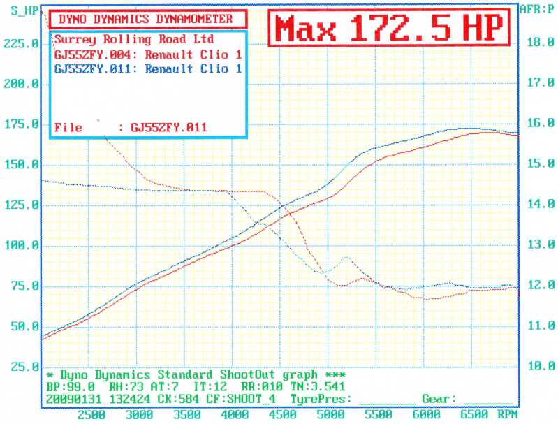

Hate to be a picky sod, but the graph clearly states that the graph is for Runs 1 & 3, although the operator on a DD rolling road can pull back data from any number of previous entries and overlay it onto the graph, as proven here by my graph from Surrey Rolling road (runs 4 & 11)...
Note, this is a Trophy with your remap, itg filter & ultra exhaust, hence my amazement when 16.5bhp was extracted from this 200...
Sir Dave, you are not being picky at all. At least by asking these questions and pointing out these findings we can answer the questions.
Runs 1 and 2 are when the car is standard and runs 3 and 4 were after the mods had been done. As you can see in the previous post we normally carry out a total of 4 runs for consistency. When our dyno is back up and running we are hapy for customers to watch their car on the dyno and see the results.
In fact we have just done another 197 today on the same dyno and in the same manner and that has picked up nearly 13bhp and 16lbs/ft, this does go some way to show the benefits of having a fully custom map done.
I hope this clarifies the graph a little more.

I agree with this but if the before and after results are on the same RR the gains must be down to the changes.
Not discrediting the result, but that is a very naïve presumption. You can significantly alter RR's in your favour to “boost” your gains!
10% power from an air filter and remap.......
But that original power figure is shocking lol
With 15 odd bhp more it should feel vastly different b
I have no experince of rolling roads so you may be right. My comment was purely down to common sense.
Ali, as we have previously stated nothing was changed on the dyno settings and to think this is something we would do is just totally wrong and naive.
You will also find that many, many 197s have been dynoed at well below their quoted figures on many different dynos. The important thing is the difference between the before and after figure and how the car drives. If the customer is happy with the way the car performs then that is all that matters.
