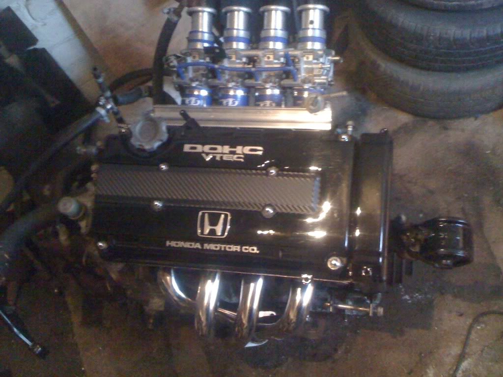

i bought a classic mini a couple of months back with a siezed engine so thought now would be a good time to fit my honda b16 on itb's

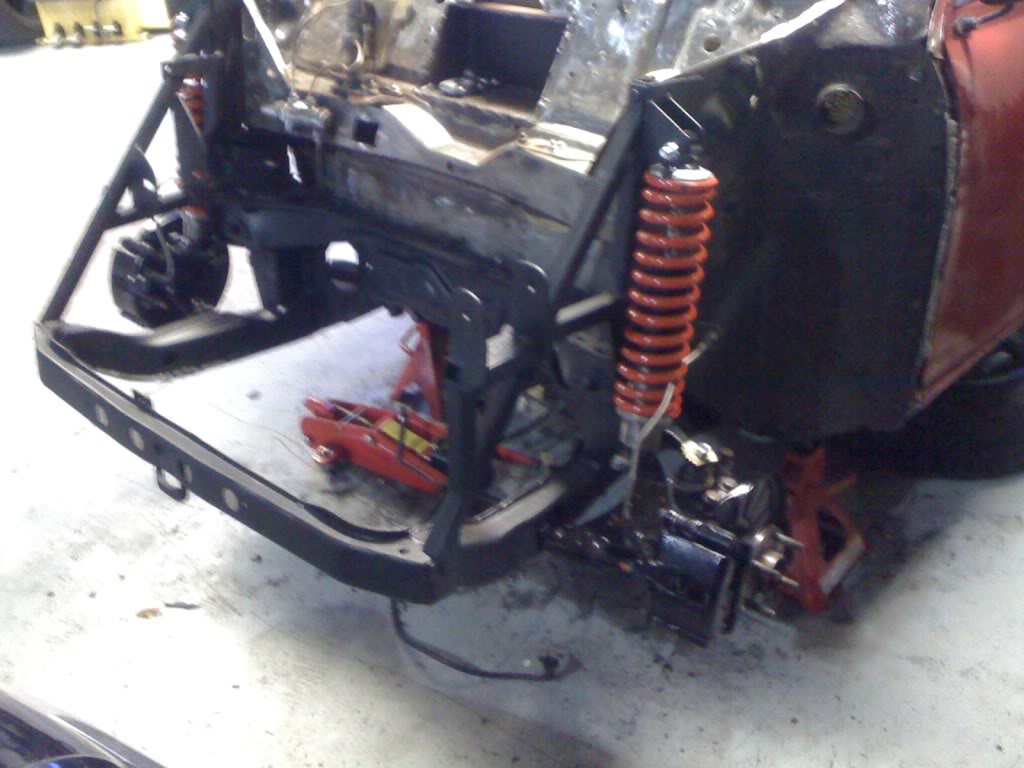

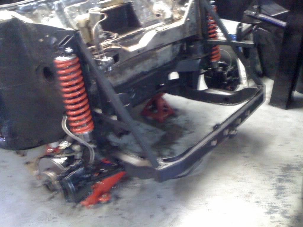

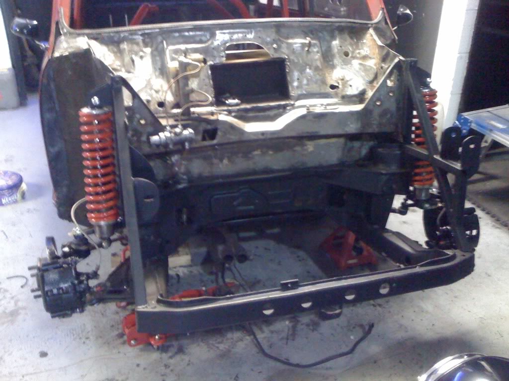

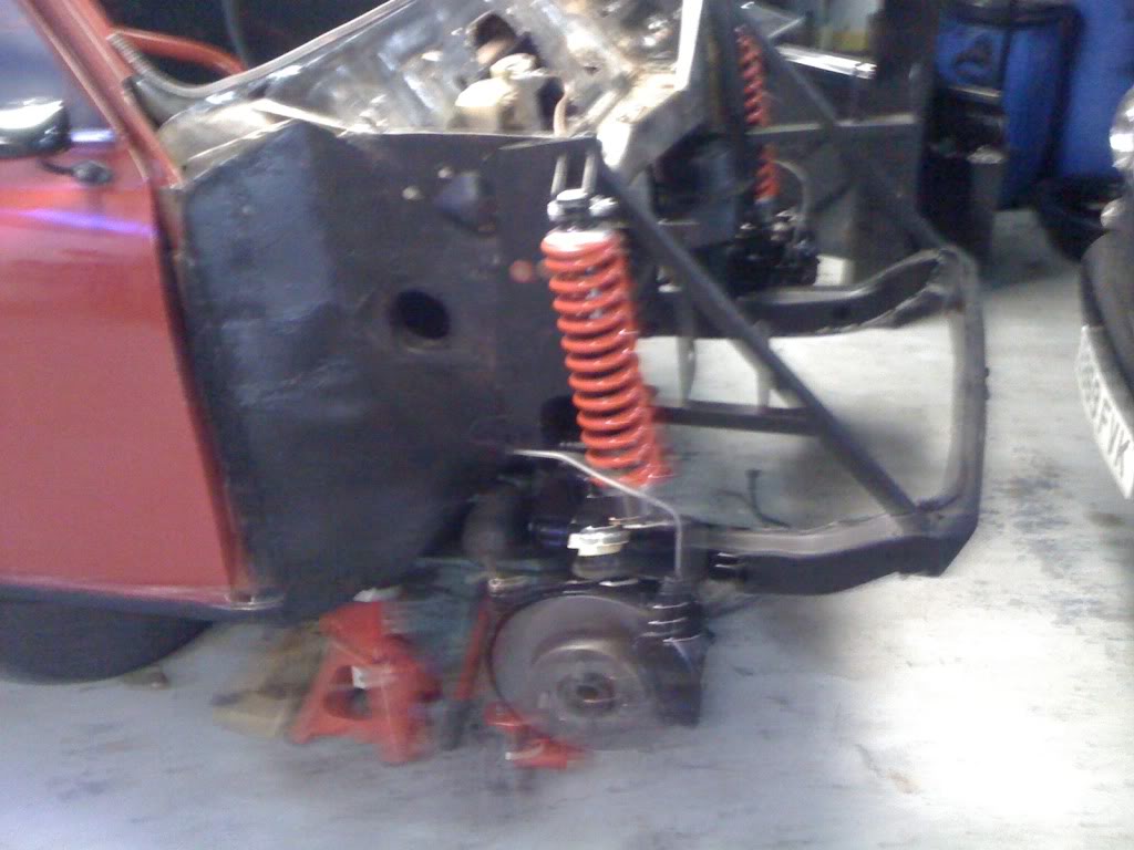

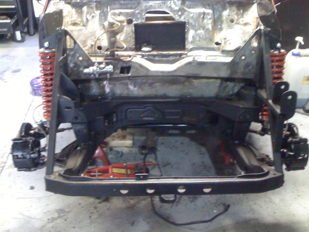

i have started work now and have ripeed the front end off and cleaned and painted all the subframe and all the suspesion and brakes up.
have fit the subframe and just about ready to drop the engine in to see where i need to cut the bulkhead for the itb's :)
heres where im up to now

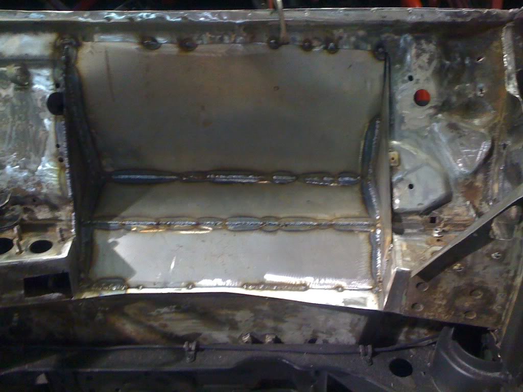

You might get away without chopping more out of the bulkhead - the original Honda inlet is quite a hefty lump, I would have imagined the TB's won't stick out as much??..

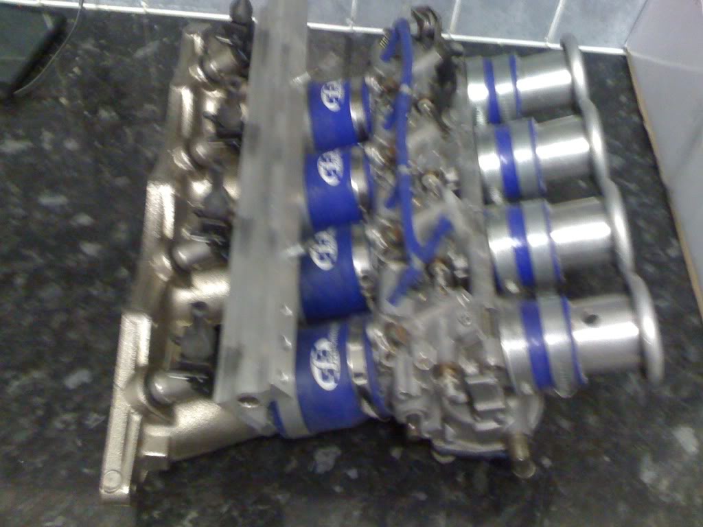

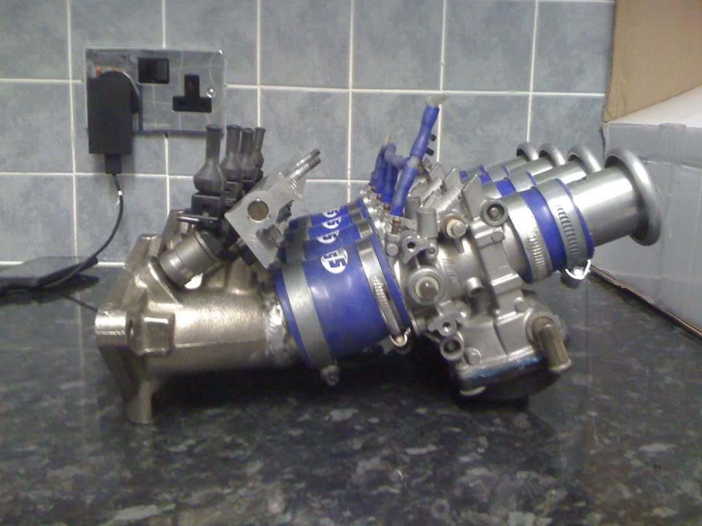

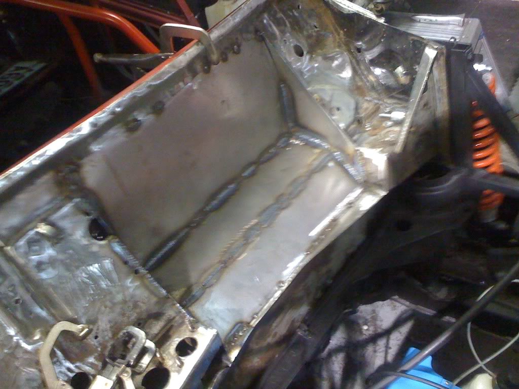

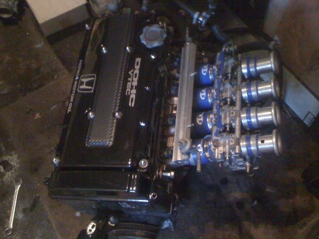

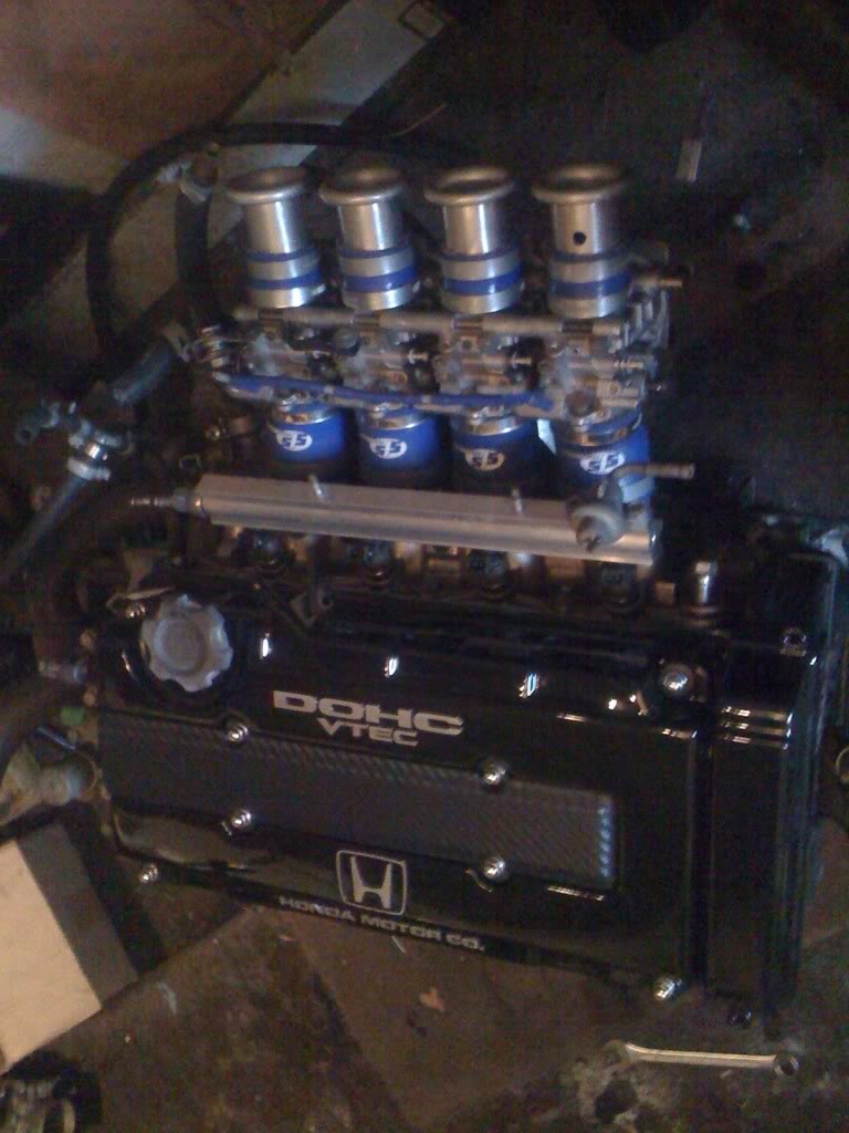

i have sent the itb manifold off to get cut and angled up at 30 degrees to help with clearance and i have cut a nice size hole in the bulkhead as i want to fit some kind of enclosed airbox to keep the noise down at tackdays.

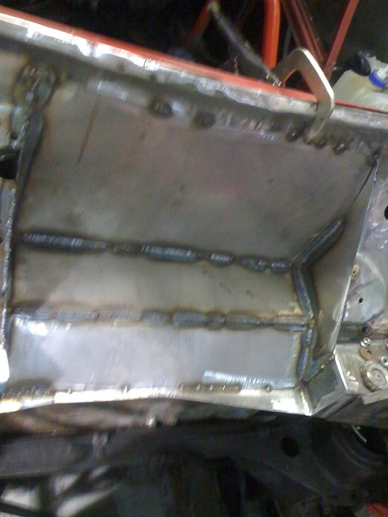

a little update we have cut out the bulkhead and boxed in the area where the throttle bodies will sit, have made it nice and big so i can fit some kind of airbox to keep the intake noise down a bit at trackdays:)

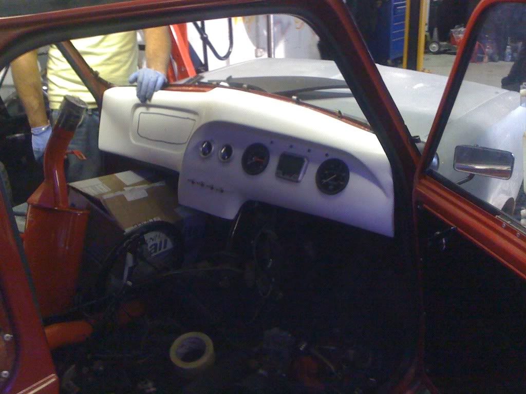

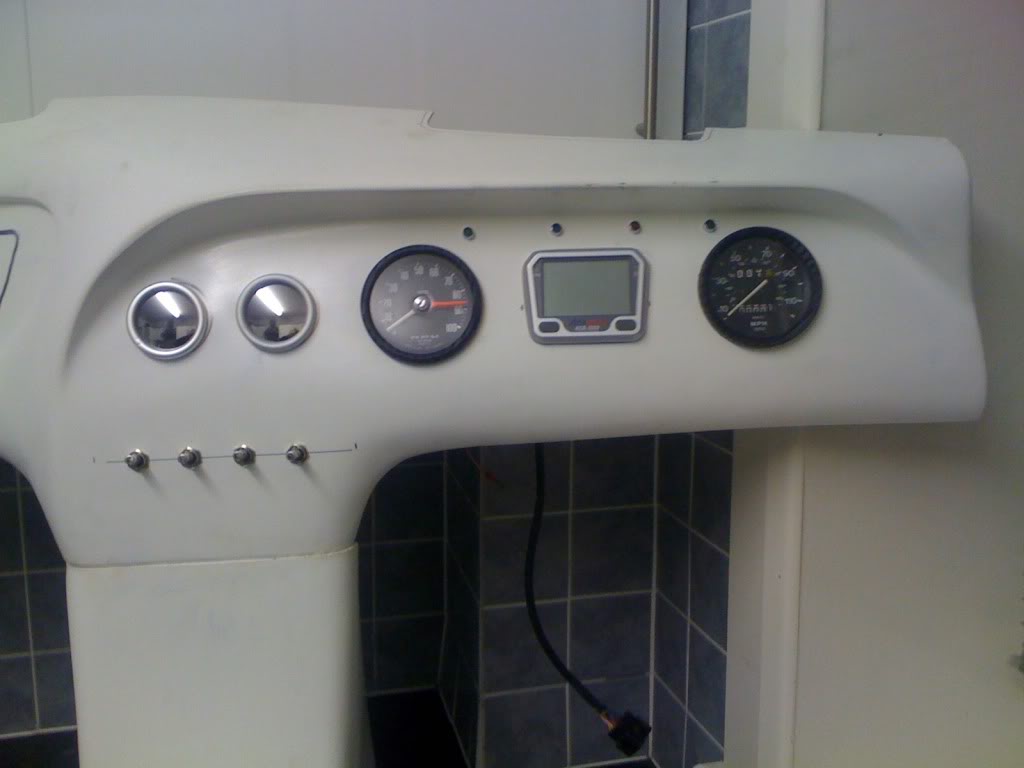

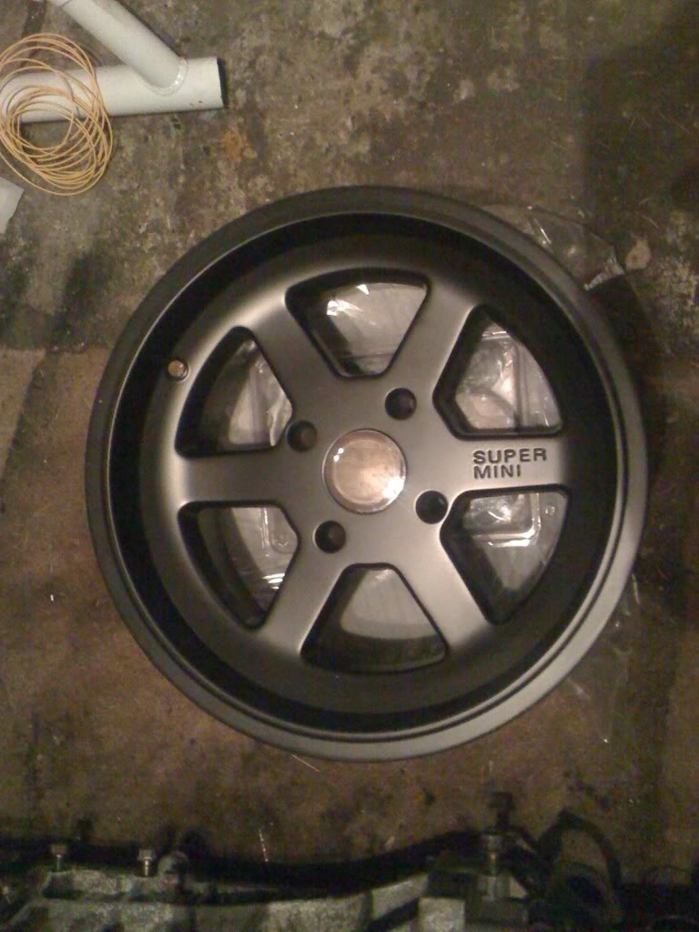

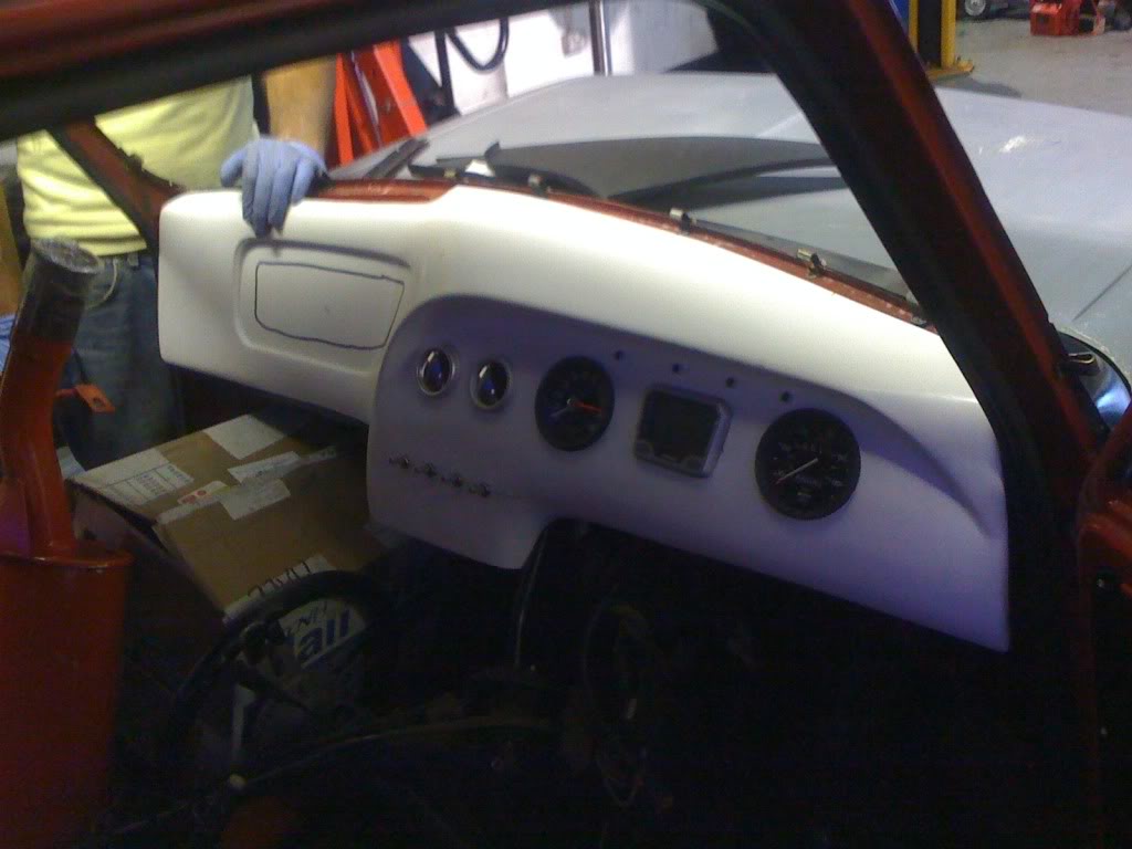

little update, i have ordered my braided fuel lines and uprated fuel pump, my new arches have turned up and are a massive 8" wide ,will be trimmed down to the wheel though which should be aound 5" once done. new wheels have also arrived :)

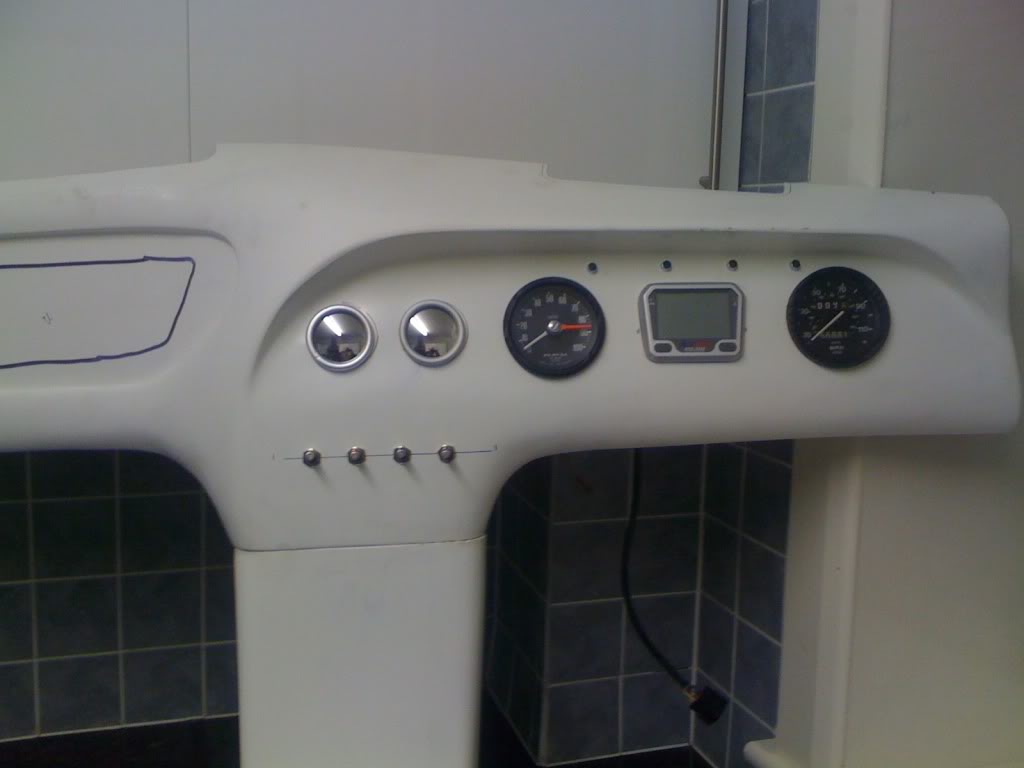

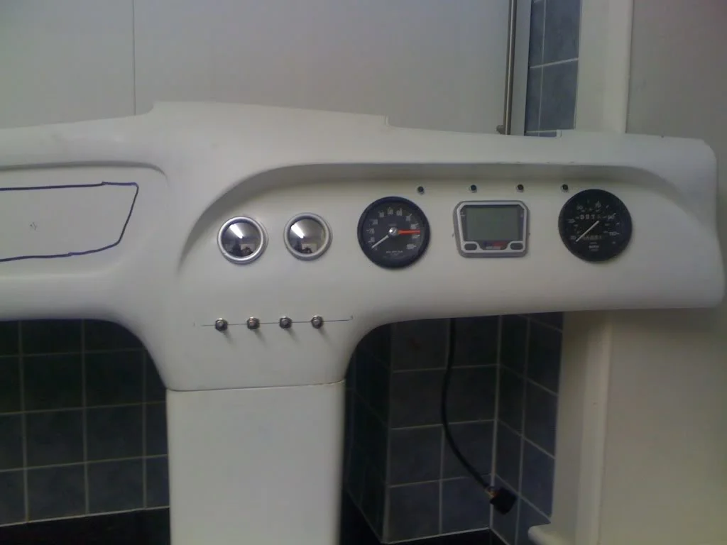

i have been waiting on the scuttle panel being welded so have been pottering with the dasboard to get it ready for flocking net week :)
heres a couple of pics of how its roughly going to look
by the end of next week i would ideally like the scuttle welded on along with the a panels, fingers crossed

Looking good matey... Is that an acewell dash?...
Take it you've gone for the extra wide miglias?.. I originally bought a set of these but they were horrendous quality..
Where are you sending you dashboard off to get flocked??..

cheers mate :)
the arches are the extra wide miglias and tbh are better quality than the arches that are already on the car.
the dash will be flocked by yukspeed as they did a good job on my 172 dash last time.
tthe dash is the acwell 3250 which should be ok for what i need.

a couple of pics of bits i have got and done to go on the car :)
the dash
powder coated and laquered rocker

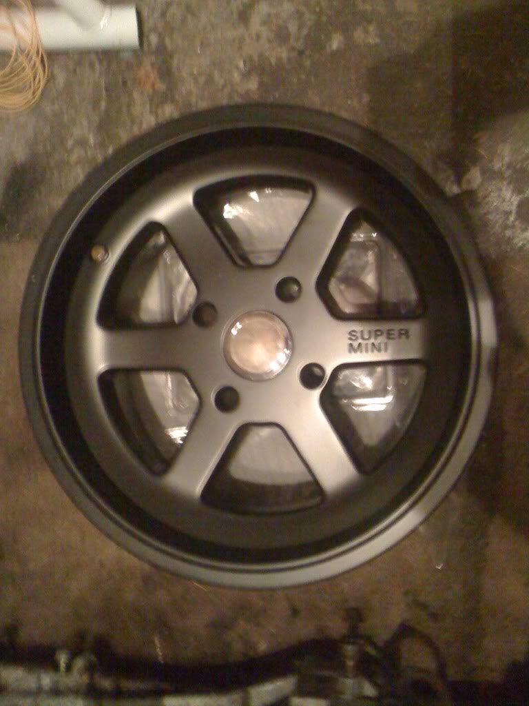

and the new rims :)

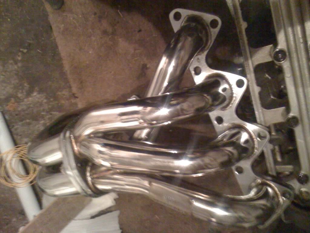

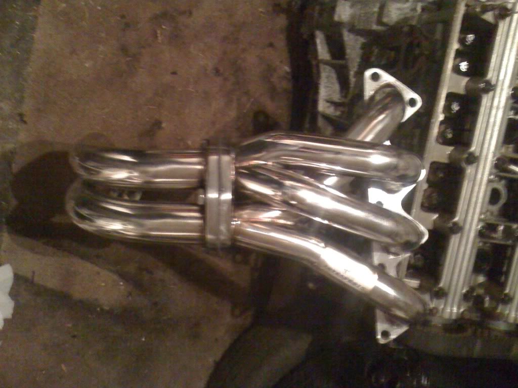

and my shiney new manifold

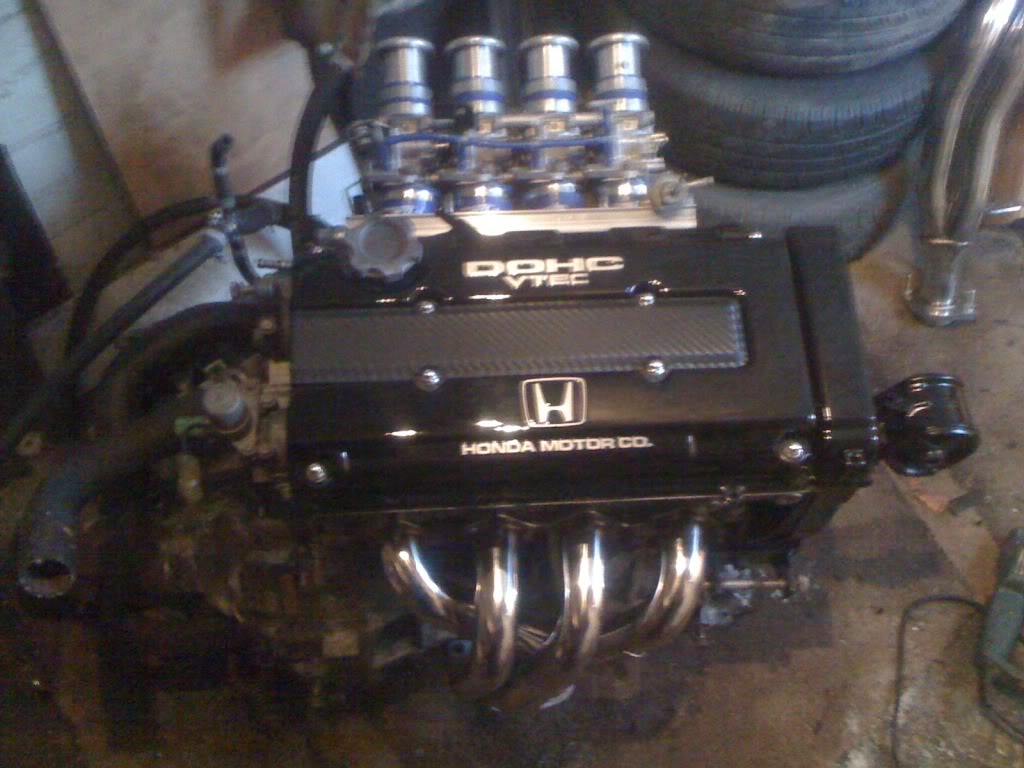

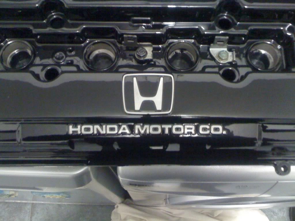

little up date engine bay is pretty much ready for paint and then i can start to build back up for the last time :)
also the engine is all together less the alternater.
  Inferno 182
You should get 170 out of that no problem. What ECU you running? If your going DTA, you can run two maps and switch it when the cams come on (I've got a copy of this Map if you want it). A B16A2 like that should Vtec at 4500 no hassle if only pulling a mini shell. I'd messure the Exhaust manifold. Standard downpipes dont fit the Kseries (Watsons) Subframe. You'll probably have to butcher it slightly. They are awsome, but dont go overbord with the offset on your wheels or it'll be undrivable :cool:
yeah i have the dta to run it off of which came off a converted mini with a b16a2 so will need a tweak for the throttle bodies which rs tuning will be doing for me :)
wasnt aware of the manifold fouling the subframe so will have to check closely when i test fit towards the end of the week.
thanks for the offer of the copy of the map i will give you a shout if its needed.
hmmmm bugger just measured the manifold and it 2.5/3cm deeper than stock, will be close if it fits if not then more modifications with the welder lol
