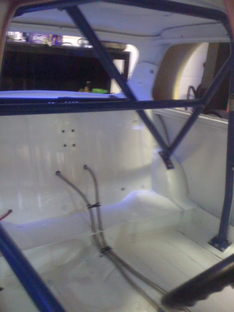

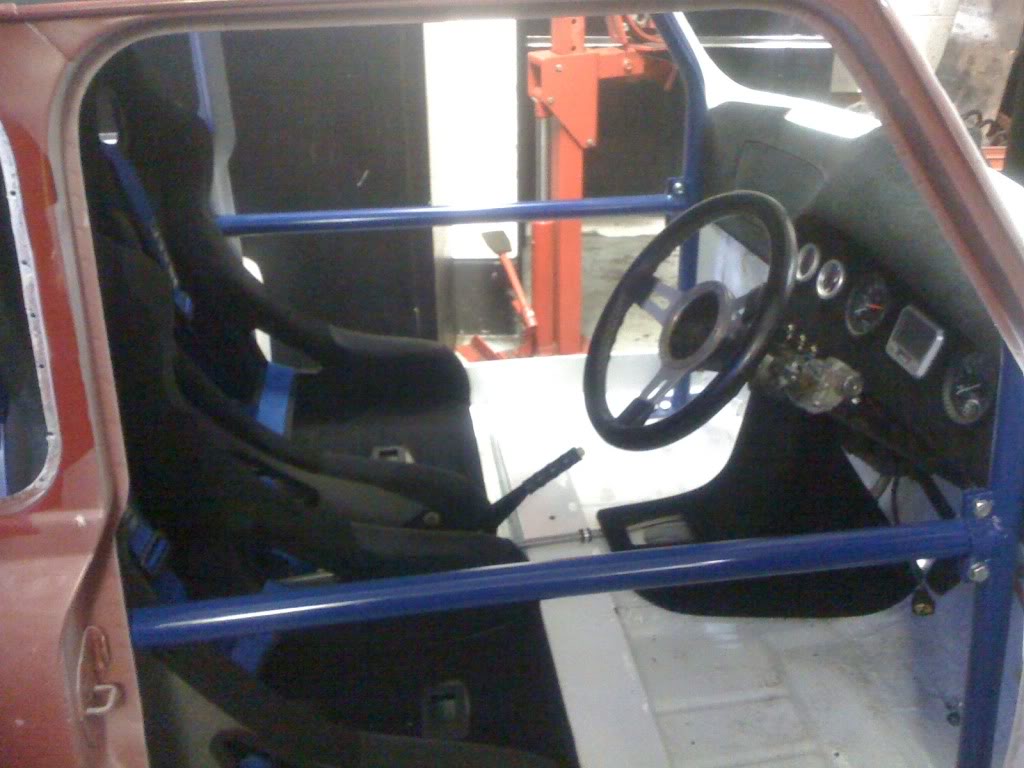

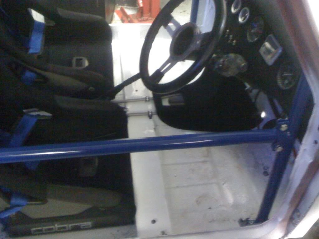

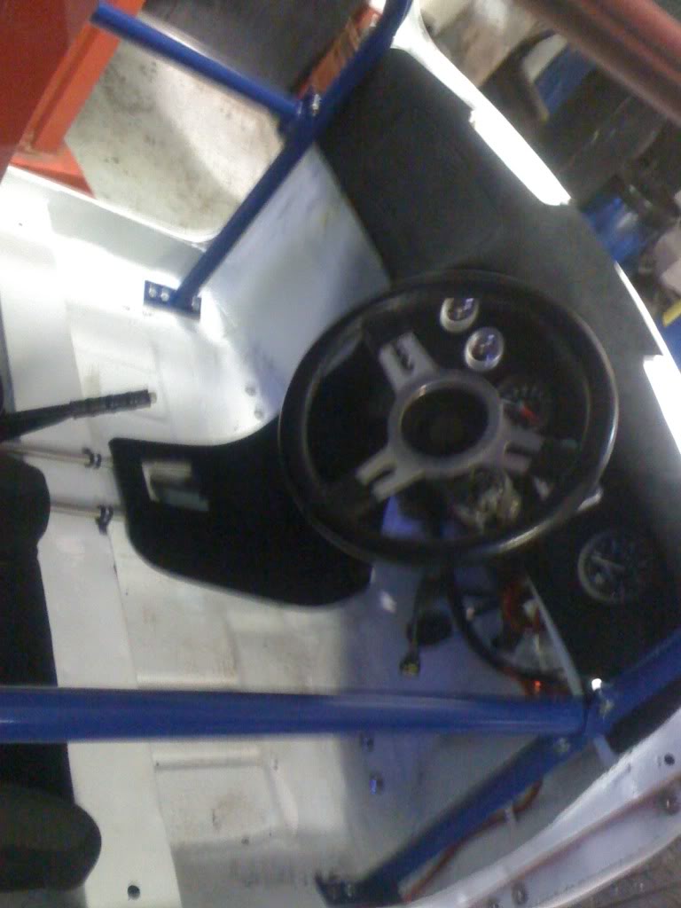

had a nightmare of a day today, managed to crack the dash, scratch the cage and floor getting the cage in so tbh im pretty pi**ed off :(
a few pics of where i got to, had to walk away as i was getting stressed and would of thrown a tantrum at any time lol

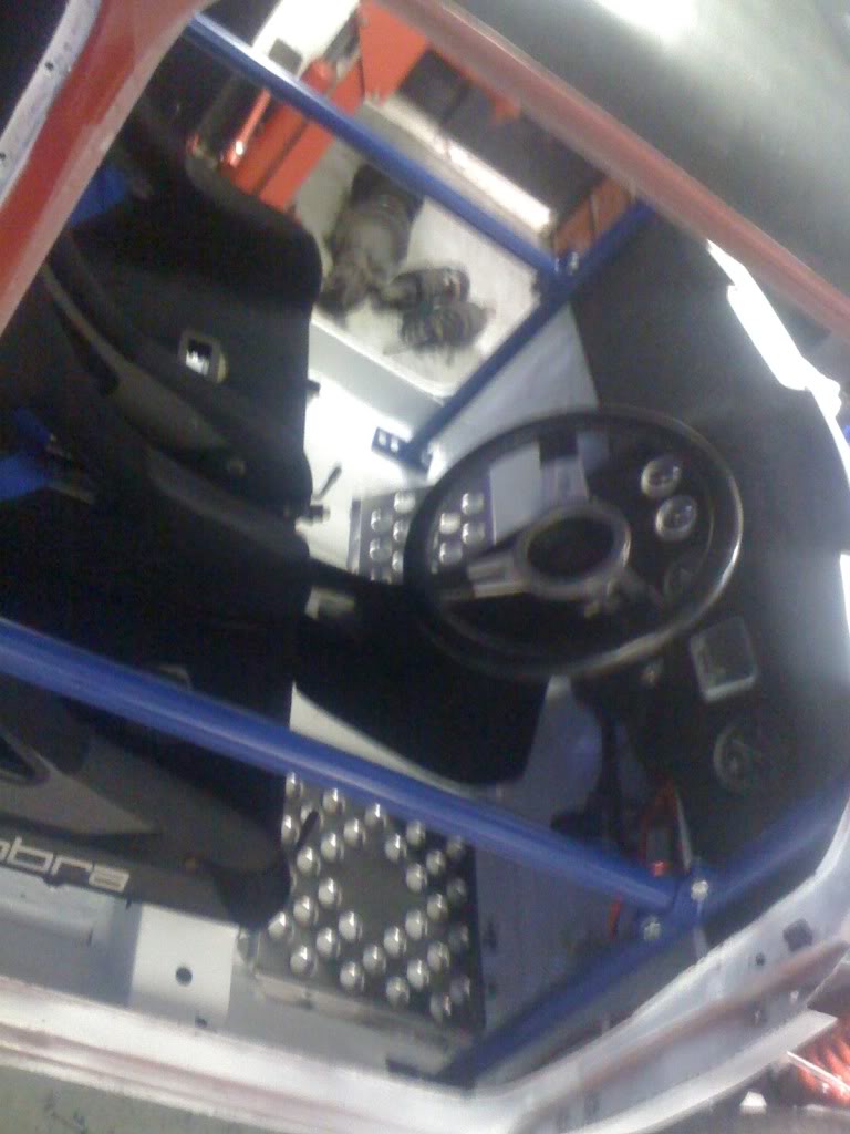

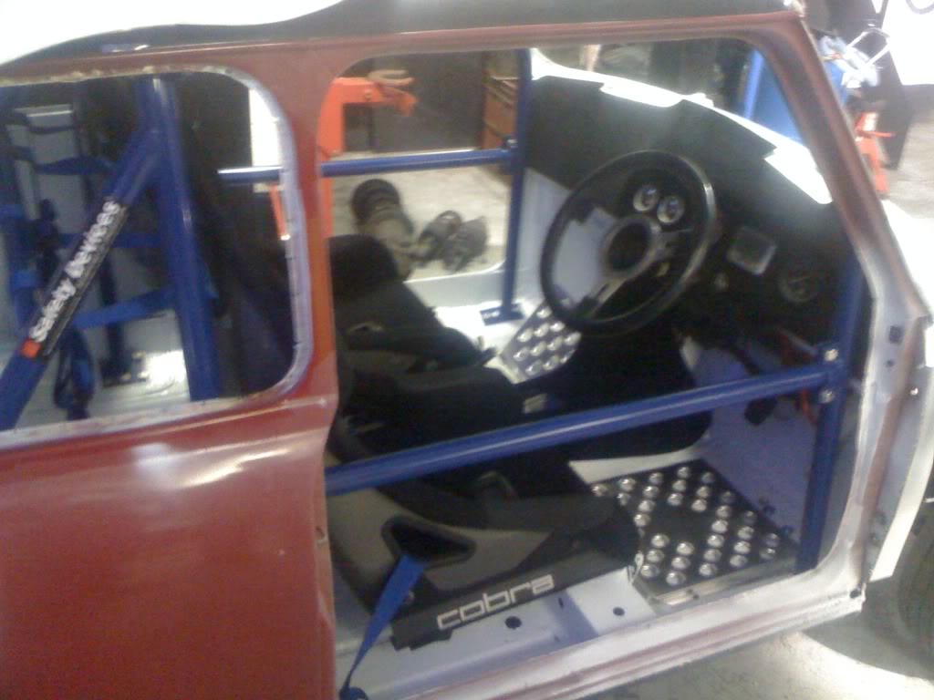

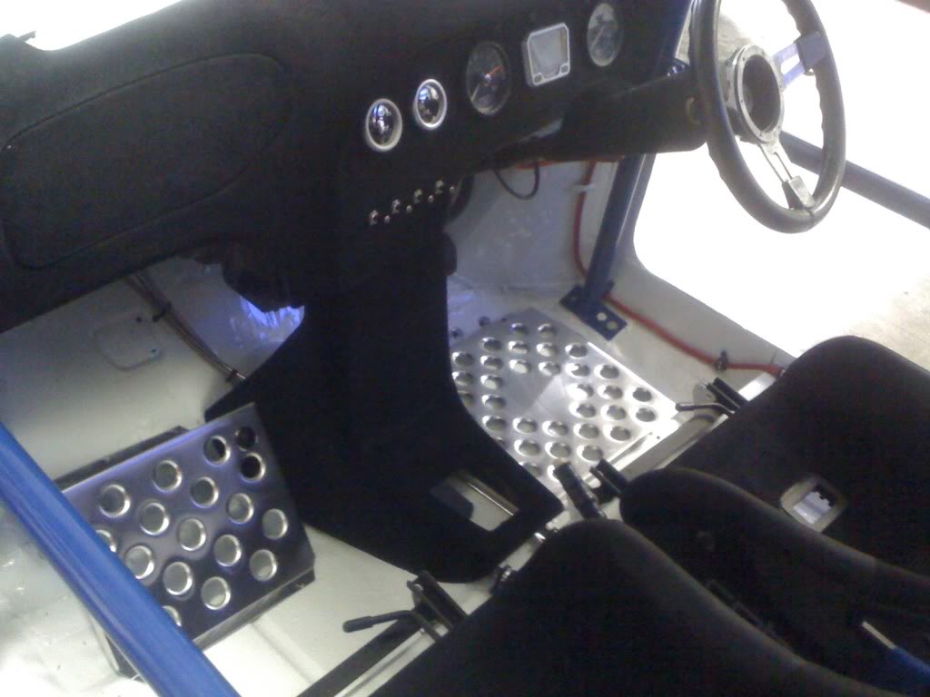

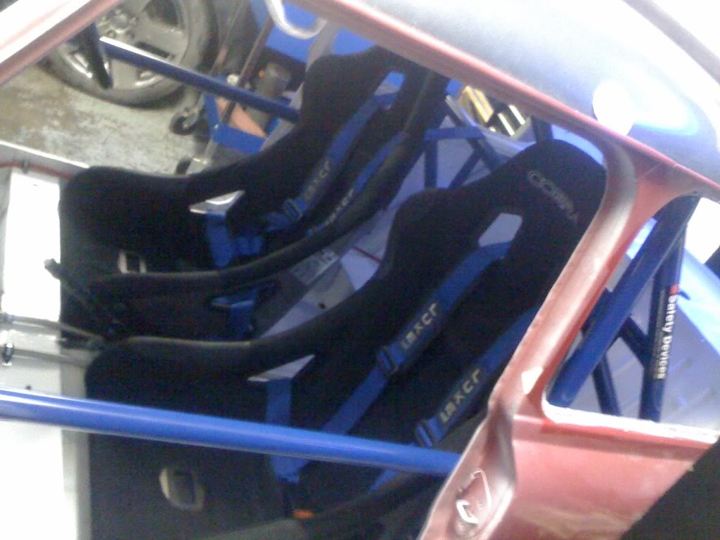

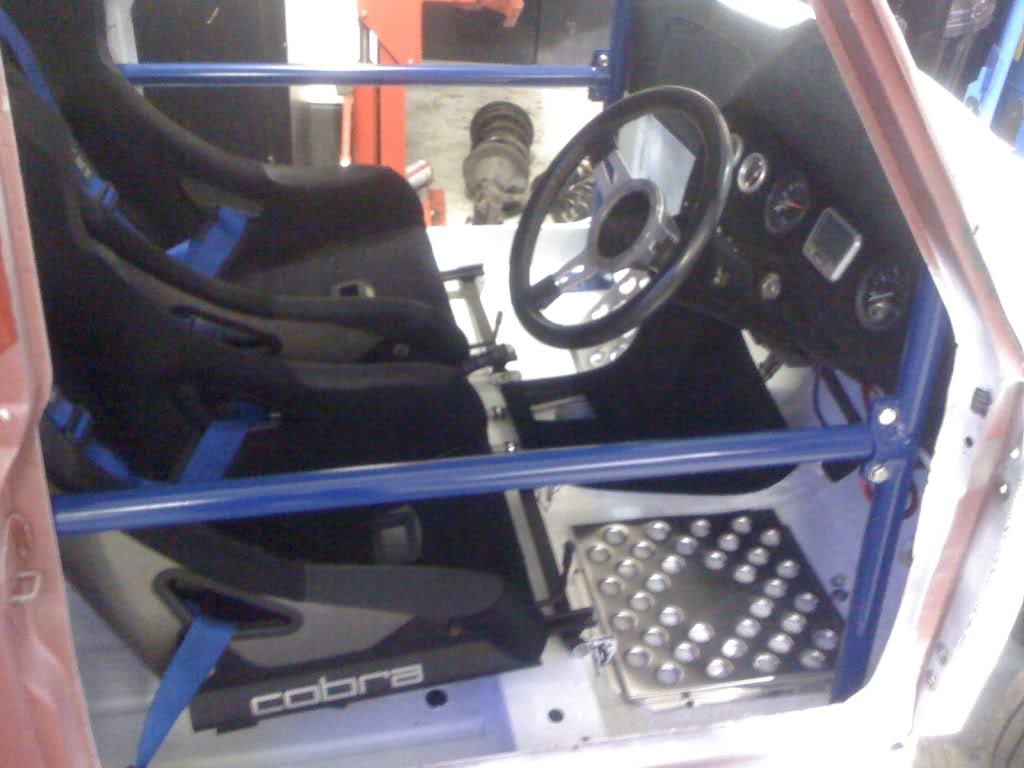

did a little more today, got the seats mounted properly and the harnesses in.then put drivers and passenger foot rests in.
starting to look like a car inside now :)

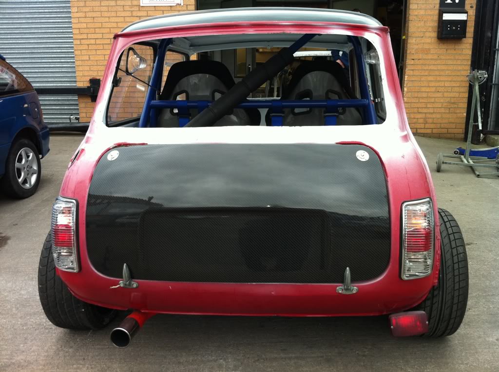

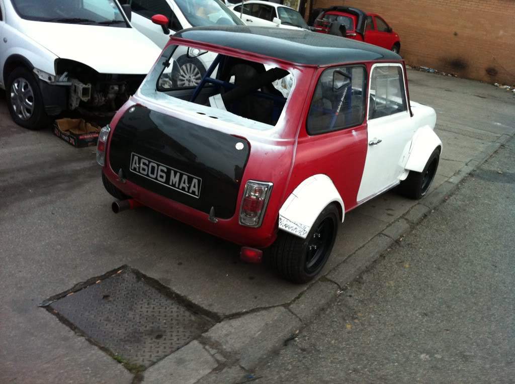

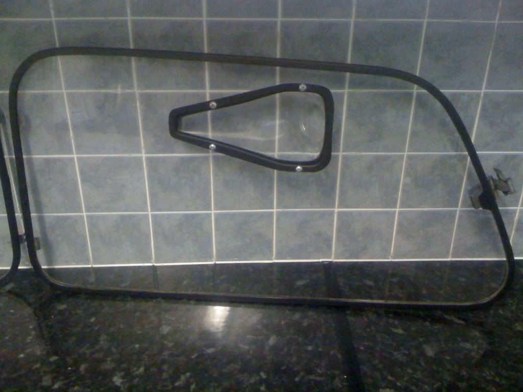

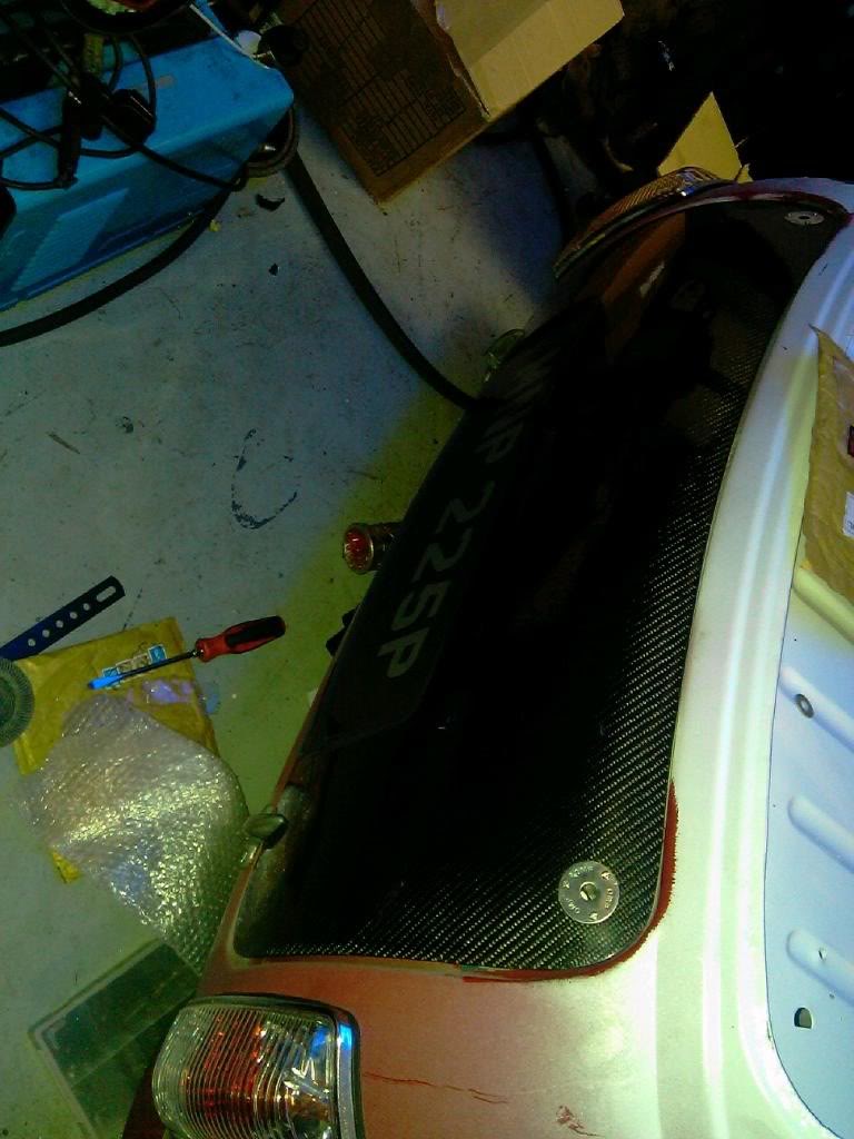

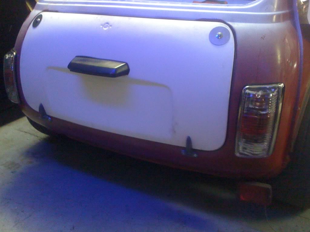

managed to motivate myself a bit and drop the engine back in and fit the single skin fiberglass bootlid. also got my new rear windows :)
bootlid locks are to be modified with smaller carbon plates when i get around to it

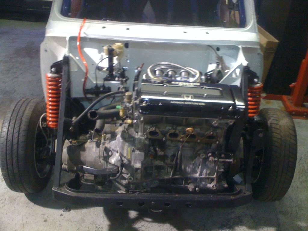

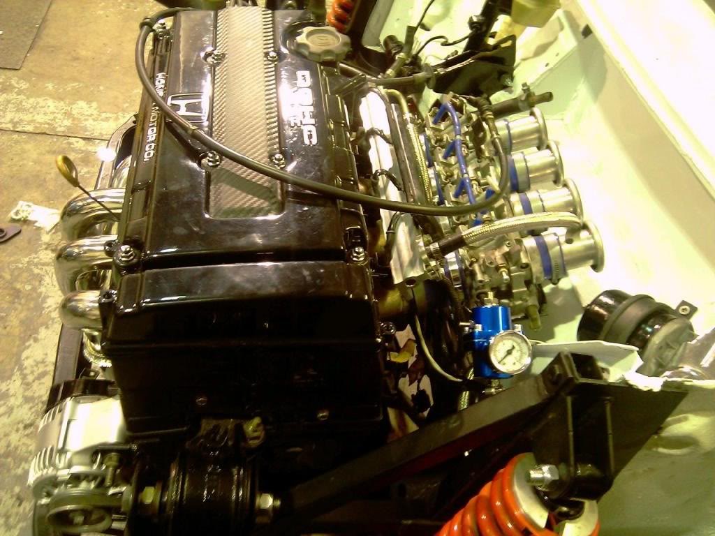

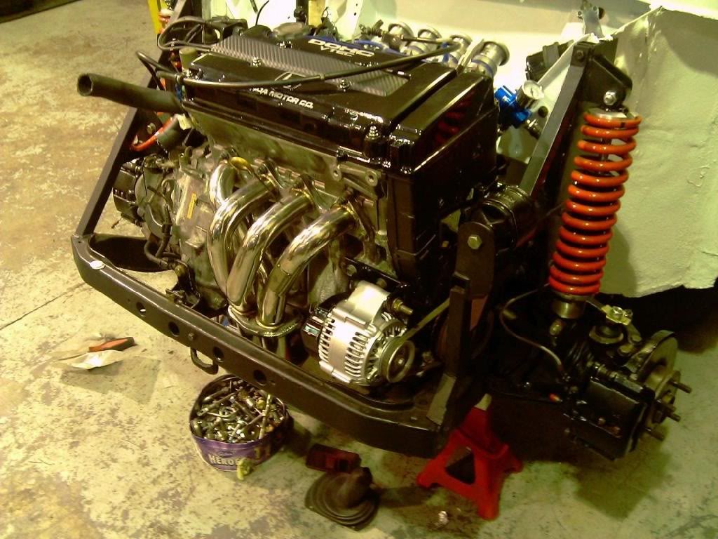

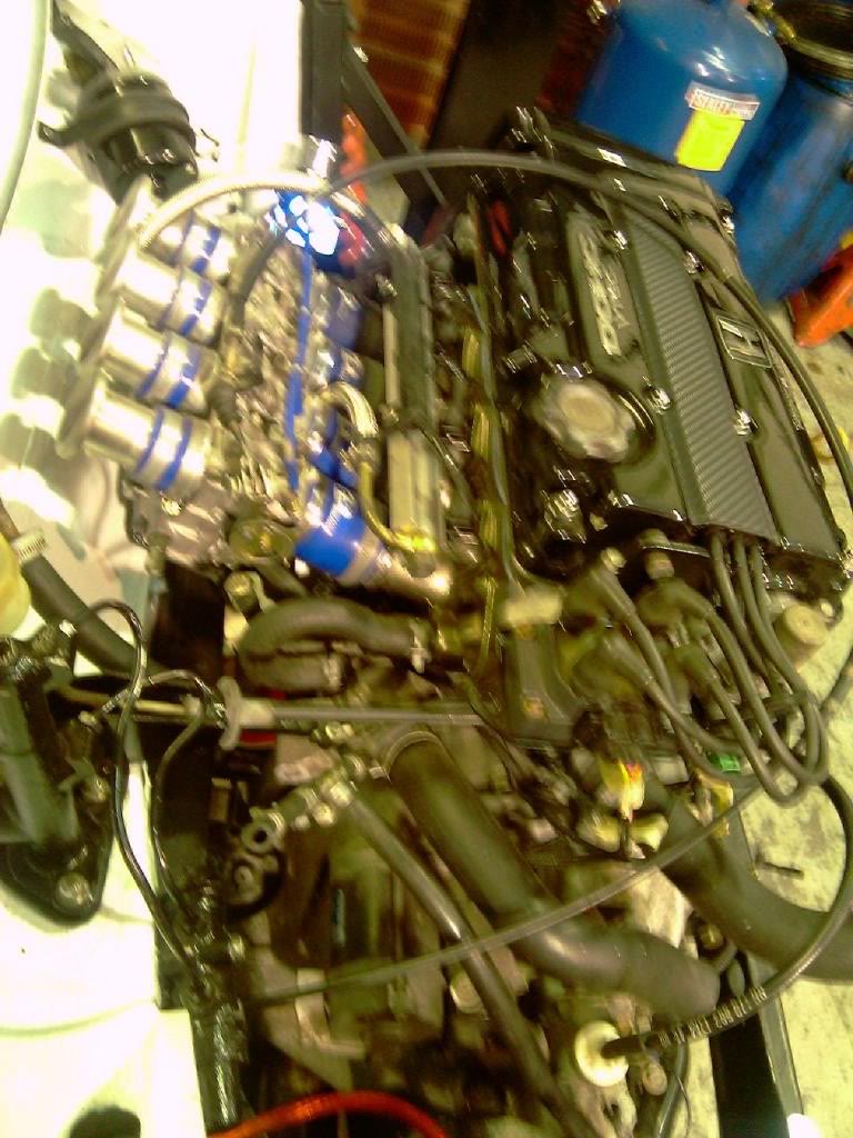

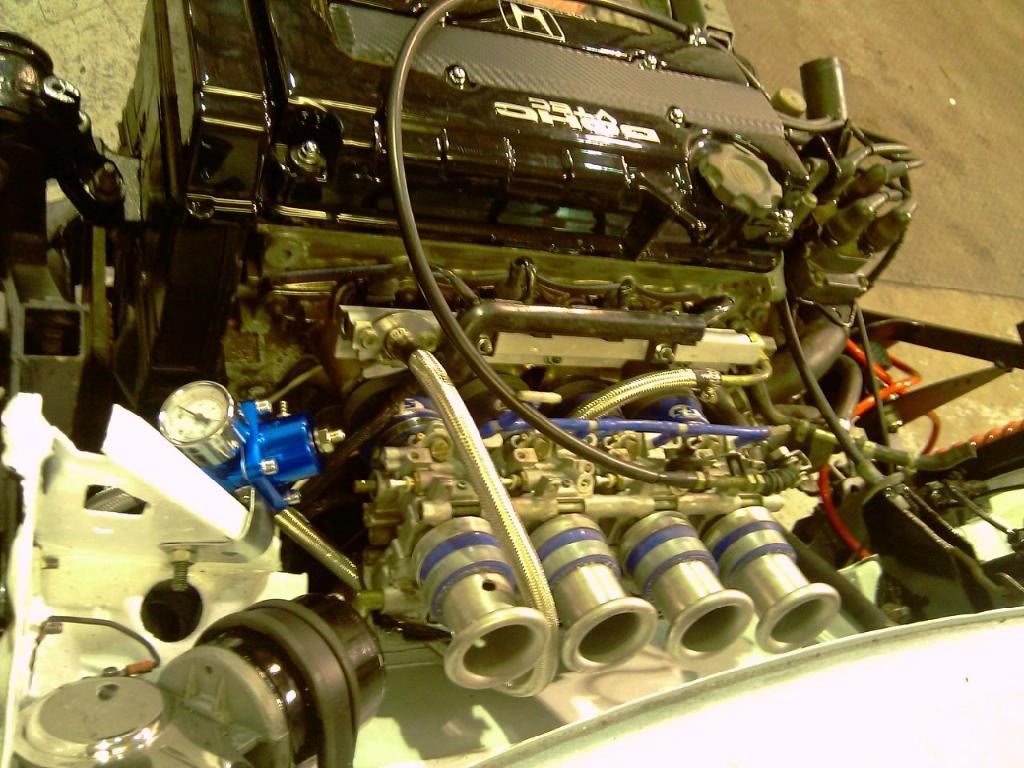

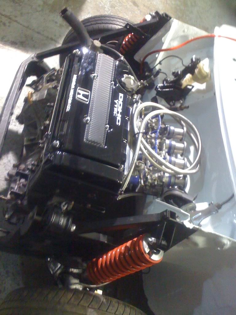

managed to get a few pics of what i have been up to on the mini lately, it doesnt look like much but its all the little fiddley jobs that seem to take forever,this week i have managed,
fit fuel pressure regulater,
connect the engine loom and connected to ecu,
final fit on the fuel tank and all the fuel lines onto throttle bodies,
fit alternator and belt,
clutch cable and mechanism,
accelerator cable,
by the end of the week i need to sort out inlet air temp sensor feed for the fuel pimp from ecu and then temp fit the radiator.
then hopefully i can get auto electrician in early next week to wire the alternater, starter and ignition for the ecu then fingers crossed i can have a go at firing her up.
wish me luck :)

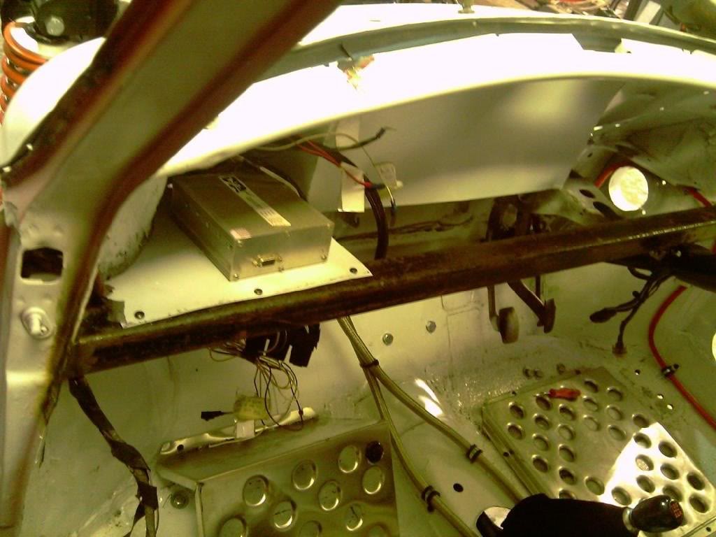

i also removed the tin can bar that goes across the dashboard and replaced it with some solid box section.

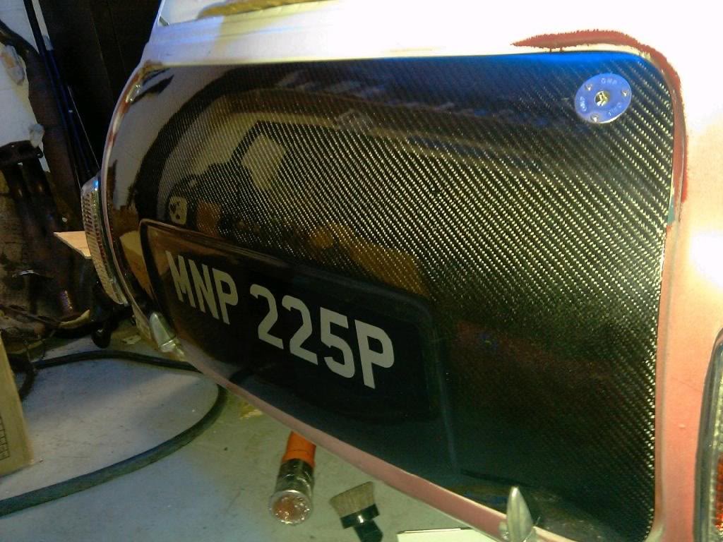

also received my carbon fibre bootlid today

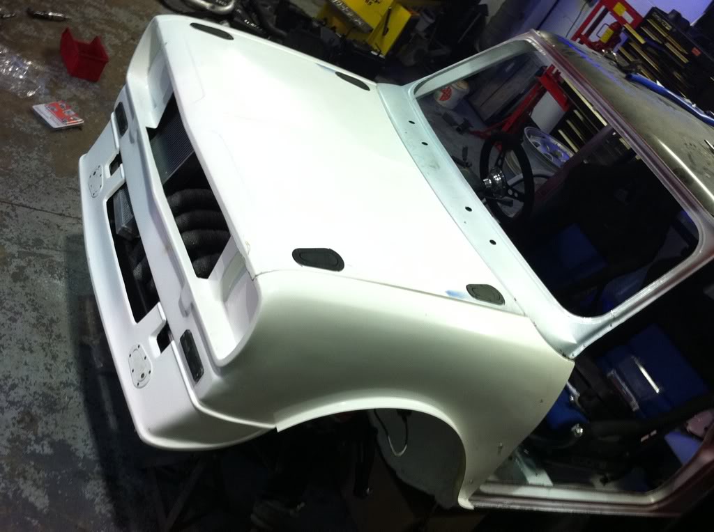

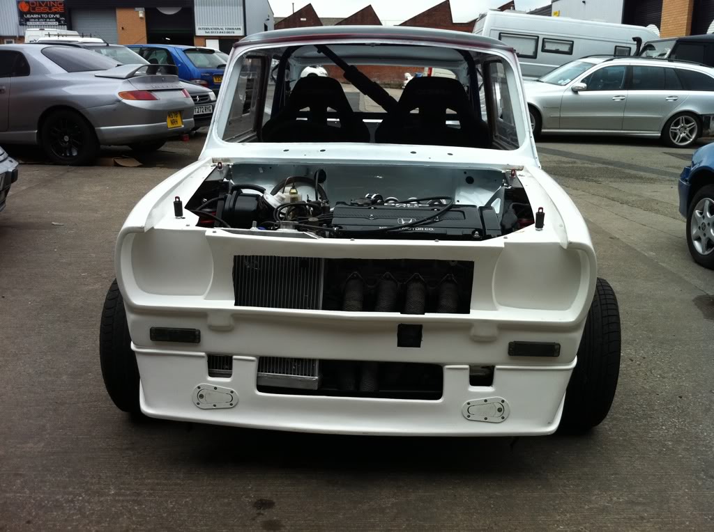

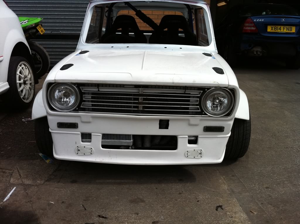

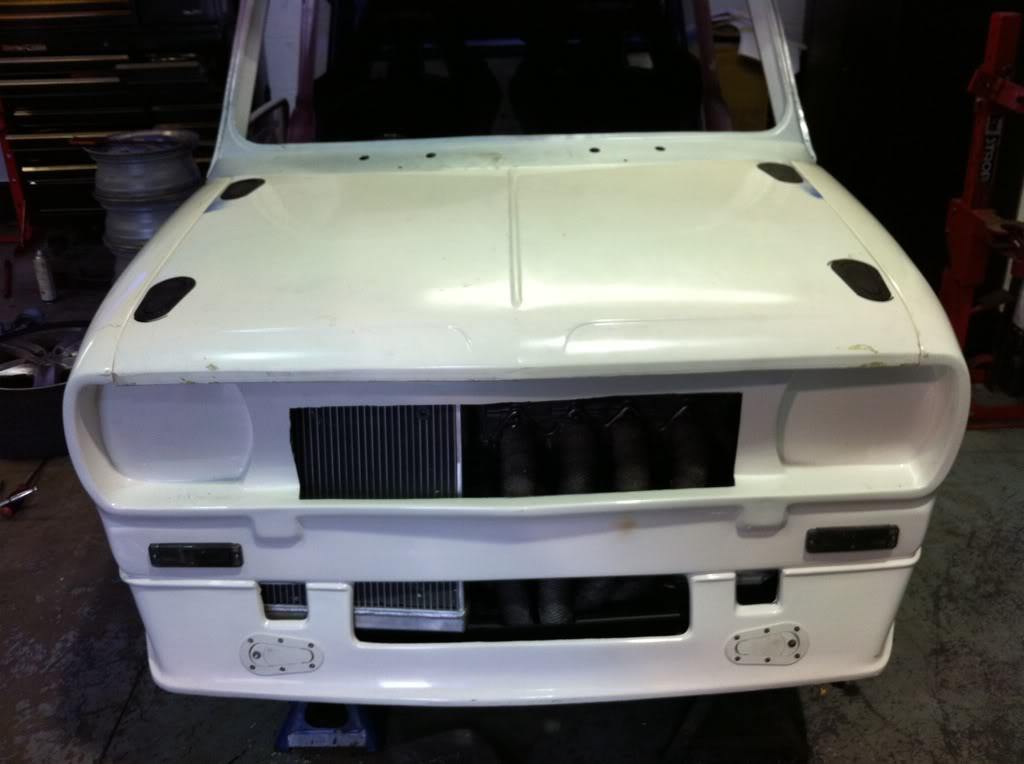

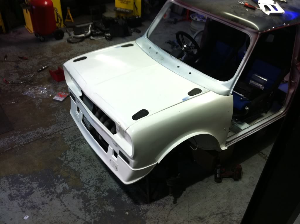

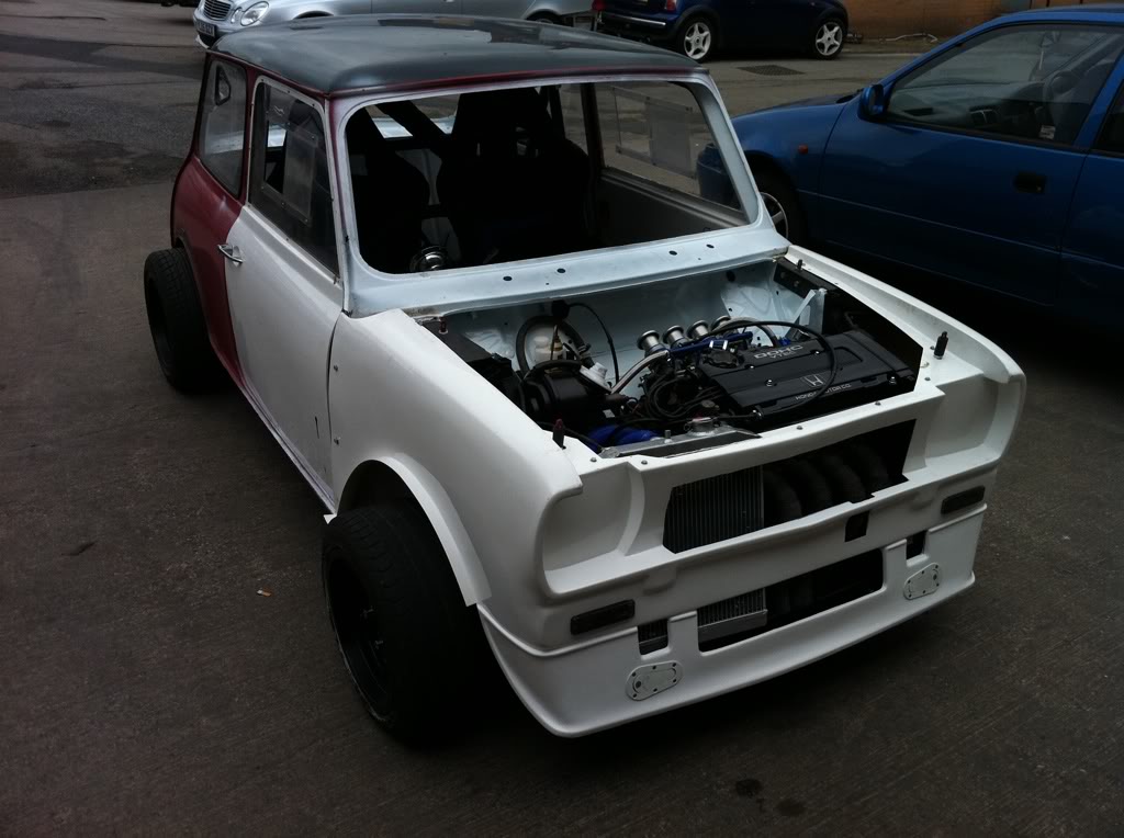

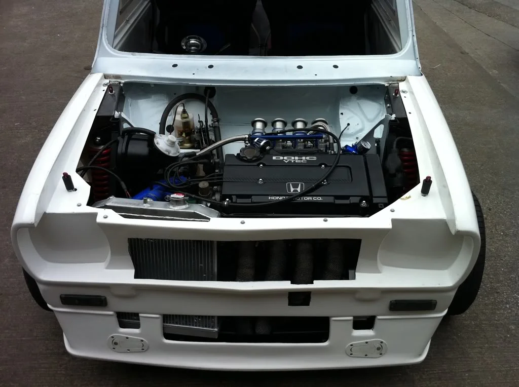

done a few more bits, have got the full front end fitted which was a job in its self but got there in the end :)
arces a seriously wide :) will be trimmed down to match the width of the rim :)

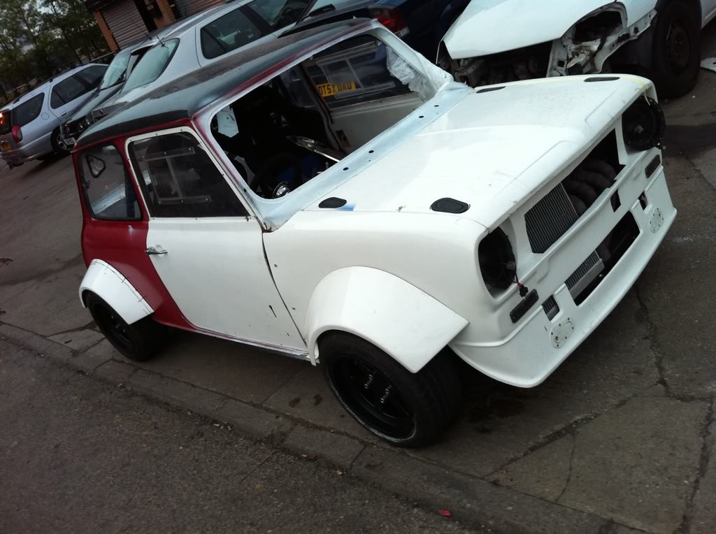

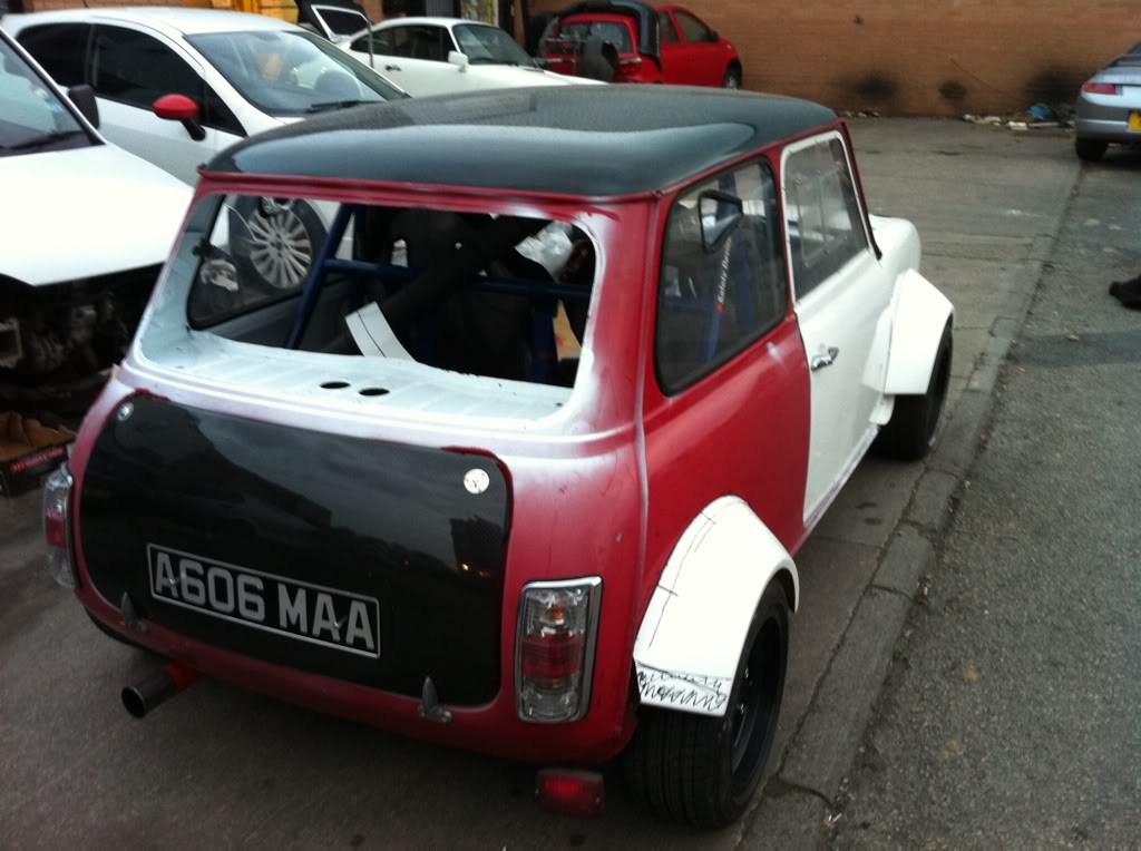

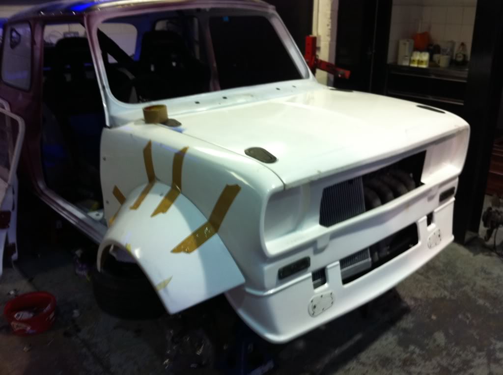

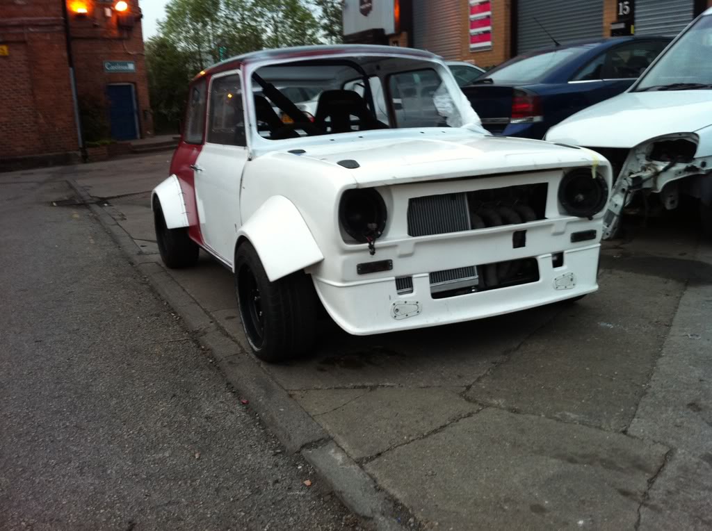

a little update, started fitting the arches which is a right pain in the arse but think its kind of giving a rough idea of what it should look like, will be a white car with black roof and black arches

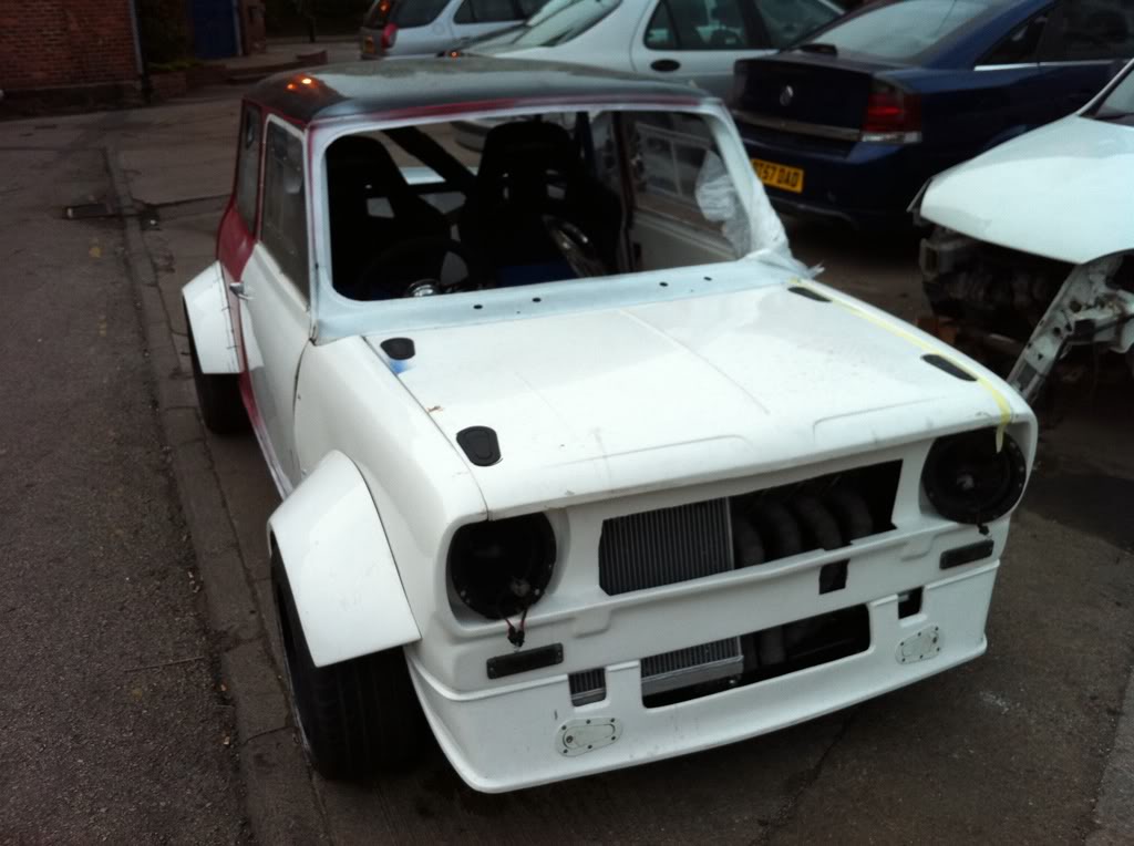

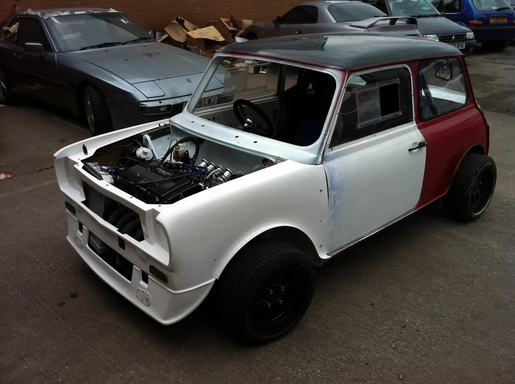

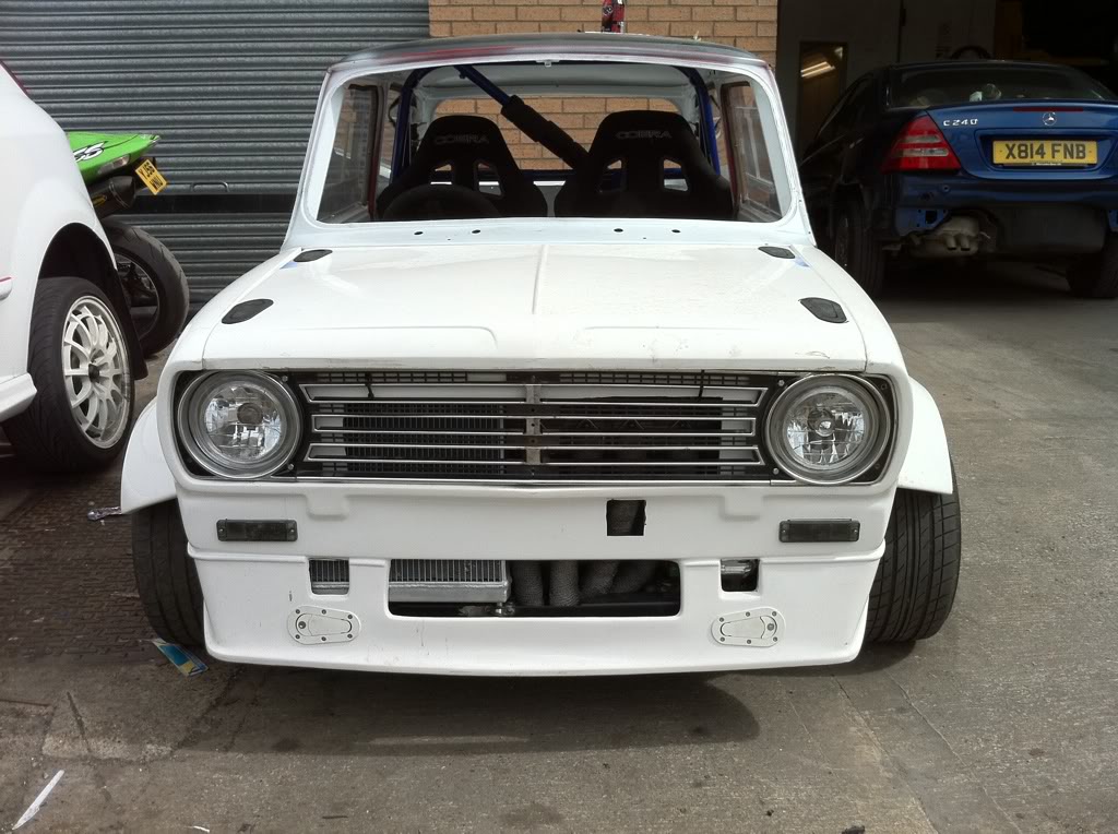

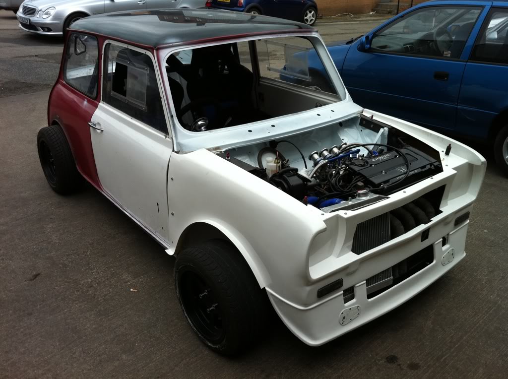

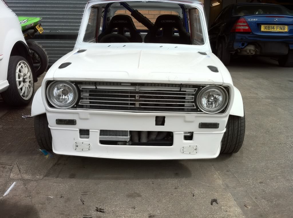

got a little bit more done today grill and headlights are now in so can see what its going to look like less the cibie oscars i have to fit at the end
