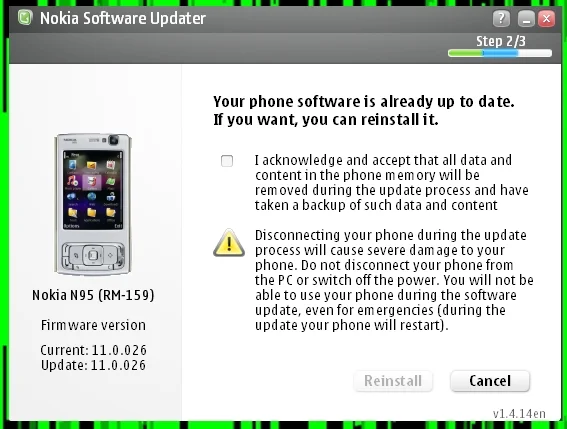

It says I have the latest firmware, but surely its not as version 12 is out isnt it?

what network are you on? it might be a case of having to change your product code to a generic one. some networks take a while to approve/tailor the update to their own settings etc. a generic code will bypass the bolocks, and get you the lastest software.
  M135i
just changed prod code with nss, updated to v.20. happy bunny!! :) apart from having to tune the f**king thing to how i like it grr

This is the product code you will have to change it to (0536062 EURO1 - Plumb)
NSS is a piece of software you need to download here and this is the video to guide you through it here.
It is really easy.
