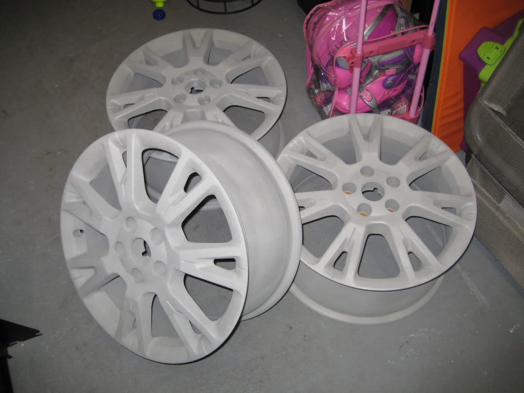

Naked 197 Speedlines!
Steve
  ST3 8.5
What colour??
Think i'll play safe with a satin black for future ideas???;)

ooh i forgot to reply to your text, the rough surface is due to them using a harsh media to blast them (ie sand) prime them first and see how it is, if still rough use a filler primer
powdercoat covers the "roughness" and creates a flat smooth surface
  Clio 172 RS2
Gun Metal / Tungsten Grey imho
Powdercoat FTW, glasslike finish depends on baking and or giving the Powdercoater clear instructions on what finish you like! Or else a reet orange peel...
Instead of coarse sandblast a chemical strip would be in order.
Be wary of powdercoating - the finish is VERY soft and scratches/ swirls very easily - IME. Especially visible on the black M400 wheels of my mate's Noble.
+1 for chemical dip over bead/sand blasting...

Playing safe as they fit 200 & R26r;)
