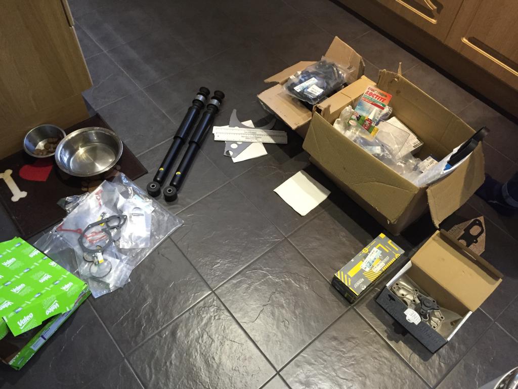

That's not all of themNice haul of parts there pal :smiley:

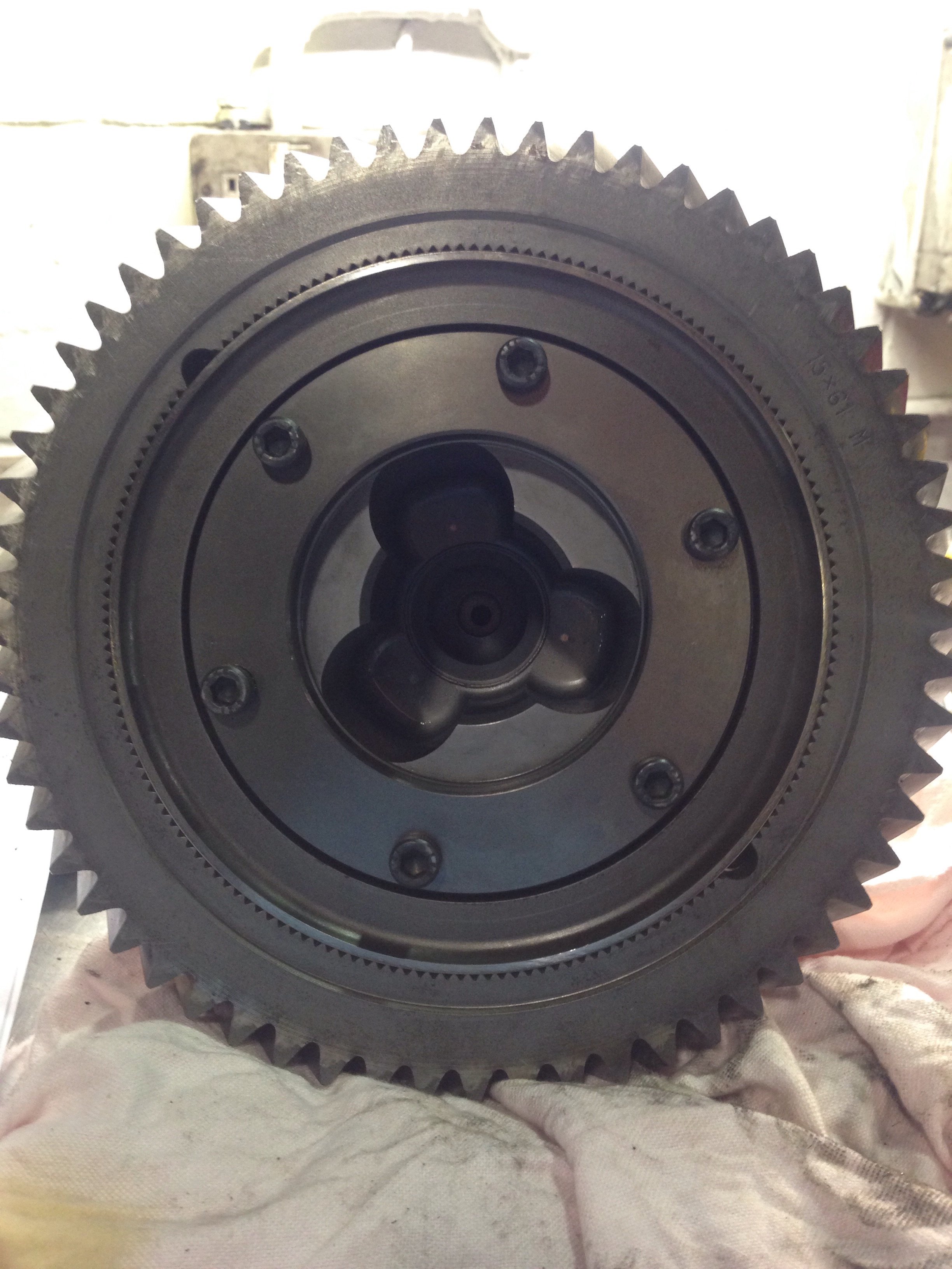

What areas in particular mate? Quaife or the torsen? I've no experience of the torsen diffs at all, but the quaifes require the crownwheel/diff machining to effectively lock the crownwheel to each other. It's a half and half job, so 50% of the ball bearing is in the crownwheel and the other 50 is in the diff - hard to explain, so I'll take a pic of mine and put it up so you can see mate. If your wanting a Quaife let me know as I can get them for an all in price (diff+machining and fitting of cw+posted back to you) but be aware they're dearer than the torsen.@NorthloopCup Can you give me some pointers?
Am interested dependant on price?? Thanks for the info buddy, you got anything on the JC5?View attachment 122751 @nath&alex - Here's one I made earlier. Lol! Didn't know I'd got one on my phone. See the 2 half moons? They're the ball bearings I'm on about. Then it's just a bit of loctite and a press = job done.
Your looking at about £1030 mate all in. Like I say - pricey.Am interested dependant on price?? Thanks for the info buddy, you got anything on the JC5?

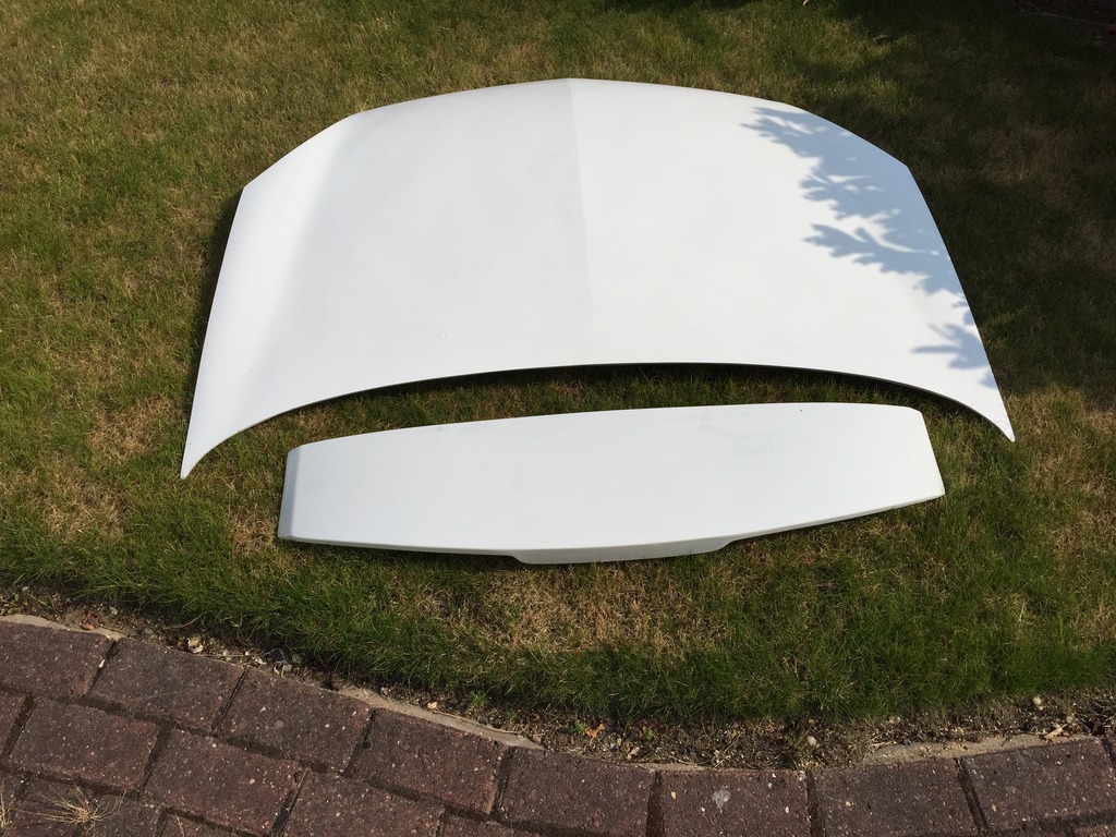

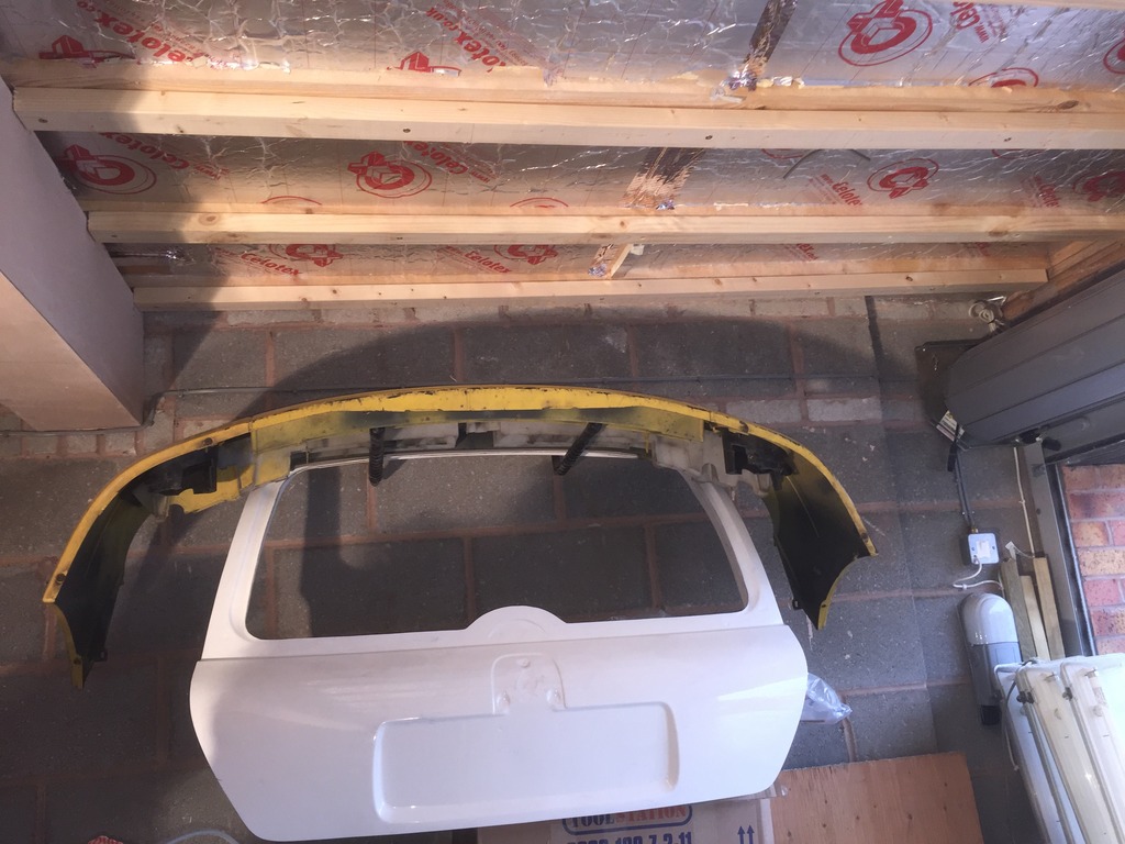

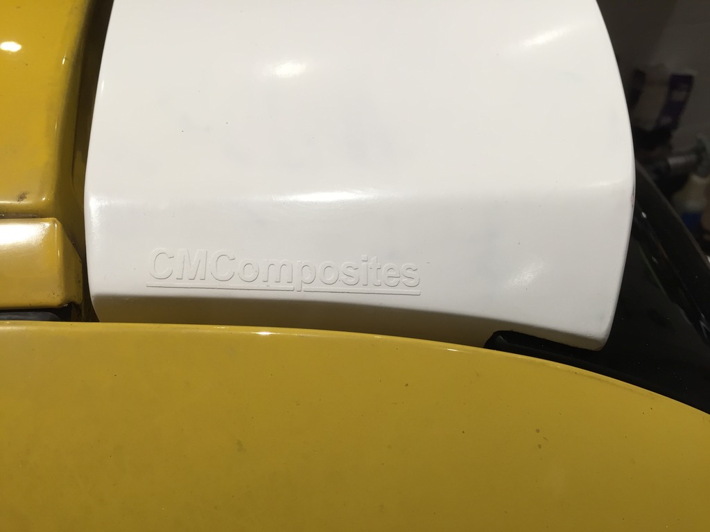

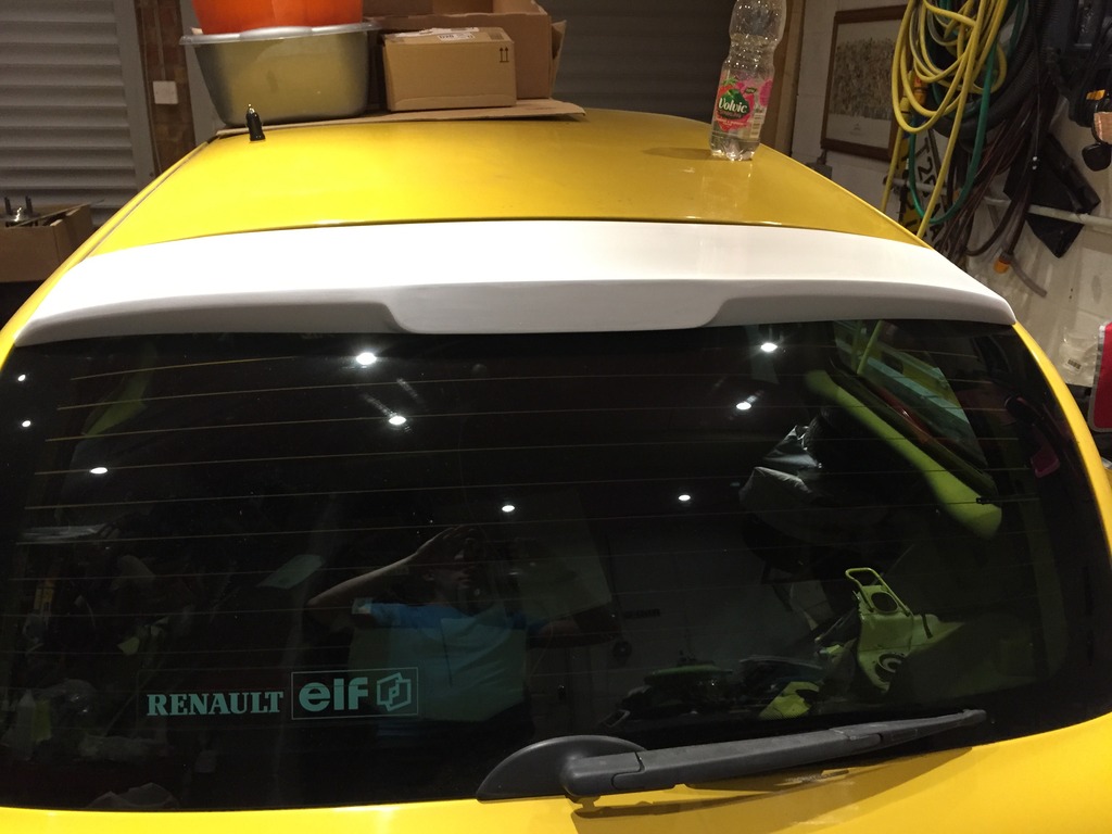

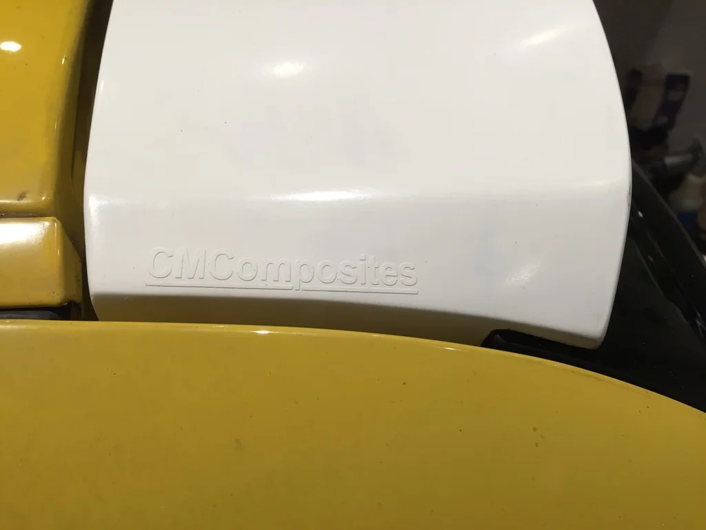

Good bit of weight to be saved in those spoilers
It's a shame you didn't opt to smooth over the area where the 3rd brake light is mate, as without the light there it just looks a bit weird if that makes sense? I like the embossed logo though mate, nice touch! :up:No point in running the high brake light as that's added weight
I'd have bought it like that!!That did cross my mind about cutting it out and smoothing it across but then I thought people might not like that option, decisions decisions ha ha
Blatant plugging your own products!!!Good bit of weight to be saved in those spoilers
Thats what I said :up:I like the embossed logo though mate, nice touch! :up:
Great minds and all that! LolThats what I said :up:
