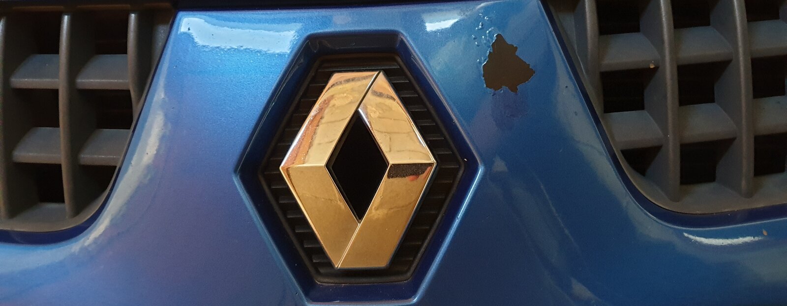

I just need some advice on how to go about touch up painting this. You can see the previous owner already tried and failed halfway through i guess but yeah. I know it's not really fixable, and the whole will probably get a new paint anyway at some point, but i'd just like to try and make this look better in the mean time.
Should i use a prime coat ? What products should i use etc. Thanks in advance.

In my experience touching up usually looks almost as bad as no paint.
I'd probably have a go at masking the whole area up along the contours rubbing it all down and attempting a proper job at blending it.
If you fremove the black plastic grill you will be able to spray into that for blending and go up to the lines where it's a sharp angle and then rub down and clear coat over the existing clear coat on either side to attempt blending.
That how I did it on my fuel cap rust and was mega impressed at the result using rattle cans
Thanks a lot mate, i think i might take it to a pro for that, there is one nearby, they told me they could do the job for about 50€ so i might just see what they can do, wont be really good looking but honestly, everytime i look at it i see it and that's starting to bother me quite a lot haha

I'd do that mate, touching up will look crap anyway lol
