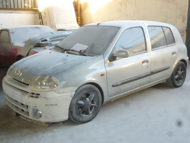

I'm Alexandre, and I'm owner of a Brazilian Clio SI K4M 2001. I am a fan of Renault Clio, and I had many of them 1.0 liter, and now I bought this 1.6 liter to get some track days.

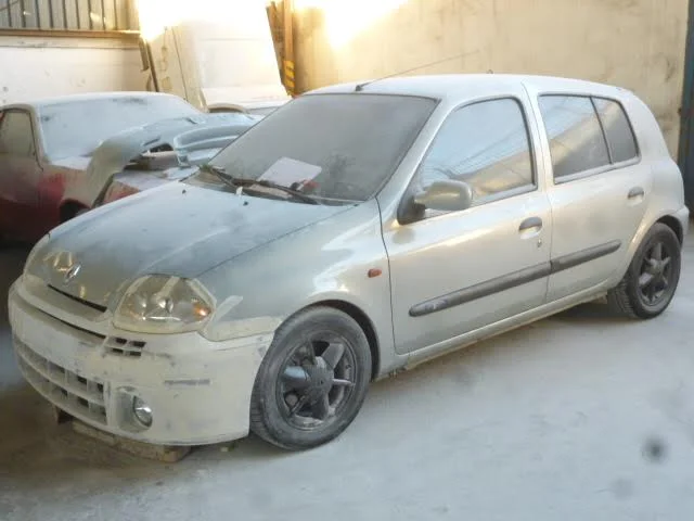

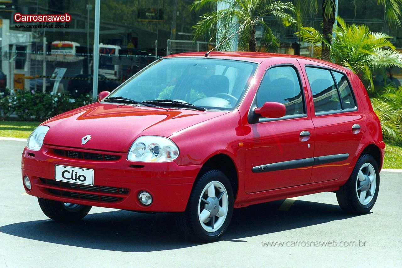

Unfortunately Brazilian Renault have never produced and sold in Brazil none of the Clio sport. Brazilians fans like me build theirs Sport Clios using Megane Scenic parts (engine, breaks, etc..) now I'm researching to produce a front bumper of Clio 172 Phase1 in fiber glass. I know you might think why not import a bumper, but the problem is that our Clio is different, and the bumper have different "fit" (check on photo of brazilian red clio).

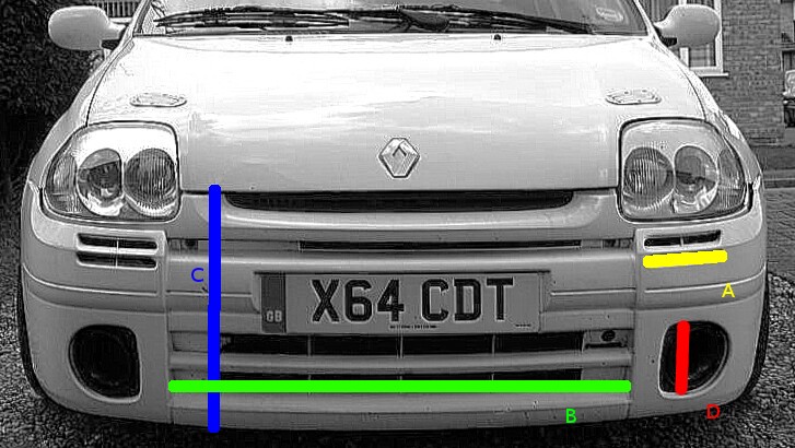

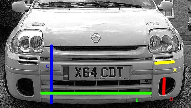

To continue this project I really need from you a favor.. Could you please measure the distances in picture and advice here in forum?
I'm working to produce 8 bumpers in fiber glass to many different Clios Projects here in Brazil for many owners (fans like me), your help is much appreciatted.

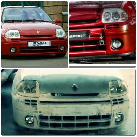

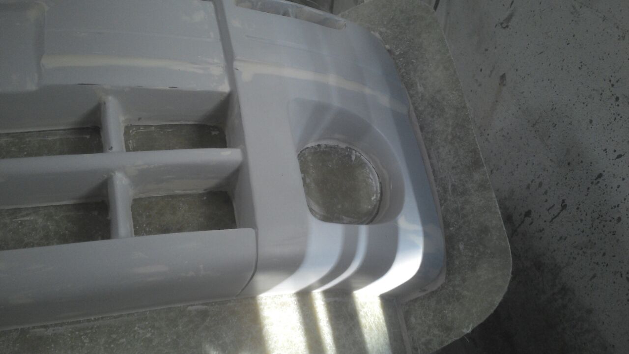

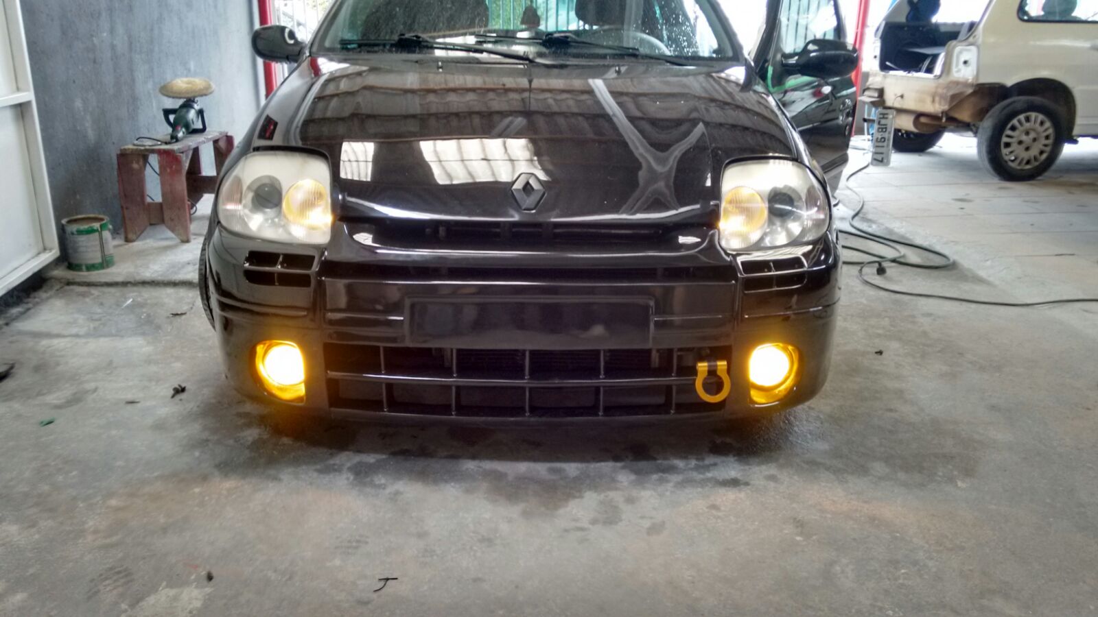

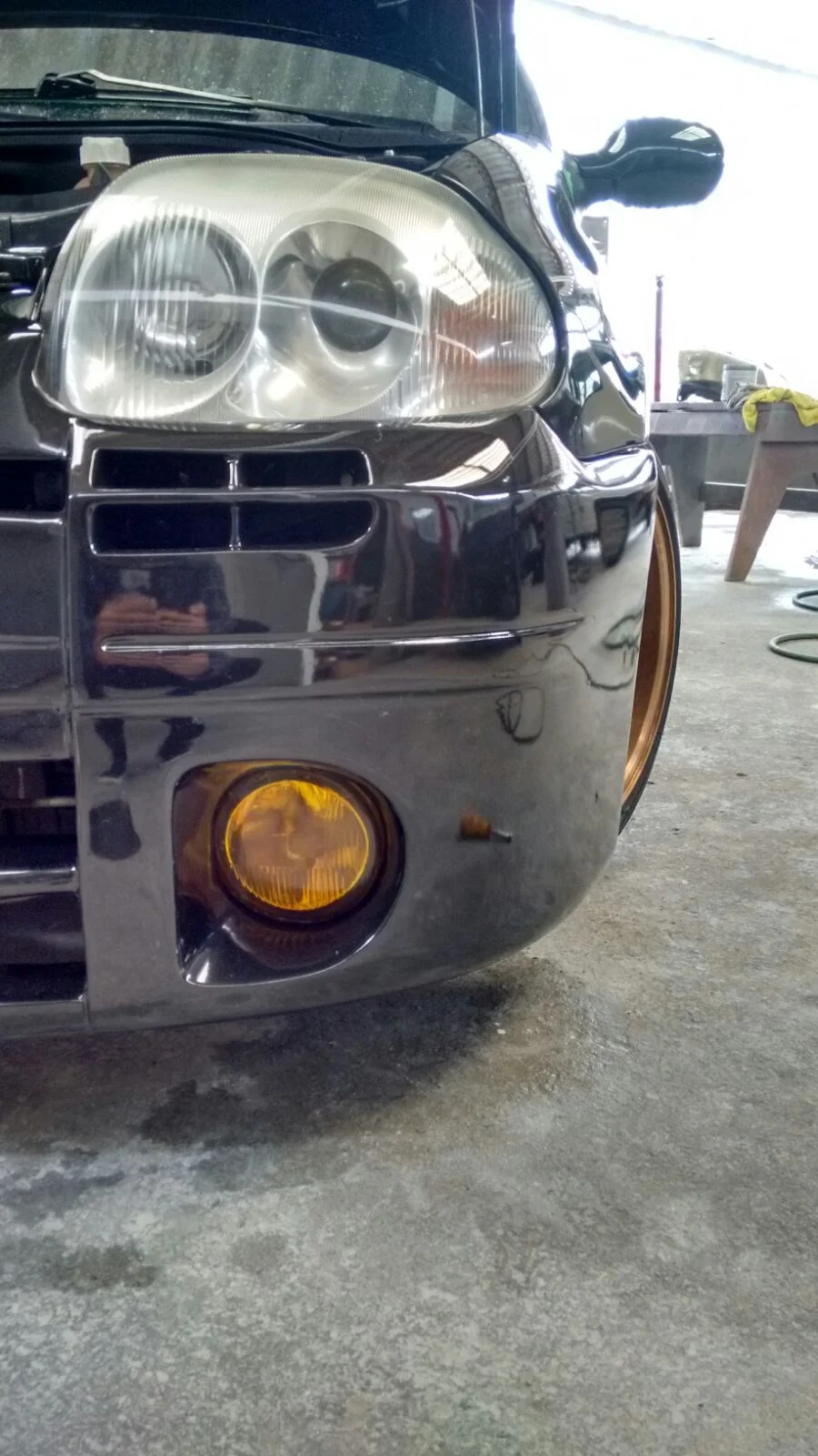

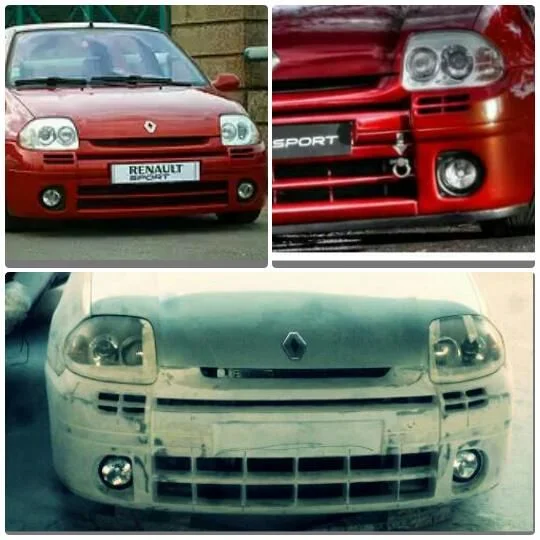

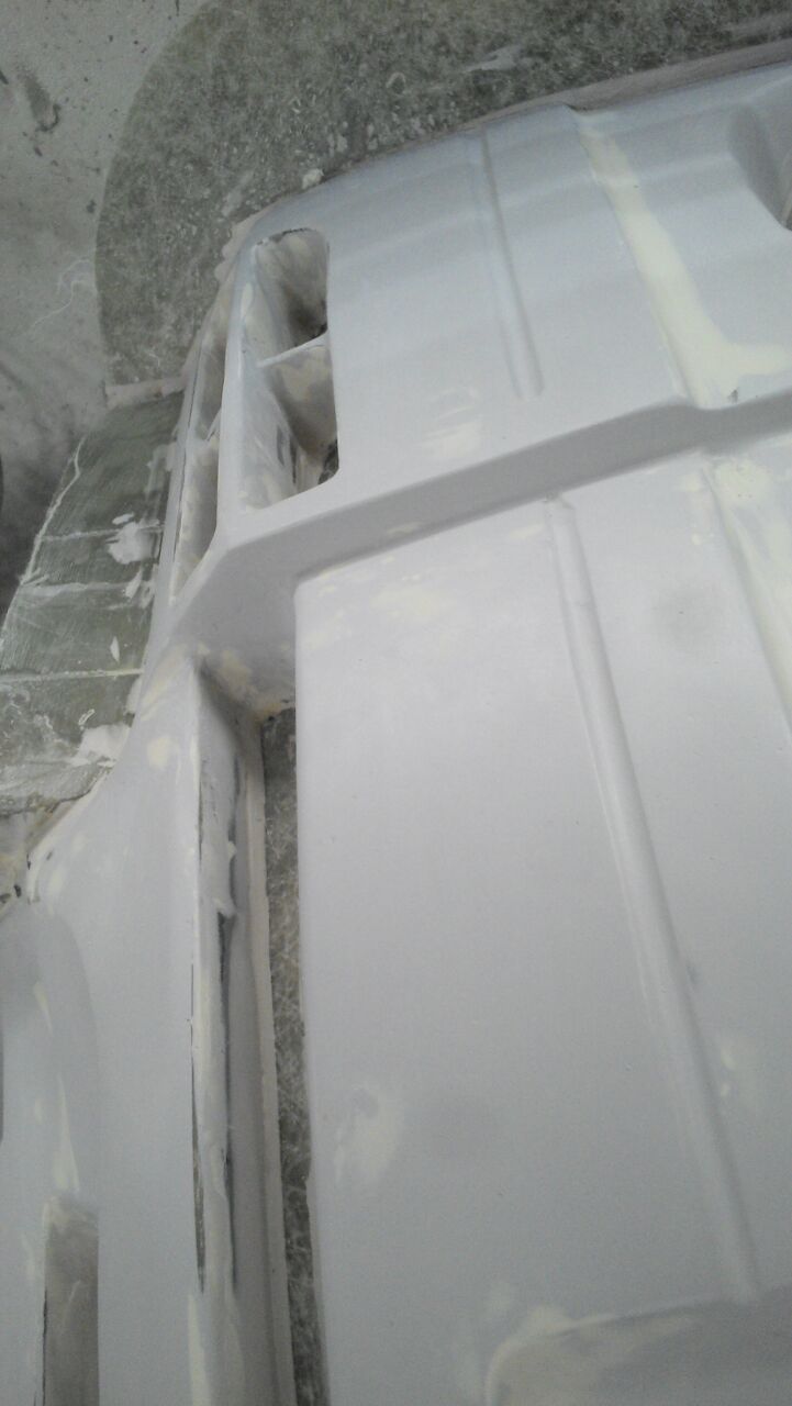

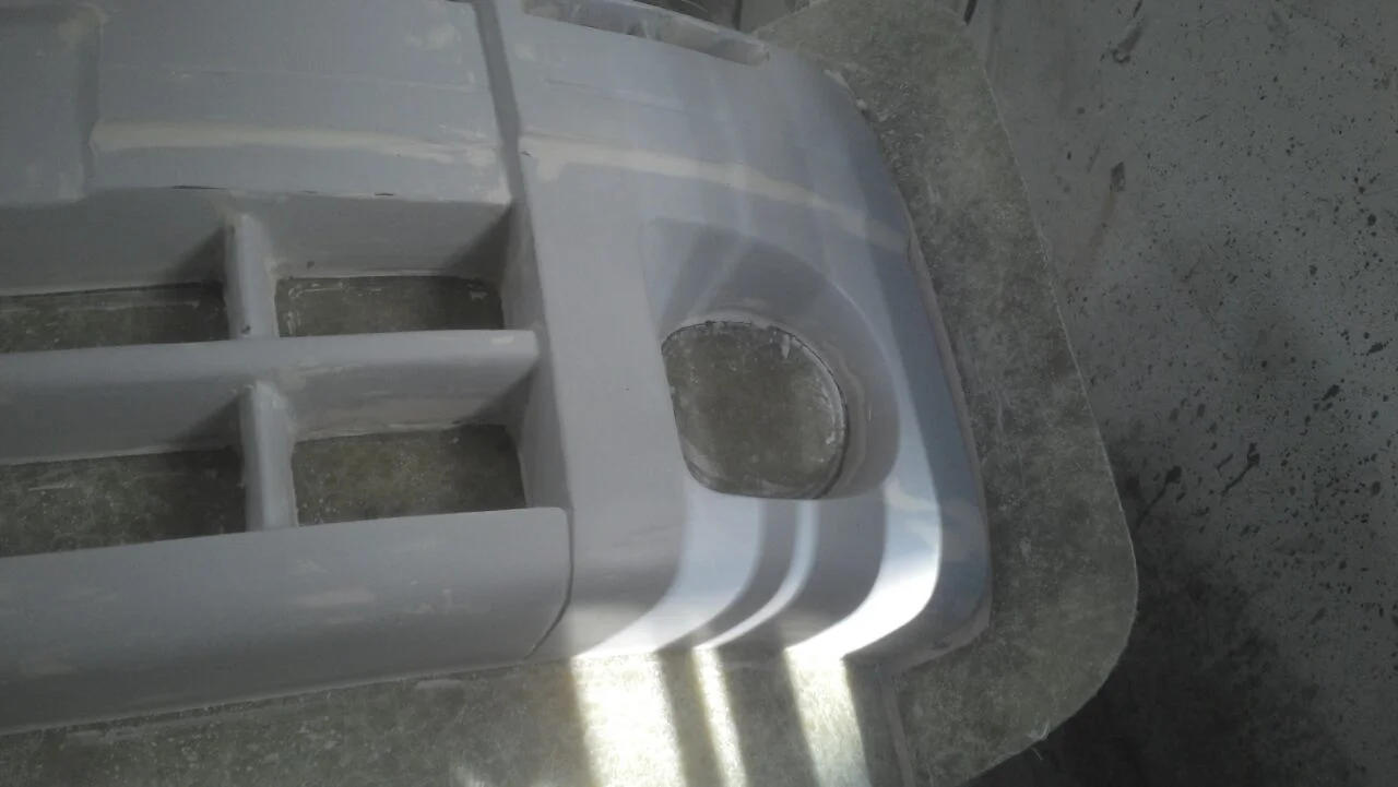

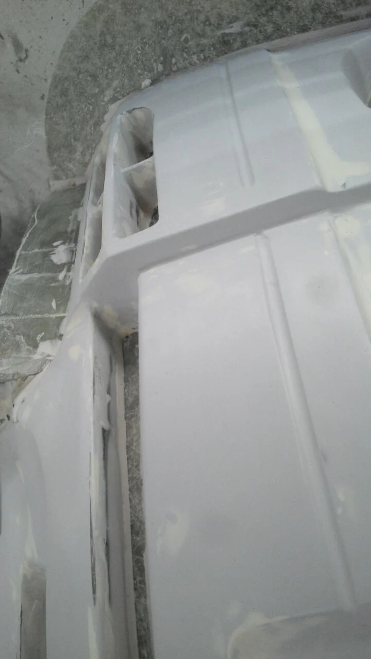

With your help we have already a prototype. We are very happy to end the paperwork and see the results.
We known it's not perfect, but we made all base on photos.
See attached

That looks very near on! The front vents look a tad closer than they should be but good job!
Couldn't you just have got the wings/fenders bumper and the side skirts imported though? Surely the actual mounting points are the same?
Also have you used one piece for the grill and bumper?
Yes, it's one piece for all parts..
