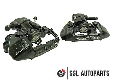

With current discount ECP are exactly £182 when you have taken the old ones back. They don't come with the pad carrier just the mech so seems expensive compared with the SSL units on eBay which also seem to be an exchange - not sure they would be happy to receive my calipers back as a swap....

I bought some front calipers from SSL and was impressed. Fast delivery of new units and collection of the old. I've also heard a lot of good feedback about MS, although I've not used them.
