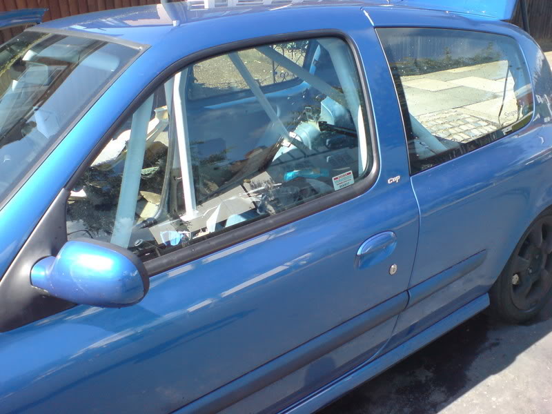

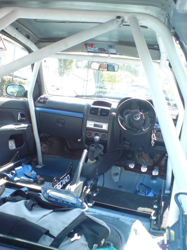

You don't have to fit one through the dash. Mark's Safety Devices one comes down right in front of the dash. Only thing you need to cut your glovebox, or leave it shut.
His number is 01279 431628.

have you got pics? i know theirs a big bar running along through behind the dash, everything out of the back is now out all the roof lining and light console and all wiring from back and roof that isnt used has been removed, i aint being shy
