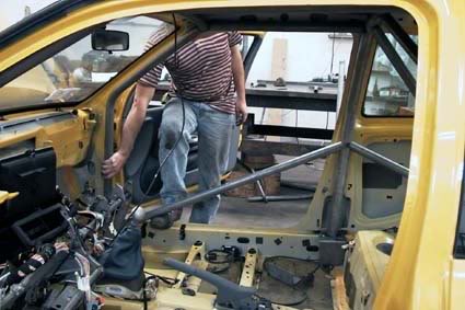

NEEDED: Help building custom cage

i lost 85kgs without the cage , thats PAS pump, aircon, stock rads, interior, race battery, ally bonnet fitted etc
  80MPG BEEZA
ive taken out all interior every last little plastic plug,rear wiper motor and wiper,all wiring thats not needed and i took a holesaw to a couple of places in the back, just gotta start on the front, i just bought a red top 25 thats sitting on the bed it'll go behind the passenger seat at a later date

all bars next to pillars to attach reinforcing plates :)

ive got all the other fitting pics, do you have them?
yea ben i just got the whole file as there's around 5 different models with a few differences and some weigh more this ones 32kgs and only costs £435 so well under budget, hows the super charger work going? people keep on saying i should go down that route but its just alot of hassle!

The ligthest weight is not having something there so bin everything run simple wiring loom for lights etc then space frame the car would be good.
well thats how ive tried to think i dissconected the rear loom after everything was out then worked out what wires were useless e.g rear wiper wires,interior boot wire,aerial wire, certain earthing wires, door sensor wires and sensors, then removed plastic lugs and grommets then plotted out where the holesaw can go (would space frame but cant be assed) MOT is due on fri so i'll get that done, then i gotta take seats out to take carpet up and remove airbag wires, then i'll tackle the dash when the cage is going in, then front window has to come out to weld in reinforcement plates by some lucky crap TIG welder :rasp: before being sprayed then i can plod on with dash,race battery and the like and do front doors and windows
