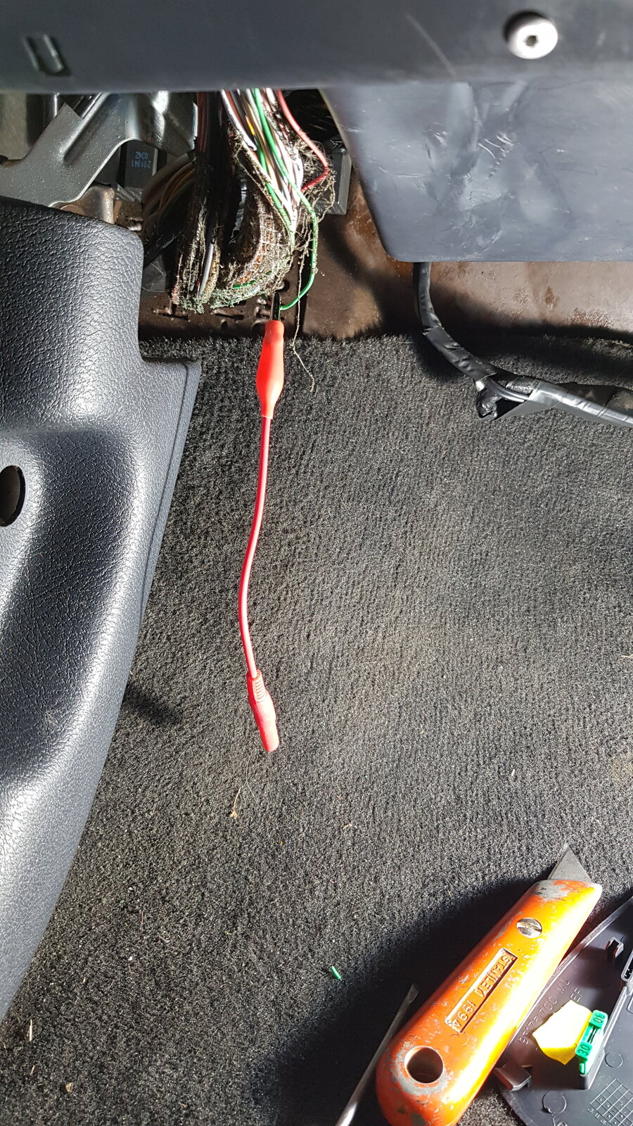

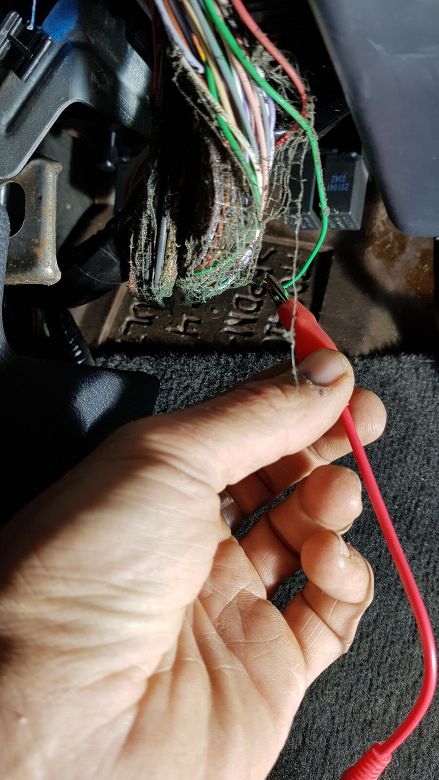

Just the interior light to sort, I've got continuity from the light to the green plug under the dash but I cant trace where it goes after that

No I was meaning the interior light
I've tried but I cant follow it once it goes behind the dash, be handy to know what pins it is in the plug
SOLVED IT!
It was a broken wire just off the uch plug, see photos. Cant believe how long this has taken me to find such an obvious fault.
