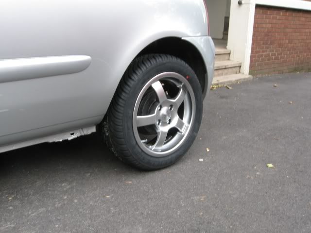

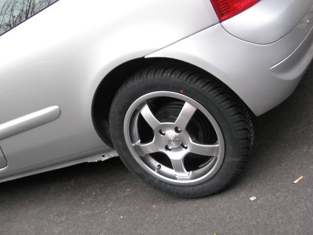

if you're gonna paint the drums do them black imo, as for locking nut key i don't have one, cos of no lockin nuts (nobody steals ph2 wheels:clown: )

Black sounds like a good colour.
But I was thinking about red, like on the Seat Cupra's?

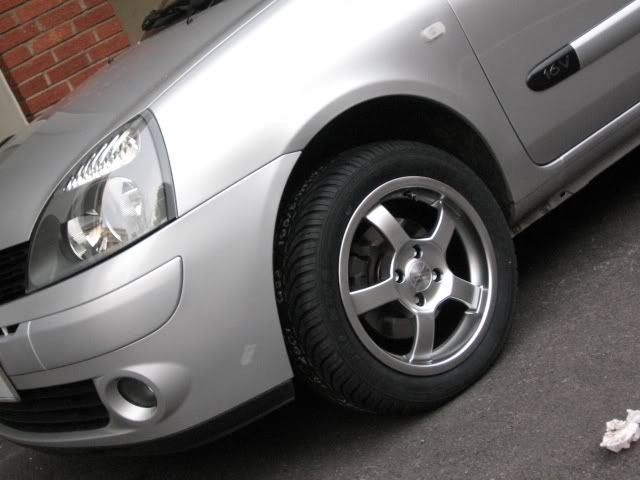

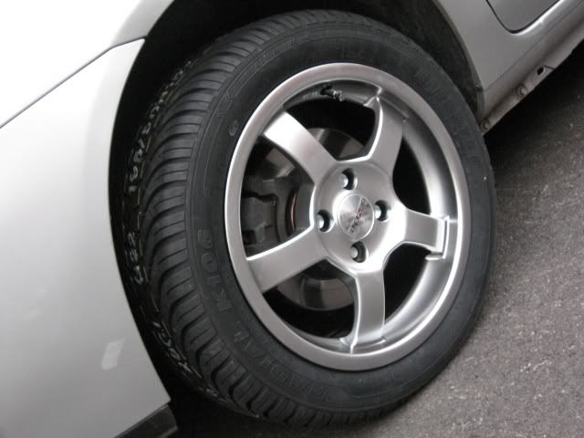

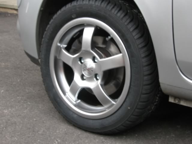

Think it looked better before, it looks liek sum1 stole your clio wheels so you just replace them with the cheapest ones you could fine. sorry
Then agen, how can i talk, i useto have vault chromes

Na no-one nicked my original alloys. They are sitting on the kitchen floor at the mo.
I think that these alloys are pretty smart.
Oh well, at least I am happy with them. That's all that really counts.

not great to make drums stand out imo, isn't it the calipers that are red on the seat's??

please tell me that you put the spigot rings on with these 'cos just before you fitted them it looked as thought you didnt have a clue

Ok, I am confused.
I was advised to get some Copper Slip, which I did. Applied it to the areas that needed it - basically where the alloy had contact with the rim on the Clio.
As for the Spigot rings, I am sure Motor-world would have supplied them if needed? When putting the Alloys on the Clio earlier, they fitted onto the hub nicely. So I thought as they fitted straight on (and snug), I thought I wouldn't need Spigot rings.
If I am wrong, please correct me. Also where woud you advise me to get Spigot rings from, and how much will these usally cost?

could do with lower profile tyres look a bit balloon like but sadly thats how places keep the cost of wheel sets down by fitting high profile tyres. If they fit snug you dont need spigot rings.

Well done mate, as long as you like them...Look std to me, but smart. DON'T get coilovers...Waste of ur money. 60mm springs would do you fine.

personally i think the standard alloys that would have came with your car look better, if your going aftermarket i think you should get 16" instead of 15" alloys, but even at that 16" turinis from the cup would have looked better.
should look ok when its lowered though, id go 60mm but not just springs, get shocks too because if you just go for the springs the shocks wont last long. plus its handy having a dad as a mechanic because he can fit them for you :)
as long as you like them then thats all that matters.
