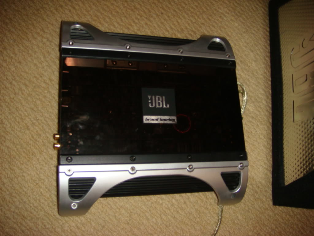

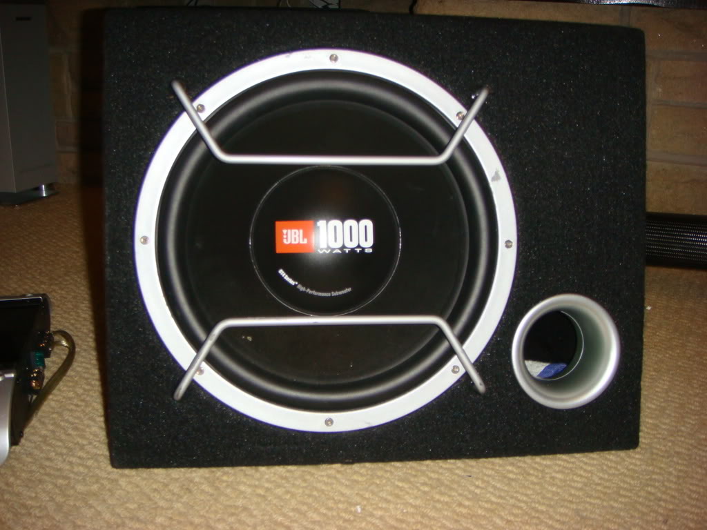

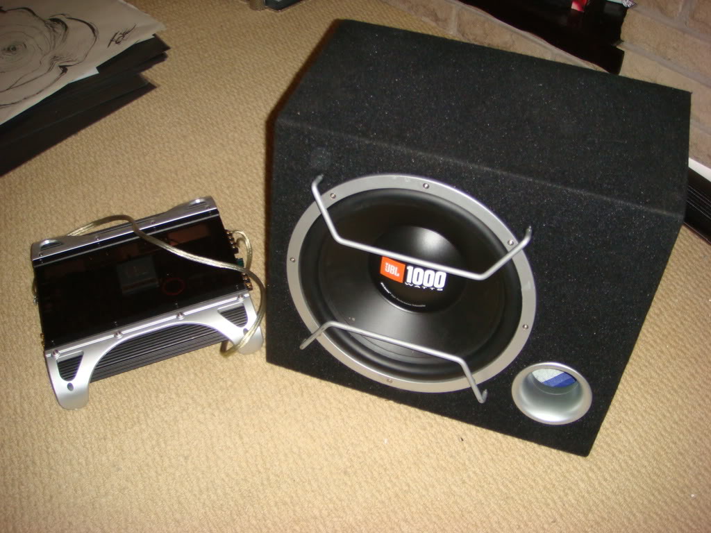

i got these for free from my dads friend.. he gave it to me so i cant really complain about them.. the question is.. how the heck do i wire it all up??
i have no idea about interior audio... so help would be really apprciated!

Unless your Dad gave you it, you need to go buy a wiring kit.
It'll have the power cable with fuse (goes from the battery to the amp), an RCA cable (goes from headunit to amp, send the audio signal), a remote cable (tells the amp to turn off when the headunit is off) and speaker cable to go between the amp and sub.
Make sure the level/gain on the amp is all the way down or you'll kill something.

omg i tried to make as much sense as i can, and from common sense i think i know what your talkin about... i deffo need a wiring kit because the guy stil had the wires wired up in his car, and my head unit is standard atm but am thinkin of getting a new one soon..
this is the first time ive come across in car stuff,.. i never done anything besides the exterior..
does it make a difference because it says 360 watts?
i dont understand wires.. its getting fustrating lol some one make a list and links of what i need to buy and il buy it to fix it all up lol
You need a wiring kit (the one above comes with everything including terminals and connectors, even the correct fuse) and a new headunit.
Your sub and amp are rated at 250w and 290w respectively so you'll have some overhead with that wiring kit.

ha i can see, they look good, the one you have looks pretty neat aswel! argh cant wait to get this all done
