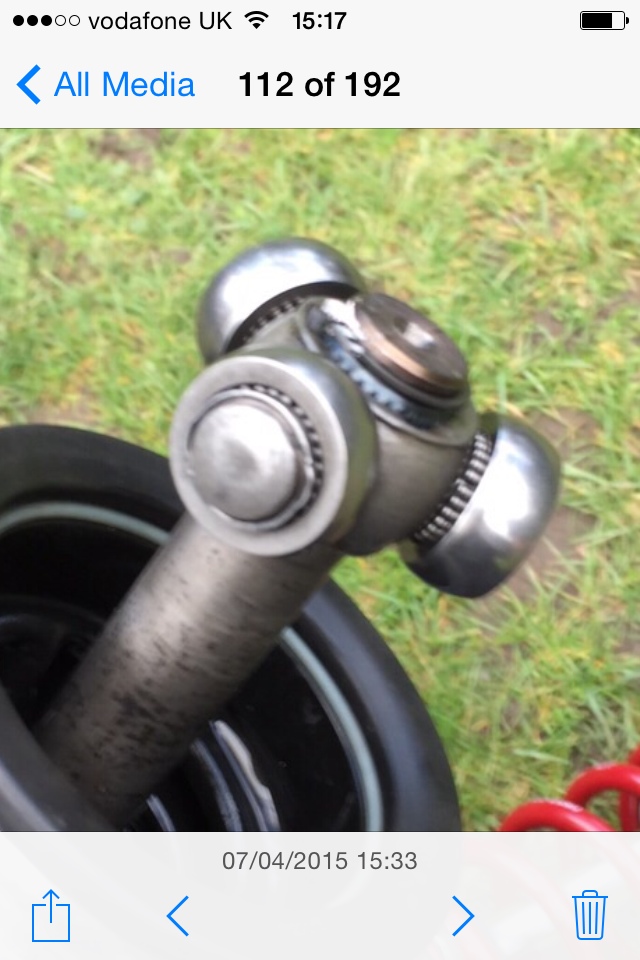

From what I gathered, they think it's something to do with the drive shaft bottoming out. (correct me if I'm wrong lads)
But I thought I'd whack a post up on here anyway, just in case someone else had encountered this problem before or had any advice/suggestions. @NorthloopCup @BIGASH
I think next steps will be to take the shafts off again and inspect them and around the knuckles...

I bet it's the short shaft making contact with the inside of the diff.
I've got a later cup subframe on mine so bolt holes are further out making it slightly wider, but I am still having to use a ph1 short shaft as anything else makes contact and knocks/judders on hard right turns.

Only doing it on hard right hand turns? Feels like a really bad vibration, like the wheel is loose? I bet you it's the short shaft being slightly to long.
ABS rings are different on the 182 cup shaft, don't think there is any other differences other than the fact it is 10mm longer than the Ph1.

Martin, I am certain a shorter shaft will do more harm.
If we call your shaft mounting point at the box Point A, and the hub mounting point for the shaft Point B...
As factory, the shaft sits almost straight and level, with extreme lowering such as you have, you have changed the level between point A and point B, which in turn makes it a slightly further distance.
On that basis, your current shaft will now already be classed as too short for the job in hand, it's trying to reach a further distance than it's ever had to before.
If you now go for a shaft even shorter, you will be making the shafts work even harder.
This is what the bump steer correction hubs try to rectify.

its shaft too long/engine too far to the N/S. Exactly as I said last night, and Exactly what I've had in the past.
Just need to find time/when I can be arsed to come down and fix it.
I would be 99% sure that it's going to be that the n/s shaft is to long, it's has happened to me and I am running a very similiar set up to you. If you speak to gripper they are aware of it as well so it must have happened to other people.
Also the driveshaft doesn't sit parallel from the factory it droops down slightly, so a lowered car (as long as it's not severely lowered) will push the shaft in even further not move it out. If you are running lot's of -ve camber this will be amplified. So you will need a shorter shaft not a longer one.

As per my text Martin, I'm gonna say shaft bottoming out. Both James and porkie ran the hub kit so they benefitted from an additional 5mm of track width. That could easily negate the issue.
If you take the outer cv joint apart it should have a clip that's holding the cv in place. Remove the clip as this should allow your shaft to gain a bit more travel and should potentially prove the theory. When I say outer cv I'm meaning the one at the wheel end if your not sure. It's been a long time since I've looked inside one of the Clio cv joints though, so I could be talking bollox.
  Many.
@NorthloopCup Circlip is holding it in the CV, so it doesn't come out, the inside edge is part of the shaft, it's that, that would need removing so it would solve the issue.
Which would be a poss fix if a shorter shaft is not available.
