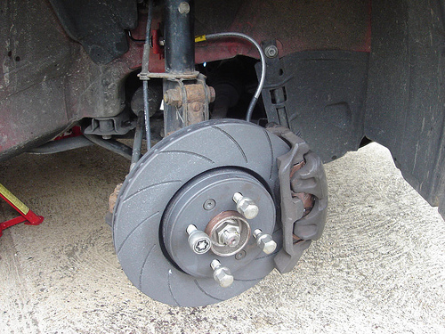

Spent Saturday fitting new brakes, pads and hoses on all four corners. Definate improvement over the standard setup.

New Fronts
