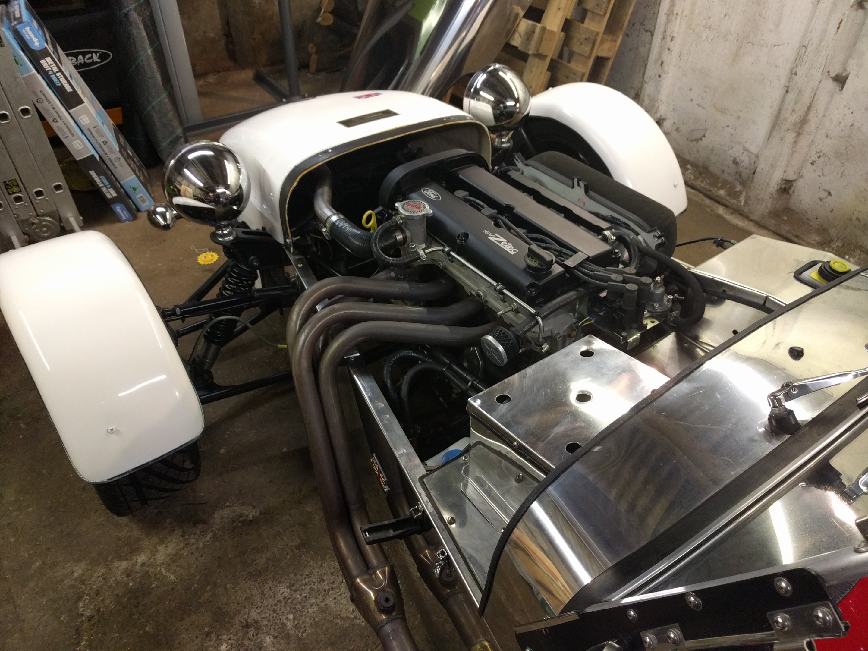

As for tuning potential James there is 250bhp in a zetec on bodies .
What ecu is it running and what chokes in the bodies , find that out first.
I suspect you wont gain much on mapping as it will have been done for the IVA .
Exhaust is also where power is held on the zetec especially in kits , trick manifolds are where its at and decent flowing silencers.

It's running an emerald K6 mate, but I'm not sure on the the bodies sizes. Just know they're AT bodies.
As for the brakes, I'm sticking with the standard caliper and going for decent pads.
I'm not gonna be spending big money on chasing power etc etc. It's just a bit of weekend fun
A 2.0 stock with the right chokes in the bodies and a good exhaust manifold will give about 175 tops
Ported head
After that your looking at cams with vernier pulleys
And you will see 210bhp

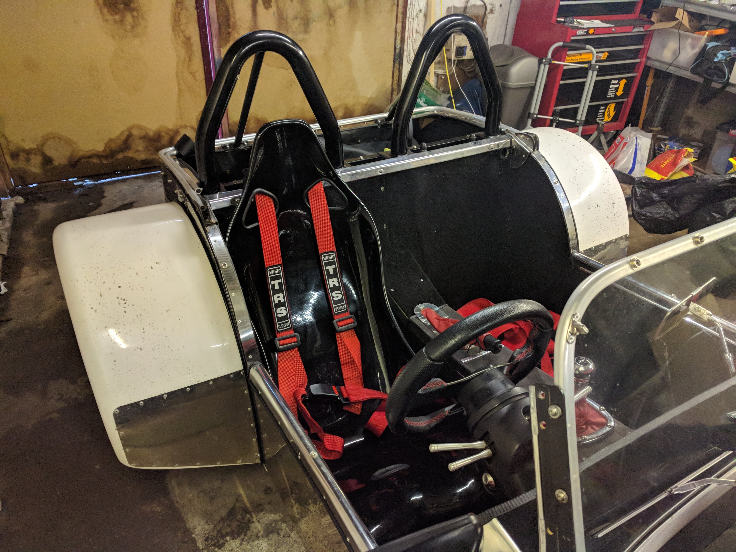

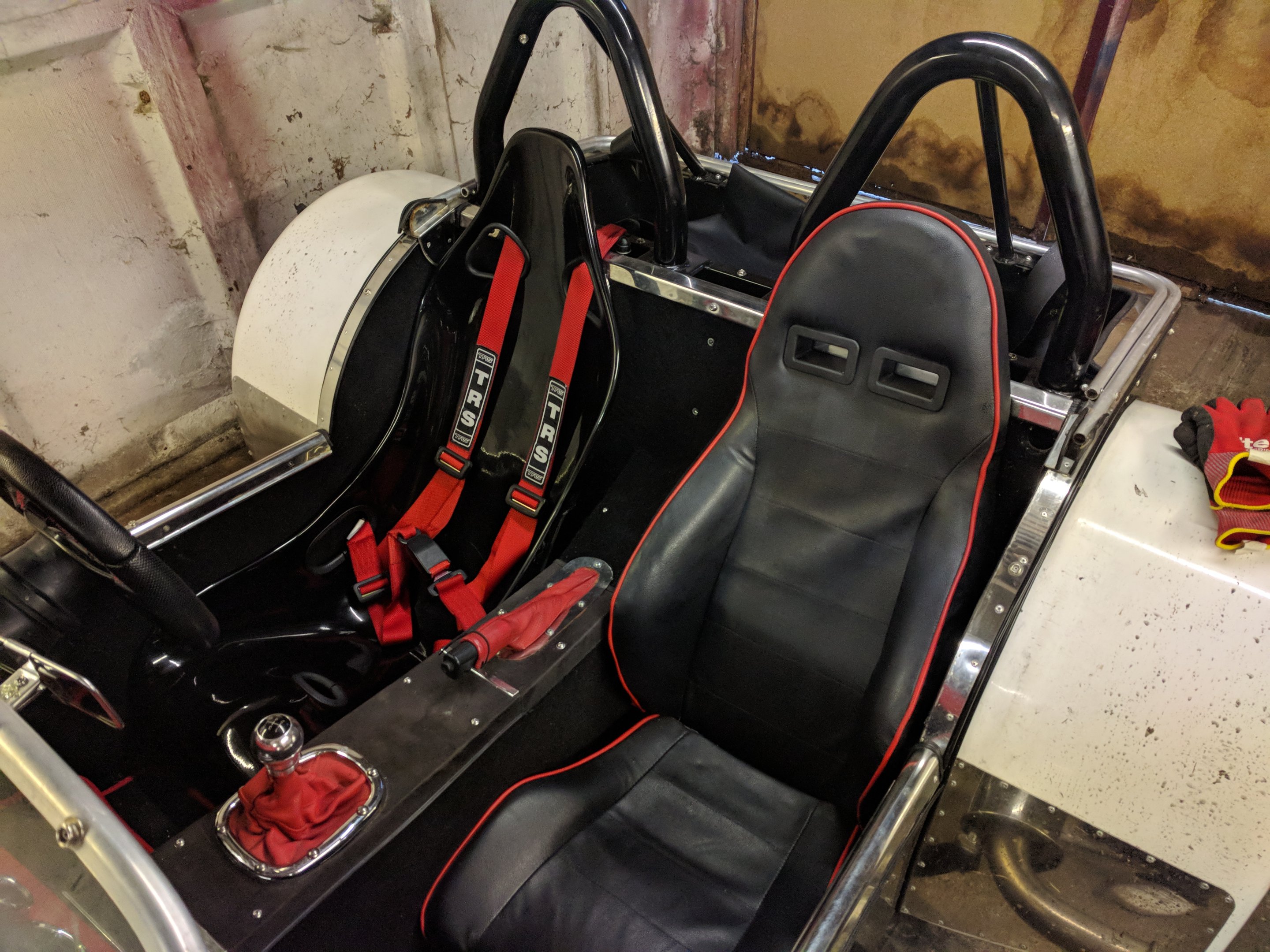

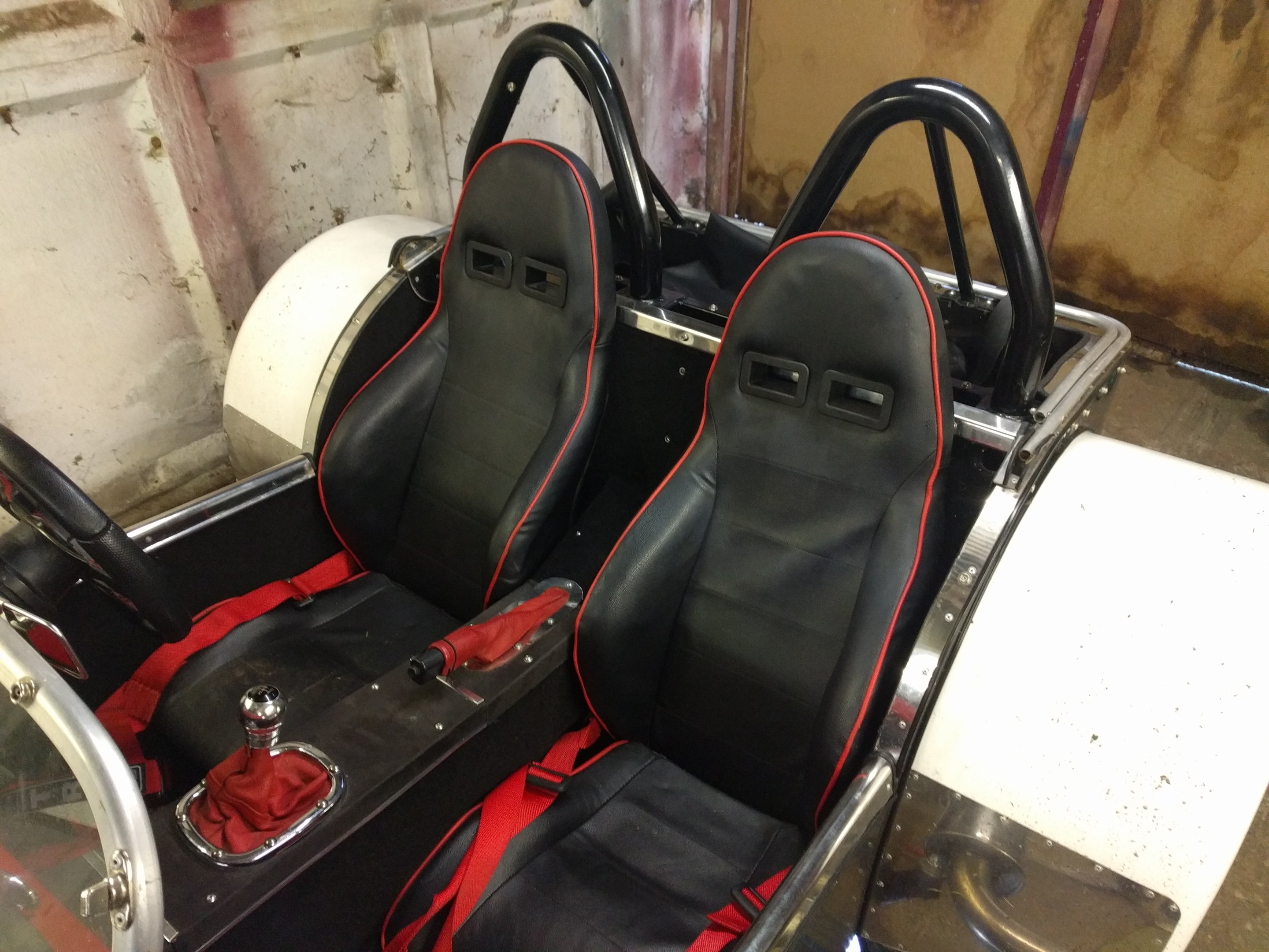

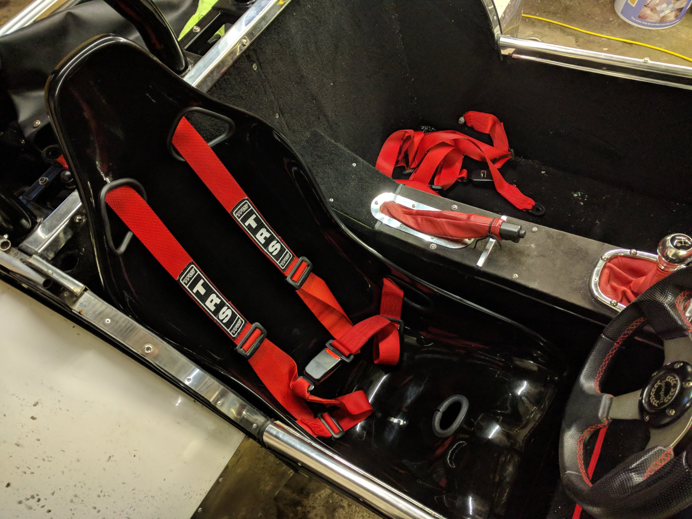

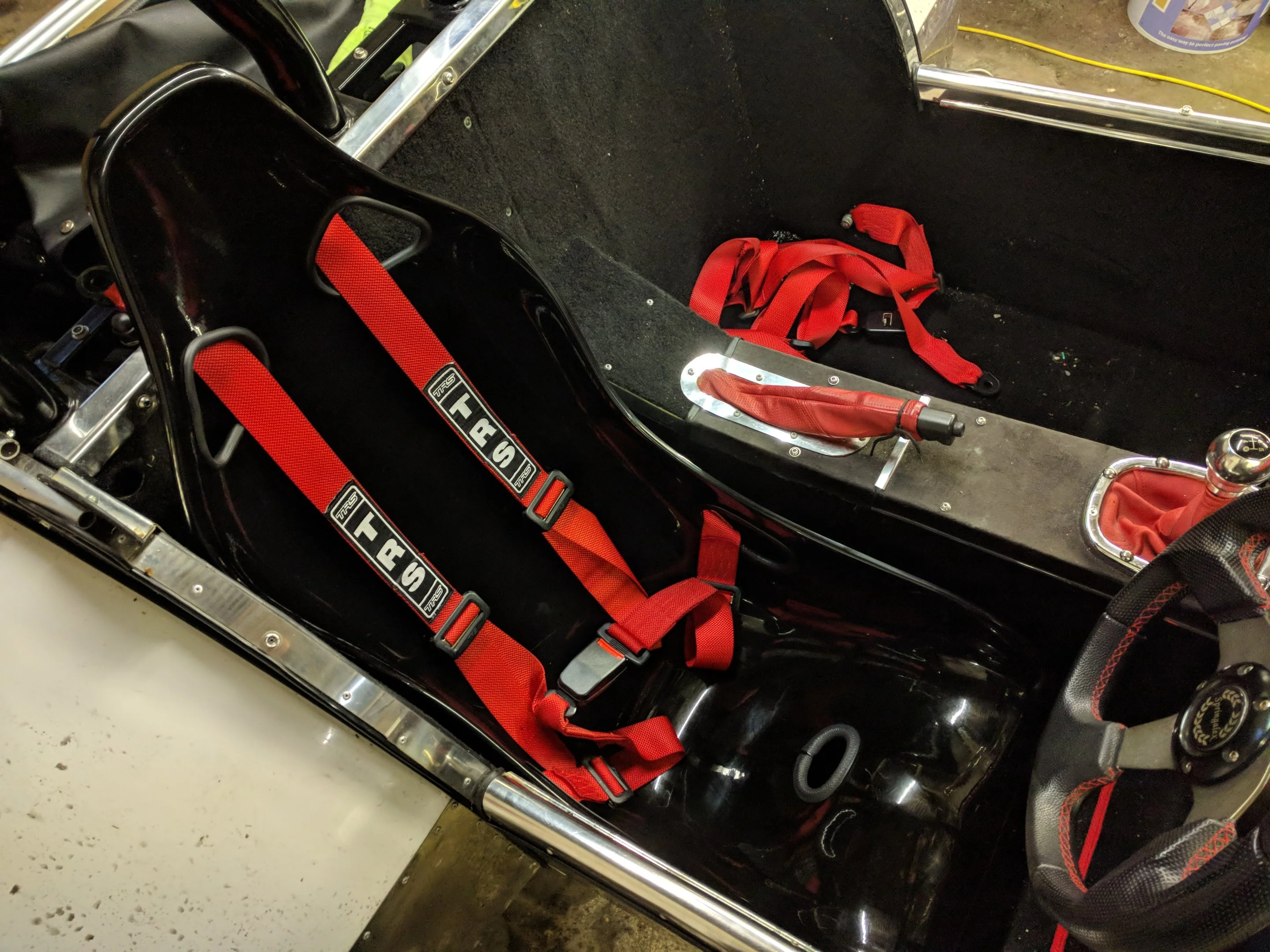

Did a few little bits earlier
I've removed all the wet weather gear and sold it as it'll never see a wet day anyway. The money I got for that has paid for the new seats.
Drilling rivets out is boring as f**k! Soon got bored of that so I decided to take the old seats out and make sure the new ones fit.
Unbolted the harnesses
Seats whipped out
New drivers seat slotted straight in with room to spare!
I've also taken the centre tunnel top panels out ready to retrim those and replace the red gaitors. Not got pics of that though.

  RB Clio 182
Seats whipped out
View attachment 1350720 View attachment 1350721
Tomorrow I really need to sort my garage out though as I'm getting pissed off with s**t being everywhere and unorganised, and nowhere to put stuff down
Plastic seats?

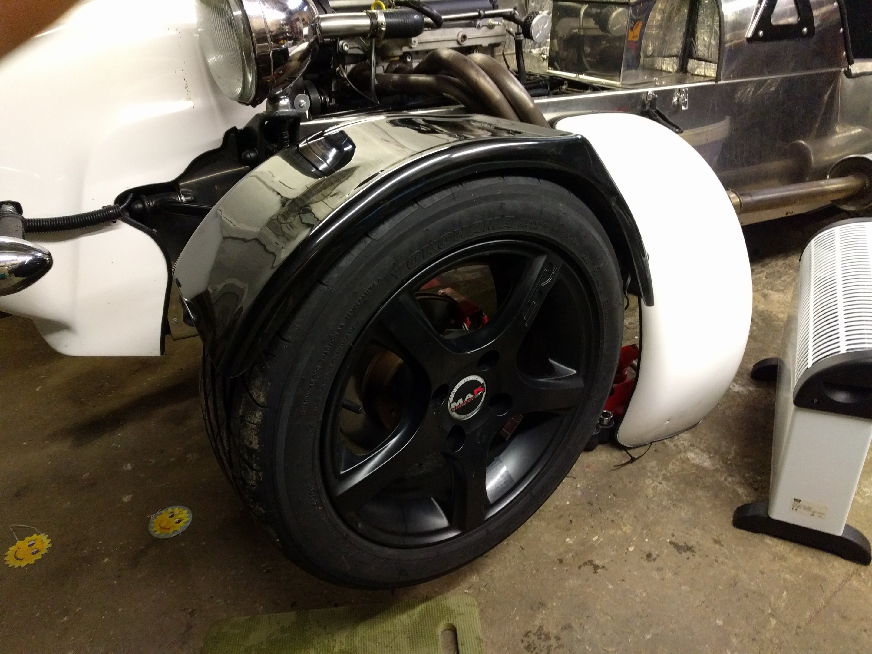

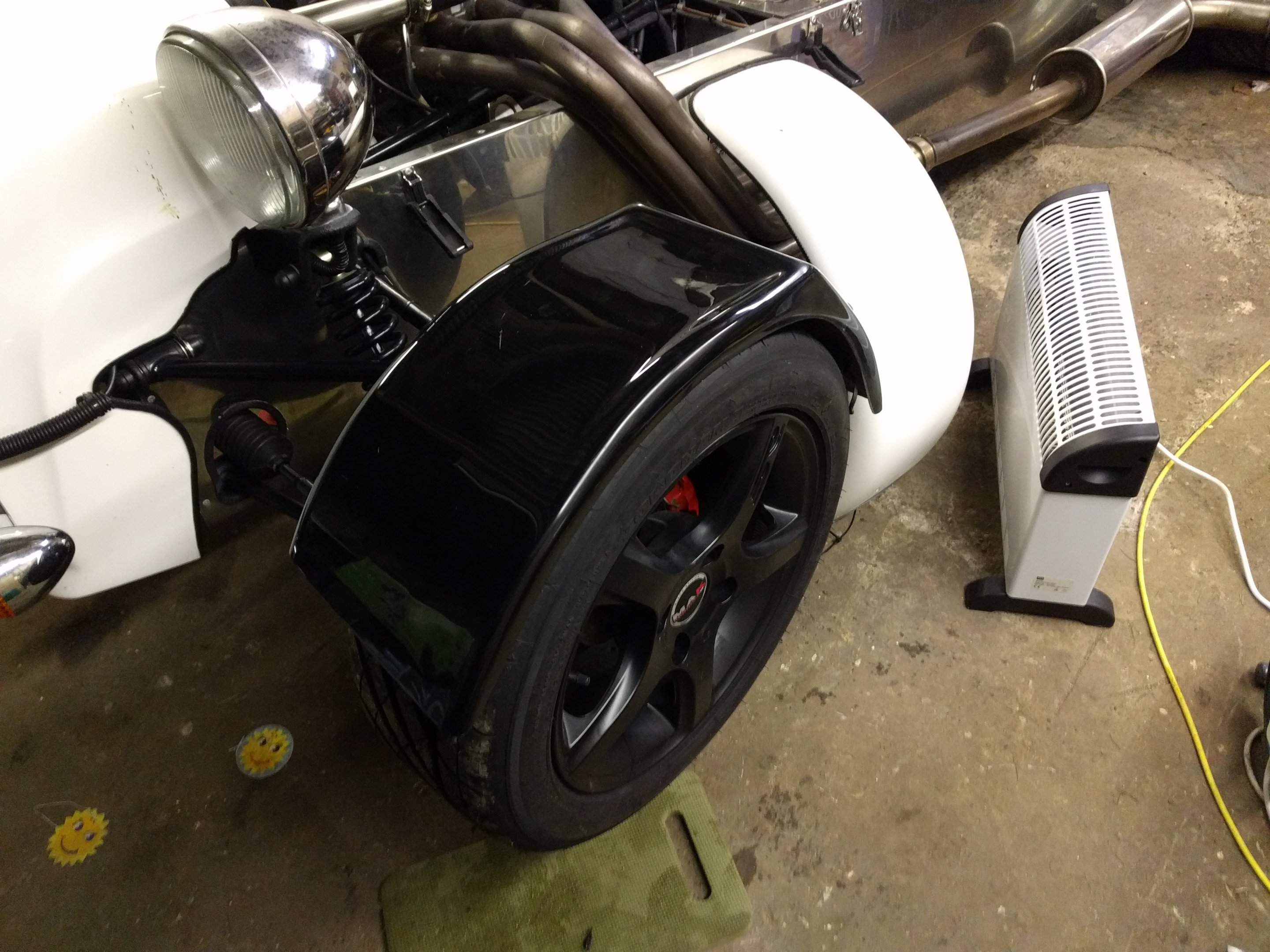

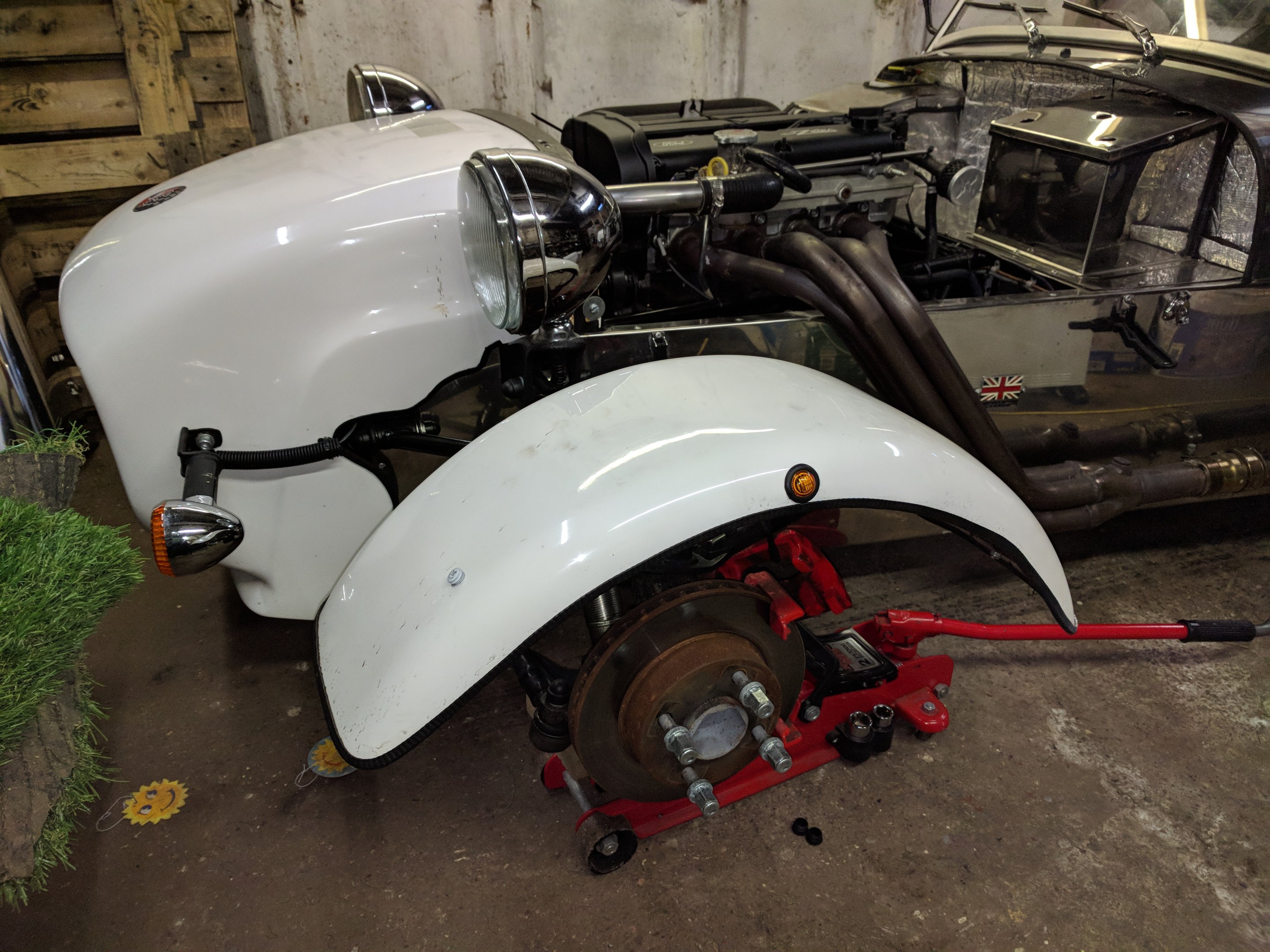

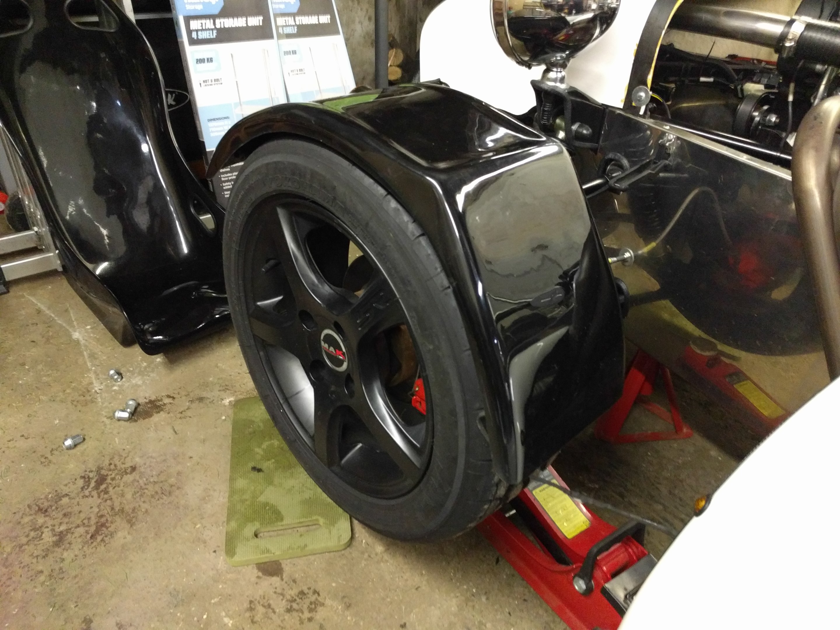

Picked up some new front wings this week. They're the "sport" style wings with flat tops. GBS sell these for 80 quid each! I found a guy on eBay who makes them to order for 60 quid, a pair! Couple that with eBay's 20% offer last week and I got them for £48.
Old
New (placed on, not fixed yet)

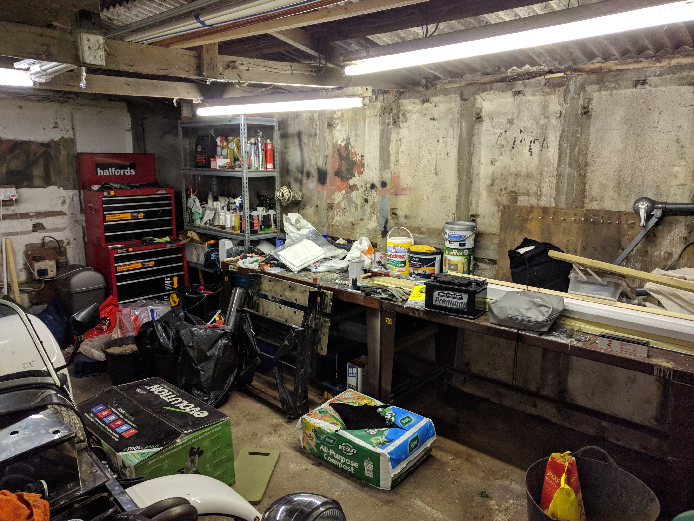

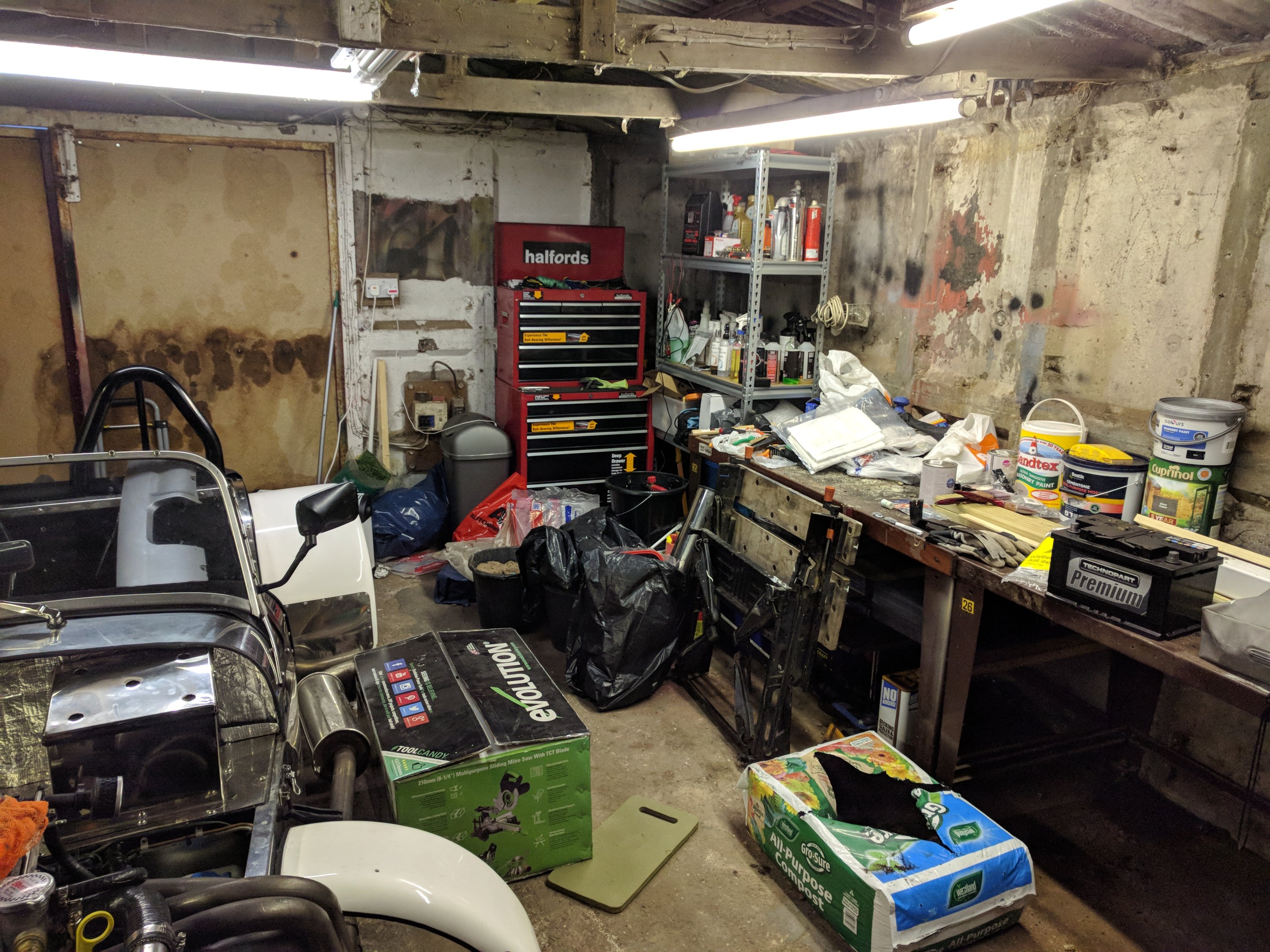

I then got pissed off with the state of my garage and not being able to put anything down anywhere so I've started to sort it. Gonna order a small skip next week to get rid of a load of s**t that I've accumulated over the year while doing the garden

It's going to cause zero issues for me, as I don't care about a slight bit of lift at the front or whatever. It's a play thing
Is that worth just reading back to yourself, fella? Surely the last thing you want at 30/50/70+ is lift at the front of a very light sports car? Having done 70+ in mine, light/no steering is not something I'd chance for the sake of a few quid or some time drilling holes (as per the suggestion above).
Ol’ Tarby
  Clio 220 Trophy
Am I completely underestimating the aerodynamic effect they have then? Lol I thought it was only a suggestion based on losing time over laps of a track. If it can have that much of a negative impact on just general driving then I'll get some holes cut in them
It wont have huge effect at road speed , but understeer if geo is set right isnt so bad unless at 60+

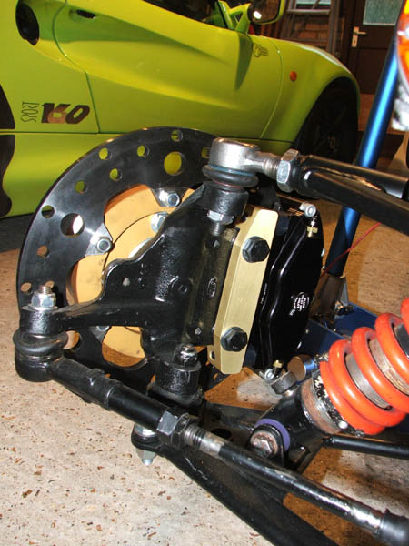

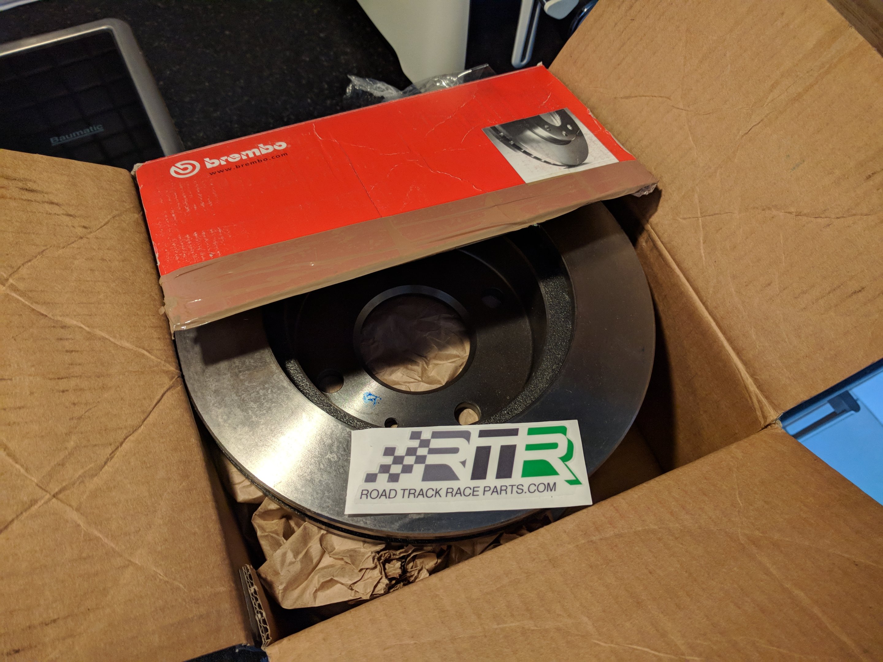

Rare as in you don't need vented on a light car with the MI-16 calipers all it achieves is adding weight
the object is loose unsprung weight
these were mine , solid , on ali bells and holes like a swiss cheese

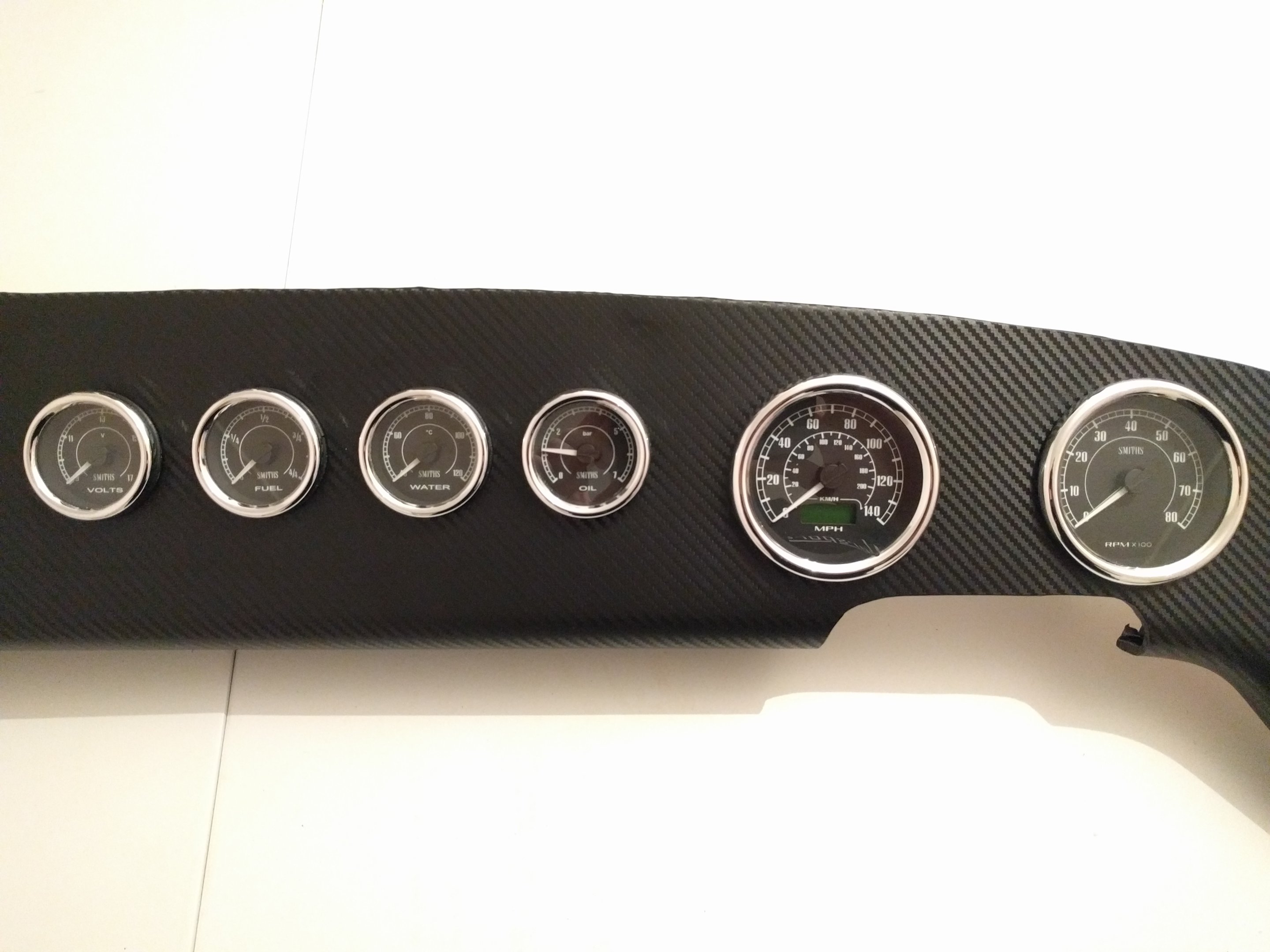

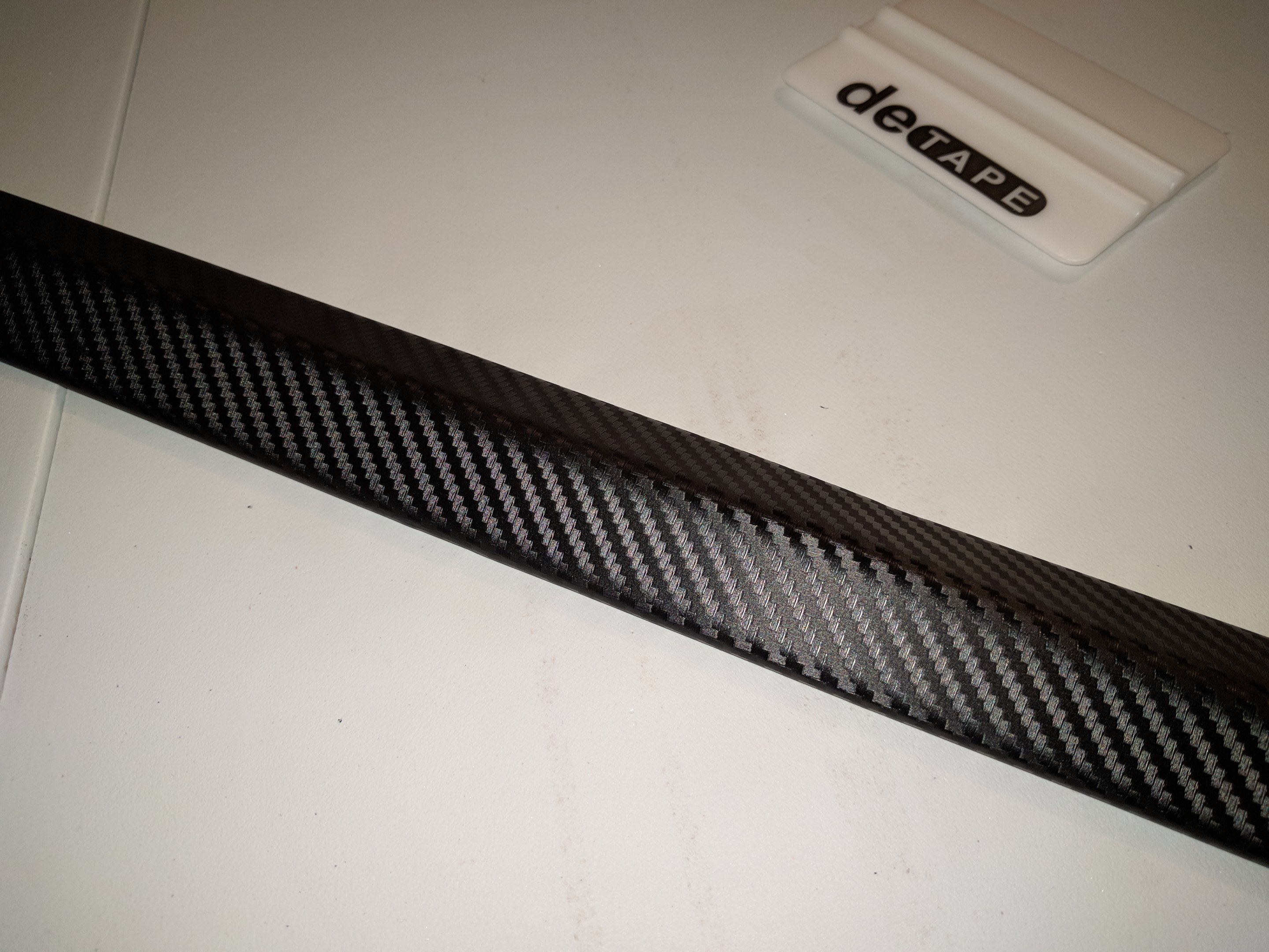

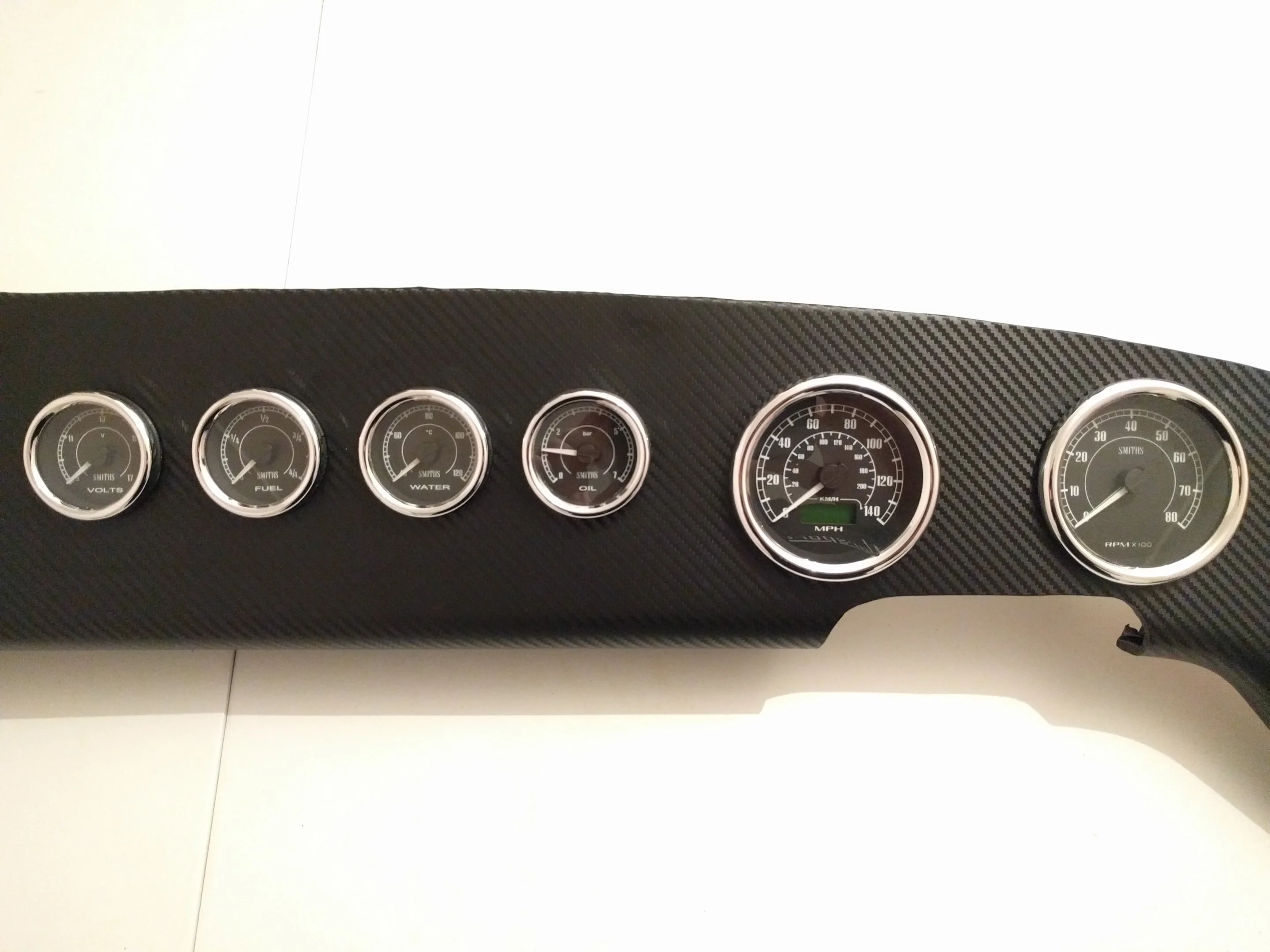

Took more bits off today. Will soon be back to kit form
Fake carbon on a few trim peices
Garage floor isn't quite so cold now either
I'm now concentrating on getting the interior finished and the new seats bolted in before I start ripping anything else off.
Suspension off next
