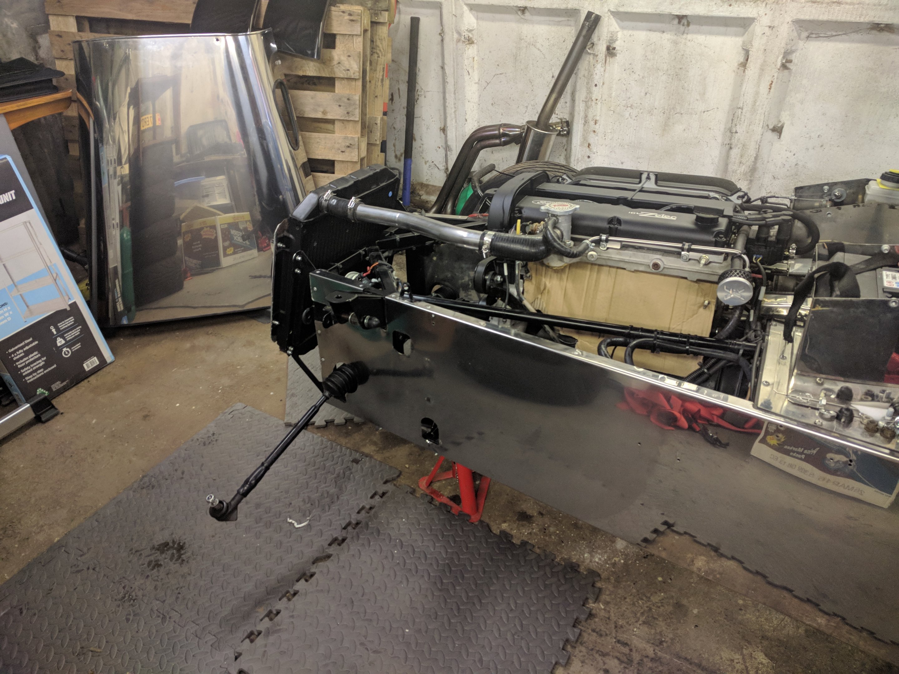

It wasn't -3 in the garage today so managed get a few bits done.

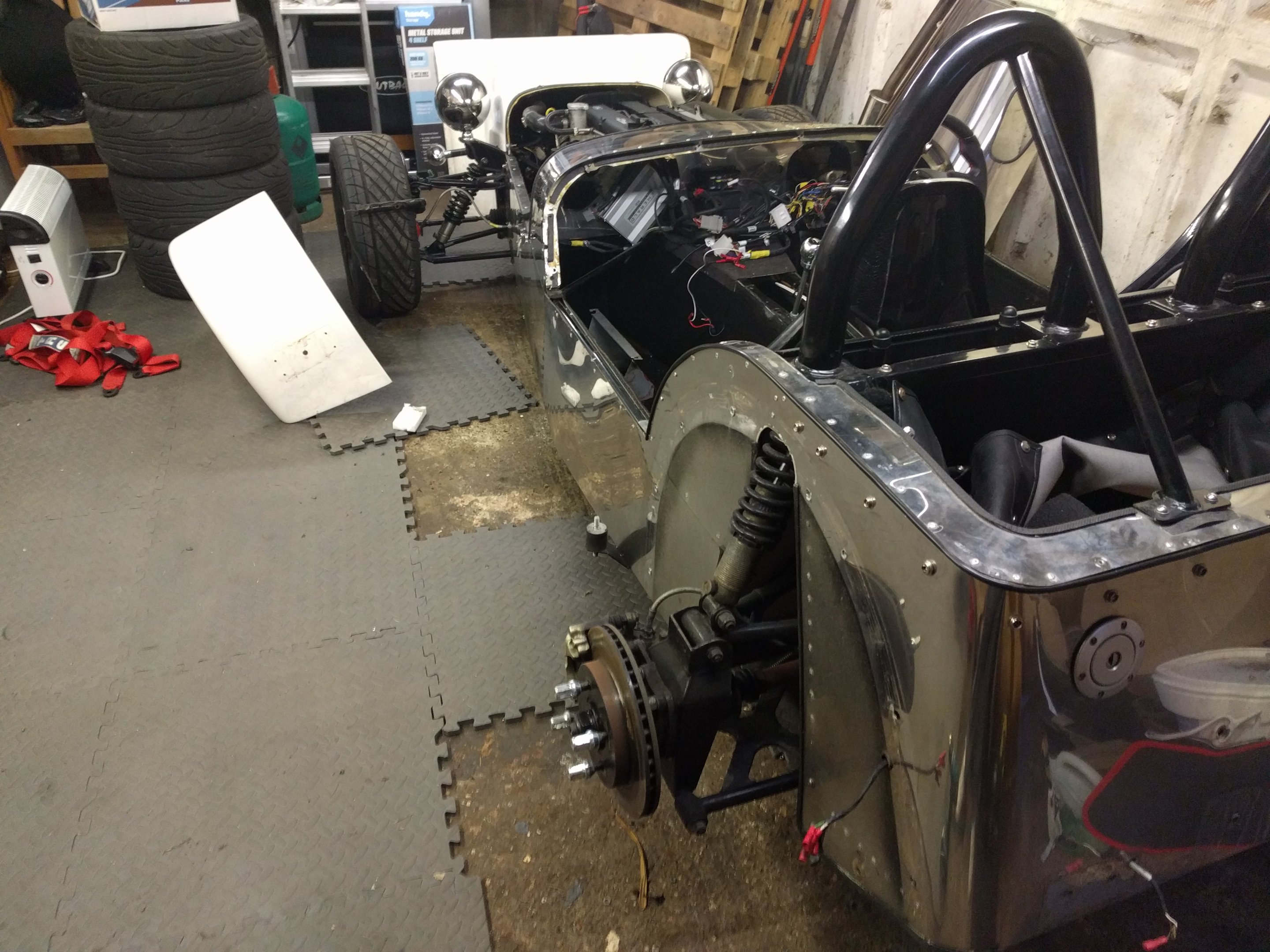

Rear arches and lights off

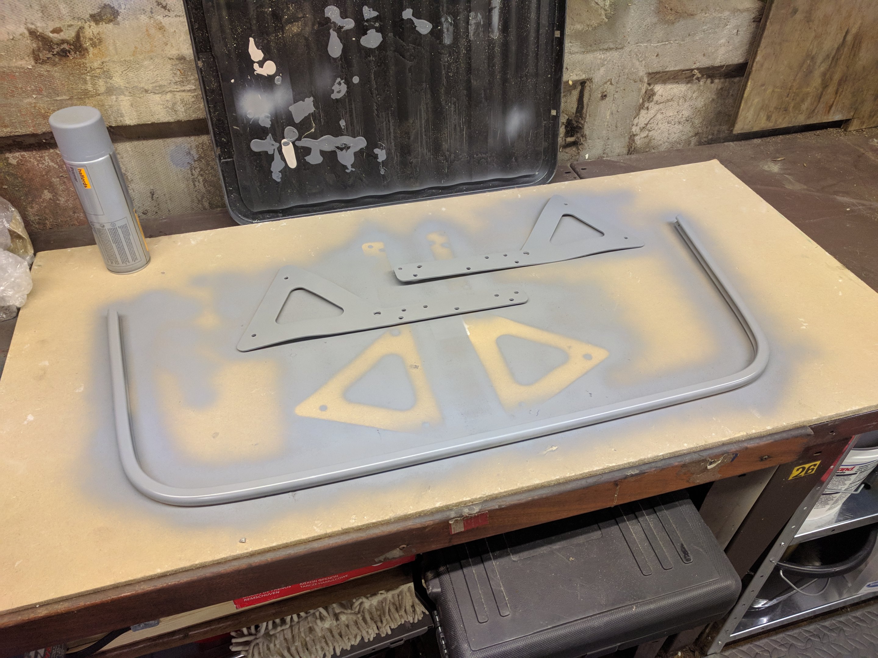

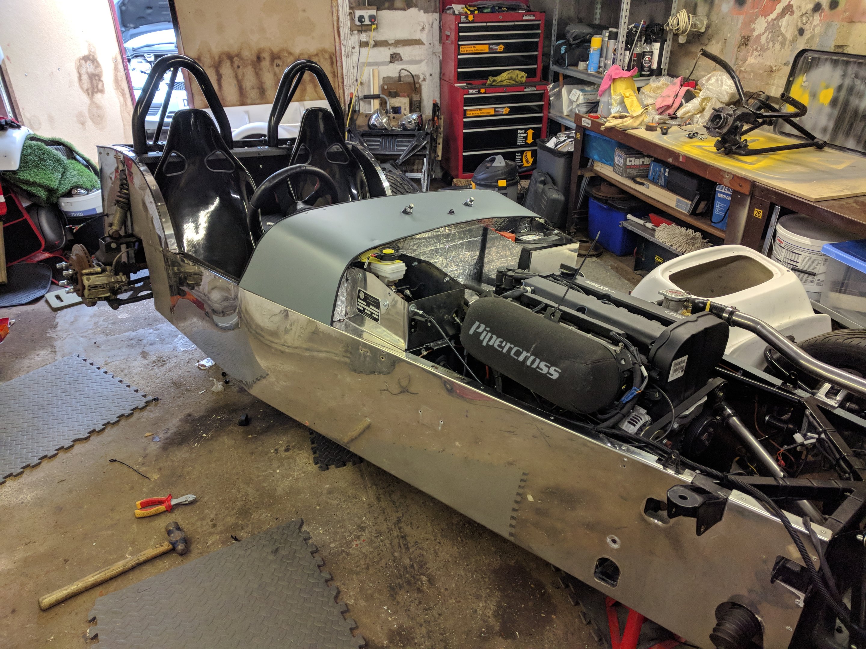

Started to prime the windscreen frame and brackets
Here's a bit I actually put back on!

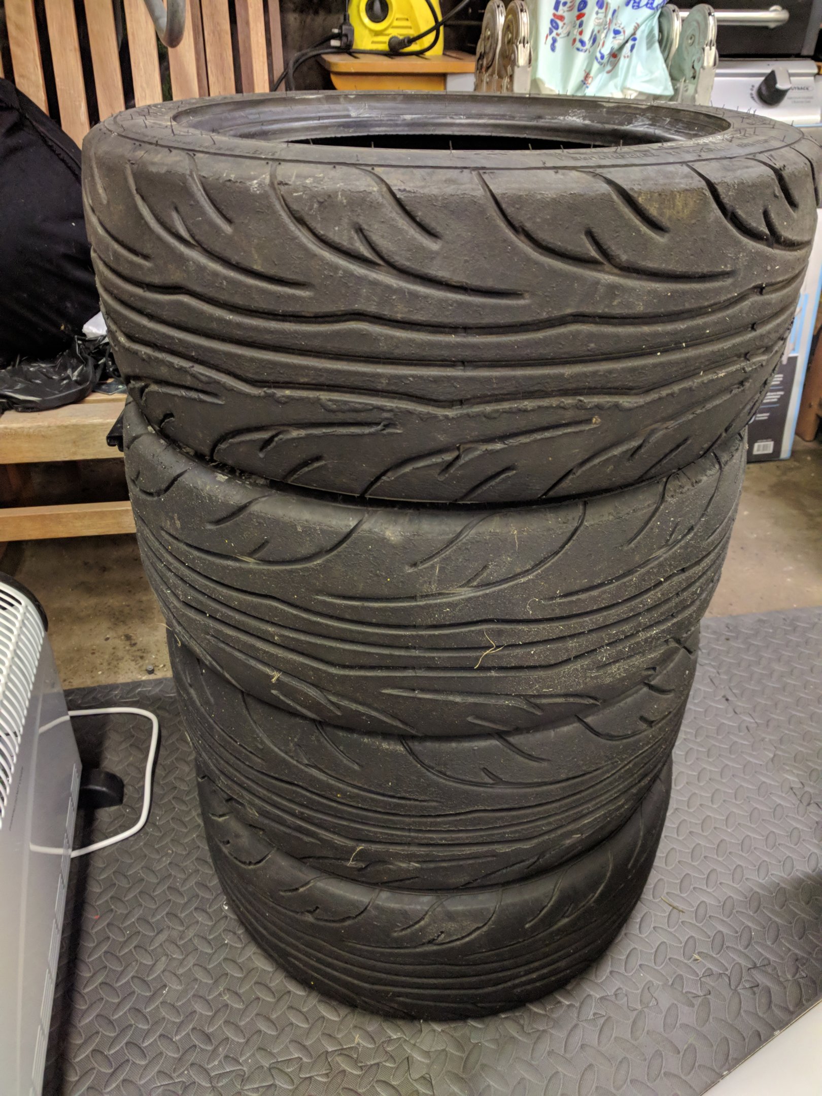

Also managed to pick up some cheap part worn NS2-Rs this morning. Still got s**t loads left on them and only 20 quid each!

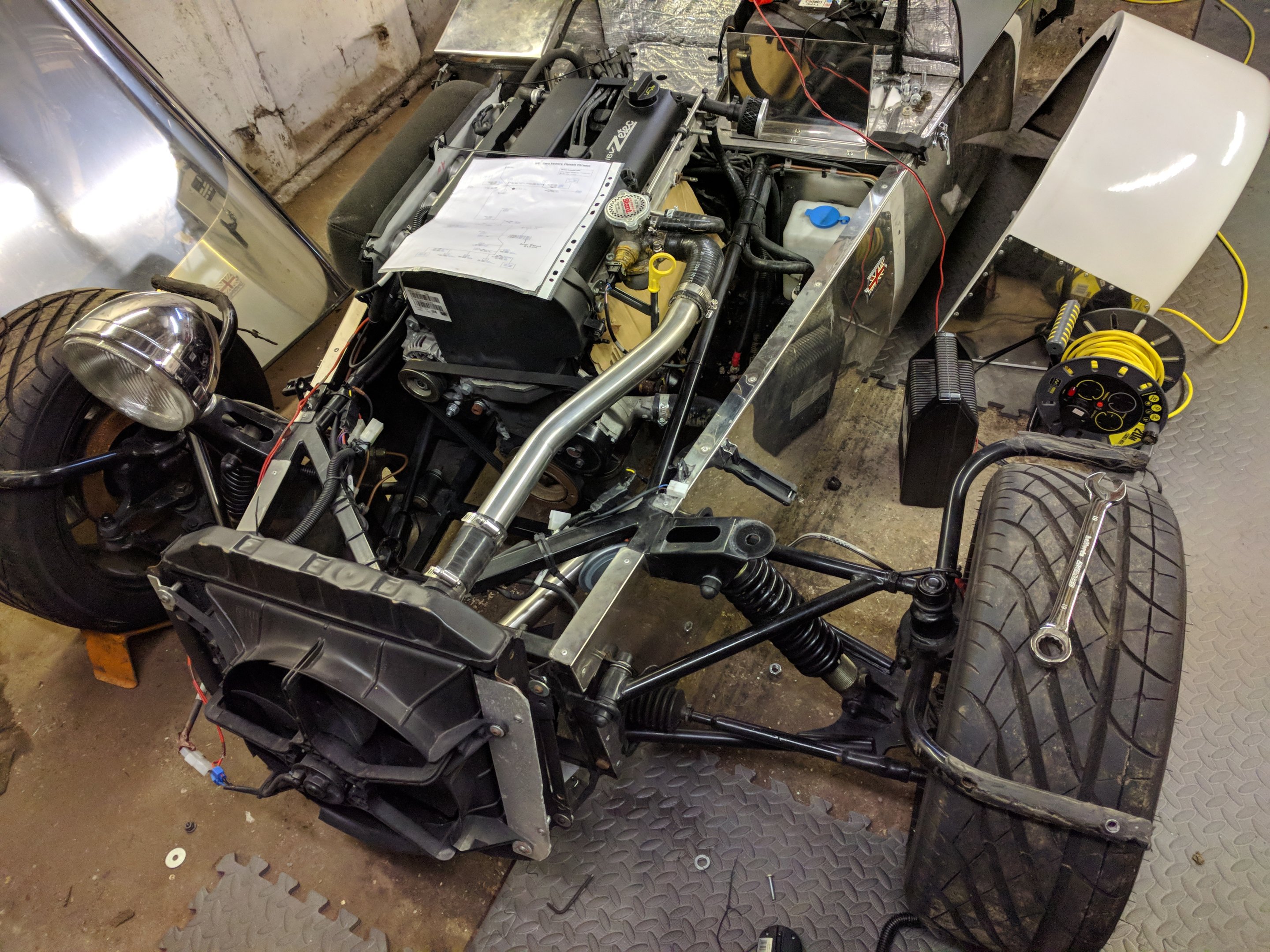

Got a load more rivets to drill out tomorrow, and then remove the front suspension. It'll be ready for wrapping next weekend hopefully

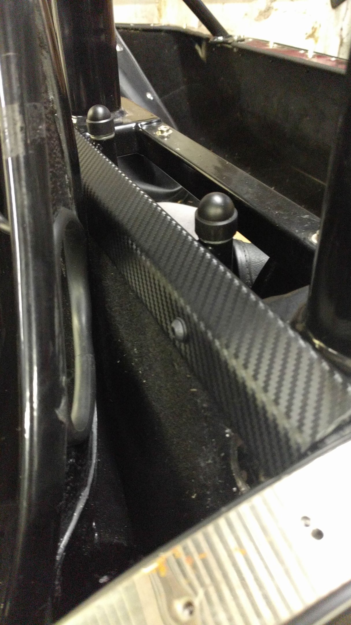

I like all the carbon wrapped bits, they’re much improved over the red!

Cheers Vicky, yeah the red definitely had to go!

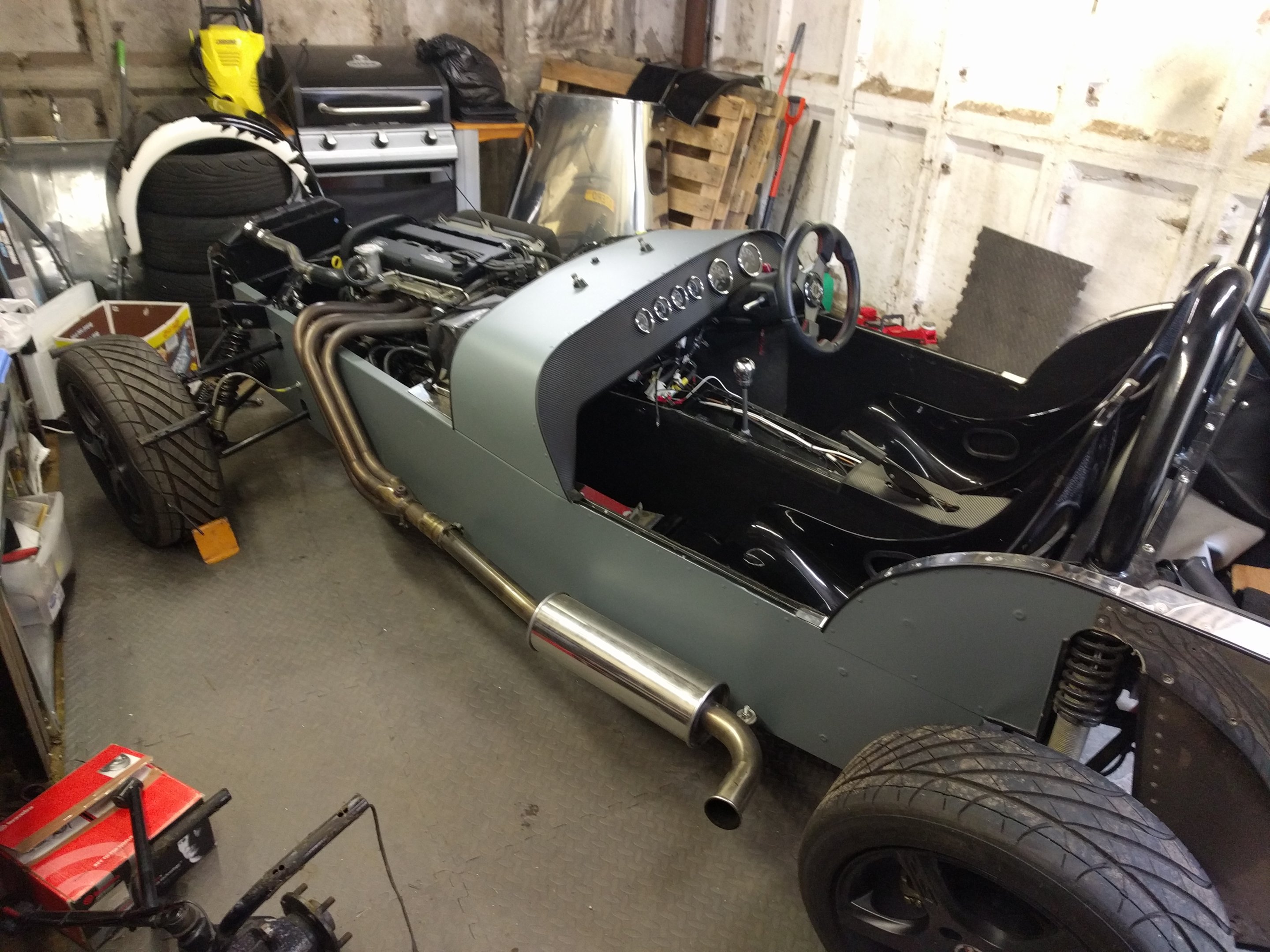

Cheers mate. It's not 3M no, it's a brand called KPMF. Im impressed with it so far.
Arches will be going gloss black, and the rest of the body is a matt grey. Although im not overly convinced by the colour now I've ordered it, but I'll give it a go see how it looks.
It's on 15s mate

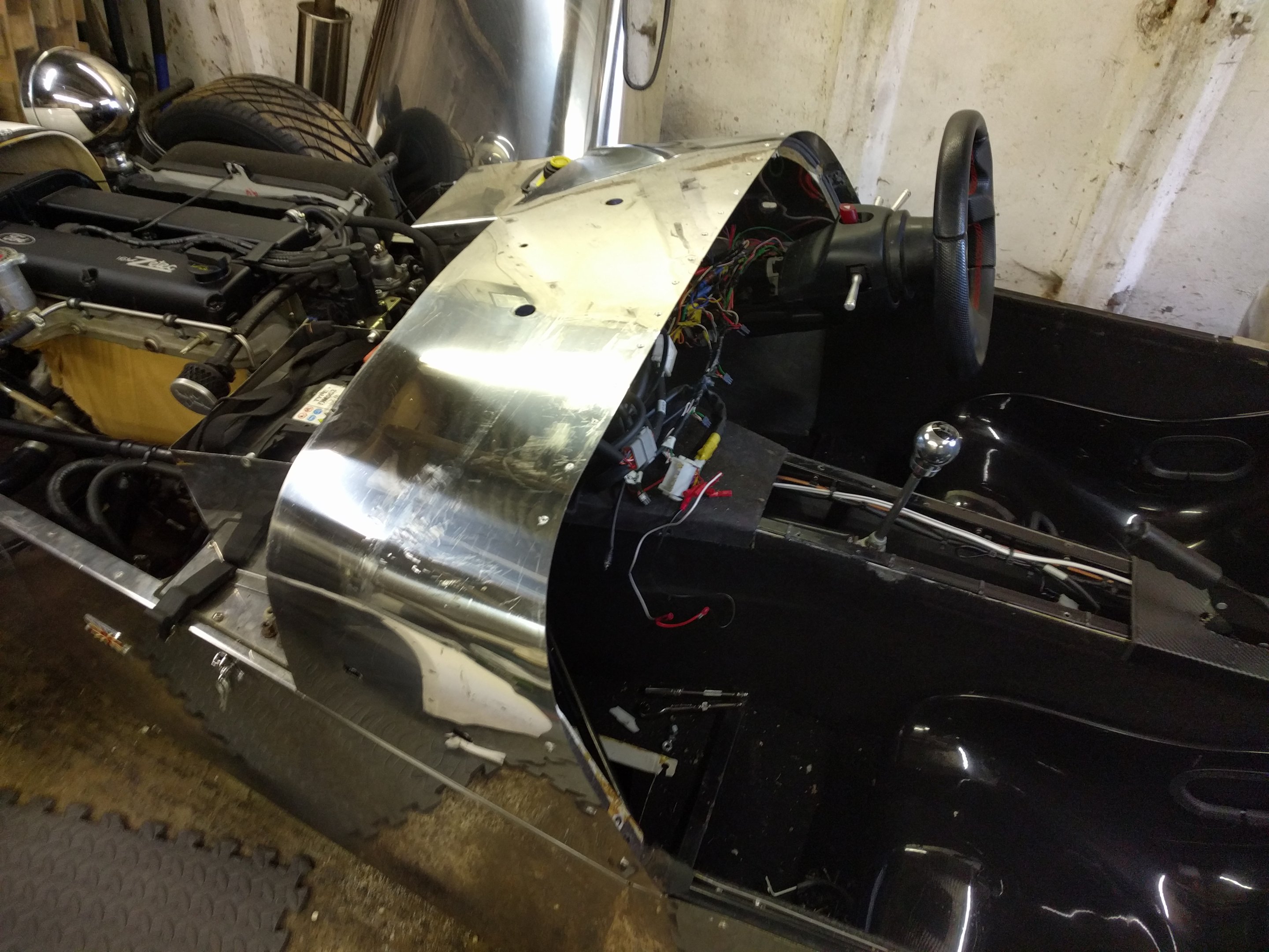

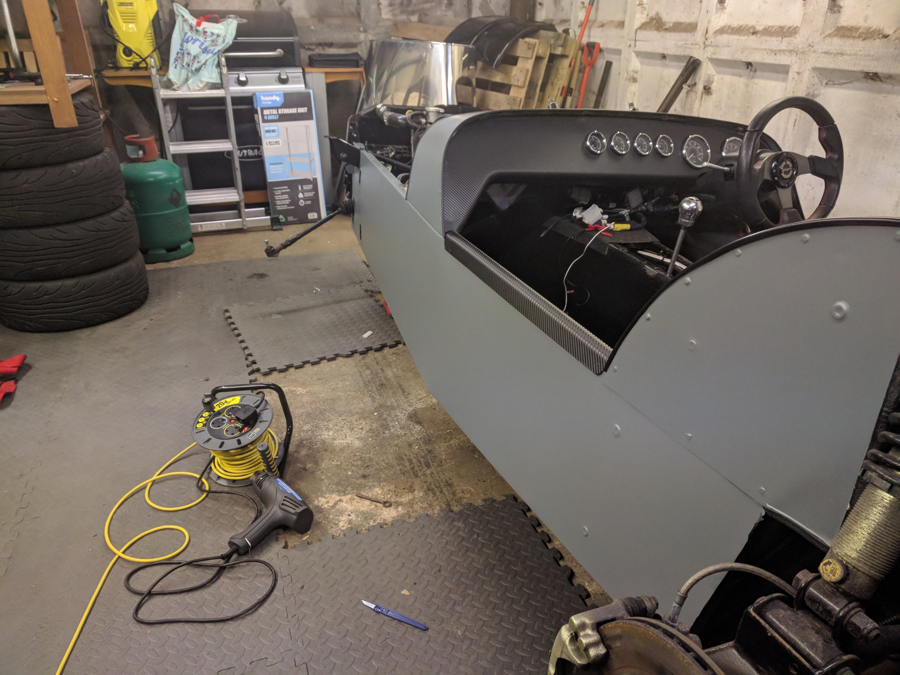

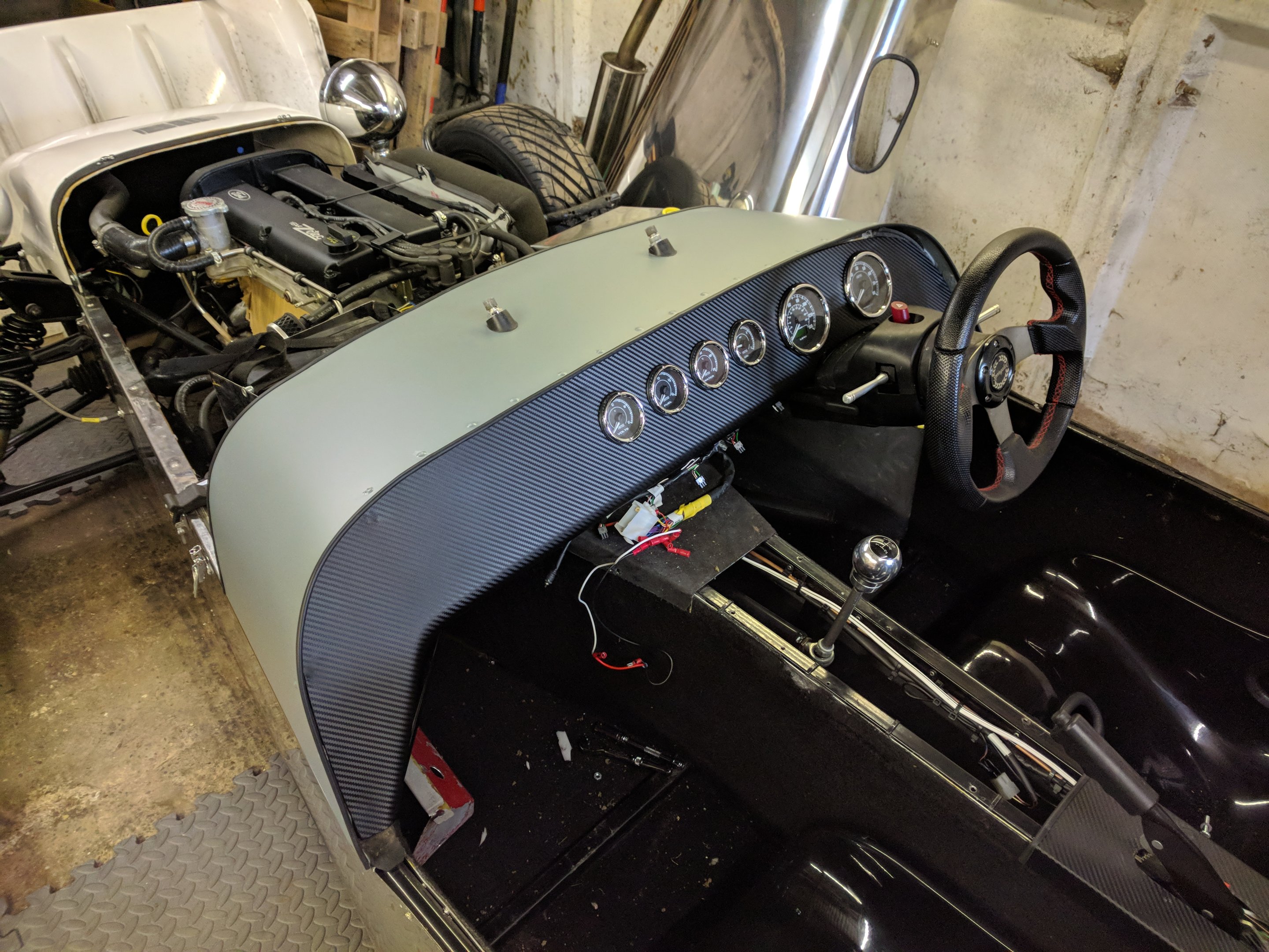

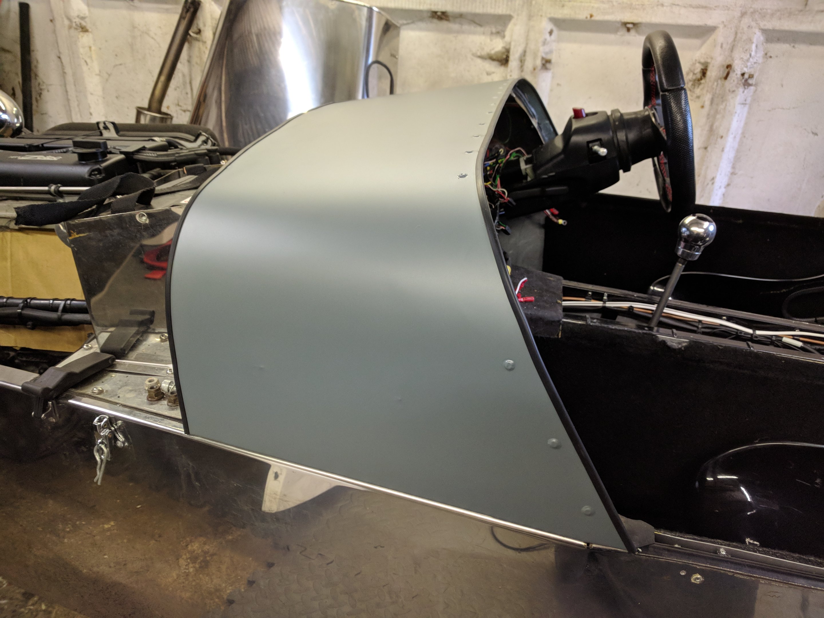

Started to wrap today. Ideally I would of liked to of drilled out all the rivets and replaced, but f**k that. The whole thing is held together with rivets, it'd take me months to wrap it.

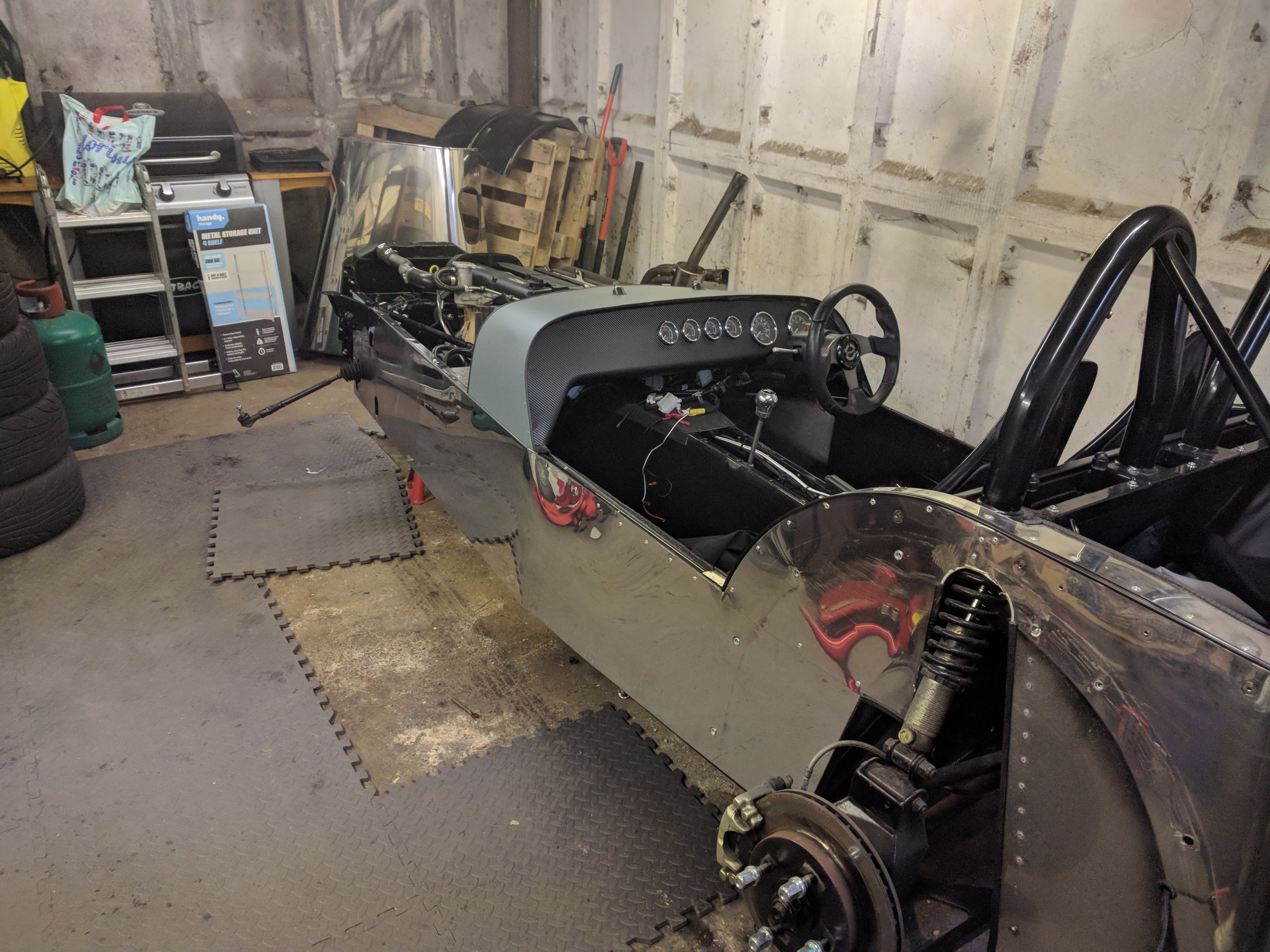

Dash placed back in to see how it'll look
Starting to strip the front end down aswell now as the front suspension arms need to come off to make wrapping easier. I'll replace the bushes aswell as I've found a bit of play in the upper wishbone

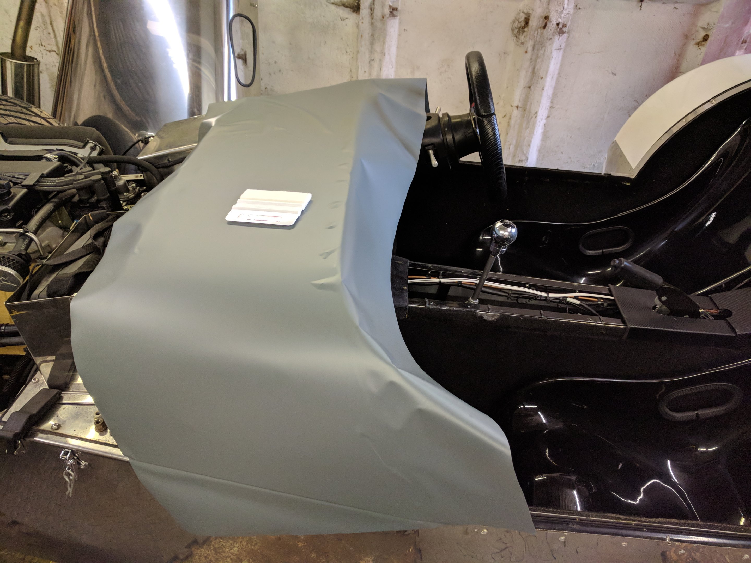

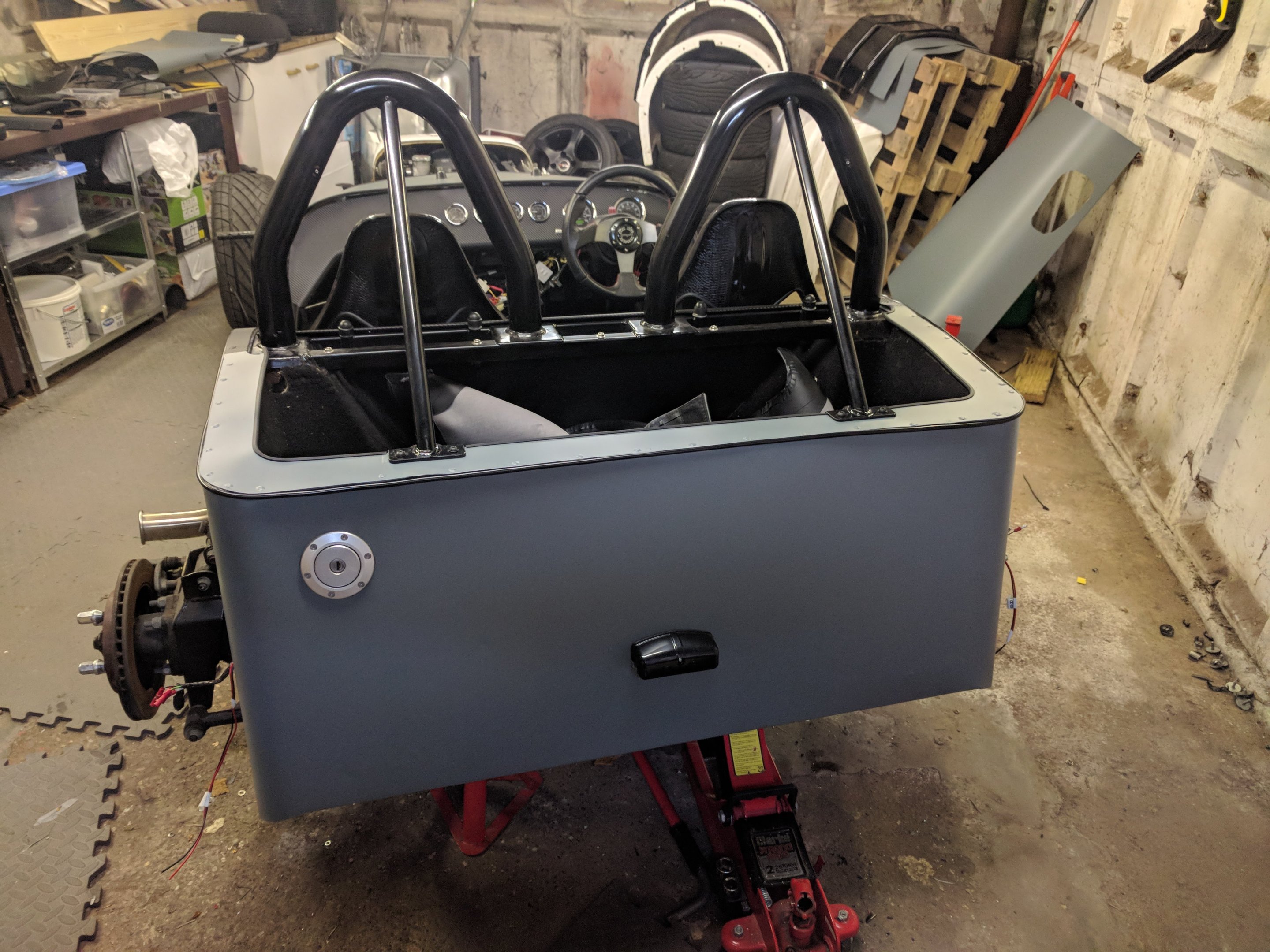

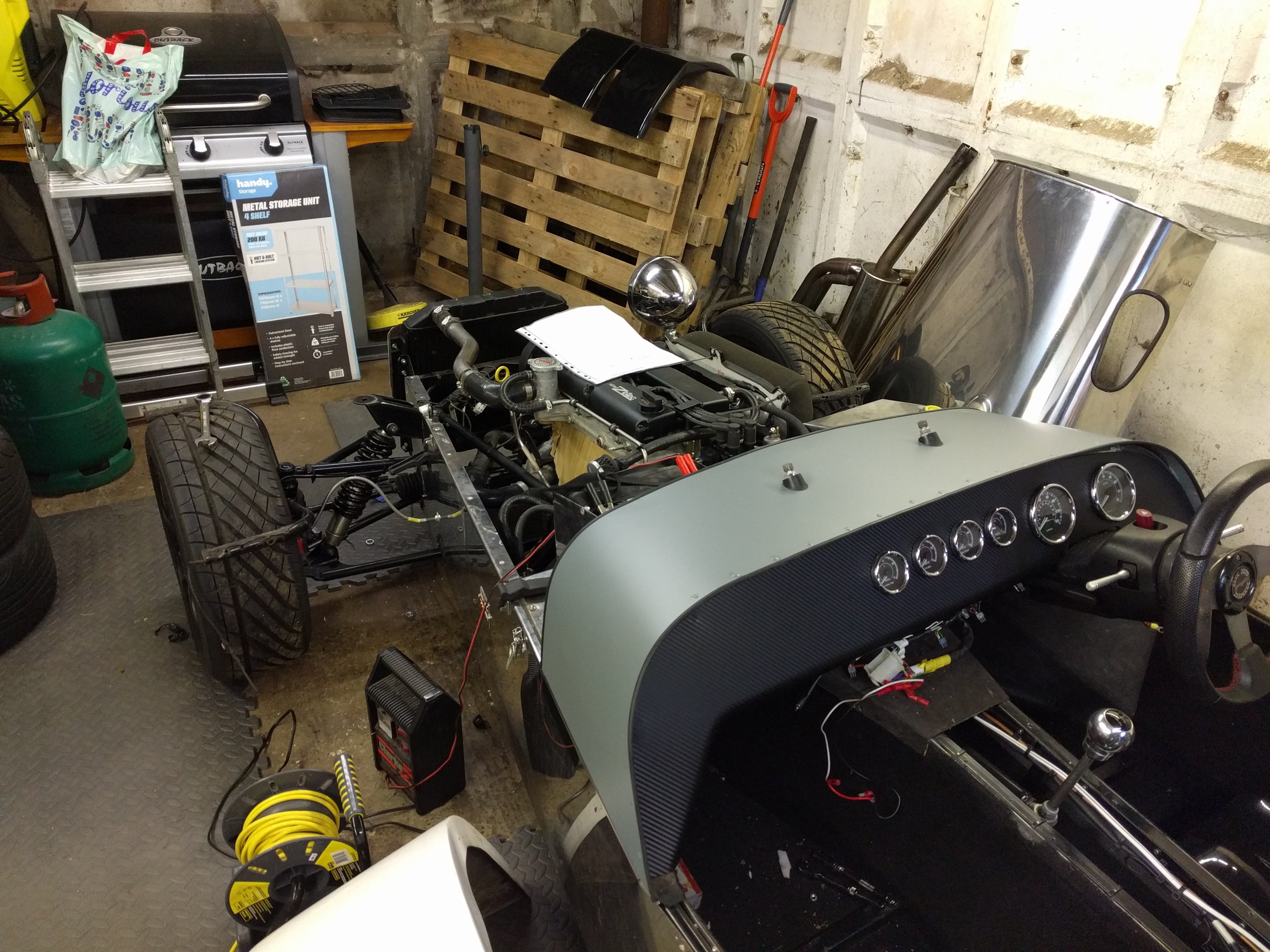

The wrap continues.
Before...
And after..
It's not perfect, but it's good enough for me. There's just one bit where I trimmed a bit short, but f**k it.
Drivers side, rear panel, and rear arches to go. I don't think there's a chance in hell I'll manage to wrap the nosecone, so I may just buy a new one already in black.
I then need to design some sort of vinyl stripes/stickers the side, just to break the grey up a bit

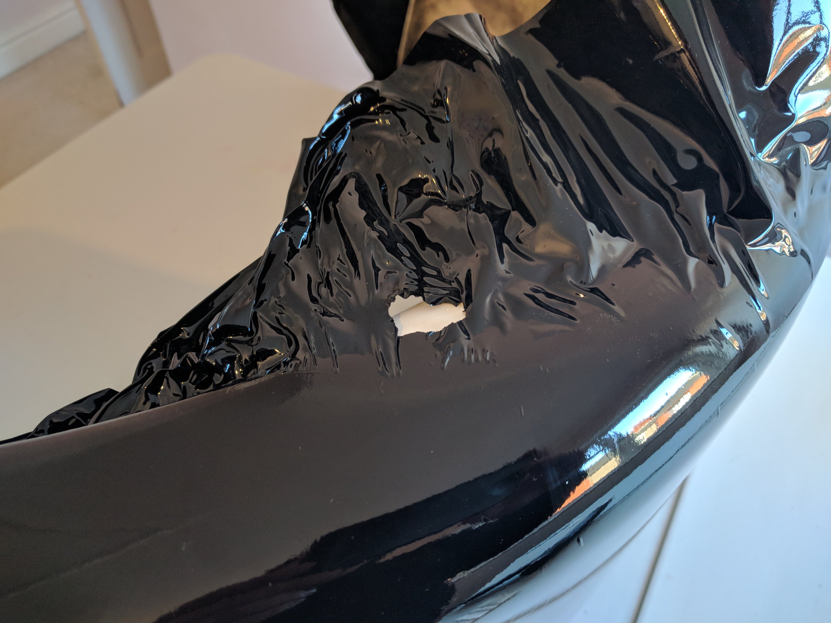

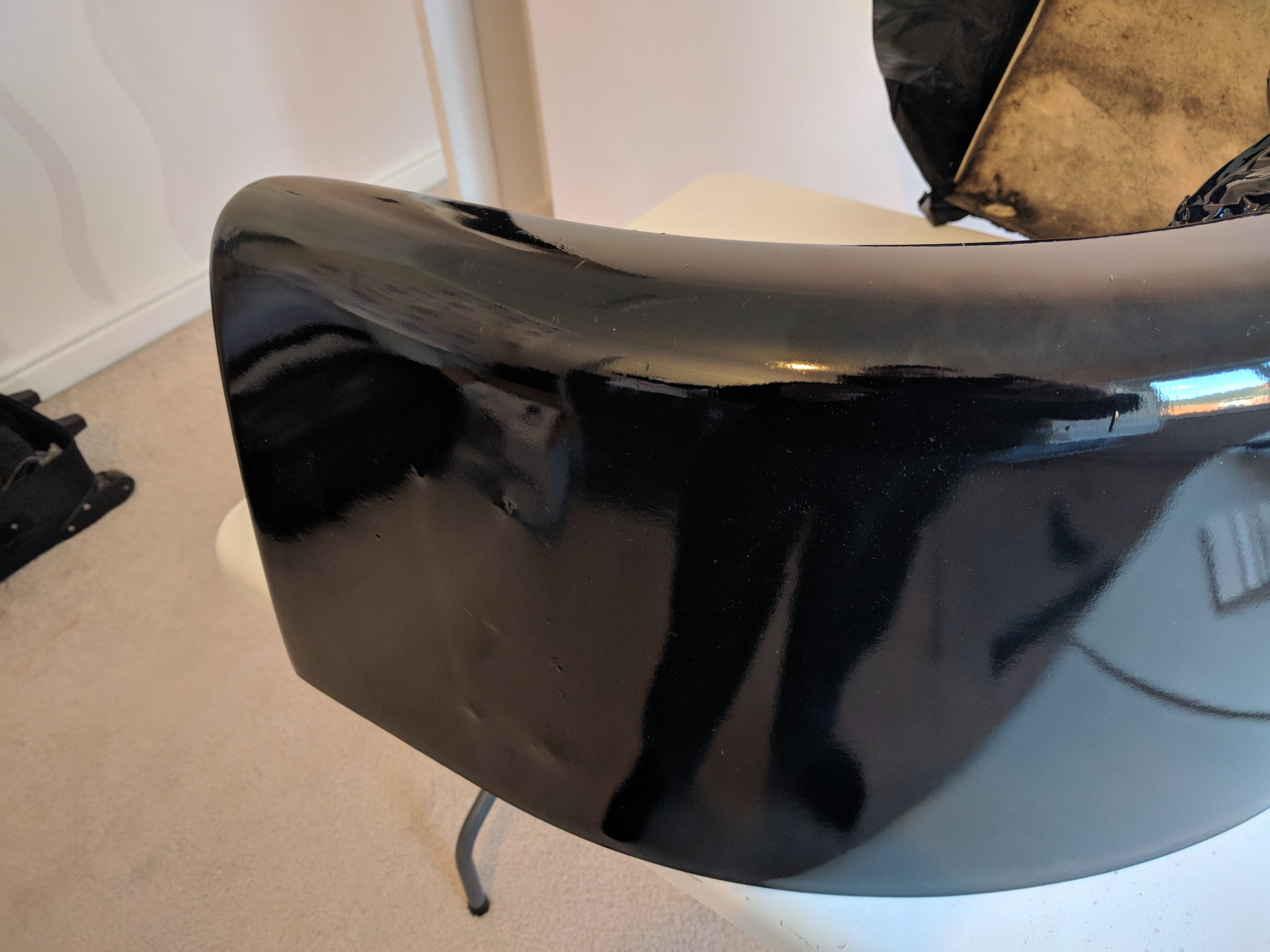

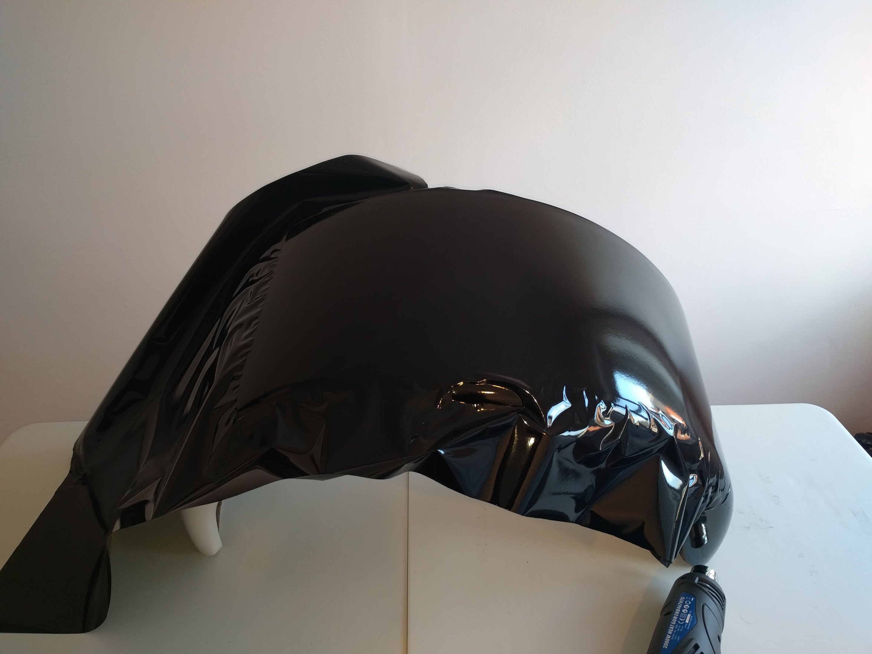

Ok so it turns out wrapping isn't so easy after all.
All was going well
Until I burnt a f**king hole in the wrap! w**k!
I think I'll buy some black arches 😂

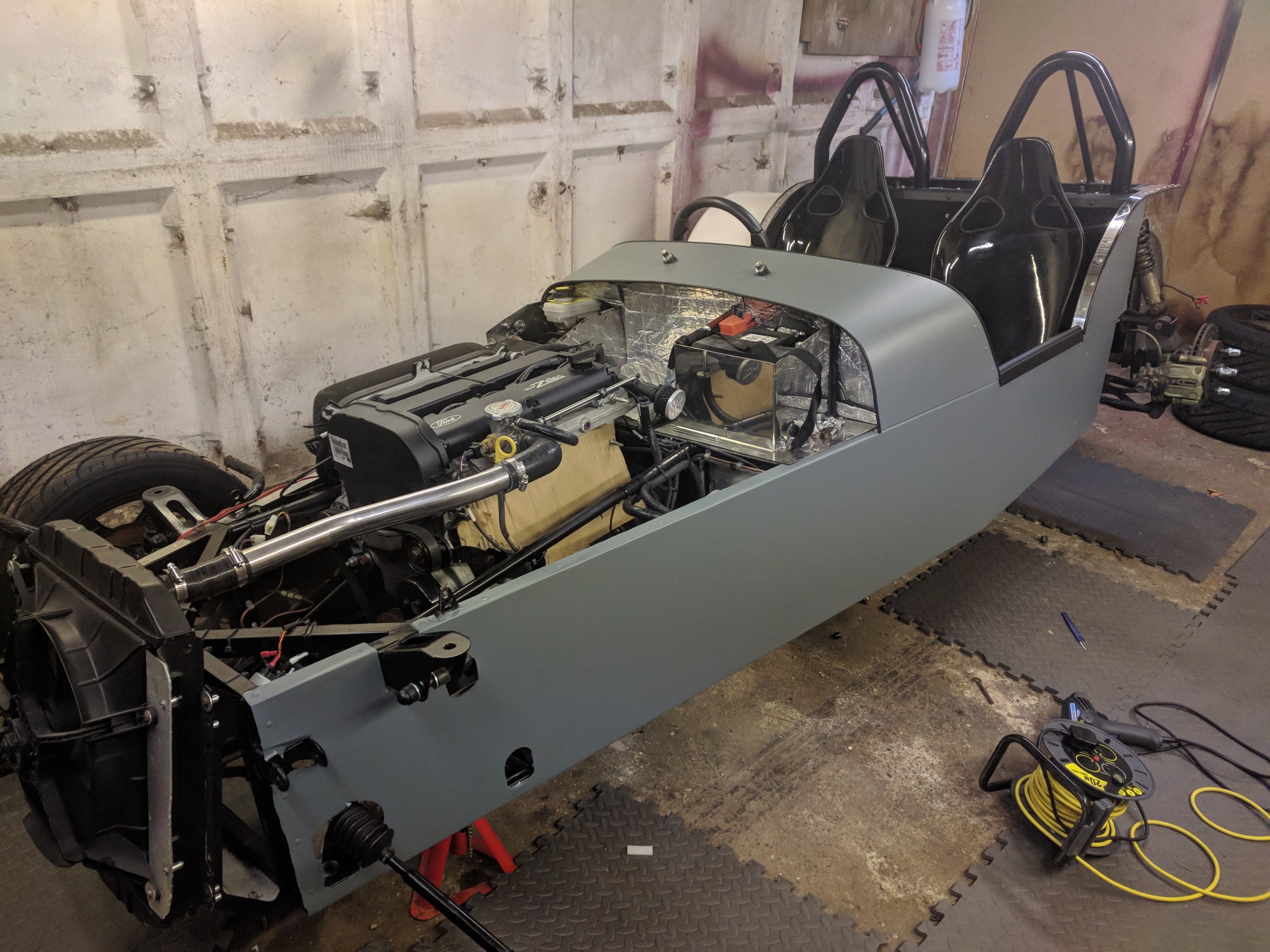

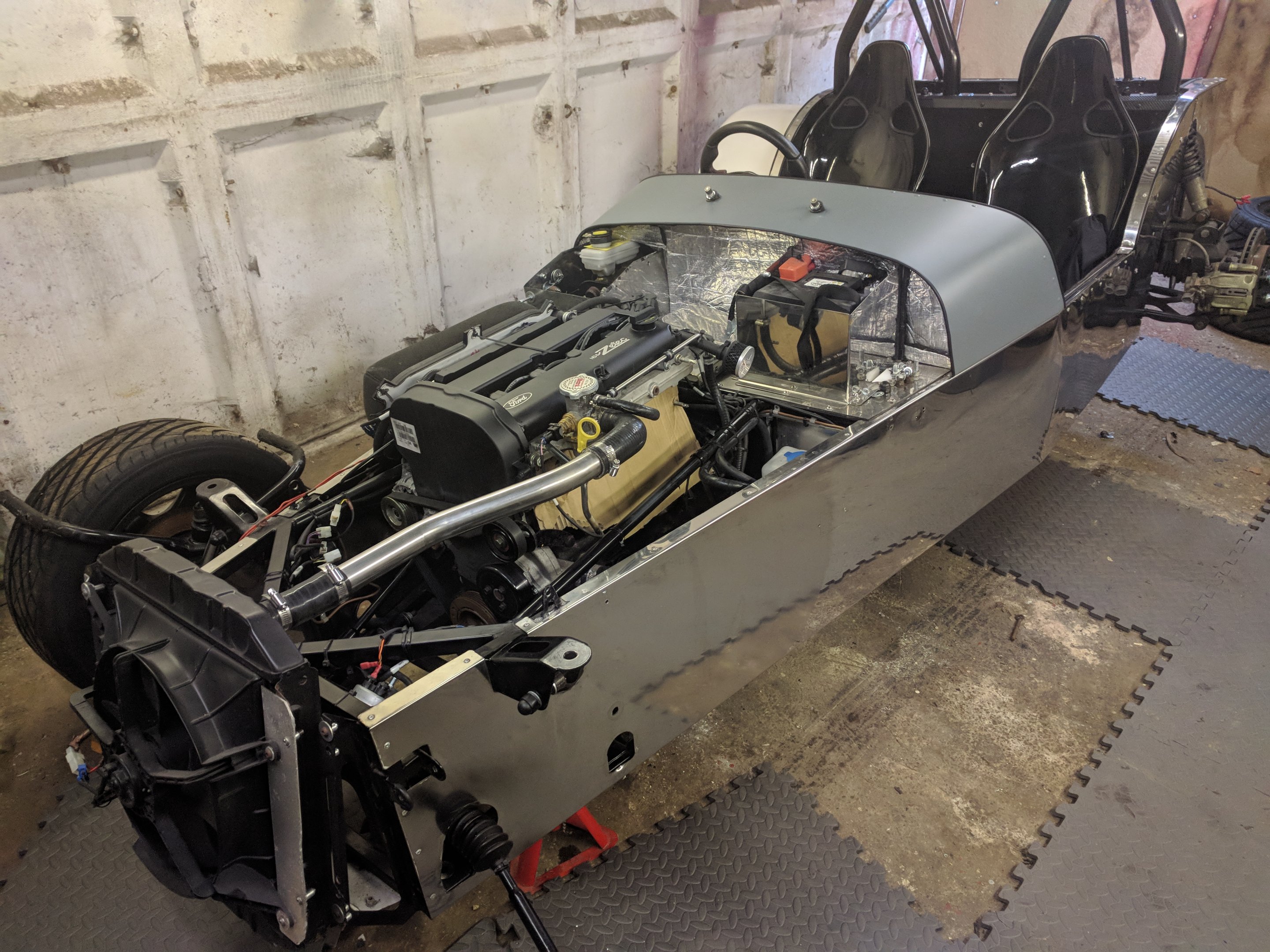

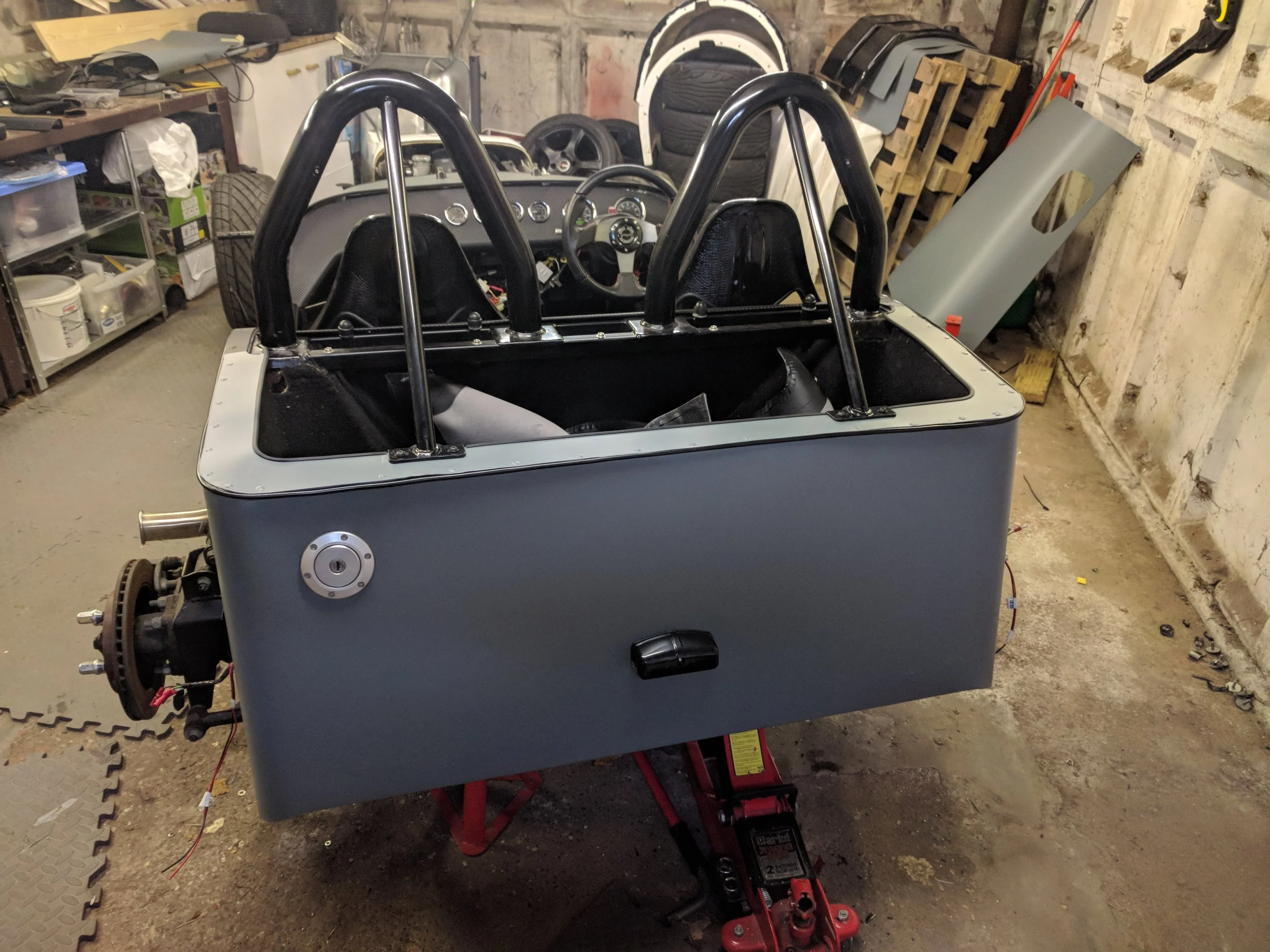

Passenger side suspension is back on. I've also sorted a bit of play in the wishbones I found. This was due to the crush tubes through the middle of the bushes being a touch too long.
Exhaust is now back on, and I've moved the car over in the garage to give more room all round it
Drivers side now stripped ready for wrapping next weekend

Not updated this in a while as progress has been slow due to 6 weeks away down in south wales. I'd got the odd bit done here and there at weekends but theres still a bit to do.
Everything is now wrapped apart from the nose cone, which I keep putting off as I know its going to be a ballache. I attempted the rear arches a second time, and wasnt happy with the outcome. Ordered a brand new set in black instead. Just waiting for those to arrive now.
Reconnected the battery and started it for the first time since around November time. Started first time. The cold map needs bit of a tweak I think as it runs a bit poo when cold
