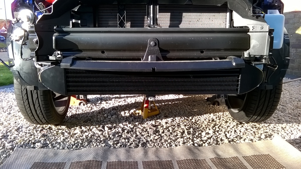

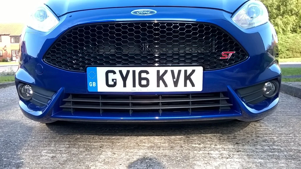

Small update .

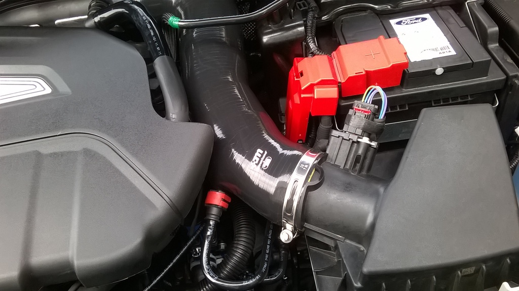

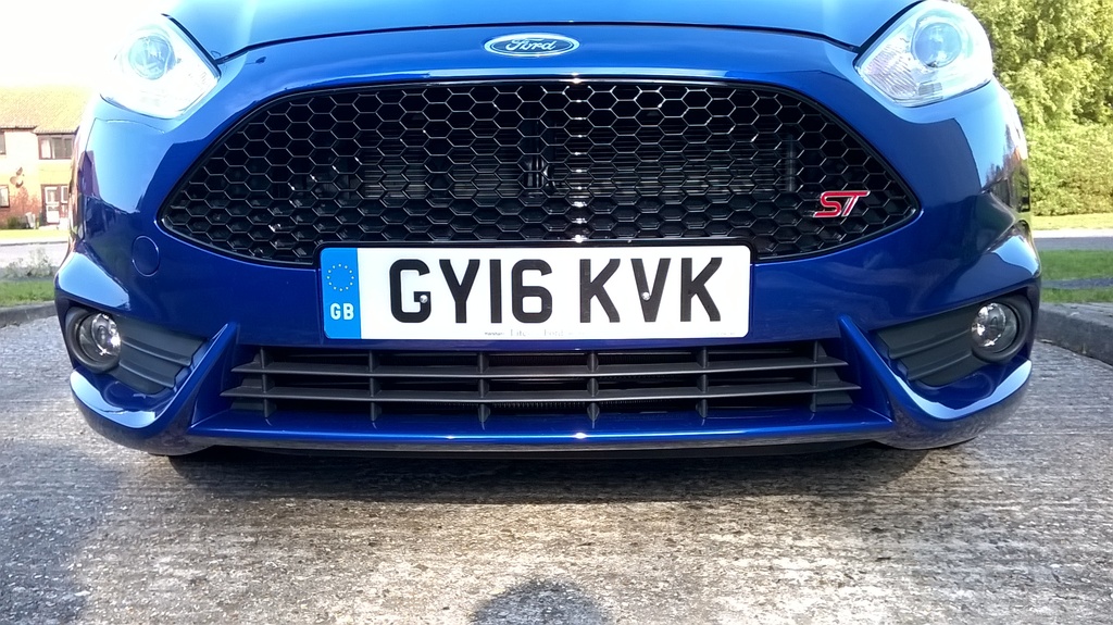

At the weekend I installed my MT intercooler and Charge pipes and hard pipe .

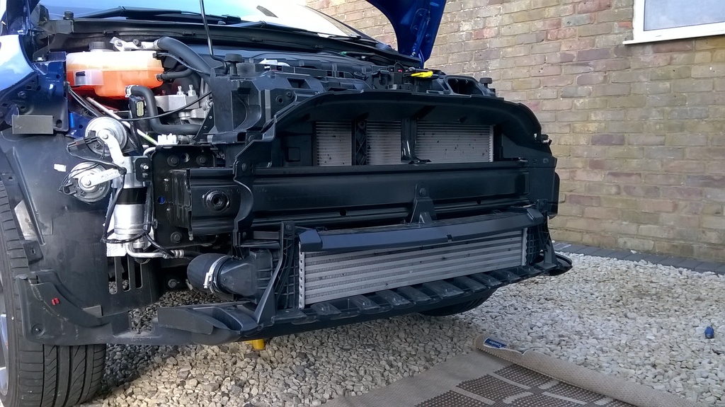

Lights and Bumper came off easy .
Then removed the stock intercooler .

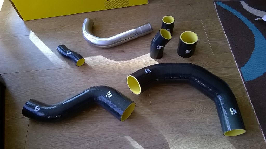

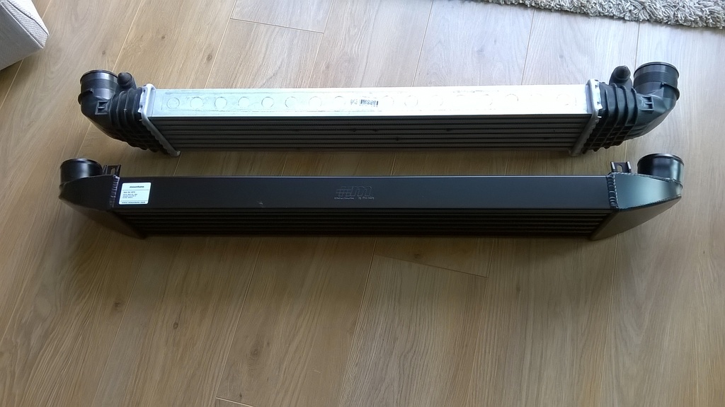

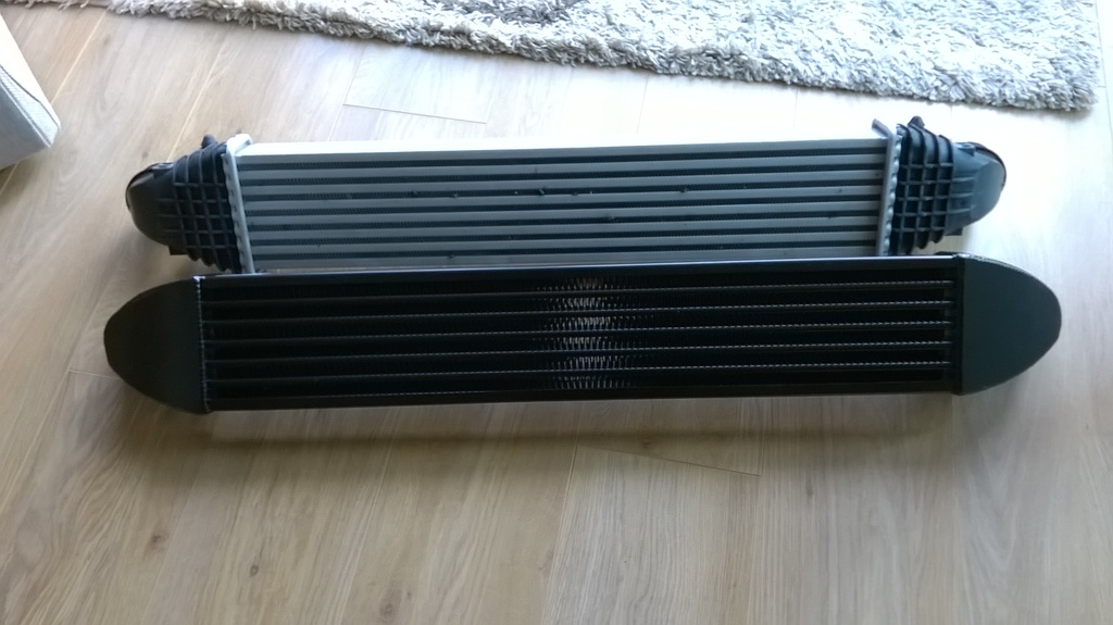

Next to the Mountune unit .

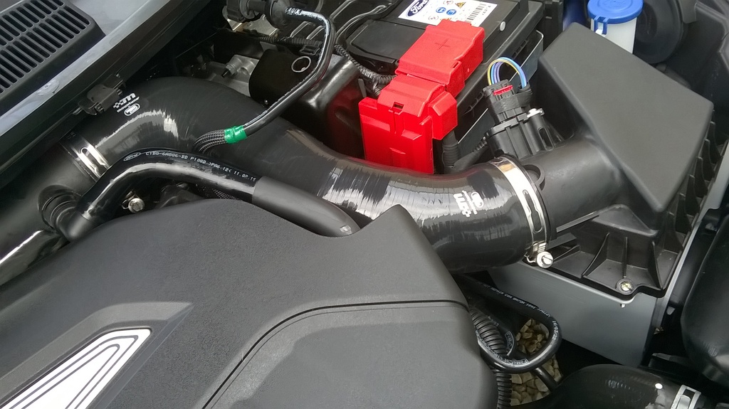

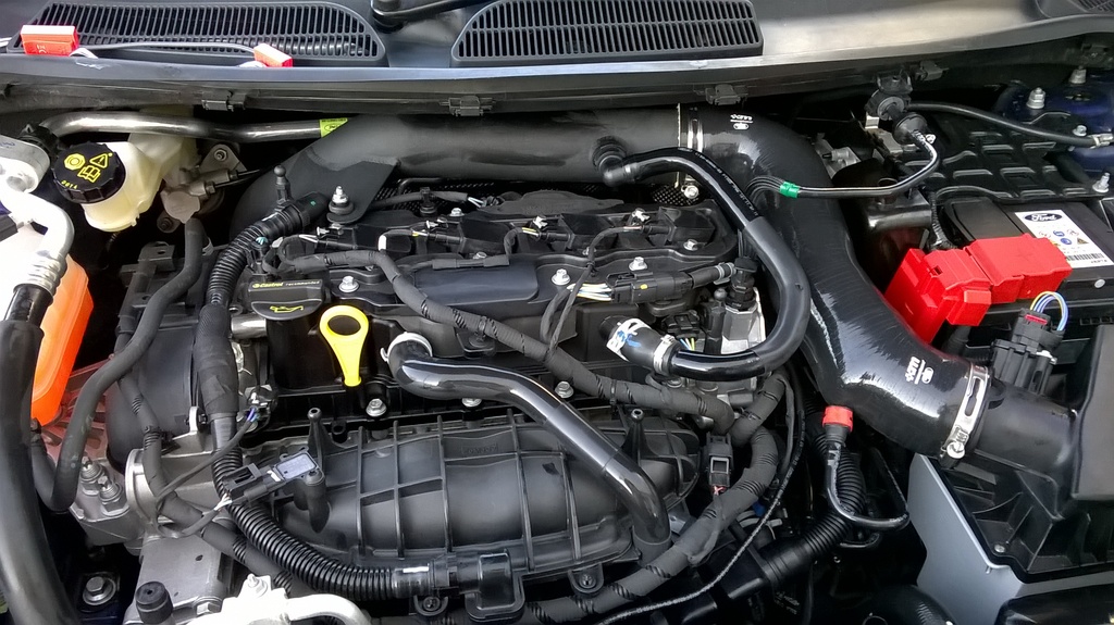

Charge pips and hard pipe
Installed
Intercooler installed
All back in and a nice black look for the intercooler .

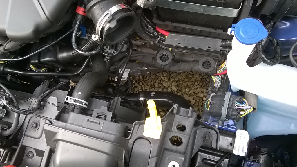

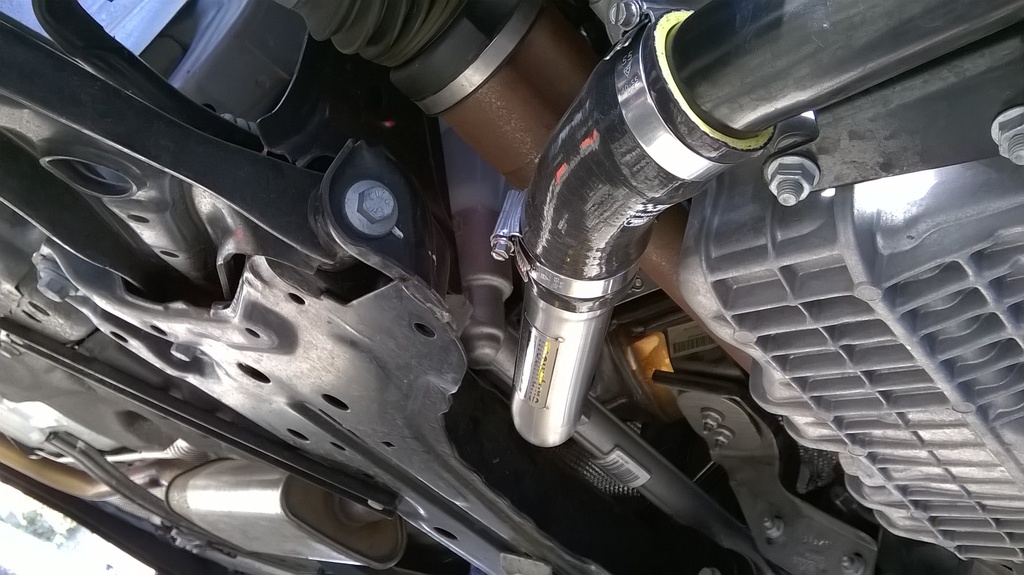

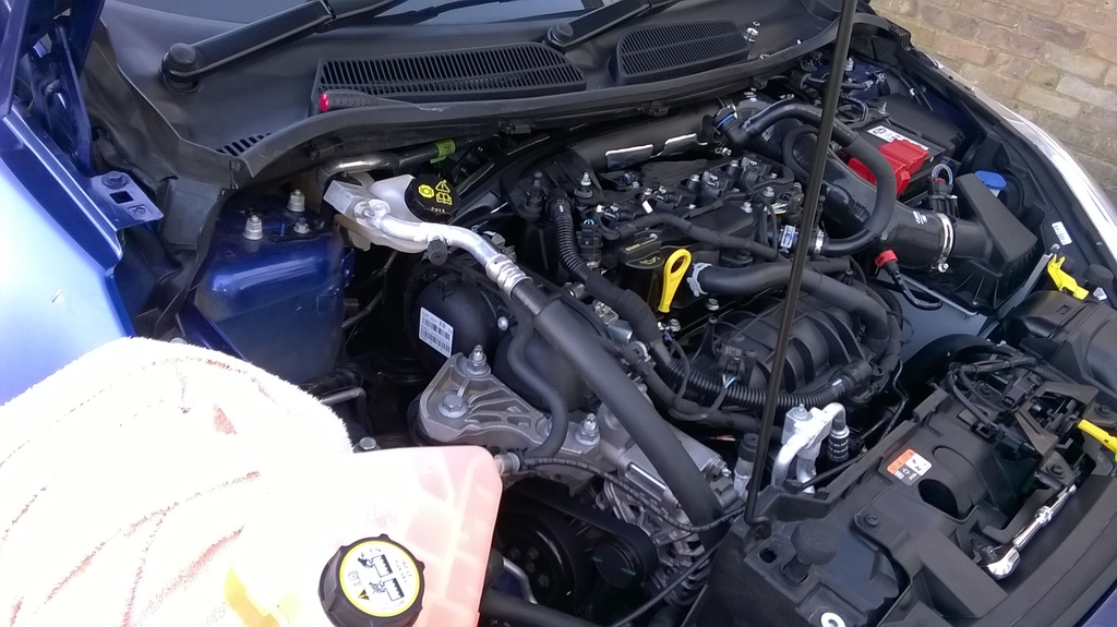

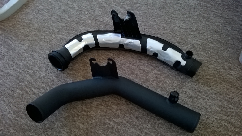

At the weekend I fitted my Crossover pipe that was ok to install but a bit of a faf at times but pretty easy .

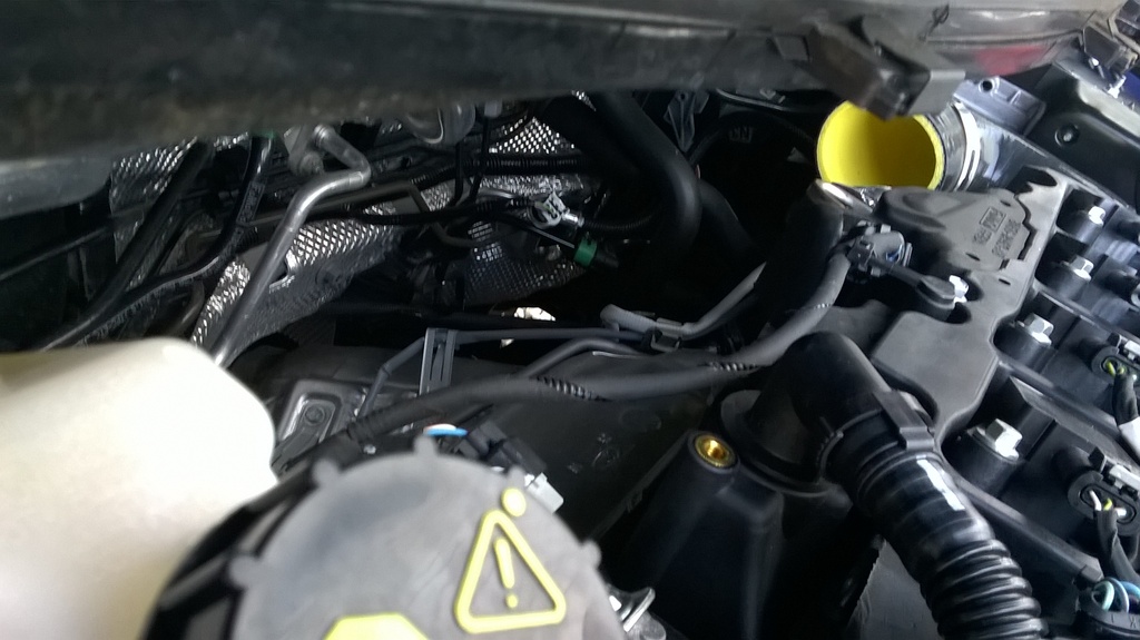

Removed the old crossover pipe taking out the headlight and coolant tank to get more room .

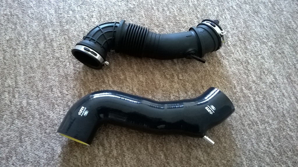

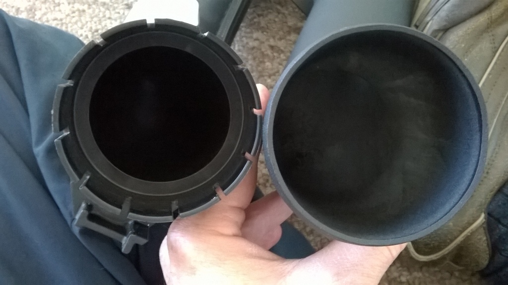

Old Vs new 70mm unit .
Installed .
http://s50.photobuck...vqlzo.jpg.html]
On a road test the pipe has increased the noise a little in a good way and the pick up is better .

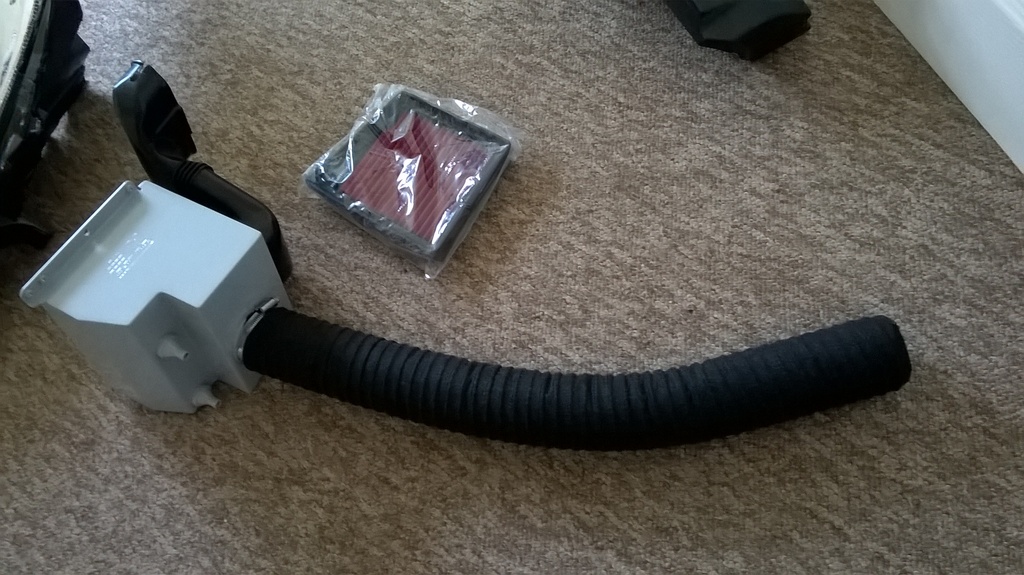

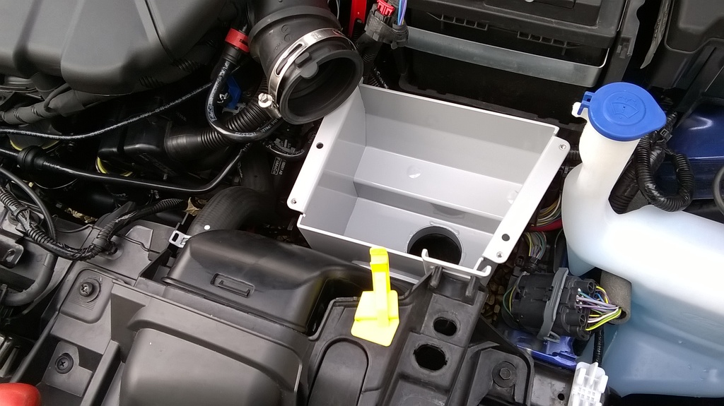

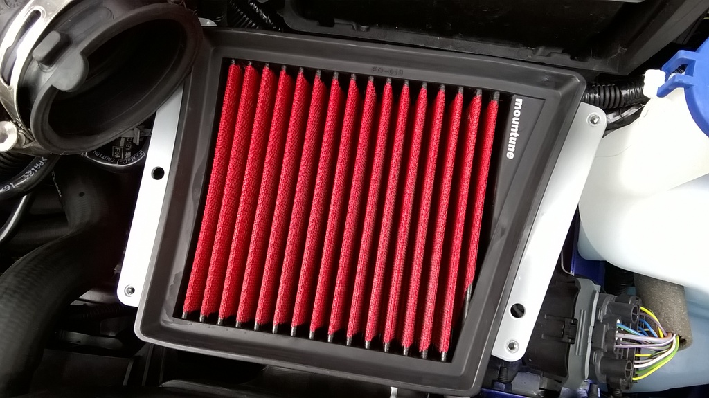

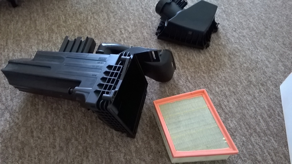

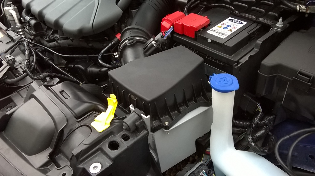

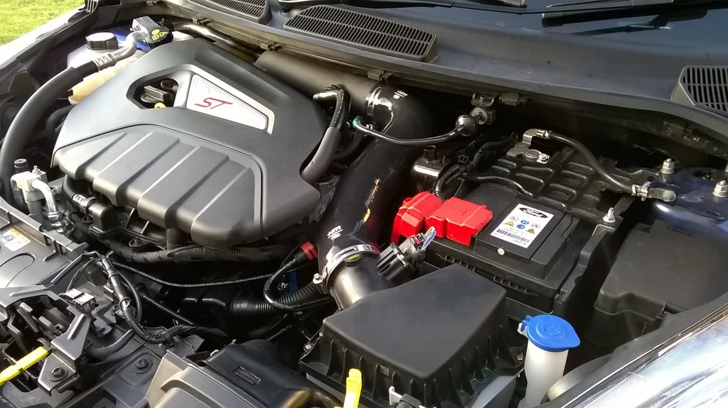

At the weekend I install my new Mountune induction box .
Removing the stock box was easy .
Then putting together the Mountune unit .
Installing .

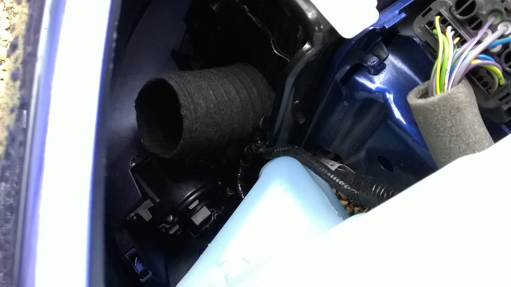

Mounting the cold air feed .

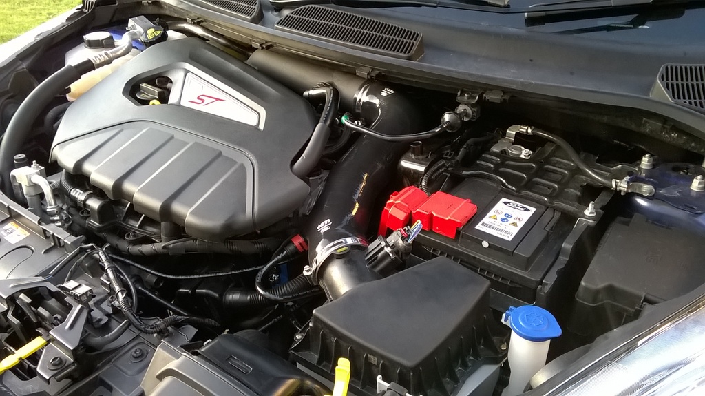

All Done and installed .
After taking for a test run the car has a little bit more throttle responsive and the induction noise is a tiny bit louder .
