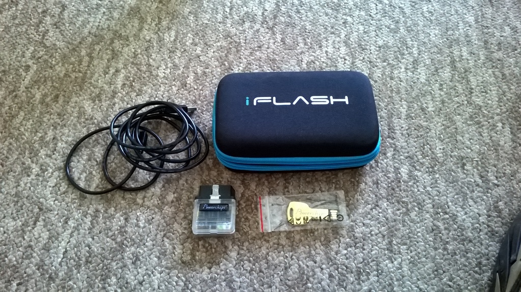

On Saturday I installed my CP2 map to go with the below parts that I have fitted to the car in the past months .
CP2 I Flash

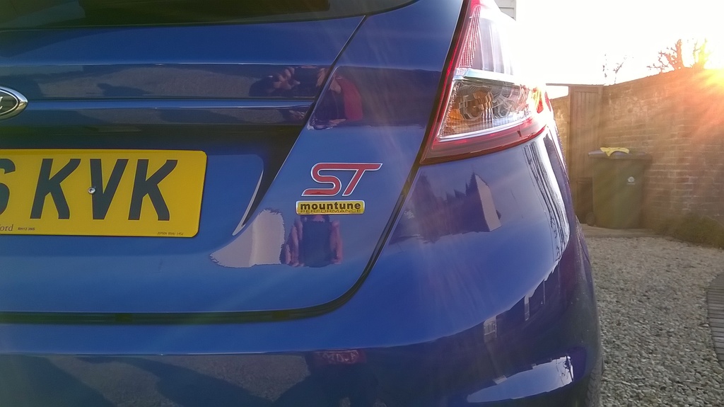

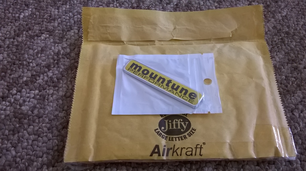

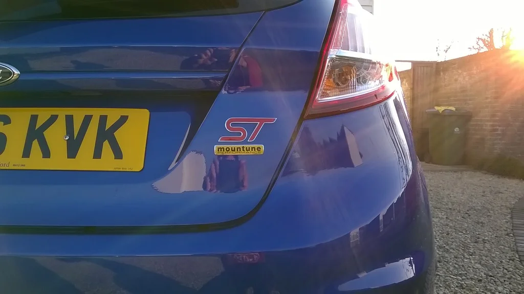

I then installed my MT badge to finish off .

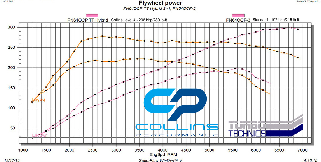

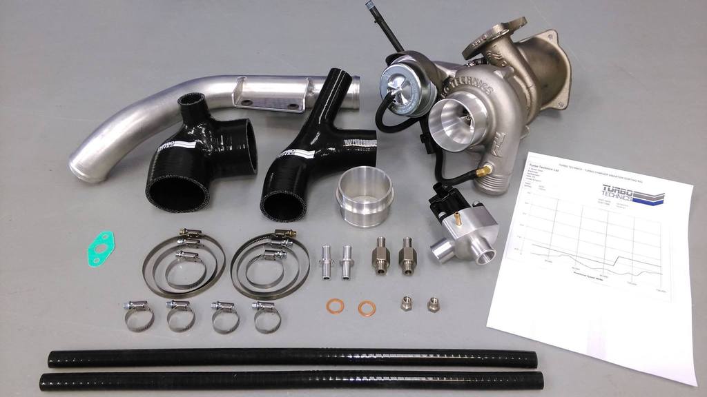

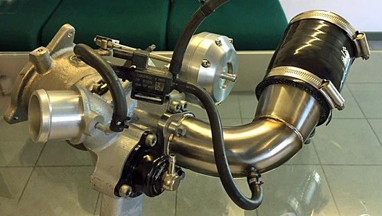

NEW - Fiesta ST180 CP4 (Turbo Technic turbo) upgrade package. (298bhp/290 lb-ft limited)
CP Level 4 software, Turbo Technics Turbo (exchange), Airtec Stage 3 Intercooler, ITG Induction system, Mongoose 3” turbo back Exhaust system
300 brake! I know how mental a decent 230 one is and I can't see why you would need more in that little car but wow!

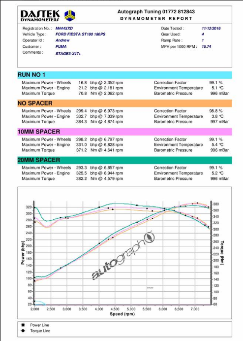

Featuring the awesome X-47 turbocharger, along with our own design uprated actuator, we have seen impressive results! Even during the early stages we have seen over 320bhp at a low 1.5bar.
We intend to run this turbo at a safe level, with all factory Ford safety measures intact, to maintain absolute drivability and reliability, with torque capped at 285lbft to maintain longevity of the transmission and to produce a very linear and smooth power delivery.
We believe this is a much better package all round compared to our previous CP4 package, as it is more drivable than the larger turbo we previously used .

Had my CP4X installed on Friday .
It was a 250 mile trip up to Cheshire from Bognor Regis and around 4 hours 30 min .
Did not get any pics but below was what was done .
The car was running the CP2 pack that was the below making 230 BHP and 250 LB/FT and was very quick and like the Mountune MR230 pack but with just a bit more BHP and Torque and non restricted 1st and 2nd gears .
Mountune stage 2 intercooler
Mountune induction pipe
Mountune boost pipes + solid hot pipe
ITG induction
Ram air induction cross over pipe
Collins performance CP2 software
The CP4X package I had was the below .

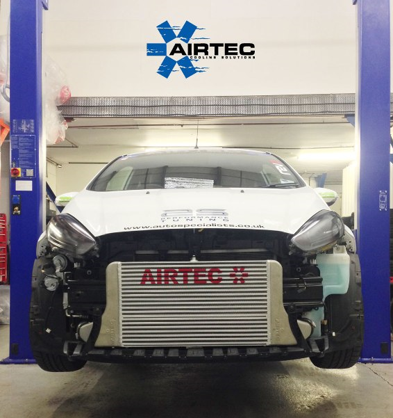

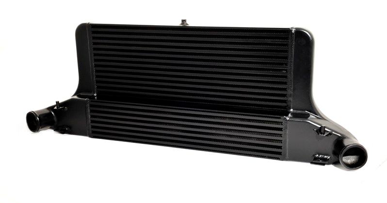

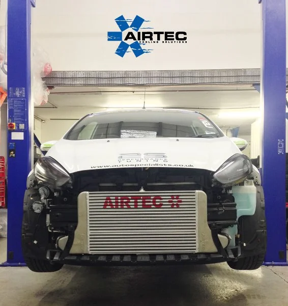

Airtec stage 3 intercooler step core design 85mm thick lower section and a 40mm thick upper section all in black with no logo .
X47 Hybird turbo with uprated inlet elbow , progressive Actuator , 45mm Large Bore Turbine shaft with Clipped back blades , 56.5mm Extended Tip 7 Blade Billet compressor wheel ,
CNC re-profiled compressor cover to match new X-47 billet alloy wheel , Motorsport Heavy Duty thrust bearing assembly , Modified Seal Plate to match hi-flow compressor wheel and
Motorsport Specification Cut back turbine blades for high flow at high RPM .
Collins performance CP4 software .
All was installed with in the day just and the car was taken for a full data log session to make sure everything was ok .
With this little lot the car will be at around 290 BHP and 275 LB/FT as I still have the stock cat on ( bigger that on a Focus ST or RS I was told ) and the stock exhaust system .
To finish this off I will be getting the Mountune 200 cell sports cat and Mountune cat back exhaust then we should be at 325 BHP and 290 LB/FT .
The drive back was fun and is a very big jump up from the CP2 the car was running and that was very quick but now its very very quick but looks totally stock and still getting 50 MPG on a run .
