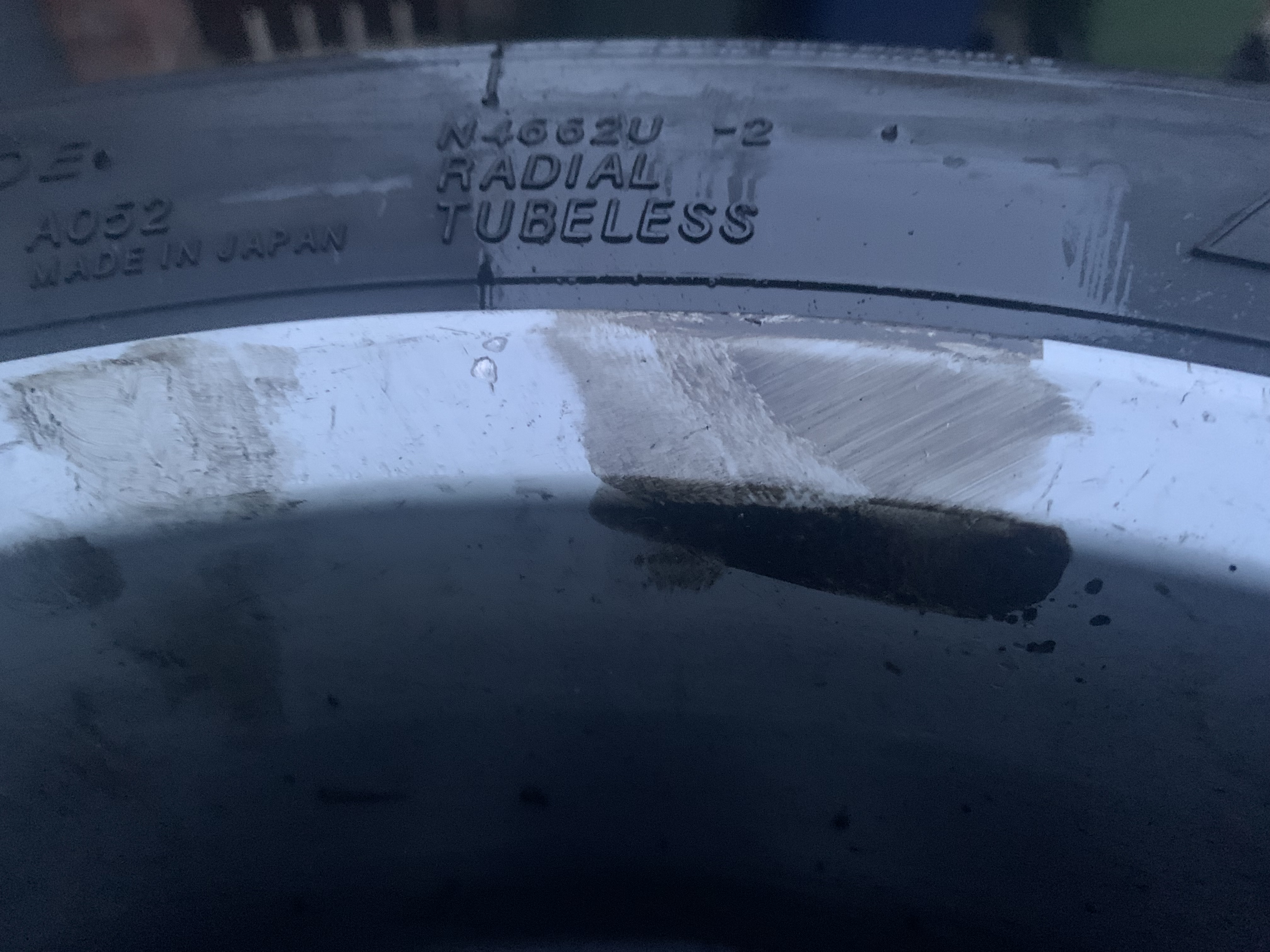

Fit my new tyres as the 52s currently on it are dead.

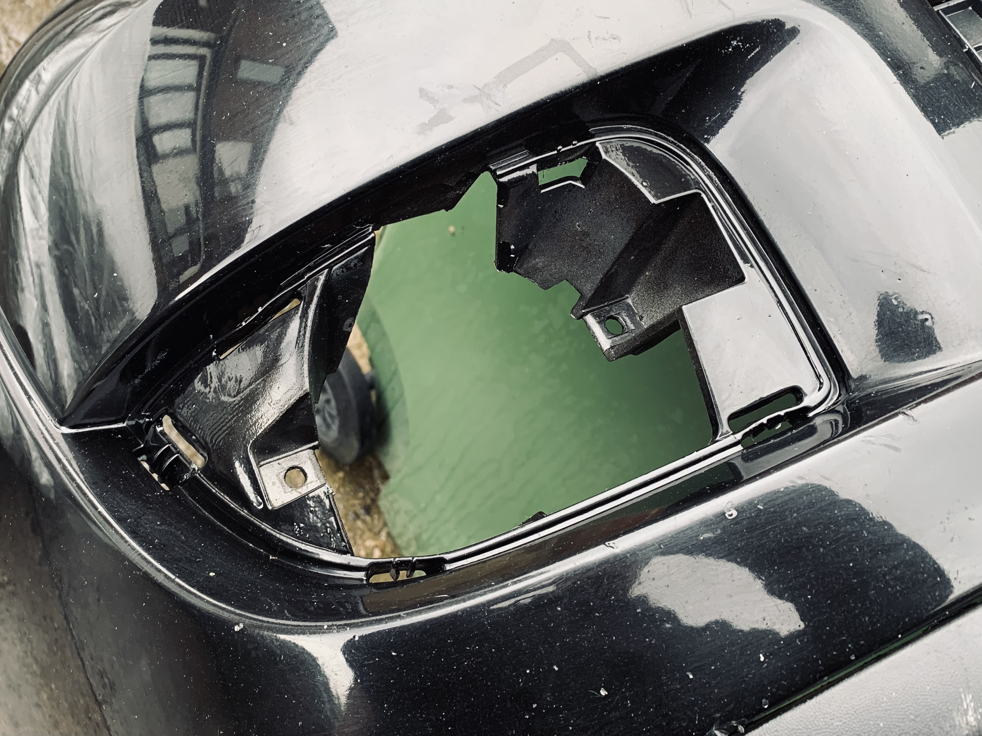

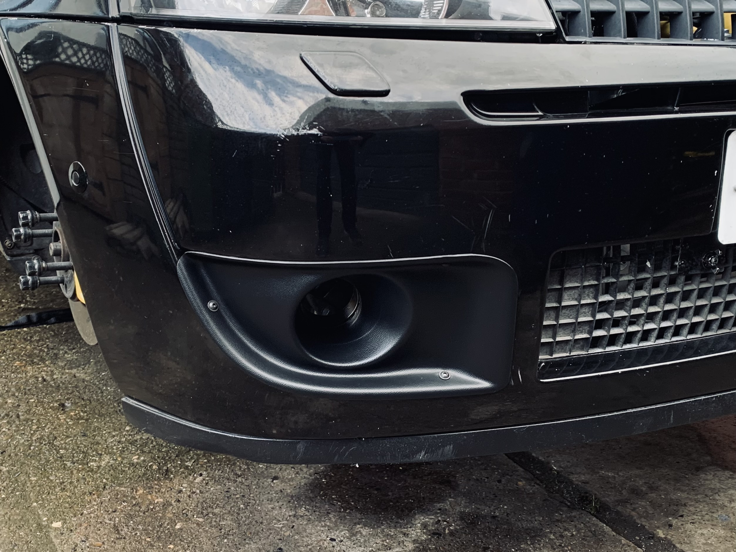

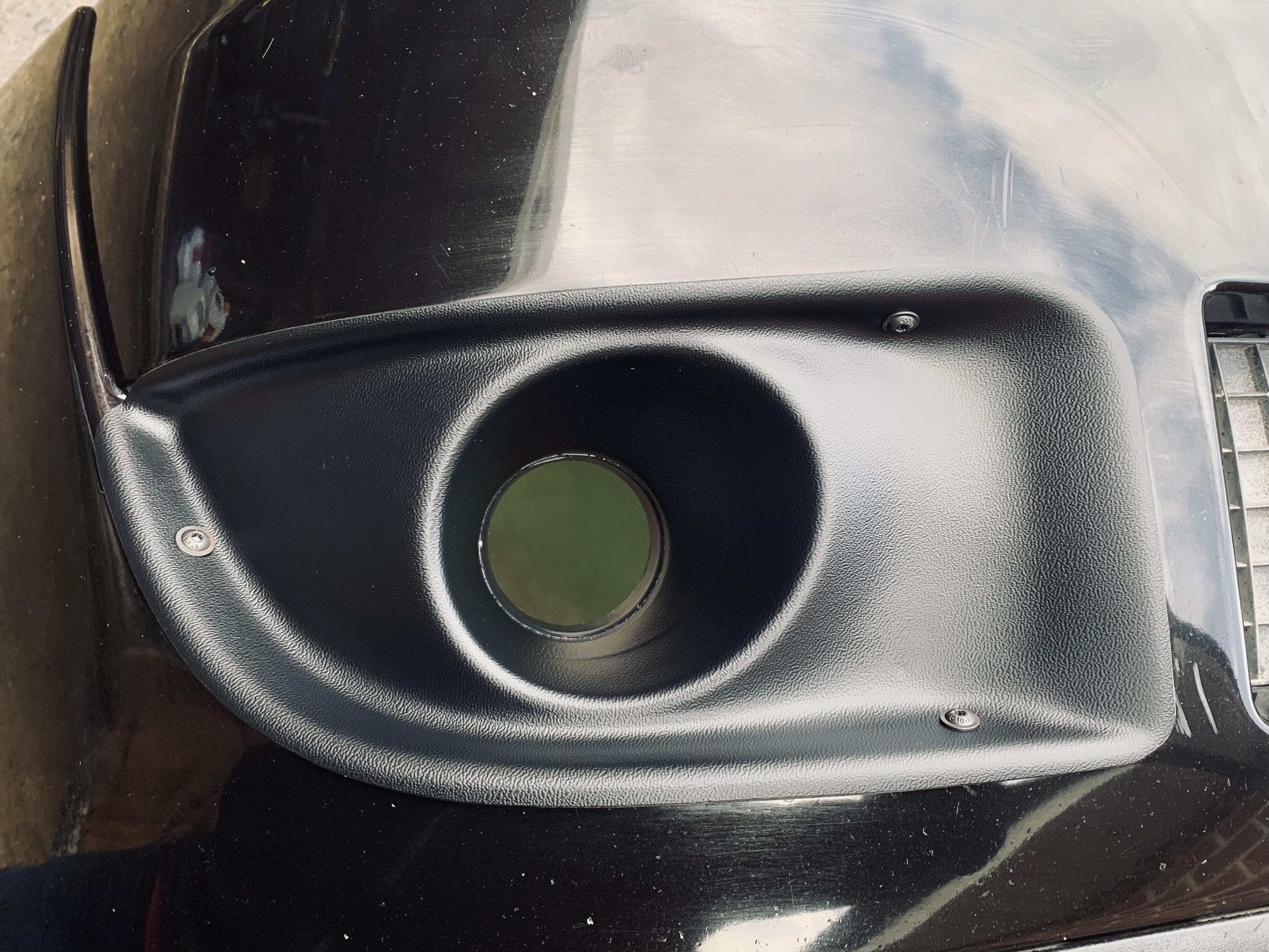

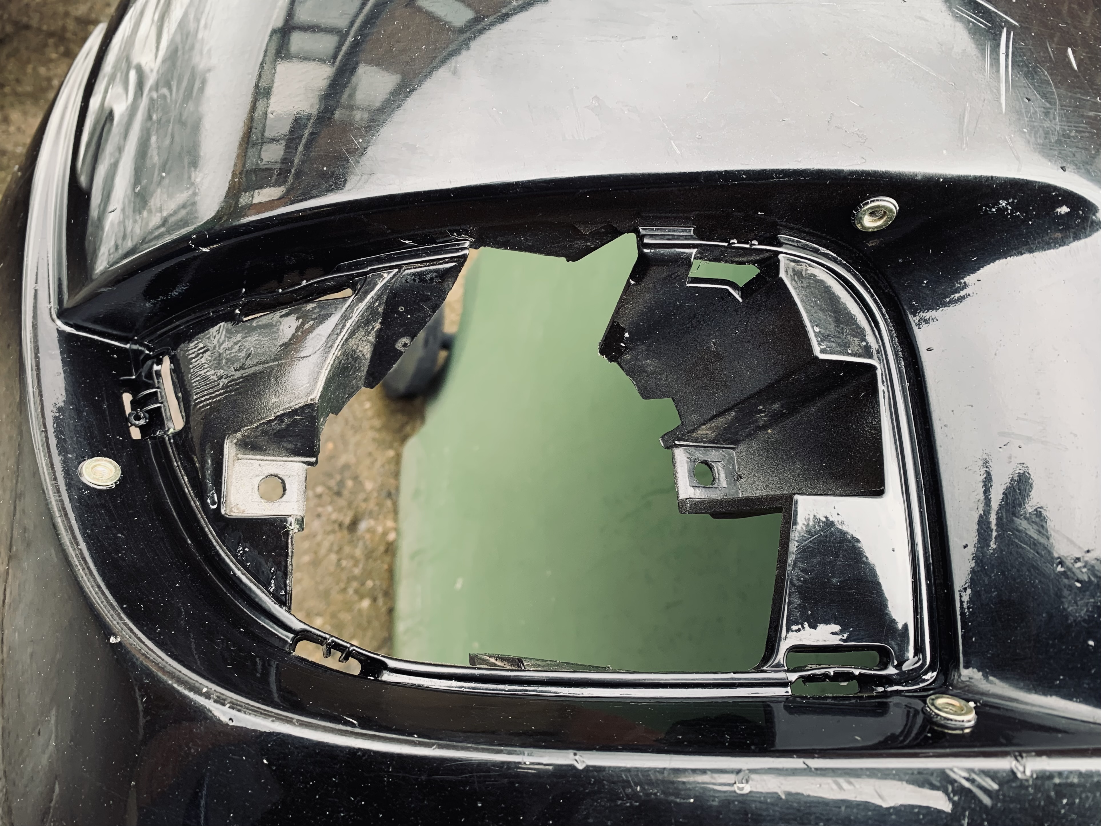

@Mr Underhill Remove the tape on the Bumper?. :)
Just there as a precaution as there’s a bit of wear on the quick release mechanism that holds the bumper on.
It causes the ends of the bumper to lift slightly and whilst I’m sure it’ll hold without the tape, I don’t want to be that guy who halts a trackday session if a Marshall thinks the bumper is falling off.
I always call the TDO over to discuss anything like this before hand, so if he’s happy, I’m happy.
Unfortunately the tabs inside the arch have been removed, so it’s not like I can put a u-clip in there and a bolt to secure it. I quite like the tape to be honest because #Trackcar

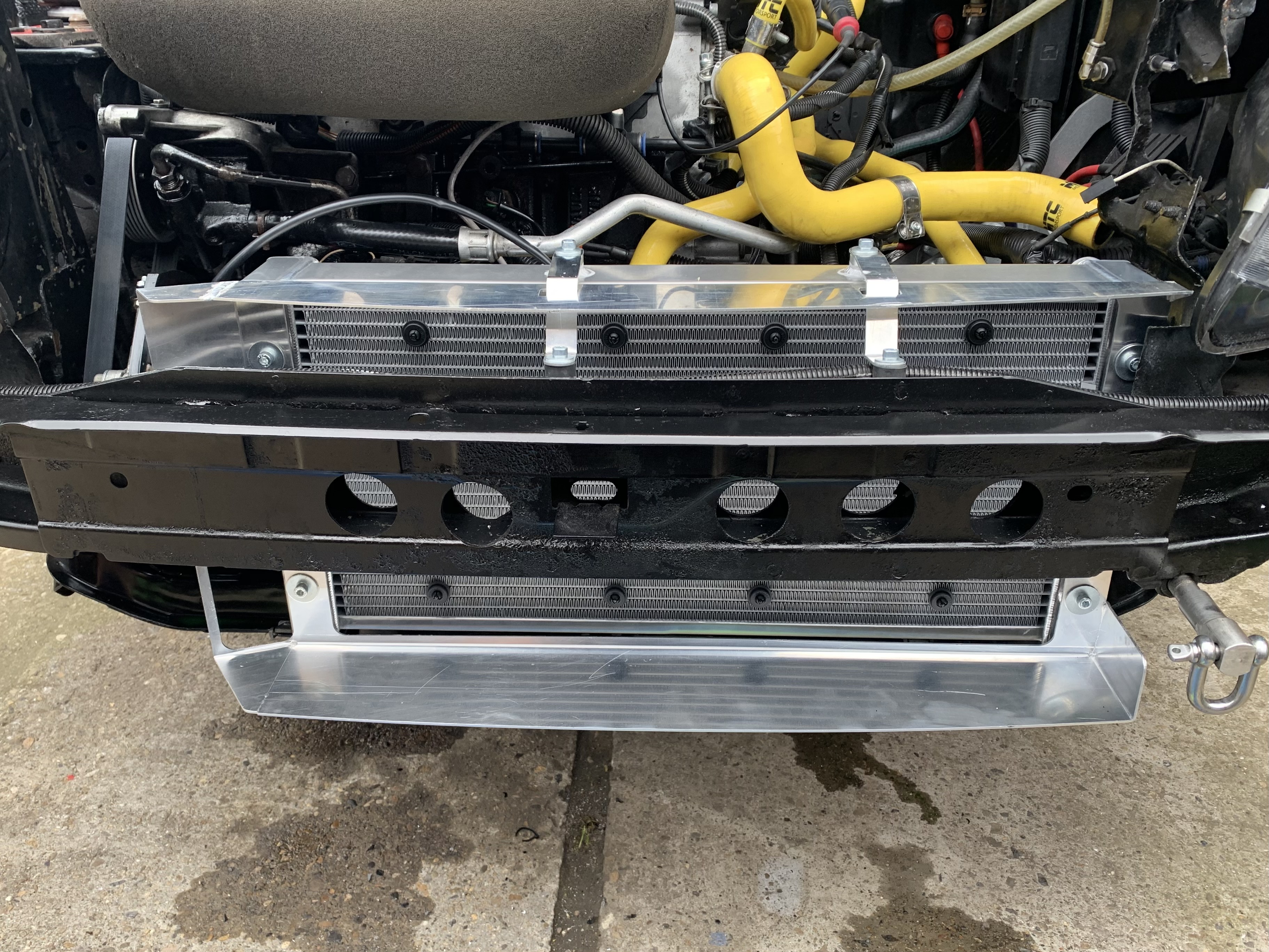

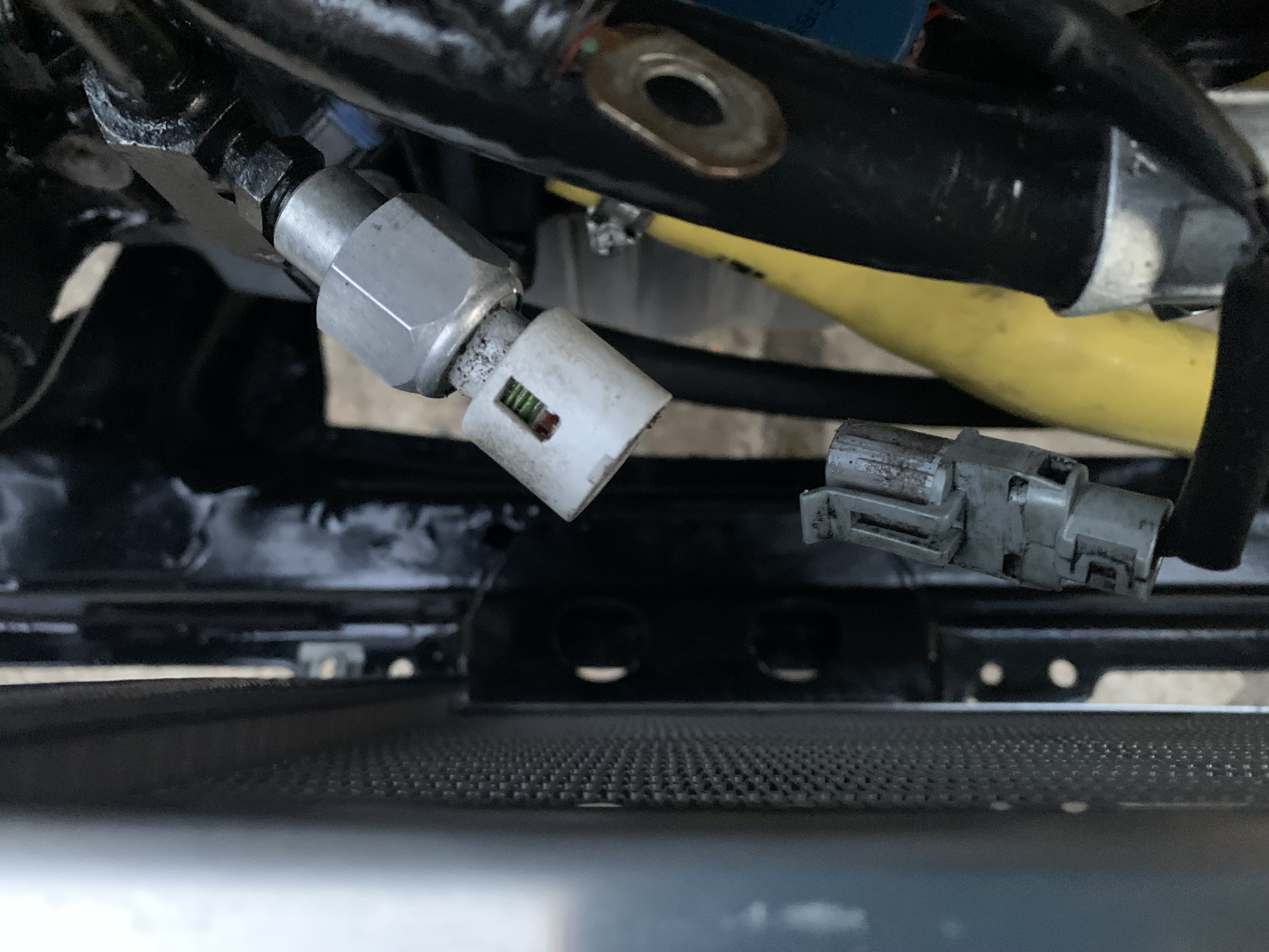

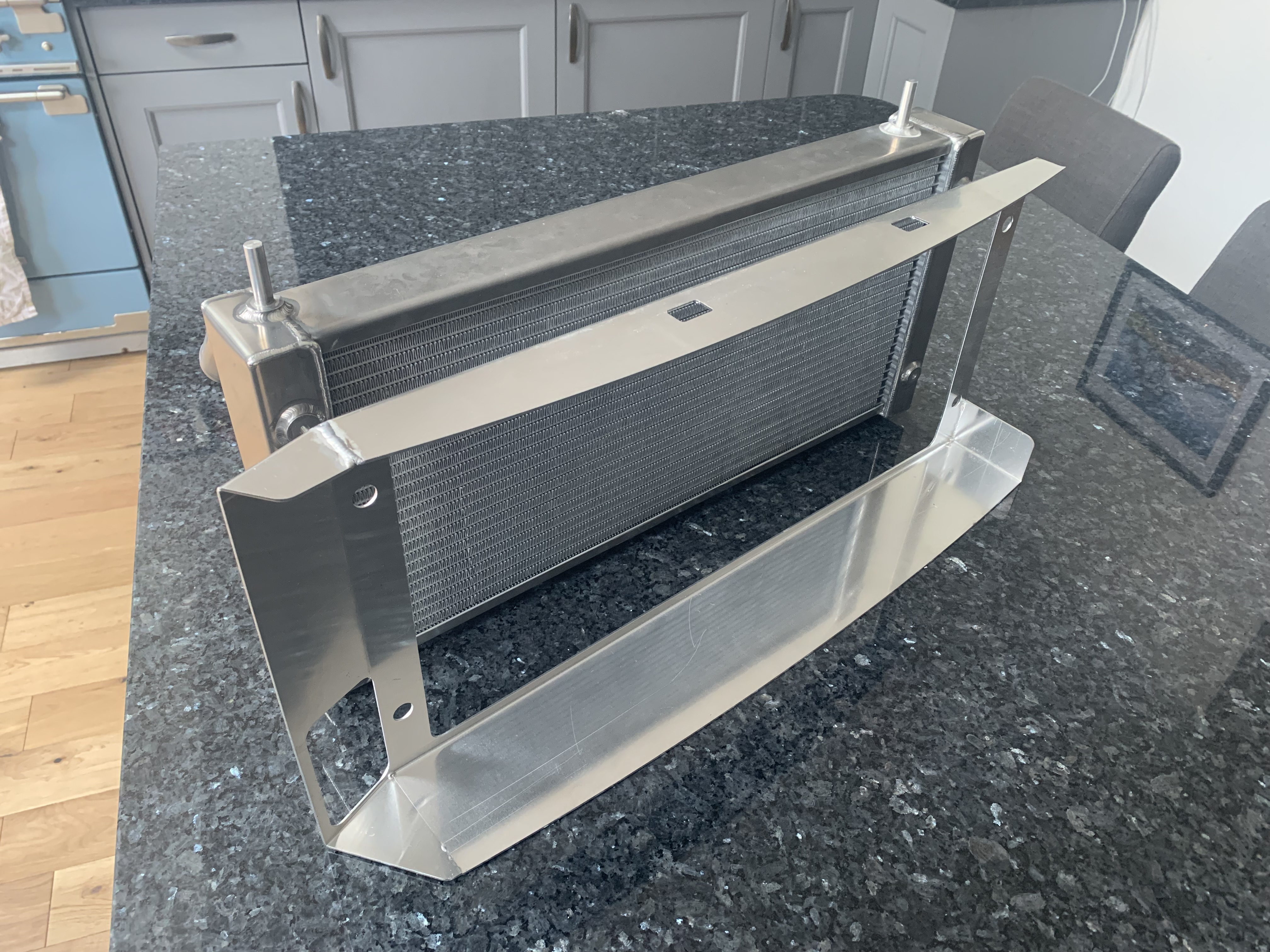

A bit of a mixed day. Spent the morning putting the 172 Cup delete kit on, but all the while I kept thinking it was going to be tight with my new radiator.

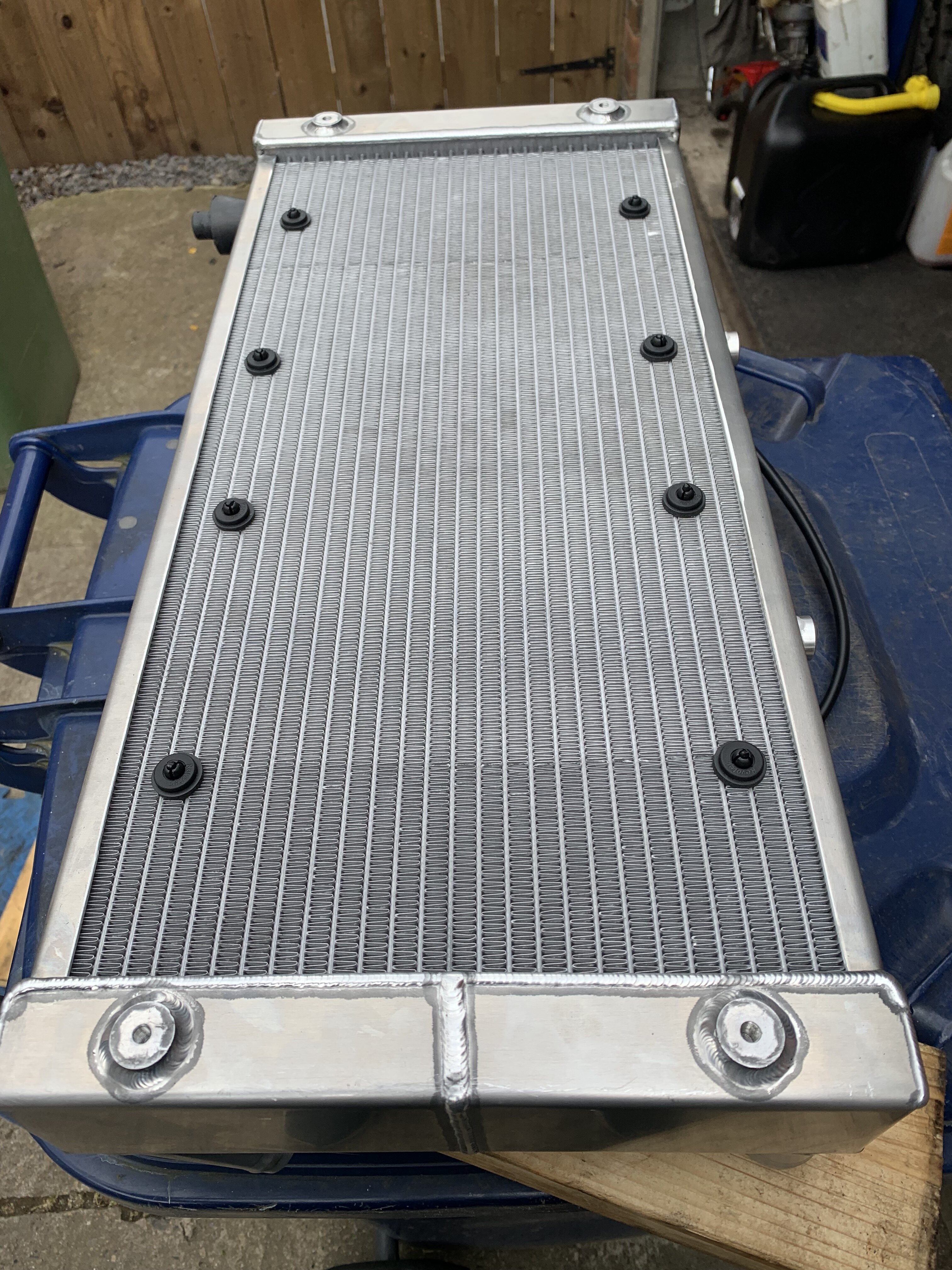

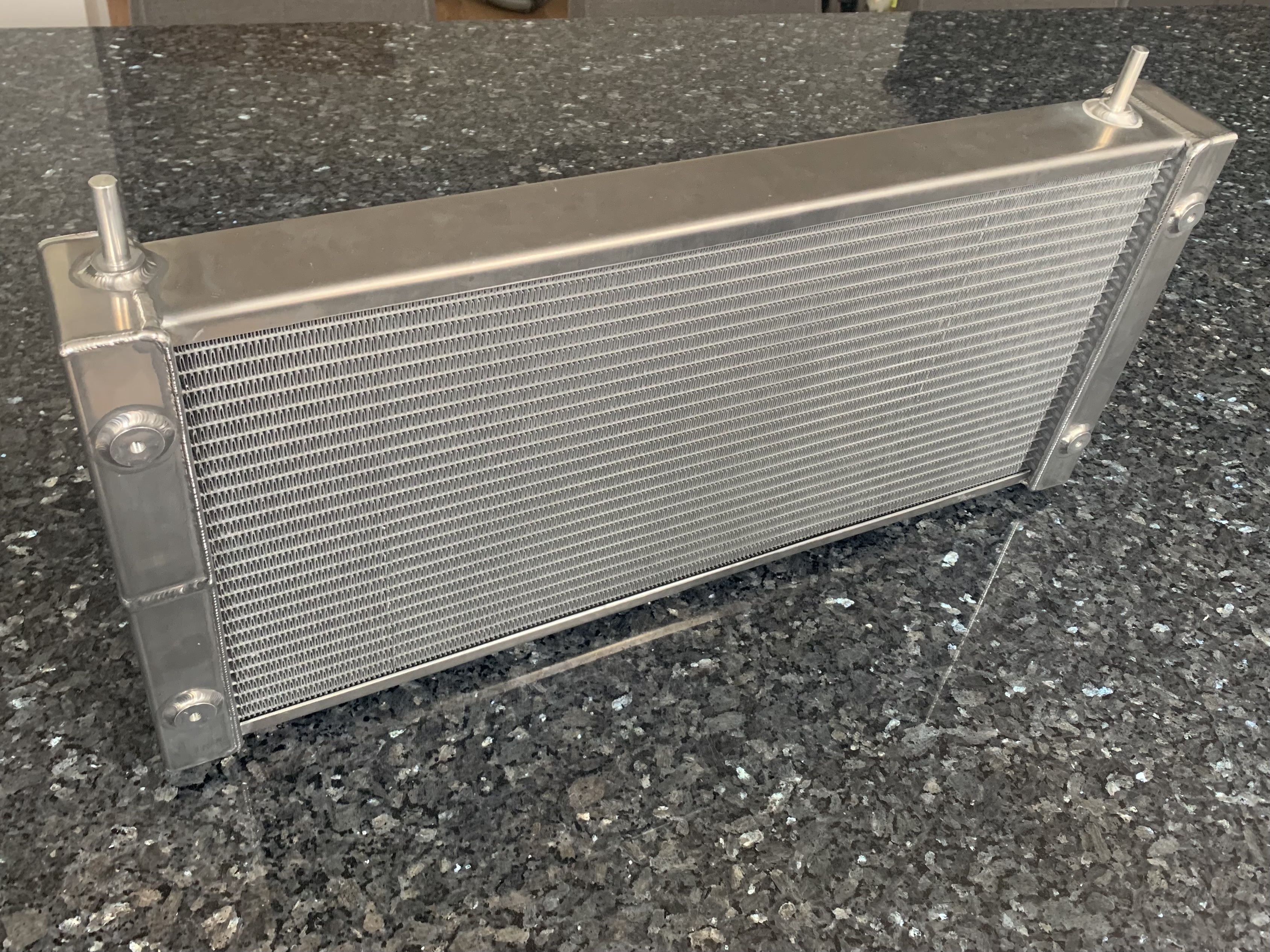

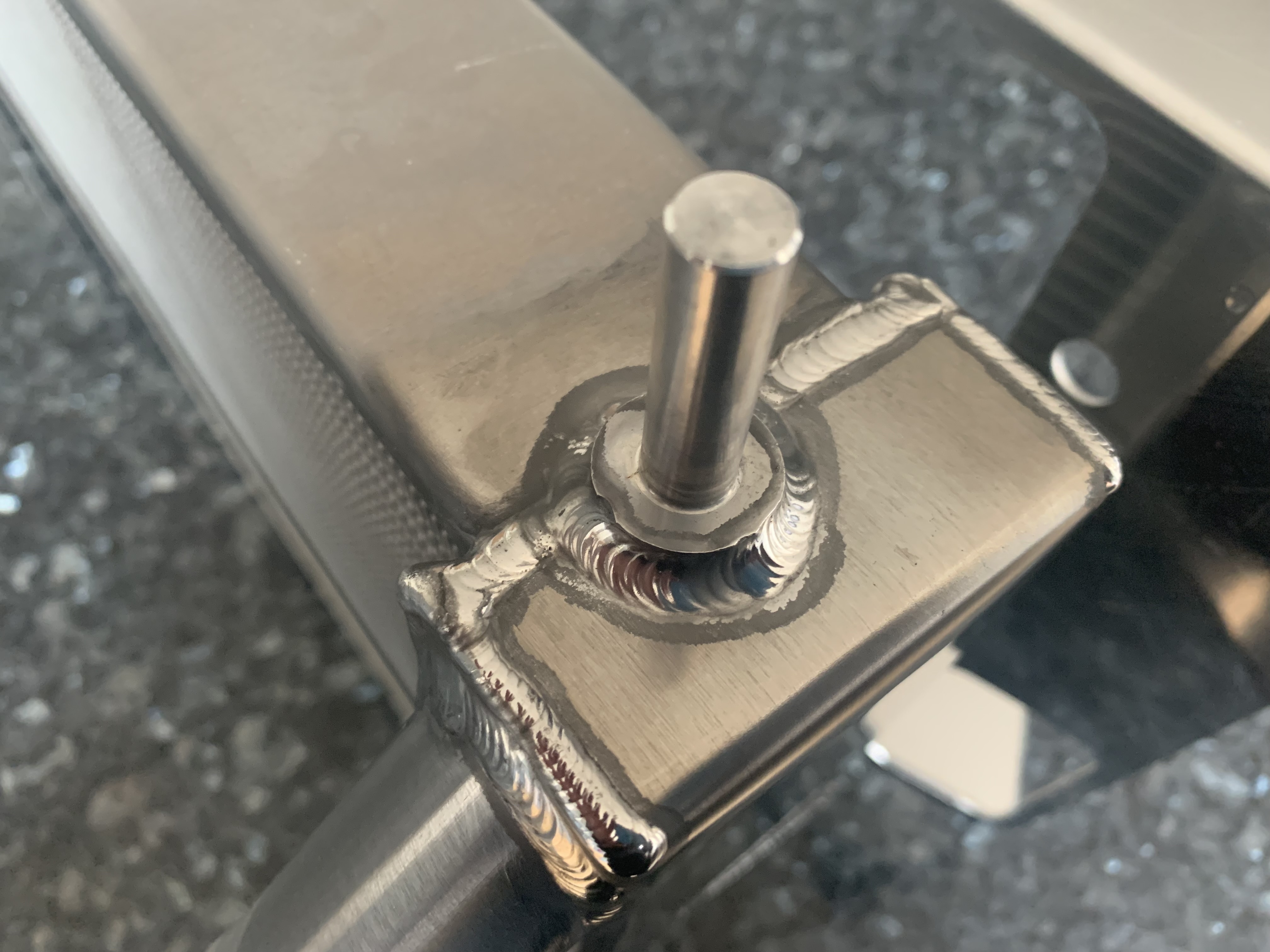

I went for a fabricated Aluminium rad from Pure Motorsport. Tis a thing of beauty 😍
Began cutting out some of the metal to make it fit and damn, the pas pipe and bracket get in the way.
It’s not out by much, an inch or so.
Even if I get a custom high pressure pipe made, I’ll still need to cut a chunk out of the bracket, which isn’t an option I want to take.
Oh well, these things are sent to try us. Tools down, hot bath and a cup of tea me thinks.

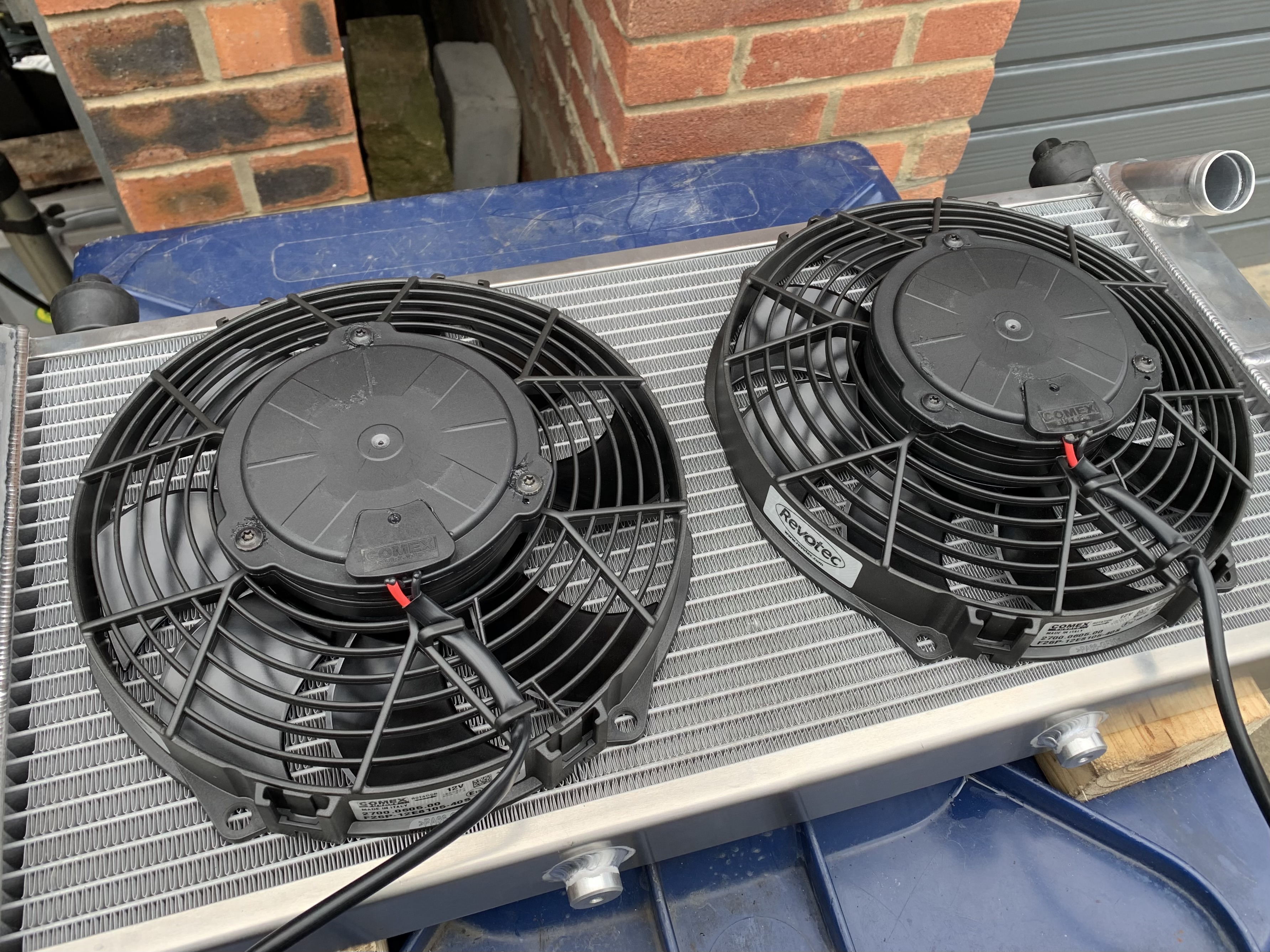

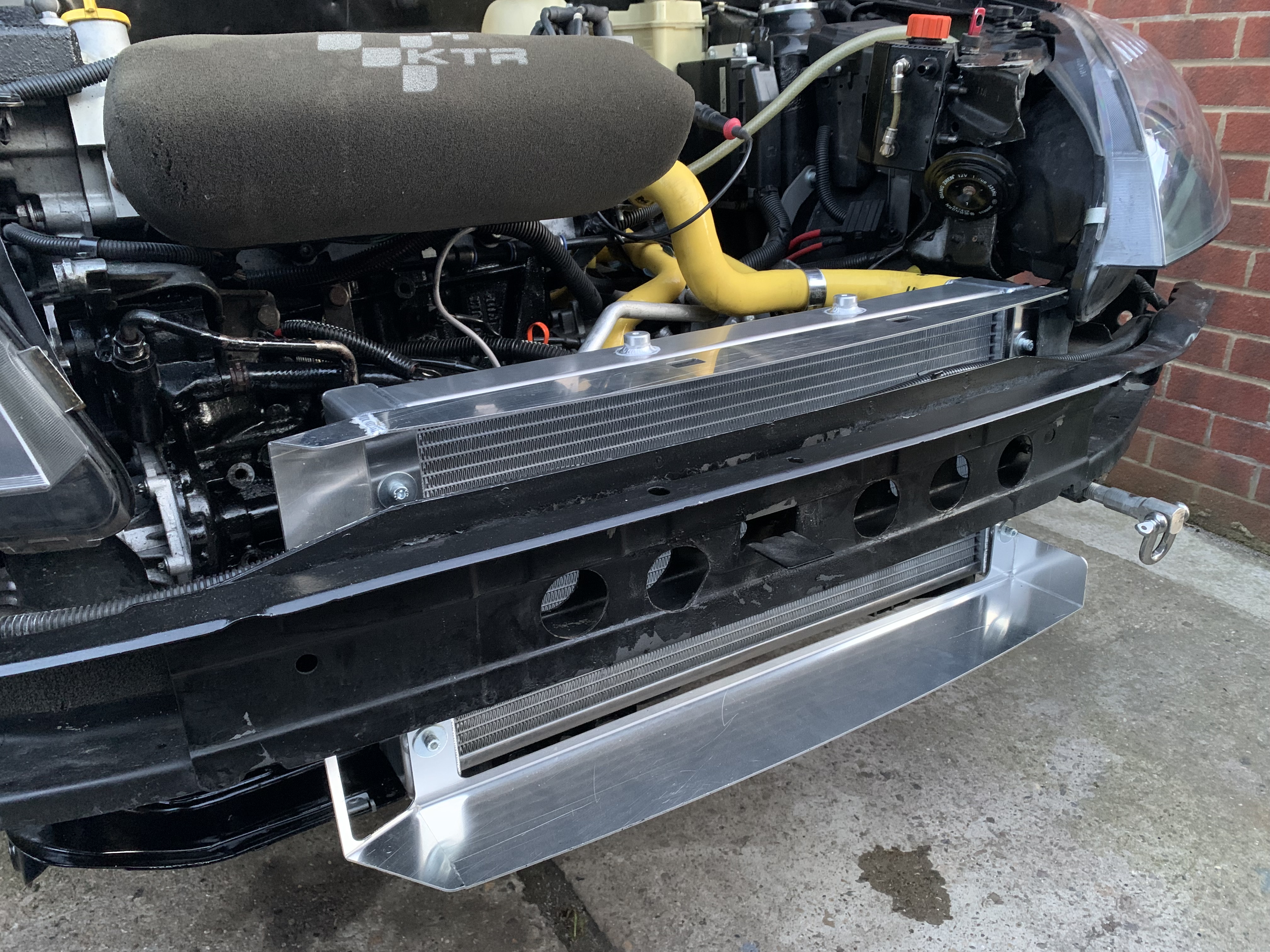

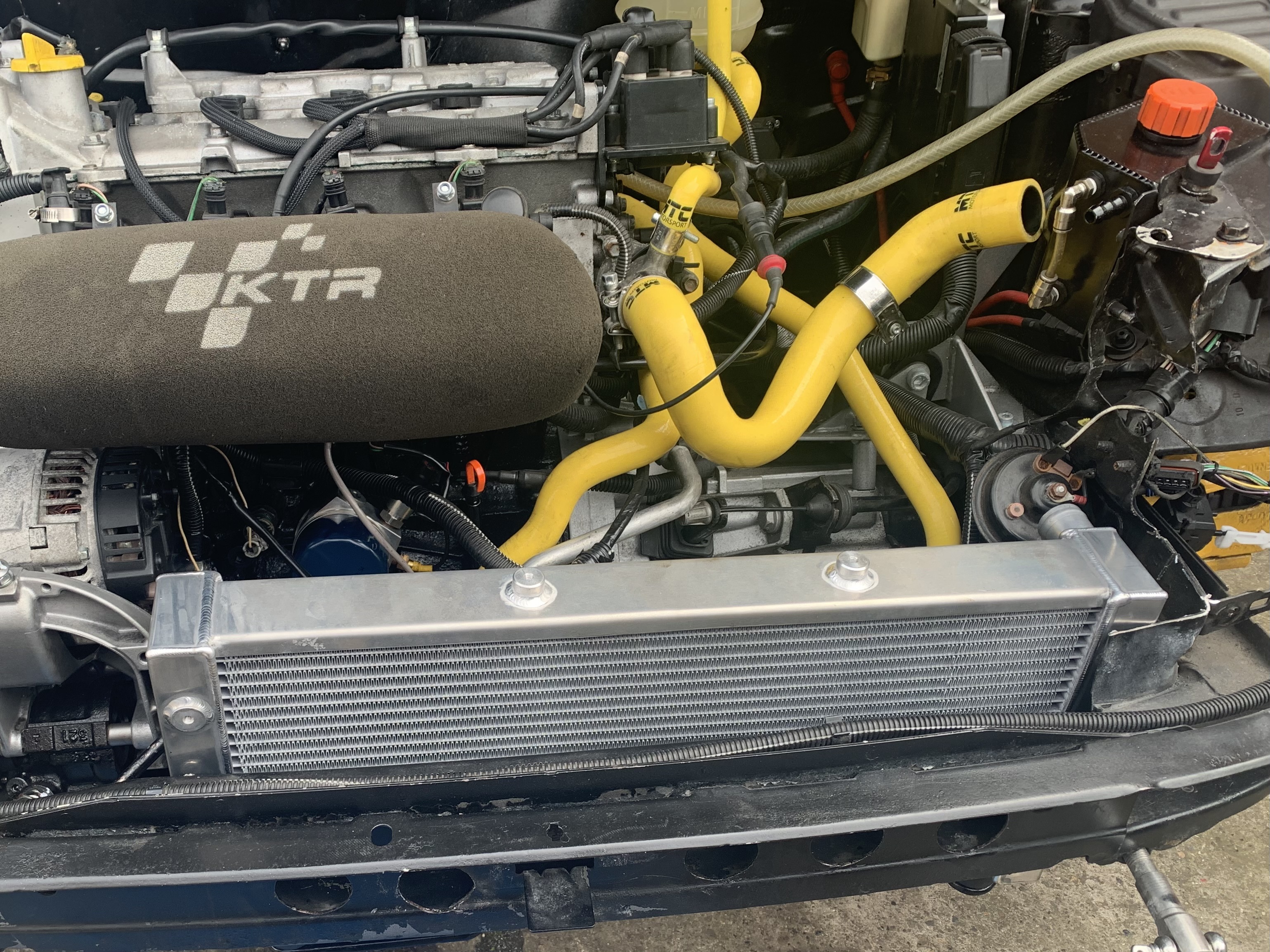

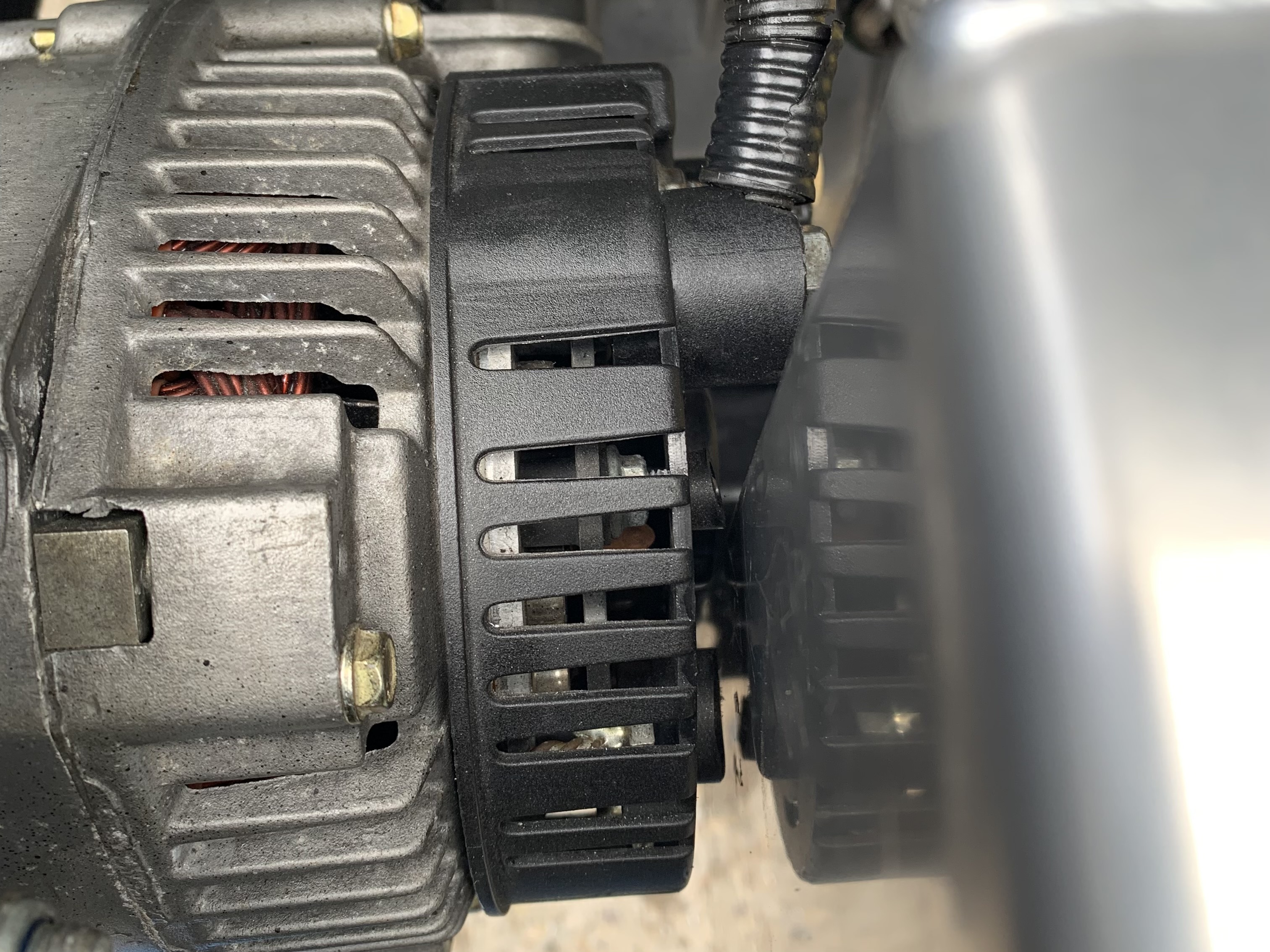

Managed an hour tonight - finally no rain.

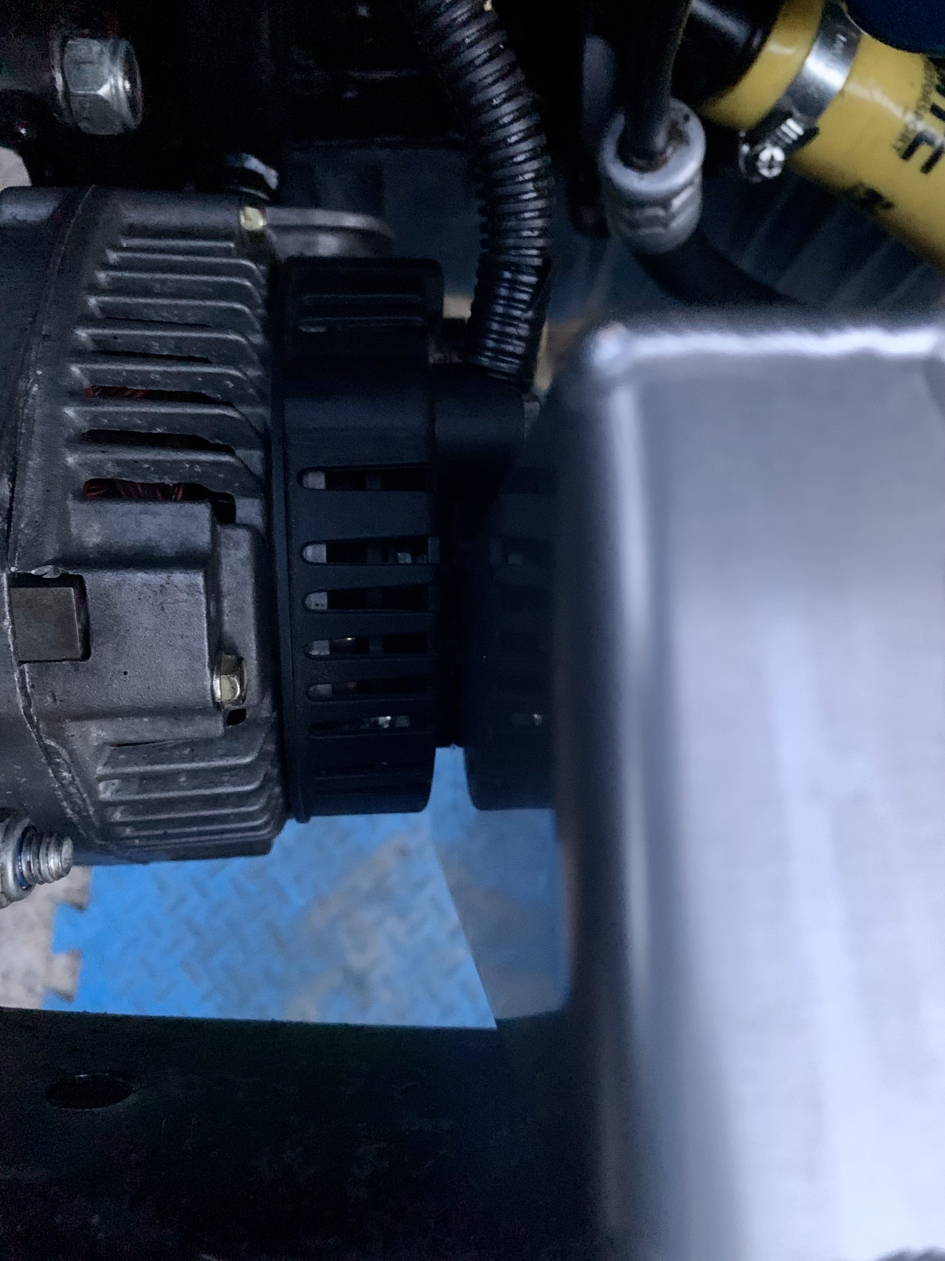

Whipped the Cup delete kit off - probably won’t be needing that now - and attached the power steering pump to the original upper bracket. Then mocked the radiator up with the Schroud.
It looks the dogs but it’s going to be tight with twin 9 inch fans and the alternator in.
A bit of gentle persuasion is going to be required 🔨 me thinks.

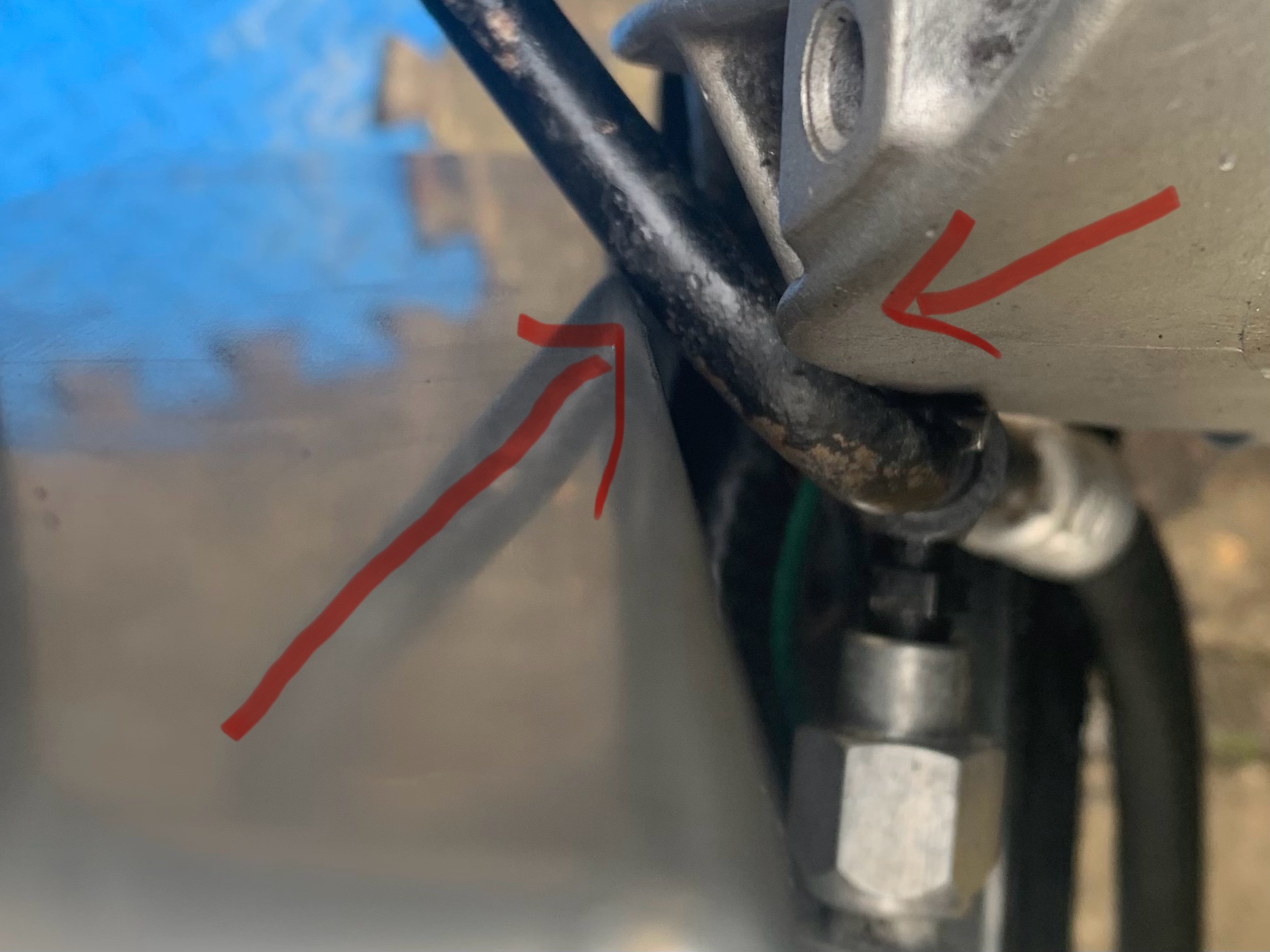

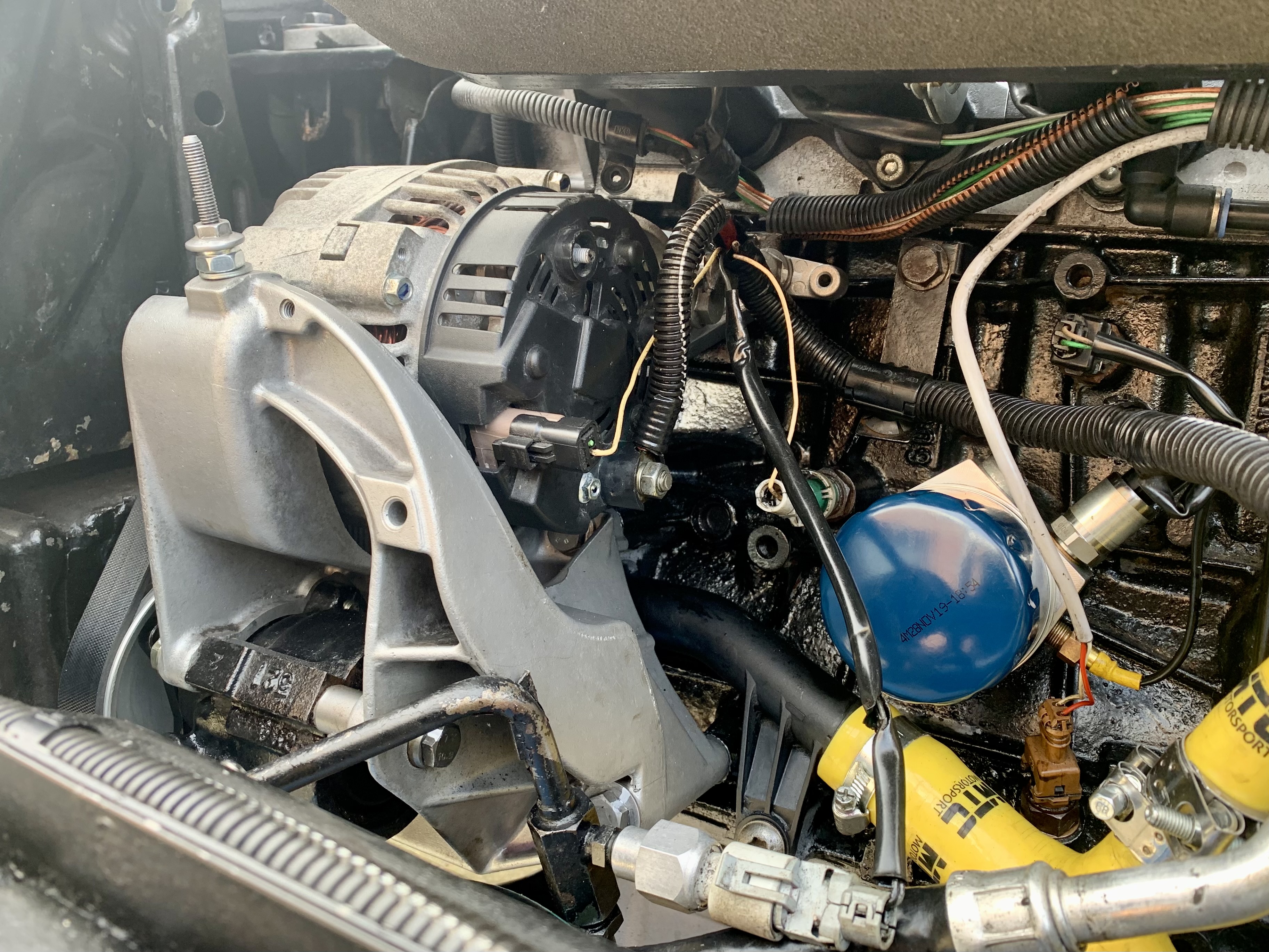

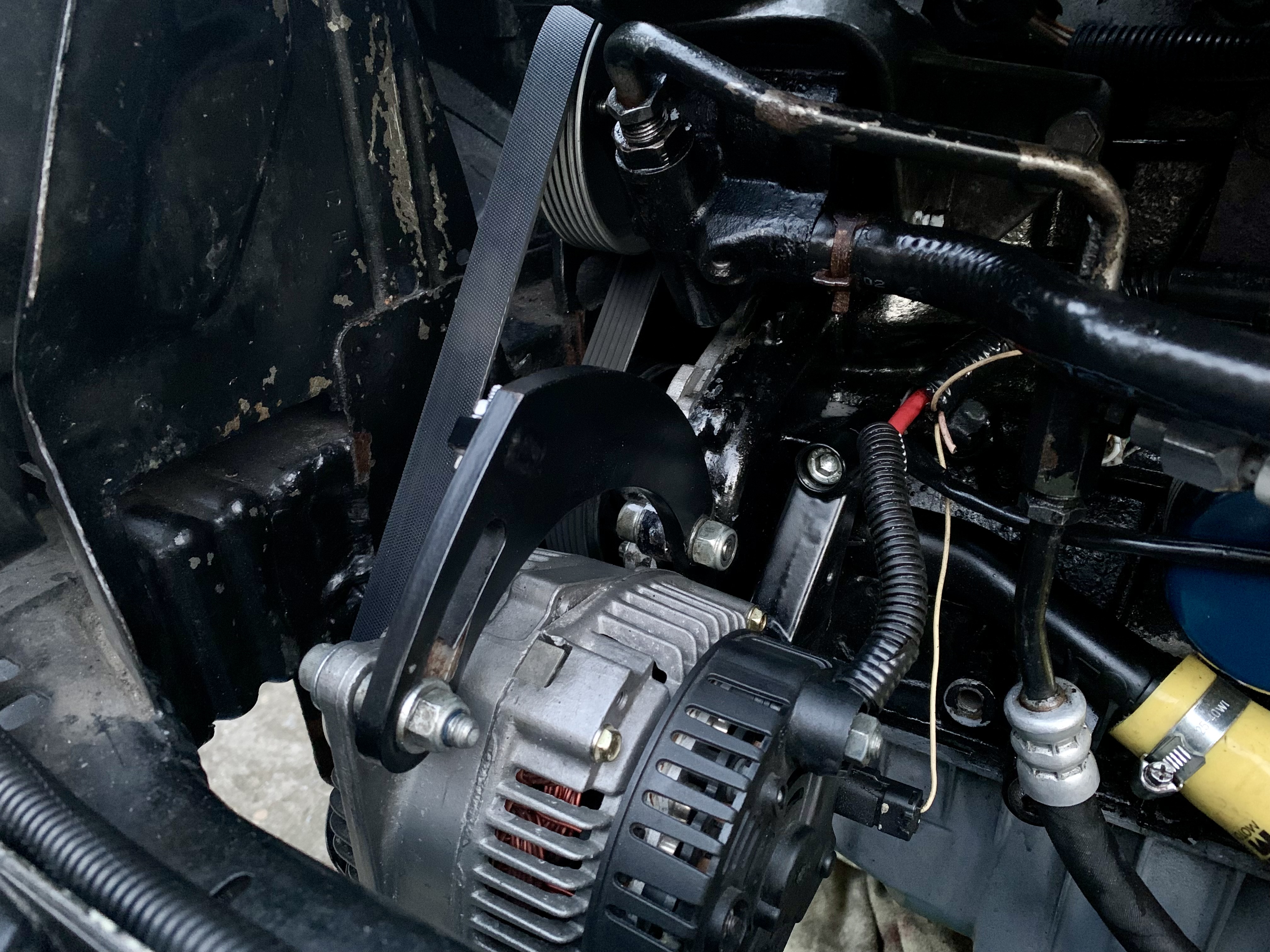

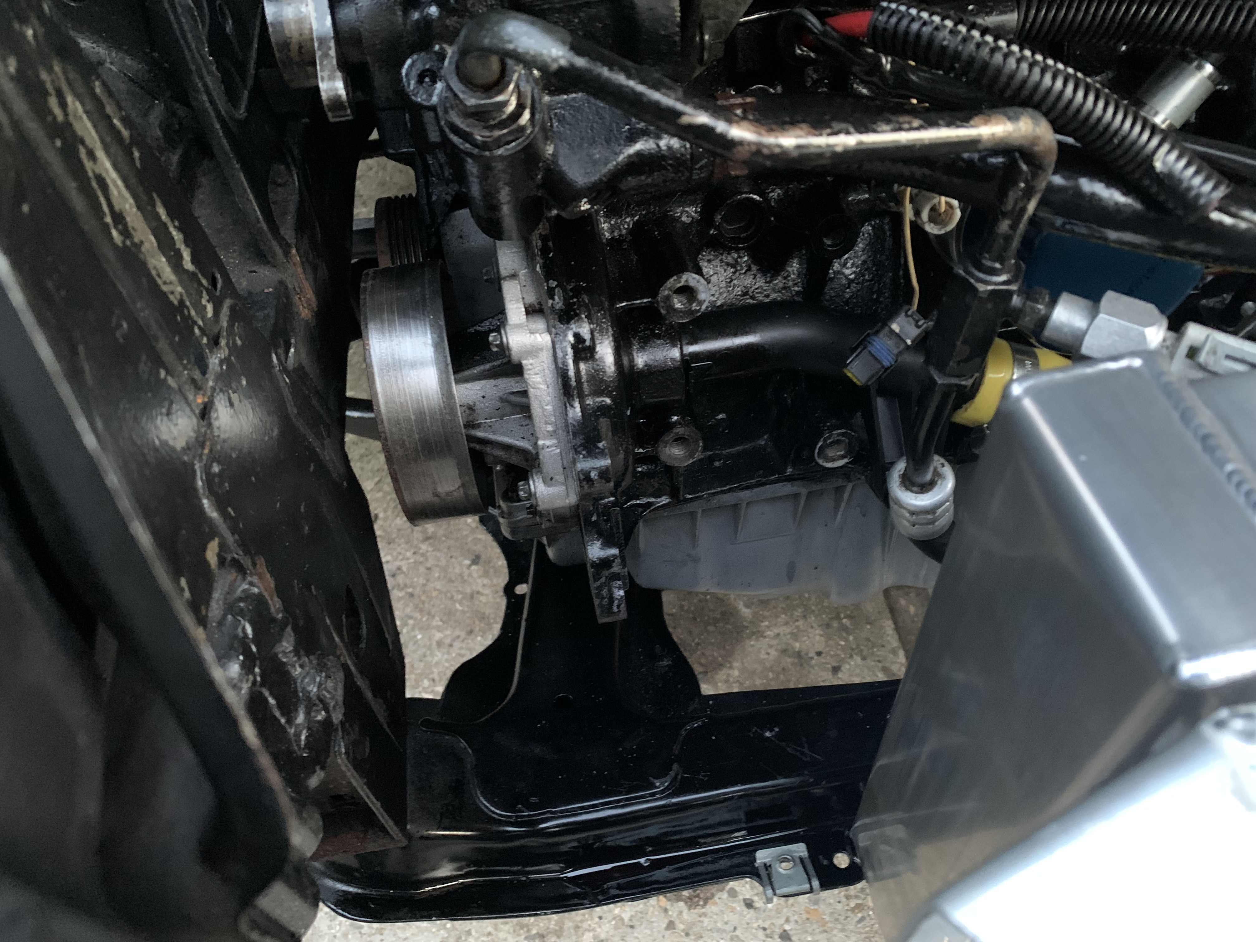

Another fight tonight, but I think I’ve got the better of it.
Put the other delete kit back on with new belt and moved the PAS pipes further back to allow for fans.
Next problem is getting the radiator to seat properly on the subframe.
As you can see it’s tight.
Too tight! 🖕🏻🖕🏻🖕🏻
I’ll just ream the holes a few mm and we’ll be good to go.

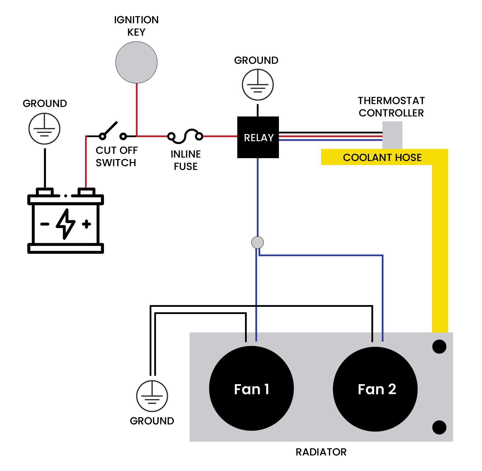

Last job was to plan the fan and thermostat controller wiring, so took to photoshop and mocked up a schematic.
Should all come together this weekend 🤞🏻

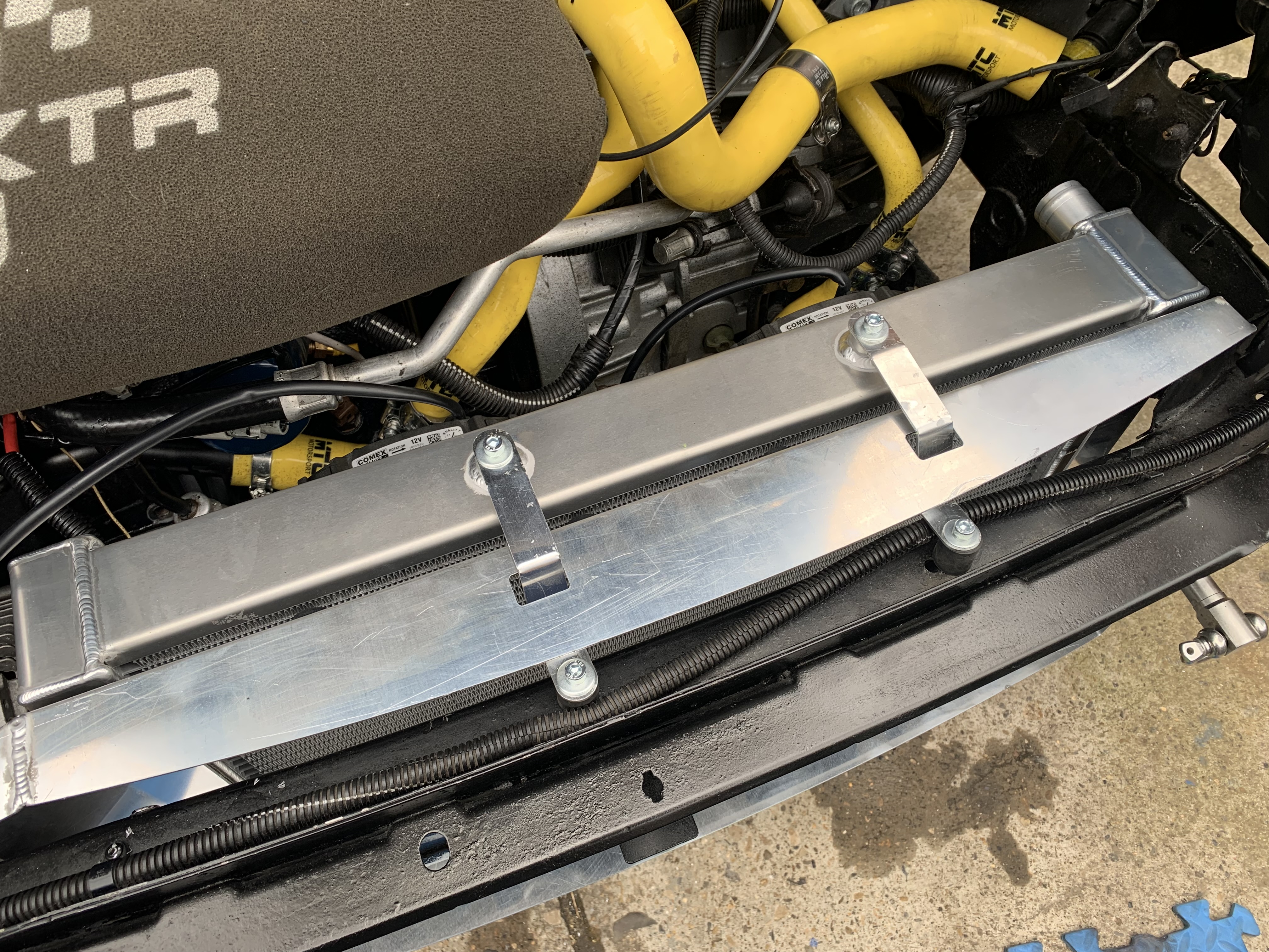

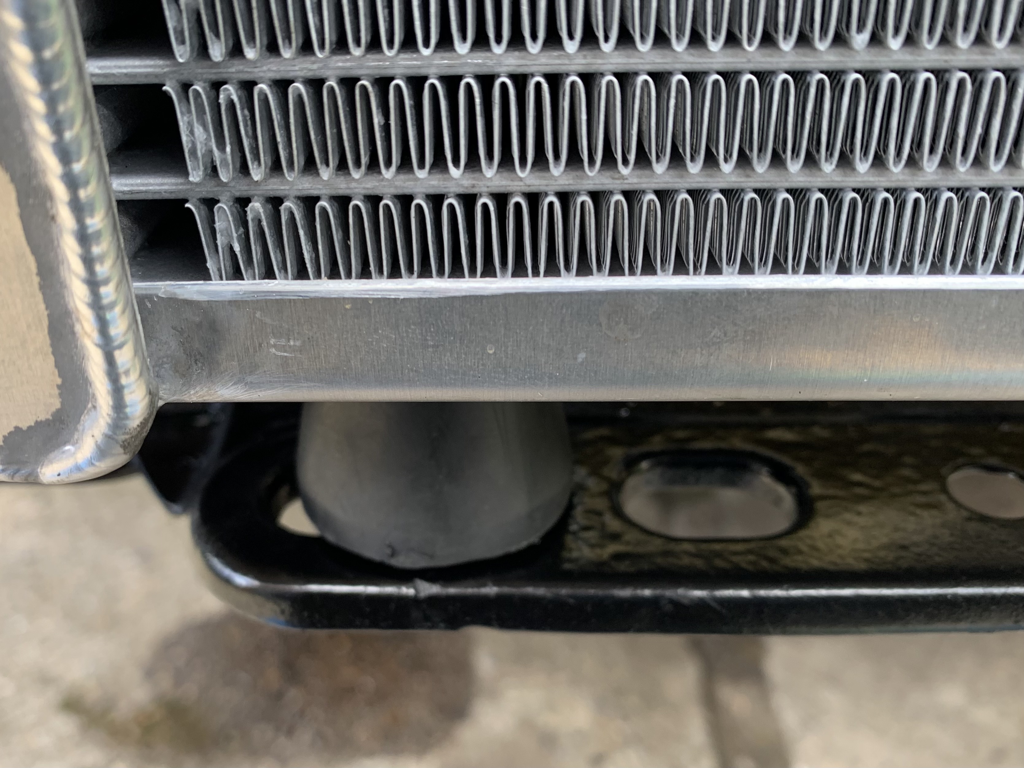

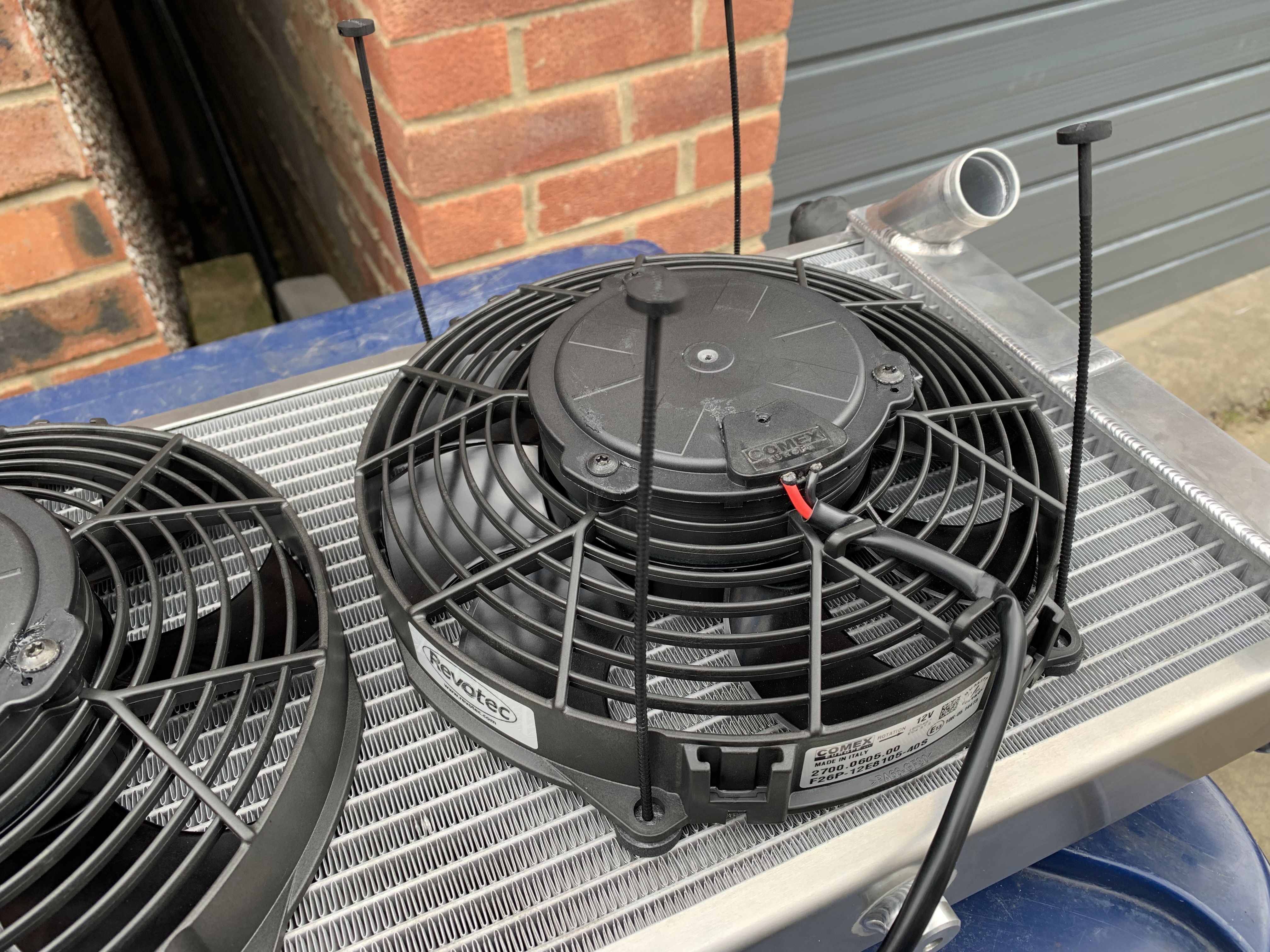

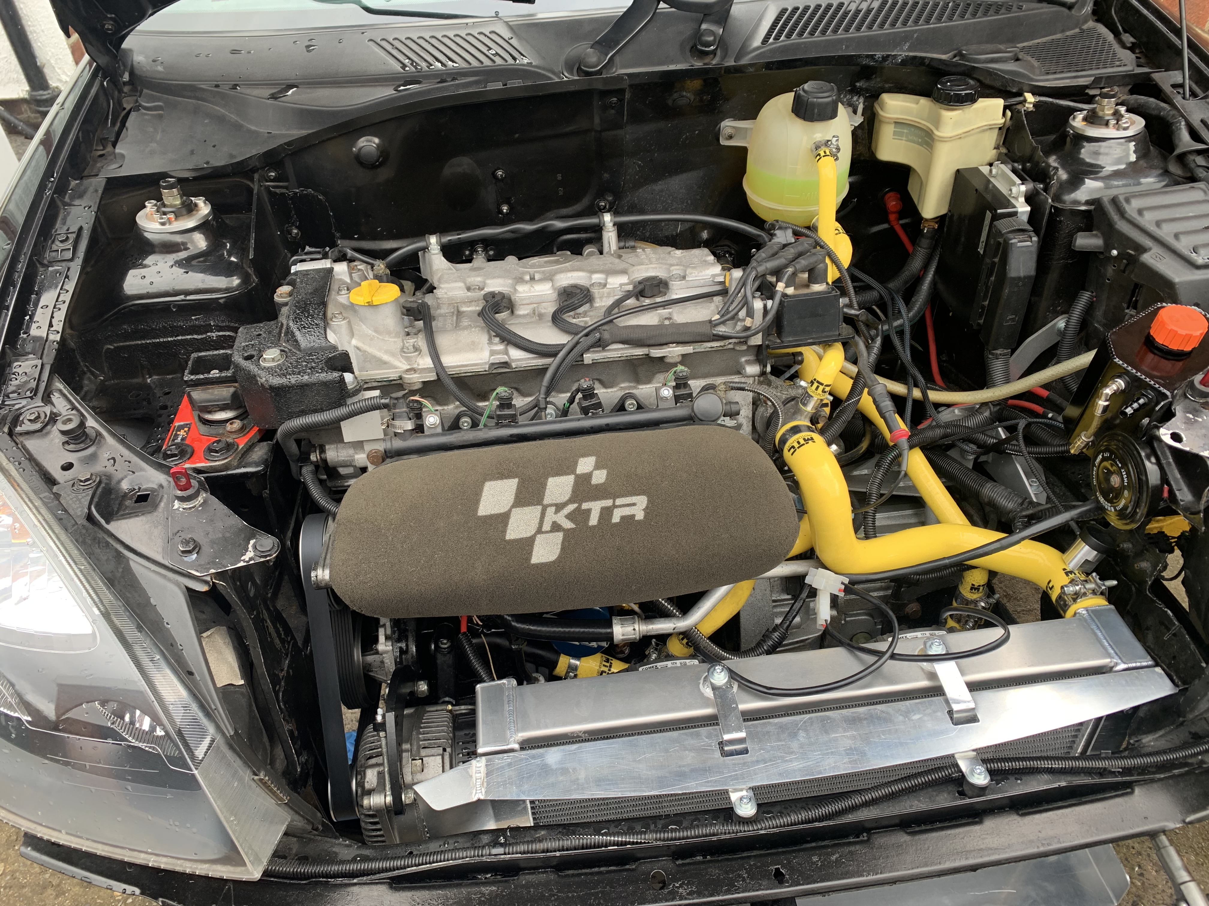

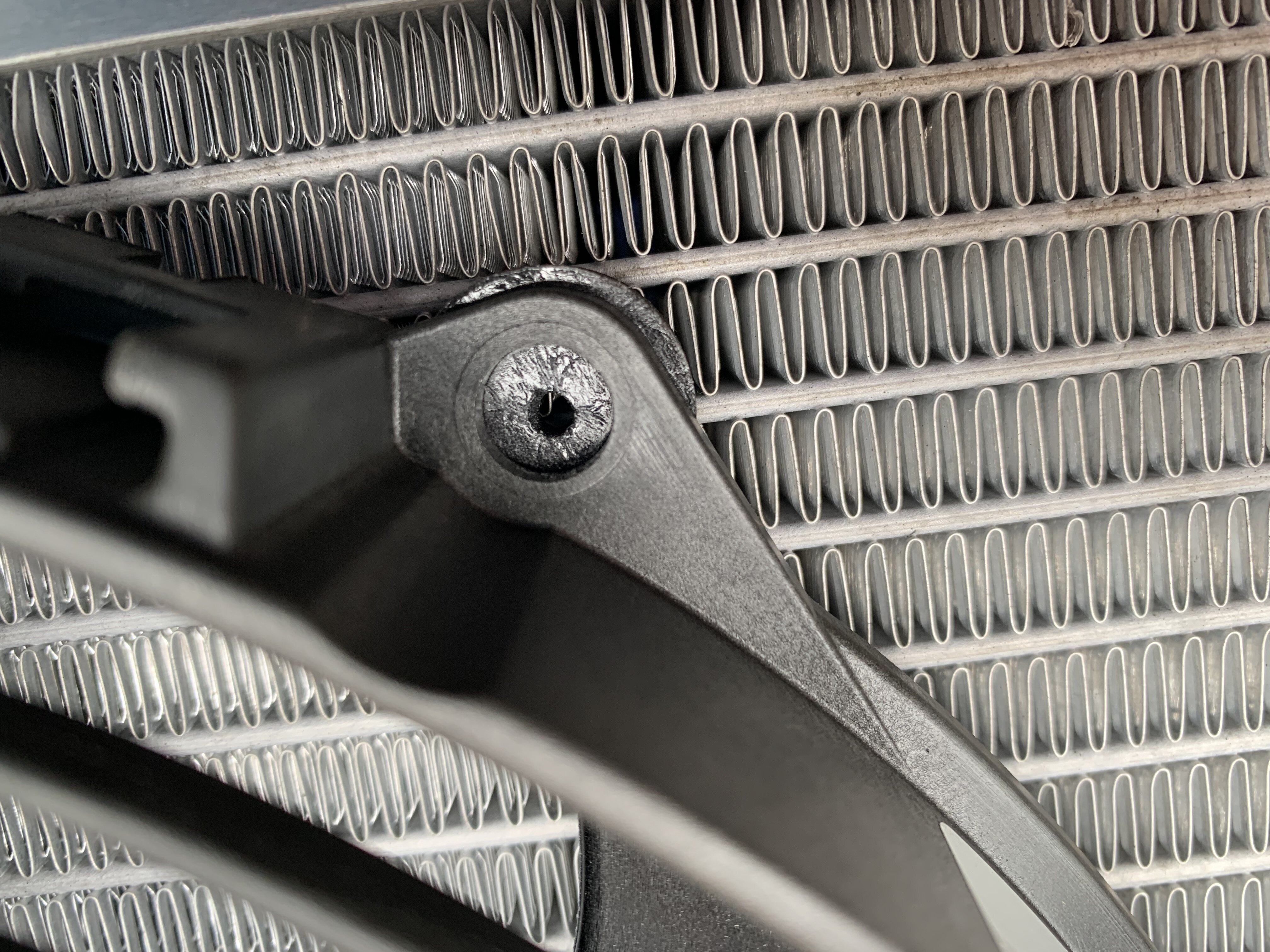

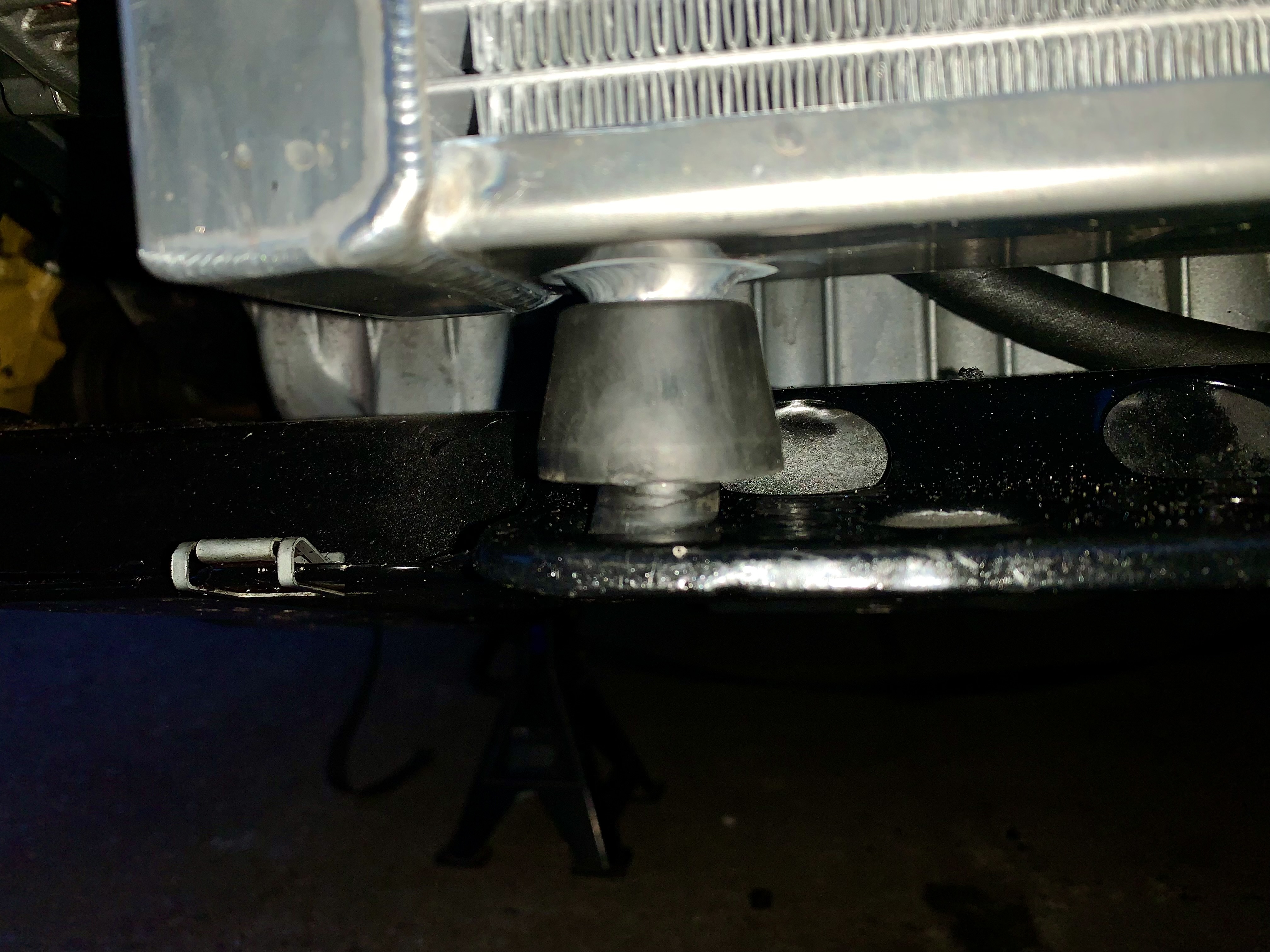

s**t weather again but it wasn’t going to stop me getting this radiator in.
Cut a few cms from the subframe allowing the radiator to go to the right.
This freed up the space I needed between the rad and alternator. This should be part of the installation instructions.

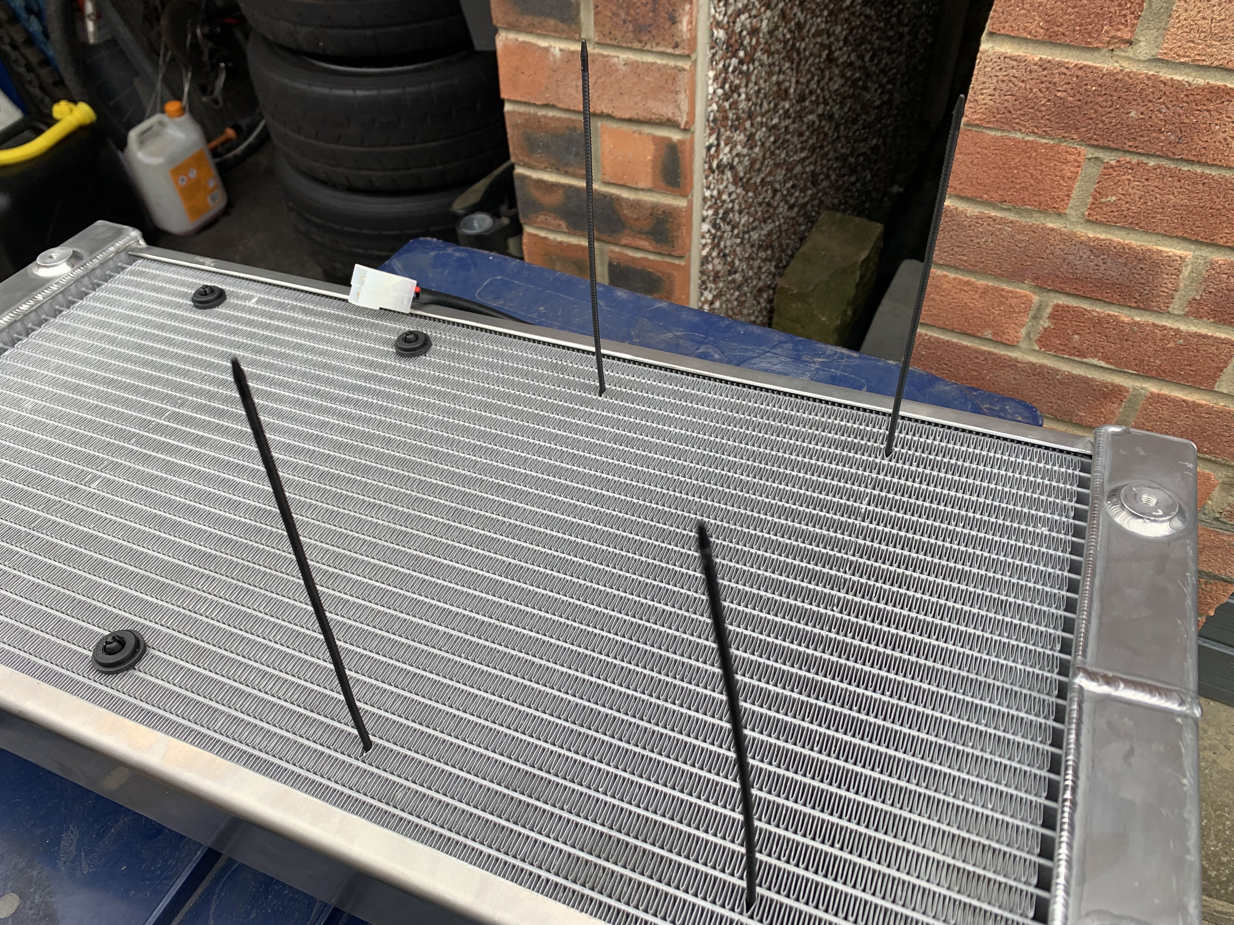

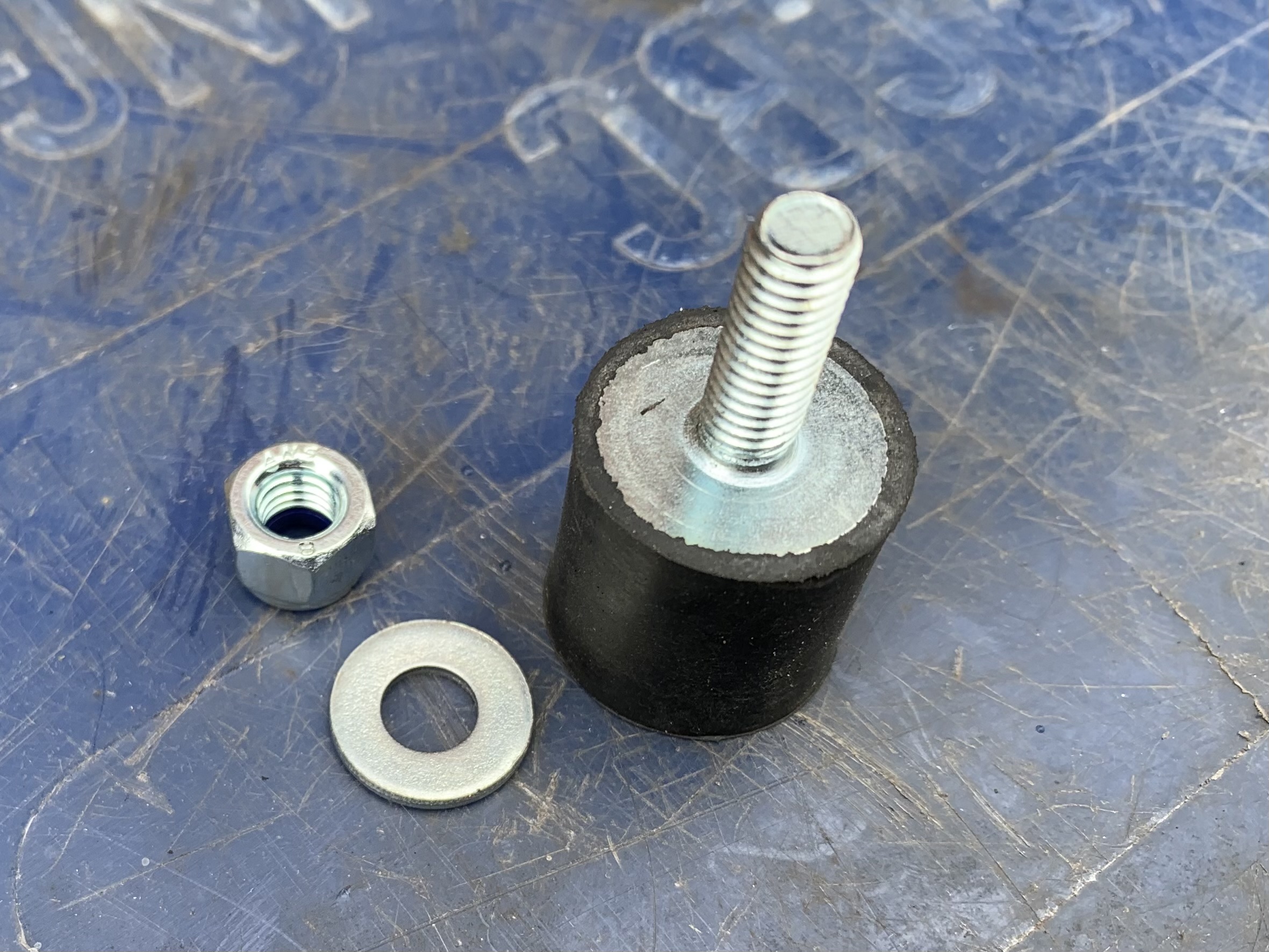

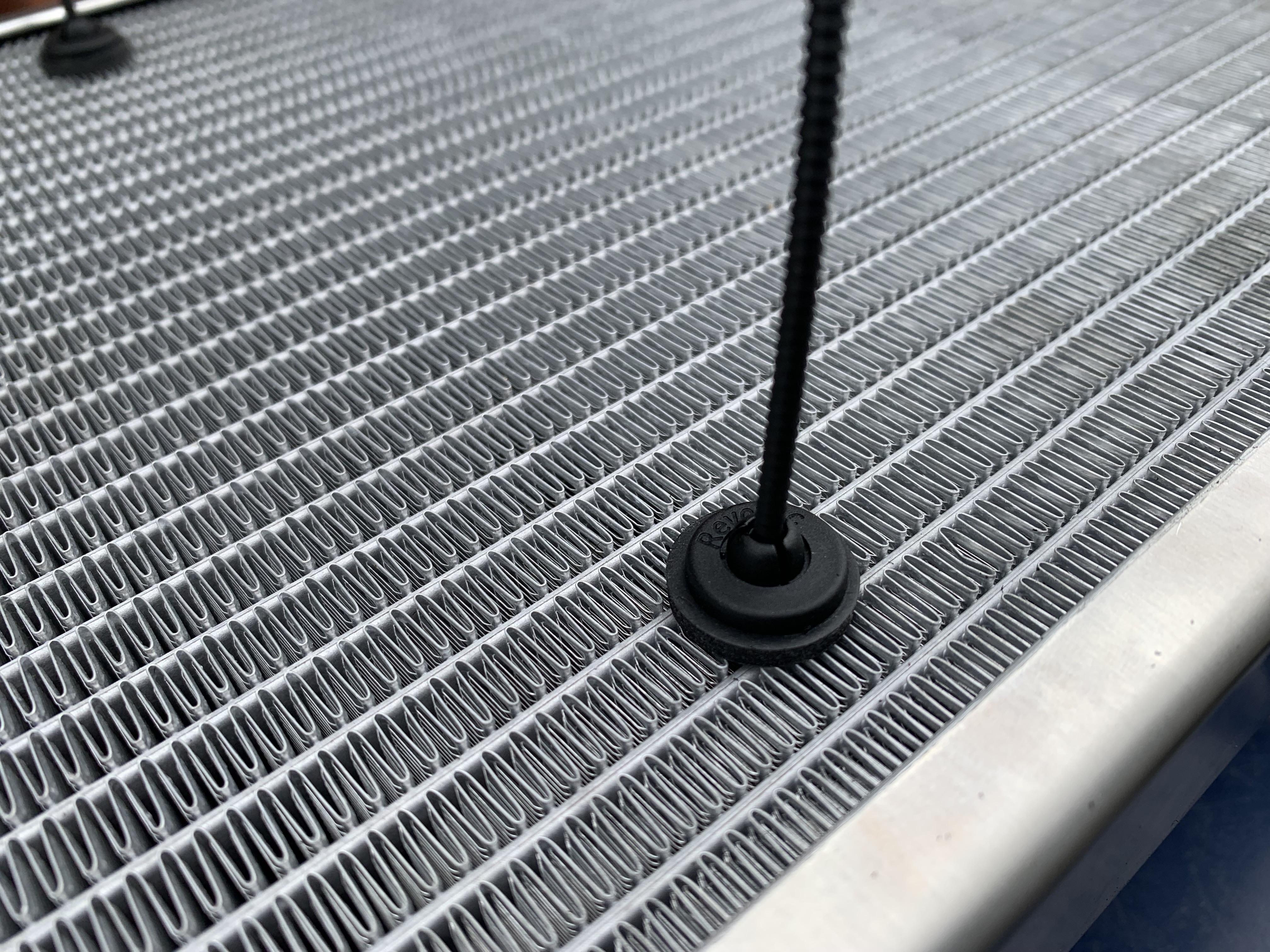

Lined the fans up and pushed through the cables. I put them near the top of the main structure for added support, as I noticed in the old radiator it was moving around and was loose.
One job finished.

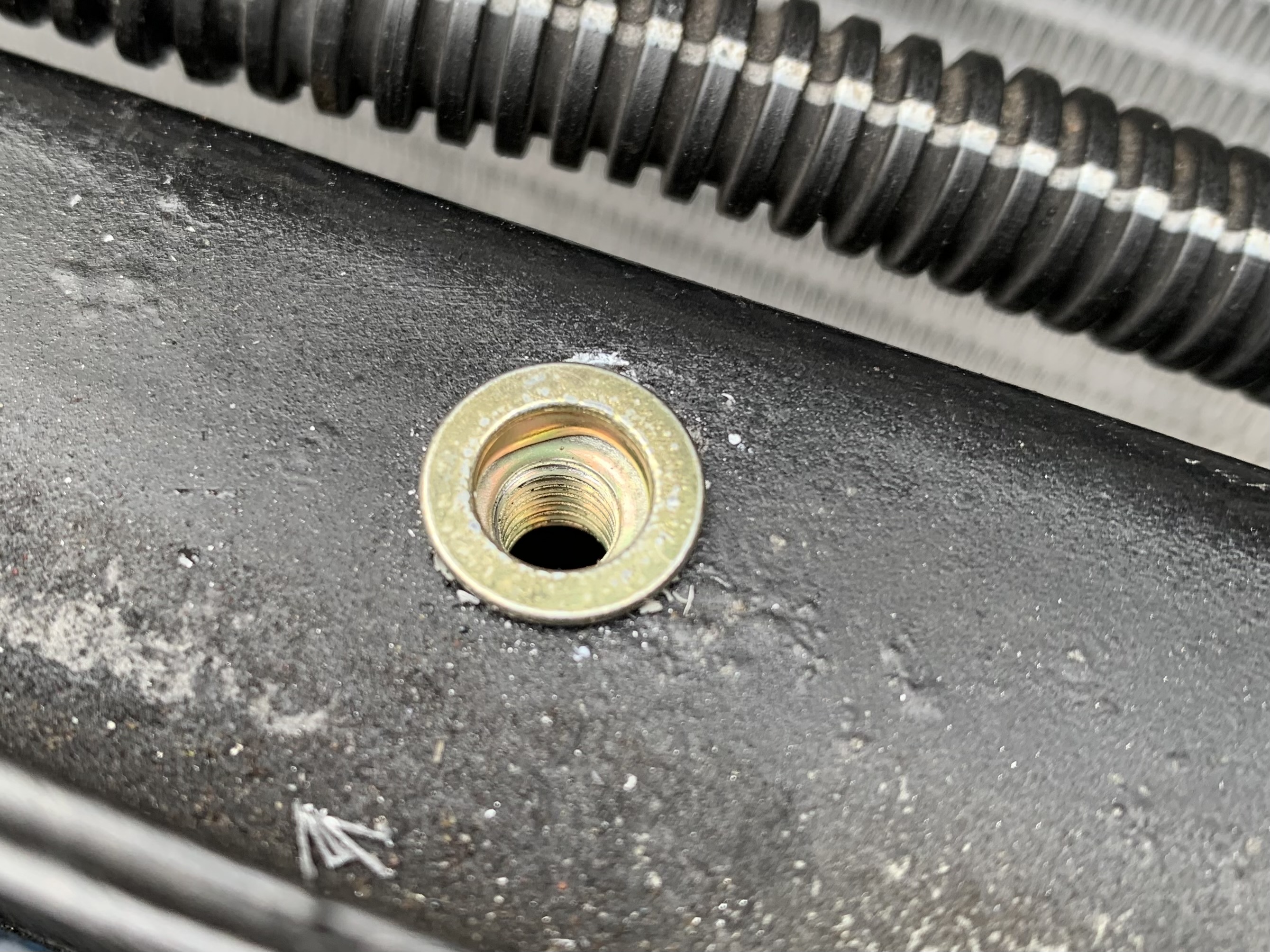

The kit comes with bobbins which you can secure with a nut and washer - provided you’ve cut some holes in the front that is - but it seemed chewy so went for Rivnuts instead.
Cont……

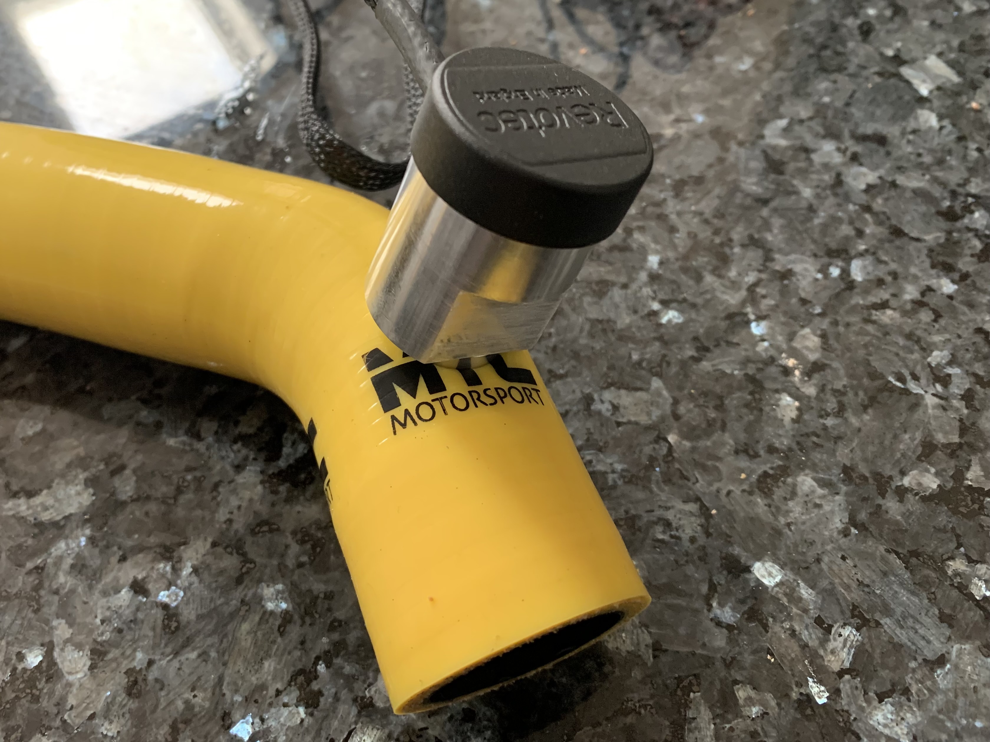

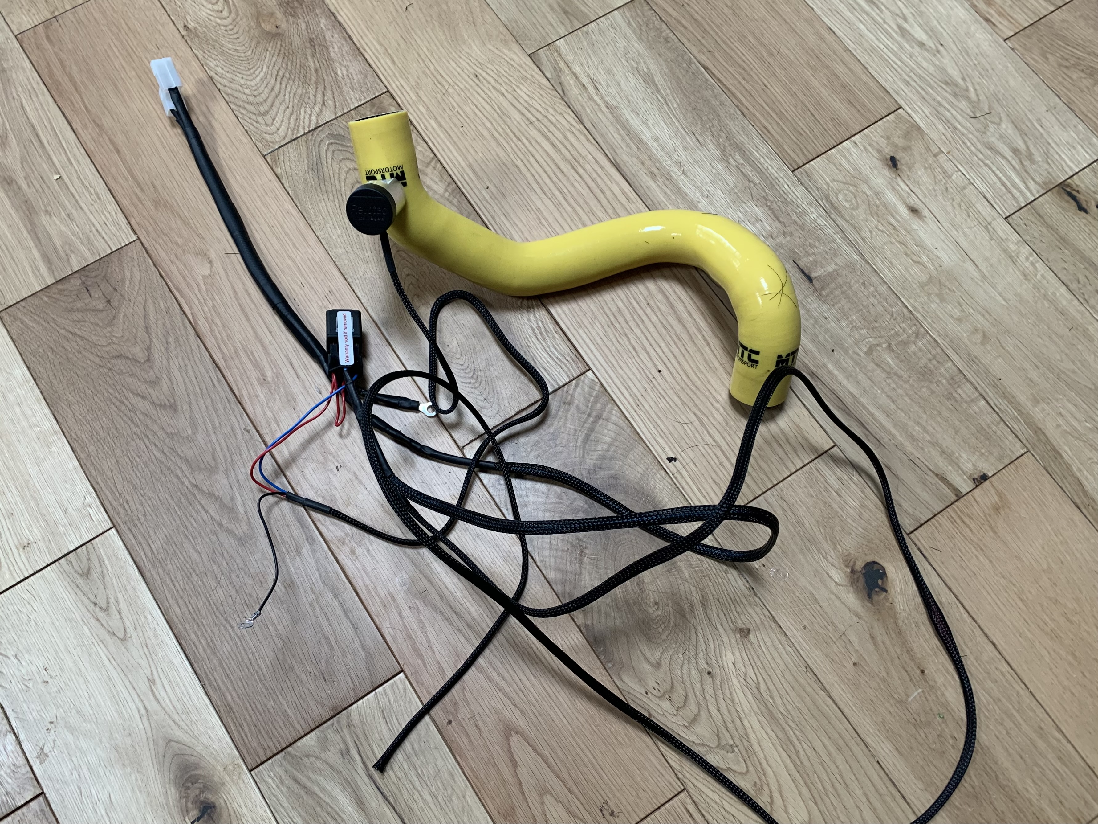

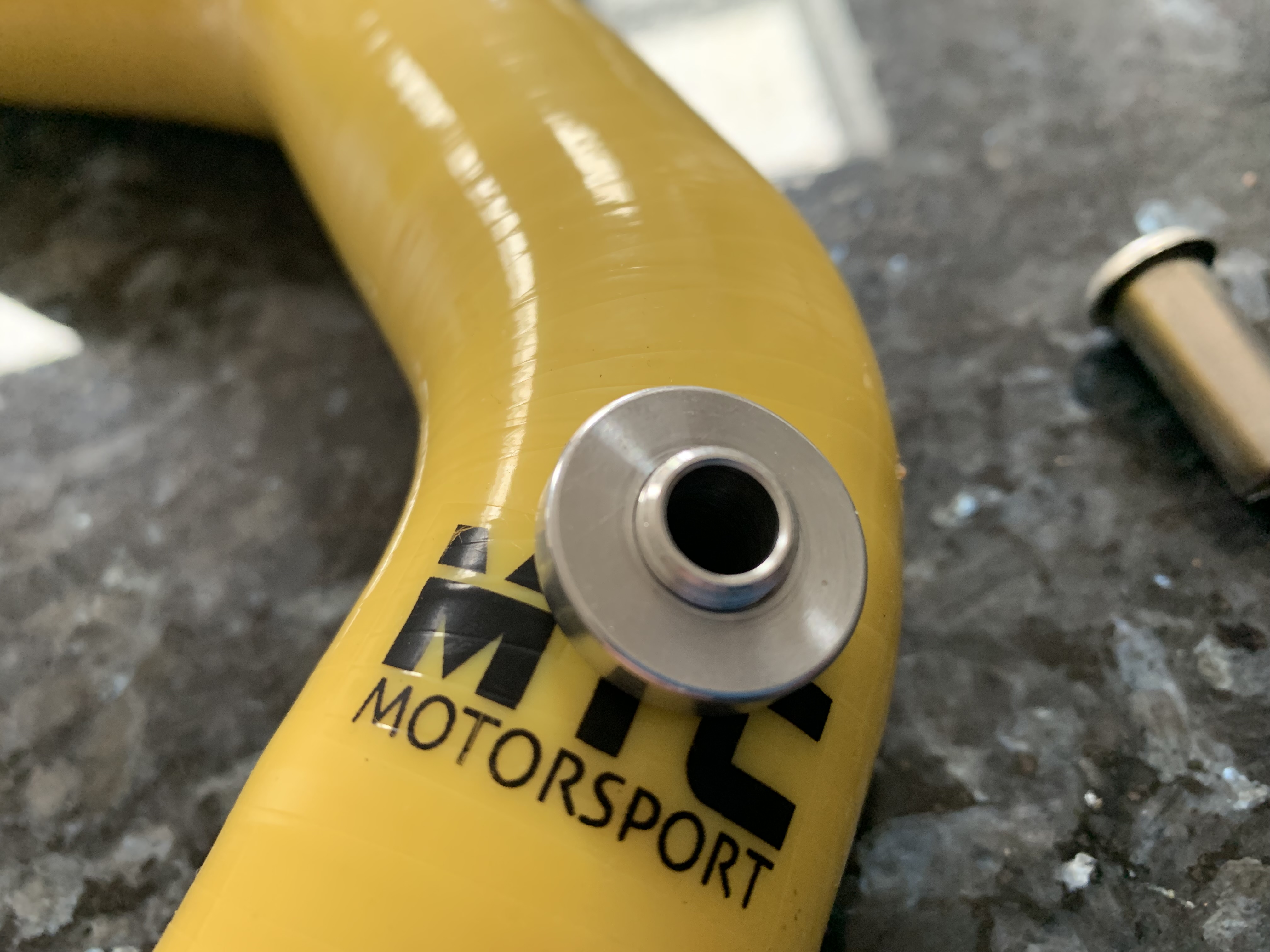

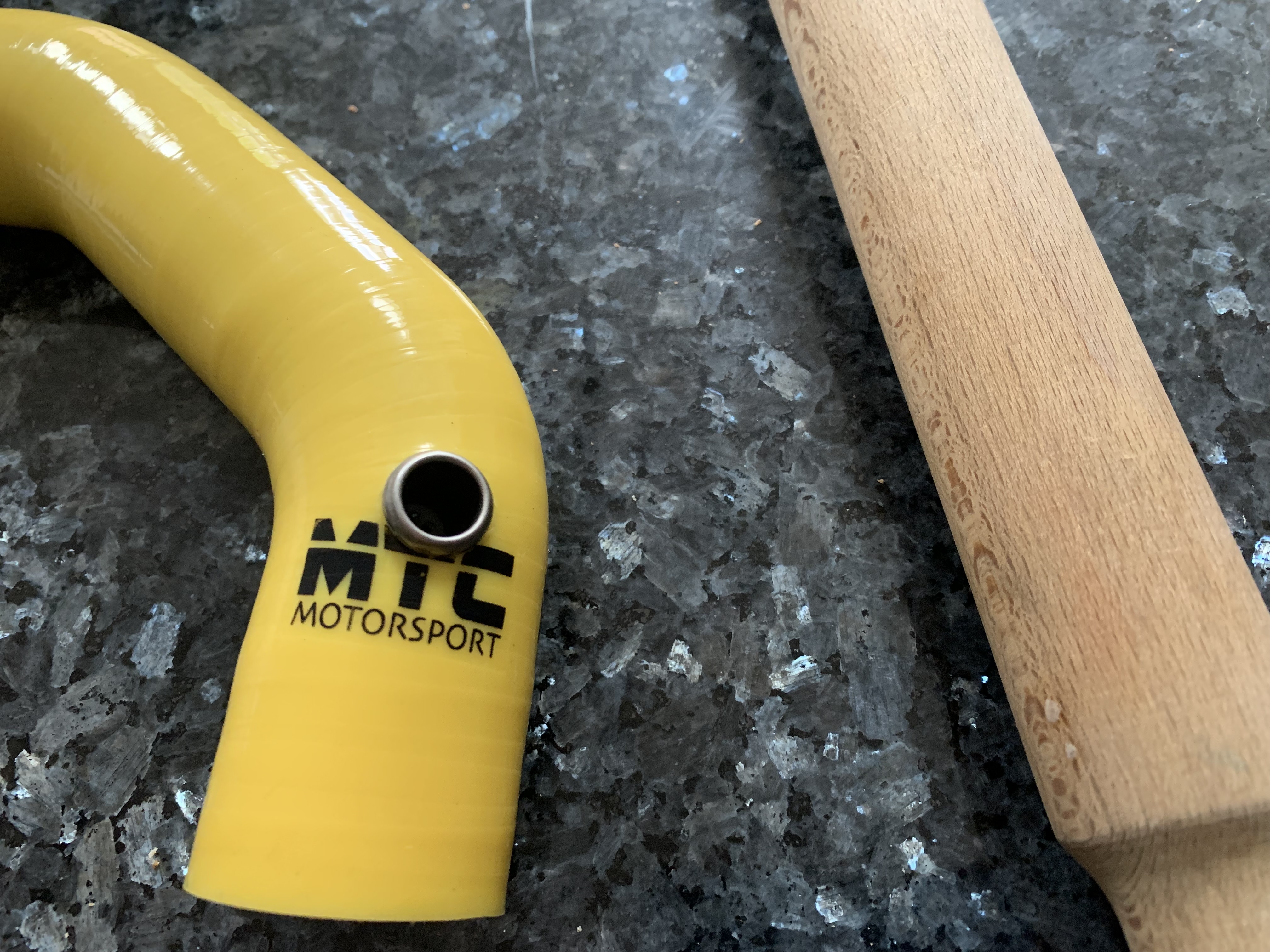

With the radiator secure, I set about fitting the controller and building a loom.
Top hose off, then stuck an old rolling pin into the pipe and used the supplied cutter to punch a hole in it.
Added the screw, seal washer, then the thermostat.
Then built the loom.
Connected it all up, filled the engine with coolant, topped the power steering with redline fluid and we have fans 😍
Job done!
Tools down, hot bath and going out for a curry.
Suspension tomorrow providing the weather is kind. Thank you for reading.
I have that rad and have the twin spal push fans on the front which gives me enough room on the back.
Subbed to your thread aswell, car looks mega so far 👍🏻
Never thought about having them on the front 🤔 It’s not too bad now I’ve twisted and pushed the PAS pipe back a bit.
Much better than the old setup mate 👌 the design of rad core will cool far better than the old one.
I’m just glad I’ve got some fans tbh Jon. I pulled back the tape from the old loom and some wires had come away, so it was never going to kick in at Croft. Glad this bits out of the way.

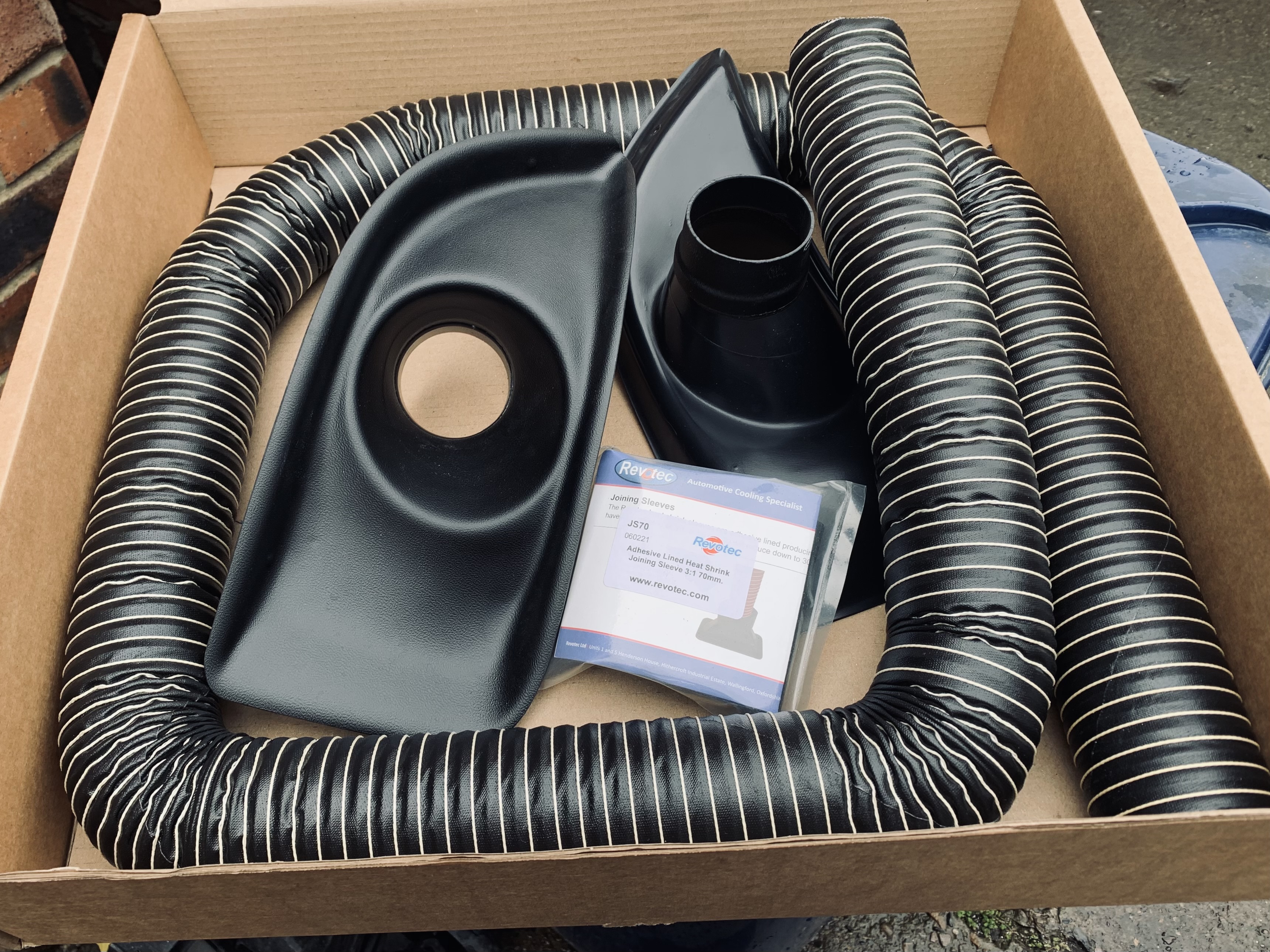

The rain finally stopped so I made the most of the time left to put my brake ducts on.
I originally ordered the K-Tec rally ducts as they looked purposeful, but they messed me about so much I opted for some from Pure Track instead.
You can either bond or screw them in. I opted to use some M5 Rivnuts and torx screws.
It just makes life easier should I need to remove them at some point.
Whole job took an hour and I’m pleased with how they look.
I’ll add the pipe work once I’ve switched the suspension over, hopefully by next weekend.

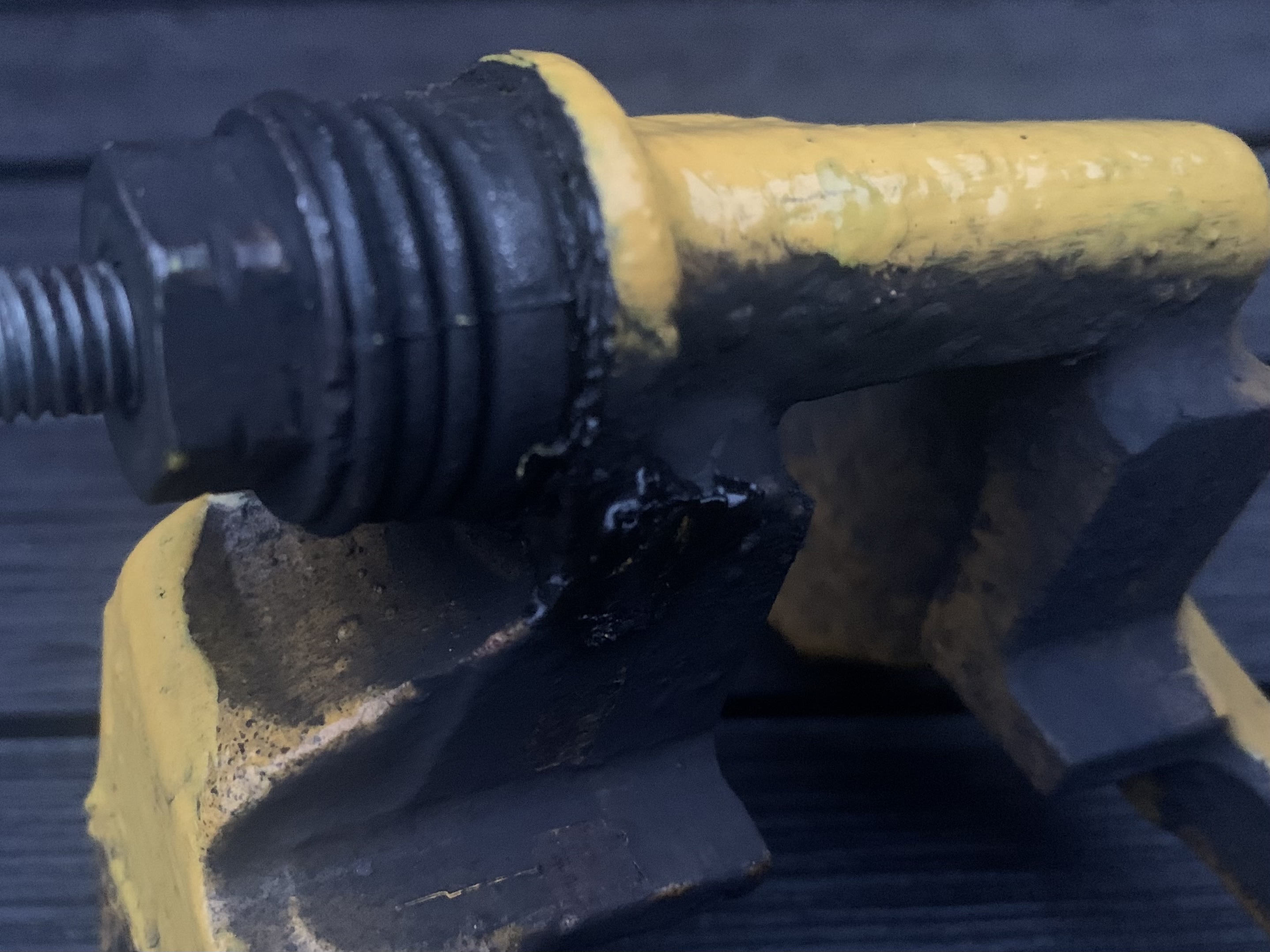

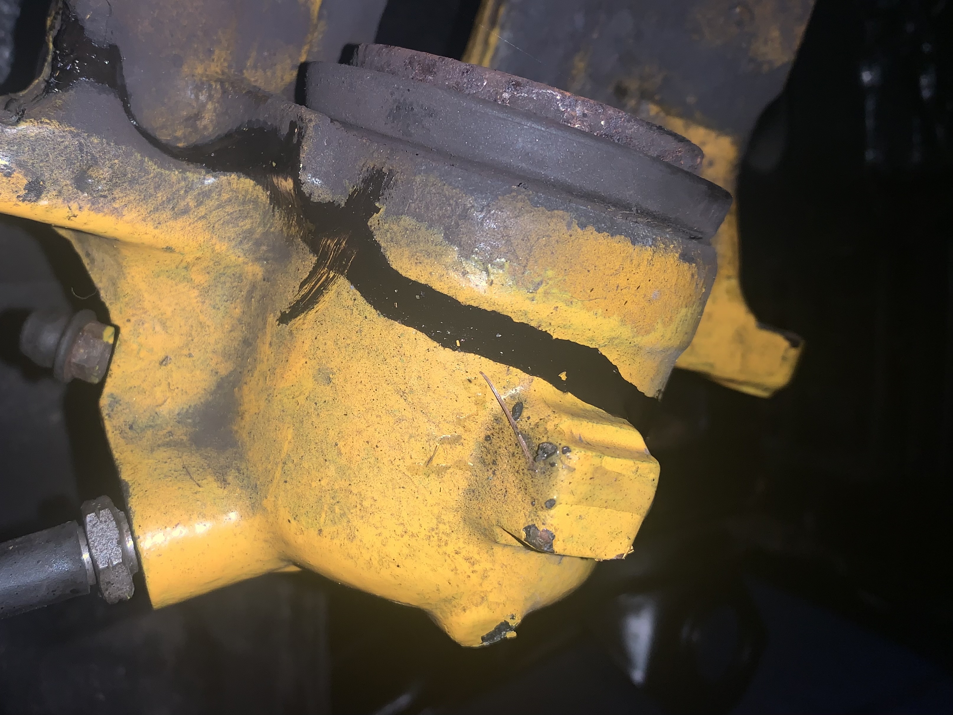

While everything was stripped, I had a look for leaks because after my last outing at Croft, I noticed some grease on the outer rim of my OSF wheel.
I did the taste test as I don’t want to do a @SuperJ and find out it was BBQ sauce 😂
Nothing coming from the driveshaft CV boot, but plenty on the caliper.
A closer look seemed to point to the sliders on the carriers.
Looks like it’s packed with thick grease, which also meant the sliders weren’t moving as freely as they should. I’ll give those a clean up and stick on some new rubbers, pins and brake grease.

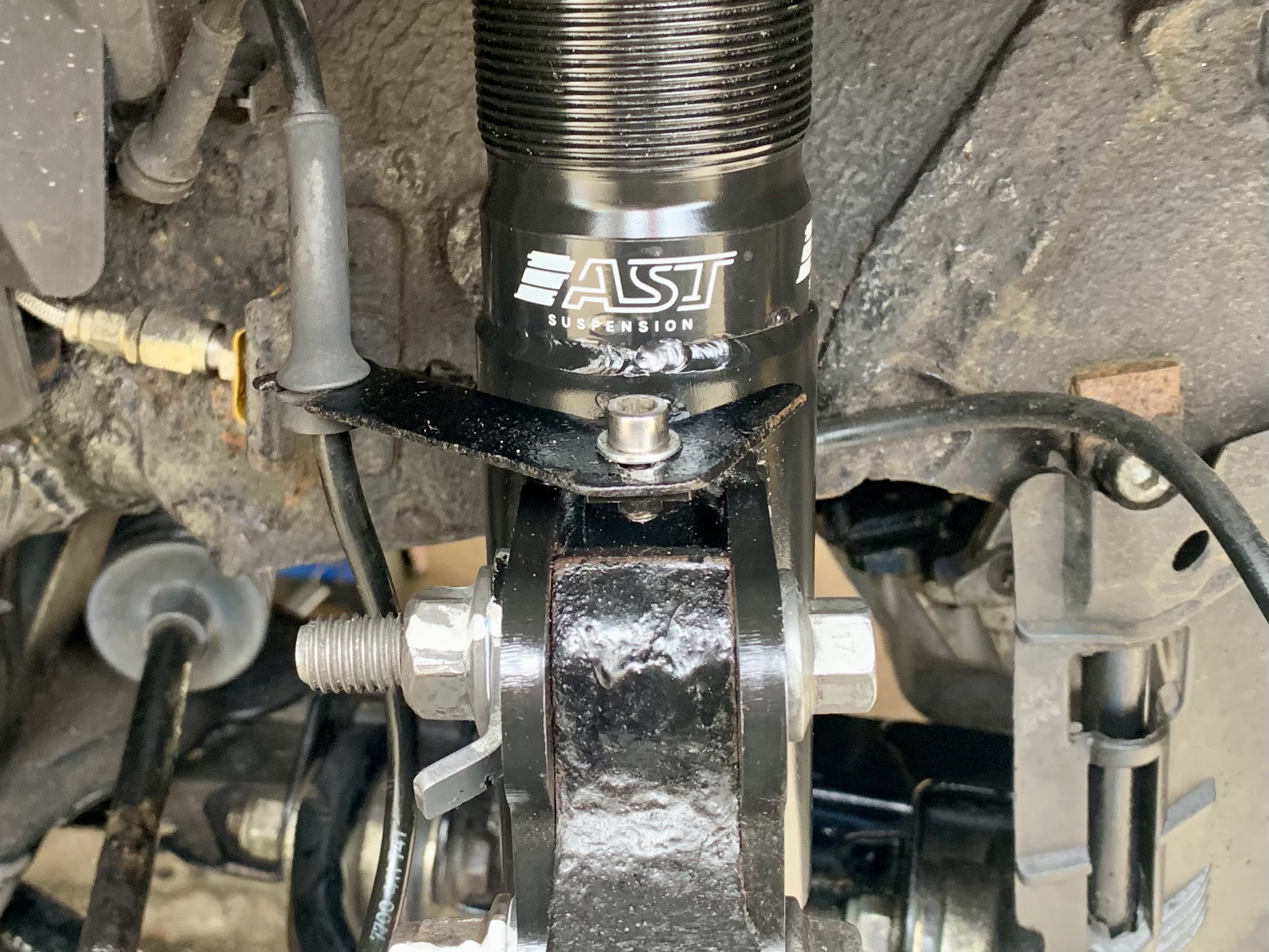

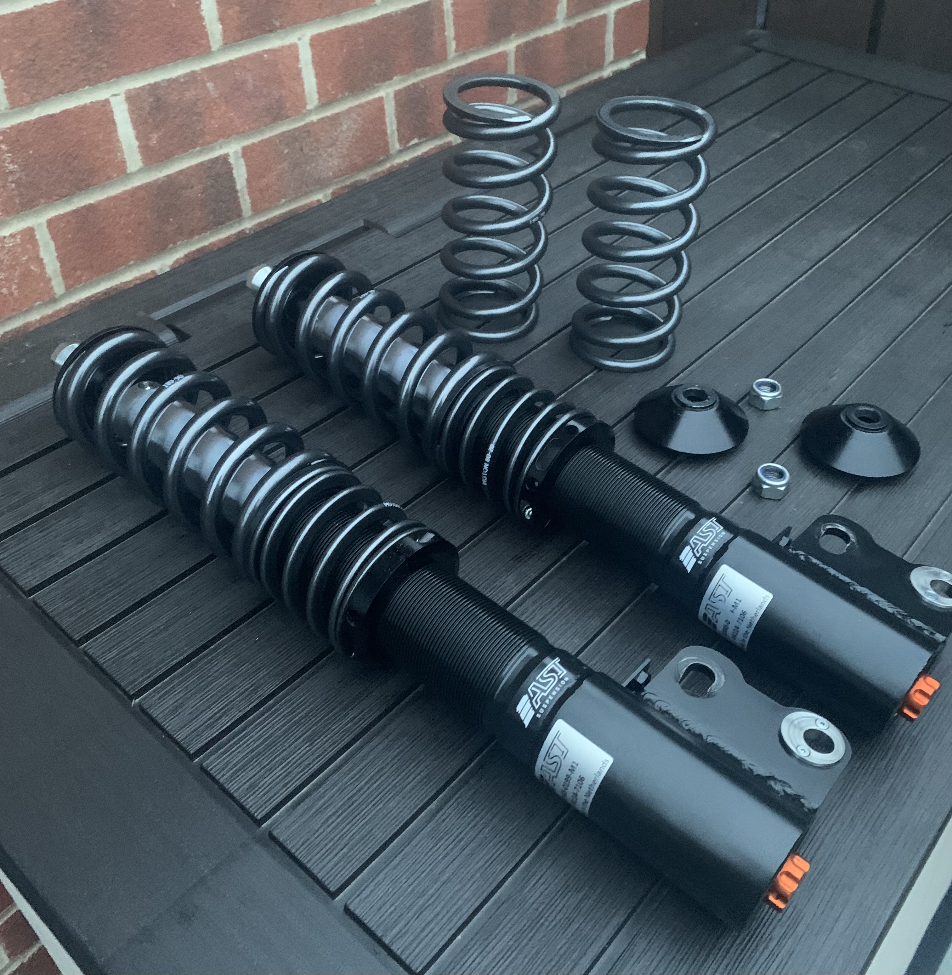

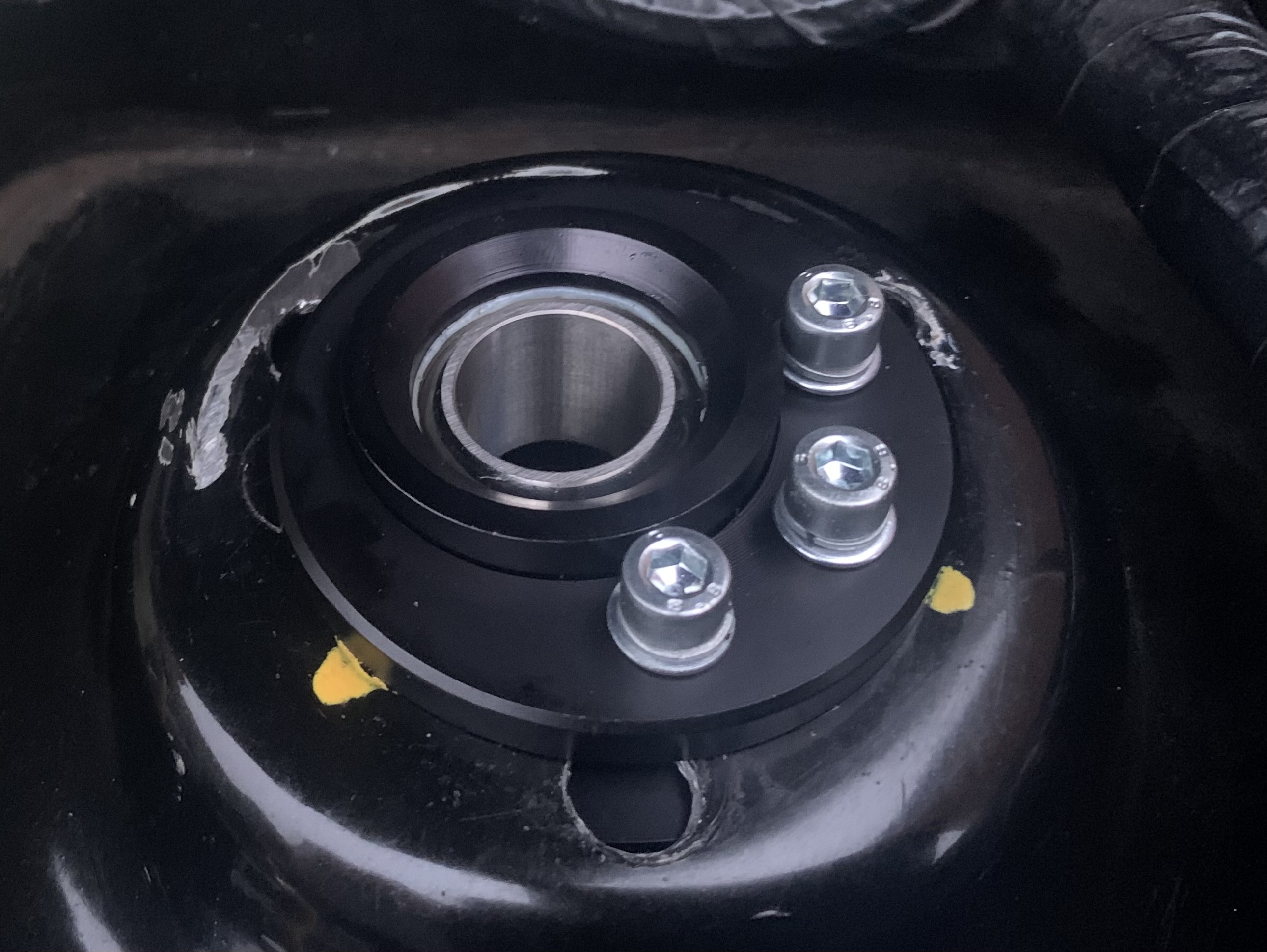

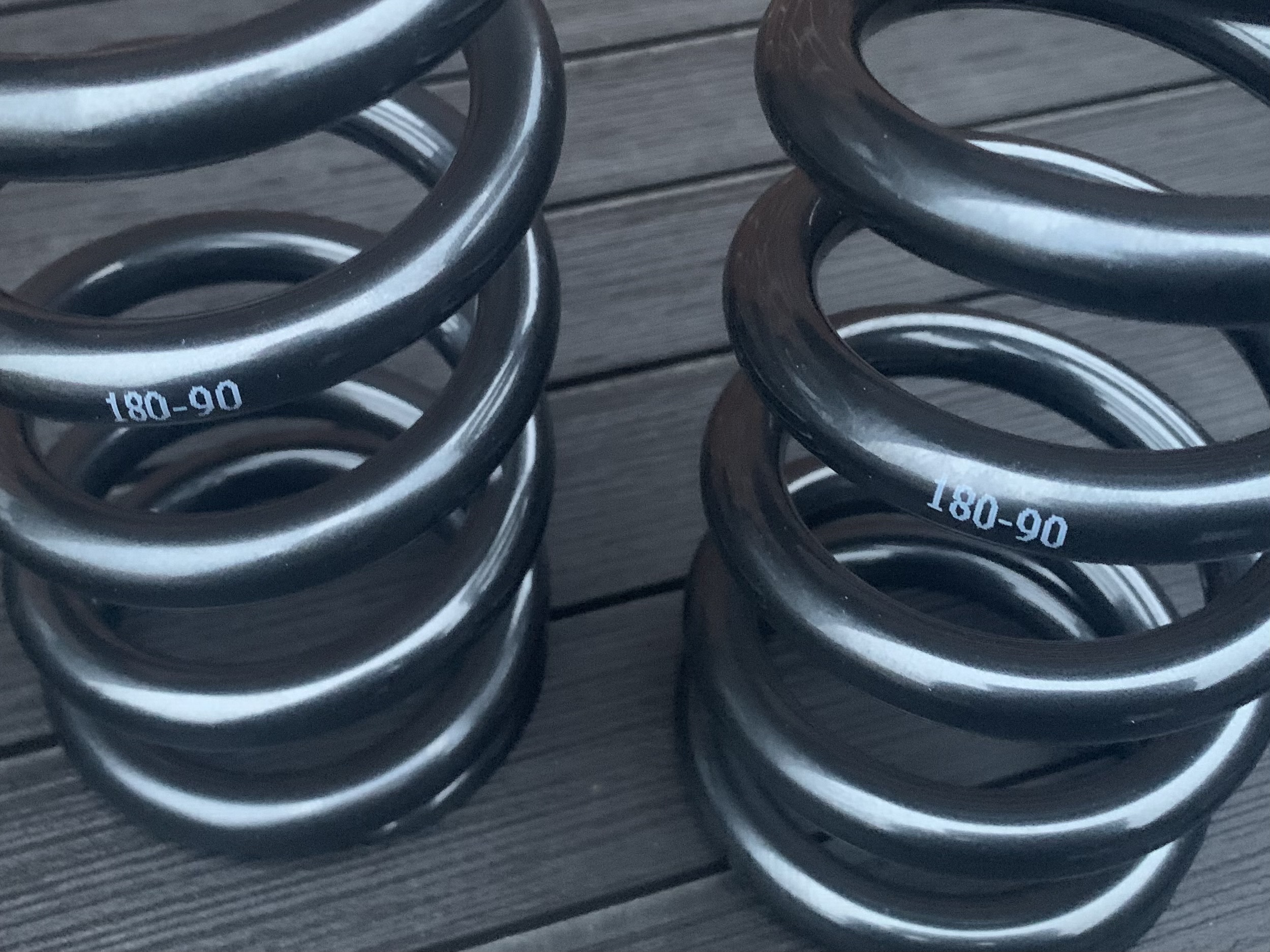

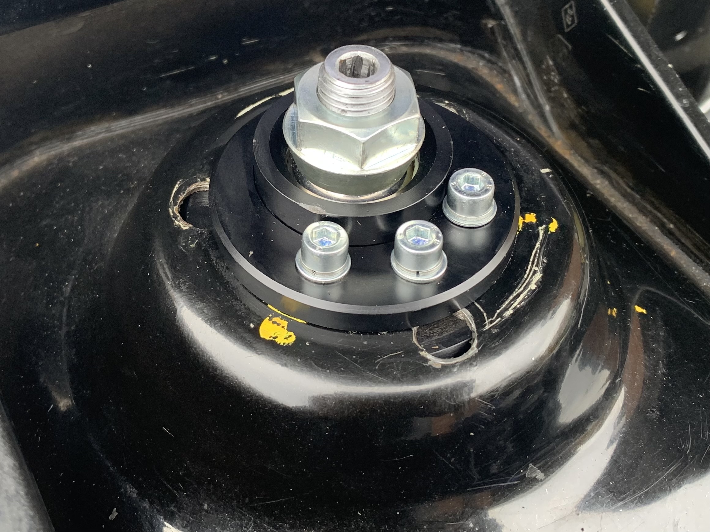

Dug my ASTs out and switched the springs over.
I’ve opted for 90Nm front and 100Nm on the rear after chatting to lads doing the TDT/TDC championships. The springs aren’t mental money, so I can always try a few different rates if these aren’t to my liking.
Last job was temporarily fitting the top mounts.

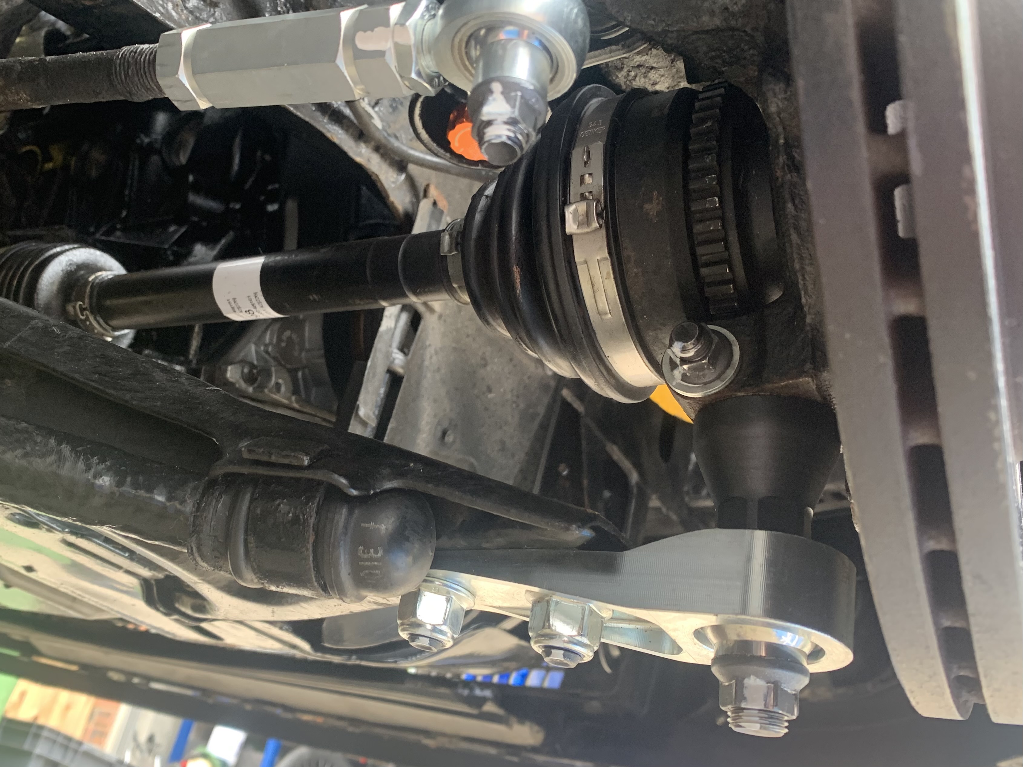

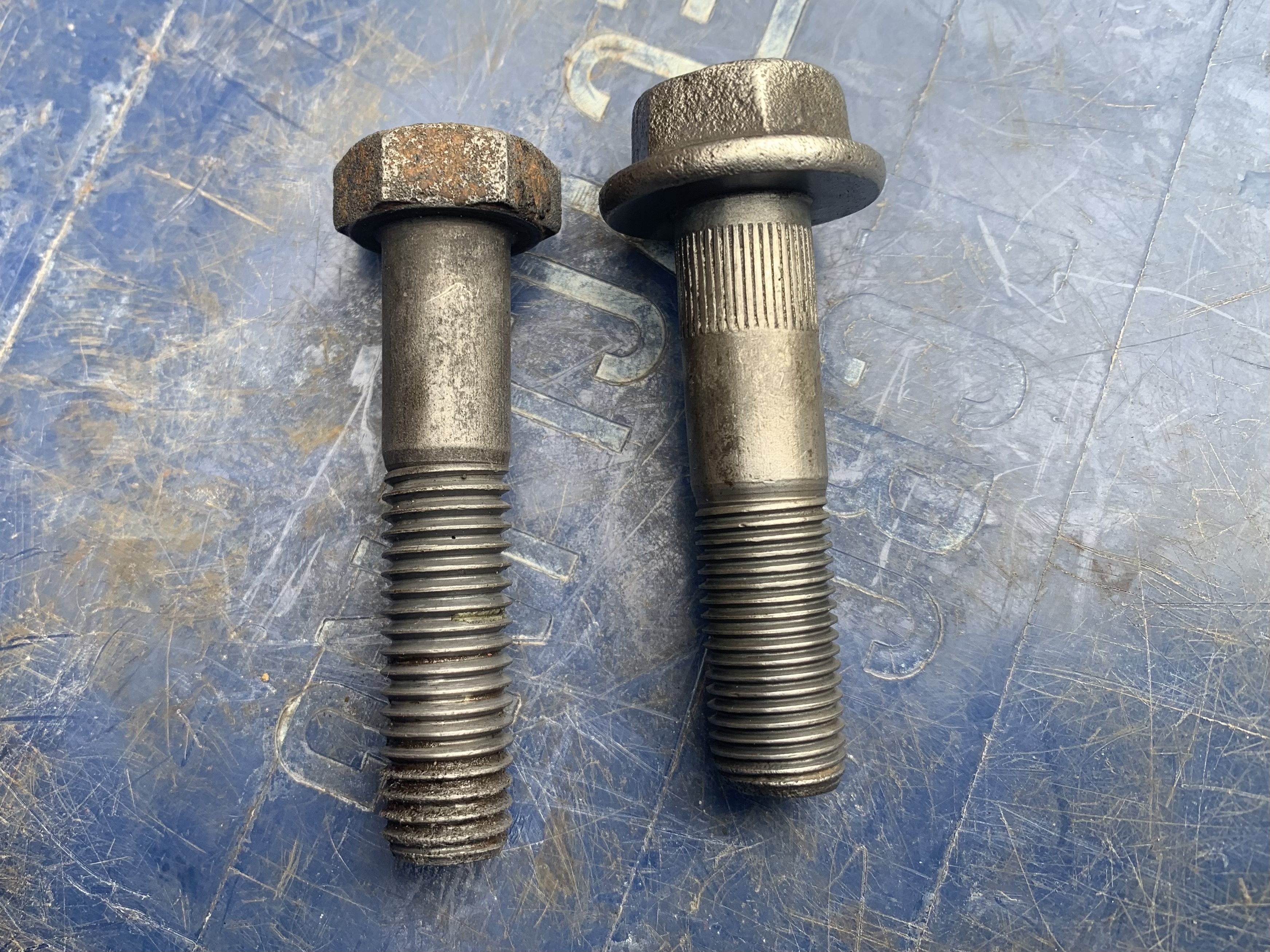

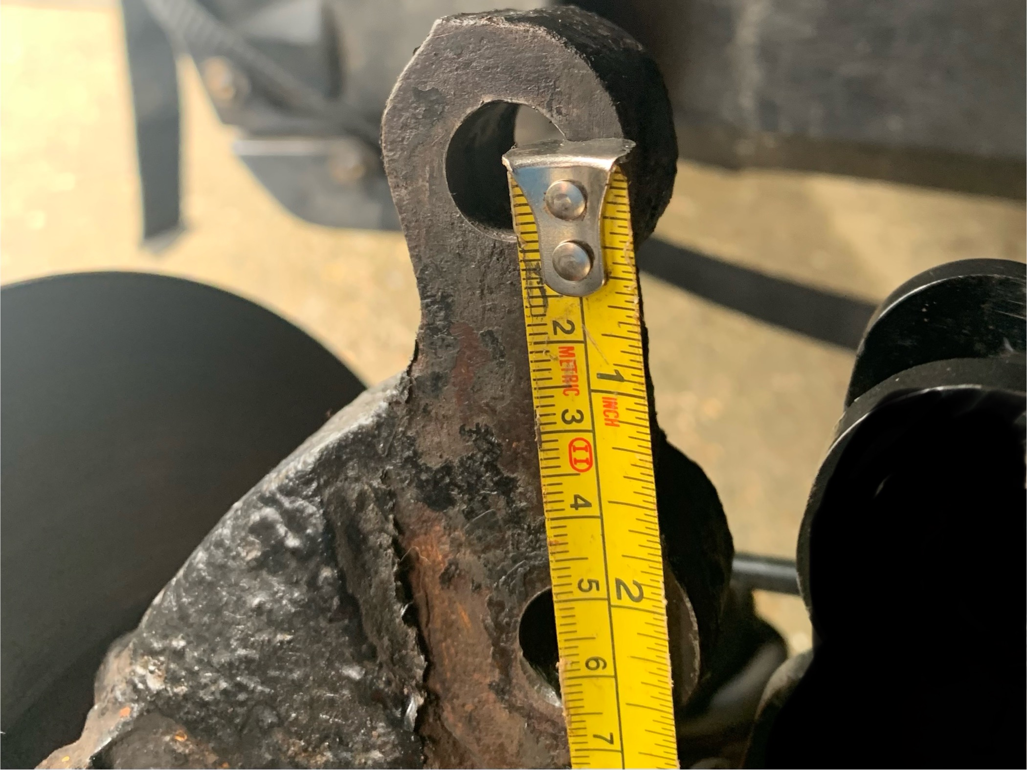

What a fight this car gave me today.
First up I was struggling to fit the bolts through the dampers and into the hubs.
I thought I’ll just measure the bolt distance and as suspected, it has 54mm hubs 🤔
It’s a CUP packed car, albeit an old one at that, so s**t happens I guess. Never mind, ASTs have a removable washer so they fit both. I planned to get some CUP hubs and stick some bearings in anyway, so that’s motivation for me.
Switched a couple of bolts for some genuine spares I had lying around. I’ll get a couple of new ones this week as they’re a bit pitted.
Top nuts tightened and suspension on.
Also got the geometry kit fitted on the drivers side.

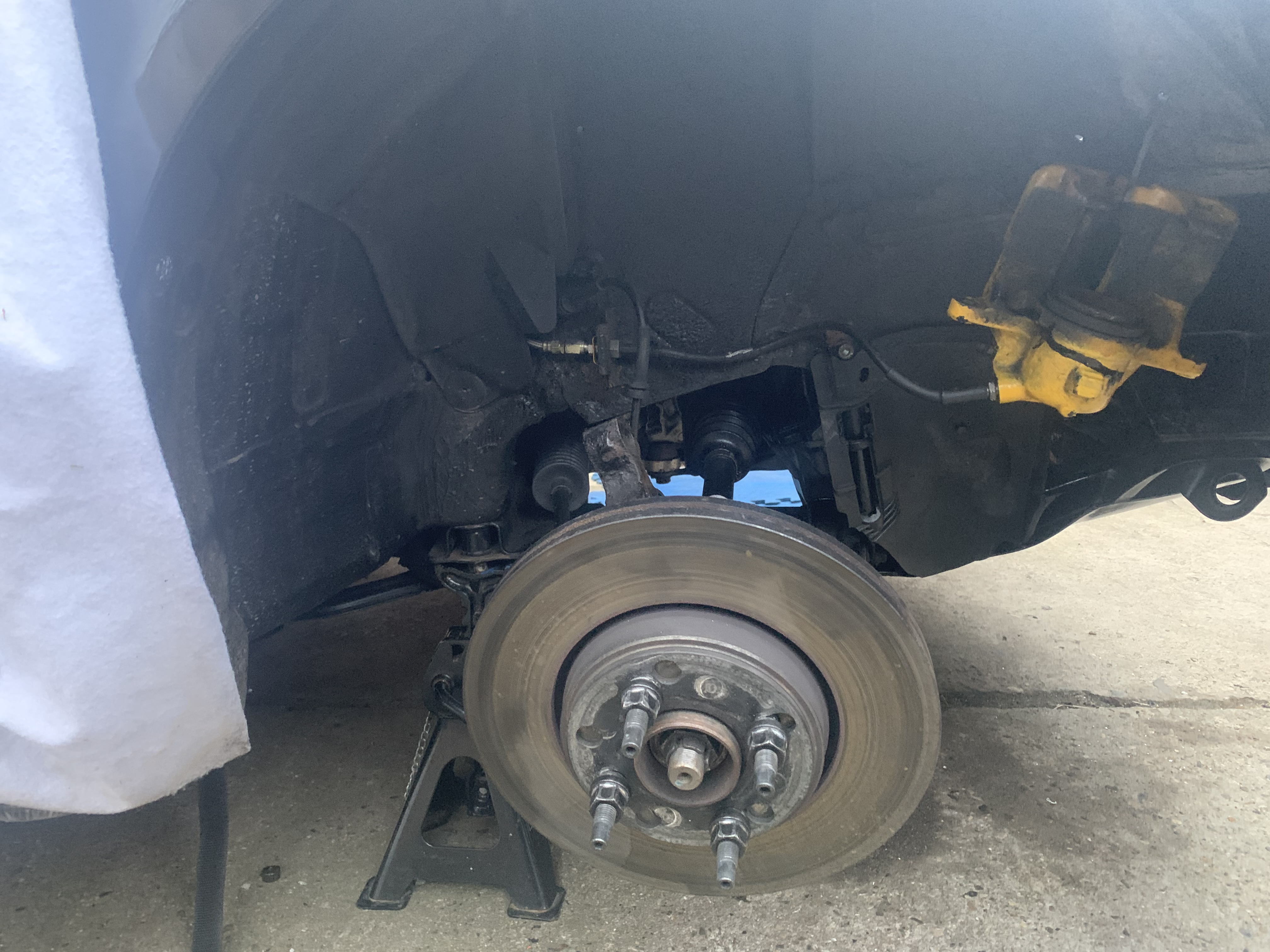

Overall things were going ok until I started the passenger side.

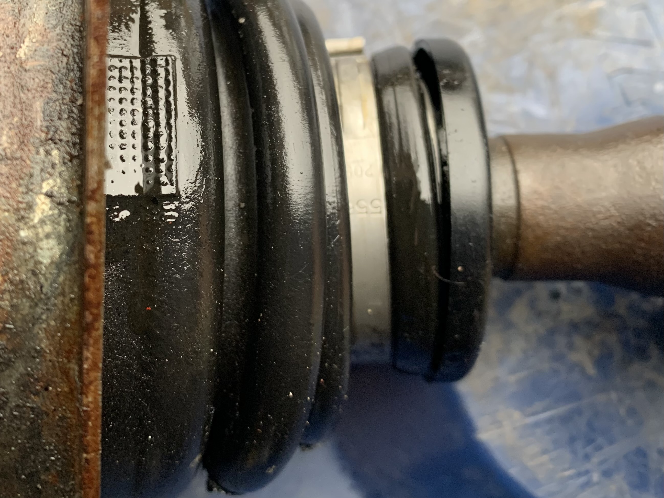

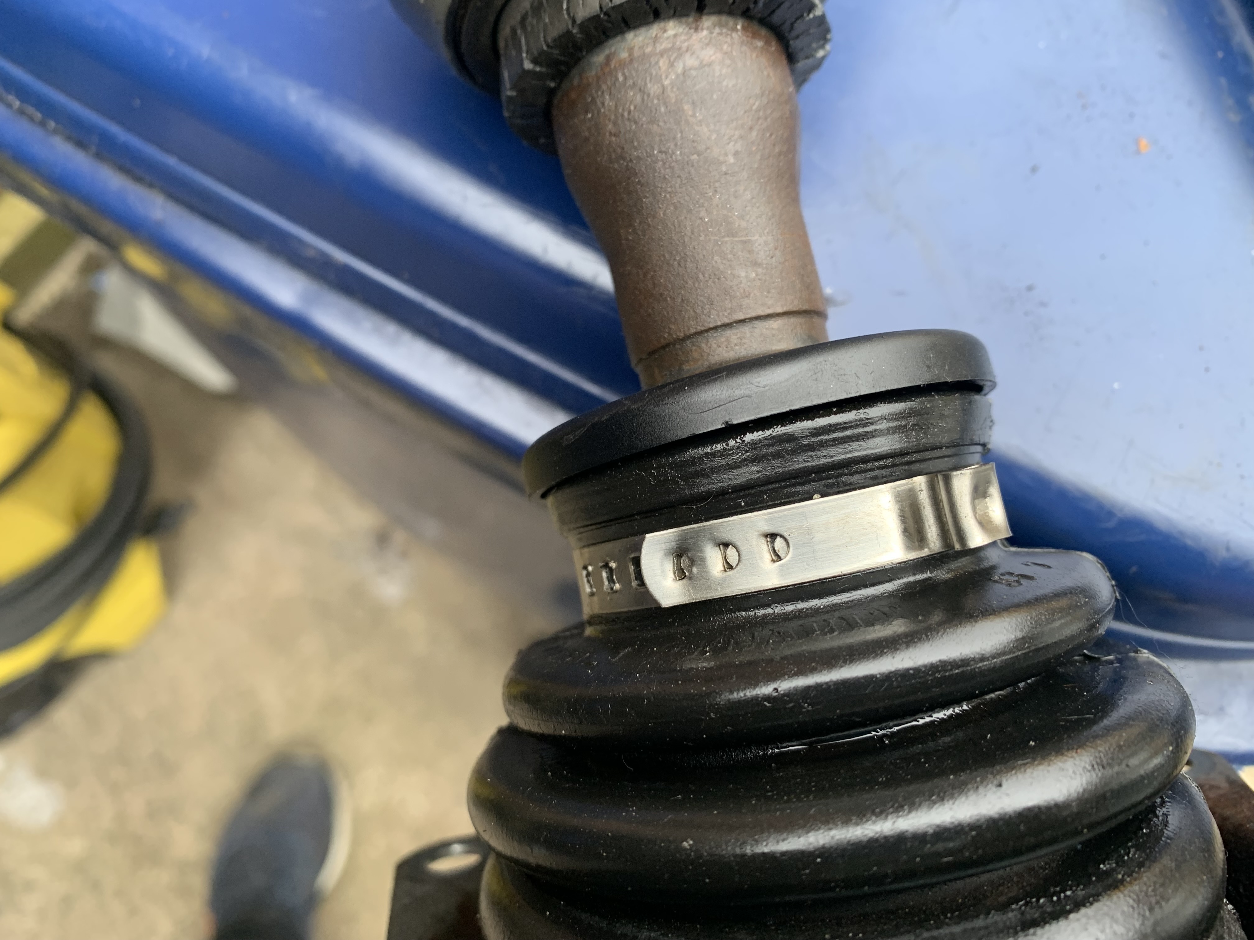

Before I went to bed last night, I thought I must remove the brake disc on the passenger side to make the whole thing lighter and avoid pulling on the driveshaft.
Of course like a knob, I forgot and as I dropped the two bolts out of the wishbones, the hub/disc lunged forward and gearbox oil began filling my driveway. F**K!
After dropping the rest of the oil I whipped the driveshaft off to see what I’d done.
I’d pulled the CV Boot away from the seal 🤦🏻‍♂️
Luckily I have every tool and spare known to man, so removed the old clip, pushed the boot back onto the seal and fit a new clip.
It’s back on the car but I haven’t put any oil in the box yet, so fingers crossed I’ve managed to fix it.
Threw the towel in after that. Tomorrow’s another day. Thank you for reading.
I did that exact same thing with the drive shaft, last time I took it off i removed all the hardware to make it light as I didn’t want to buy a load more gearbox oil having just changed it!

I didn’t take mine off the car just lobbed a clamp around it and sent it. Been fine for 18 months, given you’ve done it properly I’m sure it’ll be spot on.
