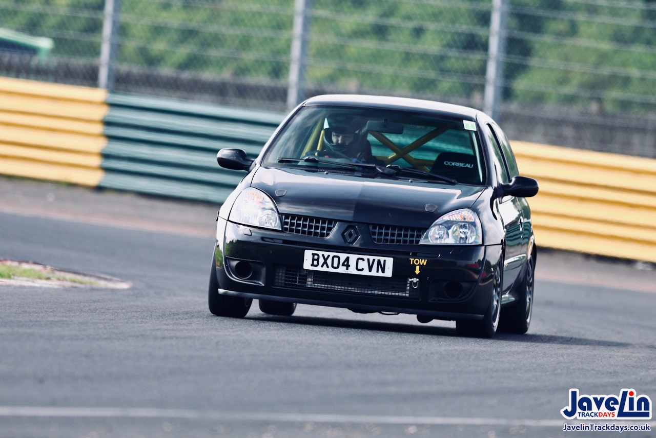

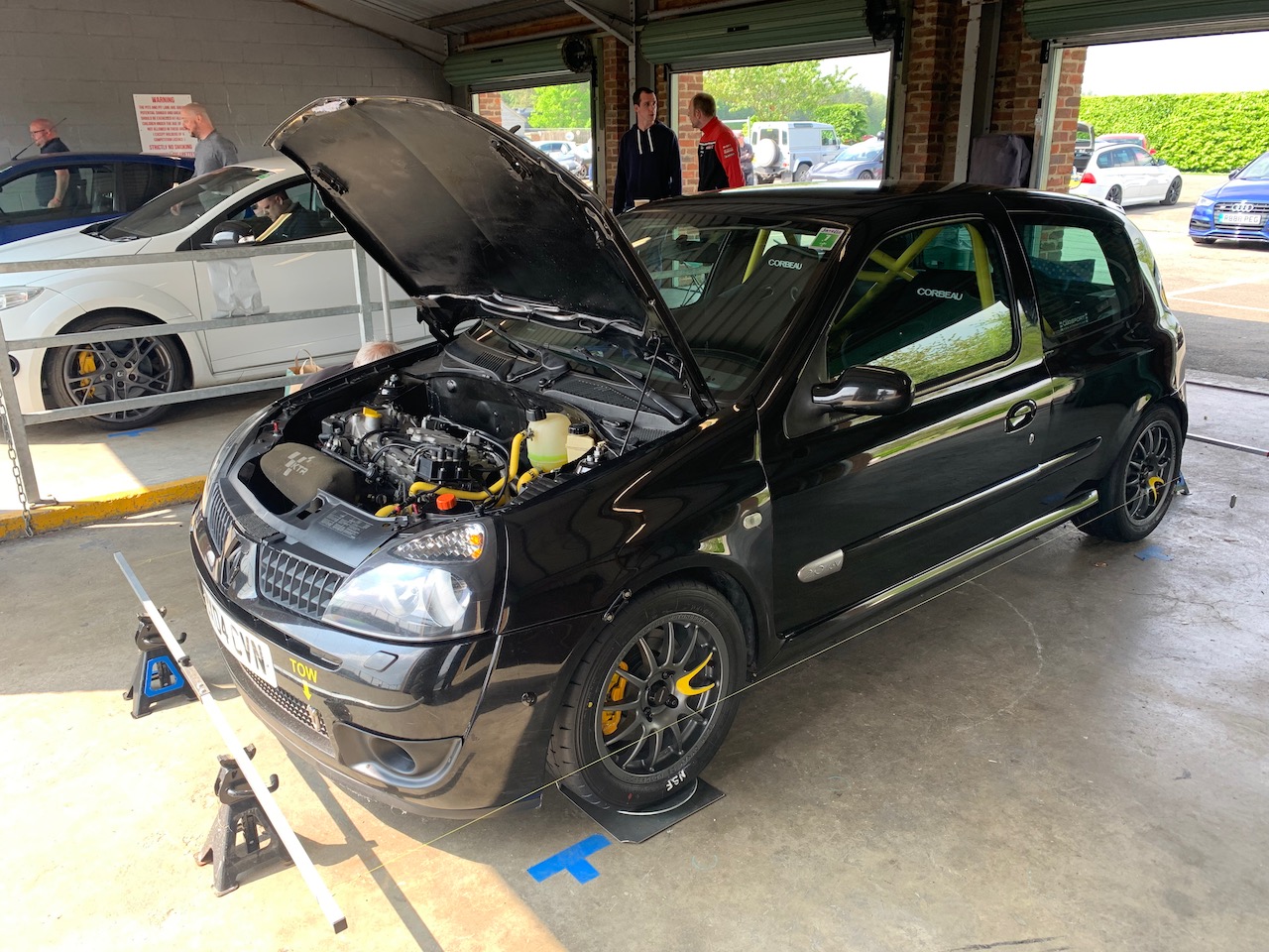

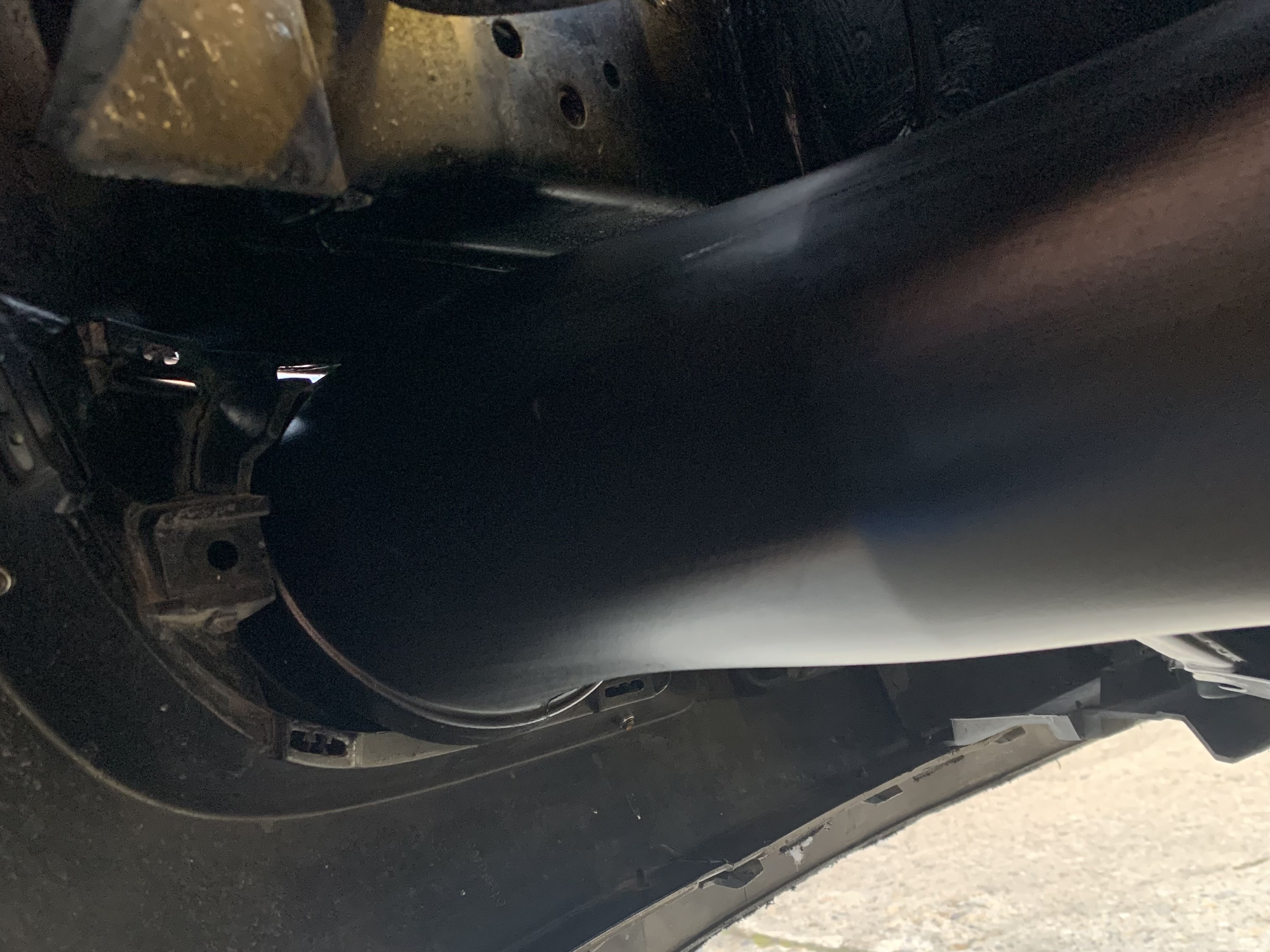

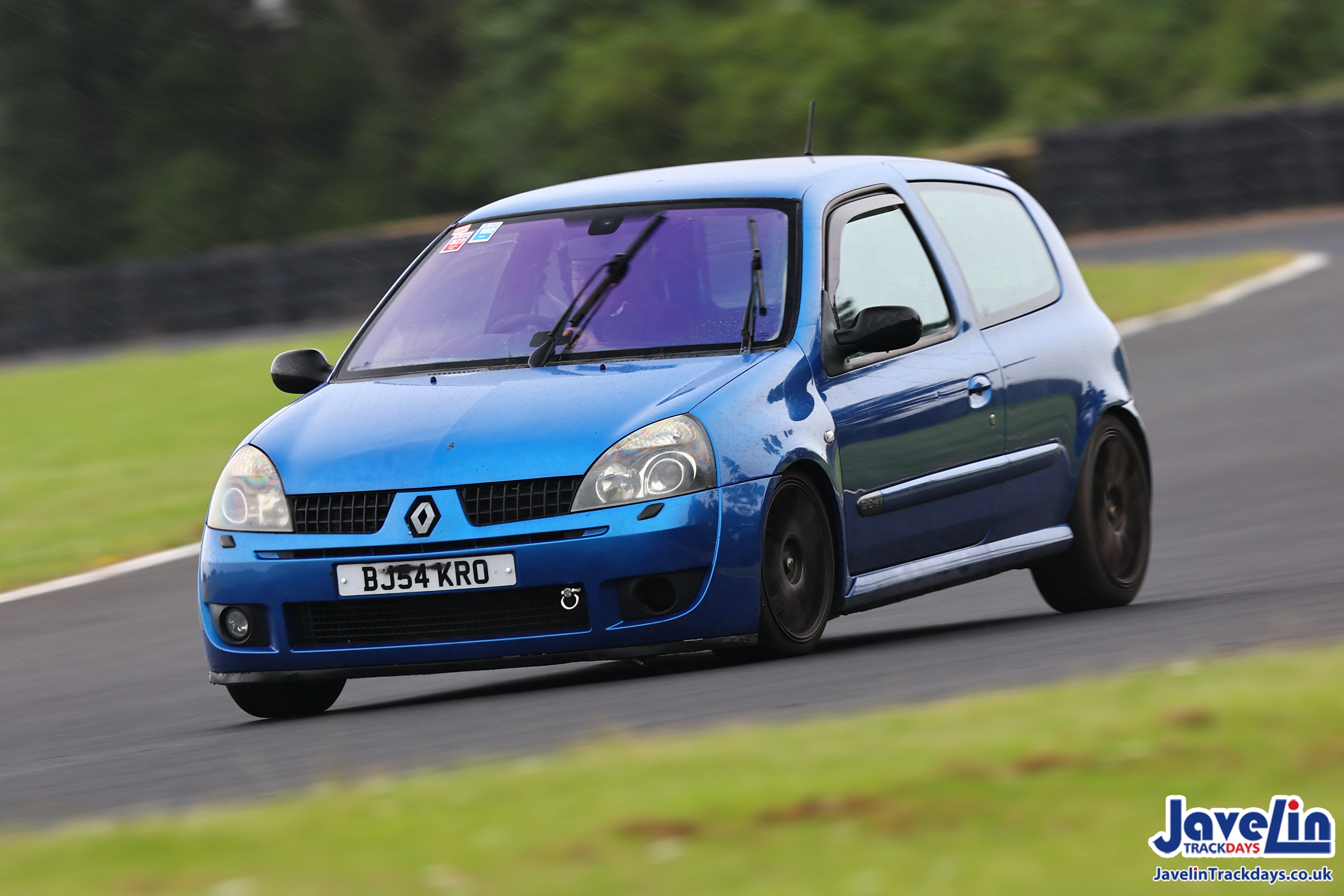

Great day at Croft, although we were having so much fun we never got any pictures 🤦🏻‍♂️
Here‘s one from the arse end on the way.
Met @SharpyClio for the first time. Good to meet you fella and thank you for the loan of the towing eye. We got sorted in the end.
@Brigsy popped in with his missus and Bumblebee 225 and we had a good old natter.
Lots of fast machinery there today and a ridiculous amount of Red Flags. Never known anything like it, which just goes to show the lack of talent that turn up to these events these days. It’s a bloody track-day for god sake.
Anyway, back to the car.

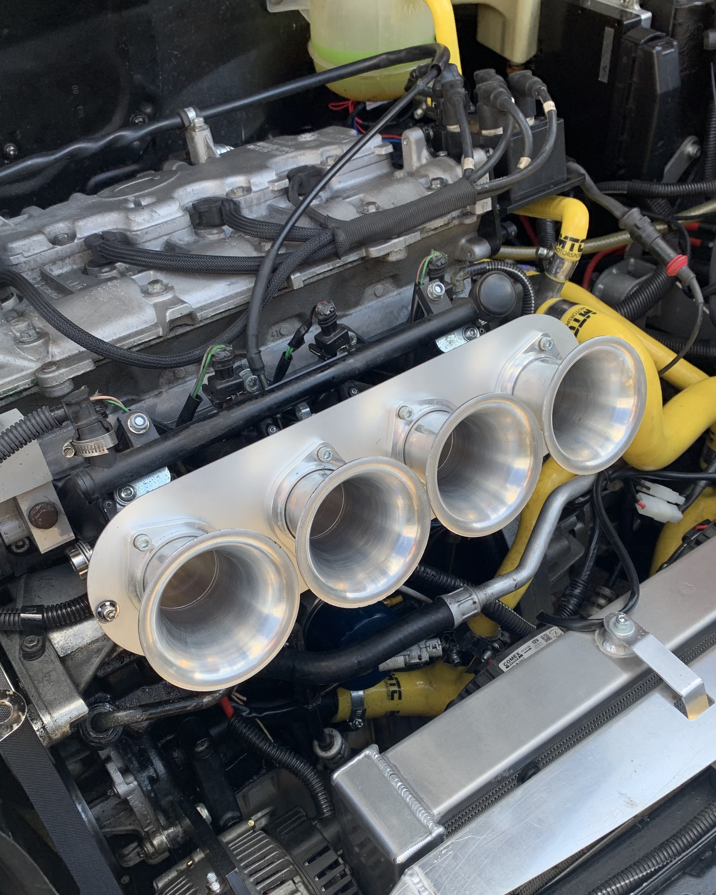

Engine : Awesome. This is a seriously fast Clio and I mean fast.
Gearbox and Gripper : Brilliantly set up and you can get all the power down.
Steering : Garbage. I’m going back to EPAS
Suspension : If I hadn’t of had my other circuit car I’d have been happy, but it’s just not set up for my tastes.
Exhaust : 97 decibels at 5,500 rpm. Happy with that.
Driver : s**t. I’ve gone back over 😂

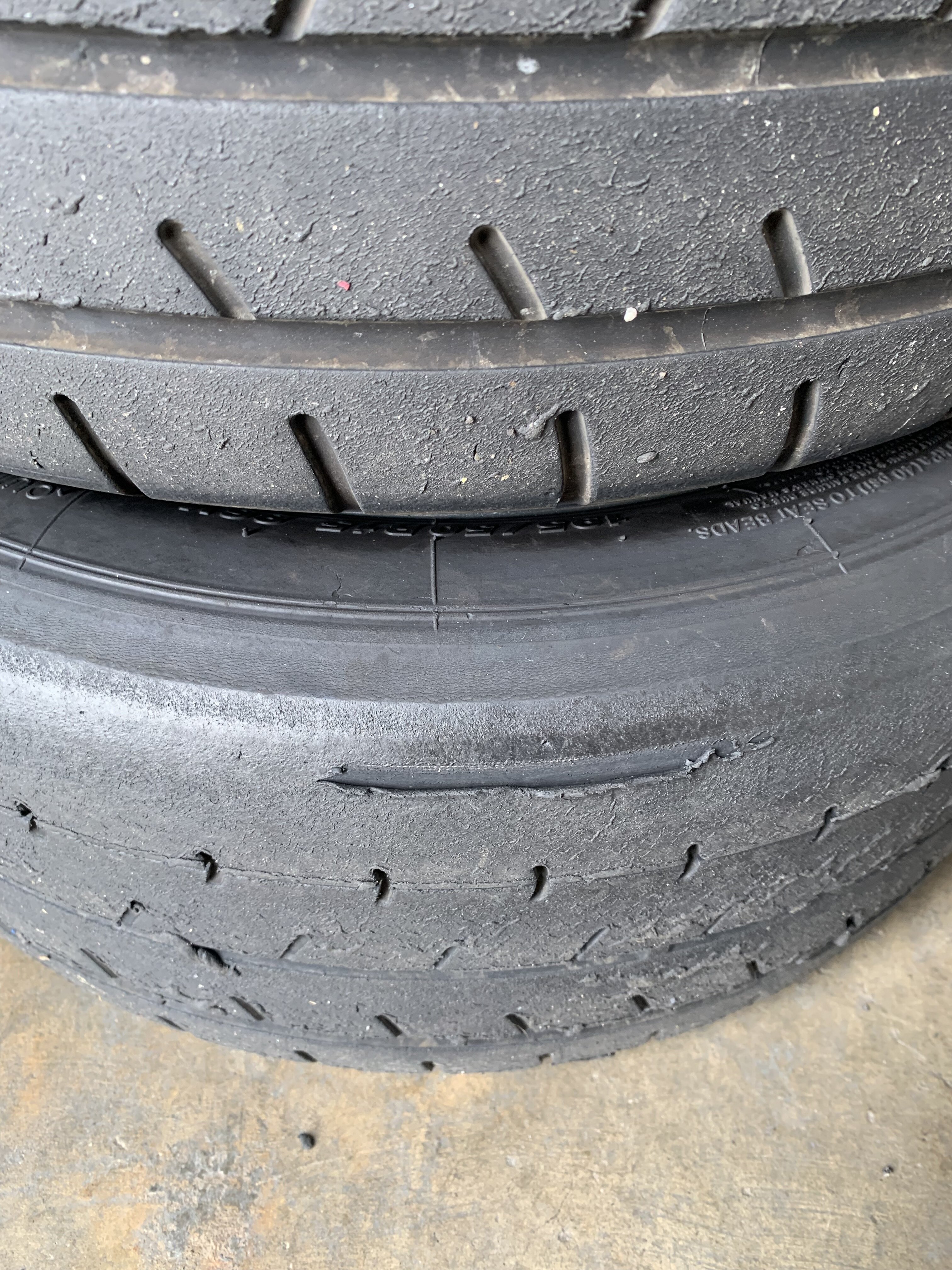

Might go Spax 750Mc like my old car. Currently have the AST 5100 kit but I can’t get my head around having the back stiffer than the front. Change my mind.
Fit my new tyres as the 52s currently on it are dead.

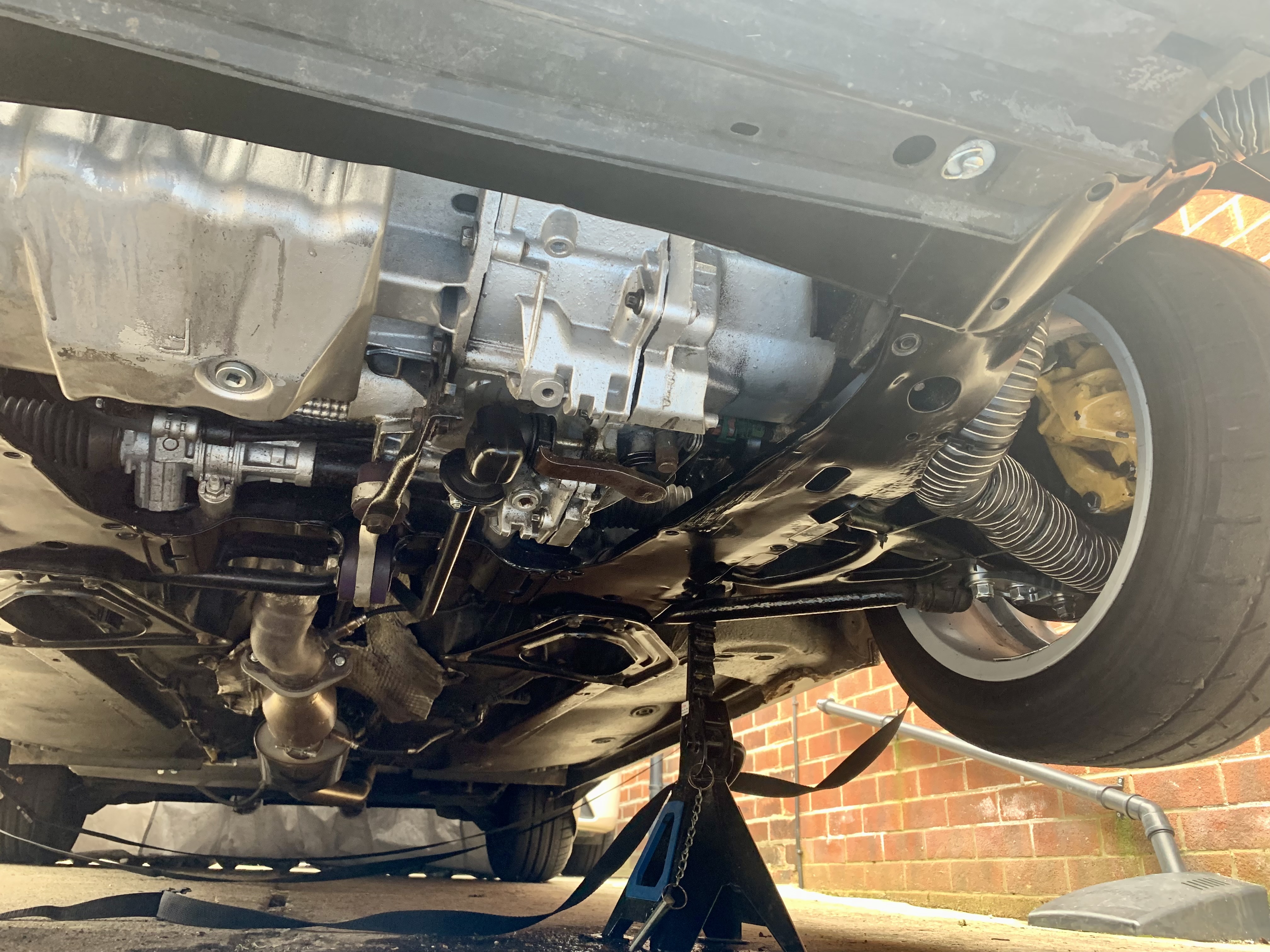

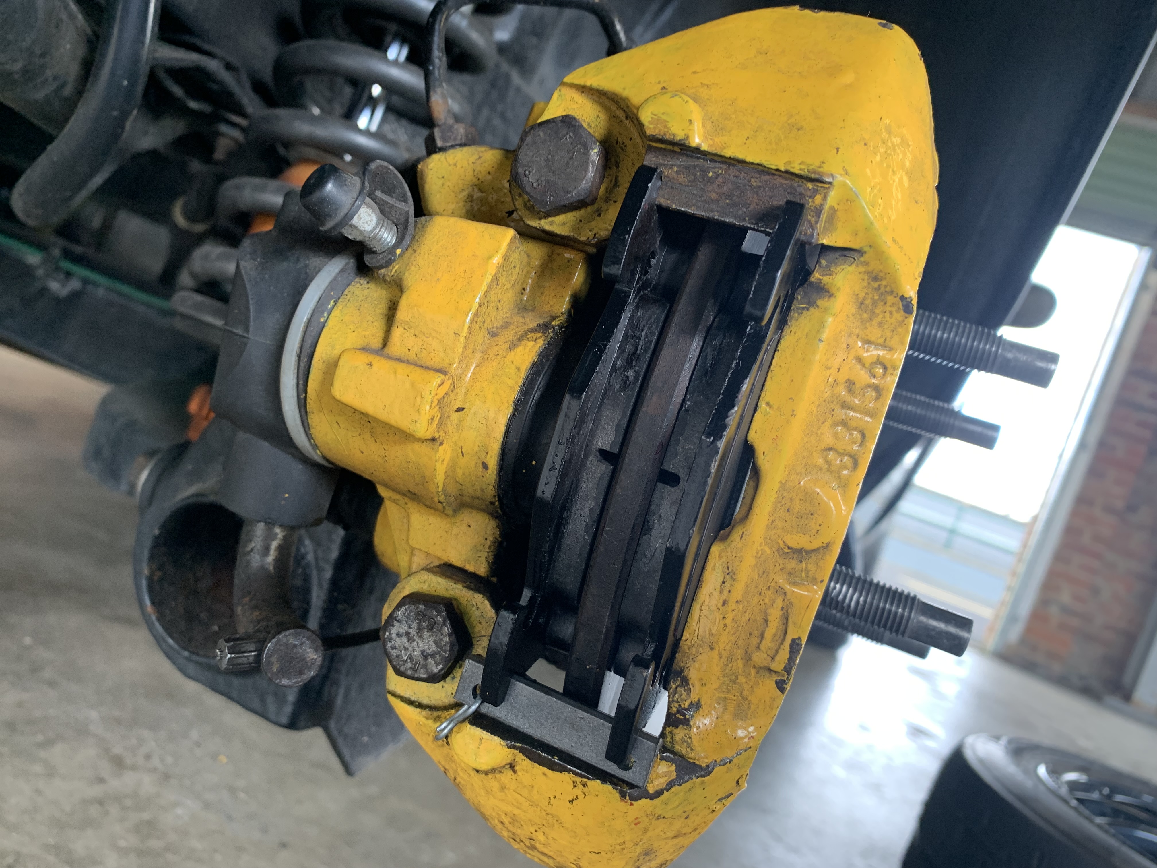

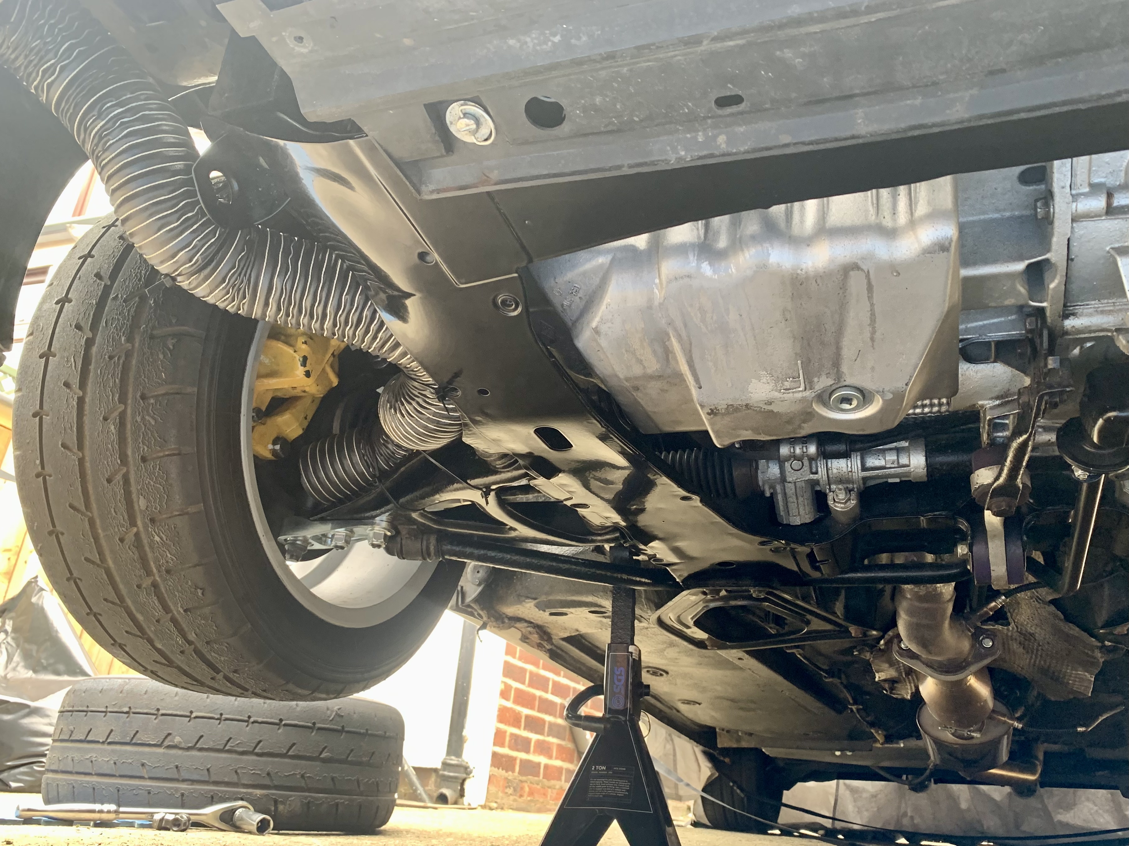

Driveshaft seal still leaking. Enough to force me to move my trackday forward to June. I’m an idiot 🤡
Despite that, I went around checking and torquing everything up.

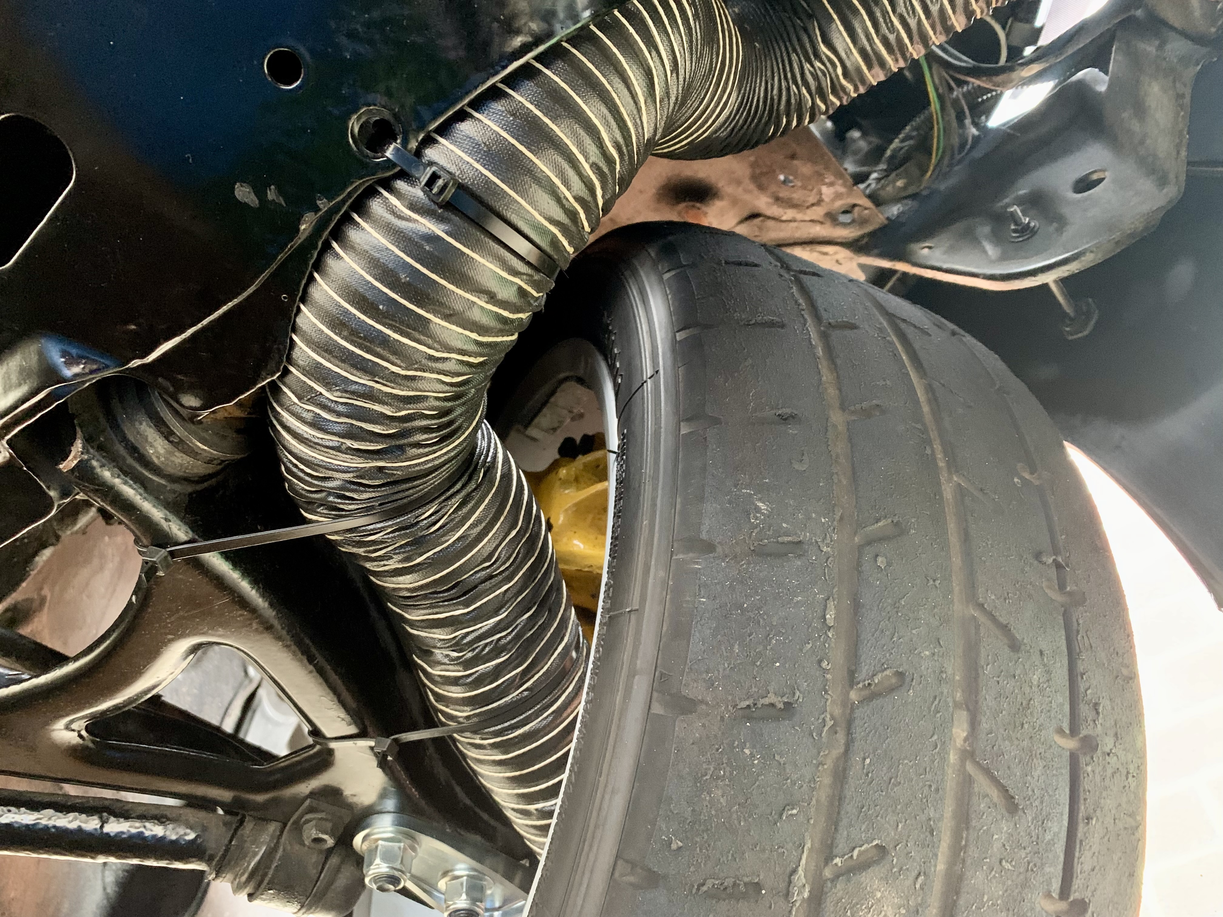

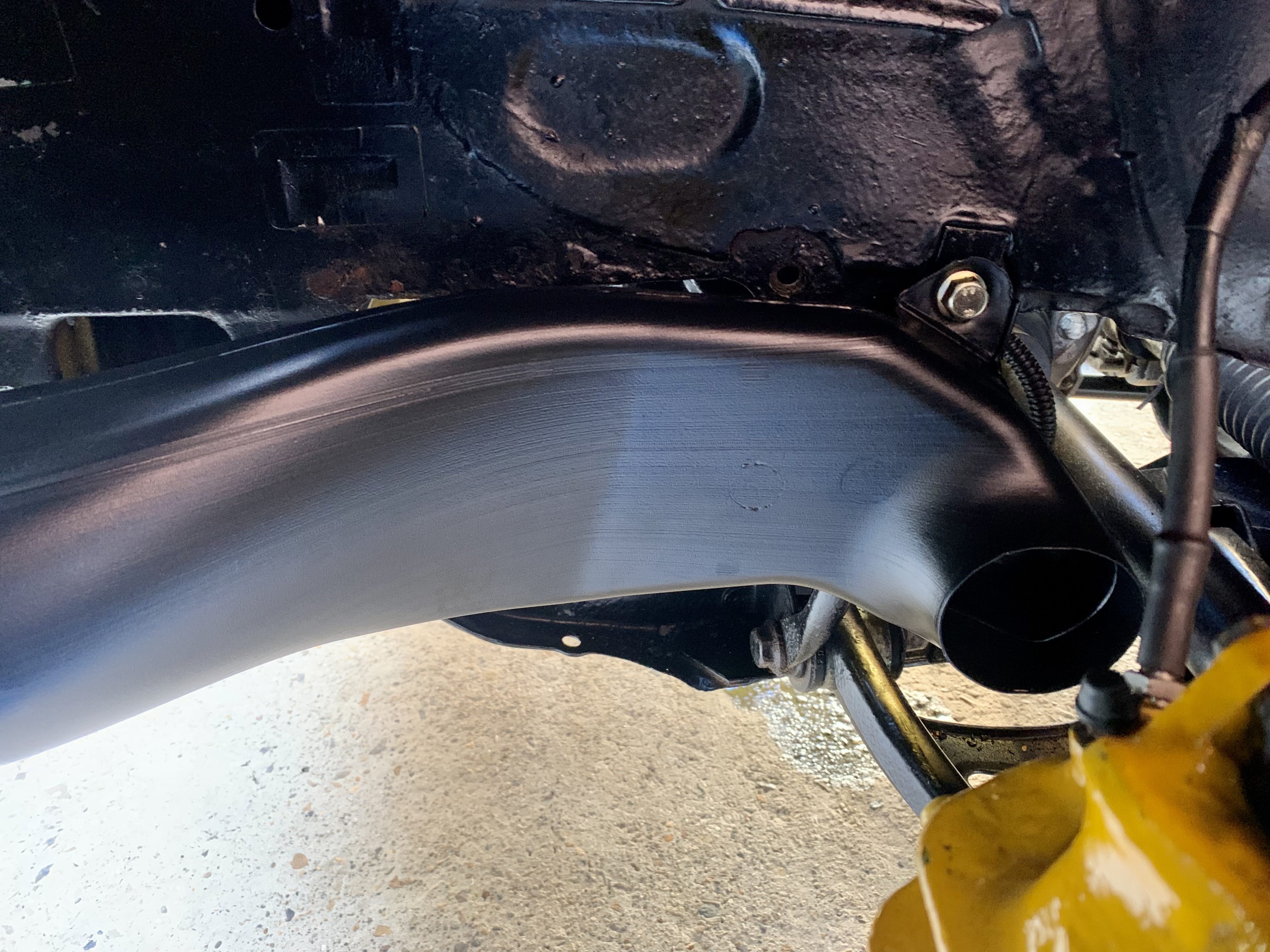

Got the rear suspension on and fitted the brake ducting. I ran out of cable ties but will secure those a bit more.
And that’s pretty much the car complete, at least for now anyway. I’ll get the leak fixed and give everywhere a good clean. Then get it to Croft in June, set the suspension up and enjoy the rest of the season.
It’s been a good education. Everyday is a school day. Thank you for reading.

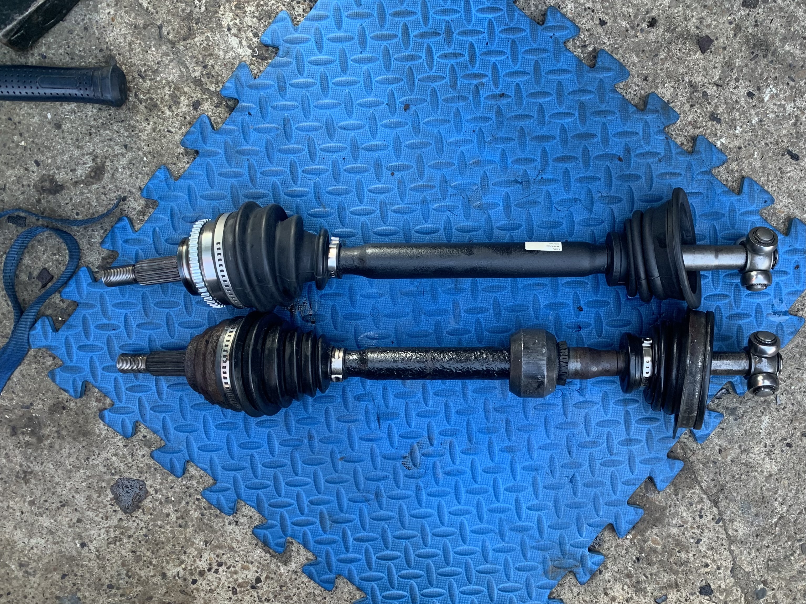

When I arrived at work this morning, it was evident that my colleagues weren't happy 😆
One brother was browsing the Javelin website, dropping subtle hints about an available spot and his elder brother was data gathering.
I mentioned I didn’t have a car and the lack of available driveshafts, but they insisted I find a registration for a non-cup Clio and book the last spot at Javelin.
So, I did.
These are the guys I share track days and Nurburgring trips with, despite them being half my age. They're reliable, and even my friend's dad from CMRacing came through with a spare. Good people.
By 3:30, I had the driveshaft in my hands.
Got home, had my tea and within the hour I had them switched over. 🤛🏻

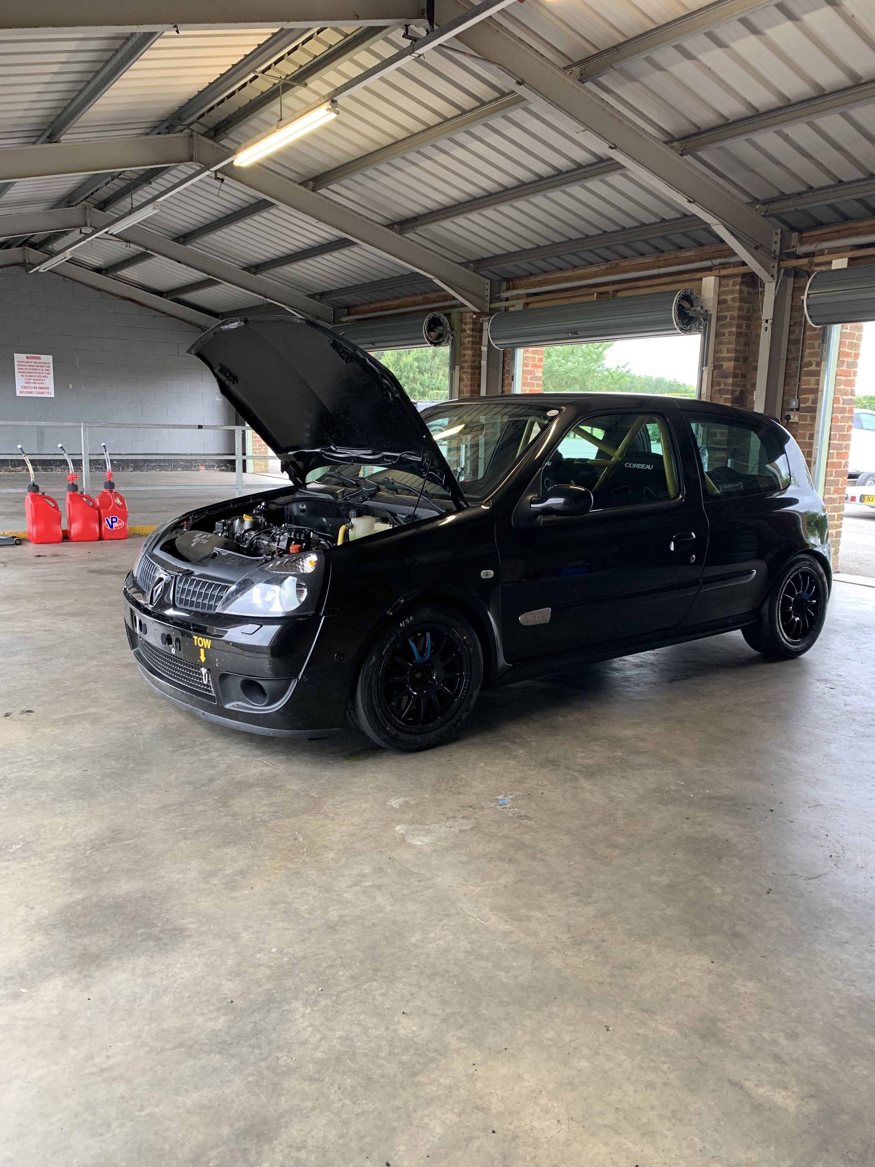

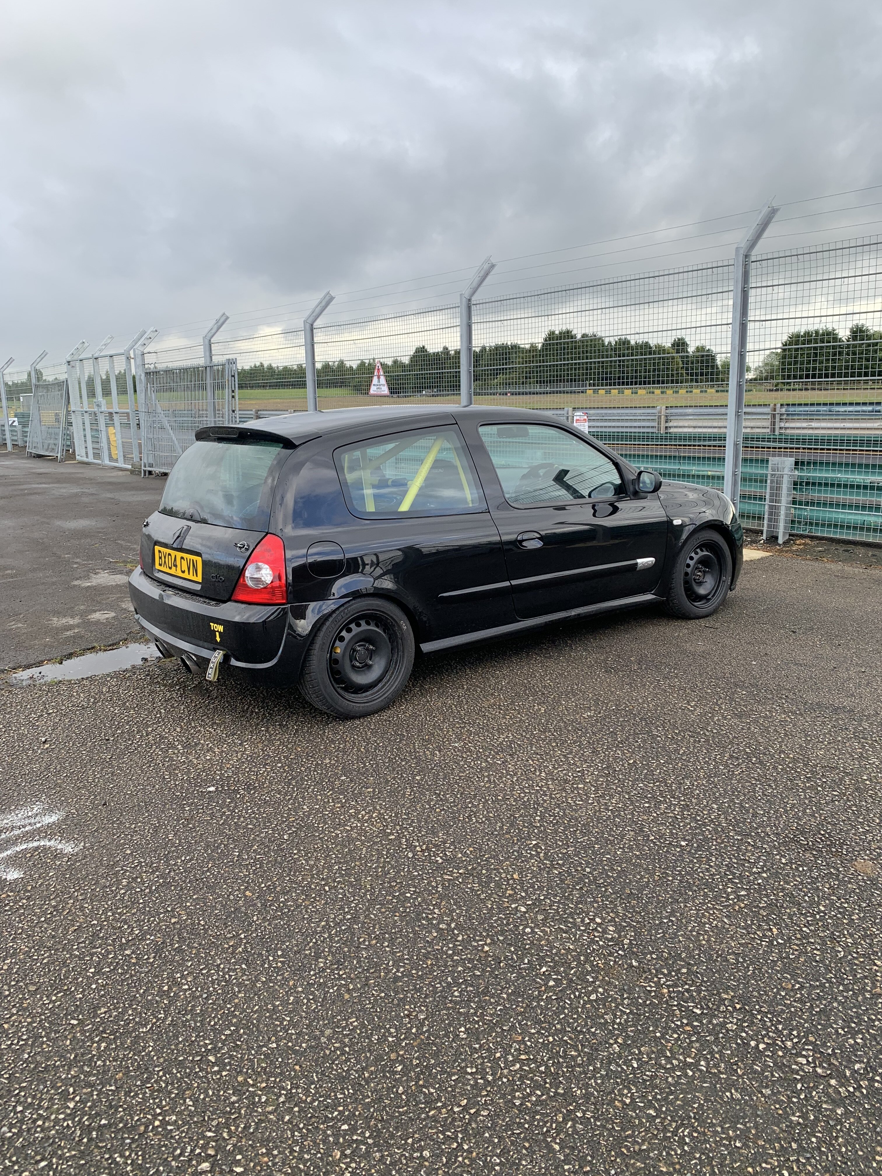

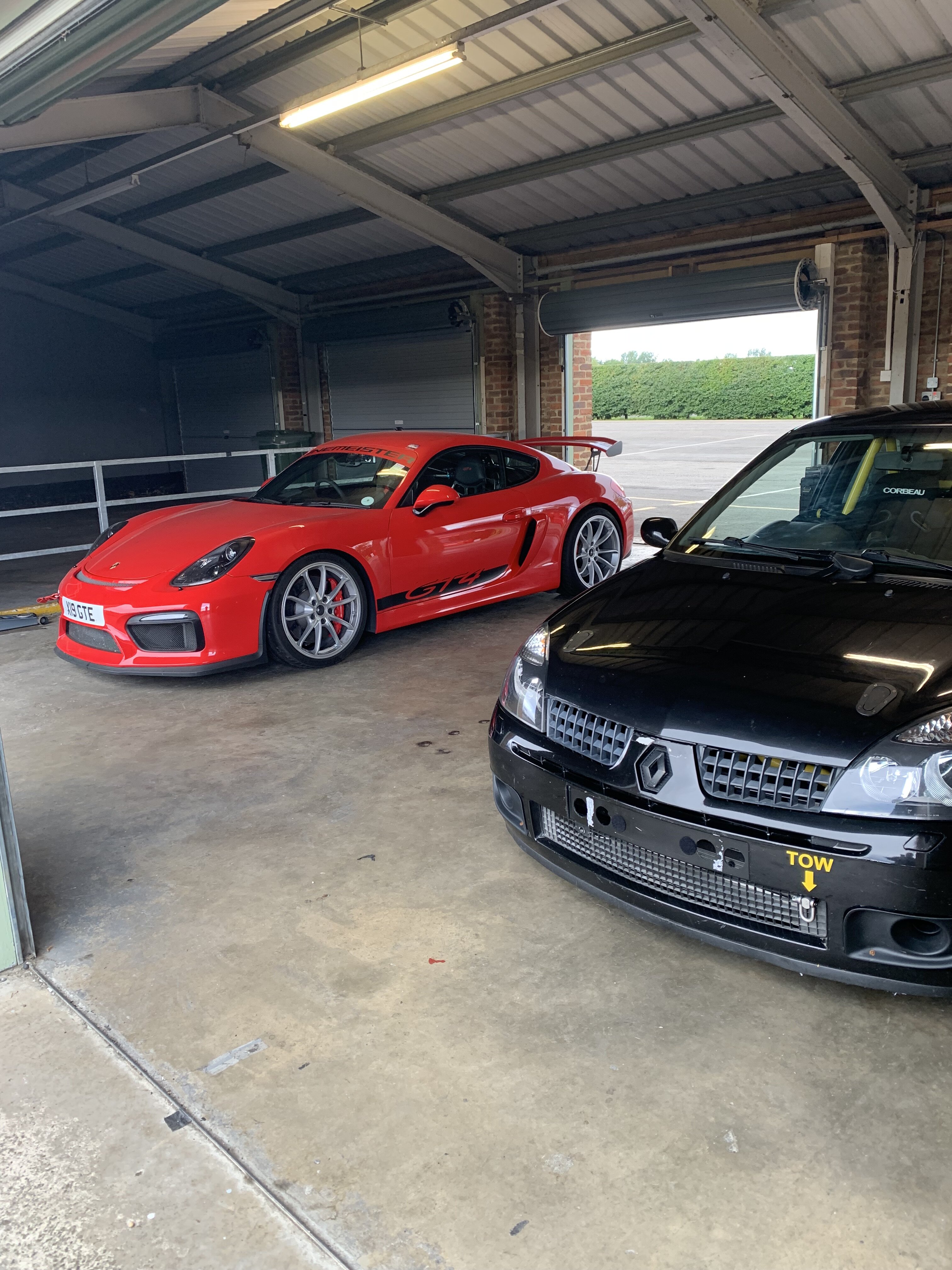

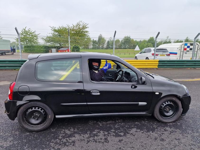

Great day at Croft yesterday where I caught up with @Brigsy in Bumblebee and @SharpyClio in his 182.

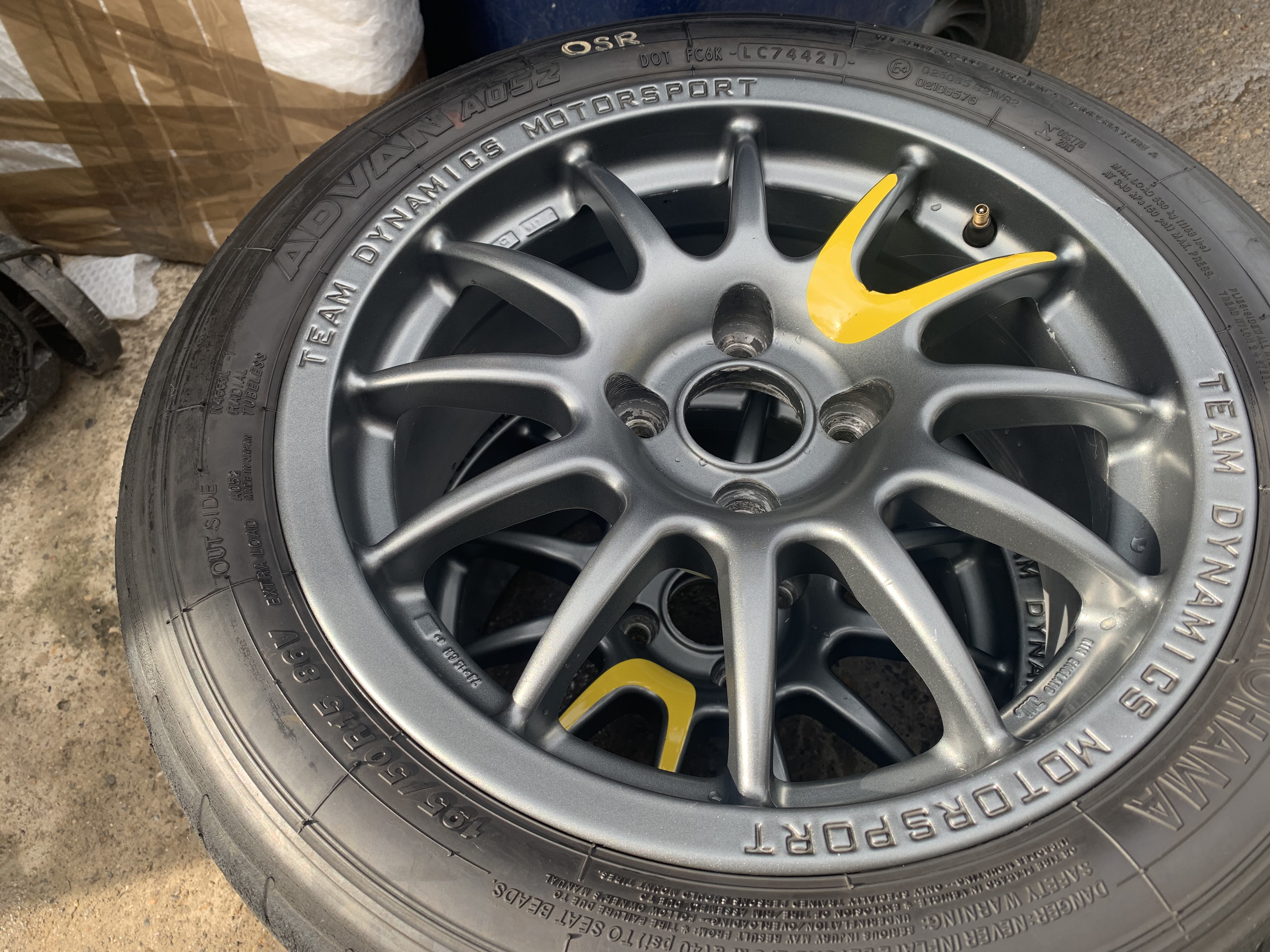

Did my obligatory sighting laps on my road-going steelies - I love those little wheels. Pictures courtesy of Brigsy.
A lovely Racing Blue 182 in front of me - anyone on here?

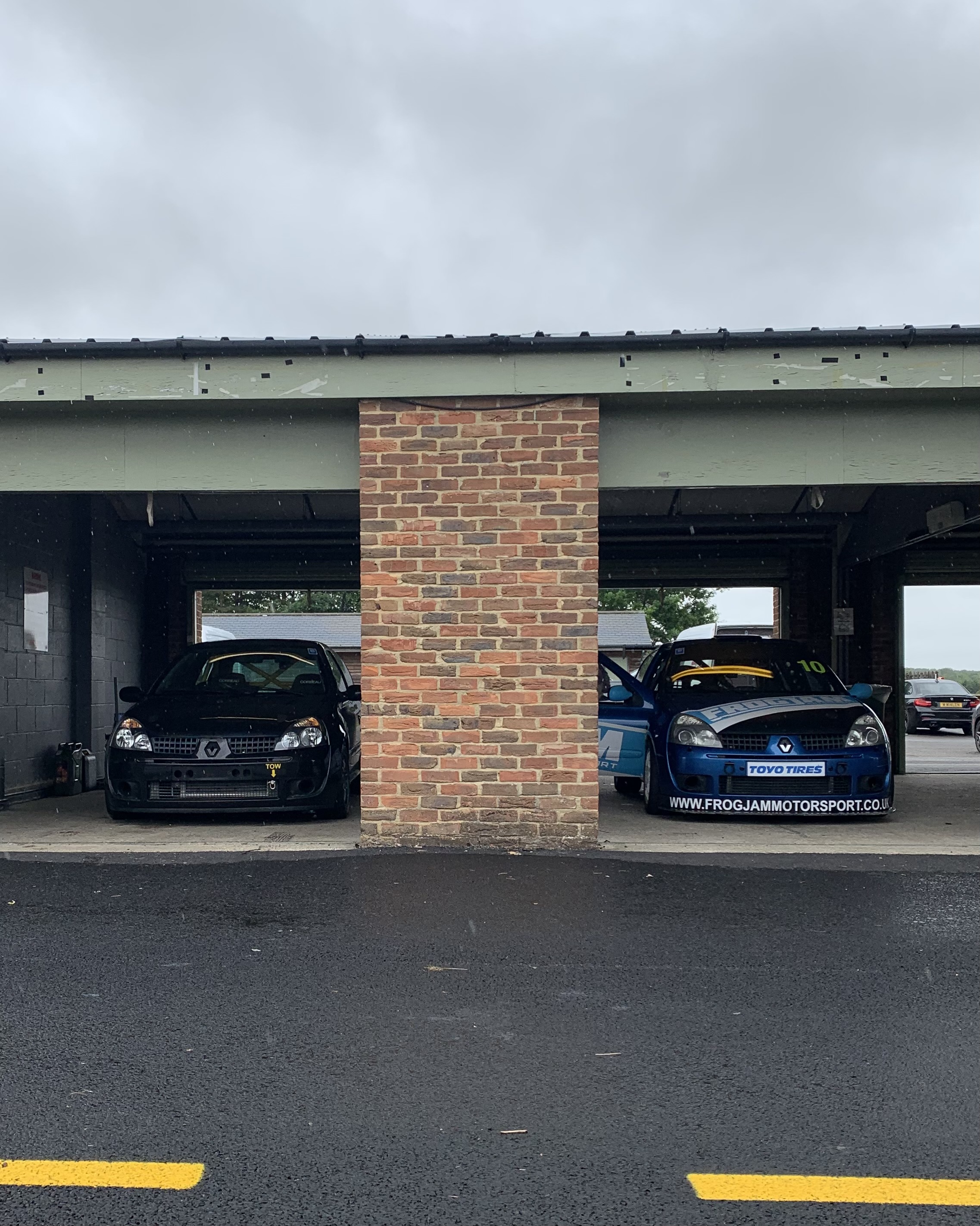

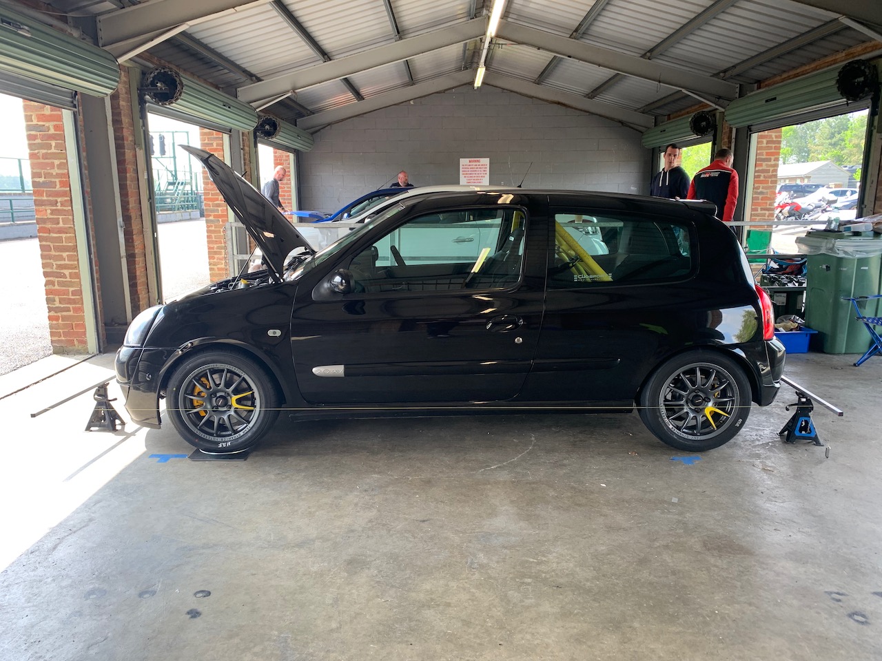

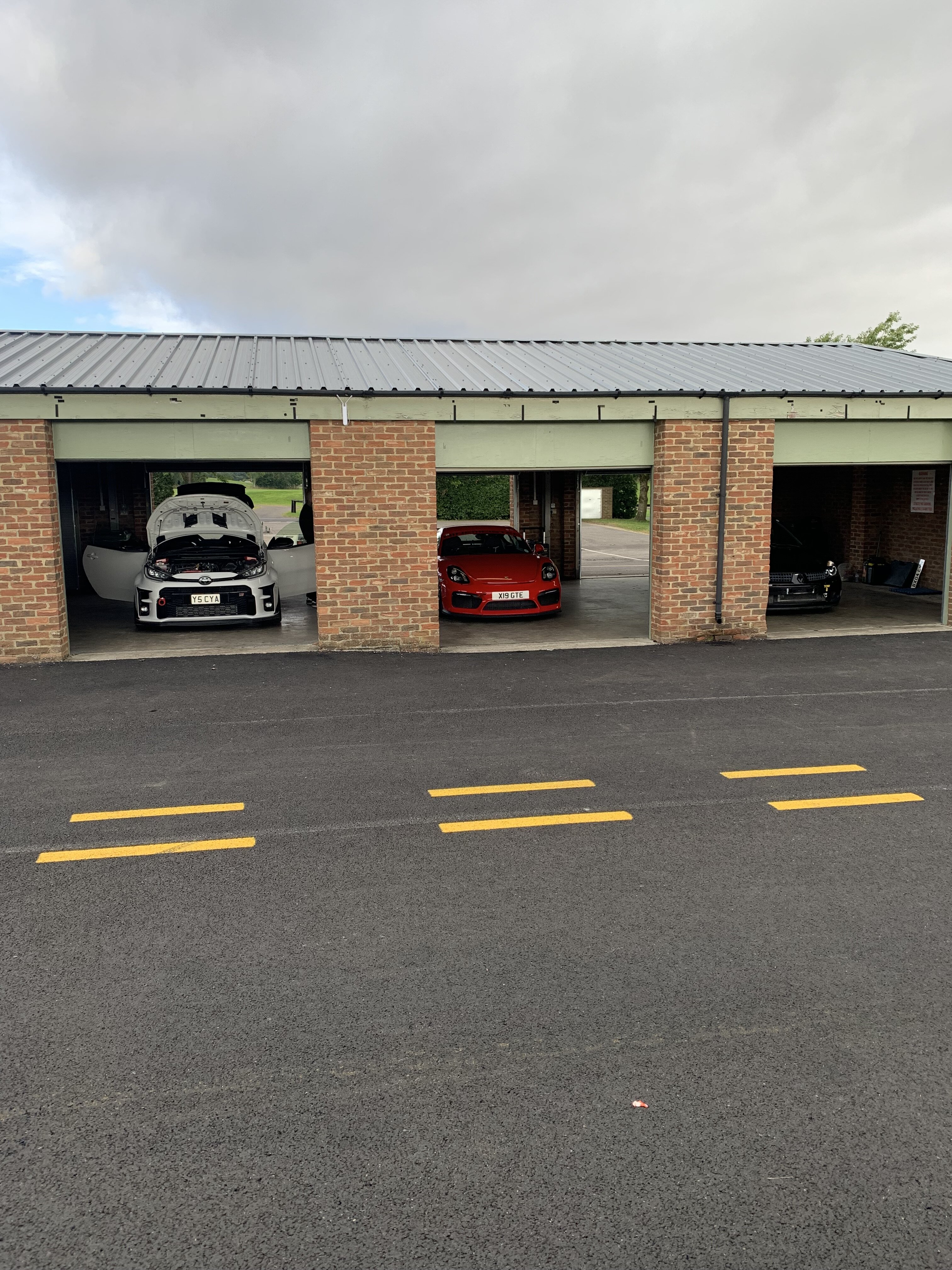

I managed to get a garage after my initial cancellation. It was much appreciated as the floor was decent and level.

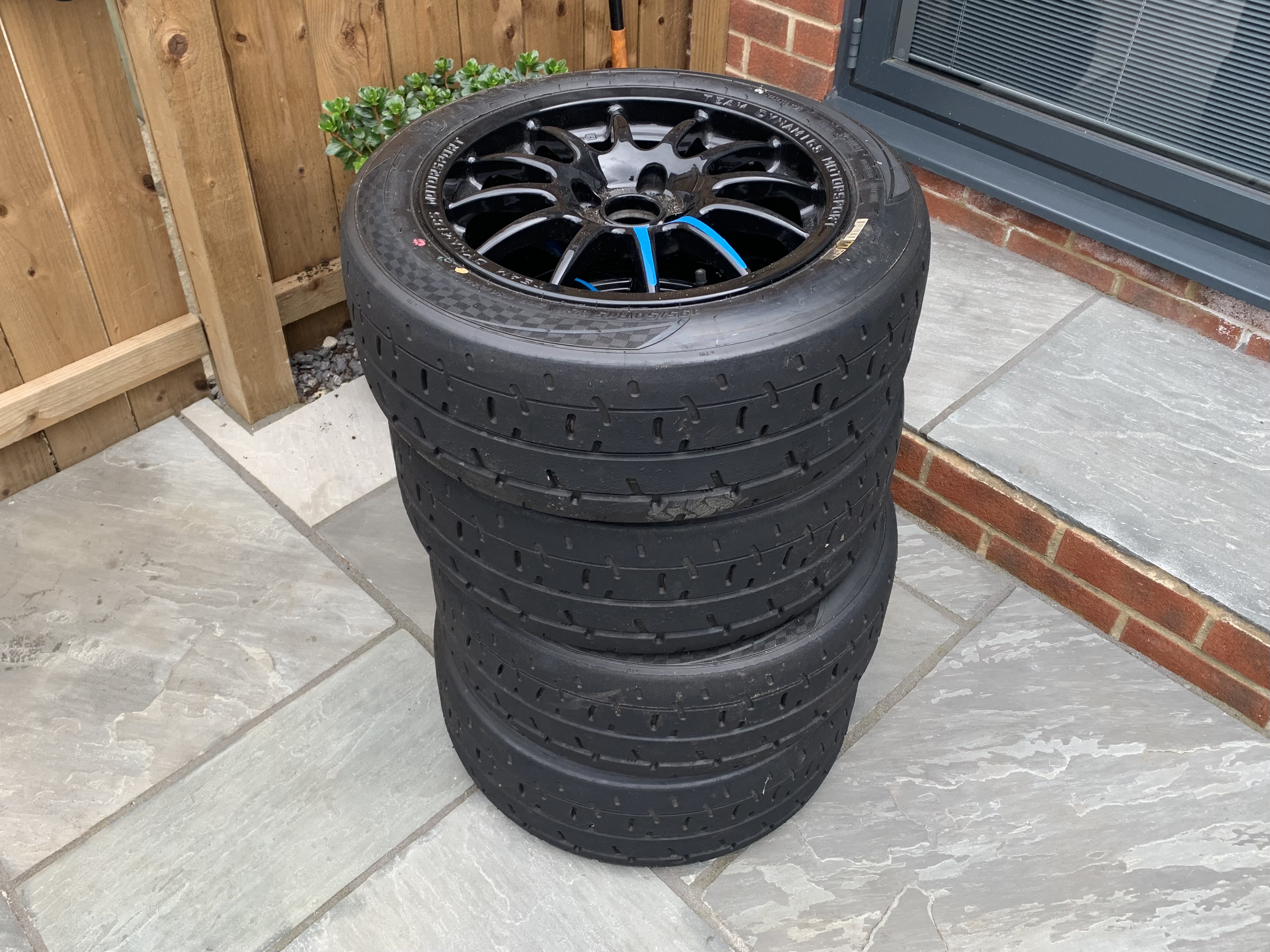

I set the ride height based on previous data from my last circuit car but chose to go a little higher than usual.
Dave then worked his magic on the camber and toe out. Old school string method. It's a black art to do it properly and fantastic to watch. At one point we had several people just standing there mesmerised by his DIY set-up.

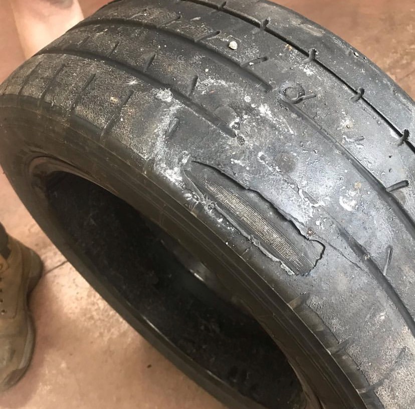

I also had some good data from Yokahama after I ripped through a front set of A052s in one track day. Simply because I used the same set-up for a set of A050s, which have a reinforced carcass.
An expensive day that turned out to be.
Camber was set at negative 2.5 degrees, and then Dave used some of his data from his son's 182 which races in TDT/Club Trophy, adding 4mm of toe out (2mm on each side).

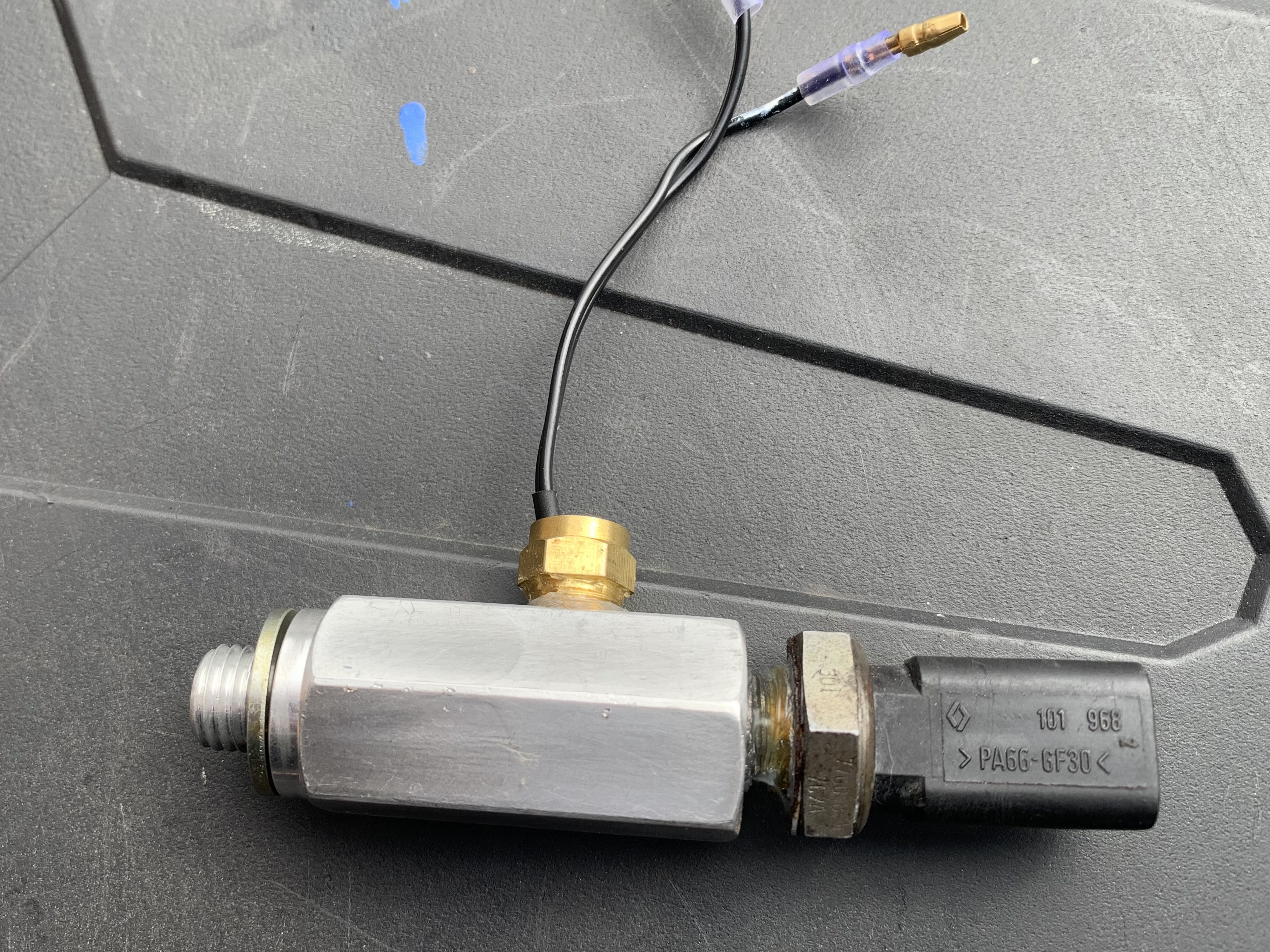

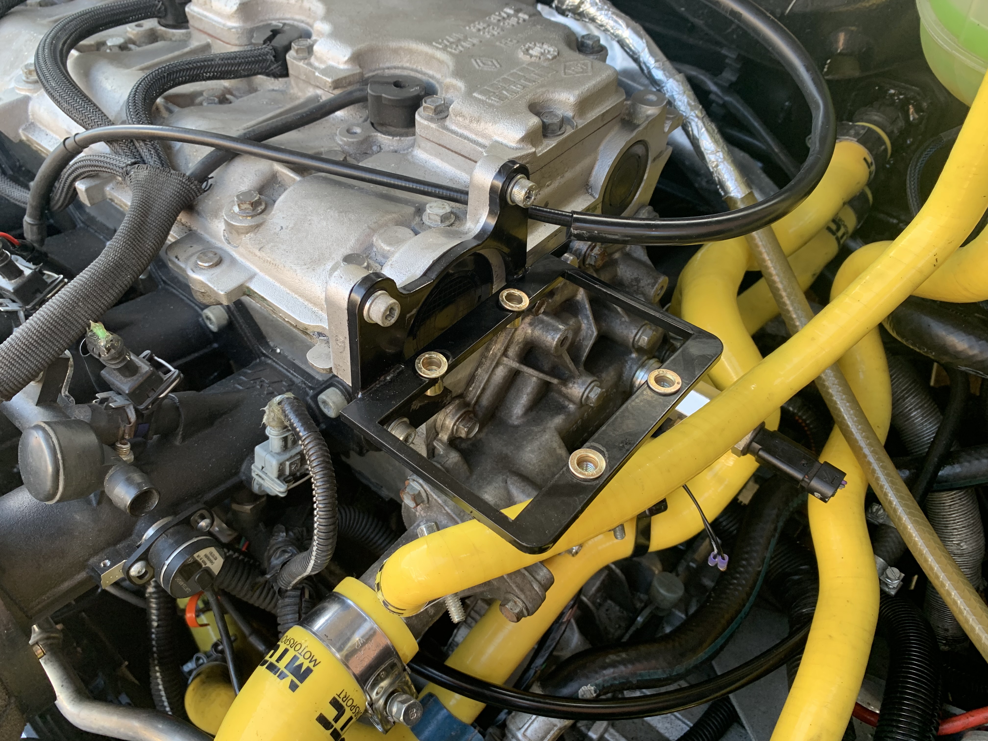

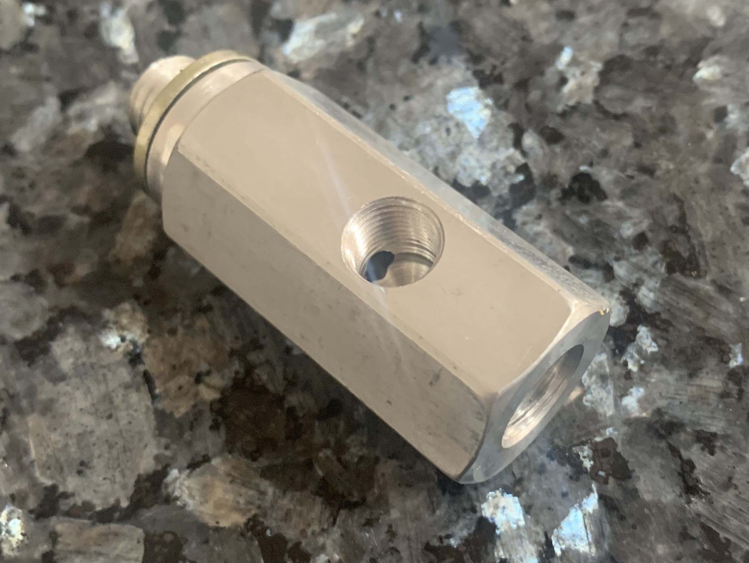

Time to sort the fans out before Croft next week.

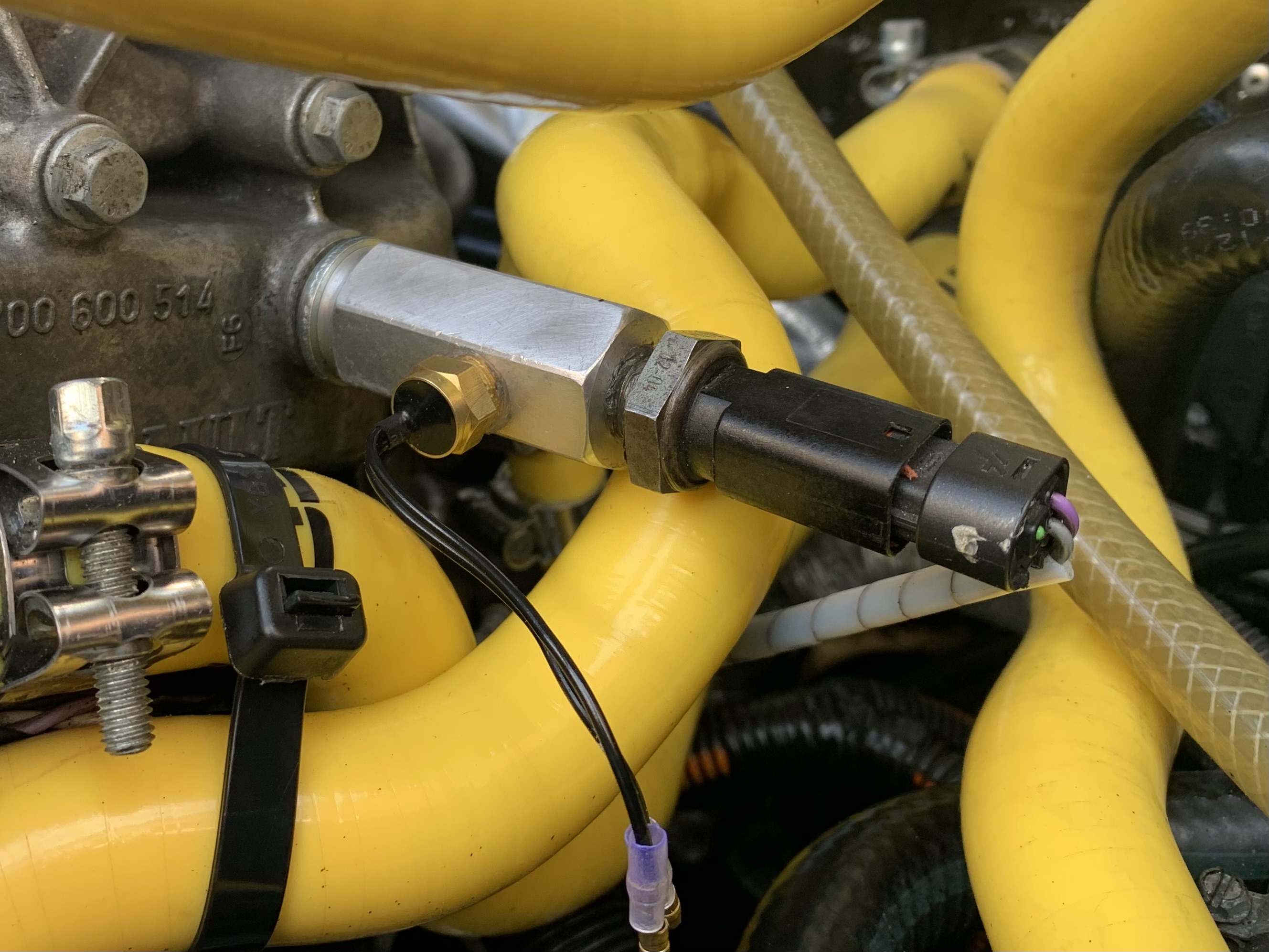

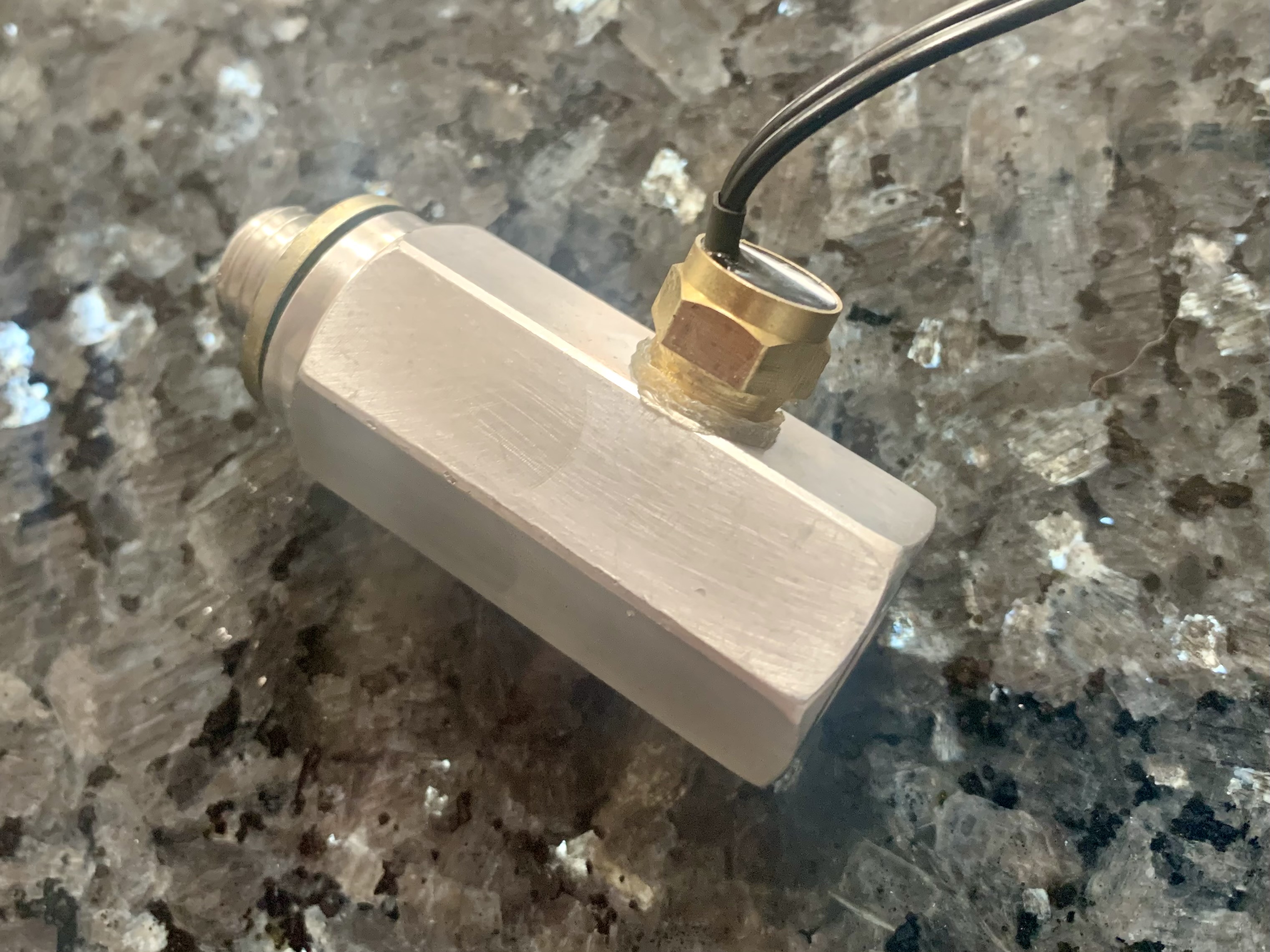

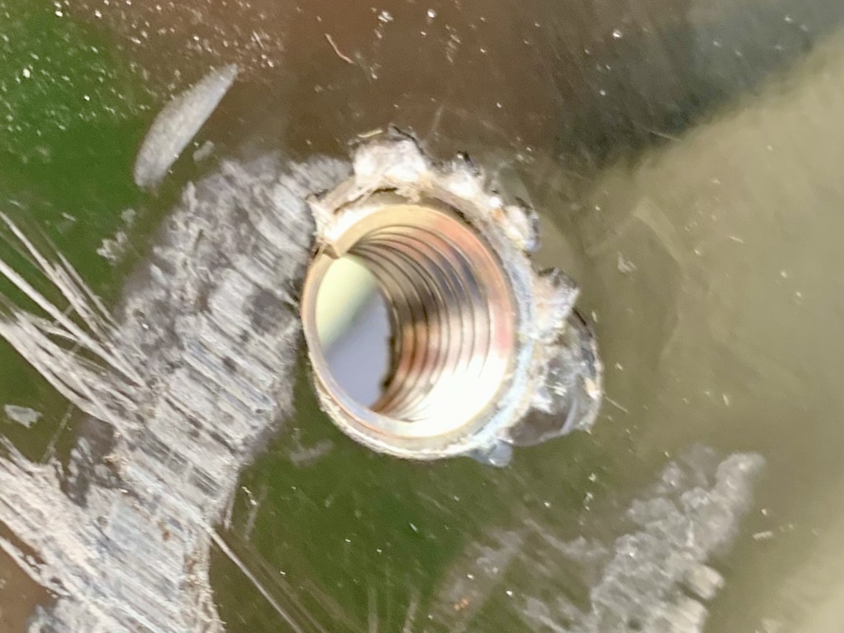

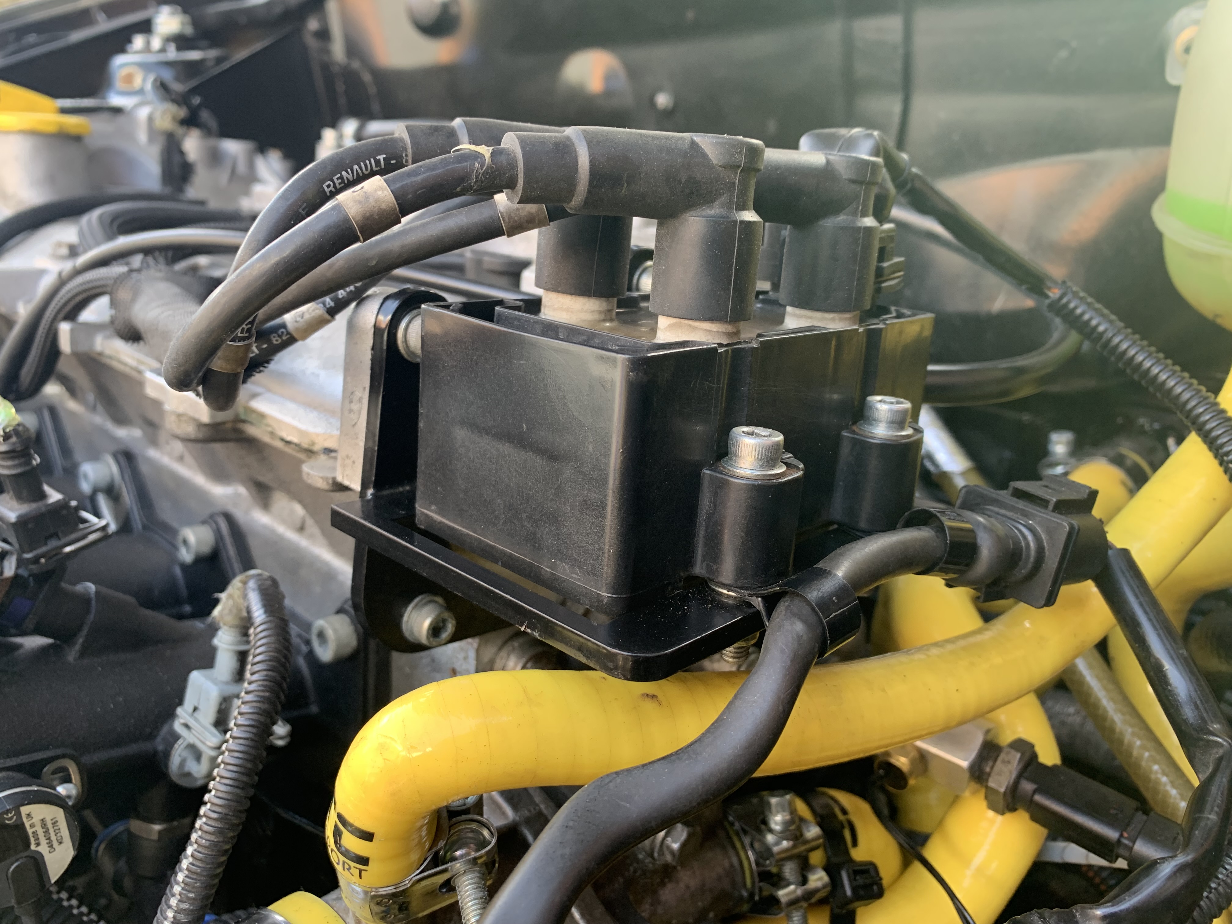

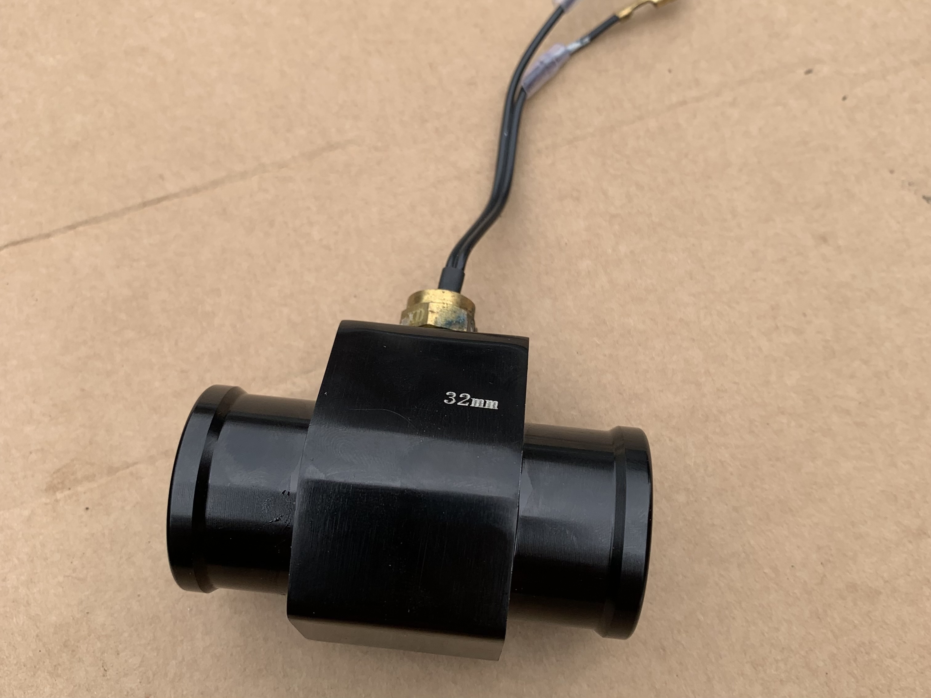

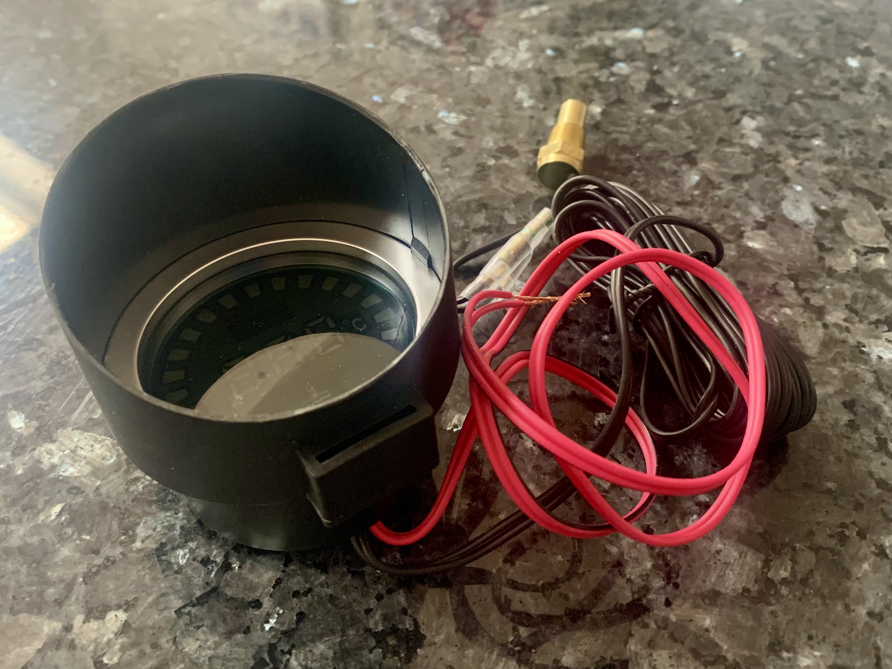

Picked up a cheap digital temperature gauge/sensor and an M12 and M10 mm 3-way T adapter from Car Builder.
I wanted to retain the factory temperature sensor and monitor temperatures without drilling additional holes in the pipework for the aftermarket sensor.
I had to do some small modifications to make it all work, but I won’t bore you with the detail.

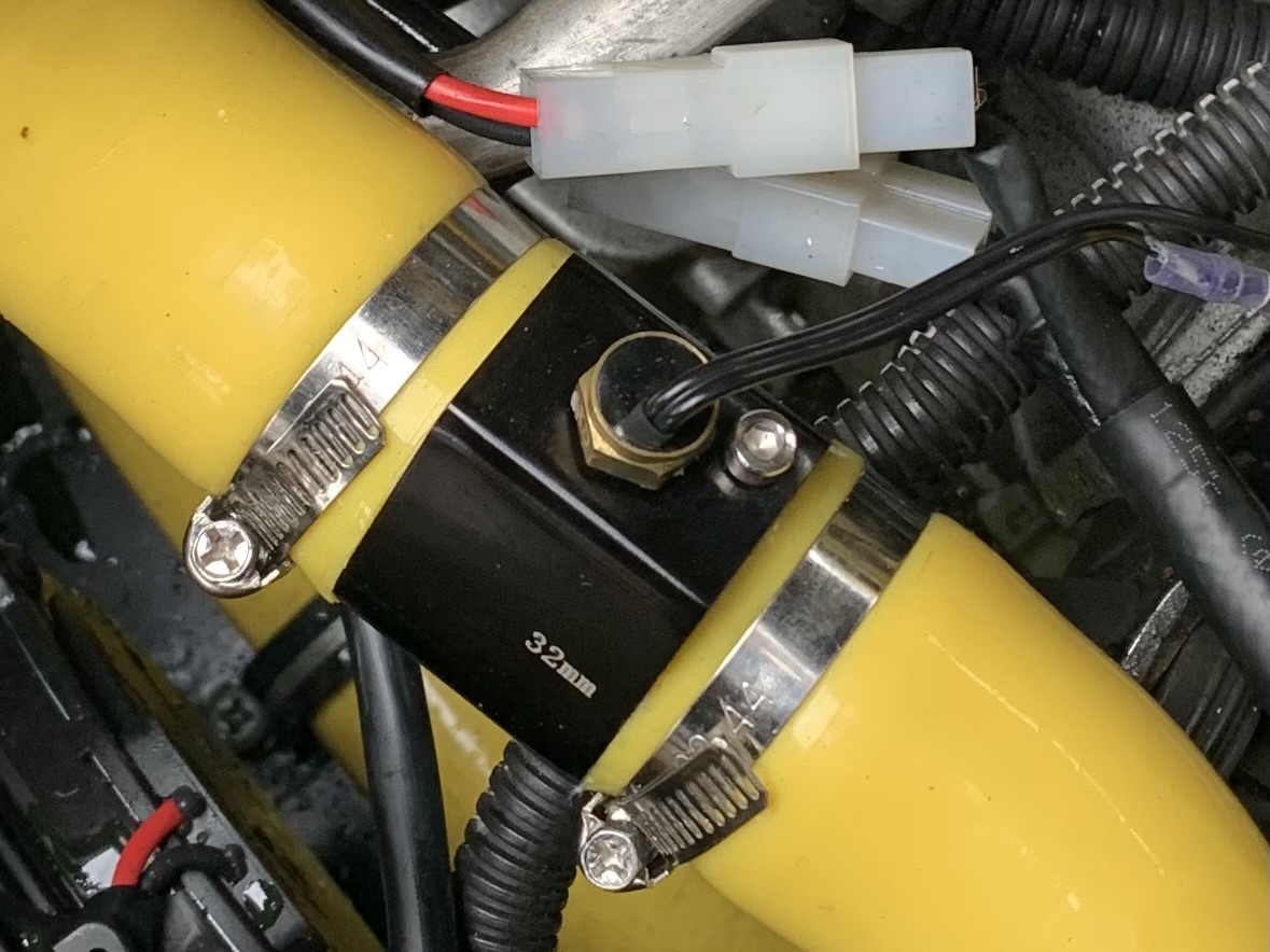

I removed the coil and bracket to make the job easier - what a pain getting at the small nuts and washers underneath - more on that later.
Then attached the factory sensor and screwed back into the thermostat housing.
The position of both sensors worked out great. Nothing snagging or getting in the way of pipe work.
Working on Track cars is all about speed and efficiency, so I added some M6 Rivnuts to the bracket. This way, I avoid the hassle of spending 20 minutes trying to hold small nuts in place with my sausage fingers.
Worked out pretty well.

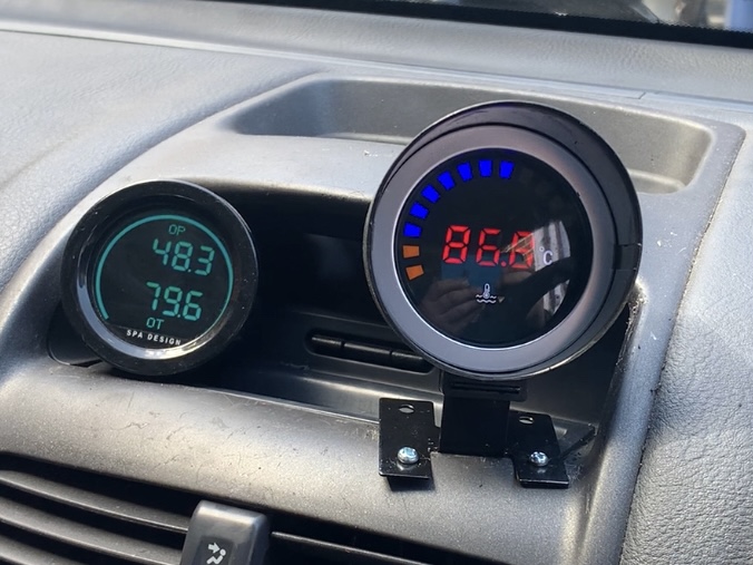

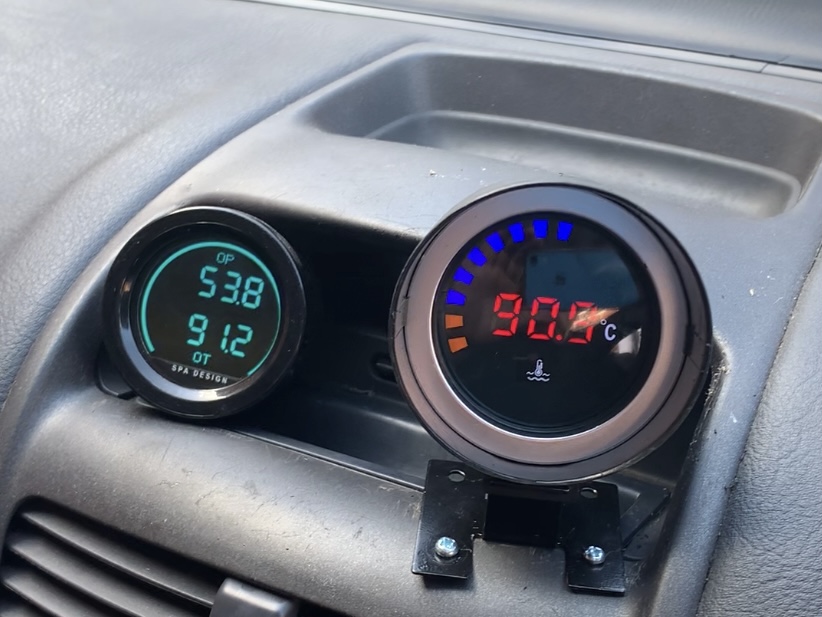

I screwed the gauge bracket next to the oil temp/pressure gauge and routed the wires down through the dash. The live wire connects to the cut-off switch, while the ground and sensor wires run down behind the center console and through the bulkhead.
Not the neatest of jobs, but I’m going back to a dashpod like my last car, then rewiring everything into that.
Fired her up and let the engine get up to temperature. Everything worked as it should and the fans kicked in around 85 degrees.
I then adjusted the thermostat until the fans kicked in at 90 degrees.
I did this because I noticed a delay, allowing the water temperatures to reach 96 degrees before the cooled water from the radiator circulated back to the sensor.
It took about 2 minutes for the fans to bring everything down to around 83 degrees which seemed impressive.
Obviously, this is all done on the driveway, so I'll fine-tune everything once I'm at the circuit. But at least now I have decent readings for water temperature, oil pressure, and oil temperature.

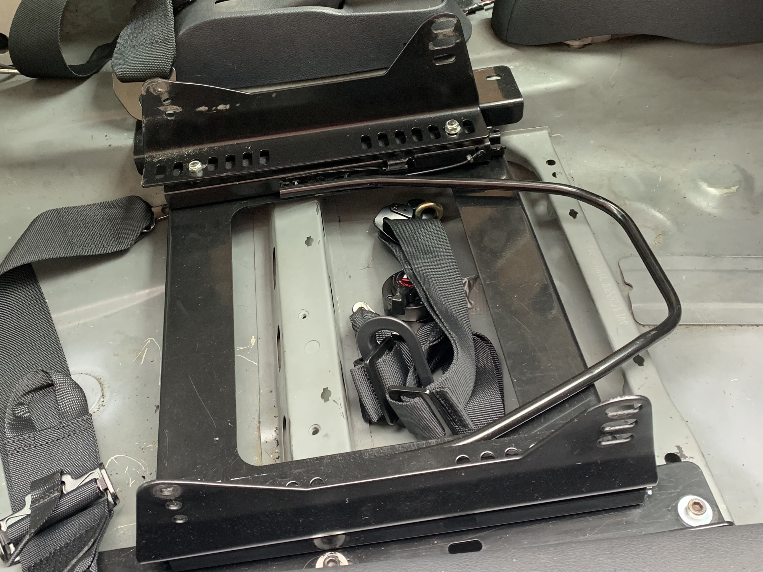

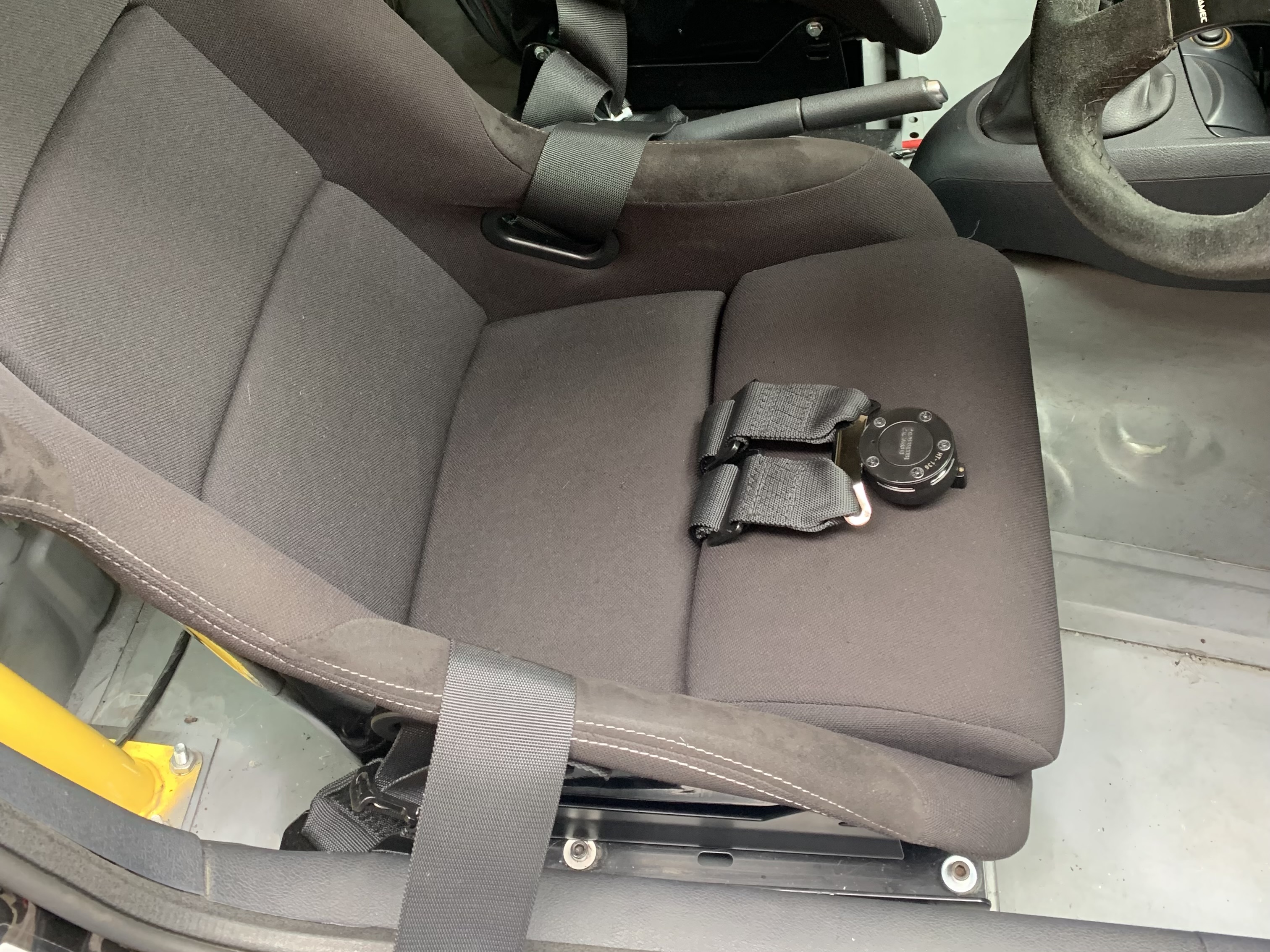

Last job of the day will be to fit my new 6-point harness, but that’s a job for this evening when it’s cooled down a bit.
Mr Underhill

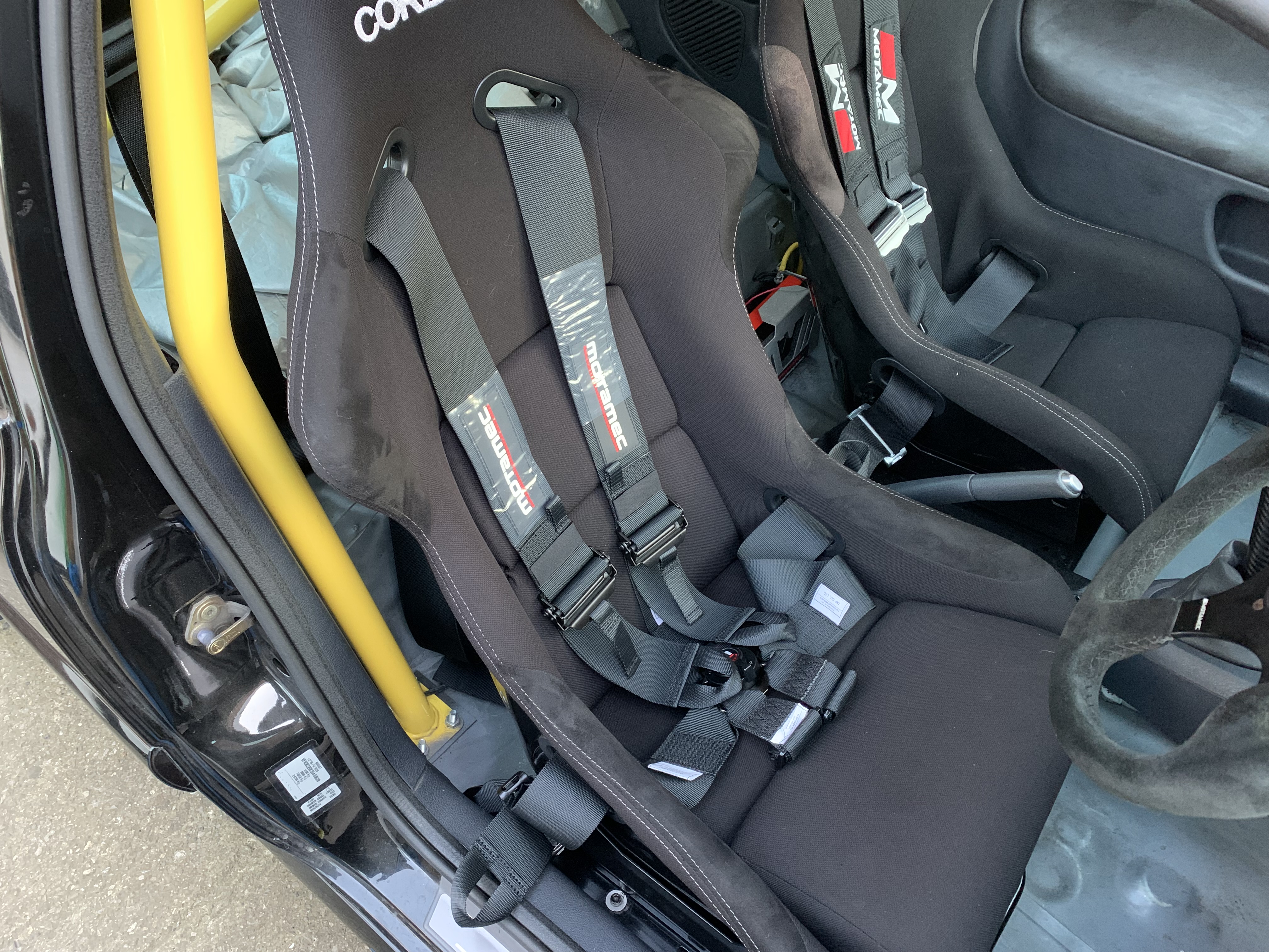

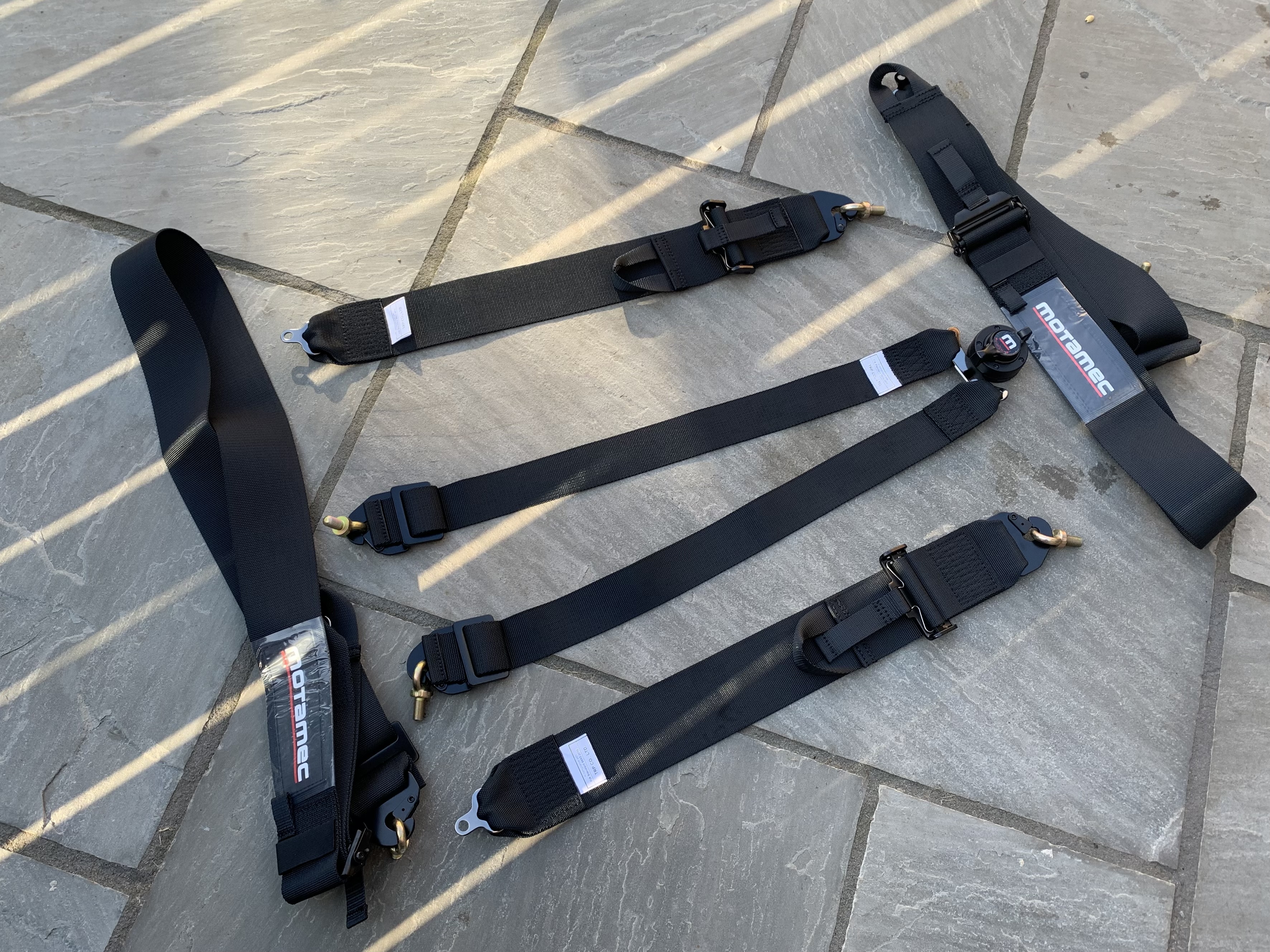

New belts pretty much in, just the straps to fix and adjust on the roll bar.
I’ve never used Motomec products before but the car came with a set of 4-point belts which are really comfortable. Sadly I can’t get away with them. I like to be properly strapped in.
They look really good quality too.
Nut and bolt check tomorrow, then I’m ready for some track time.

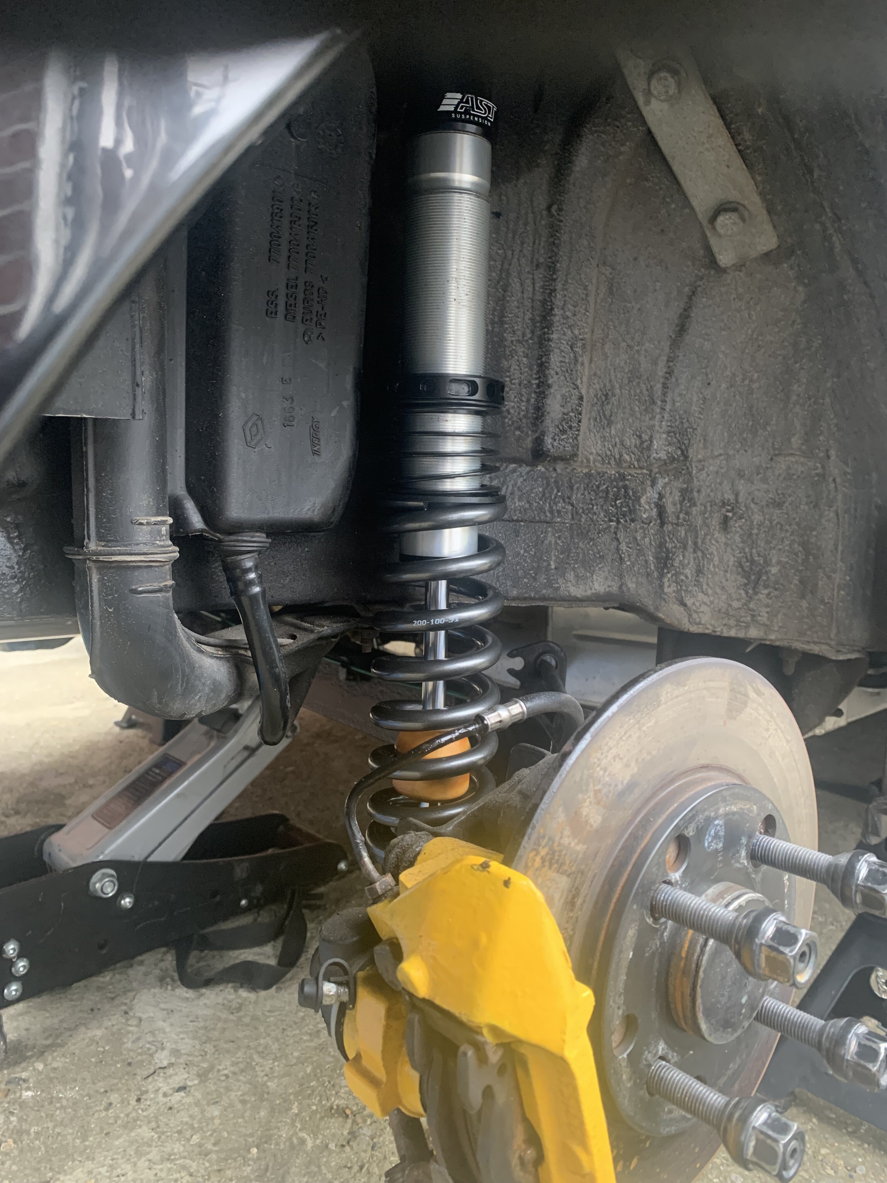

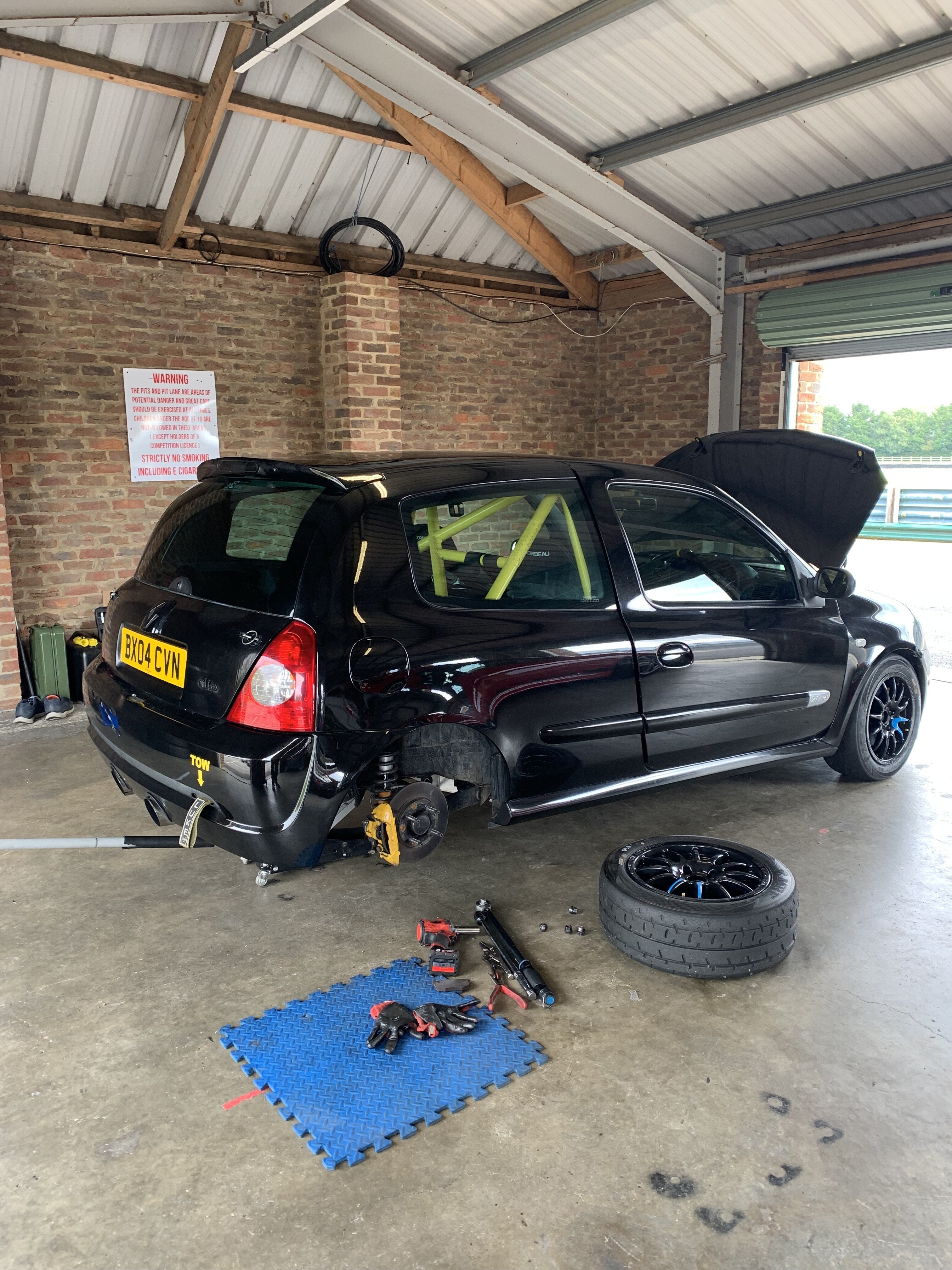

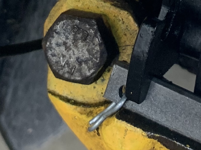

What a fight this car gave me today.

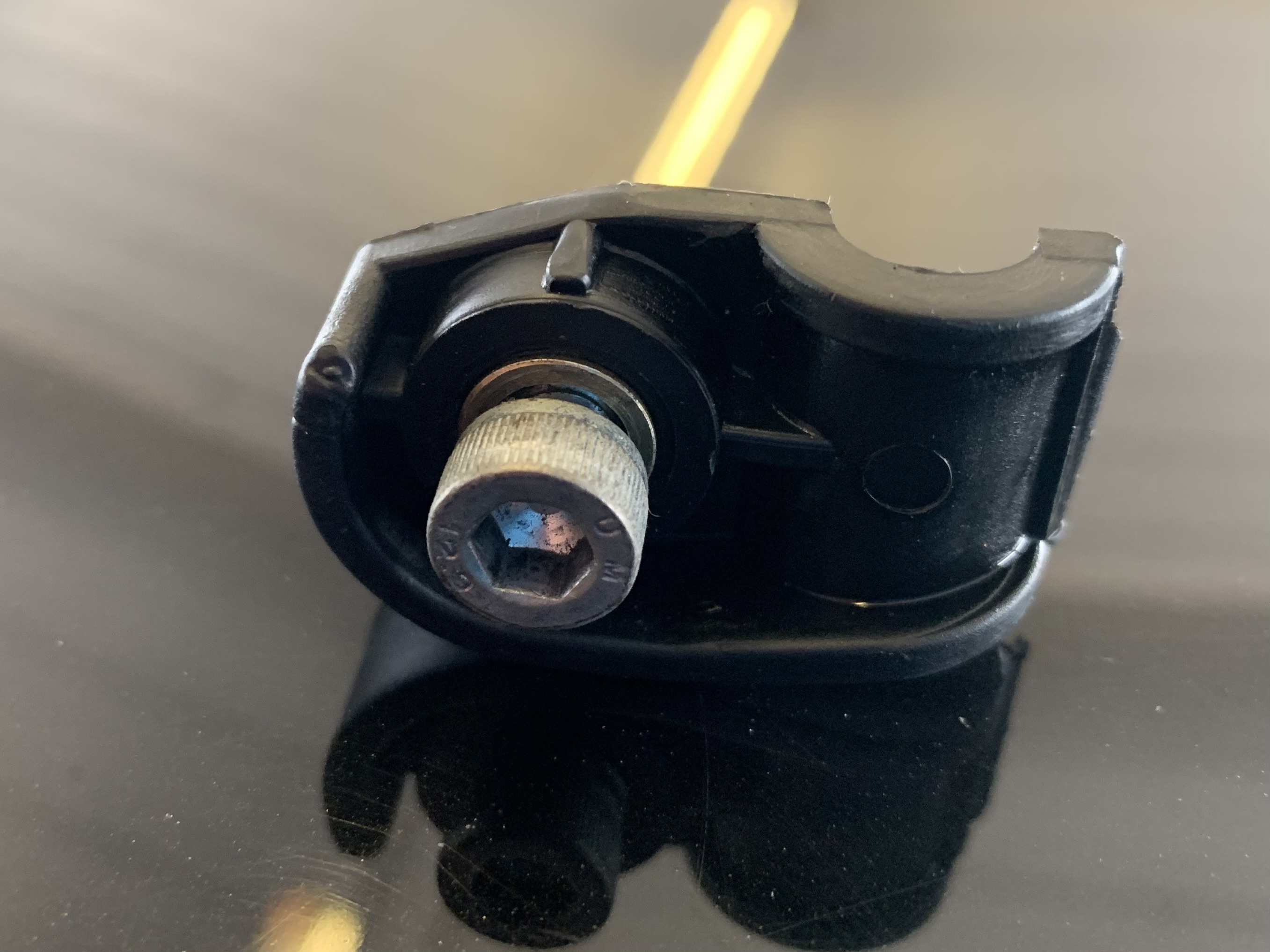

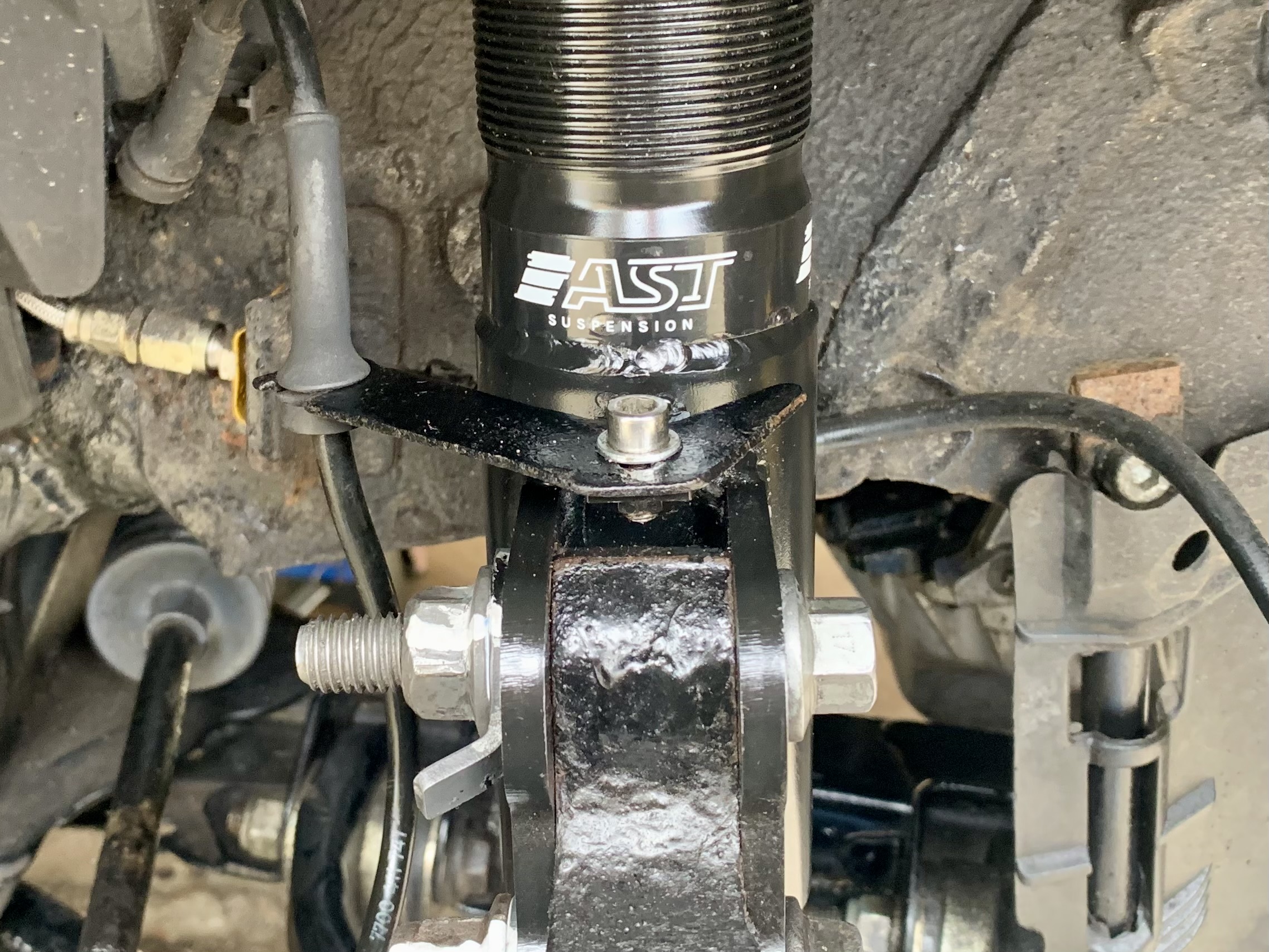

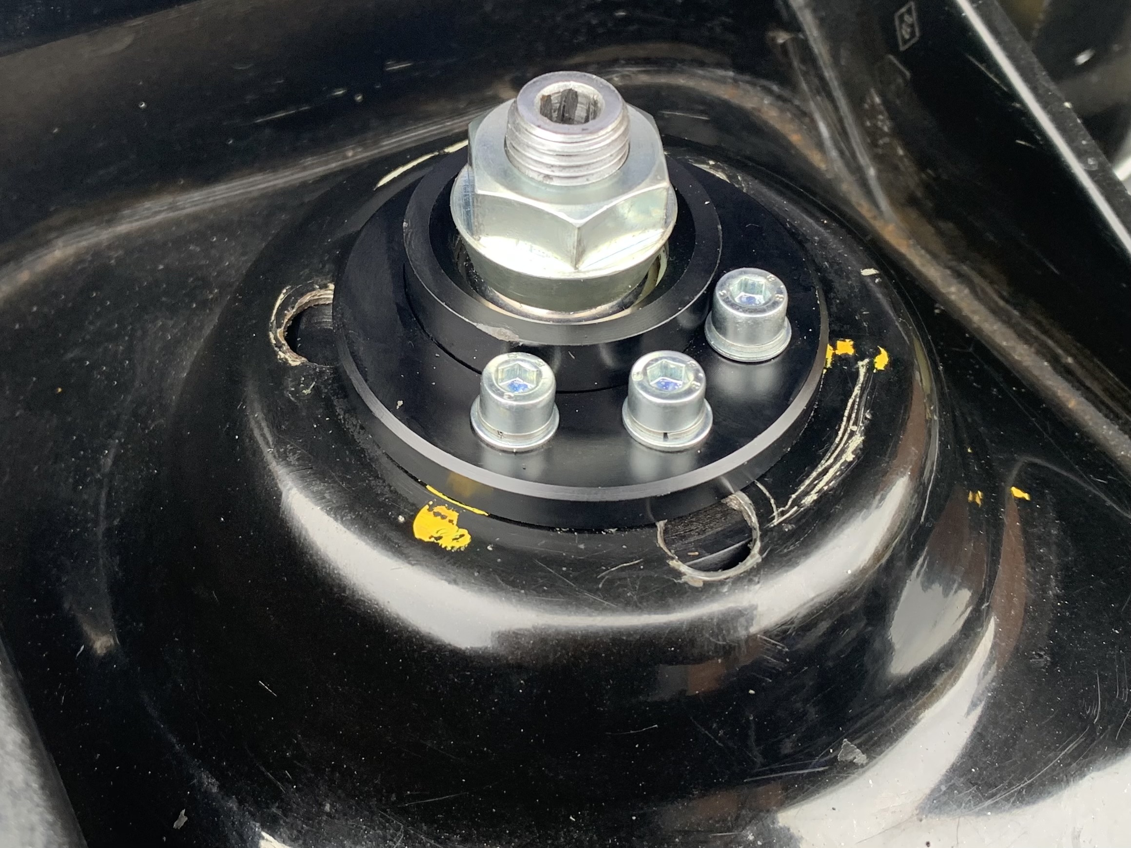

First up I was struggling to fit the bolts through the dampers and into the hubs.
I thought I’ll just measure the bolt distance and as suspected, it has 54mm hubs 🤔
It’s a CUP packed car, albeit an old one at that, so s**t happens I guess. Never mind, ASTs have a removable washer so they fit both. I planned to get some CUP hubs and stick some bearings in anyway, so that’s motivation for me.
Switched a couple of bolts for some genuine spares I had lying around. I’ll get a couple of new ones this week as they’re a bit pitted.
Top nuts tightened and suspension on.
Also got the geometry kit fitted on the drivers side.

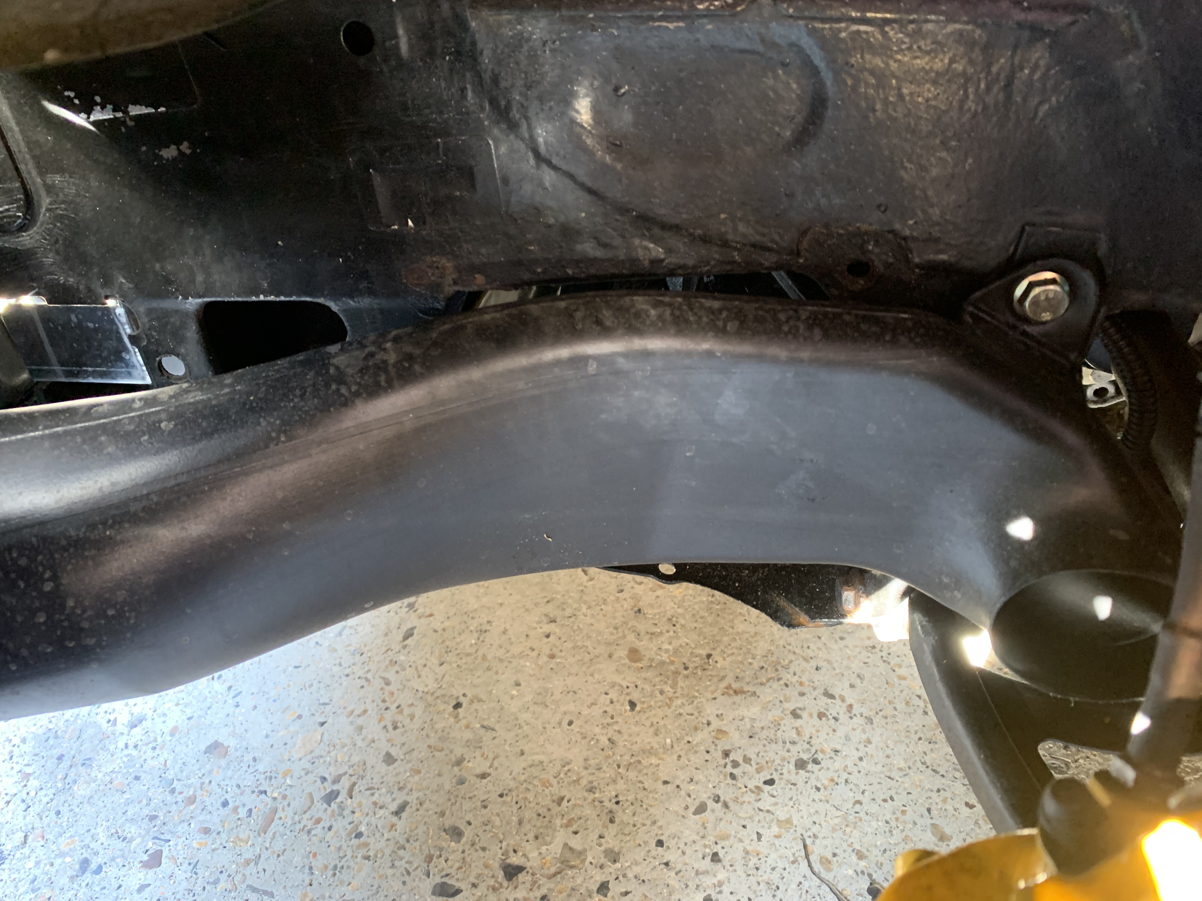

Overall things were going ok until I started the passenger side.

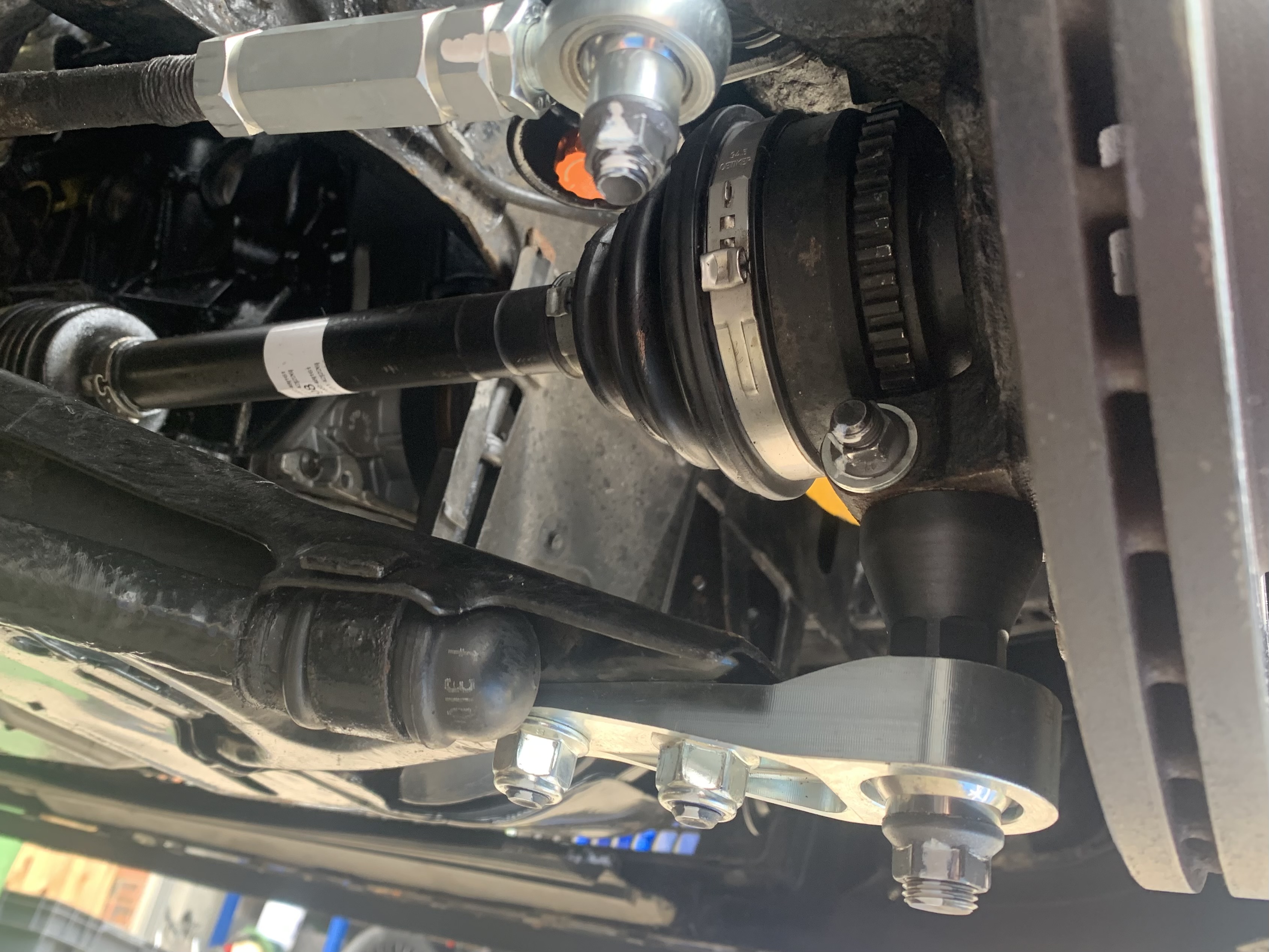

Before I went to bed last night, I thought I must remove the brake disc on the passenger side to make the whole thing lighter and avoid pulling on the driveshaft.

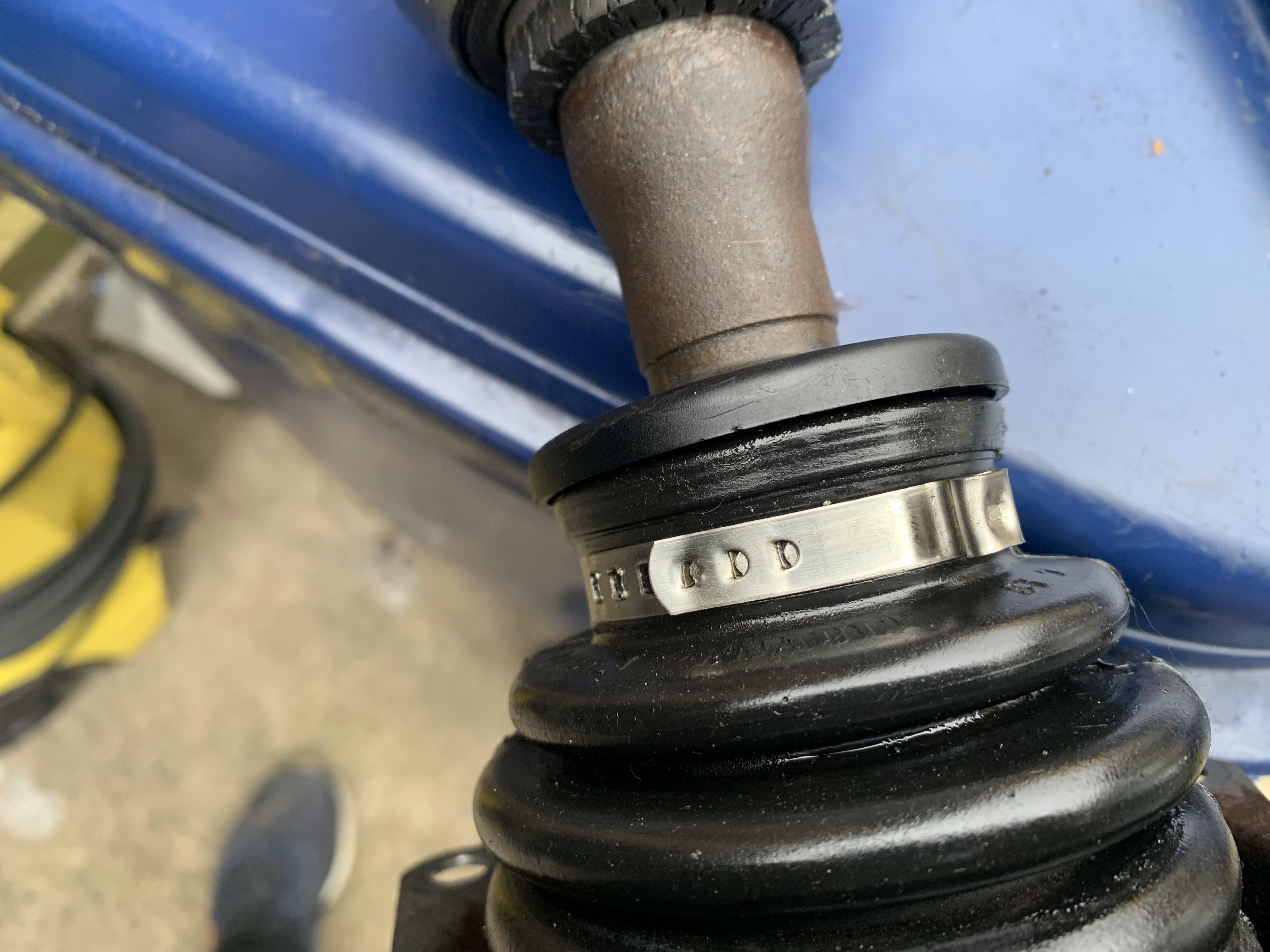

Of course like a knob, I forgot and as I dropped the two bolts out of the wishbones, the hub/disc lunged forward and gearbox oil began filling my driveway. F**K!
After dropping the rest of the oil I whipped the driveshaft off to see what I’d done.
I’d pulled the CV Boot away from the seal 🤦🏻‍♂️
Luckily I have every tool and spare known to man, so removed the old clip, pushed the boot back onto the seal and fit a new clip.
It’s back on the car but I haven’t put any oil in the box yet, so fingers crossed I’ve managed to fix it.
Threw the towel in after that. Tomorrow’s another day. Thank you for reading.

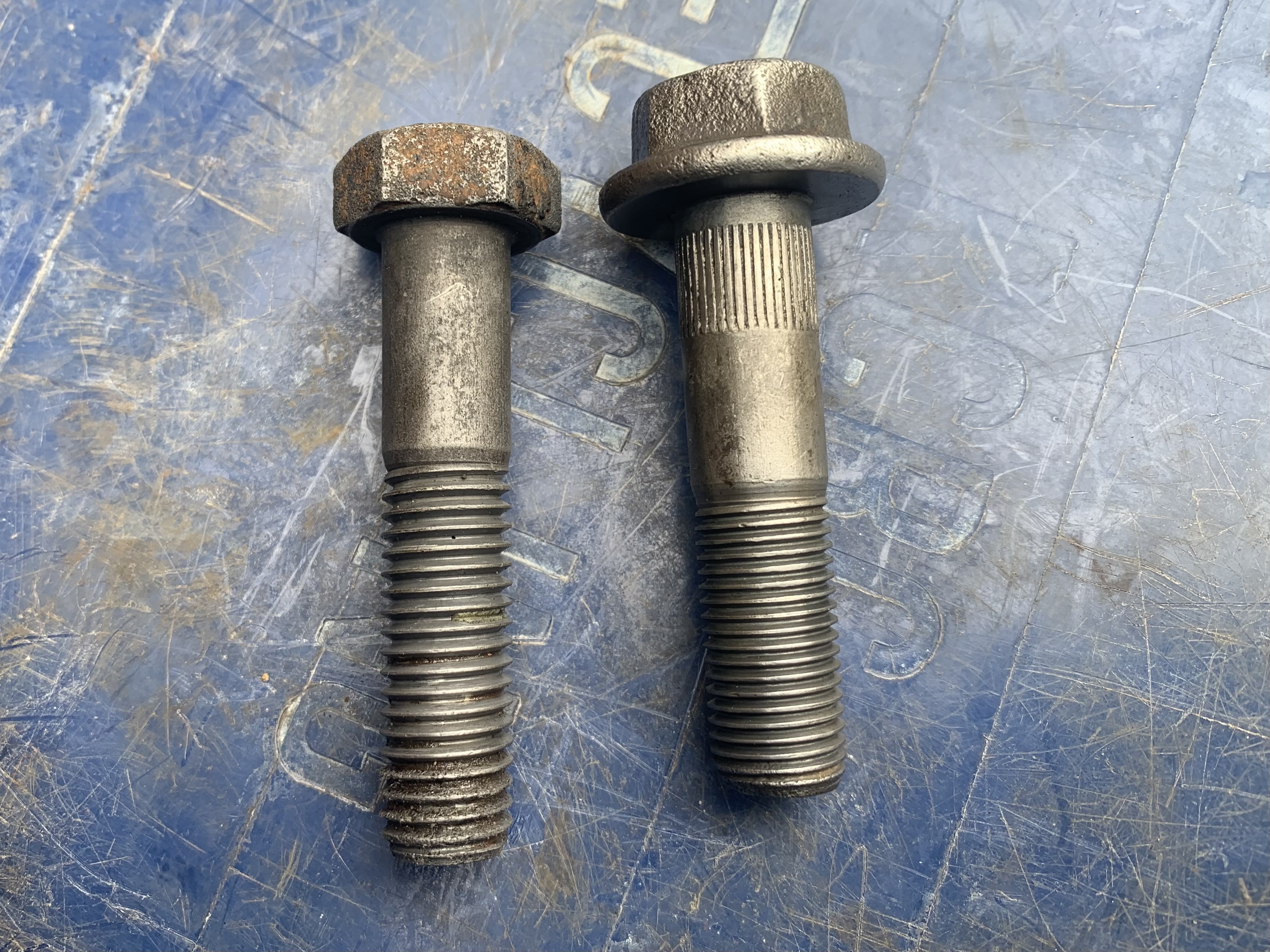

why did you installed camber bolts if you have elongated holes on the shocks?
Mr Underhill
@ripp - from my suspension post "Switched a couple of bolts for some genuine spares I had lying around. I’ll get a couple of new ones this week ..."
The camber bolts were initially fitted to the BC Racing Coilovers, which I've since replaced. A case of using what was available at the time.
AST supplied a couple of head cap bolts with the suspension, but I found them too tight and challenging to make small, precise adjustments for the desired camber. They seem like an afterthought in the design.

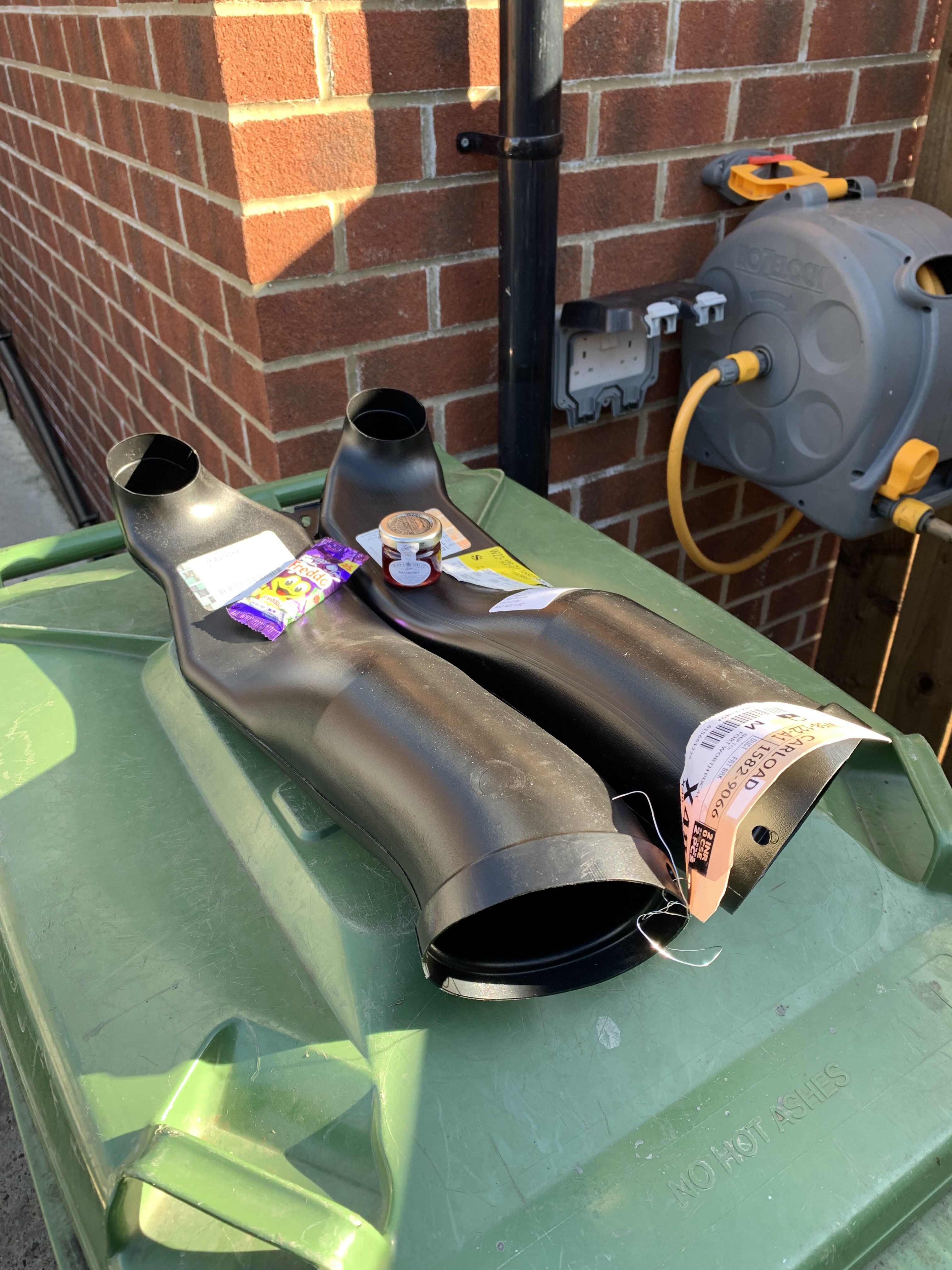

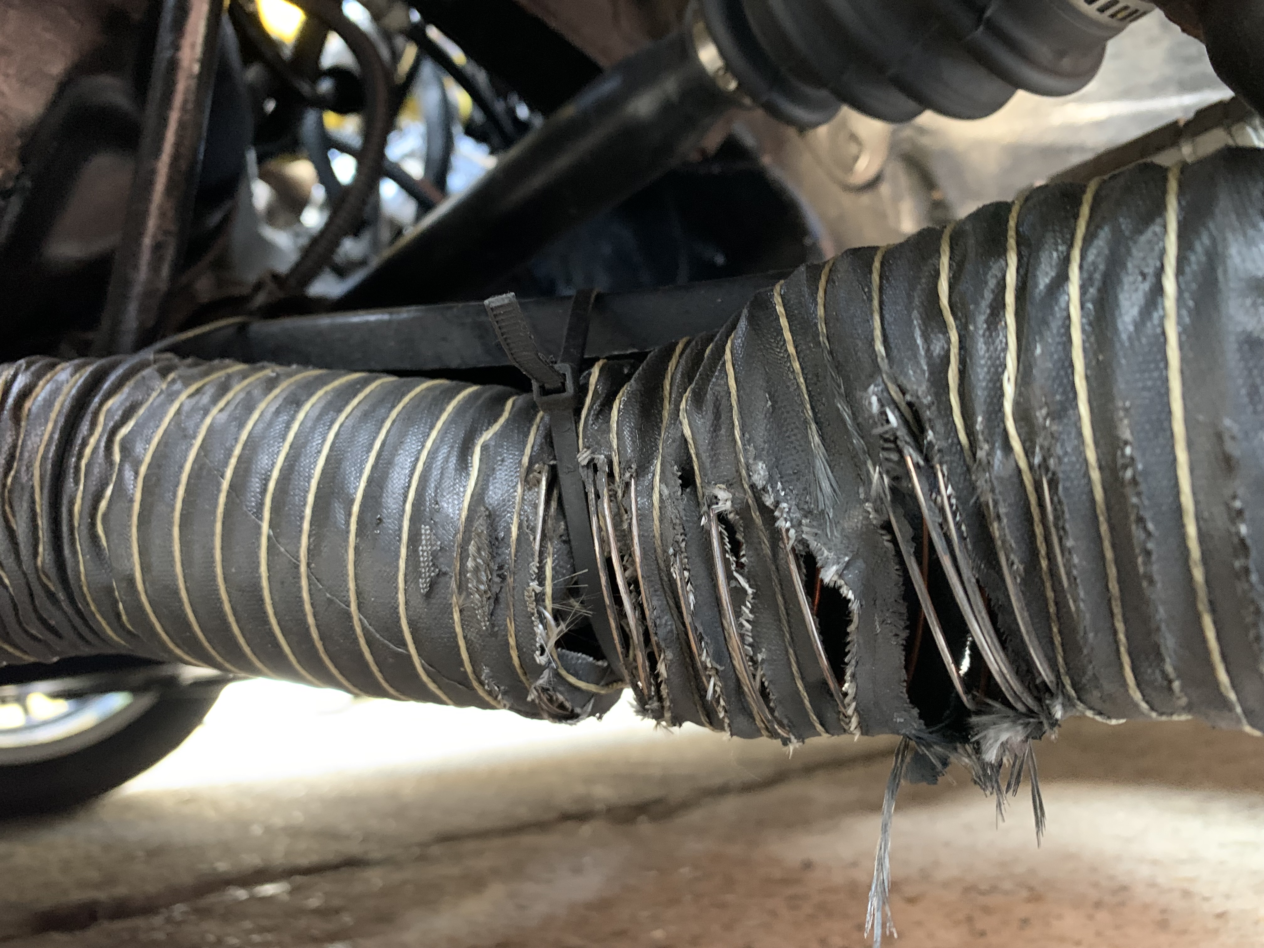

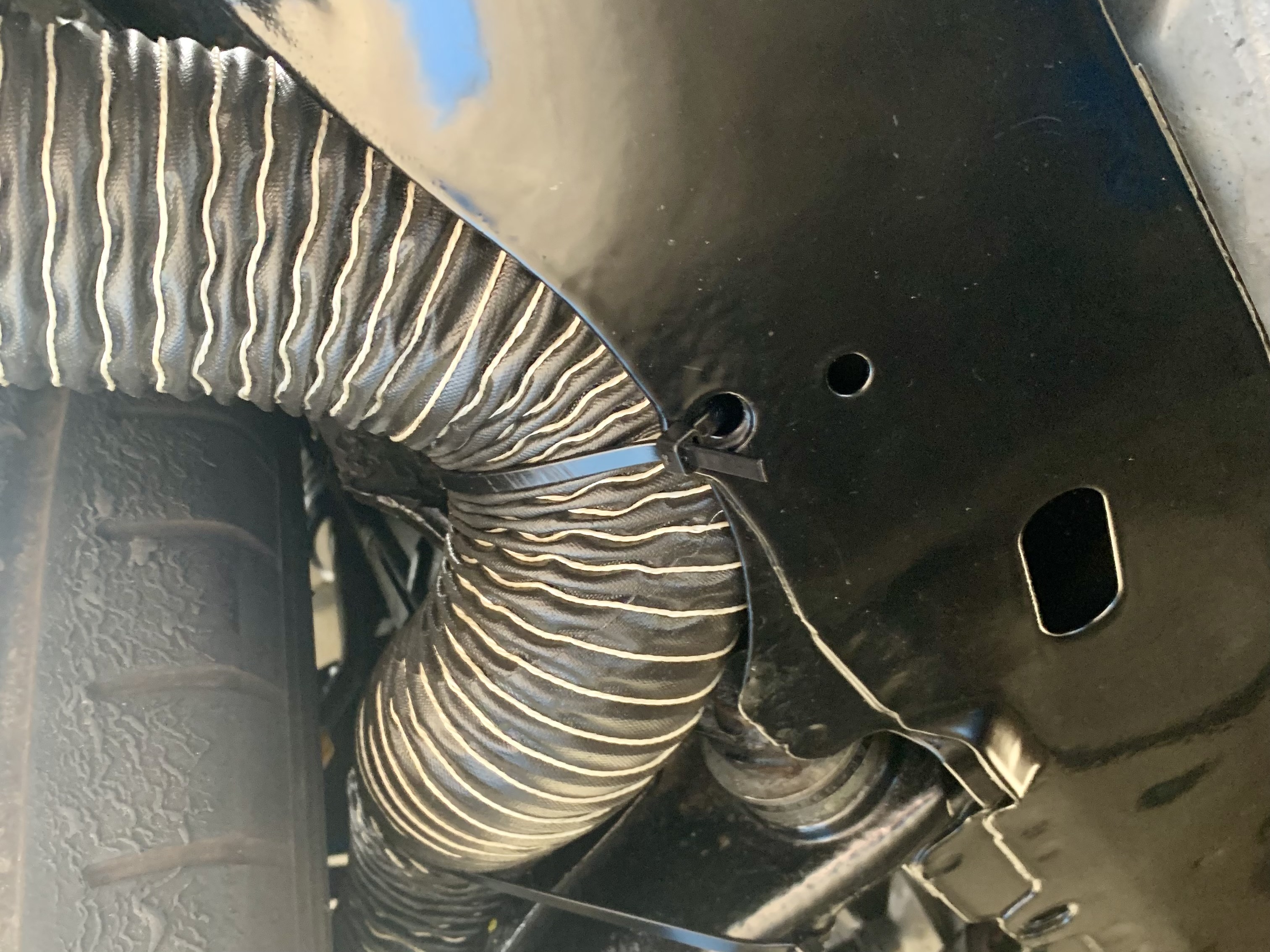

My @FrogJam Motorsport Corvette brake ducts arrived.
Lovely touch with the Froggo (Fred) and Jam (James) pot. Cheers fellas.
Came at the right time as I discovered my new ducting on the NS had ripped. I think I left too much length on the end and hadn’t tightened the cable tie enough. It was dangling down so i suspect it’s been rubbing against the wheel.
Doddle to fit - 1 bolt.
They fit over my bumper ducts perfectly without the need to shorten them, so the bumper will come off without disturbing the ducts.
All ready for Croft on Monday. Thank you for reading.

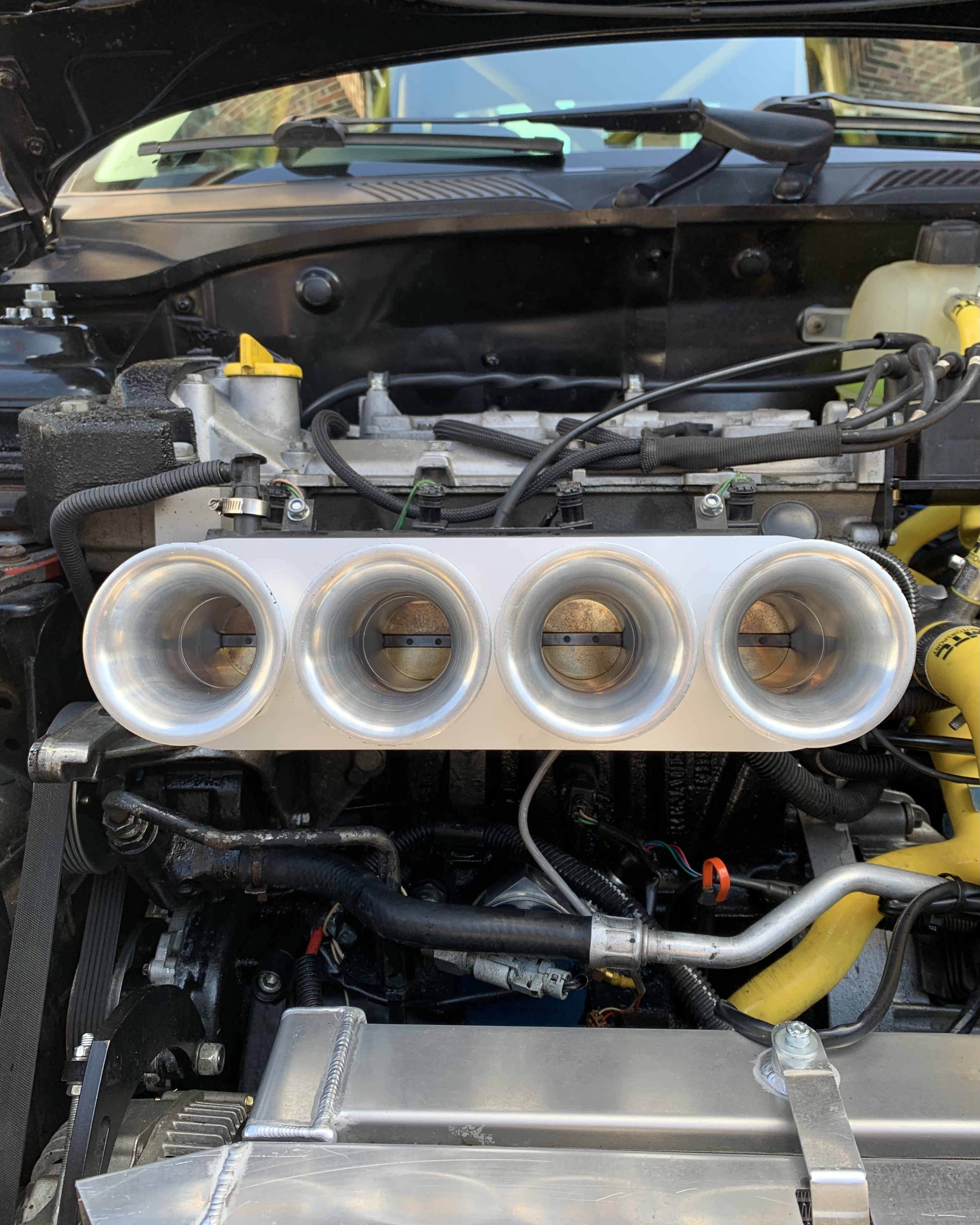

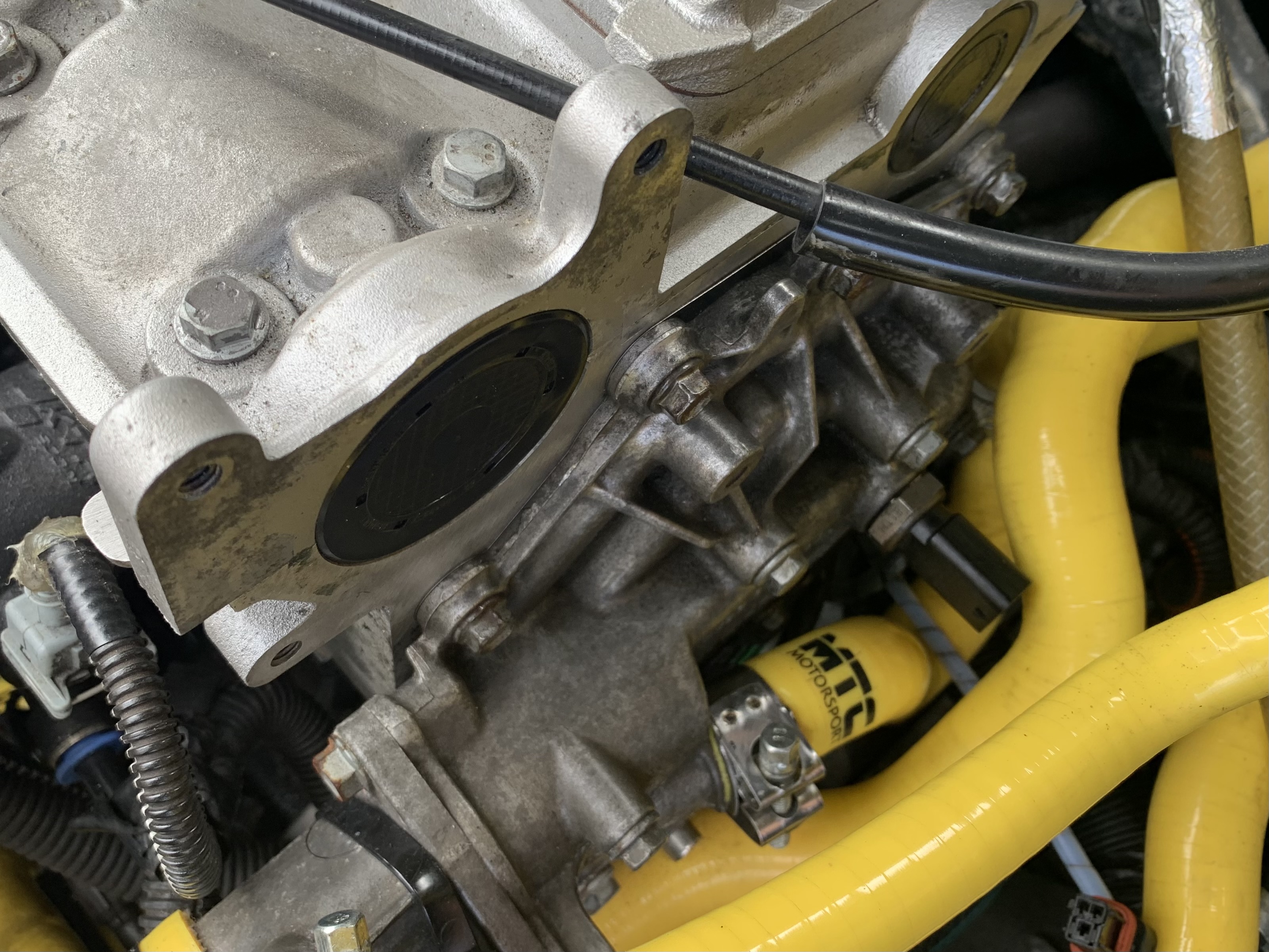

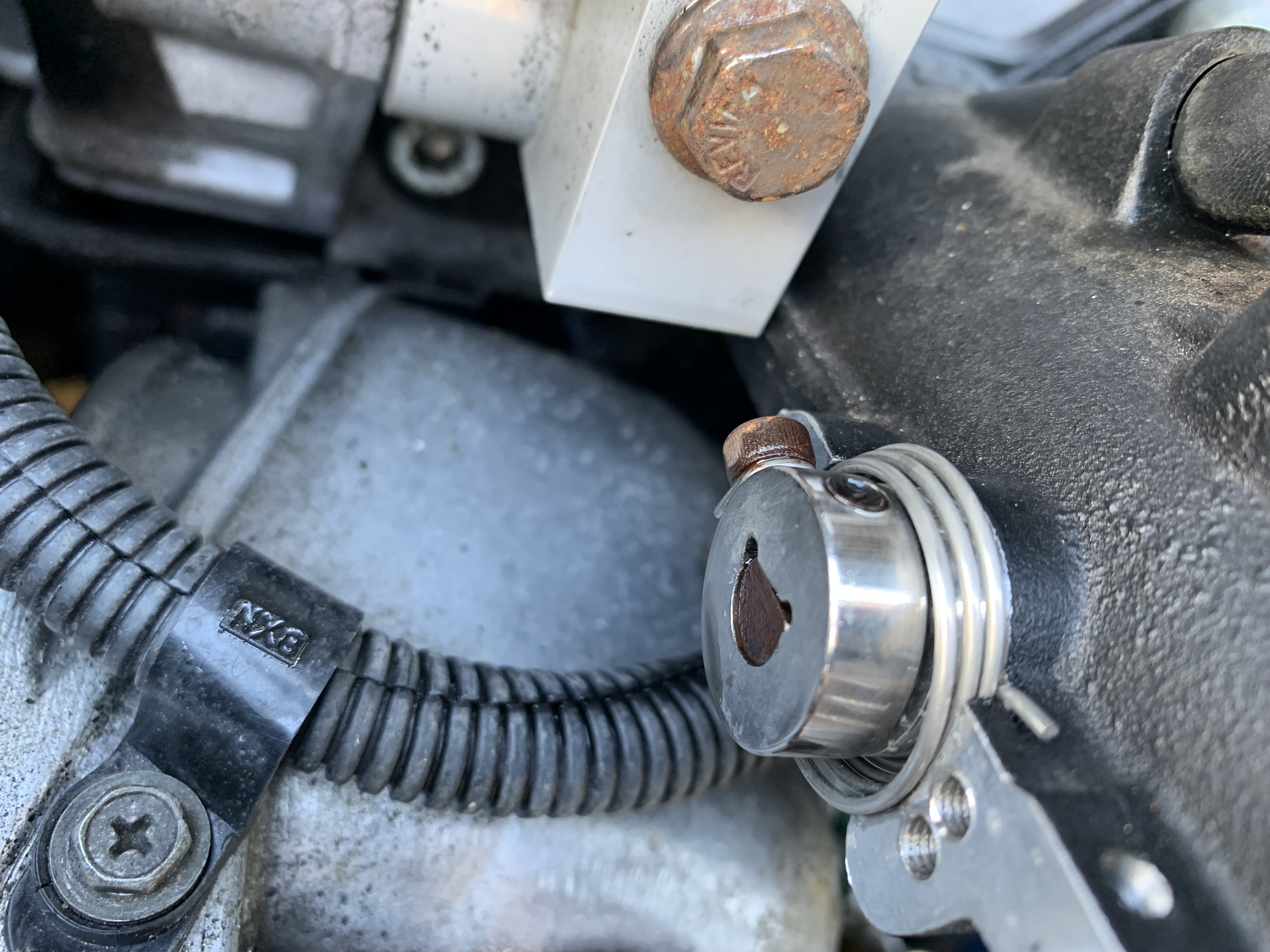

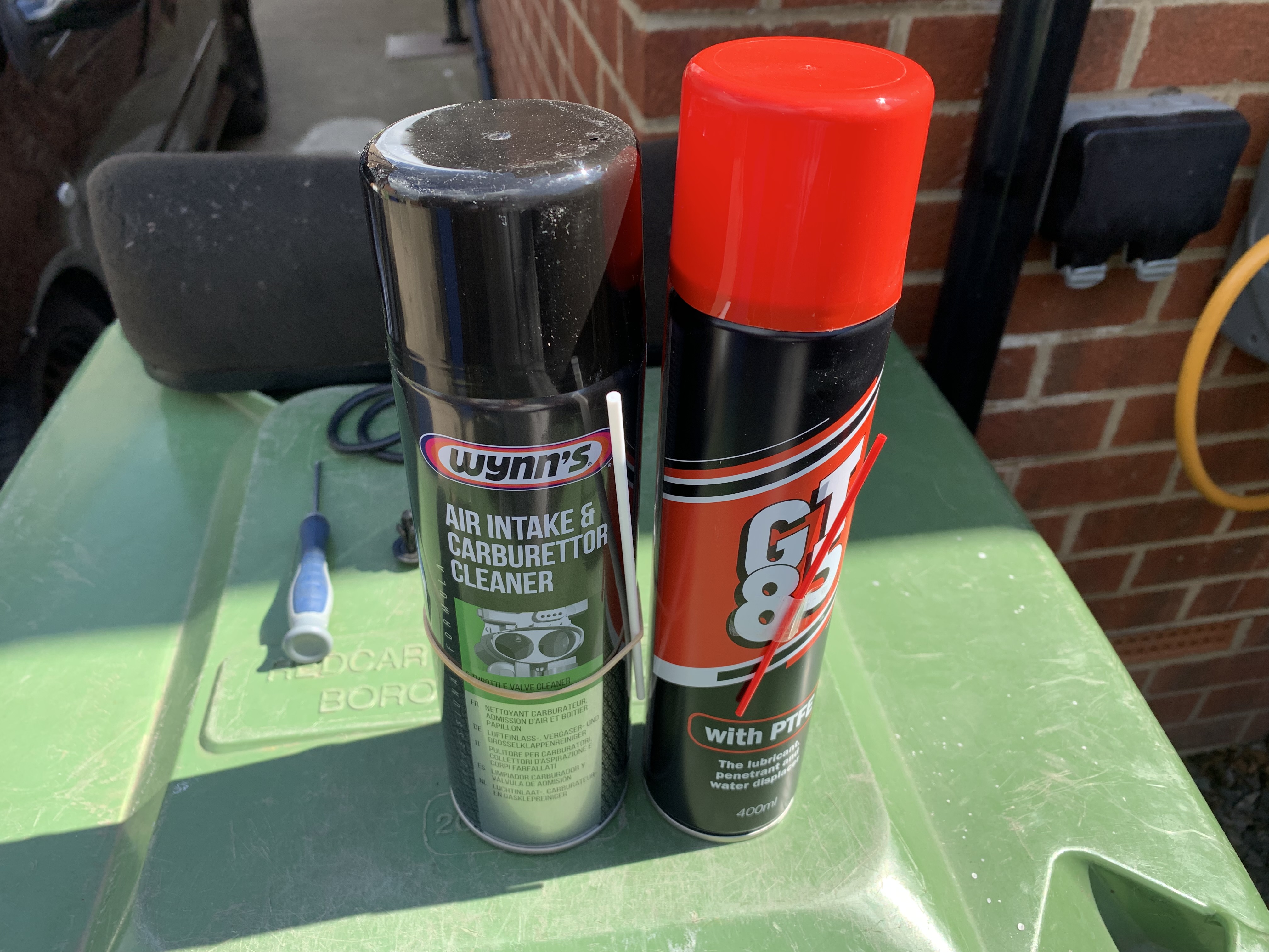

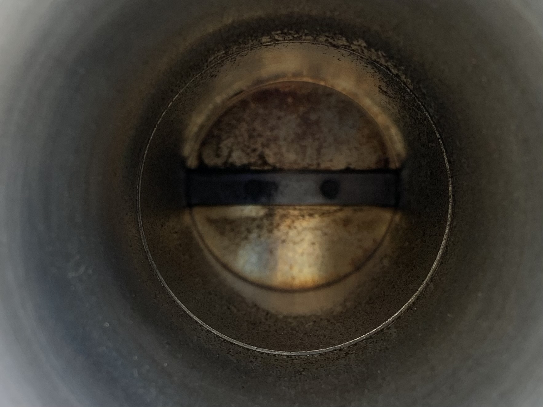

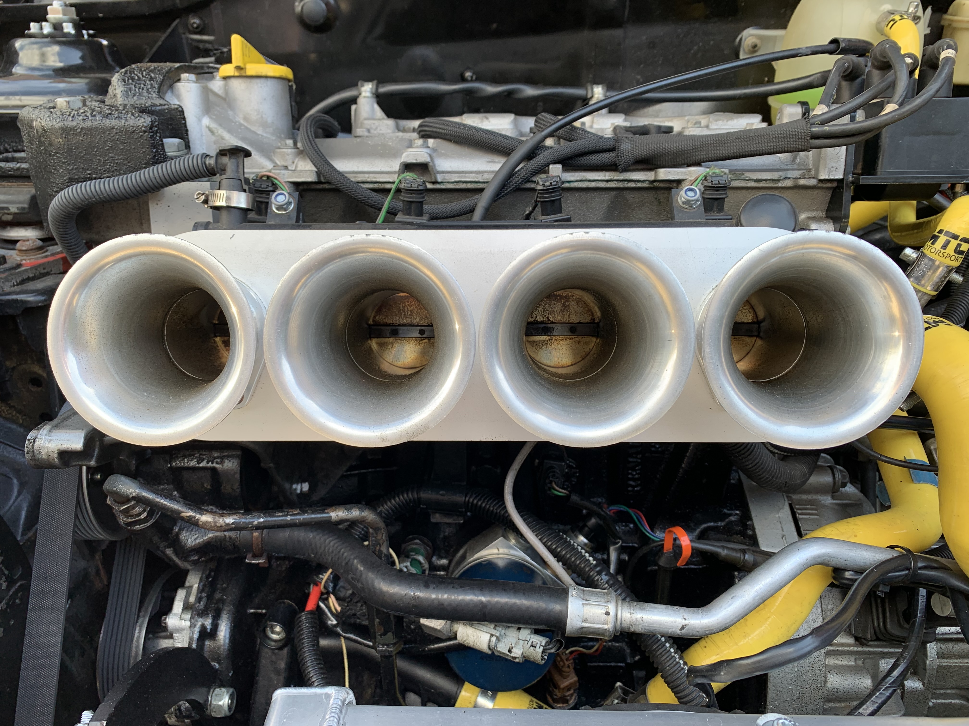

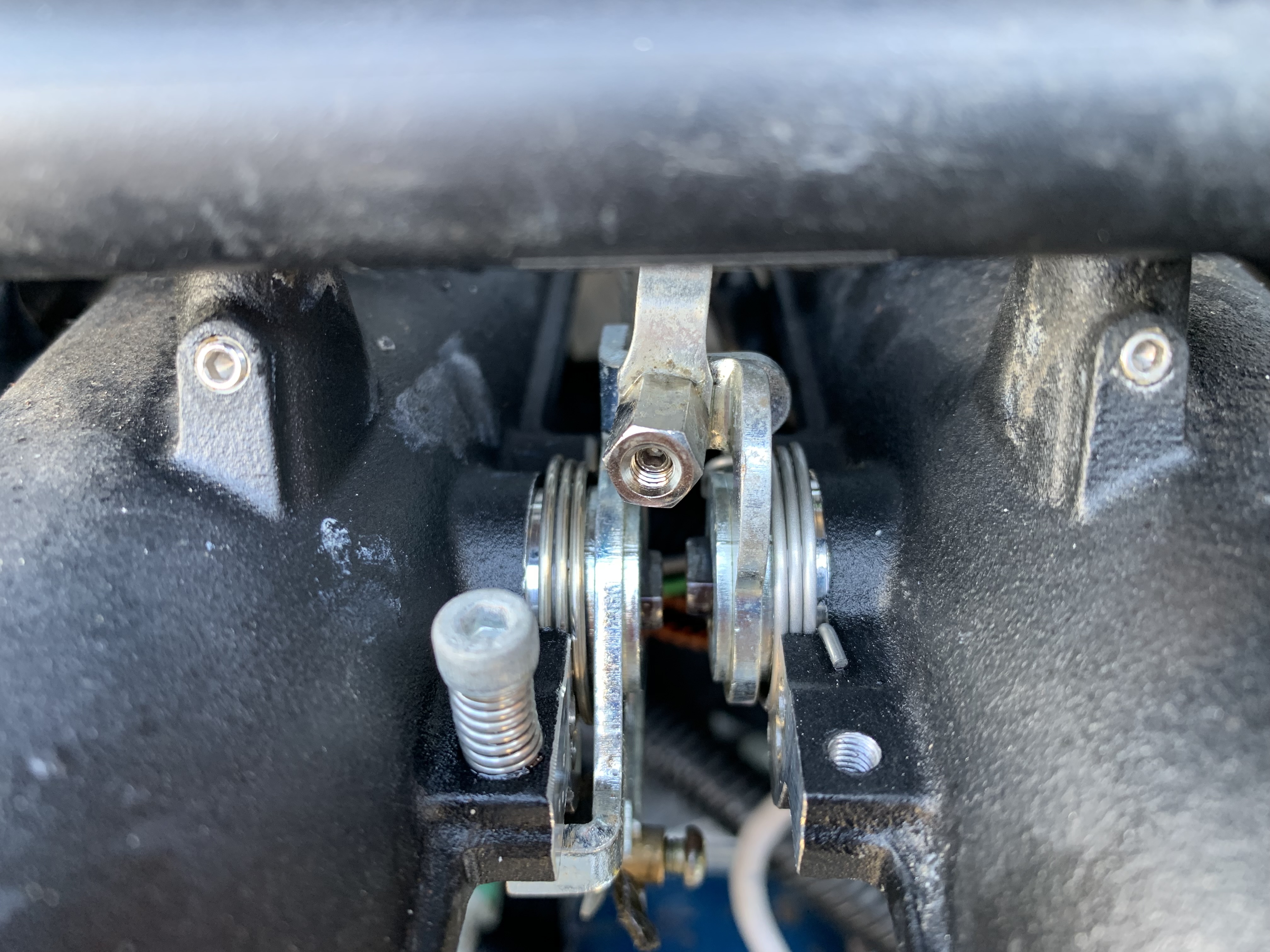

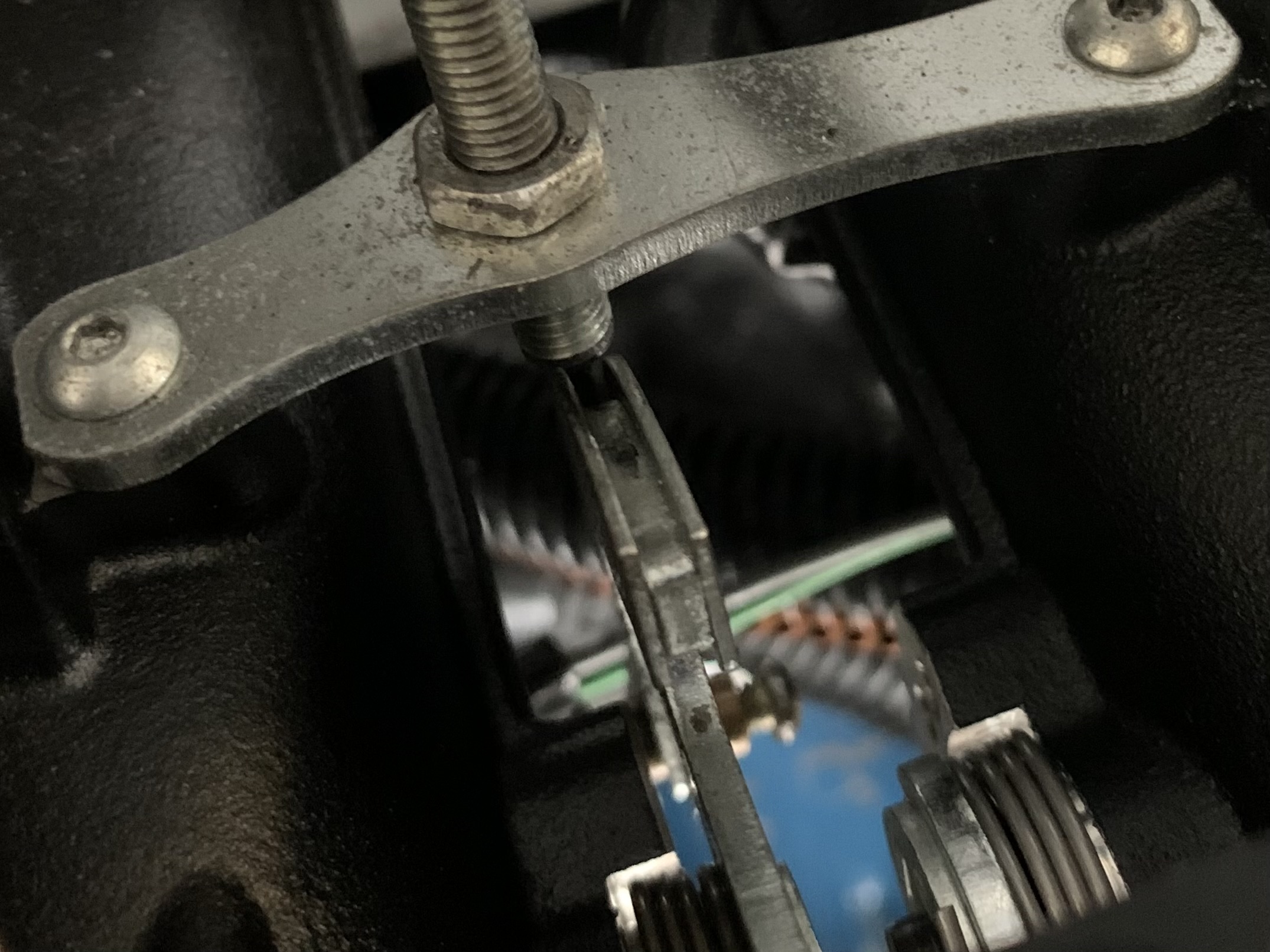

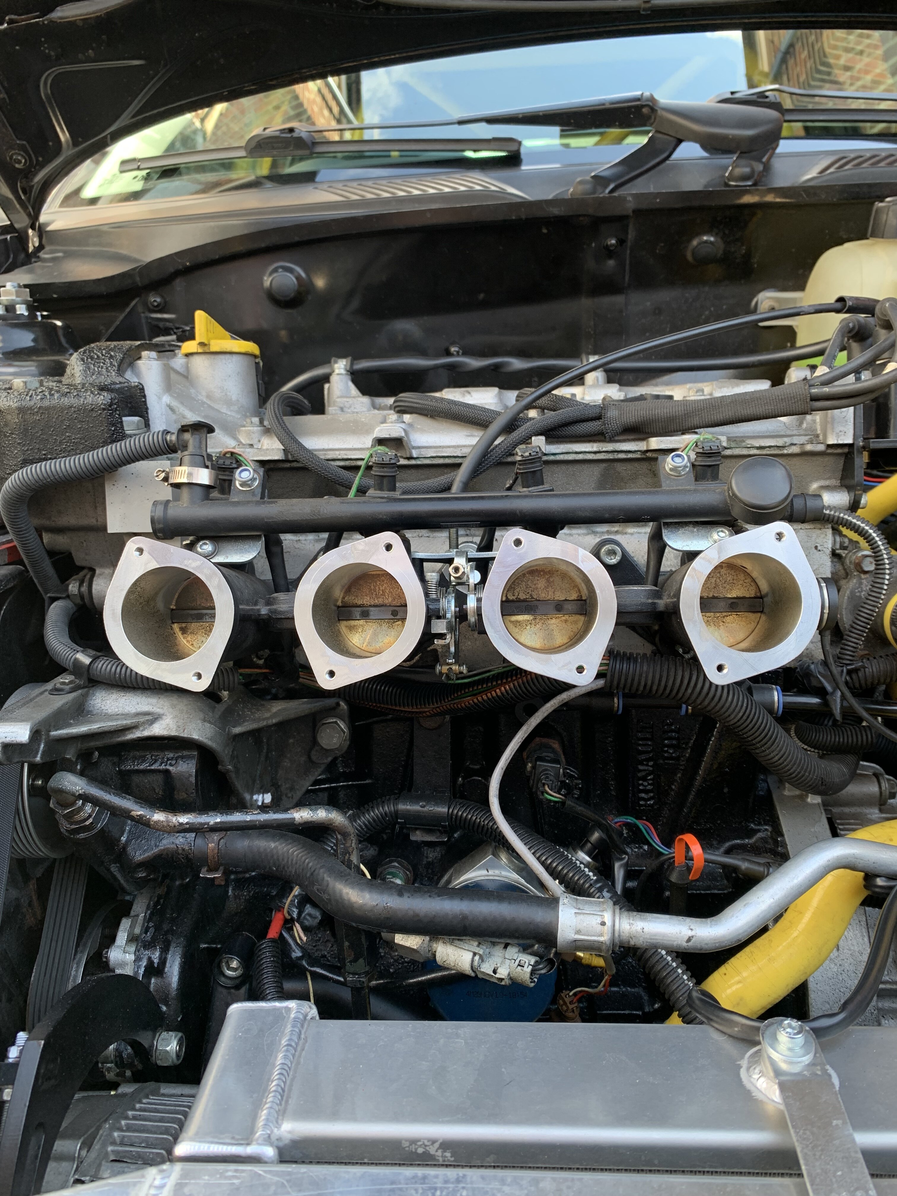

The issues started mid morning when the throttle stuck open as I was approaching Tower at 120mph 💩💩💩
It continued throughout the morning, especially when the engine was hot. I tried spraying the spring mechanism with GT85, but it didn't make much of a difference.
I considered calling it a day, but with plenty of fuel left, I decided to keep going at three-quarter throttle. In the afternoon, I noticed the engine was bouncing off the limiter at 6,500 RPM, even though it's mapped for 7,500 RPM. This issue resolved itself as the fuel tank emptied.
I didn't let it ruin my day and managed to cover a few hundred miles, using up 80 liters of fuel.
On the journey home i was travelling at 50 mph then came to some lights. Clutch in and throttle stuck open.
I’ll have a good look at the weekend. Strip it all back, clean the bodies etc. 🤞🏻

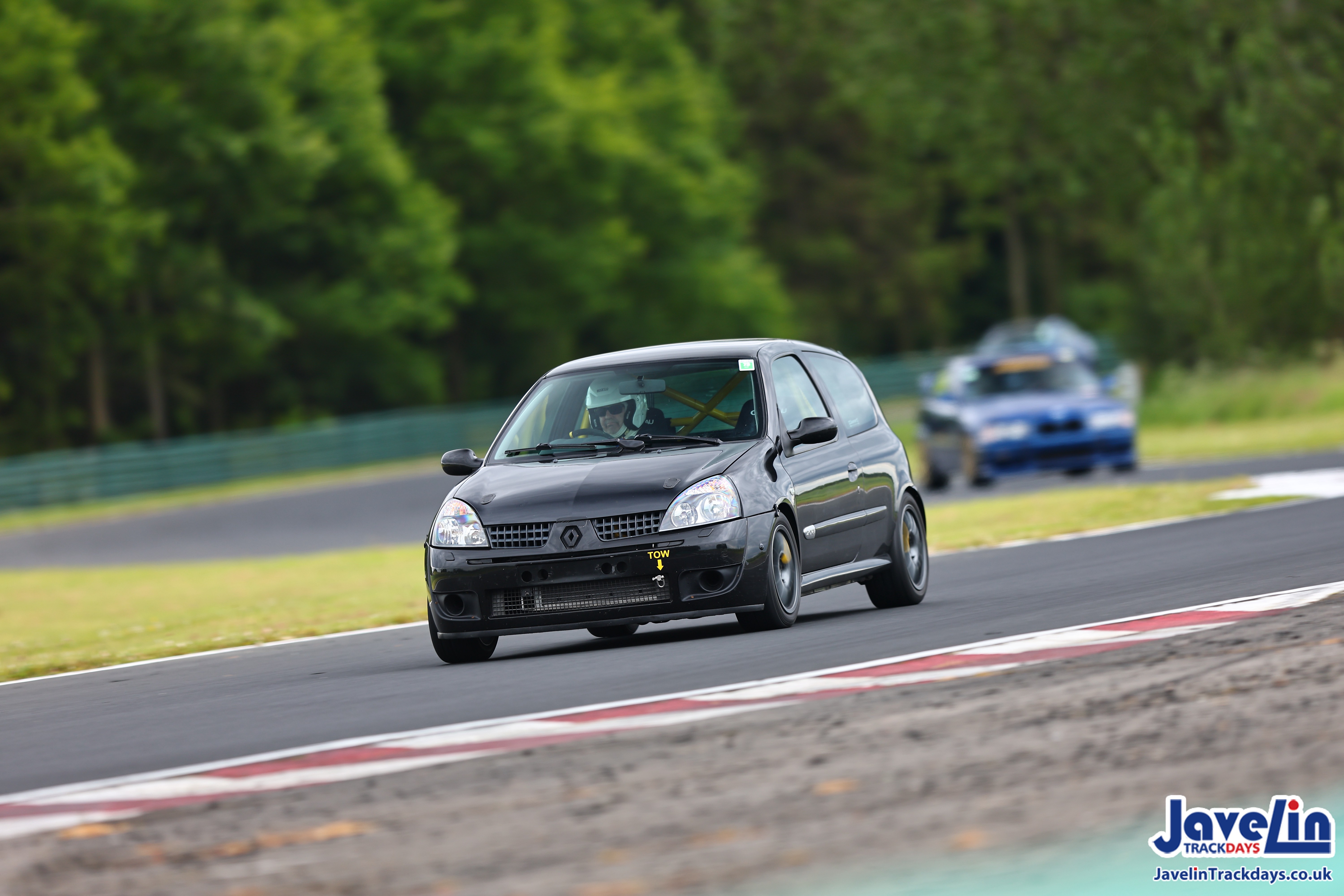

A few from Croft.
I love this shot with the blurred background.
Met a lad and his dad with this PH1. Proper people and the car was really quick. Followed them around for a bit.
Arse end shot coming out of Hawthorns and through the Chicane. You have to approach this one just right to avoid smashing over the big lumps and ending up on the grass on exit. Such a fast circuit.
The Corvette ducts lasted well and worked as they should. Brakes worked beautifully all day. Only a slight graze on the OSF as I was reversing back into the garage on full lock.

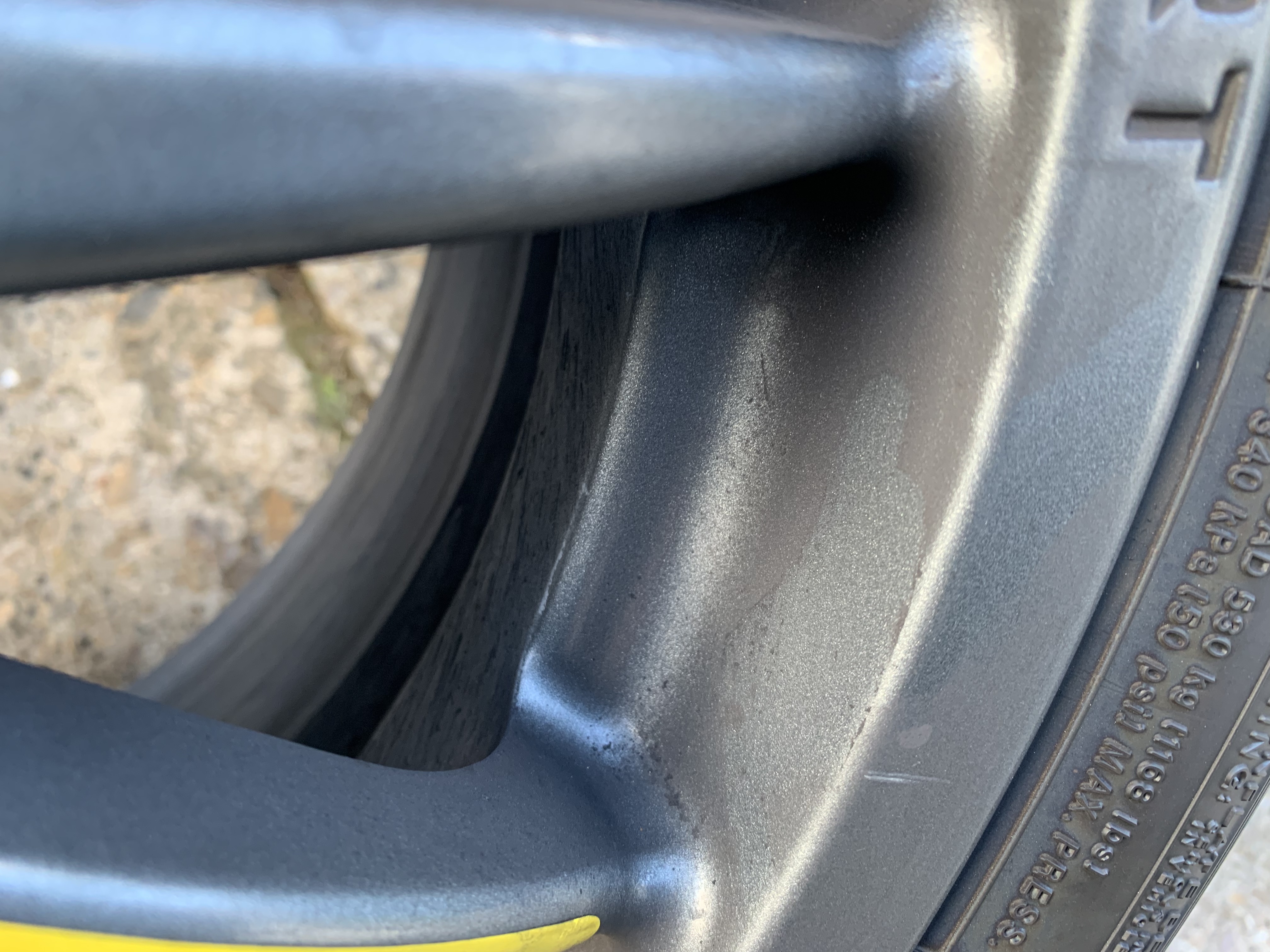

Brake dust from the CL6 pads afterwards. Just a dusting. I often see people posting they eat alloys, but I’ve never experienced it. I suppose if you don‘t check and clean your car afterwards, then that might be the case.
Quick wash with shampoo and they’re ready to go.

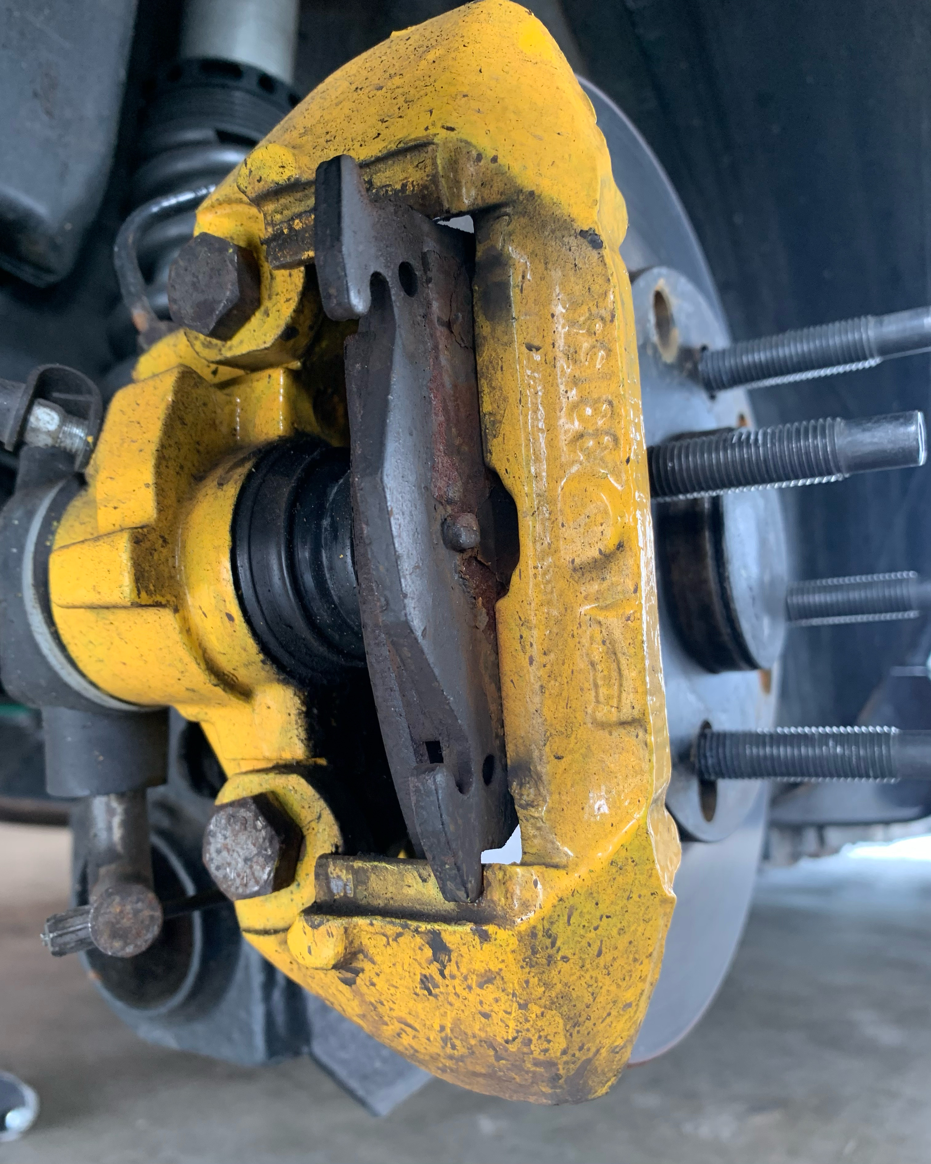

I made the mistake of not cleaning my wheels after Croft, the brake dust was well embedded and I had to dig out the strong stuff to get rid of it, im pretty sure they would have been okay had I done it before they got wet!

With another track day approaching, I inspected the ITBs to determine the cause of the sticking throttle.
With the filter off you can see a fair bit of dirt and sticky residue.
A close up.
Whipped the trumpets and front plate off for easier access.
Used a lint cloth and carburettor cleaner to get the gunk off, then some GT85 on the linkages and springs.
No signs of damage or bending to linkages so reassembled everything after a good clean.
Checked the pedal and cables and all seem fine, no snagging.
I can’t say it feels any different, but we’ll just have to see how it goes when I get to Croft.
Advikaz
A close up.
View attachment 1698386View attachment 1698387
I did the throttle body on my rb before heading to the ring, made a substantial difference.
Hopefully this cures your issues mate
Mr Underhill
Another productive track day despite the weather.
The car ran fine for about 10 laps, before the throttle stuck open again. Fortunately, it happened during a gear change and not approaching a corner.
I caught up with Fred and James from @FrogJam Motorsport who were getting some seat time in their amazing Clio.
James had me press the throttle pedal while he took a closer look and noticed the throttle return was catching on the cable adjuster.
This explained why the issue only occurred when the engine was really hot - everything expanded just enough to catch.
A few adjustments fixed the issue, but when testing the throttle again, the pedal fell off 😂 WTF!
It turned out a missing washer on a plastic component caused the bolt head to eventually work its way out. Not guilty! 😂
James to the rescue again with a washer and the job was sorted.
I took the car out for a few laps and no more sticking throttle.
Unfortunately, the problems didn't end there. The car began bouncing off the limiter just over 6,000 rpm and spluttering on the overrun. This intermittent issue had appeared at the last track day as well. To top it off, it started to rain.
After some head-scratching and messaging a few people - thanks @Brigsy - we concluded the issue might be related to the water temp extension I installed last month.
I removed the extension, reinstalled the original sensor in the thermostat housing, and bingo—problem solved. The ECU couldn't get an accurate temp reading, which was causing the map to go haywire.
The car was amazing after that, though I didn't have the nerve to push it hard because of the standing water.

At the last track day, I heard something rattling around while going through corners but couldn't find anything obvious. Then the seat felt like it was moving under heavy load, which I thought was due to the Velcro on the seat pad coming loose, but it wasn’t that either. So I whipped the seat out to have a closer look.
As I removed the seat, I noticed a bolt - seat to mount - was missing. I suspect that’s what was rattling, and sure enough, I found it on the floor.
The hole in the seat was cross-threaded, so did a quick fix with a heli-coil.
I prefer a fixed seat but like to be higher up, so had left the runners in. The downside is I keep smacking my head getting in and out, so took them out whilst I was there. Seat back in, a bit lower than I’d like, but it’s nice and sturdy again. Probably safer too.
Onto the cooling. After removing the adapter from the thermostat sensor due to it causing issues, I now had no internal temp gauge to monitor.
I bought a cheap 32mm adapter which goes into the pipe work.
The old sensor fits spot on.
I now have a working temperate gauge inside the car.
Last job was to dig the spare tyres out.
I bought some MRF ZTR medium compounds last season but never used them. Funny enough, the guy who’s running tomorrow’s trackday is the main distributor. I should be able to get some feedback on pressures etc.
The Yokohama 052s are my go to tyres, but very expensive. It would be nice to find a decent tyre at a lower cost, so looking forward to seeing how these hold up. I’ll do some comparisons when I get back.

How do the Mrf compare to AR1?
I’ve never run AR1 tyres before, and tomorrow will be my first test of the MRFs. My friend races in TDT in a Clio 182 and uses Yokohama A050s but had AR1s on his car in the first season. He found them unsuitable for a race series, where competitors are using better tyres, like Yokohama 52/50s. But he said they’d be fine for testing or track days, where you’re only out for a short period of time.
The ones MRF advertise are the soft compound, but I paid a bit more for mediums (race series) and they feel rock hard 😬 It’s forecast 25 degrees tomorrow so I should be able to get plenty of heat in them 🤞🏻
I don’t expect the ZTRs to be as good but they are used in the same series as my friend’s, mainly on the heavier Hondas. Since I’m not competing, I don’t need a tyre as good as the 52s, but based on the feedback from TDT, I would expect them to be better than the AR1s.
I’ll do a write up next week on my thoughts. I’m hoping they’re as good as people say. Not a cheap tyre by any stretch, but cheaper than what I’m using now.

Absolutely cream-crackered, but what a day! The weather was perfect, and out of a maximum of 65 cars allowed on the track, 25 were booked, but only 19 turned up. The poor TDO blew £6,000, and I was gutted for him.
Only 4 garages were taken up and everyone was called Jon. 😂 It was surreal to say the least and like a ghost town.
I ended up in garage 1 next to this chap. He’d hired Max Coates for the day to get the most out of the car.
The morning went really well. So much time on the track, no sitting in the pit lane for 20 minutes, no lunatics, and no constant red flags.
It wasn’t without drama, though. As I came screaming through Barcroft at 100 mph, I found I didn’t have any brakes. First press of the pedal, nothing. Second press, nothing. Third press, and I got a bit of pedal along with a horrible grinding noise. By now, I was just off the circuit and over the grass, but I managed to keep out of the tyres.
Limped back to the garage to find this.
Yep, lost one of the rear pads.
To make matters worse I’d also worn the NSR rear tyre through.
Damn, early bath for me then.
Luckily I made a quick call to work and within the hour they’d brought me a new set of pads and fitting kit.
I’d also brought along my new MRF tyres, so no time to waste. Lucky for me this all happened 10 minutes before lunch, so I didn’t miss any track time.
New pads in, tyres on and back out.
The only other problem I had was that the CL6 pads were too strong for the MRFs. They’re a medium-hard tyre and took a good 5 or 6 laps to get the heat into them, so I kept locking up while braking into the first corner off the pit straight.
Luckily, I’d brought my DS1.11s, which give you a more linear, less severe pedal. No more locking up, and once I got the tyres up to temperature, I was flying. The car ran perfectly all day, and I got tons of track time. It was the best one I’ve had in a long time.

What caused the caliper to s**t itself? Good write up 🦵
