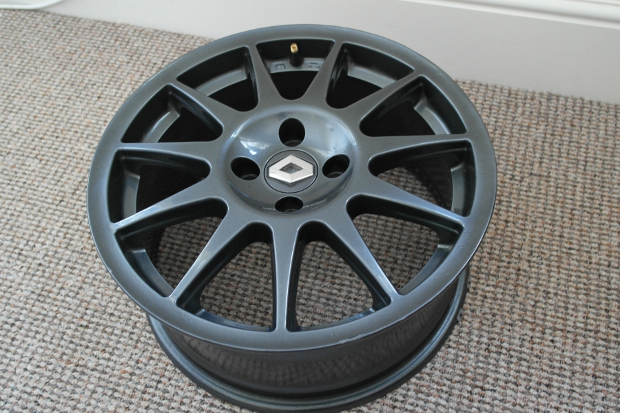

Original 'Cup' Wheels (Made by Speedline and called Turini (38.5 Offset)) were only available on the Mk2 Phase 2. These wheels should bolt straight onto your Mk2 Ph2 without rubbing.
The Mk2 Phase 3 Trophy (48.5? Offset) had the same wheels, but with a different offset and were originally Anthracite in colour, I wonder if you have some how picked these up?
The use of the word 'Cup' Wheels could also to a newbie refer to Mk2 Ph3 wheels from a 182 with Cup Packs, or even a Mk3.
Have you got the 48.5 offset off the inside of the rim, where it is stamped? Makes me think they might be Trophy Wheels
Stick a picture up of the wheels you have, sounds like you have 182 wheels of some description, most likely Trophy wheels.

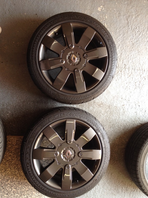

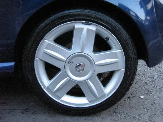

Now I'm beginning to see the light!! I think what I may have are Trophy wheels from a 172/182?
Saner, I have got the offset from the inside of the rim, yes... here's a pic of the wheels...
Although, they are now a gorgeous satin black with new Maxxis rubber all round!! :D
I can't get a pic up as the servers offshore won't let me on certain sites... photobucket being one of them!! :(
But I think reading above, they are trophy wheels... Turini's are the multispoke speedline ones right?
Well, I don't have them... they are 16" five spokes... which I'm guessing are called trophy??

Hey,
Thanks again everybody for all your help so far!! ;)
Trophy/Cup wheels are the Speedline multispokes, theyre both the same wheel apart from offset.

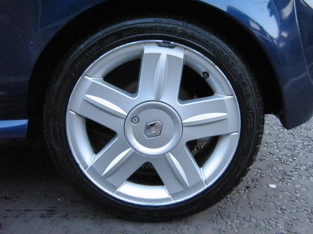

Hey!
Looking at the pics you've posted Saner, it's the 5 spokes, 3rd one down!!
Thanks again!! ;)
Woohoo! Progress,
Those are standard Mark 2 Phase 2 Renaultsport Clio 172 Alloy Wheels originally shod with 195/45 R16 tyres. Nothing to do with a 'Cup' in anyway! Offset is 48, as you know.
These should bolt on no problem, has a wider tyre been put on them?
The cheap option is that of JCC above, cut teh arch liner, however some hub centric spacers are the other option as already mentioned.

Awesome!! Now I KNOW what I've got... thanks for that!!
195/45/16's are the tyres I bought, so no, nothing wider!!
I defo want to go the spacer route, and now we've established exactly what I've got, just need to know which ones to go with!! ;)
