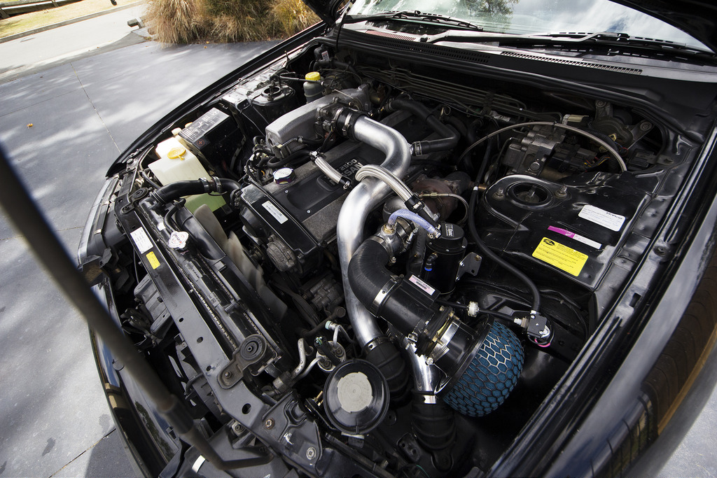

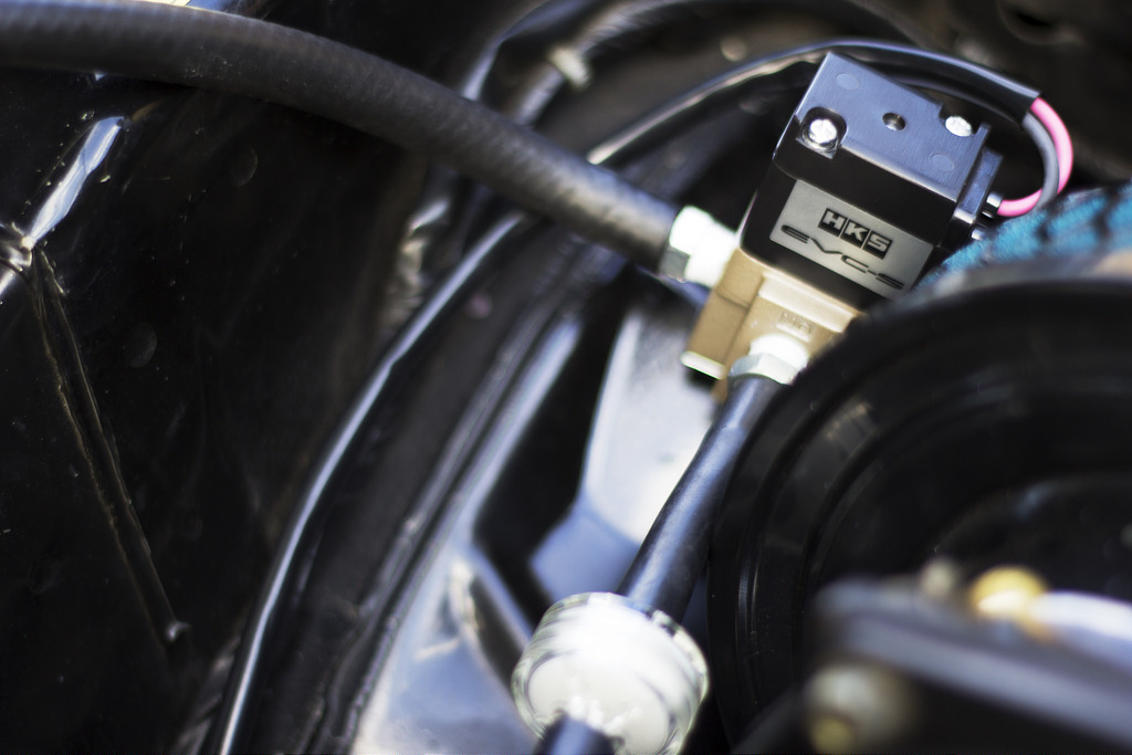

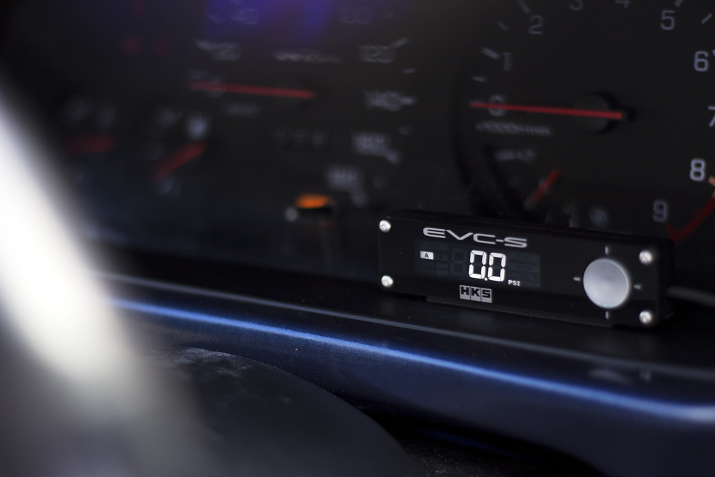

Right so nothing is straight forward haha... I thought it'd have like a setting where you say ok I want it to be XX psi, but nooooooo... You have 'offset' 'response' 'drop' and 'overboost'... Apart from overboost, everything is percentages... Percentages of what?! nothing makes sense haha. I tried going with default settings, it would boost till like 9-10psi then drop down to wastegate pressure...
So 'overboost' is like the boost level that you're aiming for, offset increases boost?, response is how quickly it spools, but sacrifices accuracy i.e could spike, and drop is how much the boost drops by if it hits the selected 'warning' boost level, which I put at 10psi.
After some googling, found that it was obviously dropping because its hitting the warning, so lowered the overboost setting to like 4-5psi and upped the offset and its now boosting as it should lol, wierd s**t.
Turns out its now running almost 10psi now... i saw 9.7 on the evc s haha, making some bad noises though... sounds like from the turbo... kinda rattly... yeaaaaaah. Next to no play in the shaft (giggedy) though.

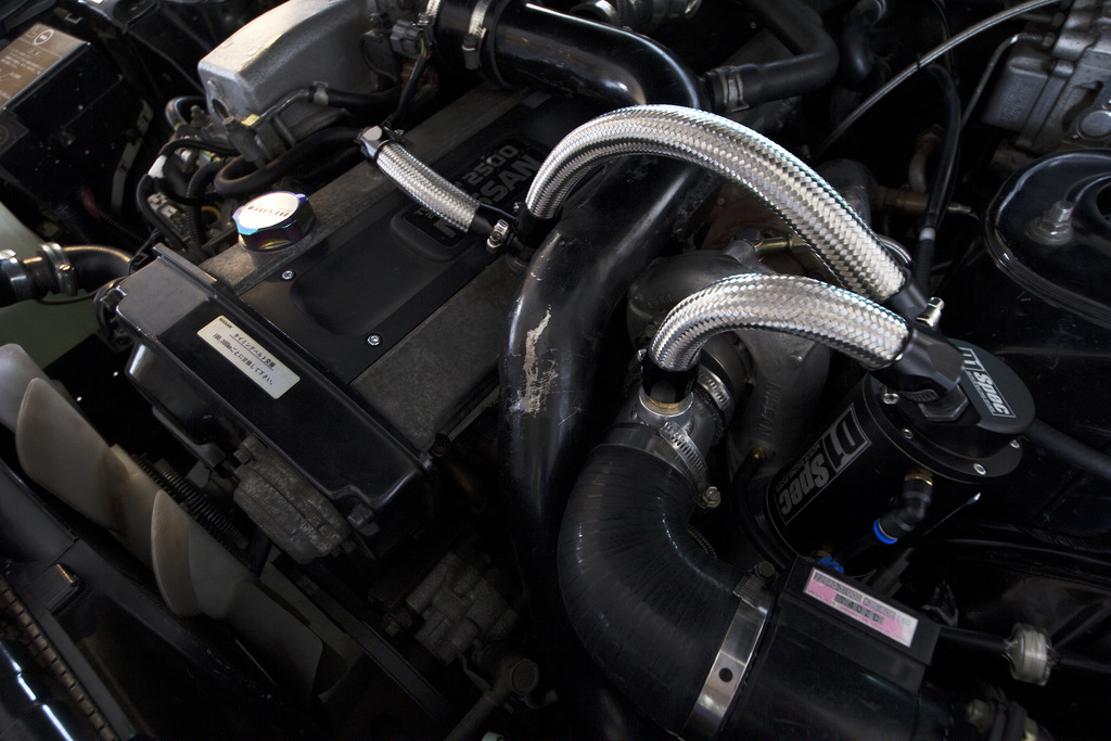

Installed the catch can, was a bit of a b*****d tryna get right, kinda had to shove some other hose into the hose and clamp it down to step the big hose down so it'd fit onto the catch can, but hey if it works, it works.
Also the hose catches the bonnet a bit so might have to address that issue at some point. Put some plastidip on it for the mean time. Can just cut the underskin off right lelelel.

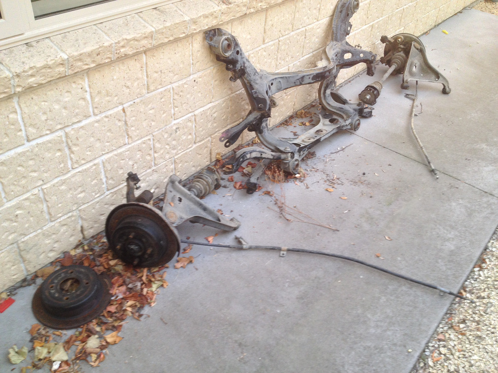

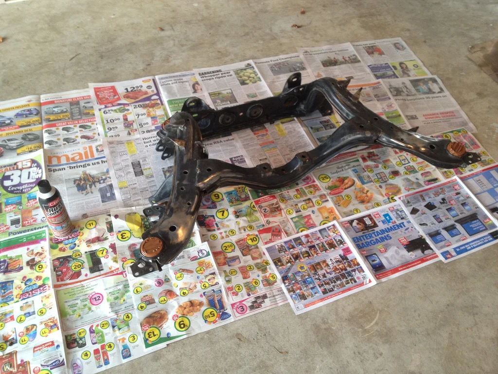

So one of the things it failed on was play in ball joints in the rear steering system (HICAS), so I've decided to go the proper route of deleting HICAS with a non-HICAS subframe.
It's a hell of a lot harder than a simple lock bar, but it'll be worth it in the end if I do it properly and it wont have any serviceable parts to.
With a HICAS lock bar, you still have all the ball joints in the system which can cause play and fail wof inspections (which mine has) so it's no better excuse to do it.
Managed to score this for about £30 which isn't too bad.
Untitled by danedser, on Flickr
Gonna strip it all down and give it a good coating of subframe black paint, sort the bushes while I'm there.

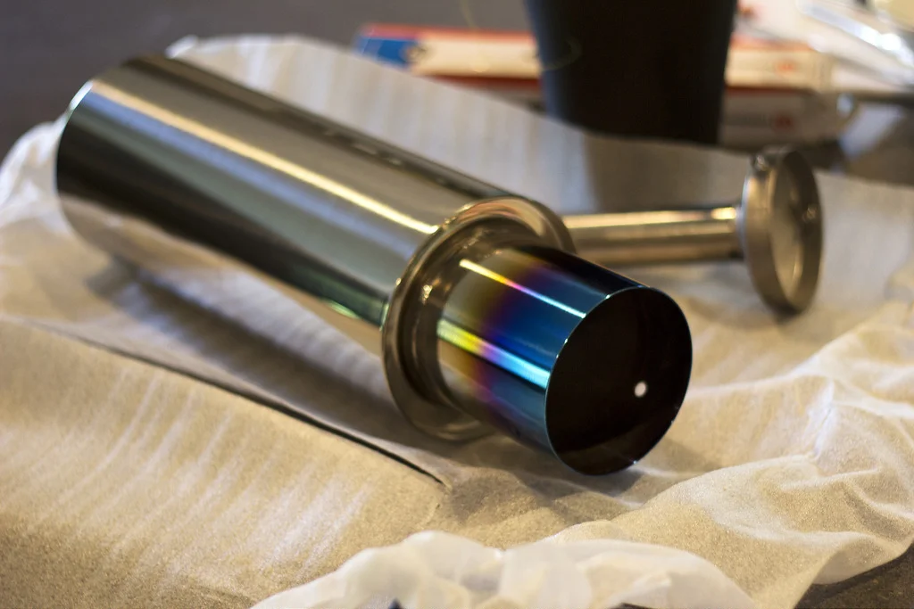

Also got a new muffler to go on and a v band so I cant drop the exhaust when I need to do the subframe, as currently the exhaust is all one piece.

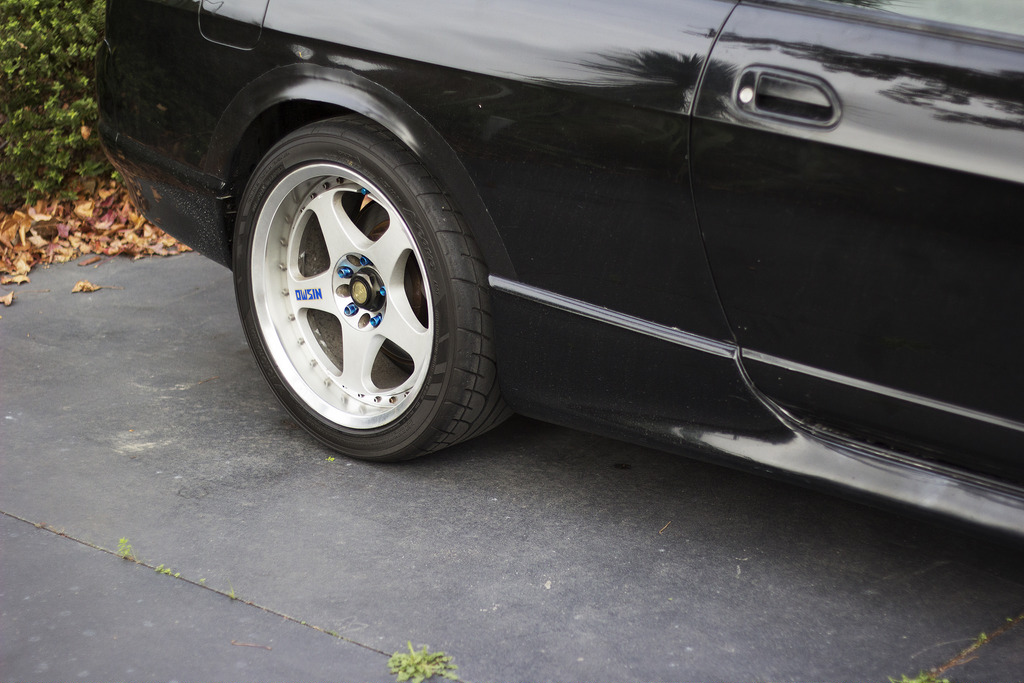

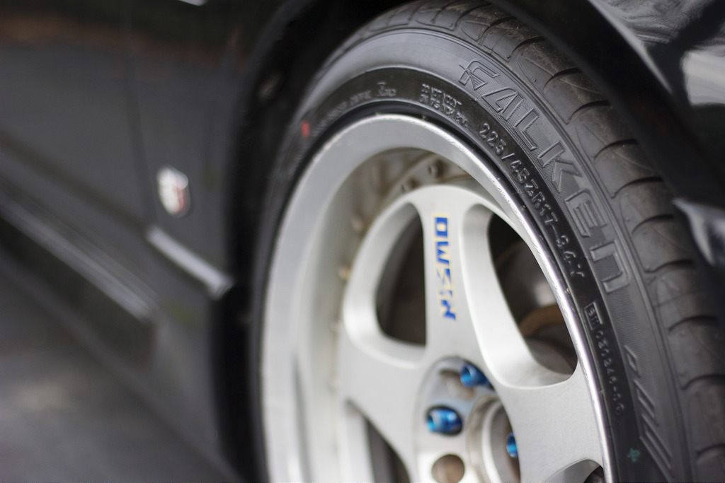

Decided to take the hit and get the 'legal stretch' Falken FK452 tyres in 225/45R17 as the Bridgestone's weren't wof-able. Might do me for a drift day though... Got another pair of tyres sitting about the garage too... Hmmmm.......
Fills the arch a bit better now but the lip doesn't 'pop' as much as it did with the 215's. I really wouldn't say they're stretched at all.
At least they're certable and wont get pinged by the popo/wof man.

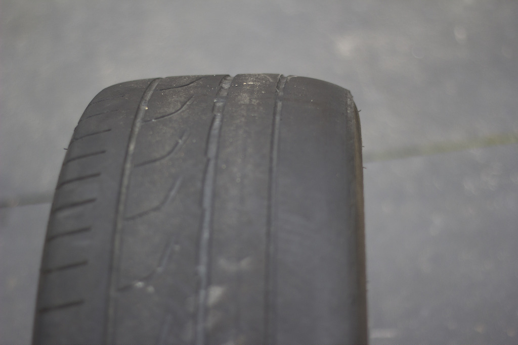

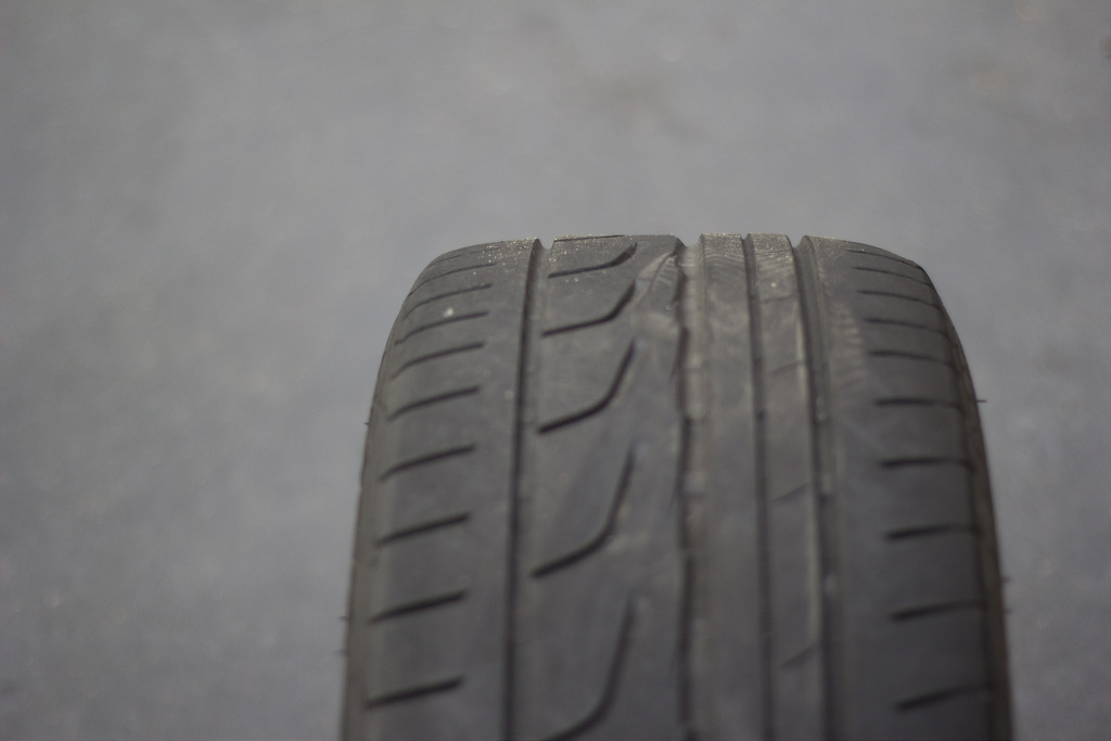

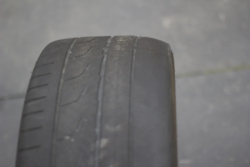

So this was the tyre that was causing wof issues
Fucked tyre by danedser, on Flickr

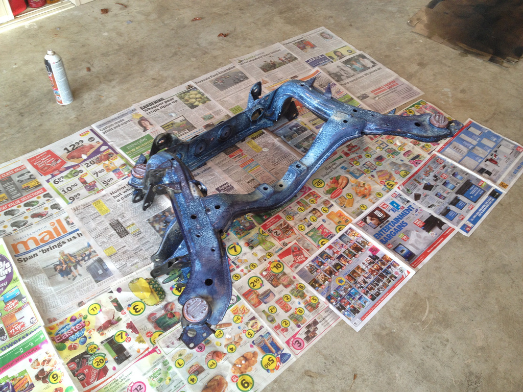

Subframe is happening, managed to wire wheel most of the rust off and keyed the paint. Sprayed one side with CRC rust converter and about to do the other side tonight. Should be ready for paint tomorrow and we're onto a winner!
Comes out like a foam - pretty wierd stuff

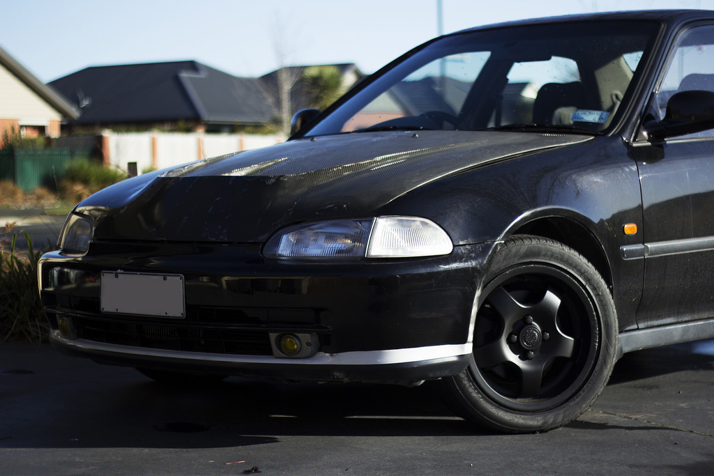

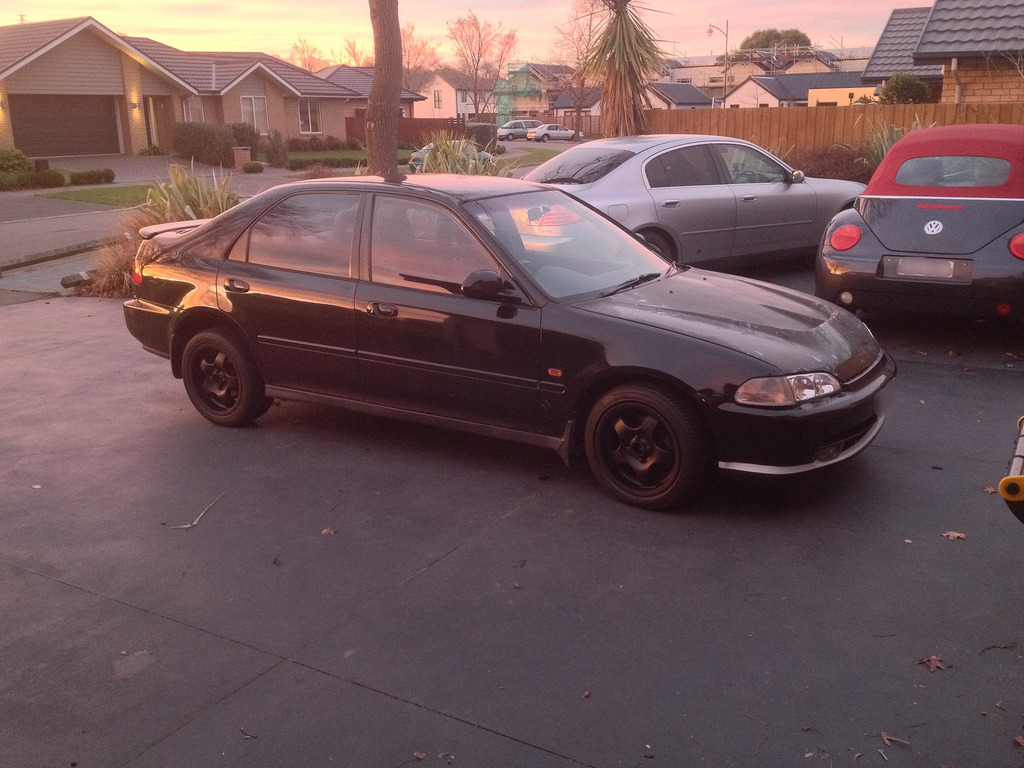

It's a JDM Honda Civic EG9 SIR :smiley:
Got it for a steal off a mate, just needs a fair amount of tidying up and will make a pretty sweet little runabout!
Doesn't go too badly either with its B16a motor :D
Sadly it is auto but my mate I bought it off is throwing in everything needed to do a manual swap and will help me out doing it when I get around to it.
Pls excuse s**t pics, it's not as bad as the pics show xD

Fart can might need replacing with a proper muffler, although it isn't loud at all. Rear bumper needs paint as is green whereas rest of the car is black. Had a shitty fibreglass aftermarket bumper on which I threw in the bin straight away.

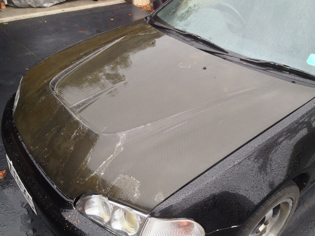

The bonnet definitely needs to go.

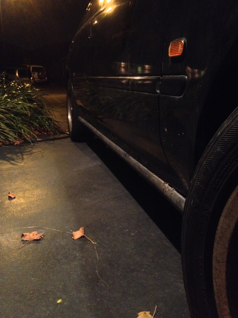

Ripped the ugly as f*ck side skirts off straight away!

To be fair it's f*cking light! Holds itself up haha, although that could be because the hinges need some wd40...
Yeah it needs a bit of work but is a good base.

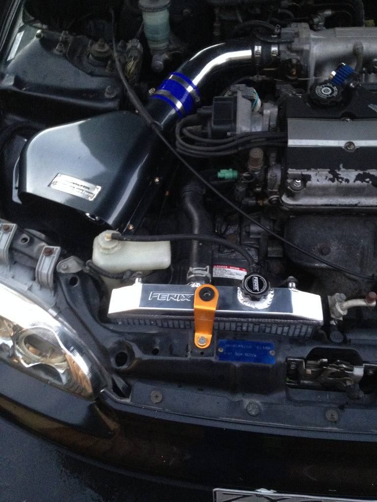

Bonus alloy rad/induction kit pic
IMG_4828 by danedser, on Flickr
Also have an OEM bonnet that needs paint, and paint the bumpers and she's mint!

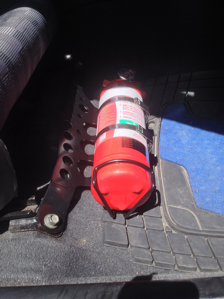

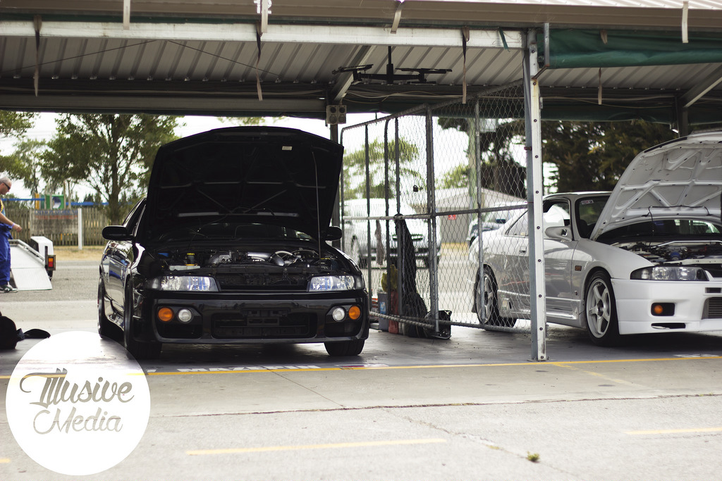

Also installed some Hawk HP+ track brake pads, and a fire extinguisher using a fancy bracket which means I don't have to drill any holes in it, and did a track day at Ruapuna :D
Was an epic day, definitely not the last!

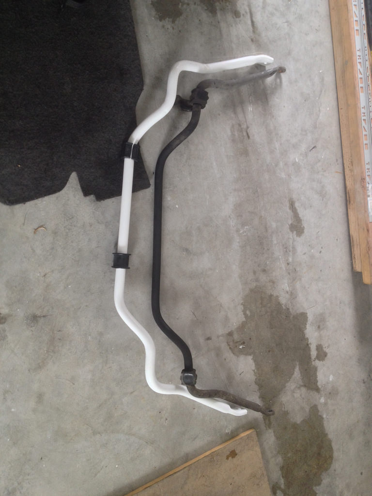

So installed an ultra racing front sway bar on the skidline and did another track day at Levels in Timaru, really good track day had lots of time and was keeping up with the big boys around the corners, just didn't have enough grunt down the straight which was annoying.

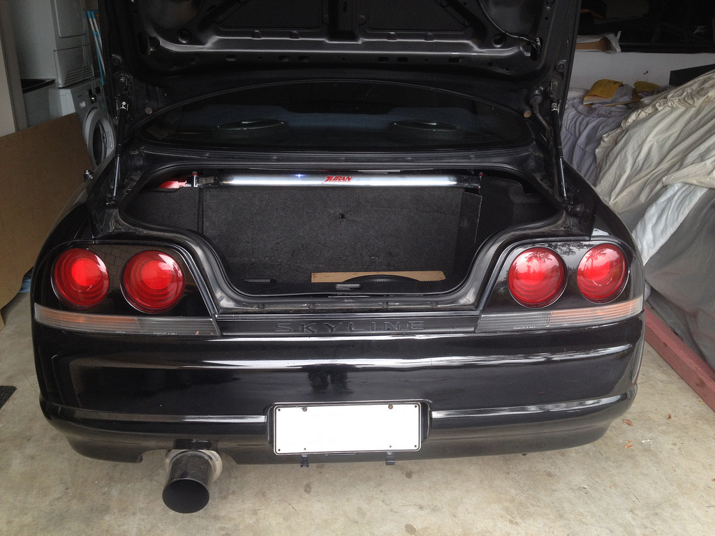

A Juran front strut brace to match my Juran rear brace I got a while back :smiley:
Next mod will be matching ultra racing rear swar bar :smiley:
