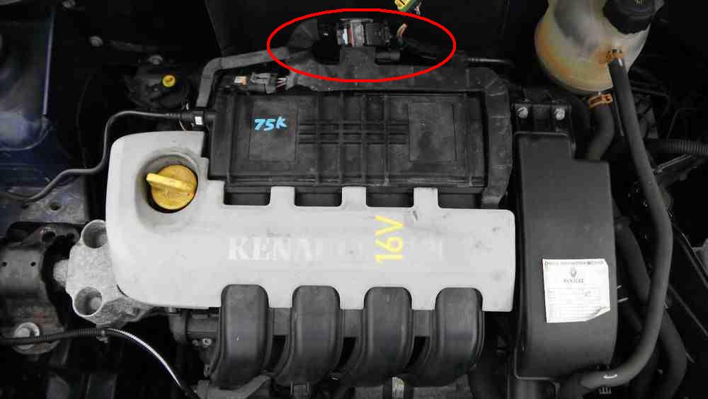

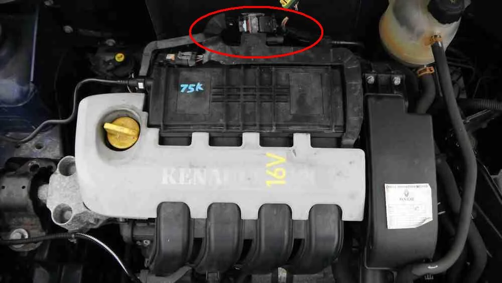

Nope :weary: it's still on the engine in the car, can I get to it without lifting the engine out again? it's facing towards the car isn't it?
Circled on the image below, have you got the ECU off the engine that has 1250000 on?
