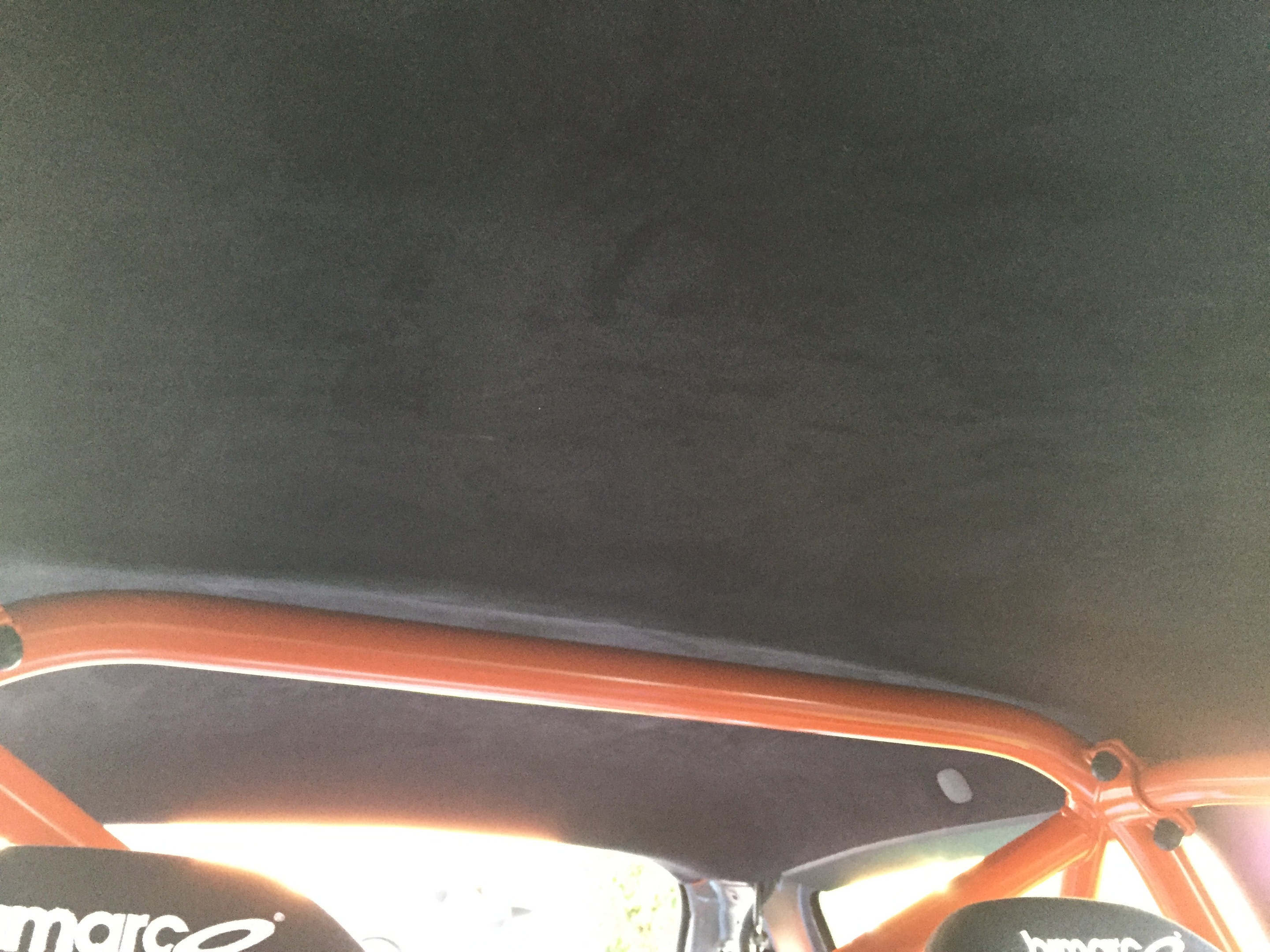

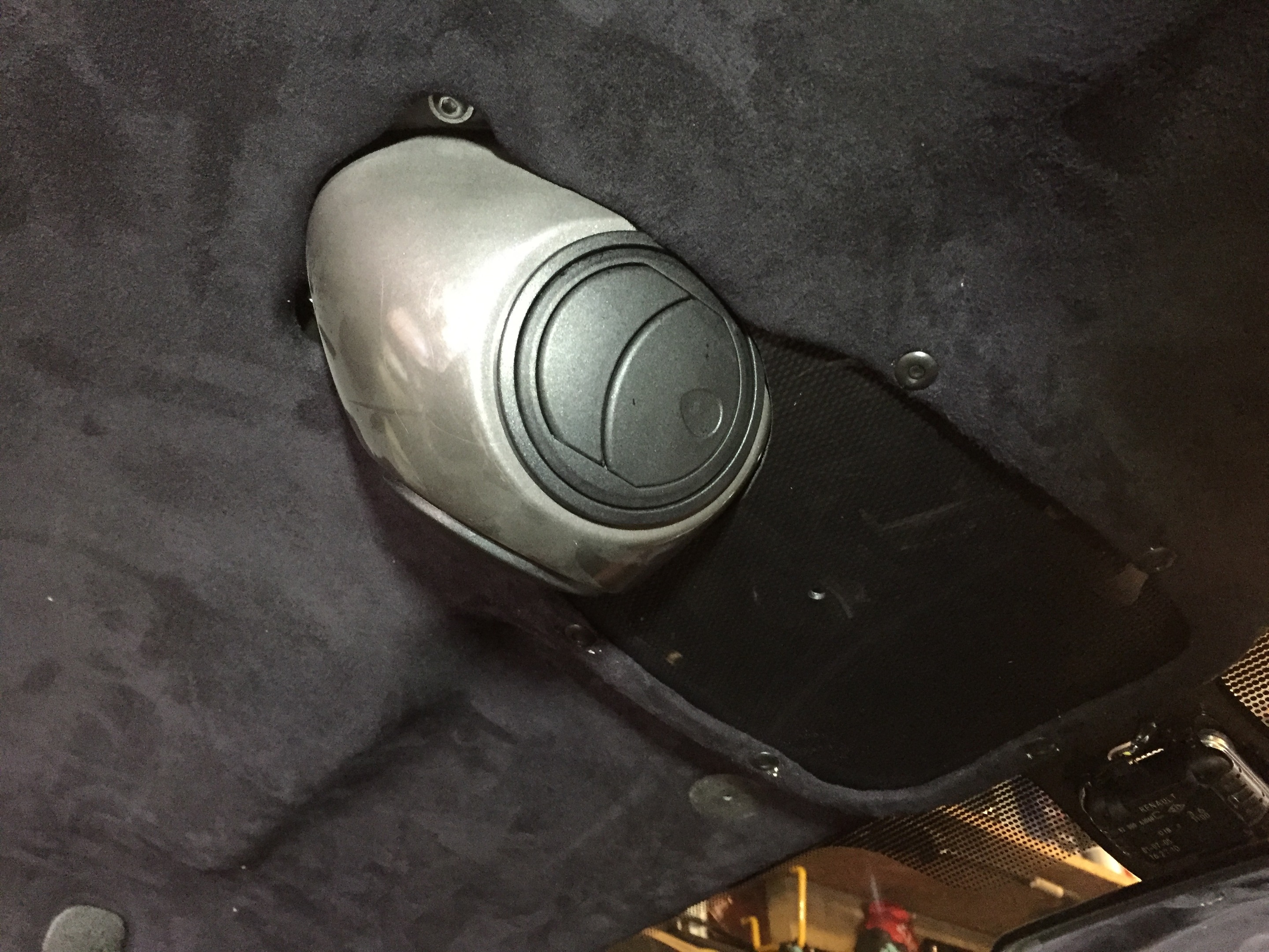

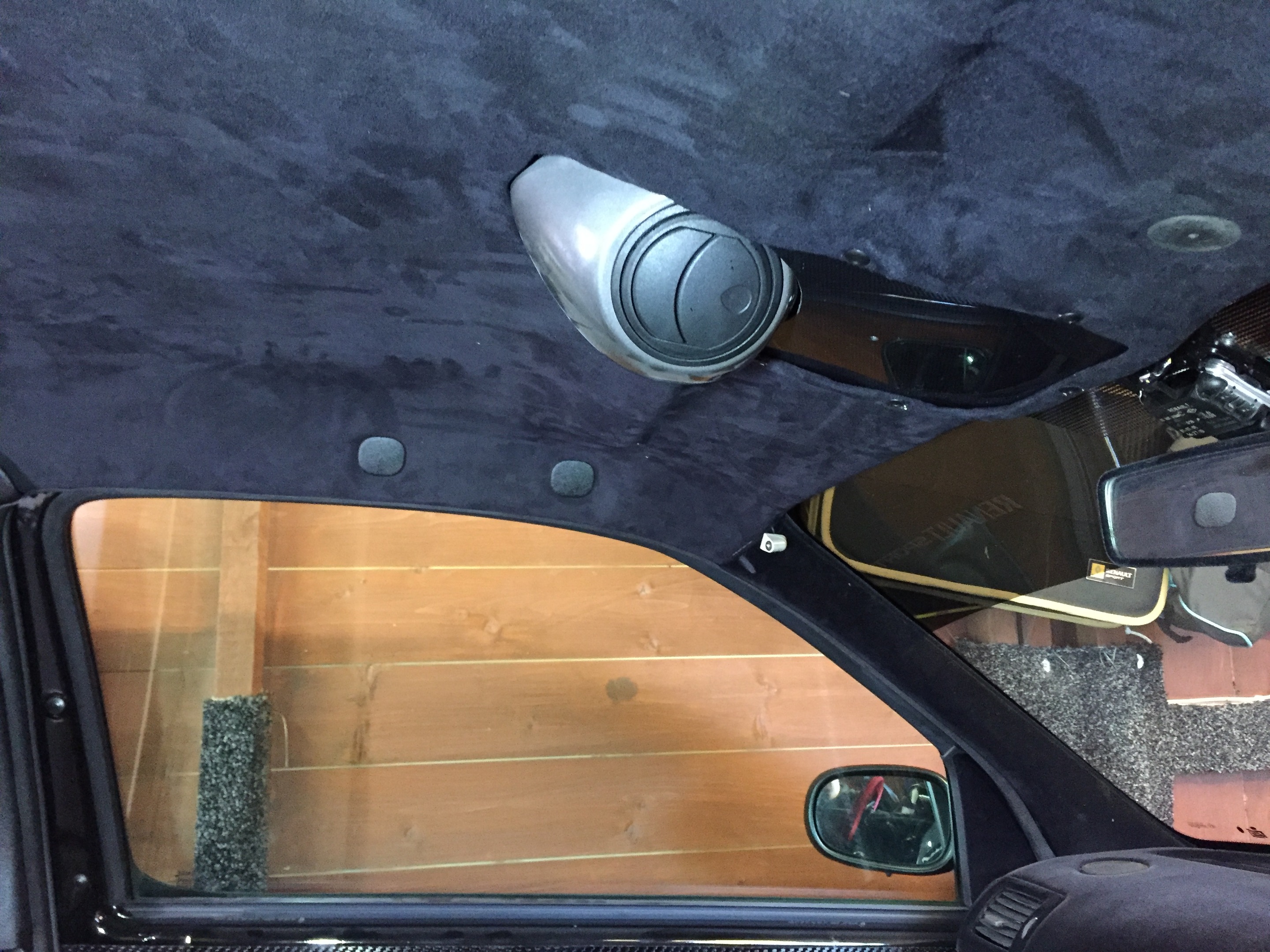

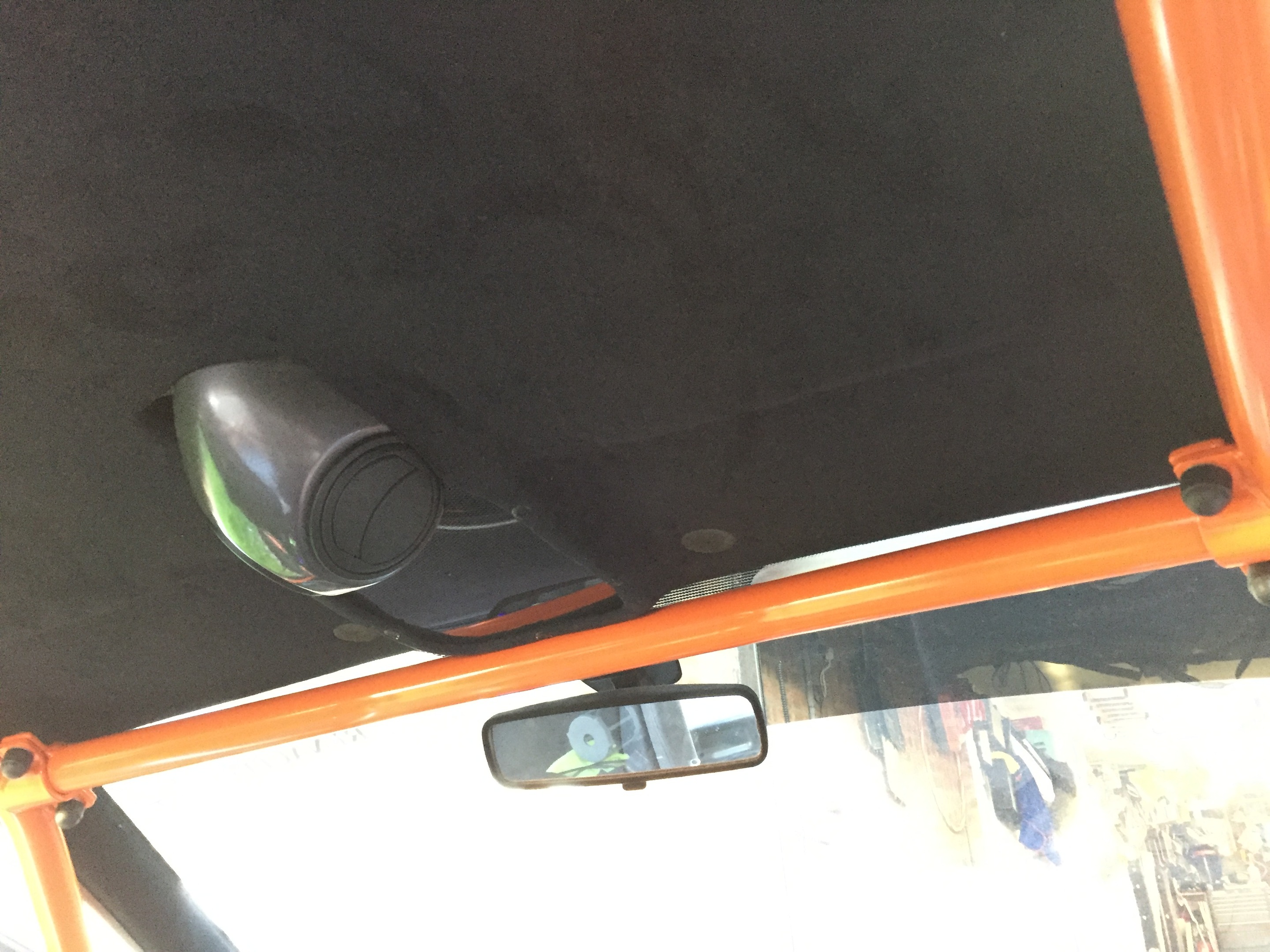

I did mine on my track car cost about £25, 3 cans of high temp adhesive and a couple of metres of faux suede off ebay.
Just take your time, when spraying the glue do it in small sections don't try and do it all in one go or you will be fighting with the material when it keeps sticking to the glue.

View attachment 313316 View attachment 313330
Looks smart with the vent and blanks too, been wanting to do this myself.
