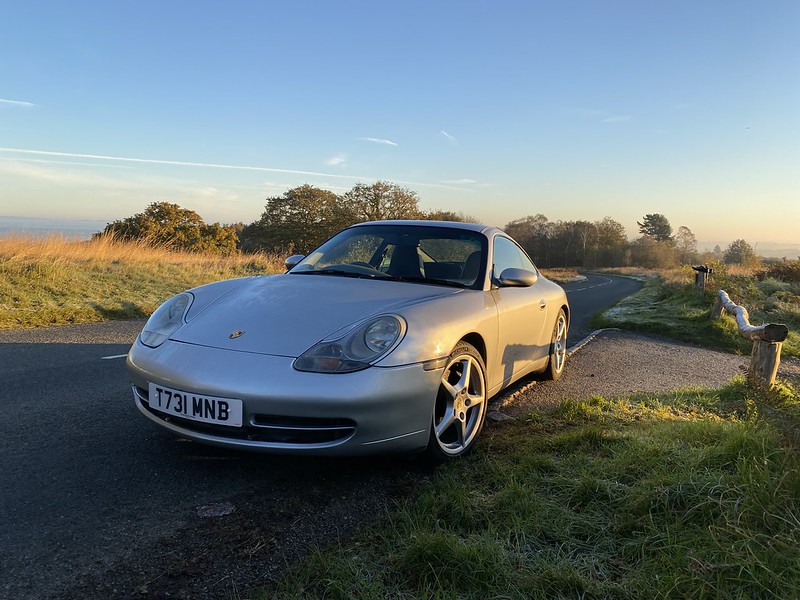

Hello to all. I'm considering getting a Clio as a track day car and keep my 996 for the road, so thought I'd sign up here for some insight into Clios on track and possibly cars available for sale.
In the interim, here's a bit about the 996, it's a 1999 3.4l Carrera, manual, coupe; it’s a relatively basic early car, so cable throttle, no traction control, sport suspension kit (M030), and later 997 Carrera iii wheels (same sizes but slightly different offsets). It has a few subtle modifications to make it a bit more focused: Quaife ATB limited slip diff, equal length manifolds and CarGraphic ETR silencers, semi solid engine mounts (RSS), short throw shifter, GT3 centre console delete, 997 sport hard back drivers seat sits much lower and is more supportive, and 5mm Spacers on the front (to correct the offset from 997 wheels).
