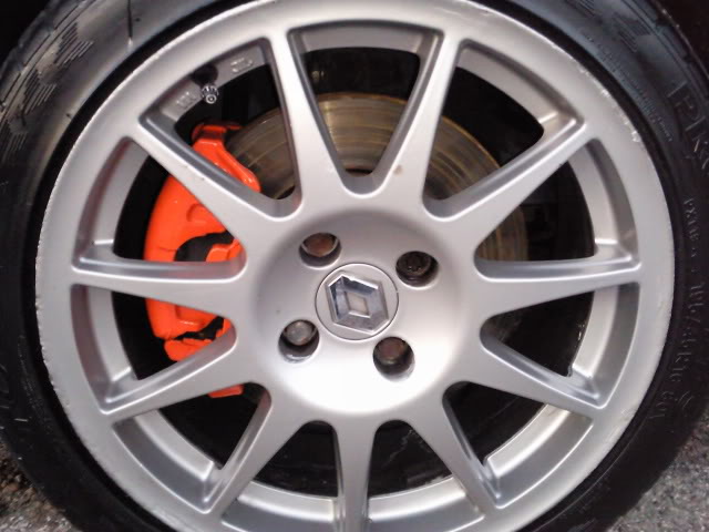

* went for a trip to halfords and returned with alot of paint lol for the cover and calipers

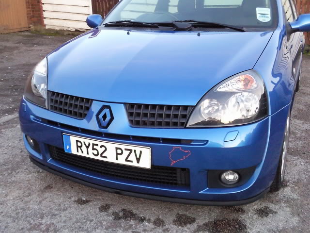

* and while on ebay i brought some nurburgring stickers cuz i shall be there early next year :D

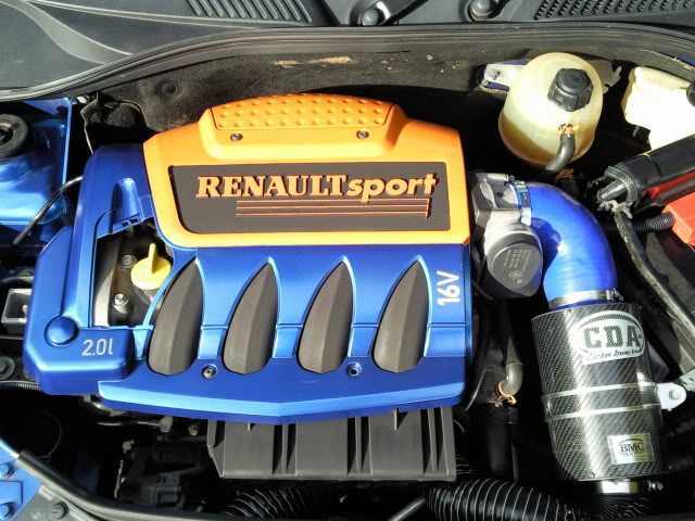

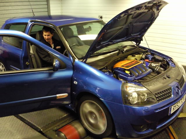

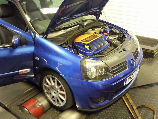

then it was a case of putting it all together and alot of painting over the weekend decided to do the font diamond while i was at it and the i was off to the power station for the rolling road to see what its like half way through my mods and it pulled 180.9 engine power and 178.4bhp corrected power with 149.4lbf.ft i was quite chuffed off a filter and full exhaust

calipers :
getting strapped down and the run :

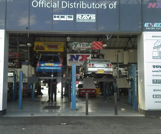

just thought id add the pic i found of it at the exhaust shop with the big boys lol it must of been the slowest car there and its not exactly slow :S lol
yeah think they have there's around 4 or 5 of them now and when he was talking to me i think he said the yellow gt-r skyline is pushing around 1000bhp he said its insured for £150000, yeah got some pics now so heres the contaversial ph-quick on a cup lol :

Is that the CAF running along near the fuel rail protector ?? :eek:
yeah why is that bad lol ive made room for it and its not touching anything thought it would be quite good as it will heat the air up abit so it wont be always running cold
It could be better fella. Air has a fair bit to travel plus its in contrast to the the forward motion of the car with it running parallel
its air it shall get there some how lol i didnt wanna mess about too much and every where else was abit hard to get to where do you recon then? might be up for having a change around if it will make some differance
Im not sure of the lay out on the ph2's.
Going by other folk most stick it through the bottom grill area.
The less bends and distance in the CAF the better the flow to the IK :)
well its only got 2 bends at the mo which will be the same as the lower grill plus in the lower grill it has to travell more distance and im really trying to keep the stealth look so i dont want a trumpet in the lower grill giving off that i have a IK, "no show but lots of go" :D
Aye but its up stream. Running it horizontal is going in the opposite direction to natural forward facing flow
You could always put the trumpet beind the grill ;)
nah gunna keep it there its easy to get to to move as its always apart getting stuff done might change it when its all finished thow but for now it will do just fine for me :approve:
