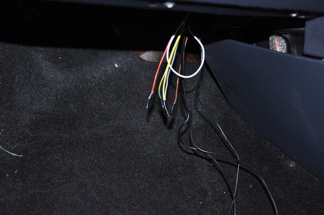

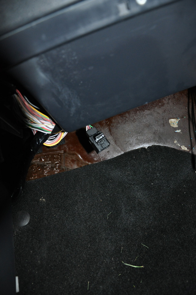

there are loads of wiring behind the glove box and that have been cut and a connector that have nothing plugged into it. does anyone know what they do?
as far as i can tell, everything in the car works
Regards
James L
i have just noticed that the alarm doesn't work. so i assume these are the wires for the alarm?
James L
That's where the immobiliser is usually fitted. Inside the lower dash so it's close to the original immobiliser(in front of the gear shift) and right next to the ecu wire loom. It's common for 172 immobilisers to pack up completely when left sitting. Since yours is at 51k, I'd assume this is what's happened.
