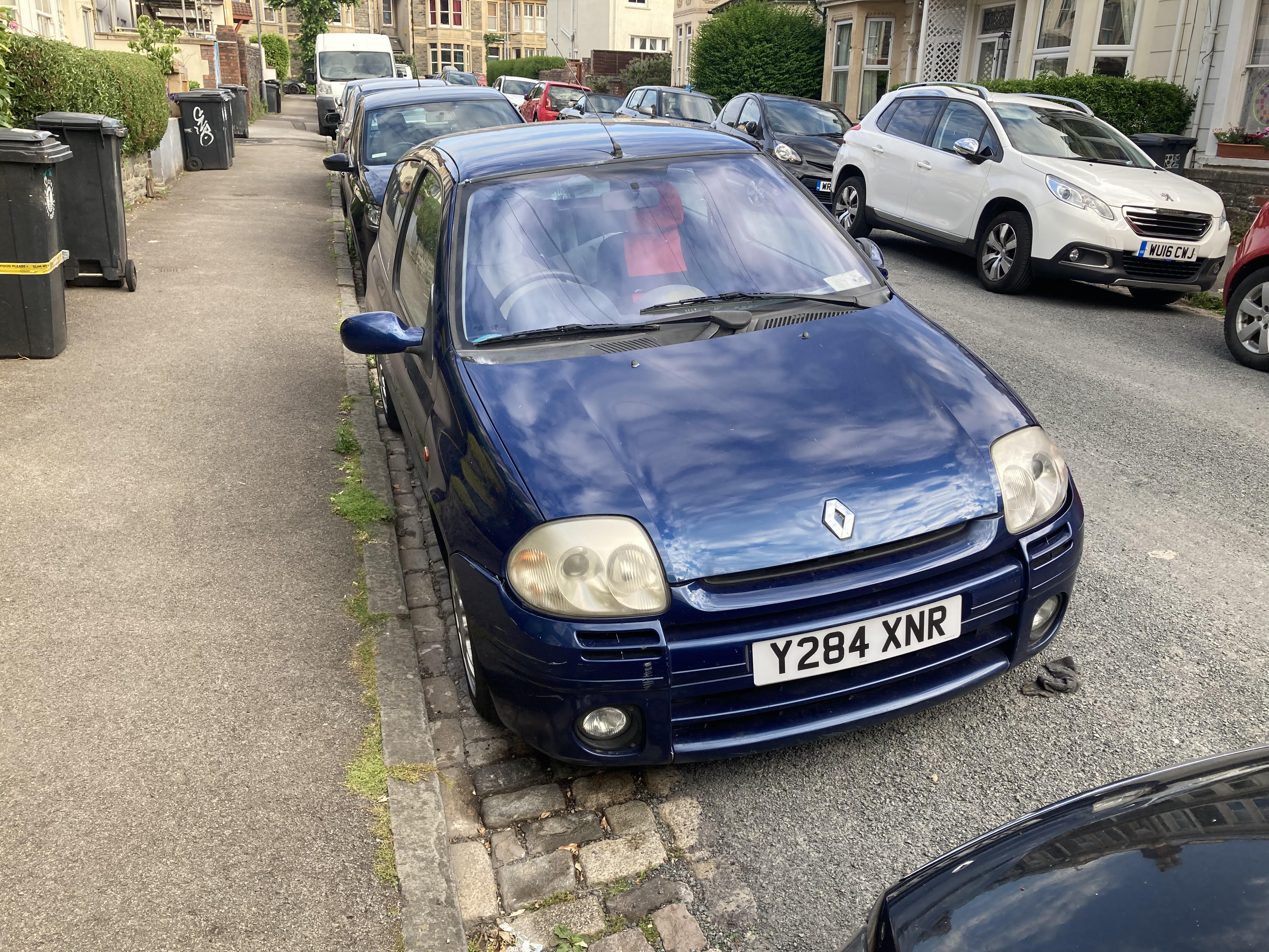

Fitted a new PAS (from ebay for a Clio same size & same connectors etc one stamping the same the other different) removed noisy one that was providing hydraulic power and now nothing. Turned lock to lock static and with engine running - fluid level not dropping? No weird noises - new belt pulleys etc very quiet just no PAS?
As the PAS fits even if a different capacity should give some assist - it gives none.
What do I need to look for.
Done in road - slight hill but jacked up nose up for the lock to lock.

On a hill - quite a camber - tried 30 lock to lock - nothing so far - and thought turning car around might help?

OK no laughing - but sit down for this.
Im a fellow of the IMECHE, work at the world most famous aerospace company and was a fitter for 10 years. Topping up a brake reservoir with steering fluid does not translate to power steering - topping up the steering reservoir and seeing fluid come out the pressure switch does. Thank god for syringes I say!!
anyways works perfect - thanks all.
At least now I have a technique for changing a PAS in the street without removing the light or front panels and a SHAFTEC HP1233 does fit a 2001 CLIOSPORT 172
