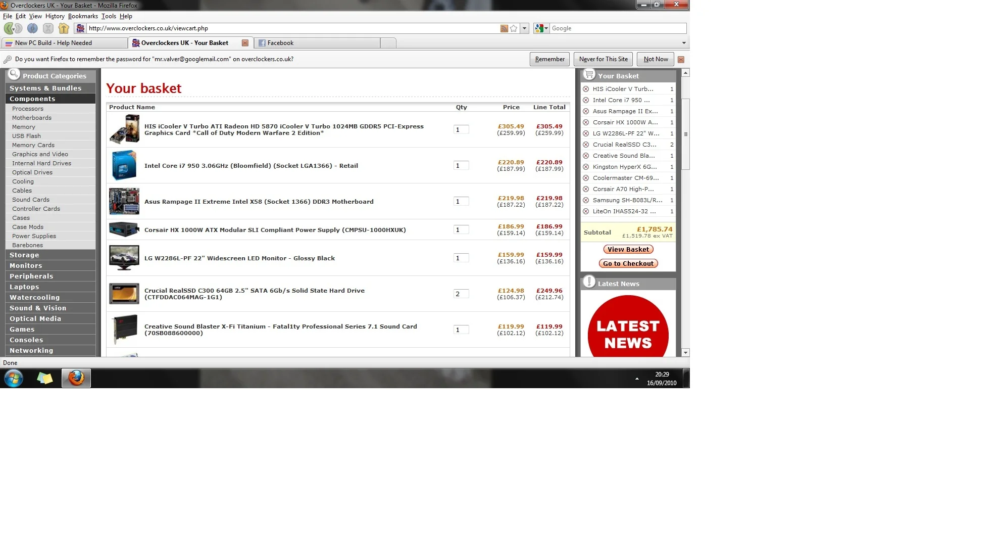

I have a budget of £1800 to build a new computer. Its been five years since I built my last computer so I am quite rusty when it comes to what I actually need.
Below are the parts I have selected, can anyone advice which parts could be changed for different ones bearing in mind that the computer will be used primarily for 3D rendering (3ds Max) and gaming.
I'd like the cost to be slightly less so I can get a decent 22" monitor and keyboard ect...
Also, would I need a sound card to hook up to my speakers (Optical).

I'm looking at doing similar with a similar kind of budget (well a bit more anyway)
Firstly, I'd get the i7 950 over the 930, for the difference in price it would be rude not to.
I'd also spend more on a better case.
CD drive cost seems excessive for what it is, see below.
Also, that GPU has a water block but you haven't specced or priced up the other necessary equipment to run that.
The 6000 series cards are going to start being released any day now (which is why I'm waiting)
My spec currently (ignore the 5970 as I'm going 6970 as stated) and I'll also be adding a full water cooling setup.

I would make a lot of adjustments, plus I wouldn't buy from Overclockers either personally. The GPU you selected, you know you will need a full on watercooling rig for that? If you don't have that well you can't have that graphics card. To be honest not a big deal anyway though.
So for me this is what I would do and get it all from Scan. Overclockers are awful when it comes to problems with returns etc, even on here you will find plenty of people who aren't happy with them.
3XS bundle
Slik core i7 bundle at 4.2ghz overclocked (Asus Rampage III, i7 930, 6gb corsair XMS memory, Prolimatech Megahalems Cooler, 120mm fan)
£704. Sure if you call them up they could add the H70 cooler if you really wanted it. Scan are pretty decent when it comes to things like that.
http://www.scan.co.uk/Shop/Computer-Hardware/Overclocked-3XS-Bundles
ATI 5970 sapphire card (slightly overclocked)
£446
http://www.scan.co.uk/Products/2GB-...DDR5-GPU-735MHz-3200-Cores-2xDL-DVI-I-Mini-DP
Will keep the same Bluray drive
£96
http://www.scan.co.uk/Products/Lite...DL-x16-DVDR-x6-DVDRW-Writer-OEM-plus-Software
Corsair Force SSD drive (faster read and write speed, nearly same price)
http://www.scan.co.uk/Products/60GB...orce-SSD-Read-285MB-s-Write-275MB-s-w-bracket
£110
Case Corsair Obsidian 800D
http://www.scan.co.uk/Products/Cors...-Case-with-Side-Window-3-x-140mm-Fans-w-o-PSU
(£206)
Corsair 1000 W HX Power Supply (modular and very under rated, the internals are actually two smaller power supplies, they aren't 500w each either. The 1000W corsair is actually closer to 1300w true output.)
http://www.scan.co.uk/Products/1000...dular-Power-Supply-UK-Version-5-Year-Warranty
£175
£1737 total. But similar spec, better components for a few parts though and more suitable. Otherwise that original 5970 you spec'd up would need a further £150 - £300 spent on cooling it. To get a decent rig. Cheap case isn't worth having. And a 650w PSU with an overclocked i7 and a twin GPU 5970, not a good idea.

Thanks for the reply's everyone.
If I were to buy all the items you have listed I wouldn't need anything else? No extra cooling or cables etc?
Would it be a better idea to buy this? or is it going to be cheaper to build the system myself?
