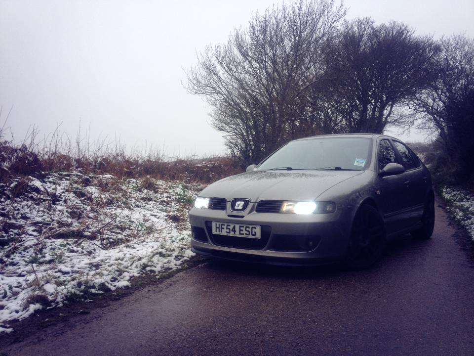

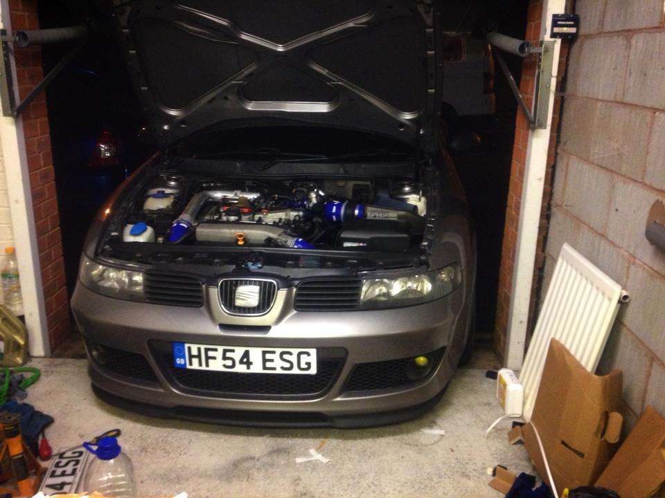

So i decided to delve in the vag scene, selling up my Clio and moved on to this 2004 seat Leon Cupra r. the fun factor and rawness i loved about the clio isnt there but for build quality and comfort its great, (soon to be ruined by me)
first pic on the day i got the car
car already had a few mods done at AMD Essex and the car pulls great

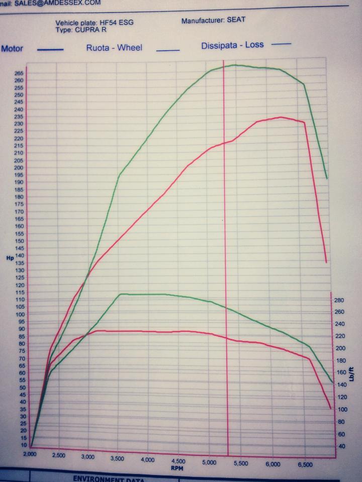

They go well with a map. Mine was 275 bhp 289 ibft iirc.

With just a map? Hello dyno lottery. AMD rollers per chance?
Yeah was Revo (I forget what the timing and boost settings were) on Stealth Racings rolling which is usually very accurate.
Car was about 5k miles old.

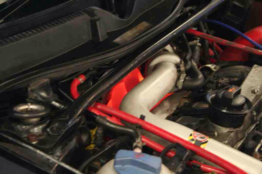

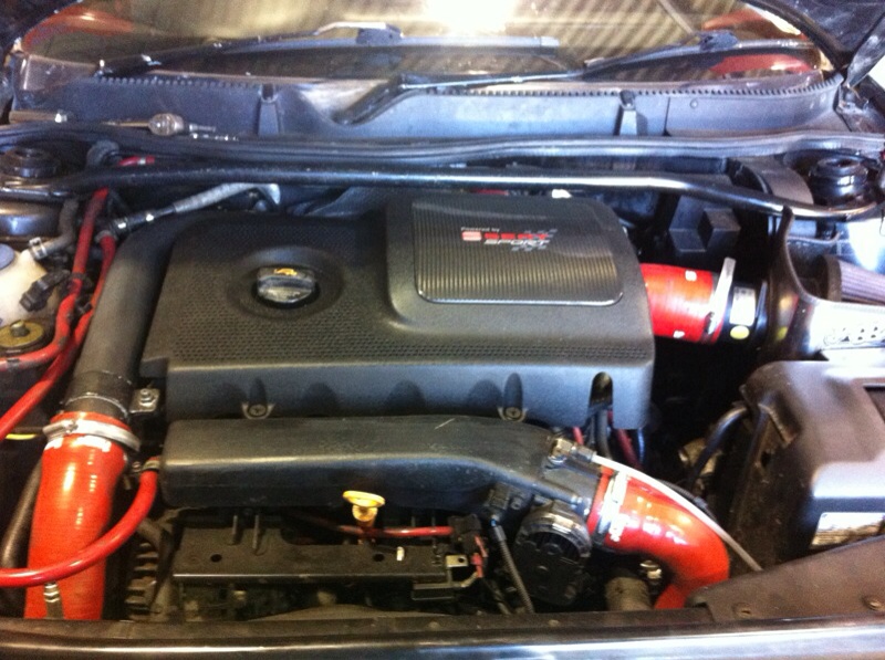

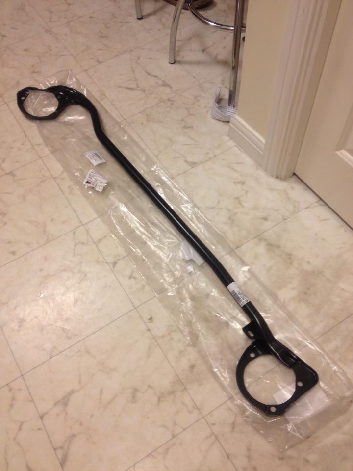

so after waiting for a week for TPS to get this in stock a audi s3 strut brace, iv also got new gaskets for the rockercover, throttle body and intake manifold so i can tart up the engine bay a bit as it just looks dirty,

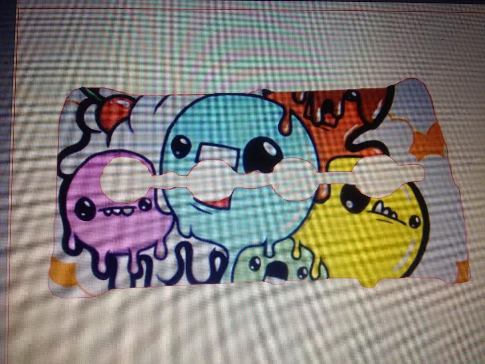

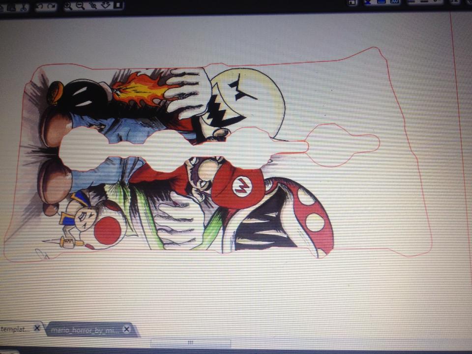

iv been toying with the idea of having my rocker cover airbrushed, not sure yet but ill probably get it powder coated in red crackle effect as all the silicone hoses are going to be changed to black
heres a couple designs i threw on firstly the iscream's
and the zombie Mario i found on the net, not sure it will be to much. but would be a good way of getting attention at shows to advertise.

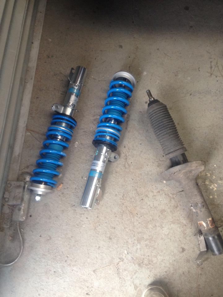

coilovers turned up today :) hopefully il fit them on Monday and get it feeling more like a sport model and not a boat

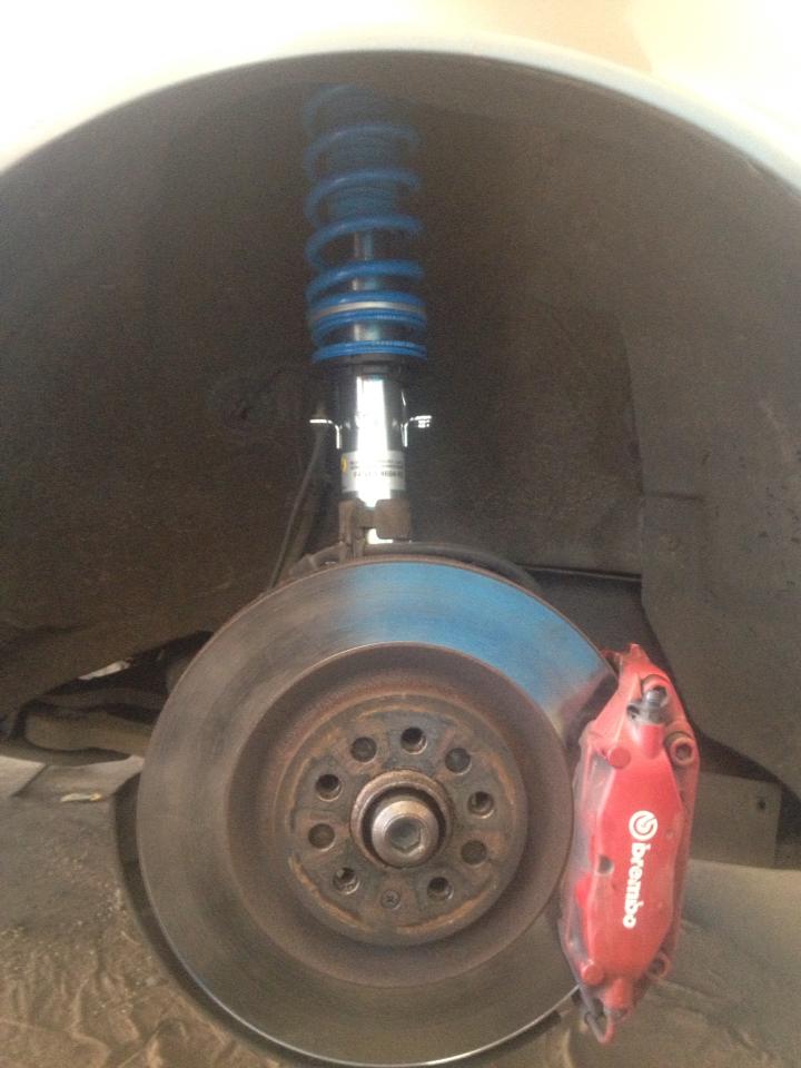

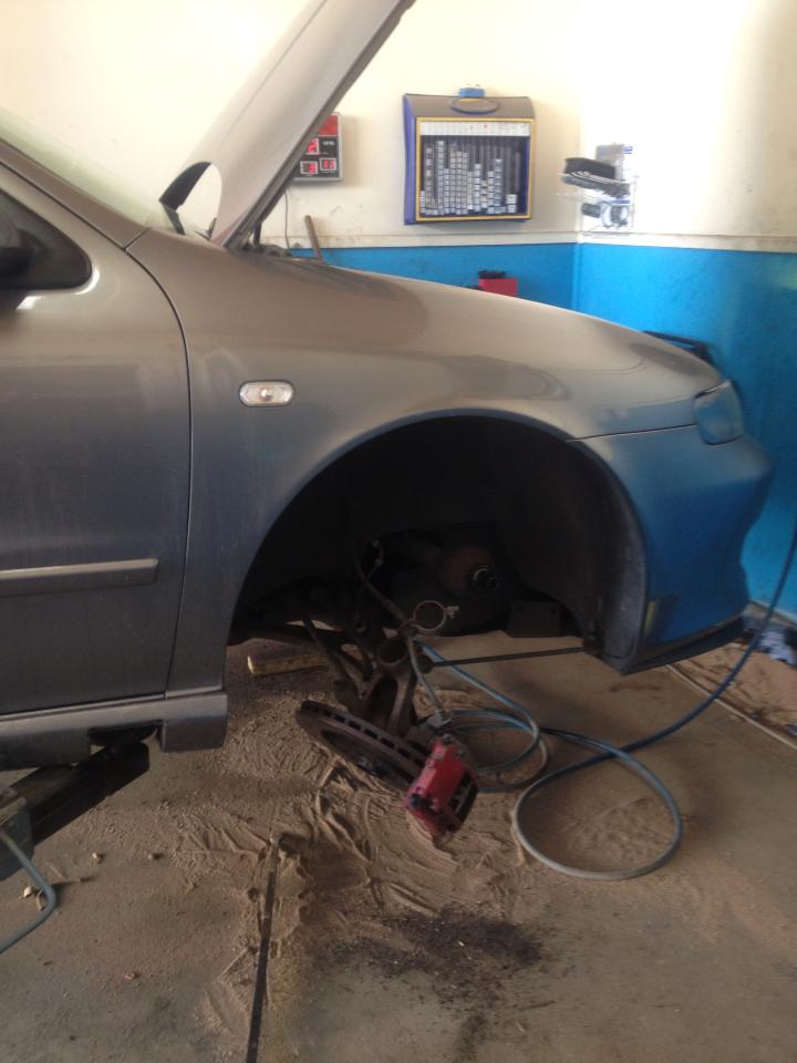

fitted my coilovers today, stupid VAG design doesn't make it easy removing the front struts that's for sure !
drive shafts out, drop-links disconnected, lower balljoints loosened off. what a ball ache to do !
Things kind of went downhill from there after bating 10 belles of s**t out of the hubs to finally get the struts out.

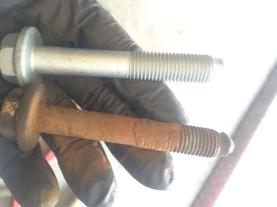

The bolts that secured the strut in place were IMO excessively corroded so i ordered up some new ones of them

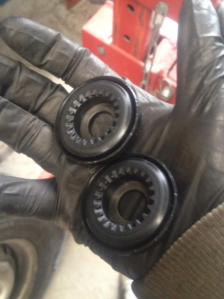

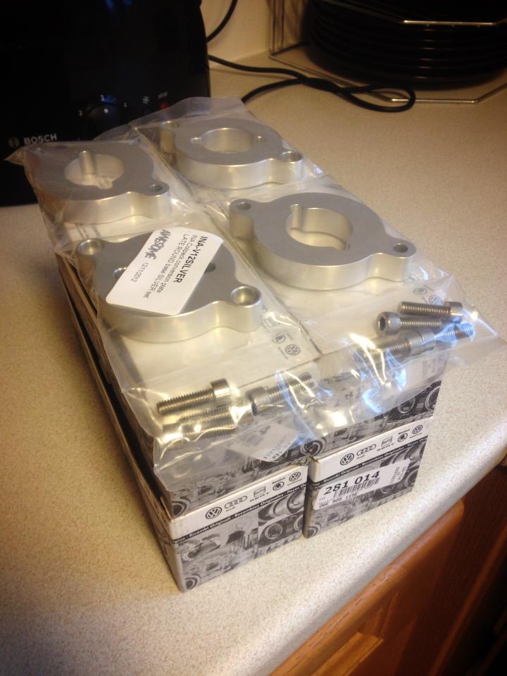

whilst i was swapping the top mounts over i dropped one of the bearings promptly it burst in to 1000 pieces, ball bearings all over the shop so i ordered another set of them, after inspecting the other bearing they were shot anyway.
so new OEM bearings

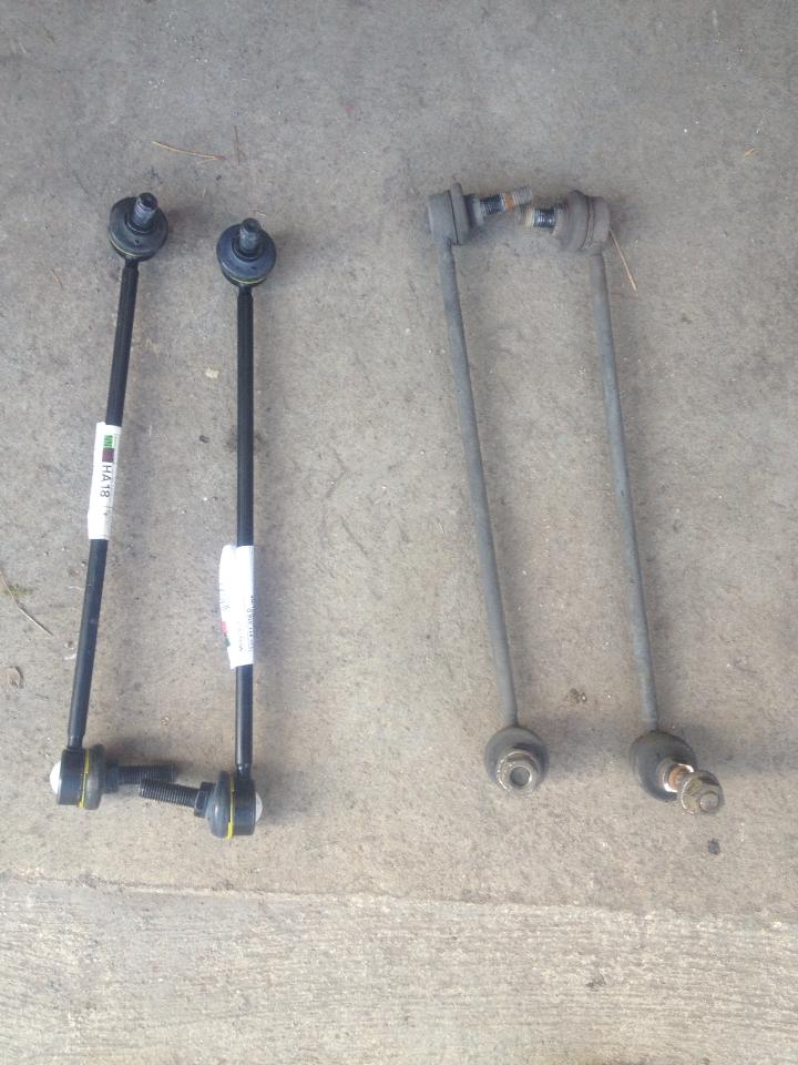

whilst i was at it i thought id put some new drop-links on to for the sake of whilst i had it all off.

That's a bit OTT. All you need is a lump hammer and a big bar. The struts soon come out then..;) Tried and tested many times.
Re: New prodject BAM Content
drive-shafts were bottoming out on the sub-frame so i had no choice but to pop them out, anyone thats met me im only a small lad, so beating 7 shades of s**t out of it is more like tapping it lots of times haha
didn't help that the bottoms of the struts had corroded up making it hard to get them out, i think il be investing in a hub spreading tool
I stand corrected. Never had that issue with any other MK4's although it can be a b**ch..

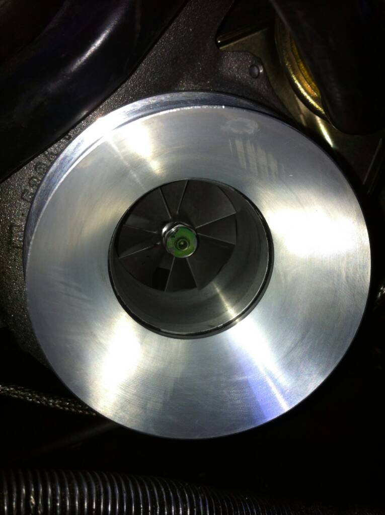

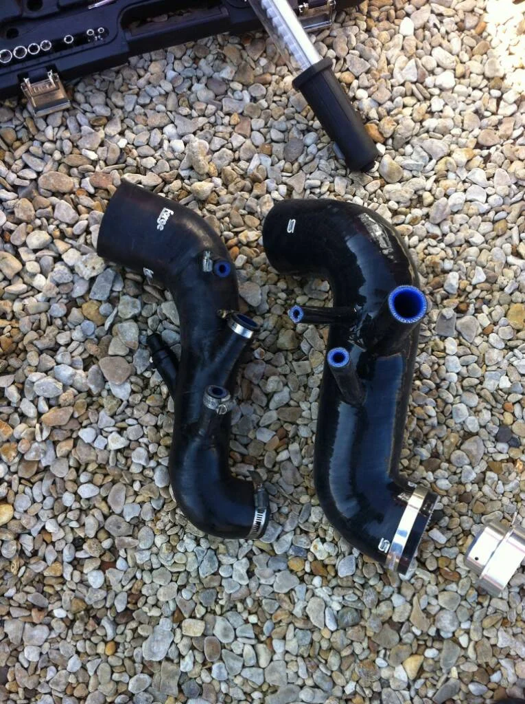

Yeah its tapered
Thats how the adapter sat on the turbo. Pretty sure there is a newer version out now. Which is like the forge, tapered silicone. No billet adapter.

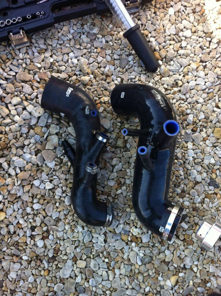

Its the turbo intake pipe. Its about a third larger than oem. Allowing more air to be drawn in.
Plus the soft oem rubber actually sucks inwards (collapses). Starving the engine
