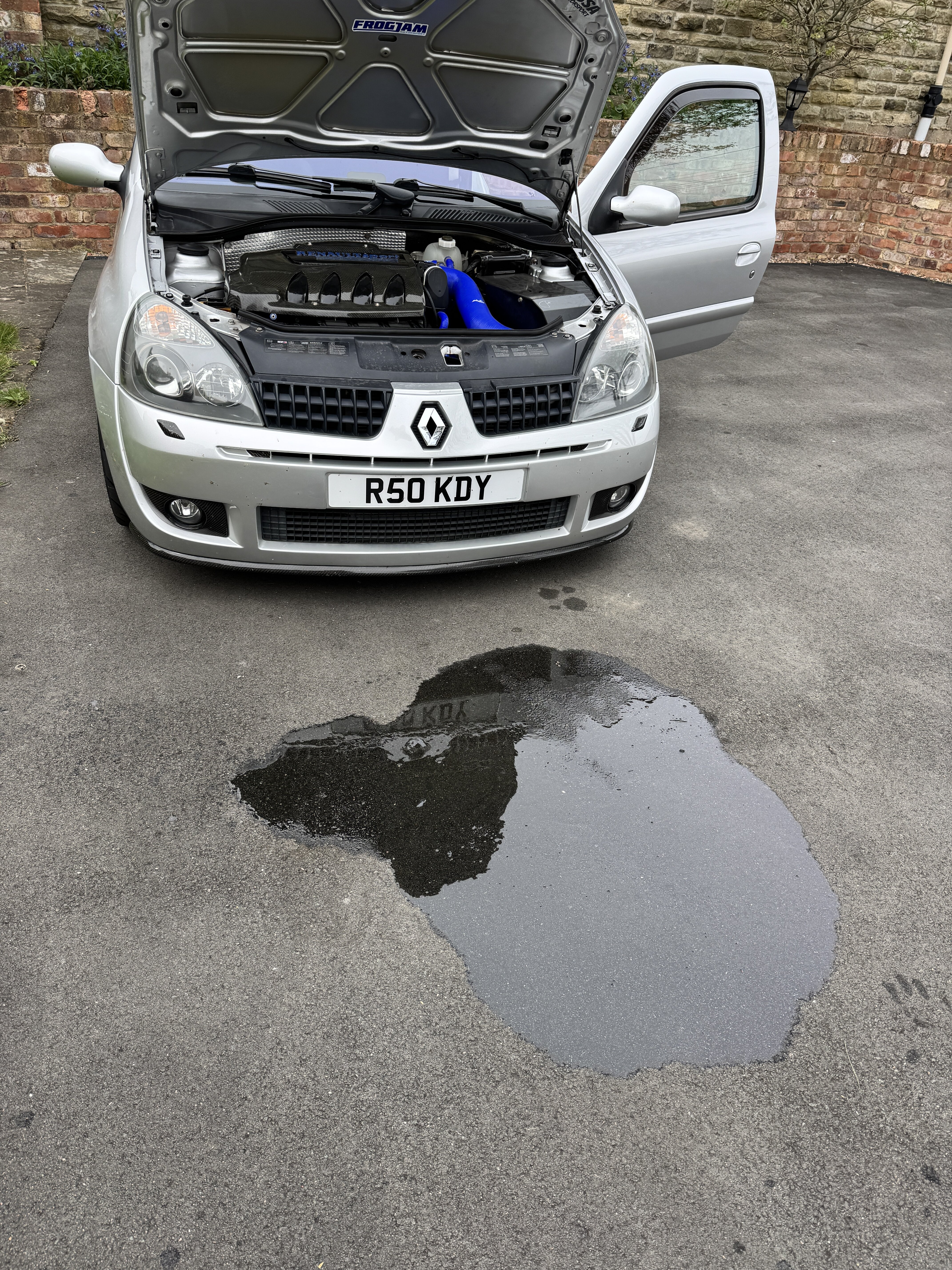

Decided to top up the gearbox oil as I have a leaky seal and it was definitely beginning to feel a bit less smooth on gear changes.
I followed the hosepipe guide and was waiting for the leak out but the hosepipe created a perfect seal and muggins didn’t think to put a catch tray down…
Waste of £15 millers. But changes are now silky smooth again.

I had to put a sealant down on my driveway as it was such a state due to my incompetence. But that above is an impressive amount to lose.
EFA
Mine isnt sealed but there has been many car oils all over it.
Im shocking when it comes to catching the old oil during a service but my favourite was loosing most of the gearbox oil when the drive shaft fell out during a ball joint change!

Read on one of the guides to get a funnel and hose pipe to get it in the hole. Then it would leak out the hole as it was full.
However the hosepipe somehow created a perfect seal so when I pulled the pipe out it then leaked everywhere.

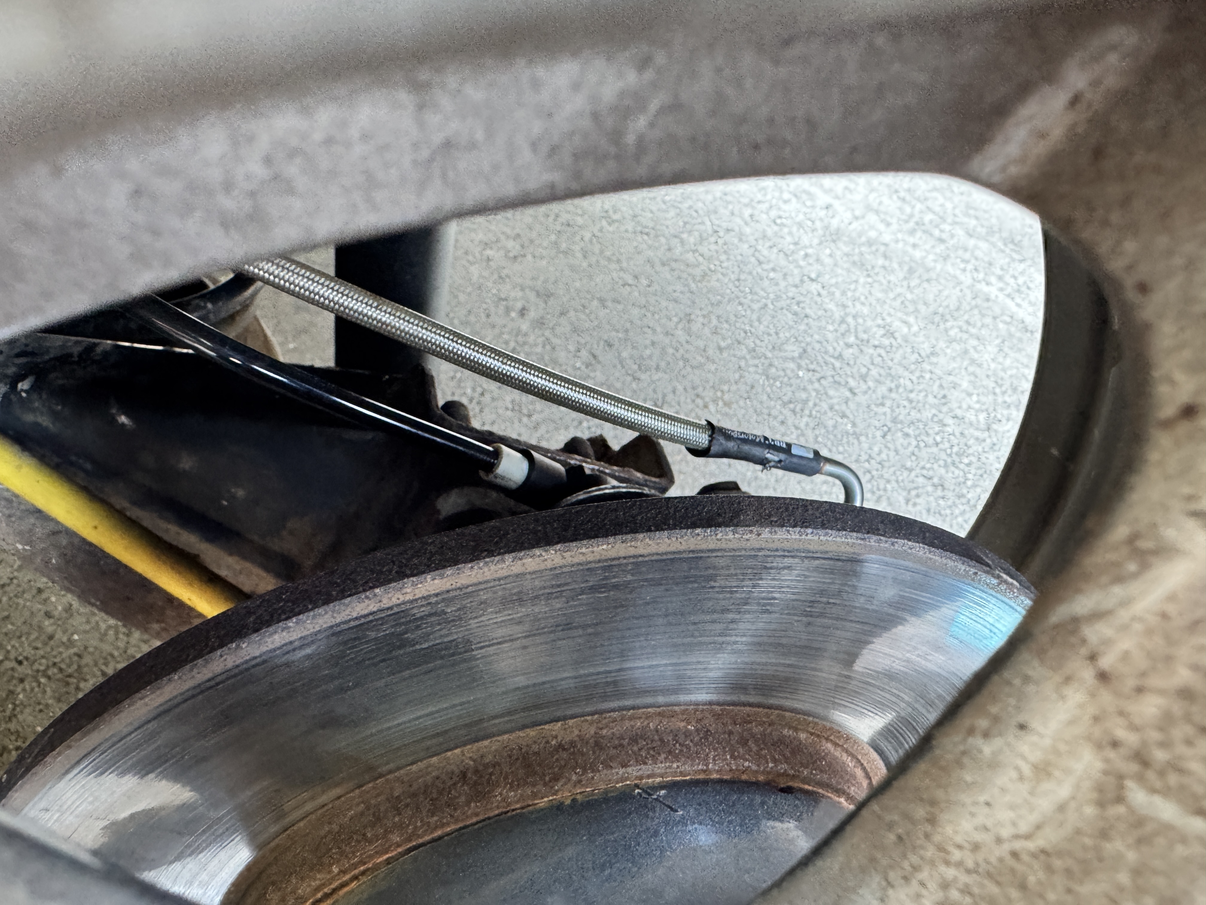

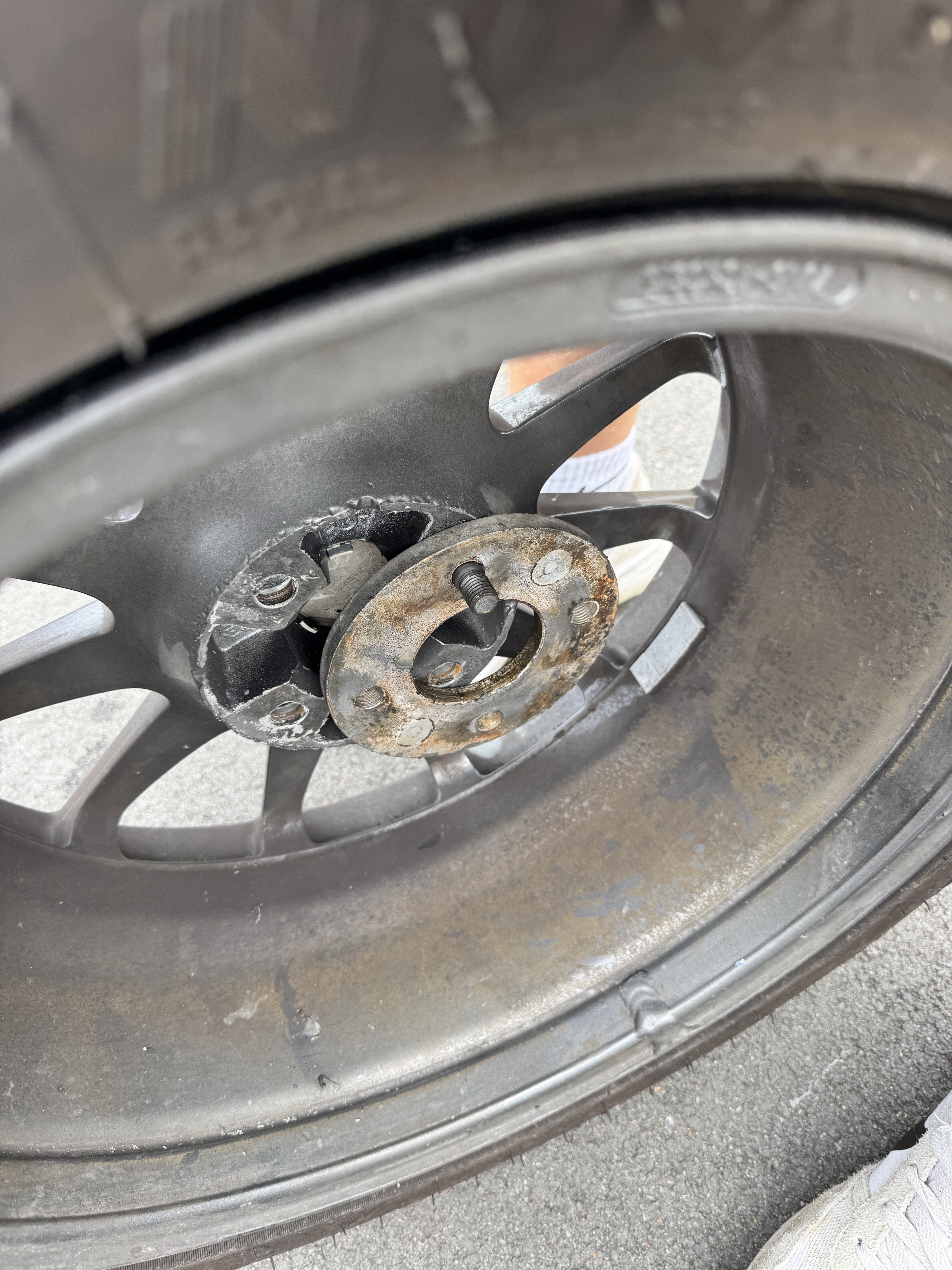

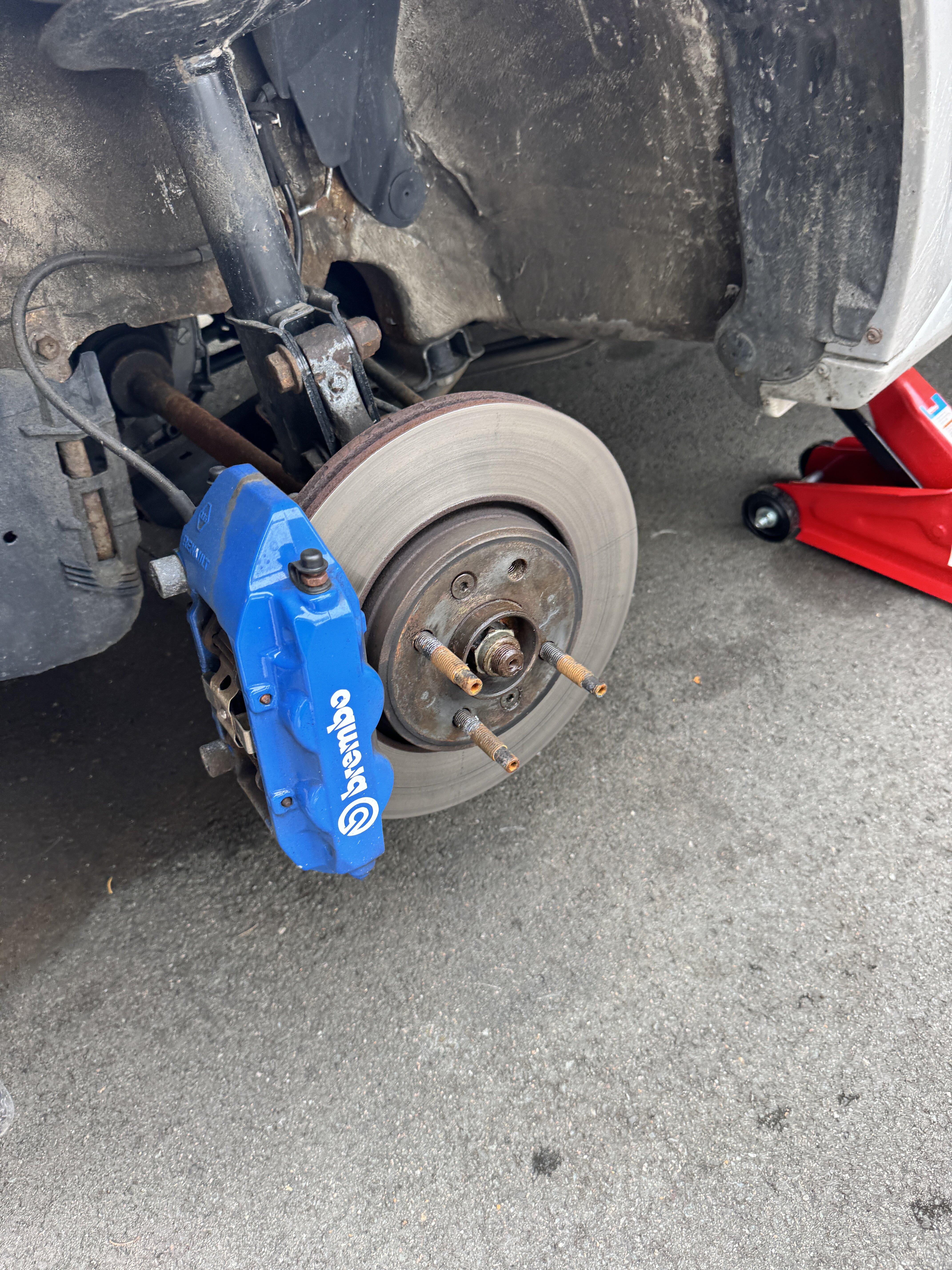

Thought I’d give changing the pads a go today. But got stopped in my track by the wheel stud and spacer coming off instead of the bolt…
Managed to screw it back in but I’ll probably need to do it again with loctite. I’m guessing they should be replaced regardless? I also assume it’s a pig of a job?
I did have some wheel wobble over 70mph so that explains that. Whilst I had the wheel off I did t see any leaking coming from the driveshafts so not sure why the garage has said that’s the source of my leak? All looked bone dry, leak seams to be coming from the input shaft.
Over-tightening the studs can stretch and weaken them, so if you think that’s happened, it’s best to replace them, though I guess only you'd really know that for sure. Spray some brake cleaner into the hub to remove any crap. Then, apply some Loctite to the studs and tighten them to around 20 Nm. Not a difficult job.
You’d definitely see oil if it was leaking from the CV boot at the box end. It would be all over the subframe for a start. But oil moves around, so it’s better to clean everything up with brake cleaner, dry it off, take it for a run, and then see if you can pinpoint the leak more accurately.
