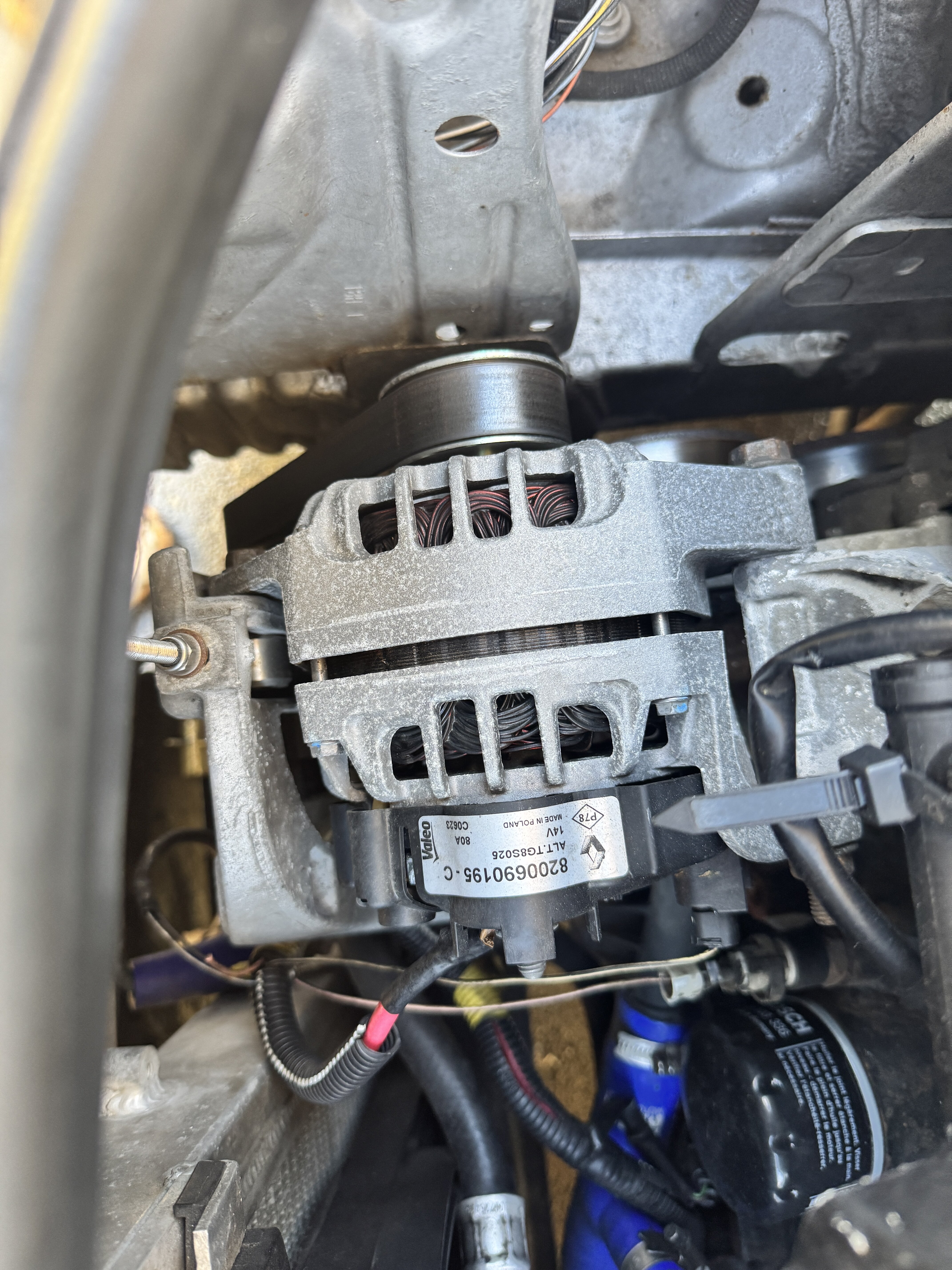

Voltage should be 13.8+ when running. Id verify with test meter.
Needs scanning with clip to see whats stored. Might be pedal, tb or wiring at a guess.
im f**king useless with a wrench, as you can see by this thread.
checked with a volt meter and was much lower, highest it got to was 12.8v
Throttle bodies were redone by MS engineering recently so I am pretty sure thats ok. wiring very possibly as ive had all sorted of electrical gremlins but thought the UCH had sorted that.

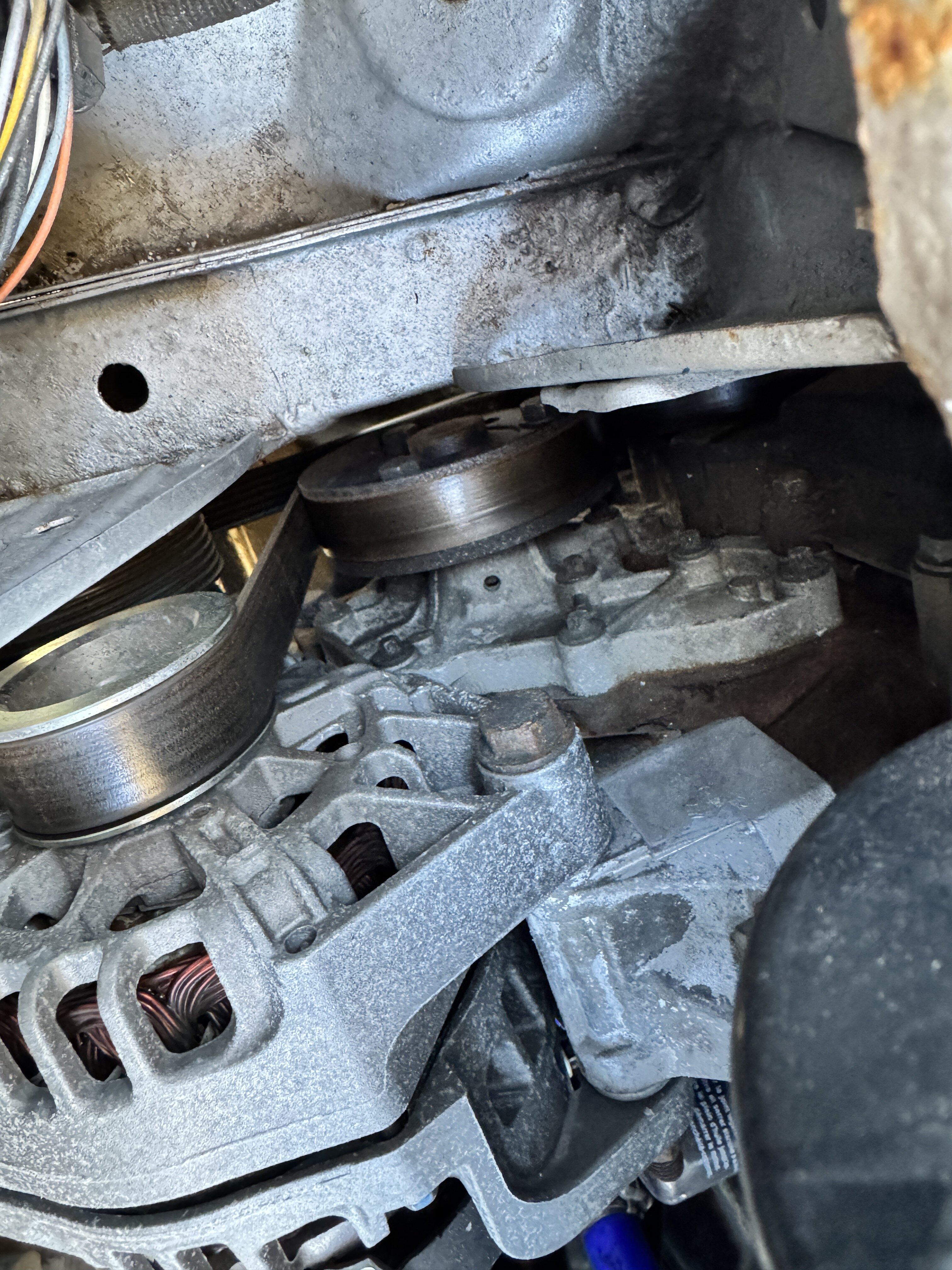

So battery light is on and when the car is running your battery is showing 12.8v across the two terminals when you check with multi meter? If so your alternator is almost certainly done. You’ll enjoy changing that at the auxiliary tensioner if you’ve still got all the ac in place mate 😂😂
This is my set up but it doesn’t have AC
Gave everything a wiggle and the throttle pedal connector a clean and plugged back in. Started up and all lights out and running normally again, ordered a new throttle pedal. Voltage is still low on the multimeter when running 12.5v
Aux belt was slipping and not charging, new aux belt and a new throttle pedal thrown at it. Saved me a few quid and lots of pain hopefully.
