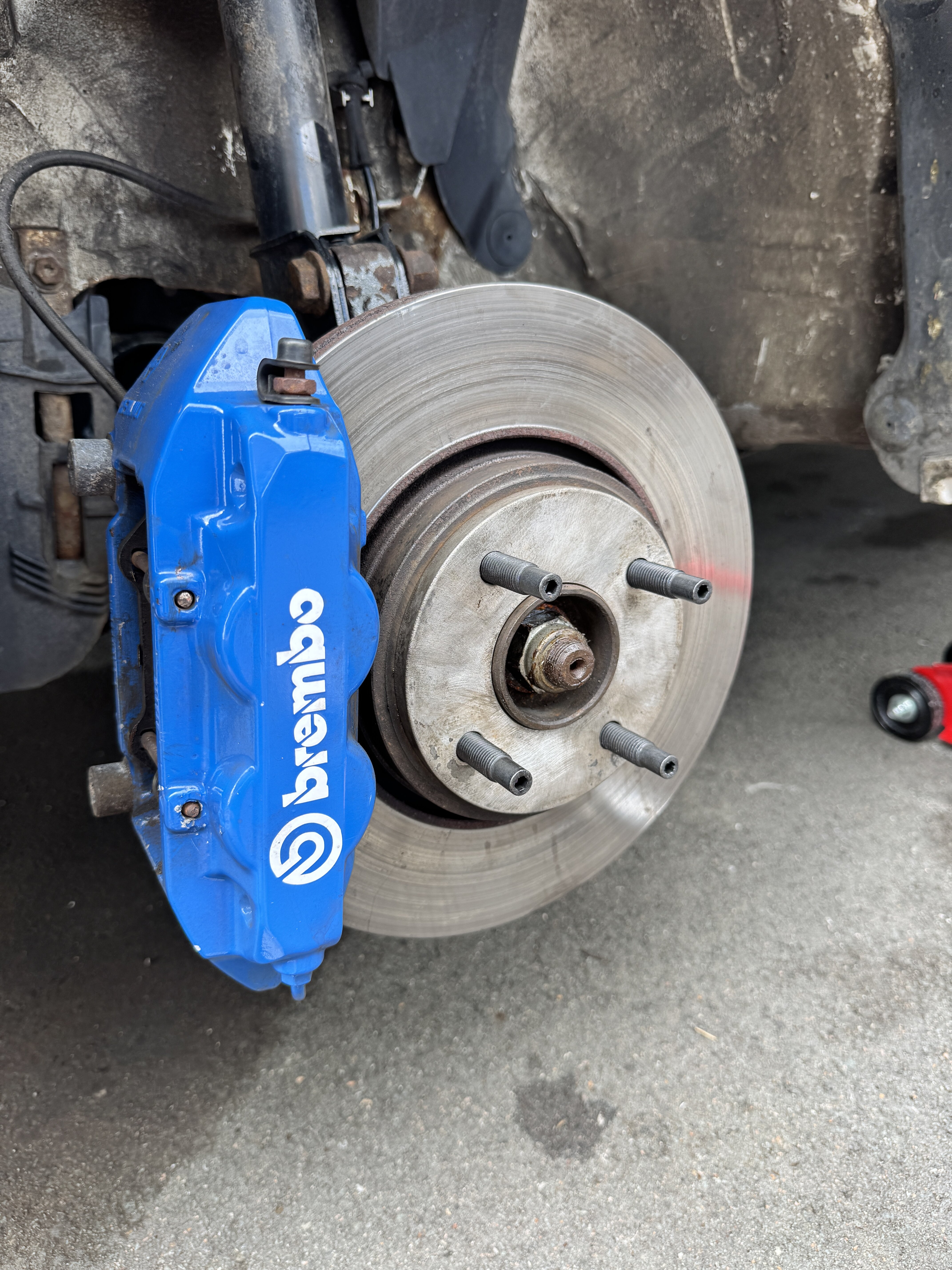

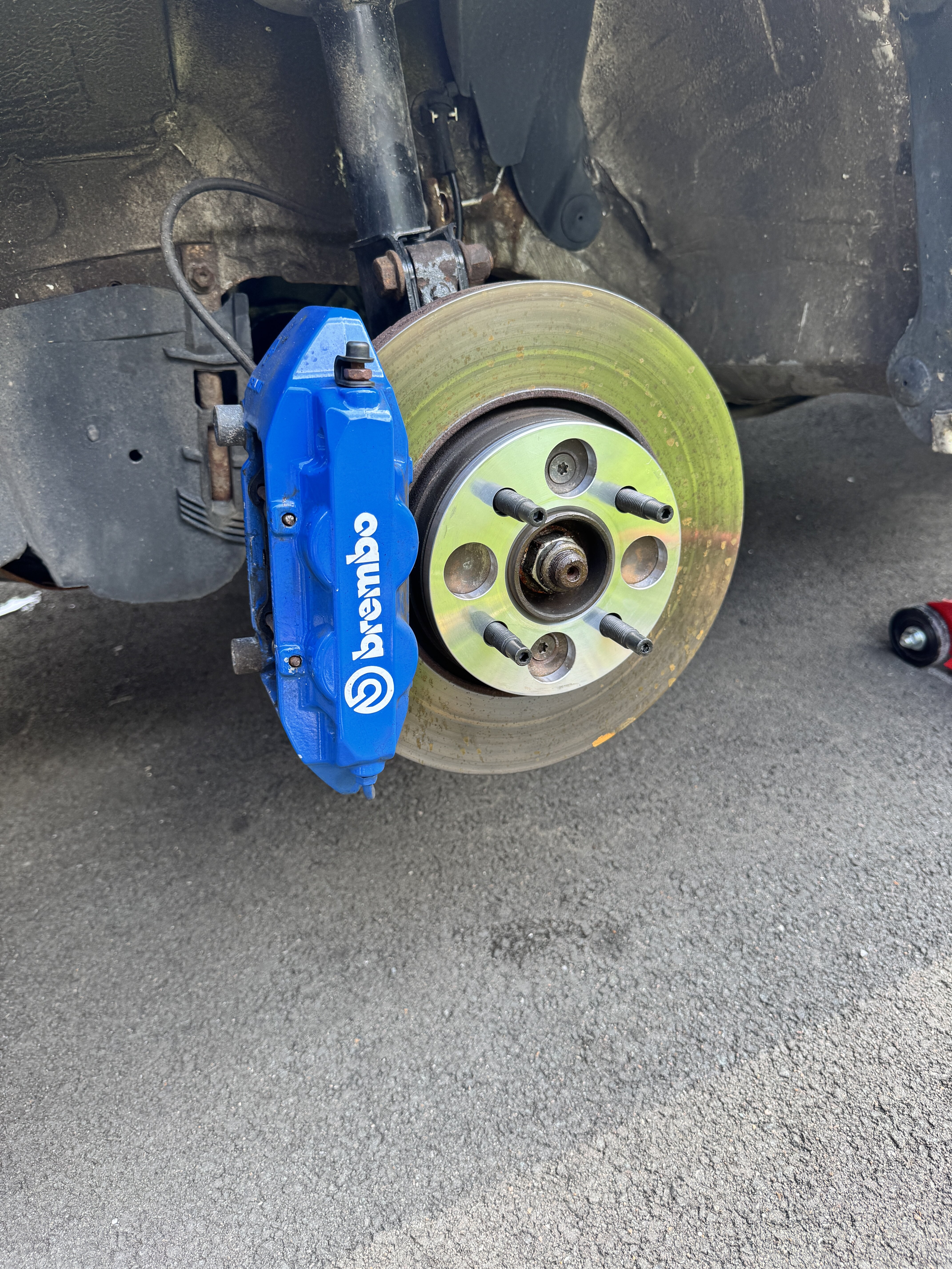

When I took the car in to get the tyres swapped over I didn’t think to tell them not to overtighten the nuts. Anyway they may as well have welded them on it was so tight.
Frogjam to the rescue again and some fresh studs and nuts for peace of mind.
I’ve been chasing this wobble and turns out it wasn’t the wheels, £400 down the swanny!
and think I’ve found the culprit which is this 50p shaped spacer that looked like someone’s been playing frisbee with. Ordered a couple of new ones from pure and will fit next weekend to see if that solves it once and for all.
Anyway drove 300 miles to Newcastle and back yesterday and sans wobble over 70 it was great. The speedo even came back to life on the drive there. Then decided to stick at 70mph the whole way back.

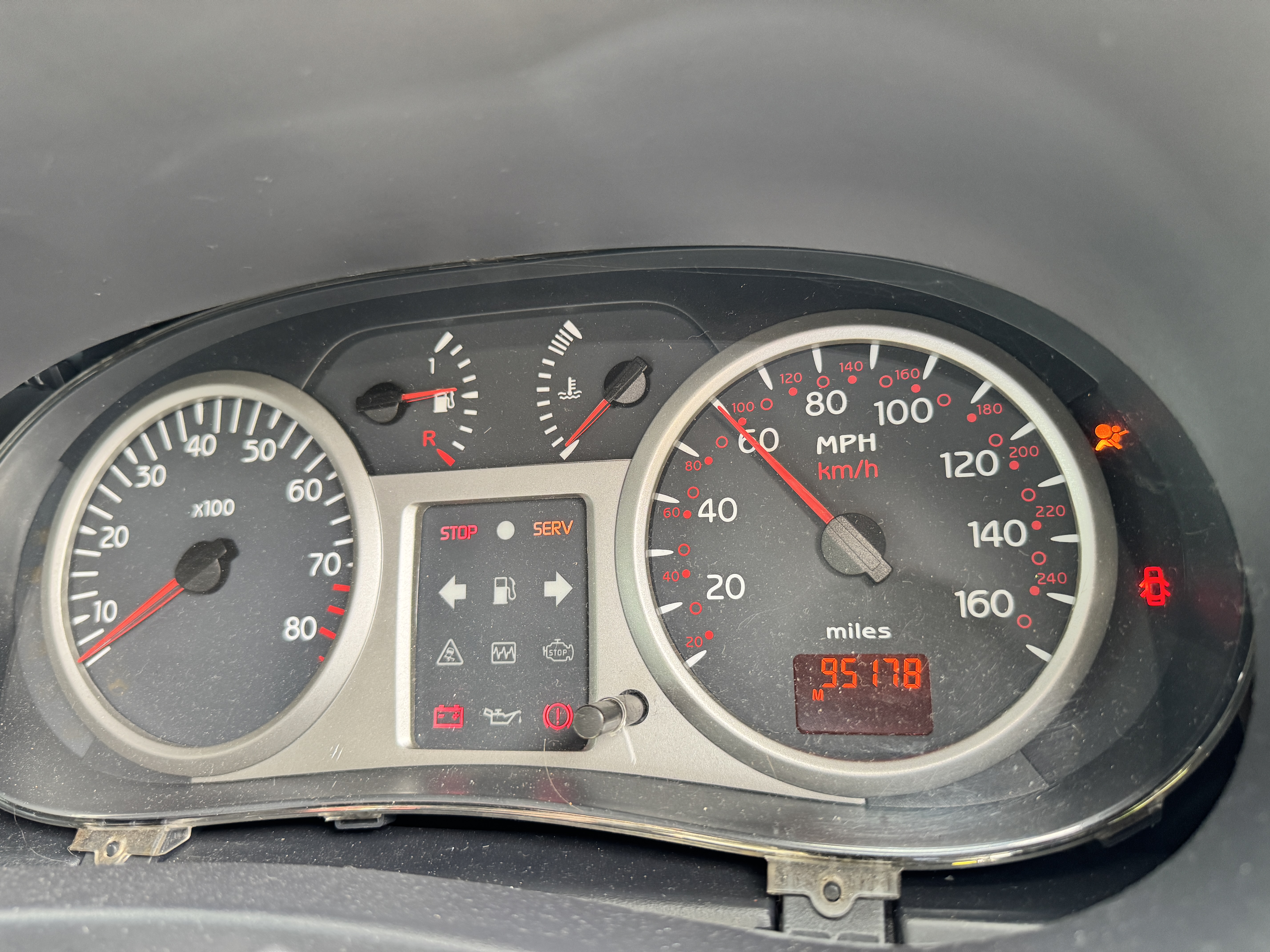

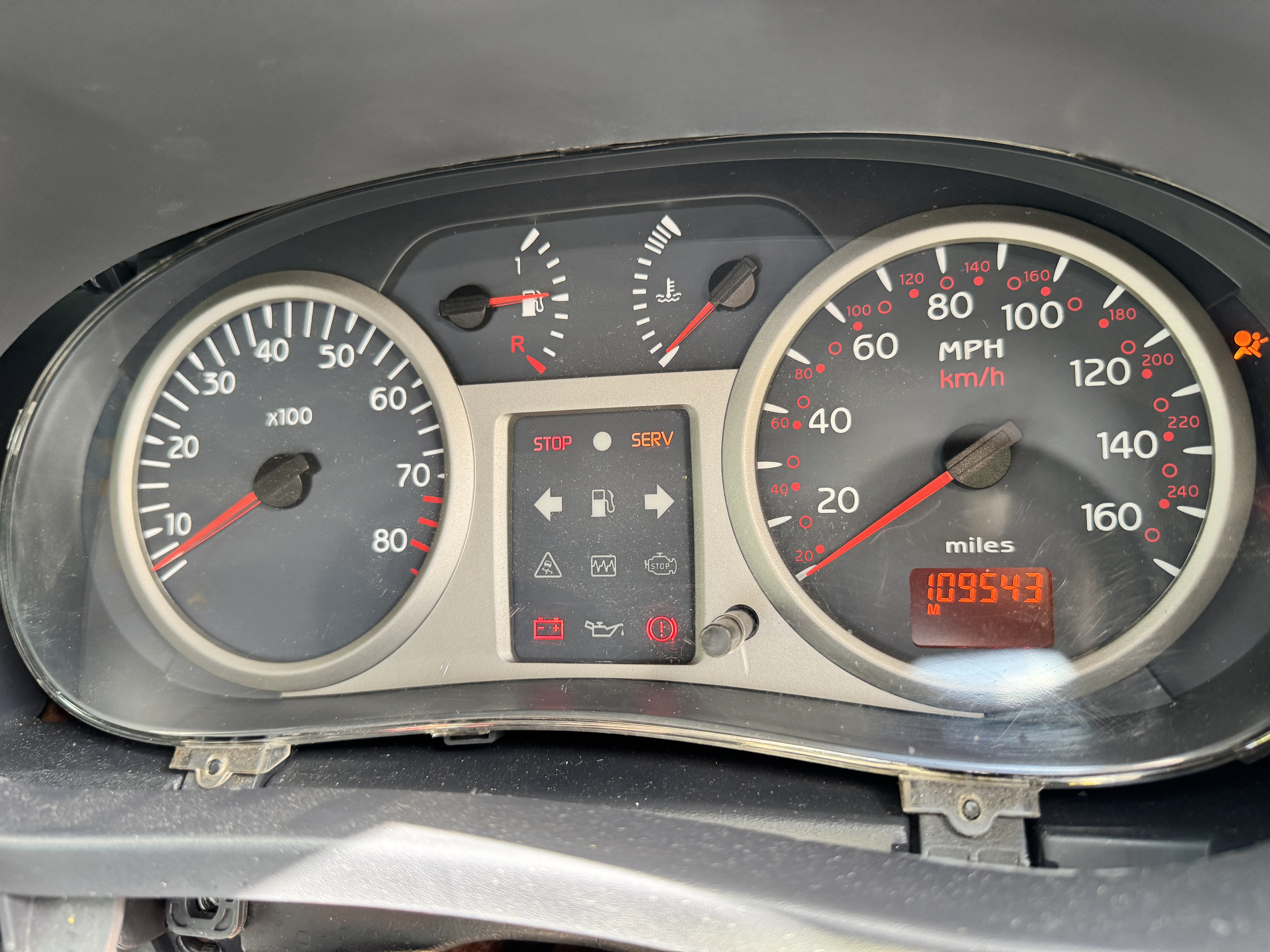

New/used dash clocks arrived today so got straight on fitting them to see if my speedo issue was resolved.
BAM!! Sorted! I have unfortunately now added 15k miles to the car. Who thought the mileage built into the cluster was a good idea?

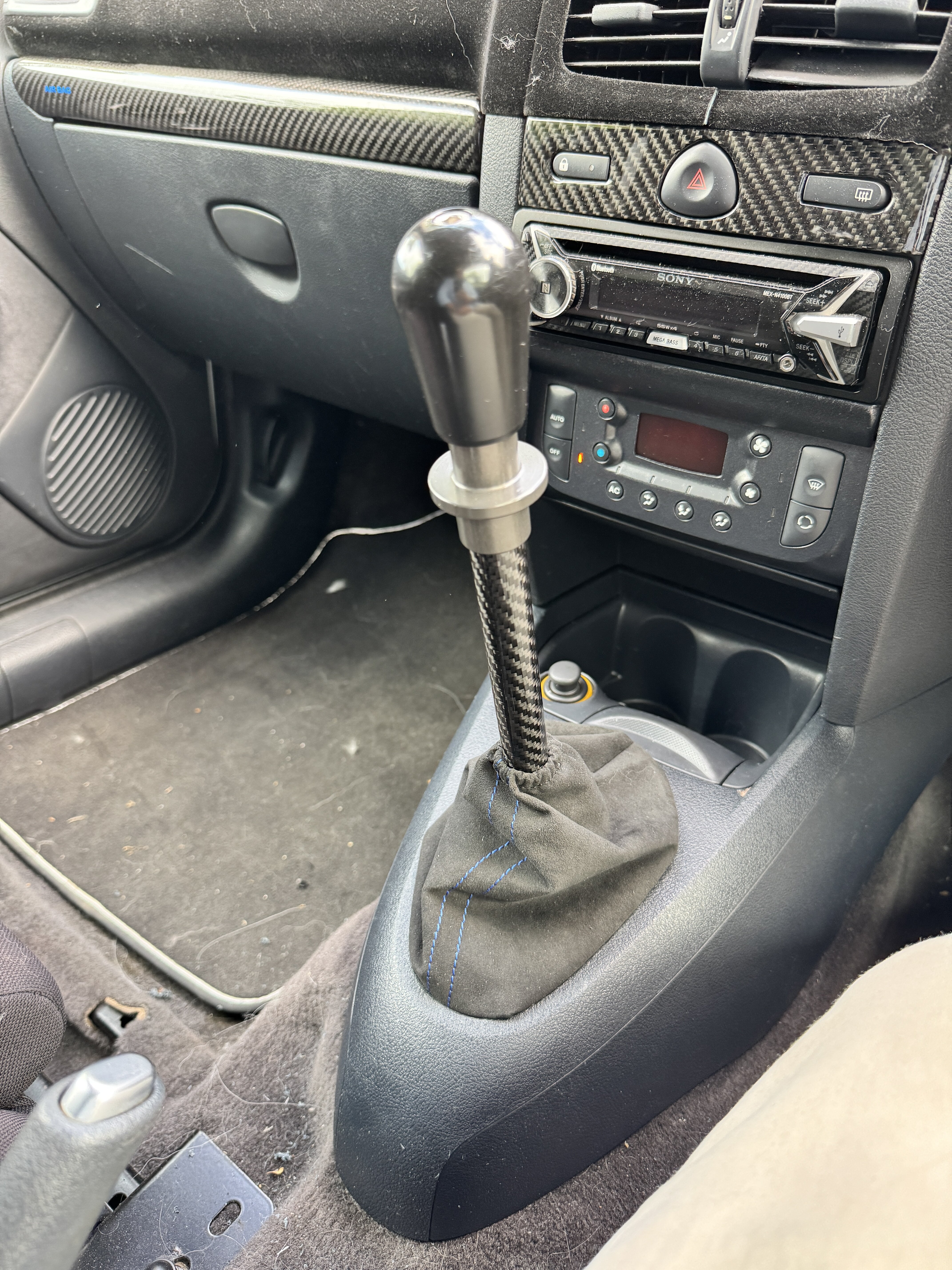

Also fitted new suede gaiter with blue stitching because. Oh and cracked the dash leaning on it so will have to glue that back together. I hate the flocked dash anyway. Might buy a spare one and cover it in Alcantara instead to match the roof and A pillars.
Took it for a drive to check everything over and I’m not sure if it’s the placebo effect knowing everything is working for once but the car seemed much faster.😅

Just stick your old clocks back in for now and see if you can find some closer to the mileage mate
Saves ruining your cars history
I’m planning to send the originals off to get reconditioned. Found someone on fleabay. Interesting that it’s that easy to manipulate the mileage though.

Fresh spacers arrived so got them fired on.

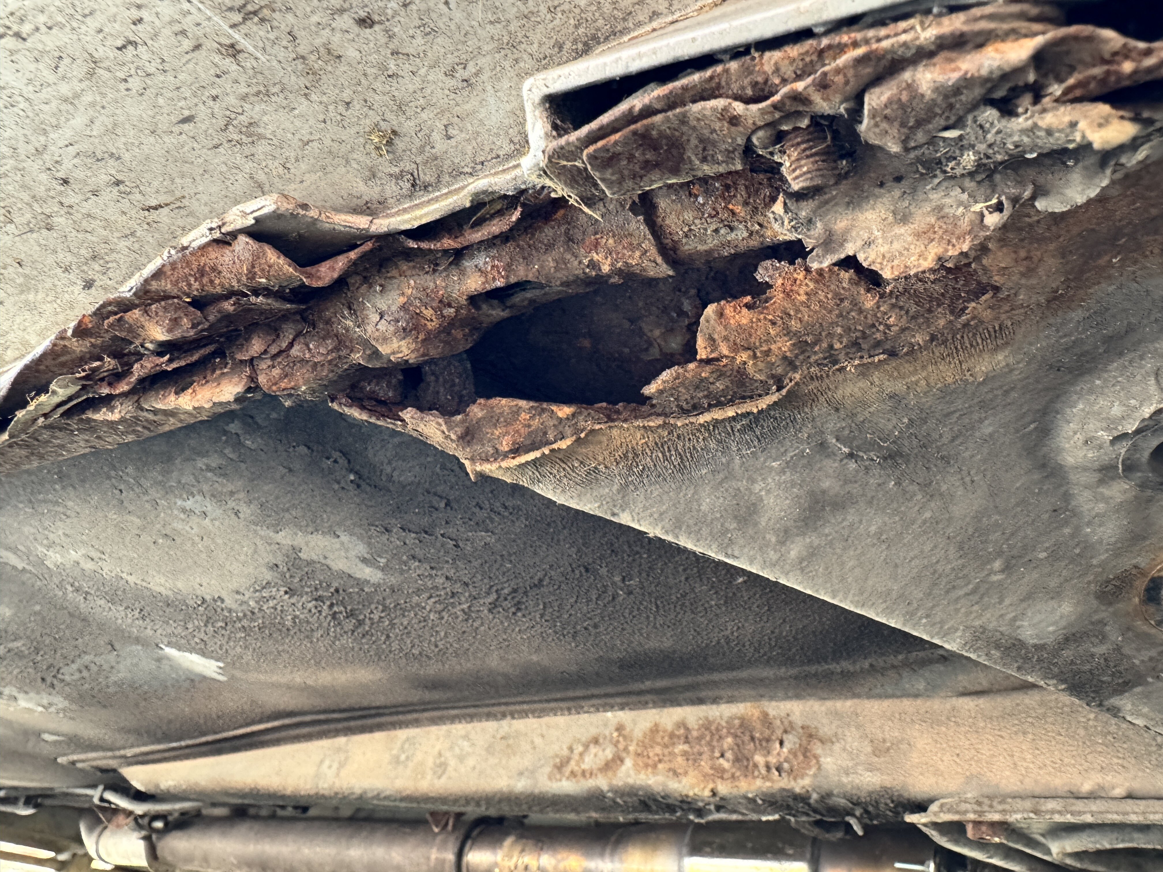

Also spotted that the scabby sill has now got dramatically worse since the MOT, so that is going to need to be cut out and welded. Should be fine until winter though right?

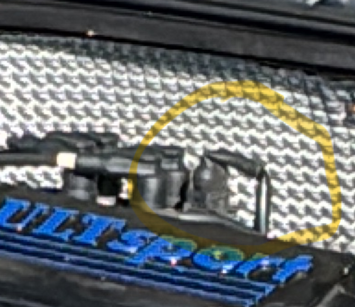

First outlap and the whole thing cut out and lost power for a millisecond. @Myfanwyi took all of 7 minutes and 34 seconds to fix it. I left the go pro on by accident so timed it…
Engine cover had been pressing on the plug that goes onto the coil pack, a sensor had unplugged itself by the oil filter and id sandwiched the maf sensor at a weird angle when I did the coil pack. Anyway one of them of all of them were causing it. No issues the rest of the day

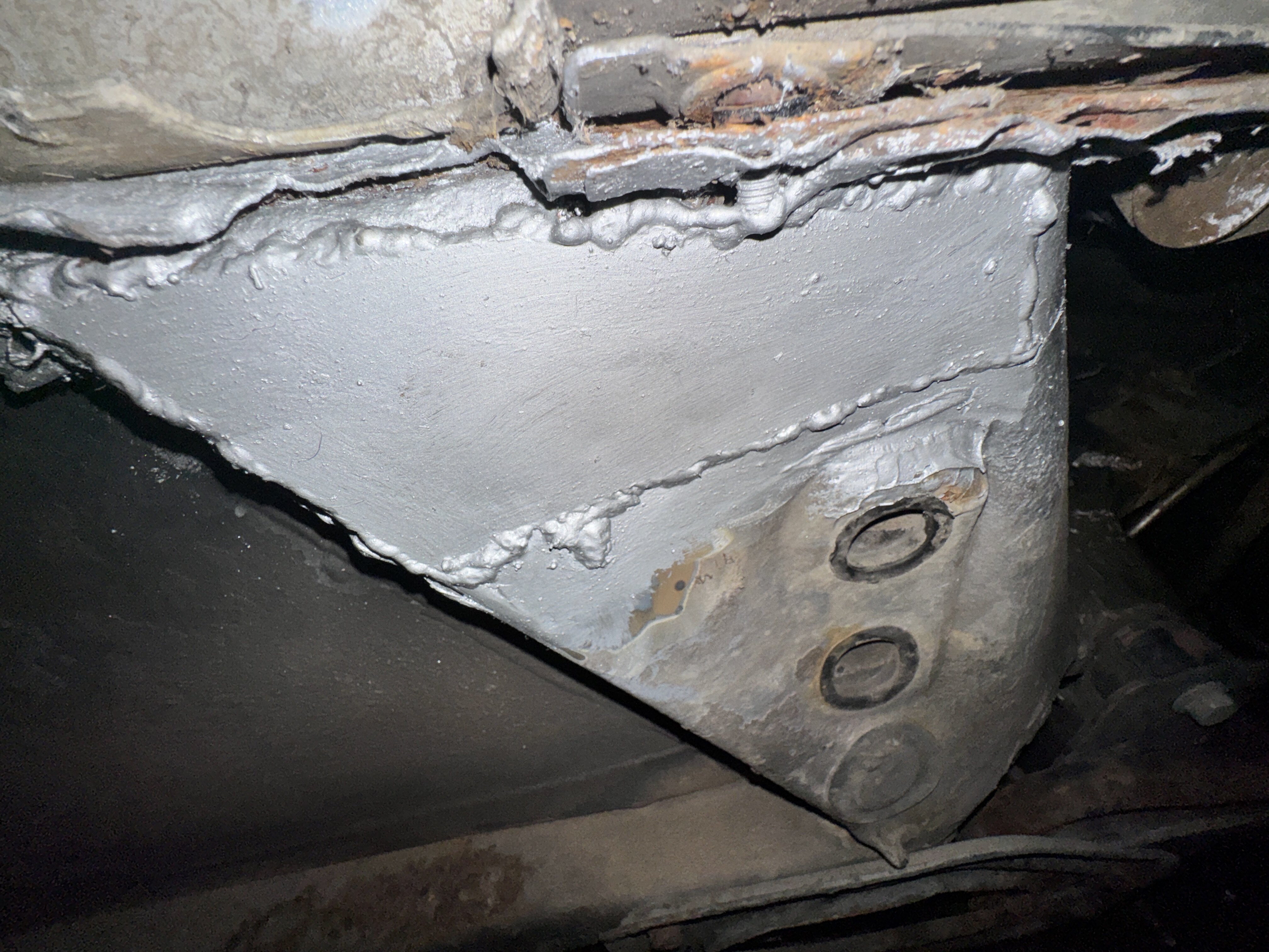

Finally got the sill welded and they did the rear arch as well. It’s rough as a badgers arse but it’s done the job.

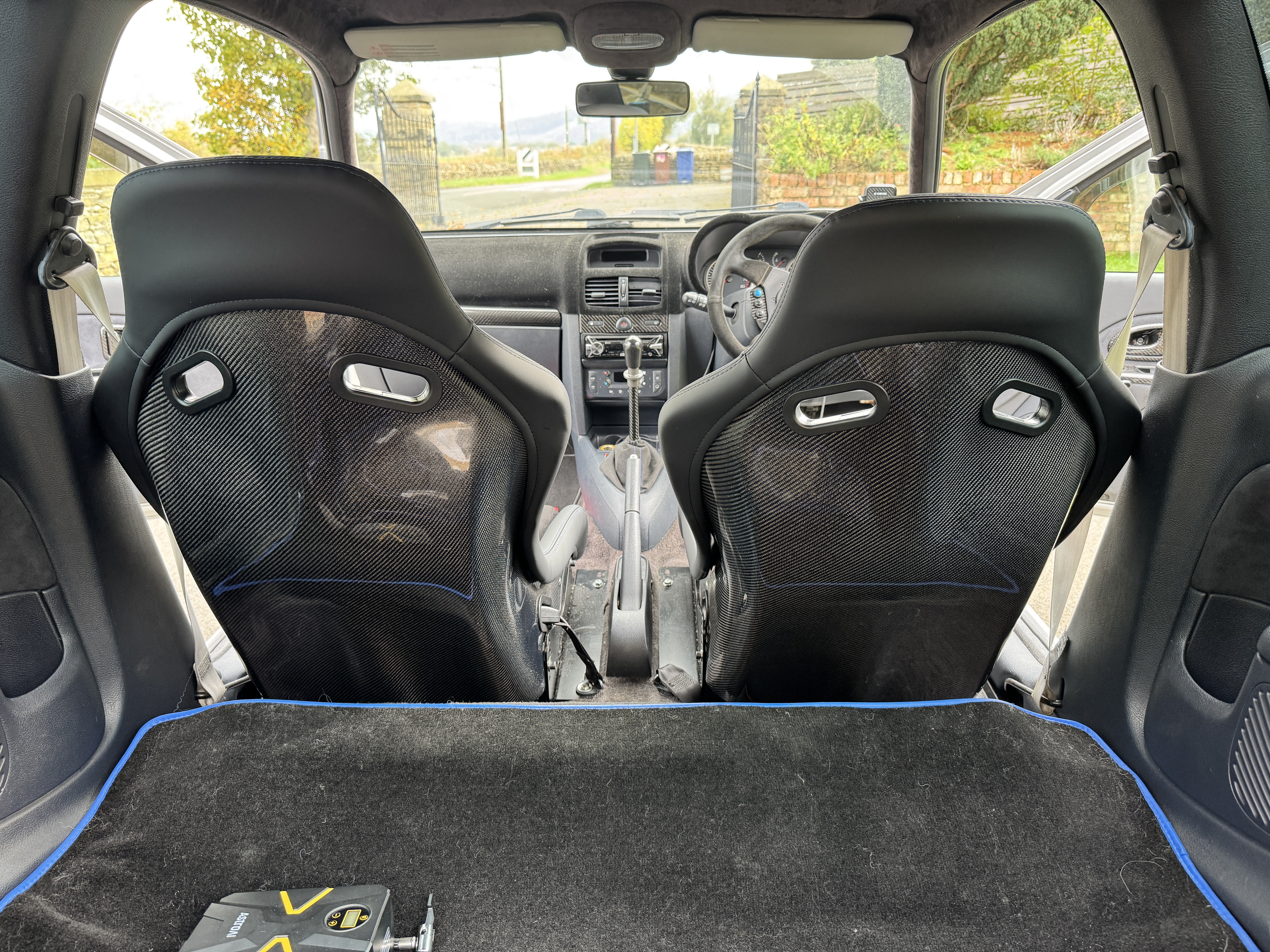

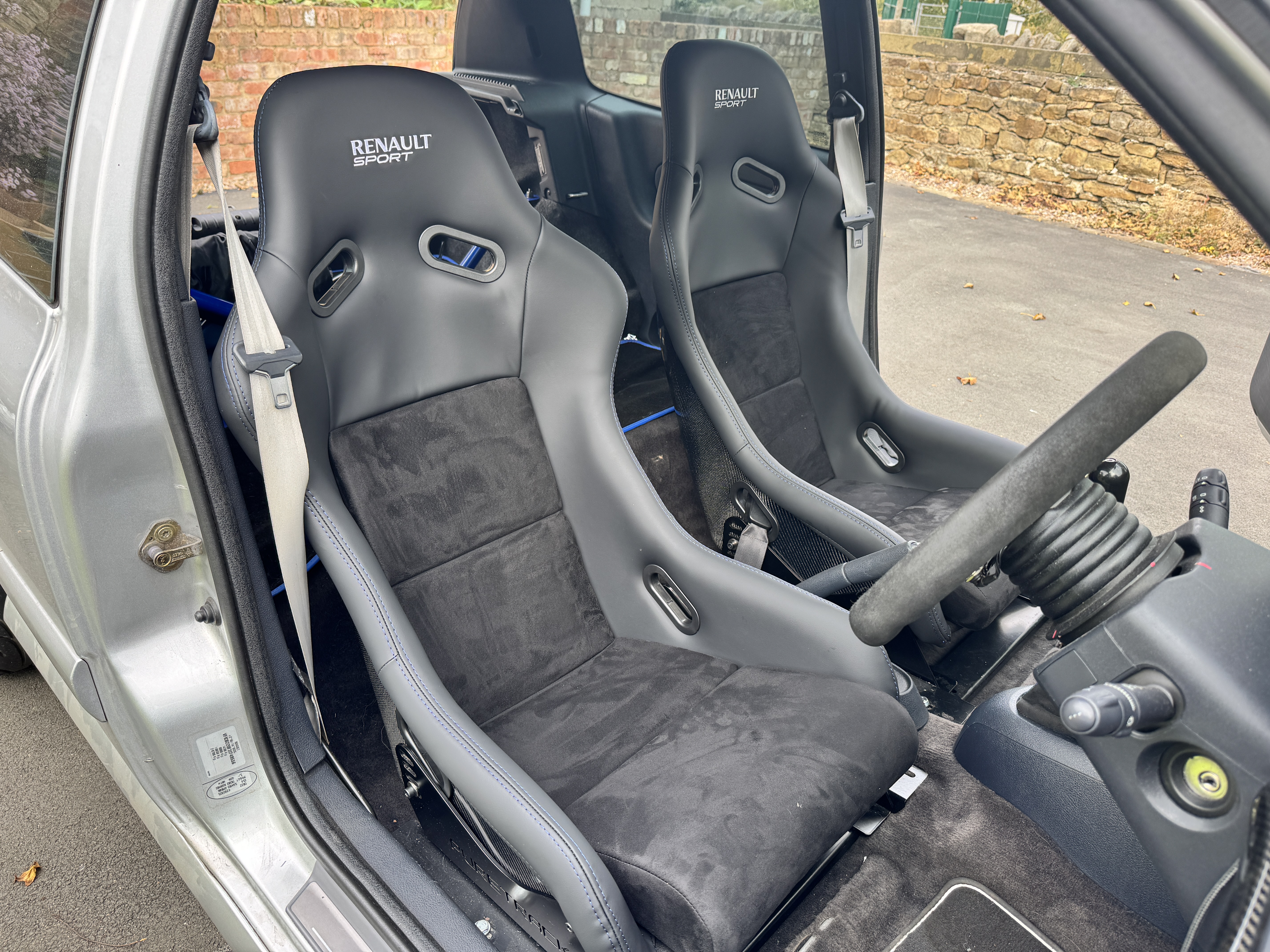

Something a bit less rough. My overnight (2 months) parts from japan (china) arrived today, so got excited and sacked off the rest of the work day to get them fitted. Need a little bit of moving about so I can actually reach the pedals and steering wheel, currently set to bradford RS3 elbow delete spec. This afternoons job.
Very happy with the quality considering they were a quarter the price of real recaros. custom logo on the headrest and custom blue stitching.

How much and what did you do for subframes? Always been a bit scared of trusting a random chinese factory with safety items, but they look really good.

They were about £500 a seat plus shipping and taxes, genuine carbon fibre. I didn't use their mounts and just used what I had for my corbreaus. What they supplied was pretty flimsy. I had measured up and confirmed with the seller the dimensions before going forward with it

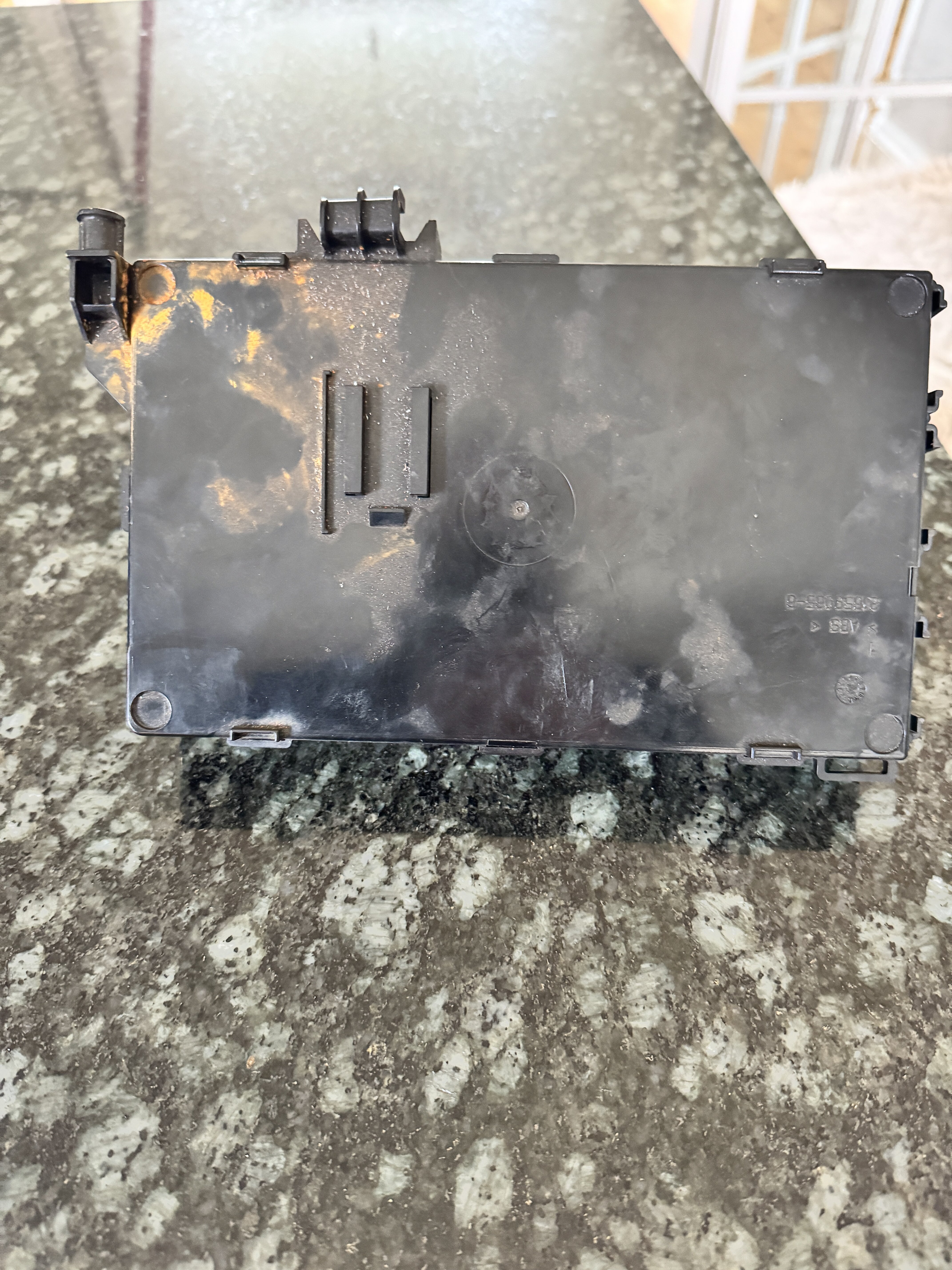

I have absolutely no idea what the cause was or how to stop it coming back, UCH? Wiring?
Would be nice to be able to go for a drive and not have to be scared to turn it off for the fear it wouldn't start back up again!
Brigsy
  T.Turbo
Hard to say without looking. Basically, solid red immob light means key is recognized but communication between ecu and uch is not working.
last time i fixed similar issues, it was knackered wiring on the engine loom. I would start by checking the white engine bay plug for corrosion. Then check the twisted pair of can wires (white and purple) across the plug for continuity. If thats ok start checking the can wiring, power and earth from white plug to the ecu for continuity as the loom can break.
Also could be uch failing. Id send it away to dieselrepairspecialist on ebay for a once over.

Thanks pal, appreciate your help, I'll pull the UCH and send it off to him, found him on ebay.

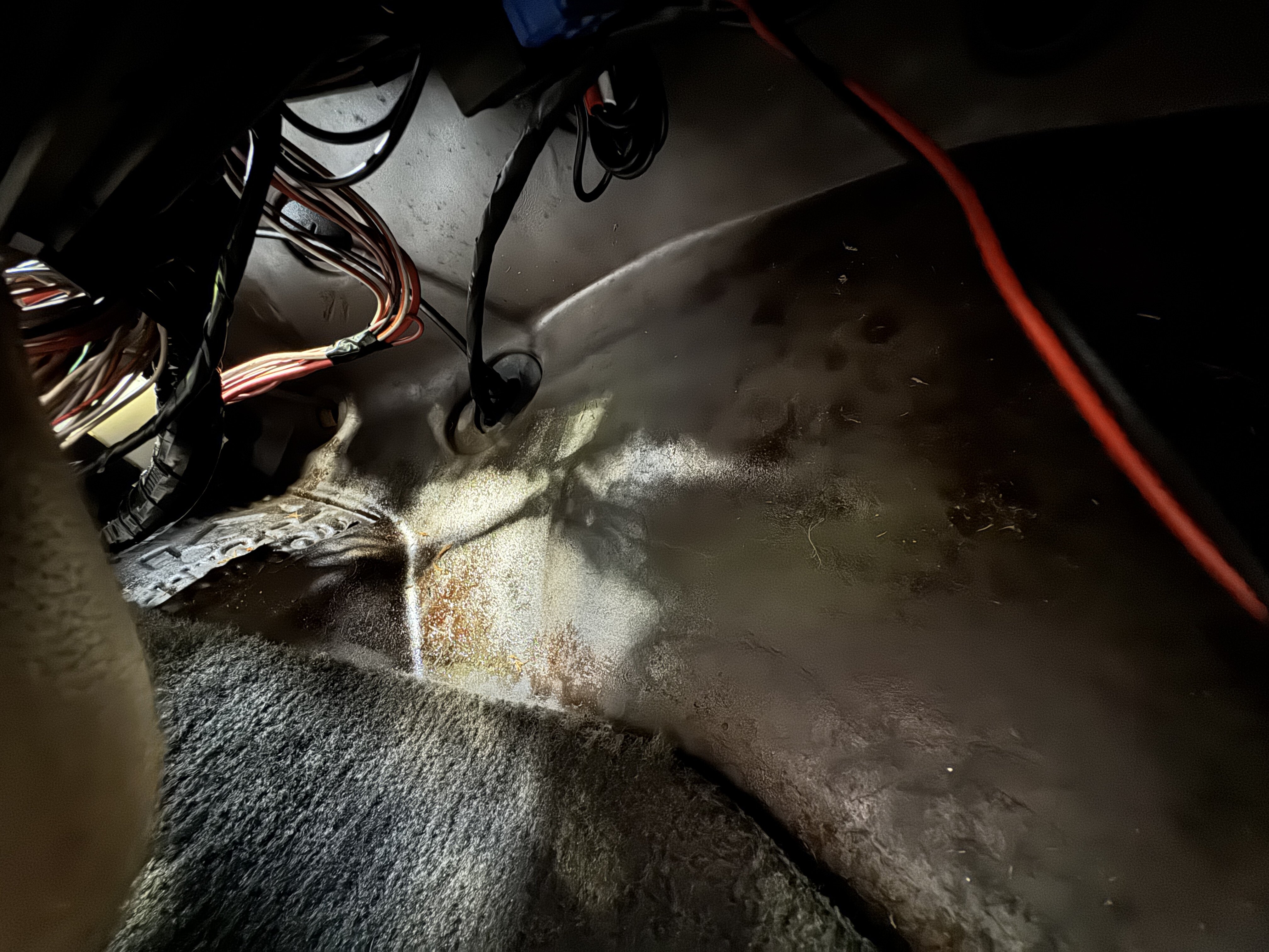

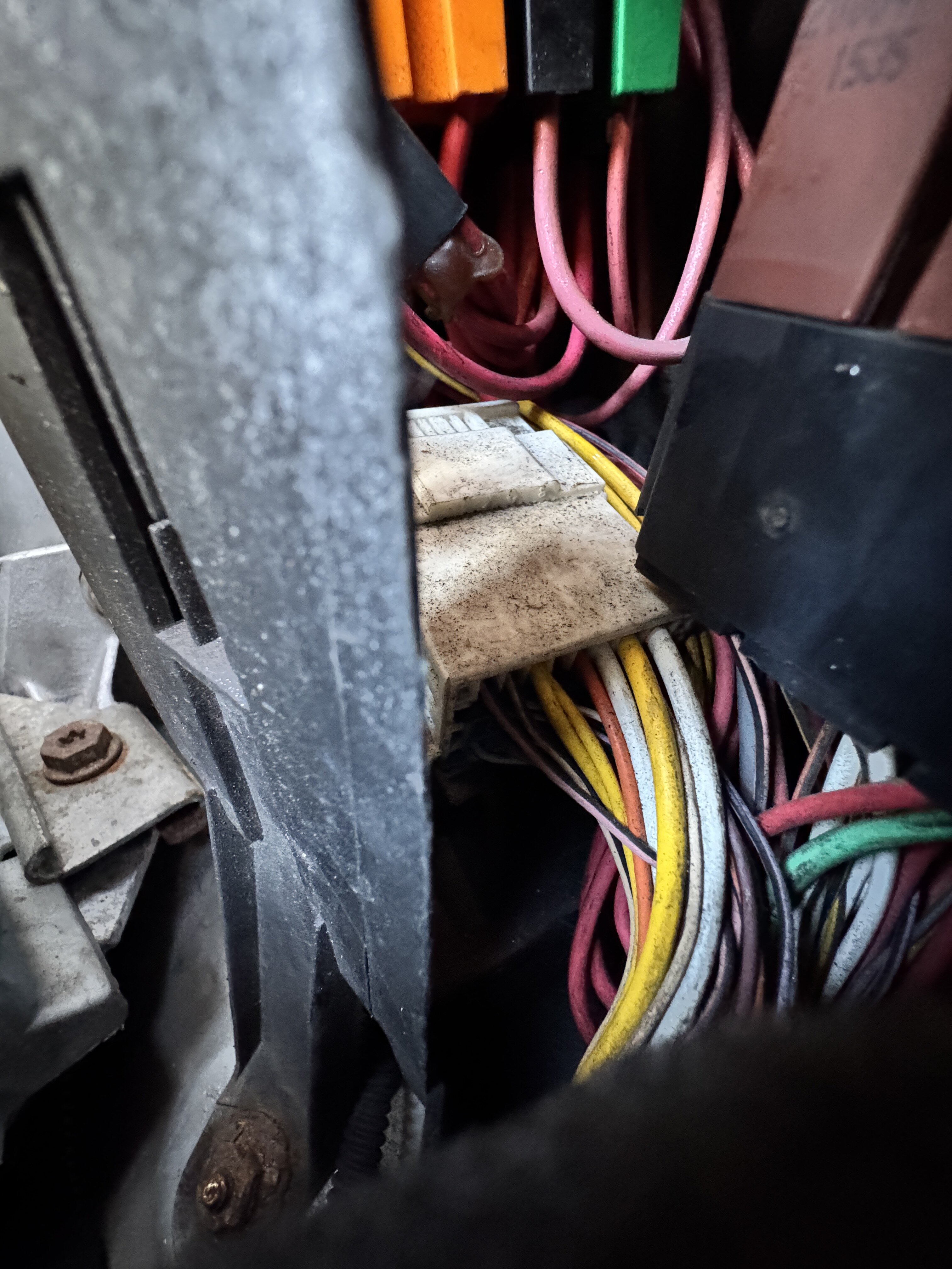

Check the grommet on the firewall. I bet they've installed the alarm like on mine where they've left the grommet out like c***s
Rskennedy
  Clio 182

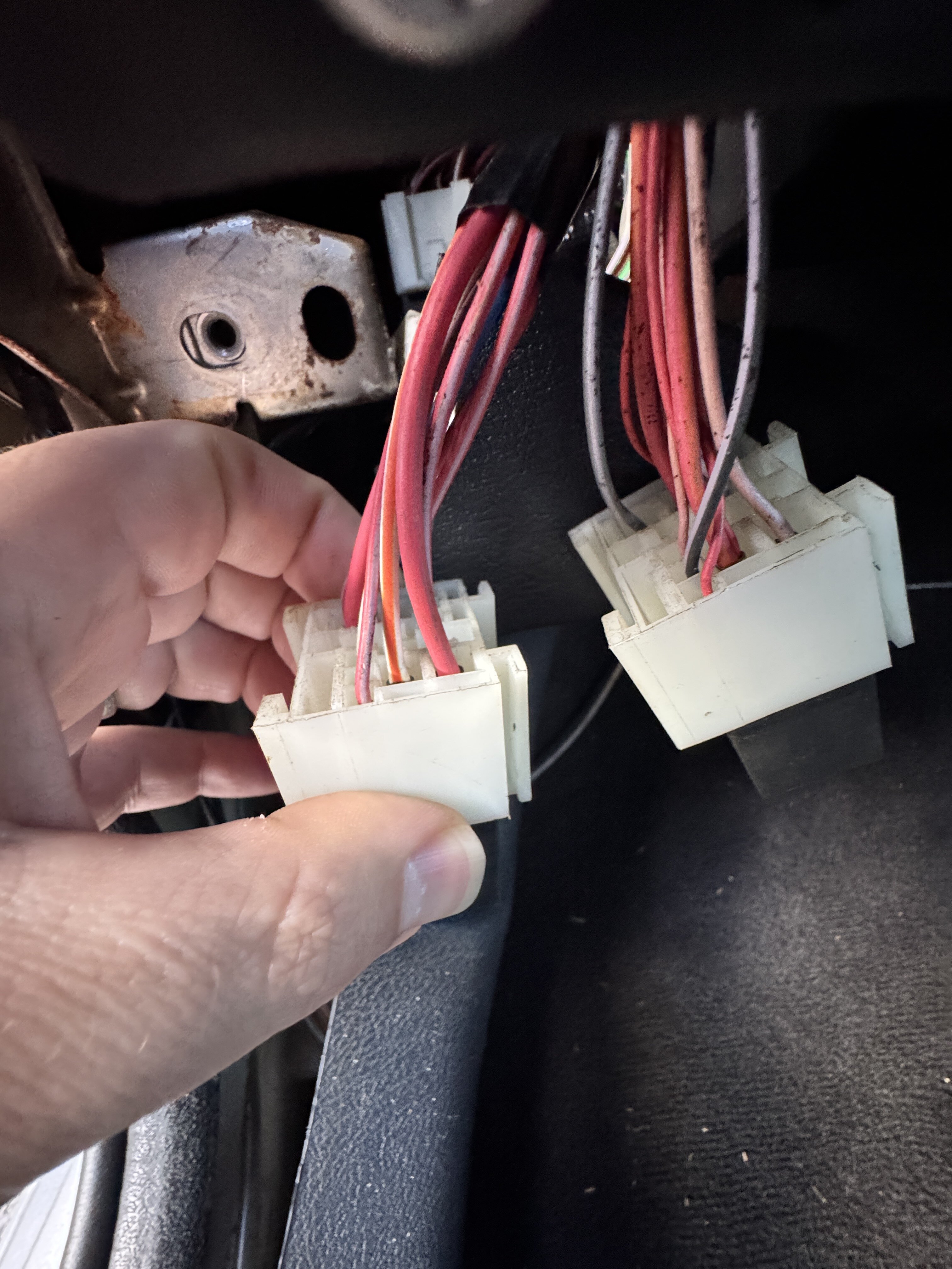

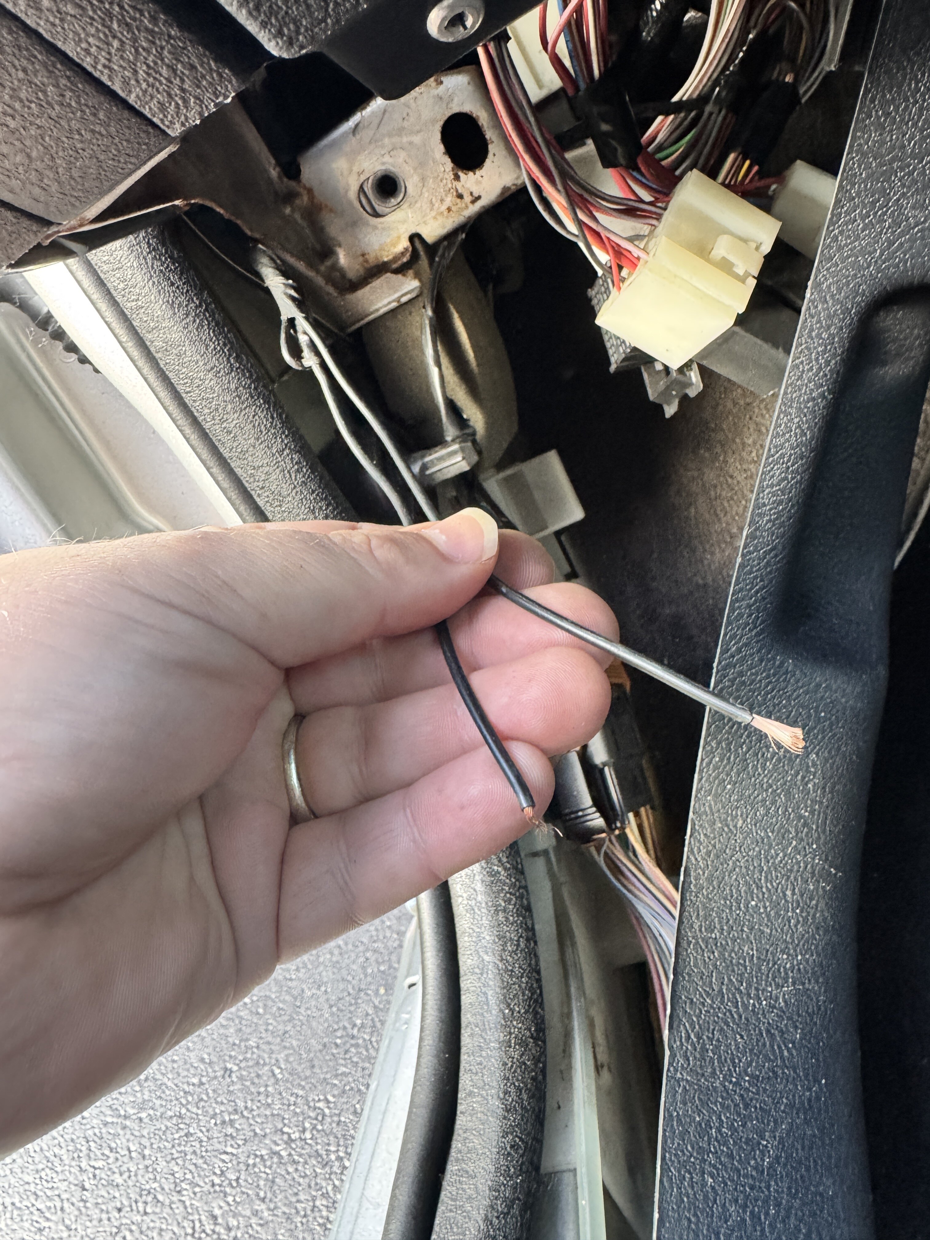

Had a little look through today and the grommet is there and nothing is damp all the wiring looked intact on all the connectors and nothing looked corroded. Just s**t loads of carpet glue on the firewall.
UCH should arrive with diesel pump repairs today/tomorrow so hopefully there’s something obvious there.
Tested all the fuses and they seem to be fine as well.
I did find a couple of random black wires in that area (speakers or something?) that weren’t taped up so I do wonder if that’s causing a short, now taped up

UCH back from repair. 24 hour turn around, thanks for the recommendation @Brigsy
He said there were no obvious faults but redid the 16 pin plug just to be safe.
Back in the car and it seems to have resolved all my other gremlins, so whether it was this or something shorting who knows but it appears fixed.

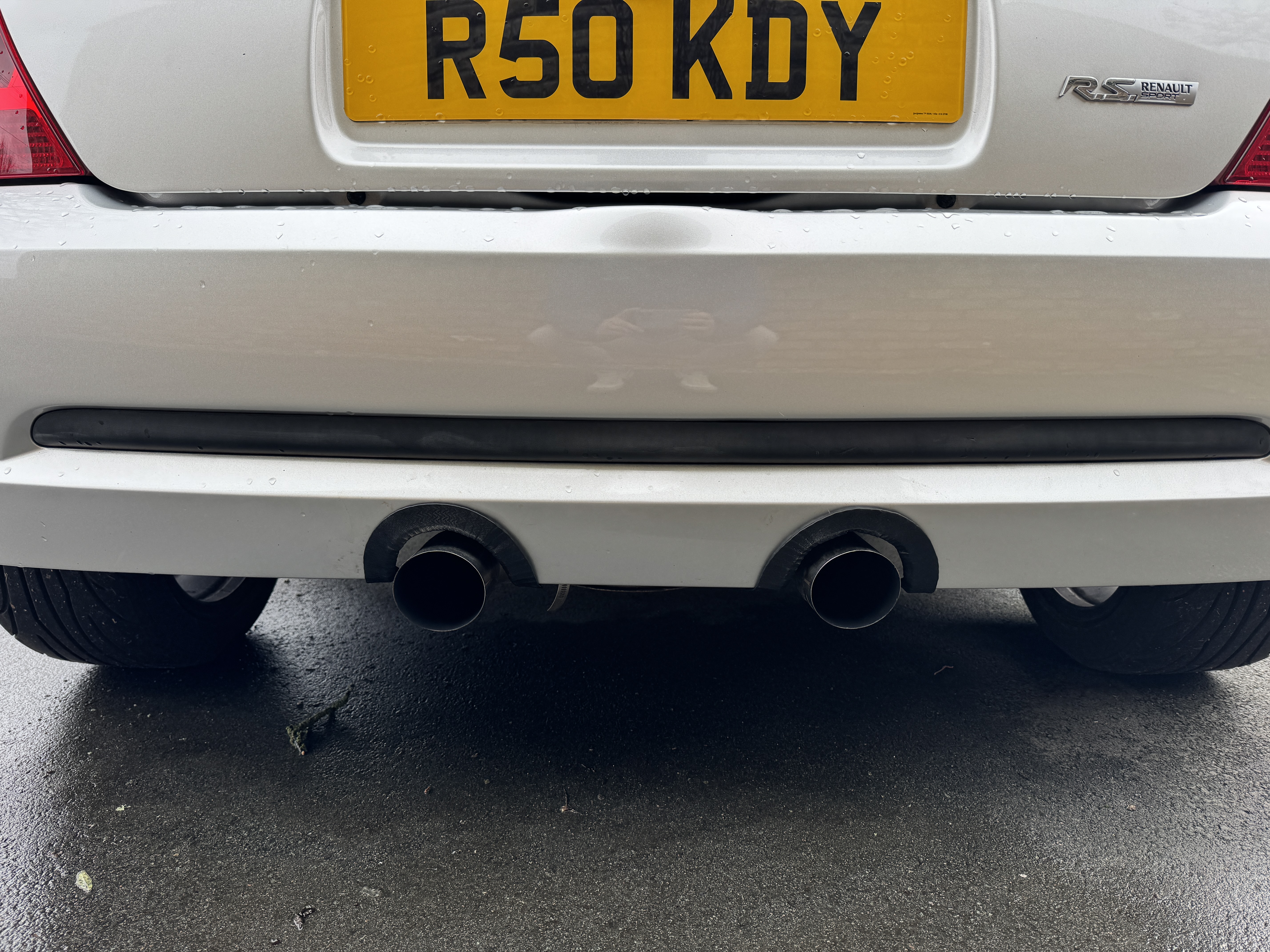

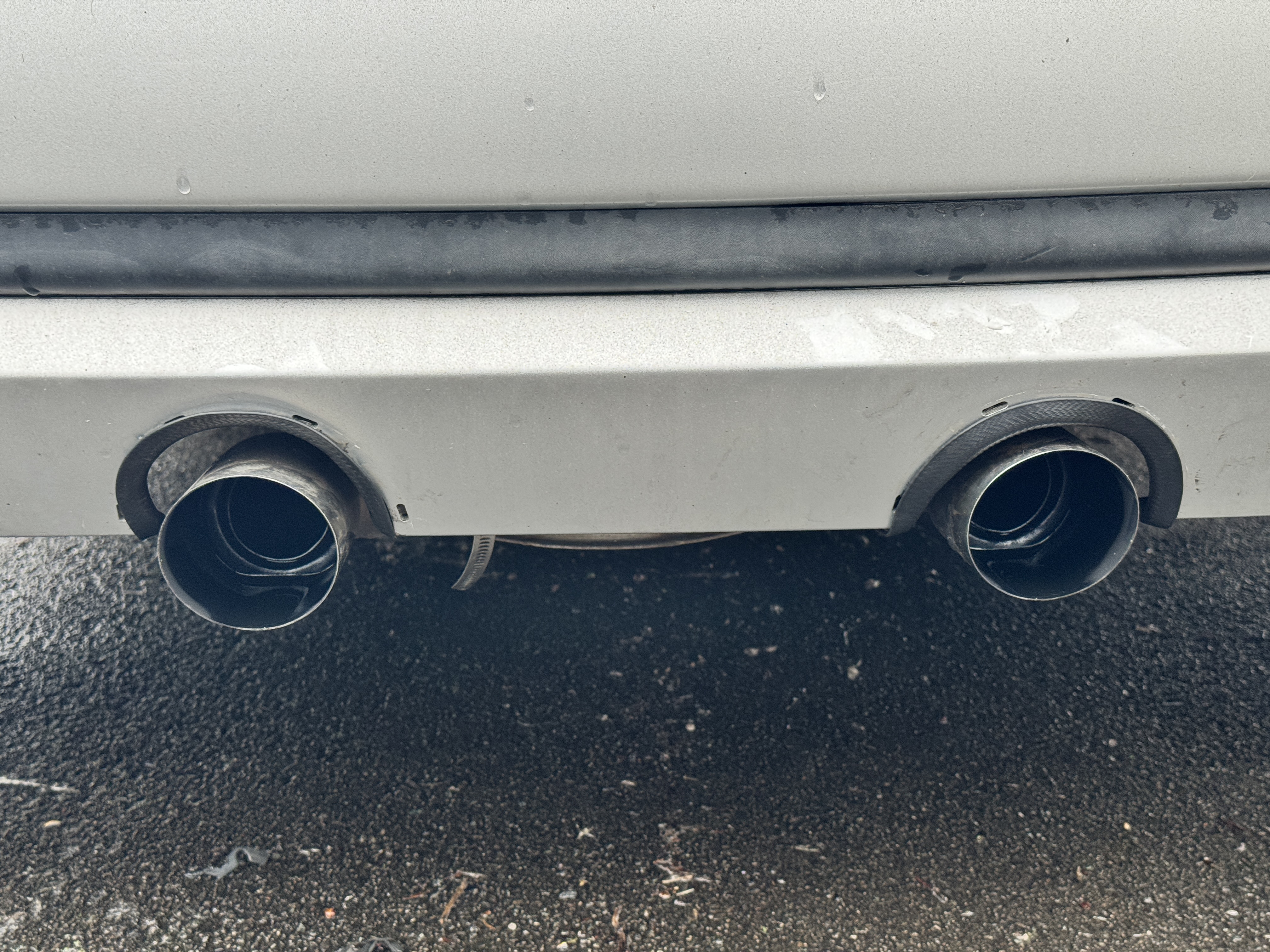

Set about sorting the melted exhaust trims but the trimlok I bought isn’t wide enough. c**k. At least I know how to make it neater for the next time!
Overall scrubbed up well and looking forward to enjoying it this year, Croft and oulton park already booked in and will be at cliosport festival as well.

Was dry yesterday so armed with some slightly larger (maybe too large) trimlok I set about attempting the exhaust surrounds again. Turned out quite neat but possibly its a bit too thick lets see.
Delighted with my work I thought this required a test drive, car started up and the idle was all over the place... normally its really smooth and has no issues. Plugged the OBD reader in and only codes showing were standard stuff for missing parts off the car. Checked live data and again all seemed normal with throttle positions etc...
Pulled forward on the drive and found a rainbow oil slick left where its been sat (been in the same place about a month so not too worried) Oil level seemed fine took a look underneath and looked to be mainly on the gearbox, so could be the gearbox again from the driveshaft seal that was sorted previously.
Its booked in for a once over and MOT next week anyway so will see what they find but hopefully its an easy fix and I can enjoy it when the weather gets better.

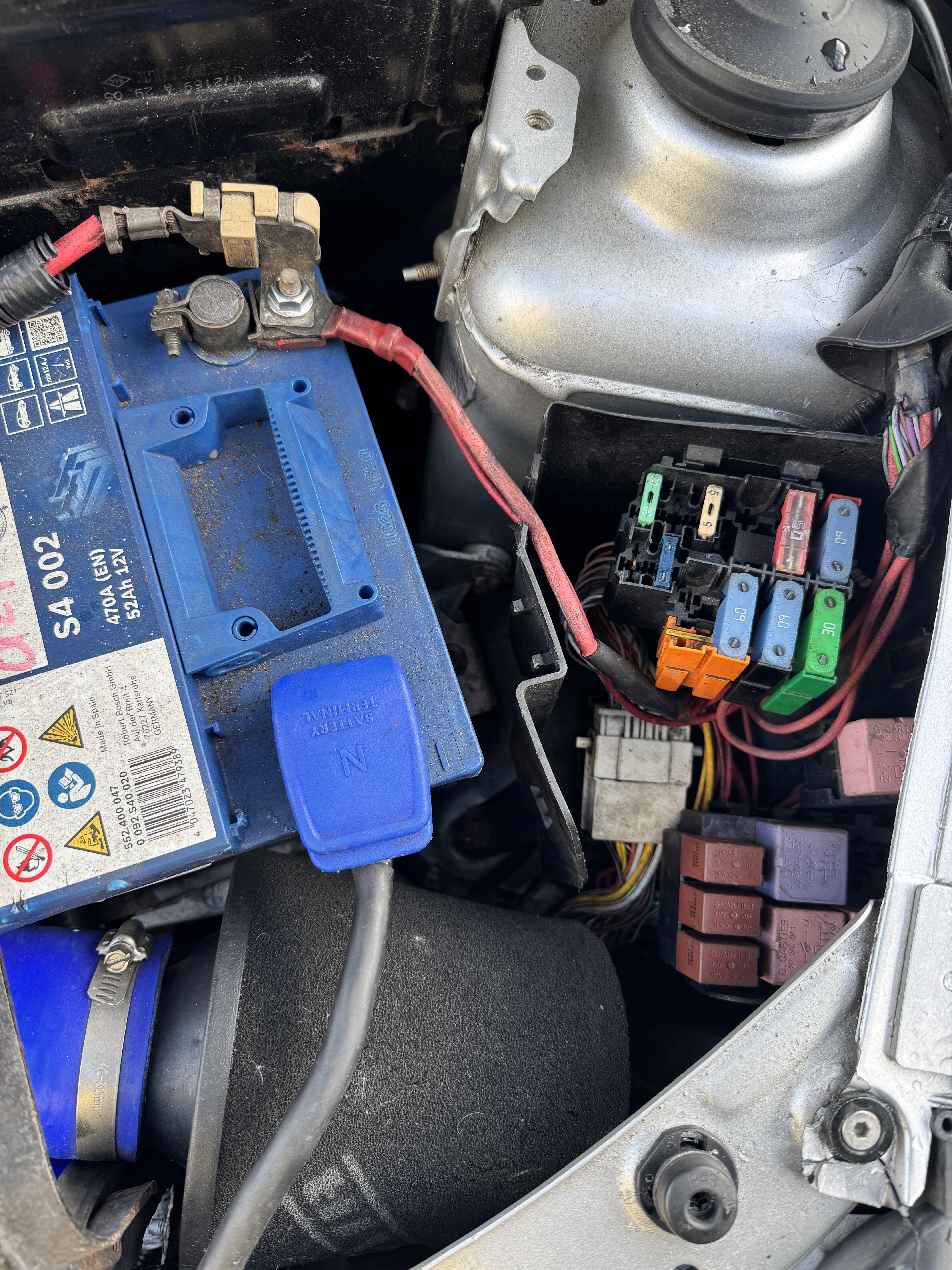

Told you I’d be back but sooner than I thought. Took the thing out for a quick drive today.
Electrical warning light and limp mode has come on.
The when I got home turned it off and the electrical warning light went off cranked the engine again and was revving its nuts off on its own to 3-4K revs like it was the other week.
Any ideas?
Rskennedy
  Clio 182
So with the help of Chat GPT and my code reader I have to the conclusion that my alternator is failing.
Chat GPT informed me that the ECU might have had a blip in voltage to the throttle pedal and thats why the electrical light came on and it went into limp. The fact it was hot added to its suspicions and the reason it revved when i turned it back on was because it was relearning the throttle position.
Armed with this knowledge i went back out with the code reader started the car up again, this time electrical light was on again but started fine with no fluctuation in revs. I checked the voltage and it was pretty low at around 12.78V. This time the code reader picked up DF129 pedal incoherence between track 1 and 2.
At this point I thought, throttle pedal, but with the low voltage, that might be why its throwing it, so i decided to turn everything on, lights, radio, heated screen, etc.. and watch the voltage, which dropped down to 12.08V
When i turned everything off again it rose back to 12.5V.
My question to the much smarter people in the room than me is.... is it the alternator? Is heat soak causing it to fail more when driven hard?
Brigsy
  T.Turbo
f**k chatgpt off for starters :LOL:
Voltage should be 13.8+ when running. Id verify with test meter.
Needs scanning with clip to see whats stored. Might be pedal, tb or wiring at a guess.
