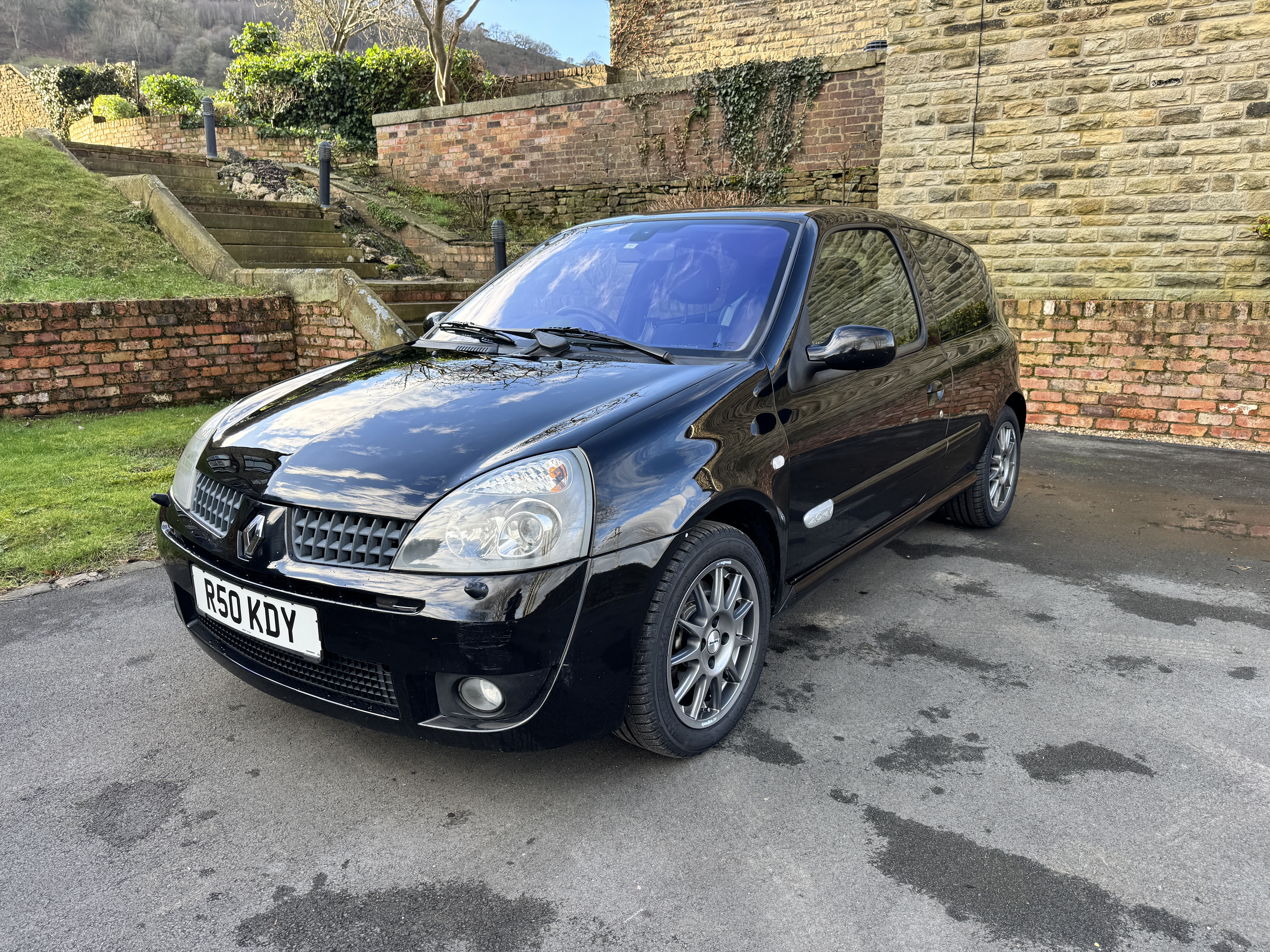

Hi All,
As some of you may have seen in the intro thread. I have recently bought a 2005 clio 182 non cup in black gold. Its got 83k on the clock and the belts were done at 78k according to the invoices, so I should be in good stead. It spent most of its life in the Orkney Islands before ending up in Essex for the past 5 years original plate was YF05YHO not sure if it was anyones on here?
I had a 2004 clio 1.2 as my first car so have a sentimental attachment to phase 2 clios! I have just come from a 595 abarth competizione with all the trimmings as my weekend fun car, being in the Yorkshire Dales having a small car for B roads is great fun on the weekend when theres not cow s**t everywhere.
Pic of the Abarth - As a comparison the clio feels sharper and faster without all the lag from the turbos. Everyone goes on about how s**t the seating position is in a clio....drive an abarth!
Car came as standard but with a stainless exhaust system and sports cat, looks like either Pure / Ktec but it has no branding that I can see. Its a bit...loud.
Bad Bits
I have a knock coming from the rear drivers side, you can feel its loose when you rock the wheel stationary
Powersteering doesn't seem to be working at a stand still
Belt whine (could be something to do with power steering)
2nd gear sounds a bit rattly, but that might just be the resonance of the exhaust
Missing the front splitter
Paint is swirly and has a lot of badly touched up scuffs
Interior is grim, sticky buttons, gross seatbelts, badly tinted rear windows, generally gross
Drivers seat has a bit of play
First thing I did was get the 182 wheels off and swapped them for some 15x6.5 Turinis ET38 (I think) wrapped in Michelin PS3's 205/50/15 and its already transformed the handling.
Car is headed to the garage tomorrow for a once over (I am not good with a spanner, I drilled through my own finger putting my number plates on...). So I will update the thread with the outcome of that.
@Andy P I spent the past 3 days reading your thread and I am promising myself I won't get as carried away as you... but claude makes a convincing argument to spaff all my cash...

View attachment 1729209View attachment 1729210View attachment 1729211View attachment 1729212View attachment 1729213
Nice car mate! Enjoy!
Btw whats with the suspension? Seems to be sitting pretty high.
Does seem really high and those rear shocks look, unfamiliar?
Nice clean base to start from.
Cheers everyone
Rear dampers are some cheapo OEM copy ones and springs look stock too. 15” wheels obviously add to the monster truck vibes.
I will eventually move to coilovers once I get stuck into it. I do like the way it rides over the bumps at the moment though. One of my big gripes with the abarth were the stock bilstein shocks were sooo crashy, rattle your teeth out.

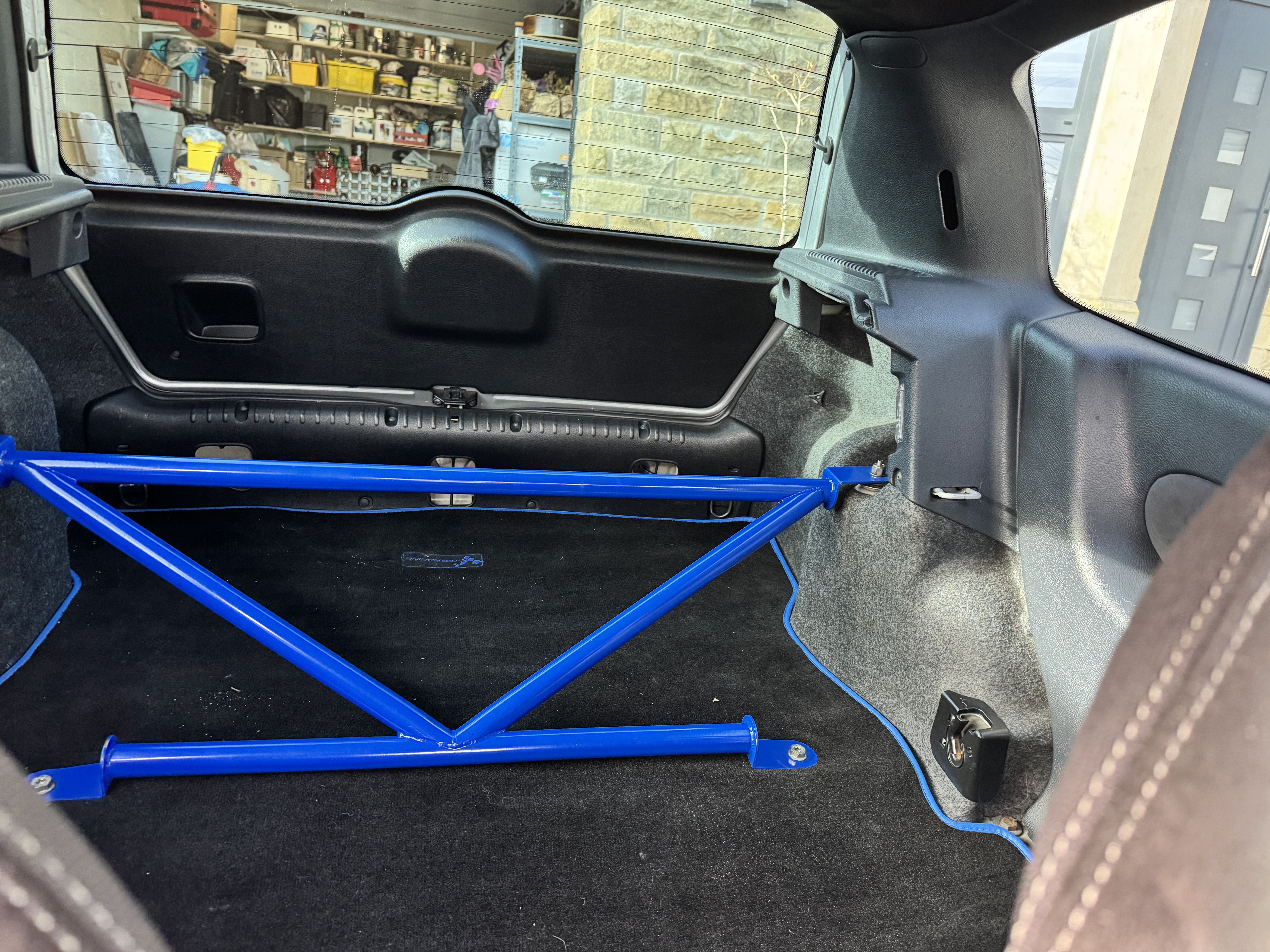

  • Strip out the rear, sound deadening and carpet, possibly a K-brace or strut brace

Blue k brace

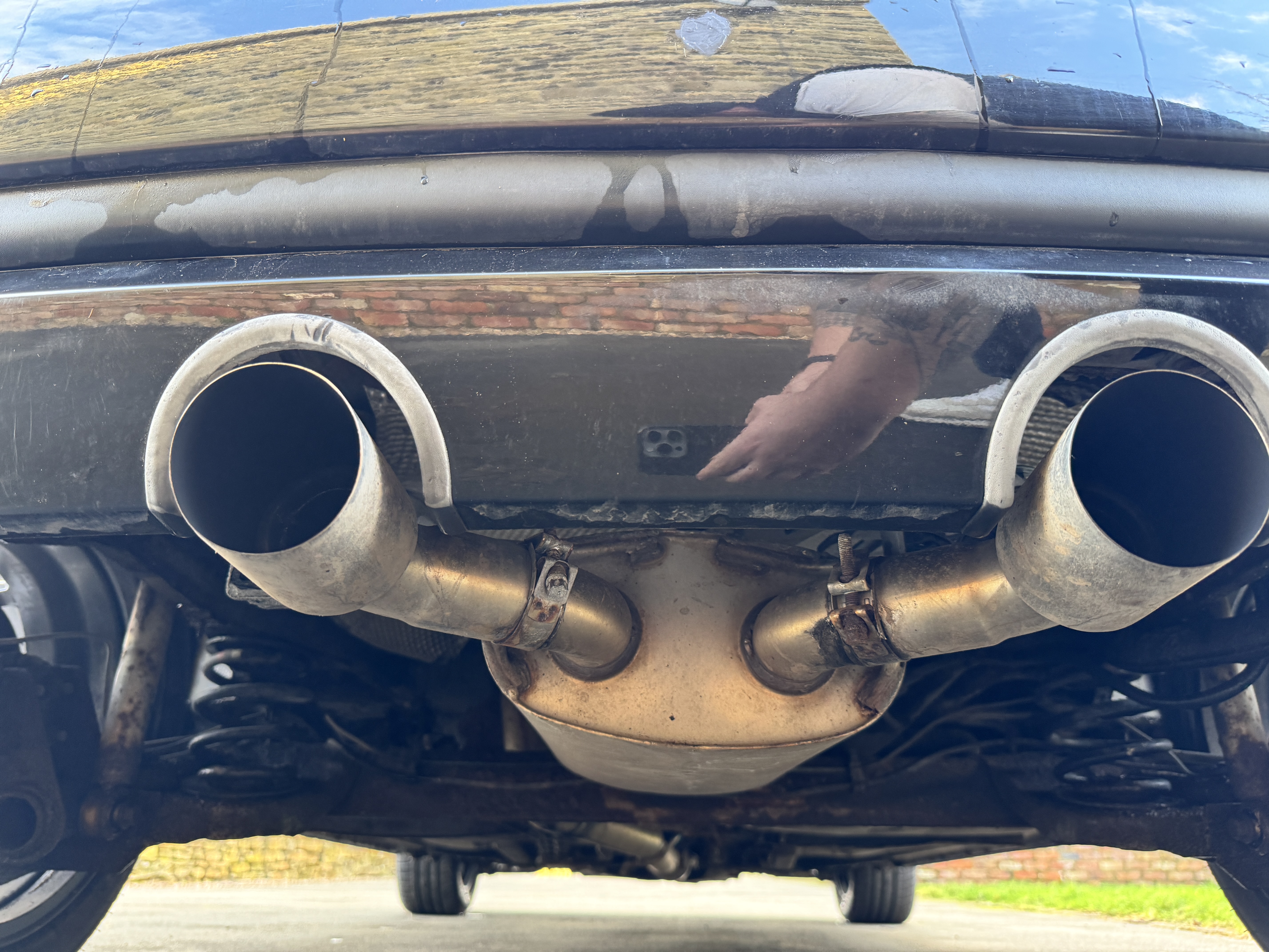

After driving to Manchester airport and back and being absolutely deaf by the time I got there decided to fit some sound deadening to relieve some of the noise.
Great success and has made the car much more liveable.

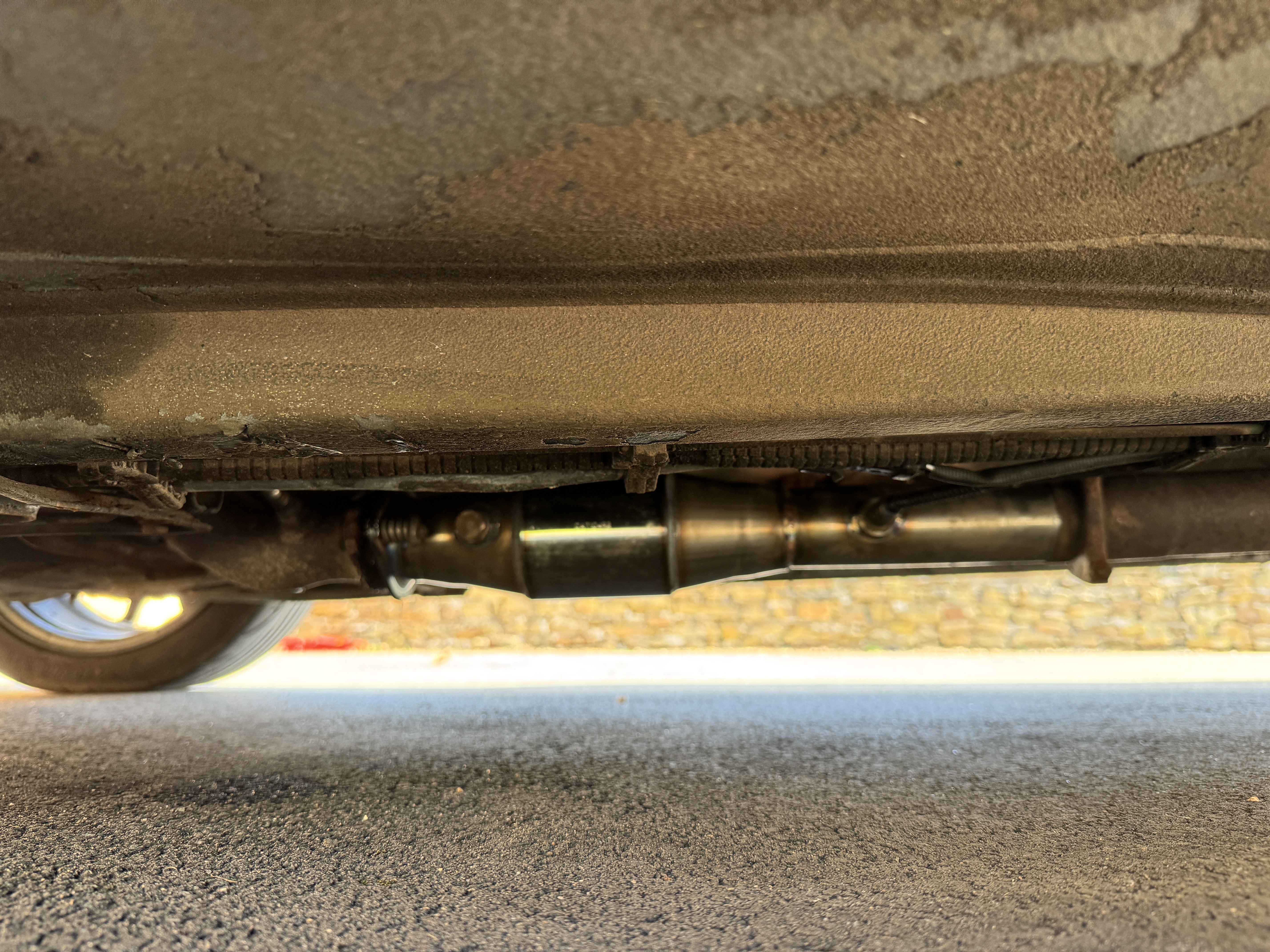

Ktec sports cat ordered ready for the MOT and to further tame the noise and fit PMS bump steers whilst I’m at it.
Next up after that is trying to resolve the PMS shifter rattle. I’ve got plenty of sound deadening left so may wrap that around the linkage instead of filling it to see if that can solve it.
Car is back with a pass for the MOT!
Ended up buying a Ktec Sports Cat which was no issue on the emissions and has transformed how liveable the car is. So much quieter and a bit less embarrassing.
