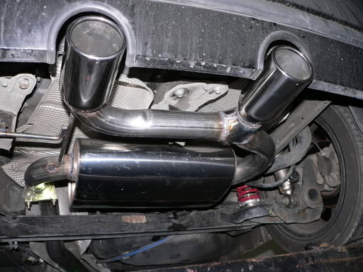

Charlie is superb at fabricating systems ... although my welds are falling apart 18 months on. It's blowing more than Paris hilton on a night out. I will probably have it fixed up (under warranty) before I pass it on.

Can I ask (possibly a stupid question) but isn't 2.5" bore for the pipework too big for a n\a engine? Isn't that a size people say you should have for a forced induction system?

Too many harsh bends imo.
Glad you are enjoying the noise !!
Mate those bends arent harsh! They are so sweeping and unrestricting I think. I have no background in it and am more than happy to be shown im wrong but look at how smooth the bends are. The cars response is amazing too.
