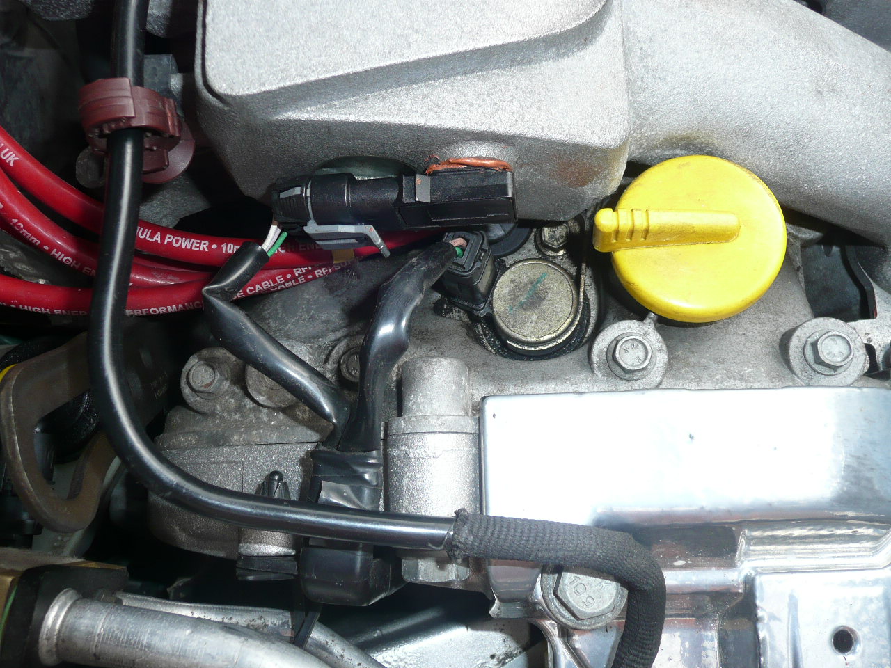

Hi, I'm new to forum as just bought my wife a 2004 Clio 182. Bought private and drove for around 100 miles before emission light came up.
Checked the codes and found P03000 referencing a low fuel pressure issue. Suspect after reading through many threads on here that the fuel pressure regulator could be suspect so took advice and now start the car using the ignition on then off then start method and starts great. However just wondering if anyone knows whether this pic shows the regulator for the car ? (The round metal cap to the left of the oil filler cap).
If it is does: Anyone know of a procedure to remove it clean/replace it?

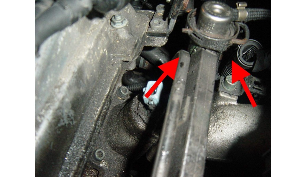

I believe the fuel pressure regulator is on the fuel rail
Stole that image and its the metal top bit where the arrows point.
Online there are plenty spares to be had to replace it.

on a 182 the fuel pressure reg is built into the sender unit in the tank underneath the rear bench seat, the round thing in the picture is the VVT solenoid that reads the cams, nothing to do with the fuel system itself

Thanks RTC I haven't even seen that component on my fuel rail :neutral:
Reading Coops reply I think it might be closer to the mark, I will investigate further.

Hi Coops, thanks for info, It makes sense, that sensor is monitoring the cams considering its proximity on the head.
I will check to see how to get into the fuel tank once it has emptied a bit.
