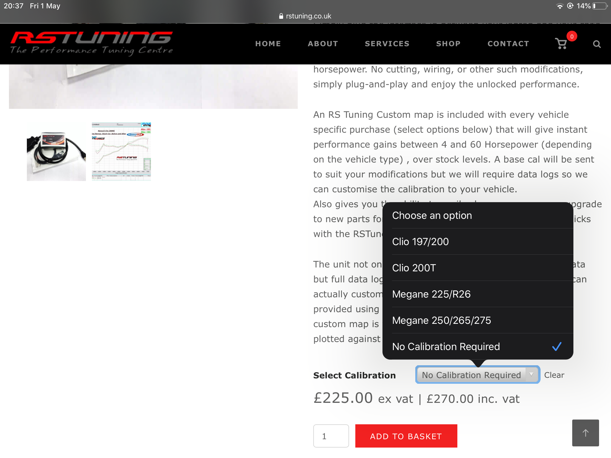

thanks for your help, I still can’t see it on the website. Is the below correct as it’s all I can see?
New2RS
