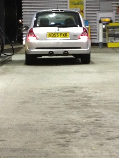

Could it be a failed spring? I'm sure the car sits Lower on the right hand side /:
  182cup & 172 racecar
Easy way to find out, jack the car up and see if the spring falls out.
Even mechanics miss out the rear washer that goes behind the disc.Fact.
  182FF
Lol then I'm shagged if the spring falls out ha. He's changed the bearing on my last Clio, maybe he forgot this time /: how do I check ha
JoshOm3
  Cup'182/Rs2'd Trophy
If you want to check if the spacer has been left out. Jack the wheel up and check for play. It will move a lot. Saying that if it's not in their. Park on level ground and look from the rear. One wheel will be cambered more than the other meaning the spacer isnt fitted.
