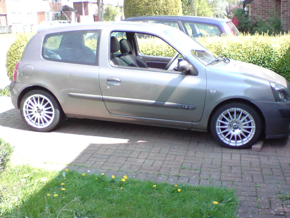

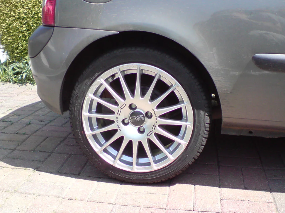

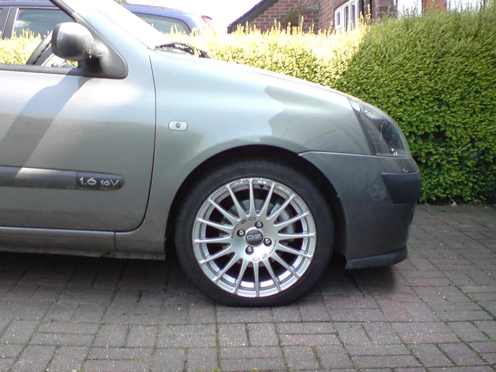

i've bought myself a set of alloys, oz superturismo's i put them on today to get an idea of how they look but the centre part of the hub is smaller than the centre part of the wheel. is there a way of solving this? or wud it be ok driving on them without the centre of the hub sitting together.

take them off until youve got the spigot rings....really dangerous!!
actually iive just started a thread asking about the size of OZ superT so maybe you could help :)
The spigot rings and wheel bolts will follow with the O.Z. rims when you buy them. They did with my Ultraleggera F1´s.
The rings are 60.06mm and are genuine o.z to fit the rimm center. So better get them from o.z
thanks for the info guys, will try n get hold of o.z 2morrow. i got the wheels second hand so no bolts or spigot rings with them. does anyone know of a wheel refurbisher round herts? not too expensive either! guna hav to get the sl*g drop a little so she doesnt look silly! oz_clio..i'll help where i can mate just give us a pm
