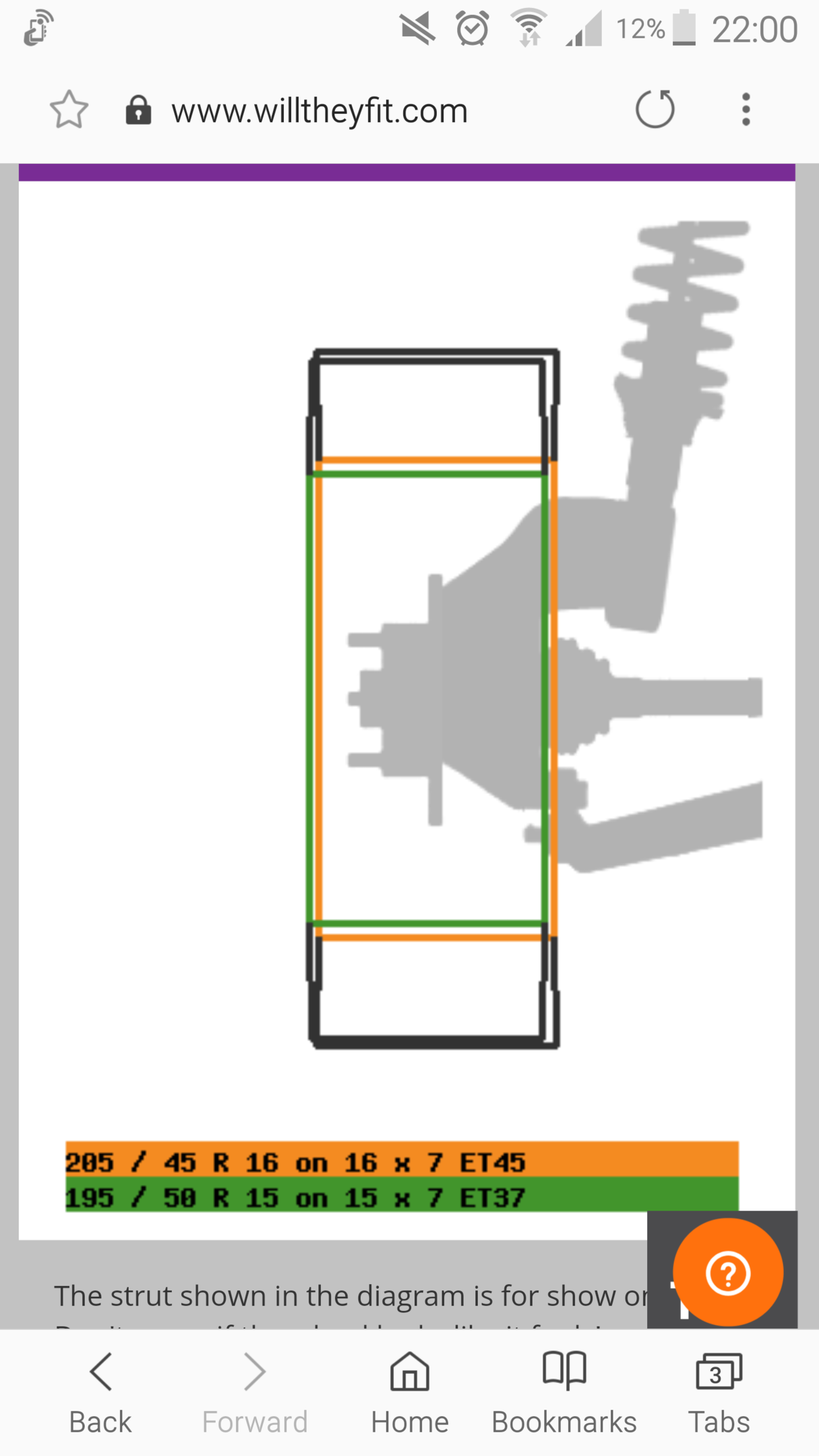

clio 182 newbie, i need some advice as im purchasing track wheels by tomorrow and am unsure, so the car is is 2005 182 full fat and will be mainly tracked, im liking the OZ ultraleggera wheels , so i have read diferent reports about arch rubbing etc , so are 7 inch too wide ?
afaik the ultraleggers are et37 and 7 inch wide, will these be a problem on my car with eibach pro srings and will evntually have coilovers etc, the plan was to get the ultraleggeras with yokohama 08dr 195/50/15 tyres.

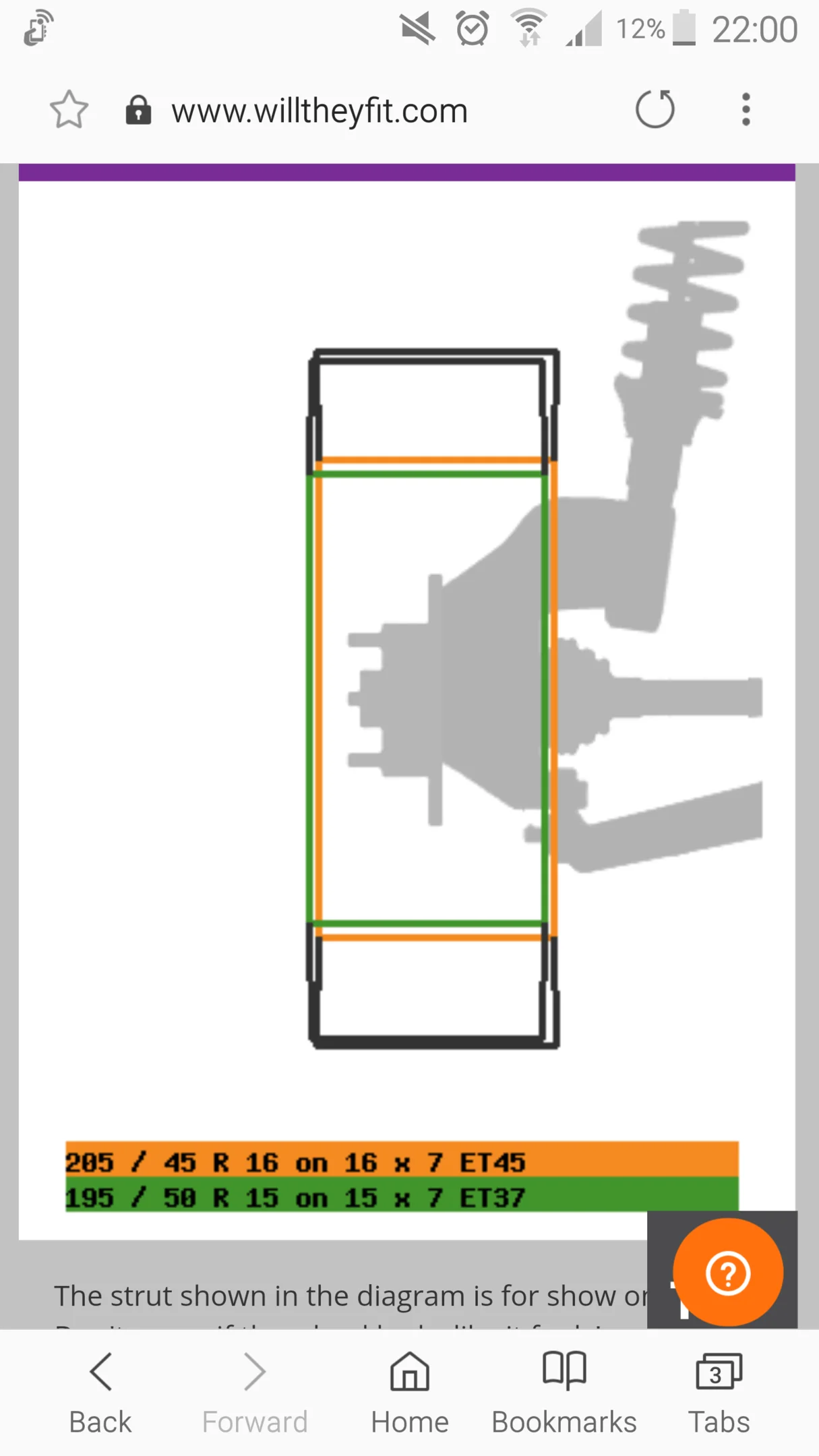

A 7J rim is the max size for a 195 width tyre and will look a little stretched also leaving the rim exposed to kerbing, but you should be OK clearance wise. See below for comparison presuming youre on OE cup wheels.
